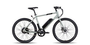

The Enterprise was the first electric bike model offered by EG in North America starting in 2008. While production of this model has slowed nearing 2015, it’s still one of the most affordable trail-ready ebikes I’ve seen retailing for ~$900. The suspension fork is very basic, lacking much adjustability or lockout, but the knobby tires and front disc brake combine with the sturdy diamond frame to create a capable bike. It comes in black or white but only one standard frame size and may be difficult to find at shops. For this review I got some input from Sam at the Electric Bicycle Center in Fullerton, CA and he still carries this model along with the EG Barcelona which uses the same electronics but offers full suspension and the EG Kyoto which also uses the same electronics but has an upgraded component set. While these electric bikes only offer ~15 mph top speeds, they do come with pedal assist, throttle mode and a locking removable battery pack that doesn’t hang off the back too far. The real appeal here is low price and frankly, given the year warranty and 40+ year track record of business that EG has maintained in the bicycle space, it’s a decent choice for budget minded consumers.
The hub motor in use here offers 200 watts of power and is a geared design that appears to be larger and heavier than more modern offerings I’ve seen. All things considered, it’s great for relatively flat and smooth terrain and being smaller it actually uses less power and may extend range a bit… but considering the small battery size I wouldn’t expect much over 10 miles for someone who weighs ~150 and relies on throttle-only power. I’m not sure which brand of motor is used on the Enterprise but it operated fairly quietly during my short ride tests and this may have to do with the lower speed and power output. There is no quick release on the rear wheel but the power cable that goes to the motor does have a quick disconnect spot which makes maintenance easier. The wheel size on this ebike is standard 26 which makes replacing tubes and tires more affordable and it keeps the overall frame height lower to the ground which may appeal to shorter riders or those who desire quick steering compared with a 27.5″ or 29″ wheelset.
Powering the motor is a very generic 24 volt 10 amp hour battery pack that’s mounted to the seat tube. I like that it doesn’t hang out too far behind the bike, this might protect the pack in the event of a tip. It has a built in handle that makes taking it on and off the frame much easier and helps to reduce the potential for drops. The pack slides onto a metal tray and feels solid while riding. You can charge it on or off the frame and having the ability to take it off for transporting the bike is a big plus in my book as it reduces the overall weight of the bike by ~5 lbs. The front wheel on the EG Enterprise uses a quick release so this might also help if you’re trying to stuff the bike into the back of your car. The cells in this pack are made from a Lithium-ion chemistry that should be light weight and long lasting but my guess is that, based on the price, they are lower quality cells. To maximize their life I suggest keeping the battery between 20% and 80% charge and storing it in a cool dry location (extreme heat and cold can be hard on it).
Activating the EG Enterprise is pretty straight forward. Once the battery has been fully charged you just slide it onto the frame and then you twist the key to “on” at which point the LED display on the right bar will light up. From here, you can read a basic charge level indicator that shows four dots. As you use the bike, these dots will turn off and once you get down to just one dot it’s probably a good idea to charge the pack up again. On the right handlebar, near the grip, there’s a rocker switch that goes from Low to High and this controls how much power you get in pedal assist mode. If you don’t want any pedal assistance you can set the rocker to the center position and the bike becomes throttle-only. While there’s no speedometer, odometer or precise battery readout on this bike, that’s part of what keeps it affordable and at least it has an LED power indicator. Note that it might be misleading at times because it basically just measures voltage and will drop as you activate the bike even though there is likely more battery capacity remaining. The cockpit feels a little cheap and crowded but the brake levers do have an integrated cutoff switch for the motor when activated and the two large Shimano SIS shifters are intuitive to use. Having 21 speeds to pedal with on this electric bike is nice given the lower power level on offer.
Surprisingly, even with the lower motor power and smaller battery pack this bike isn’t very light at ~55 lbs. I think that’s because it’s using cheaper batteries that aren’t as energy dense and the motor is generic and not as finely engineered as newer ones. This is a case of “you get what you pay for” and frankly, it’s nice that someone is offering an affordable sub $1,000 ebike at all. Sure, it only has a five magnet pedelec sensor and isn’t as responsive. Yes, the full grip throttle feels different than a half-twist that I’ve become more familiar with. Yes, the keys have to remain in the battery when riding and this can create some jingling (be careful that your keychain doesn’t get snagged on the wheel). There’s only one size and the disc brake in the front might squeak more than a nicer setup while the rear V-brake is very basic… It’s a super affordable electric bike and one that has sold well for the past seven or eight years. The ride quality was decent for me and I appreciate the inclusion of a suspension fork even though it definitely adds weight and wasn’t very adjustable. Even the cheap LED lights were nice to have, saves some money and adds a bit of safety even if they aren’t integrated to run off the main battery. If you see this model at a garage sale, just make sure the battery still has decent capacity because if it was sitting in a garage for months without juice the cells might be ruined and a replacement could be several hundred dollars.
