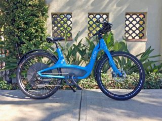

Elby is a special creature, an electric bicycle designed from the ground up to be approachable, comfortable and responsive. Seriously, the drive system on this city/cruiser is also used on e-mountain bikes! It packs a lot of power and zip along with some cool power regeneration features and is near silent. The drive systems are all produced by BionX, a fixture in the industry and partner to other premium manufacturers like Mercedes SMART. The only real complaint I have is that the motor looks large, it’s like a gray pizza stuck in the middle of the rear wheel… but at least the other gray plastic accents on the bike (like the battery box) are matched. This is a nod to Elby and their attention to detail. You can choose from five glossy frame colors including white and silver (for increased night riding visual footprint) and I love that some of the plastic accents and fork are color matched for a cohesive visual appearance. Yeah, aside from the motor, the battery, compact control system and even the wires ae mostly hidden. And while the Elby City only comes in one frame size, it’s designed to be highly adjustable, accommodating riders from 5 foot to 6.5 foot tall. The extra-long 500 mm seat post is thick and sturdy, the stem swivels up and down, even the swept-back “gull wing” handle bar can be swiveled to raise or lower and change reach. I love the ergonomic grips and slightly large but active saddle. Between these touch points and the thicker tires, you end up with a comfortable ride despite there being no suspension hardware. This keeps the bike lighter, cheaper and stiffer. Many wave style deep step-thru frames used for electric bikes have this bendy feeling about them, as you pedal, turn and stop the frame flexes. That is not the case with the Elby thankfully and I’m glad because it honors the motor and premium hydraulic braing systems. This is an awesome ebike, it’s just more expensive than some. And that’s interesting considering the direct to consumer model being tried out. You order online then pay an additional $99 for shipping/assembly and if you’re in a city where Velofix operates, they deliver it to your doorstep and set it up just right… even returning 30 days later for a free tuneup and adjustments.

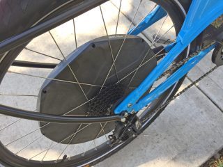

Driving the Elby is one of the most unique and effective hub motor systems I’m aware of. Yes BionX is an advertiser for EBR so you may interpret some of this as bias… but I invited them after having tested a number of systems across a range of electric bikes. This thing is years in the making and only compromises on visuals in my opinion. By designing something extra wide, they were able to achieve higher torque and better heat dissipation. The casing for the D-Series is plastic, keeping it light and durable, and it has an internal torque sensor that works well consistently. It’s one of the quietest high powered motors and I love how they tucked the power cable leading to it on the left side low and out of the way for snags or tips. Notice also that the rear wheel spokes connect to the hub and rim of the wheel, not to the hub motor casing. This provides a more natural ride and a bit of flex… so spokes don’t tend to loosen as much or break. I was told that the max weight for the Elby was 280 lbs by the rep but believe it’s actually 273 based on some literature at their site and some quick math. That’s still above average where many ebikes say 250. This allows for the addition of bags on the rear rack or for larger riders, tall, boxy and overweight. In my opinion, it has the power needed to move larger loads effectively, something people ask me about regularly. You get 500 watts nominal peaking around 1,000 with 50 Newton meters of torque that can be controlled with a throttle… that’s very unique in a world where more electric bikes are using mid-drive systems that require pedaling.

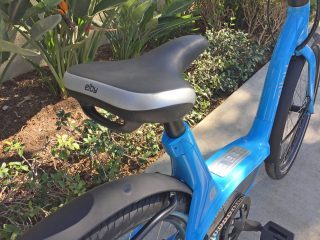

- Comfort touch points like the ergonomic grips and wider (but still active) saddle make the bike ride comfortably even though there are no suspension points, I like the wider tires and might run at a lower PSI to improve comfort further (I believe the range is 35 to 65 PSI)

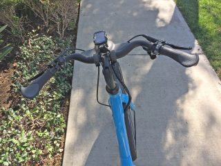

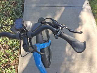

- Beautiful color display that’s easy to remove on a solid adjustable angle mount, it’s cool that they also provide a phone mount adapter and 5 Volt USB port so you can use their app and completely replace the stock display if you want
- The display panel gives you a lot more feedback than basic ones and is intuitive to use (left and right bars change views or enter setup if you hold the left one while on setup, the up and down bars raise or lower assist/regen, there’s an independent light button and power button too… I believe the control ring works even without the display panel if you want (it has two LED light strips that indicate charge level and assist/regen setting

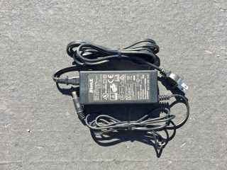

- Super small, lightweight charger would be easy to toss into a backpack or perhaps pannier bags if you get them, it’s one of the most compact I’ve seen from any company but still delivers a whopping 3.45 Amps for fast charging! Most chargers just put out 2 Amps

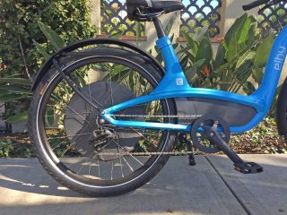

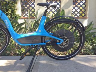

- The power cable for the motor is tucked away nicely, most cables are internally routed but the motor cable is especially important and potentially vulnerable if the bike tips… for the Elby it seemed well protected

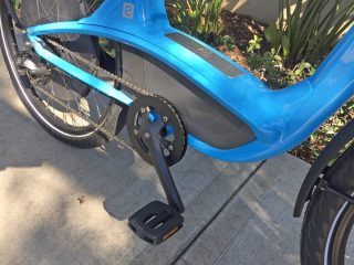

- Given how deep and wide the step-thru portion of this frame is, it’s fairly stiff but there’s still a touch of frame flex, I like the metal accent on the downtube but some other curved parts are plastic and I’m guessing they could get kicked and scratched easier when mounting (so be careful)

- While I love how powerful the BionX D-Series motor is, the casing is large and stands out on most bikes, the rest of the systems are all mostly hidden however
- The seat post is unnecessarily large and I’m told that was due to a previous design goal (to have a pump built in) but the company that makes that accessory went out of business so they were stuck with this really large post, I’d like it if they included a 39.9 mm to 27.2 mm shim so people could use their own seat posts with suspension perhaps
- If you back the bike up with the kickstand down, the left crank arm will collide because it’s mounted near the center of the bike, this also limits ground maintenance like chain lubing if you want to pedal backward
