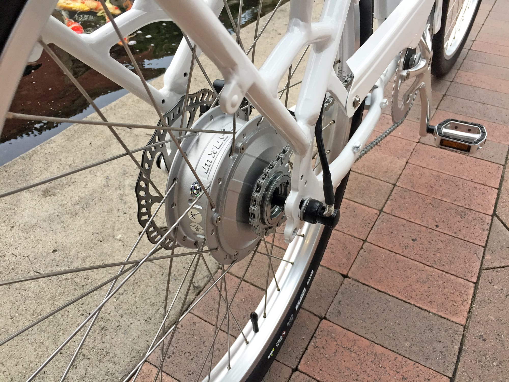

Driving this bike is a planetary geared hub motor rated at 500 watt nominal and 1,280 watt peak. They didn’t provide a Newton meter torque rating, but I’m guessing it would be in the 50 to 60 Nm range because it feels VERY powerful. The Model S and C are both speed pedelecs, meaning that they can be pedaled up to ~28 mph with motor support. You can definitely lower that top speed by entering into the settings menu of the display (discussed later on), and the throttle will only ever support up to 20 mph for legal reasons. Being geared, the motor is compact and lightweight, but it does produce more zipping noises under full operation. I reached ~25 mph when testing on a limited stretch of road at a mall in Southern California called Fashion Island. This is one of the pop-up locations that the company has been using to conduct demos and sell their product in person. For most of the rest of us, you can order online… and that comes with a bit of added cost. The flat-rate shipping for the USA is $225, but Electric Bike Company also sells to Canada and will work with international companies. This is where the shipping price can really start to rise. The good news is, I am told that the bikes come fully assembled and nearly ready to ride (I’m guessing that there is some handlebar adjustment to be done). And that is another important point to cover. The extra-long handlebars provide an upright body position and dampen road vibration, but they also stick out quite a bit. This could make navigating between cars or through doorways a bit tricky. I have definitely scraped walls and door frames with ebikes similar to this one when walking bikes out of shops to do test rides. Sorry! Just keep this in mind and be careful.

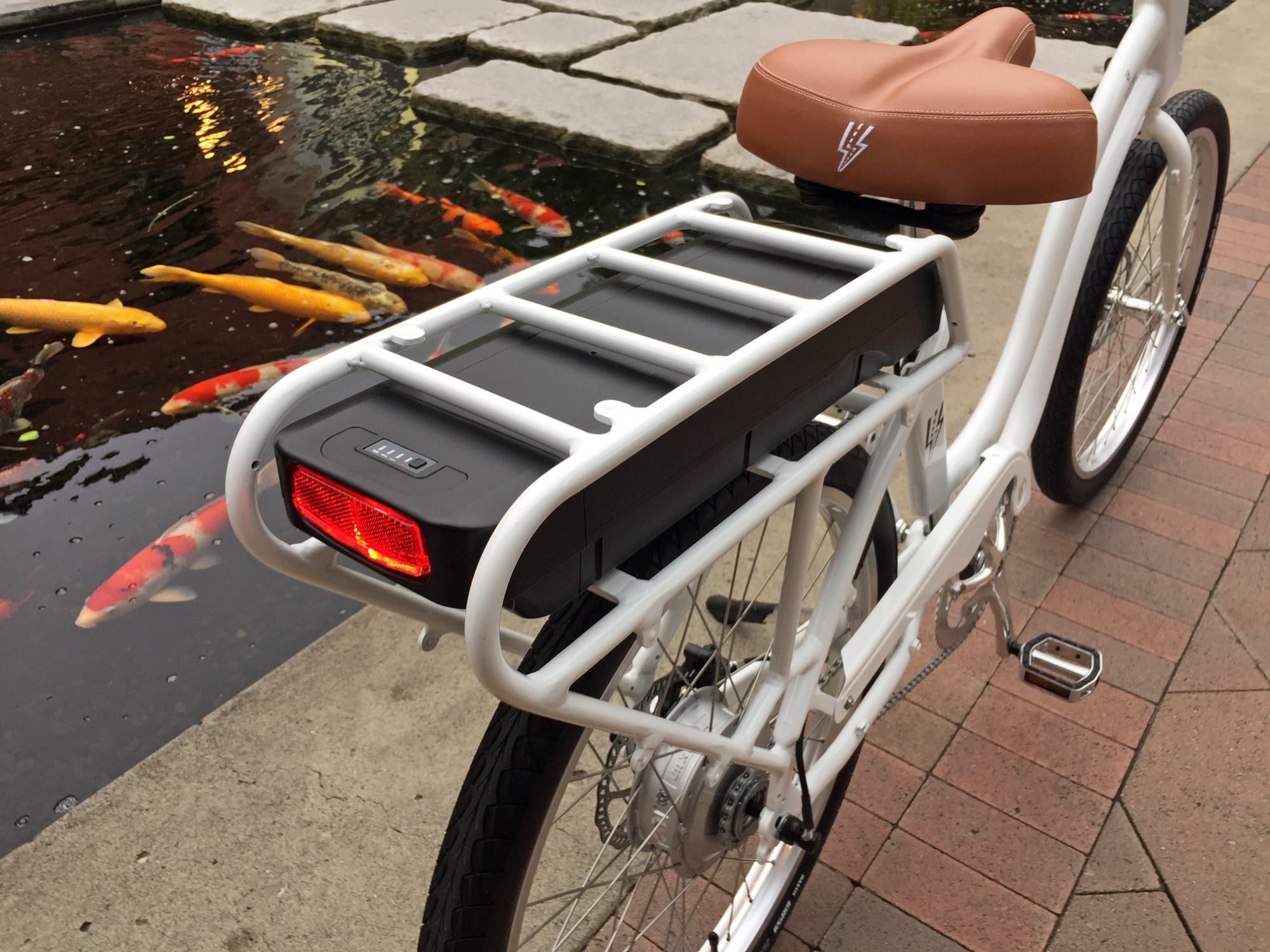

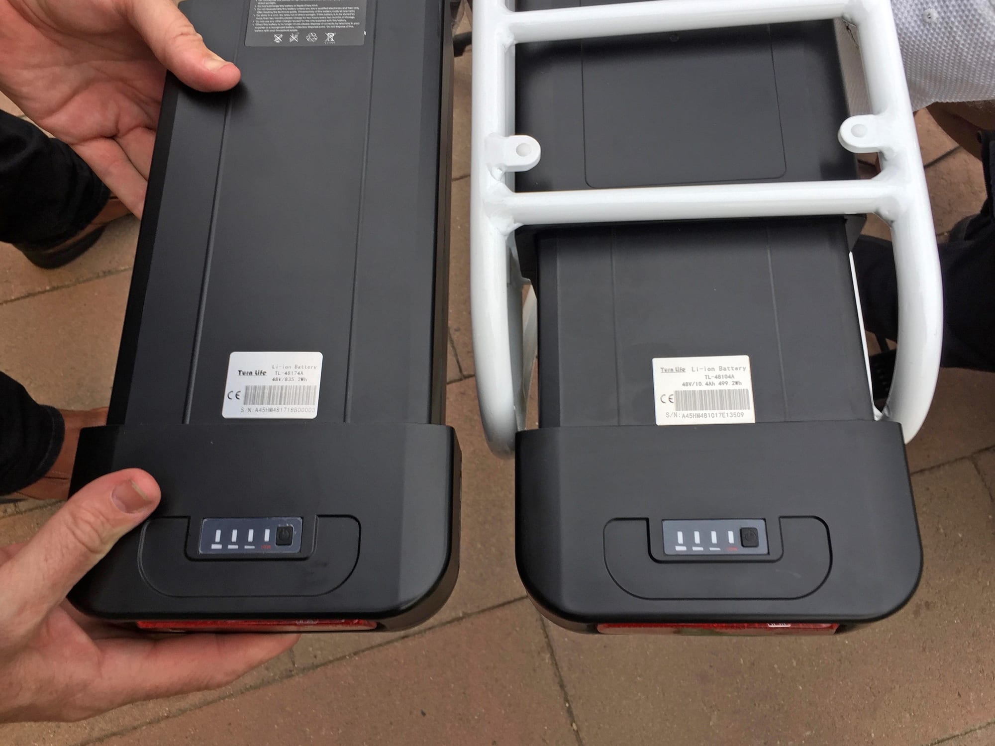

Powering these cruisers, their integrated LED lights, the backlit display panel, and an integrated USB port (below the display) is a 48 volt rack-mount battery. This pack comes in two sizes, and is actually rated higher than what EBC advertises… They call it 48 volts, but the display indicates nearly 52 volts. You can get a 10 amp hour or 16.8 amp hour configuration to increase your range, and both fit into the same rack space. I’m guessing that they also both weigh about the same because the number of cells remains similar but the energy density of the higher capacity pack is just increased through more expensive cells which offer the latest technology. Speaking of tech… batteries are one area where the Electric Bike Company has really positioned itself as a leader. Apparently they have a tight partnership with a manufacturer which custom builds each battery to have individually fused cells along with two temperature sensors. I asked Sean about this, and he explained that they wanted to make the best battery on the market so that it could hold up to extreme environments… like what they might face in parts of South Africa. That makes sense! My own experience and learning has revealed that batteries last the longest and perform the best in cool, dry environments. You want to avoid extreme cold or heat, and keep the pack charged above 20% whenever possible because the Lithium-ion chemistry is most stable there. To make charging as reliable and easy as possible, the battery mounting dock in the rack has an integrated fan and retractable cord (like you might see on a vacuum cleaner). Whenever you stop for lunch or visit a friend’s house, just pull the cord and plug-in for a quick top-off. Yes, this does add some complexity and weight to the bike. But, it saves you the hassle of forgetting the charger at home. For those who cannot park near charging outlets or simply prefer to store the pack in a more stable environment (since the bike might not easily carry up stairs), they do offer a $99 portable fast charger that puts out more than twice the energy for even faster fills. The only real downside to all of this, is that the battery position is high and towards the back of the bike vs. low and center for optimal handling and stability. With such a rear-heavy design, these bikes do suffer from a bit of frame flex. I did not experience speed wobble, the larger tires felt comfortable and stable, even when riding with no hands. In order to have the batteries all be interchangeable and allow for the deep step-thru design of the Model S, the rear rack battery was chosen.

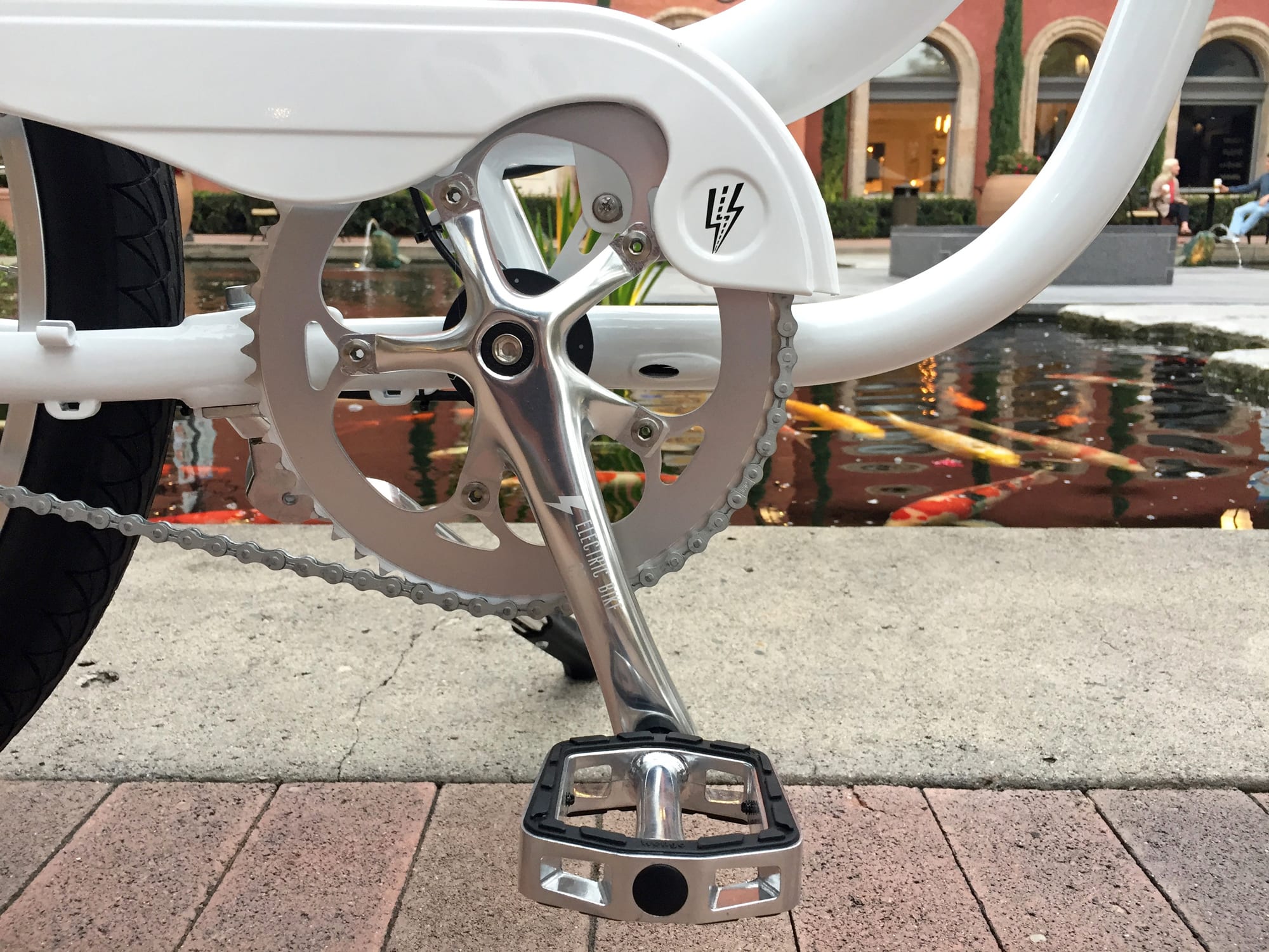

- I love attention to detail and aesthetic upgrades (silver stem, handlebar, cranks, chainring, pedals, kickstand, seat post (and optional suspension seat post), locking grips and matching saddle, paint-matched chain cover and optional fenders)

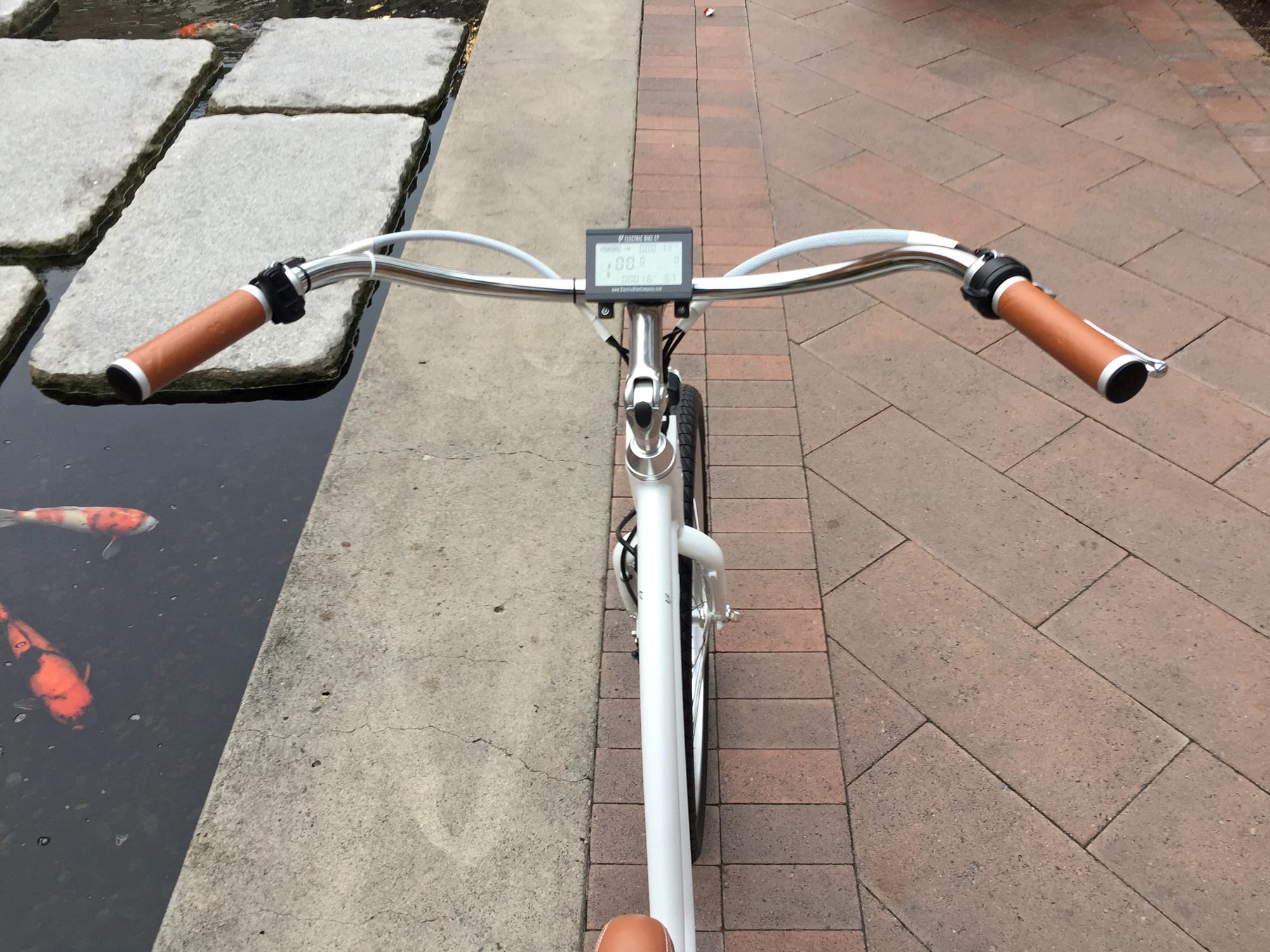

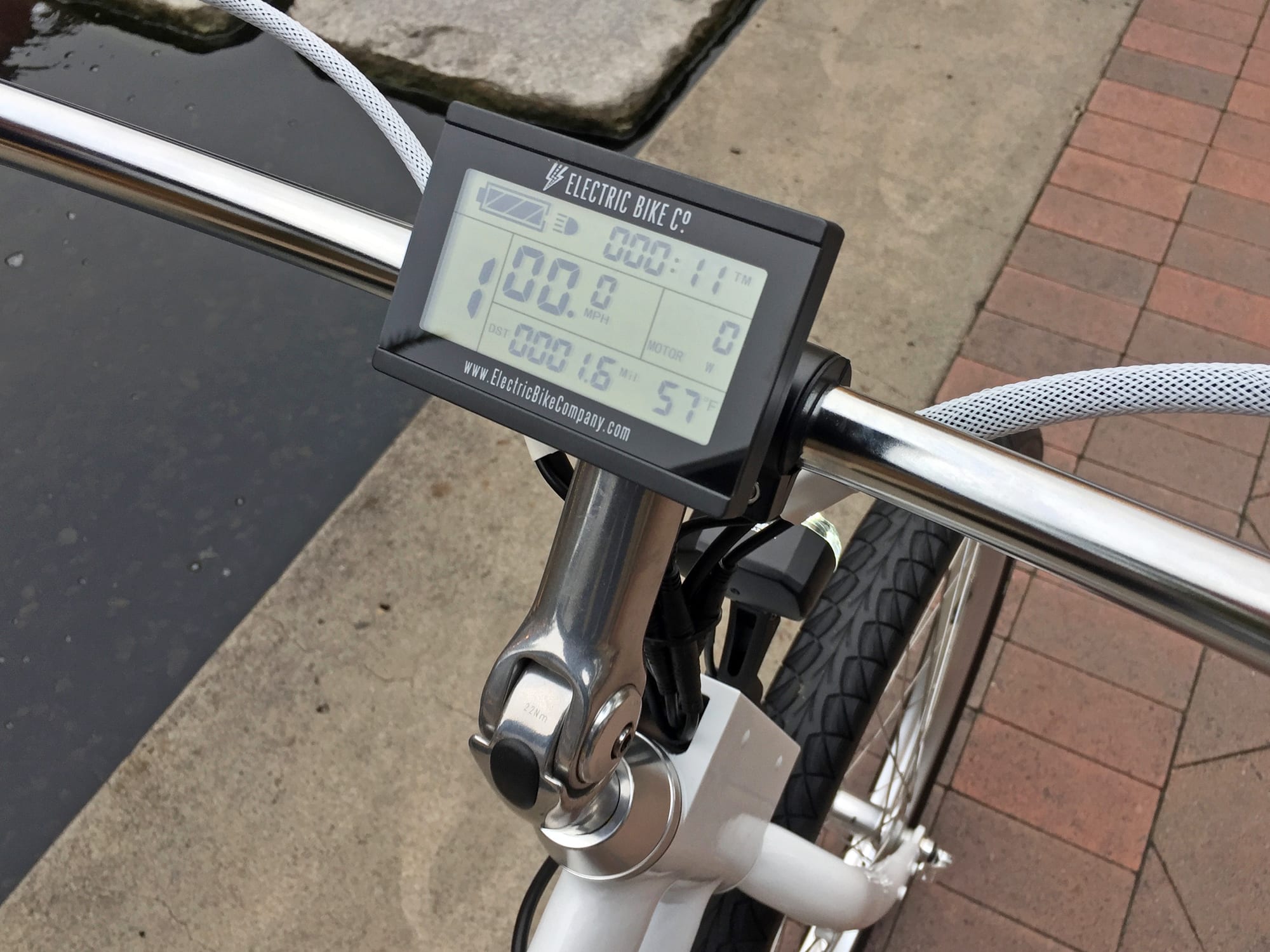

- The display panel is large, easy to see, easy to navigate (thanks to the remote button pad), and has an integrated USB port for charging your phone, the optional Bluetooth speaker, or another portable electronic device

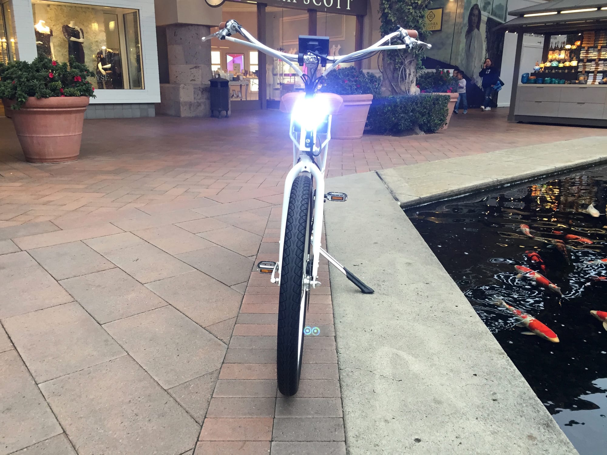

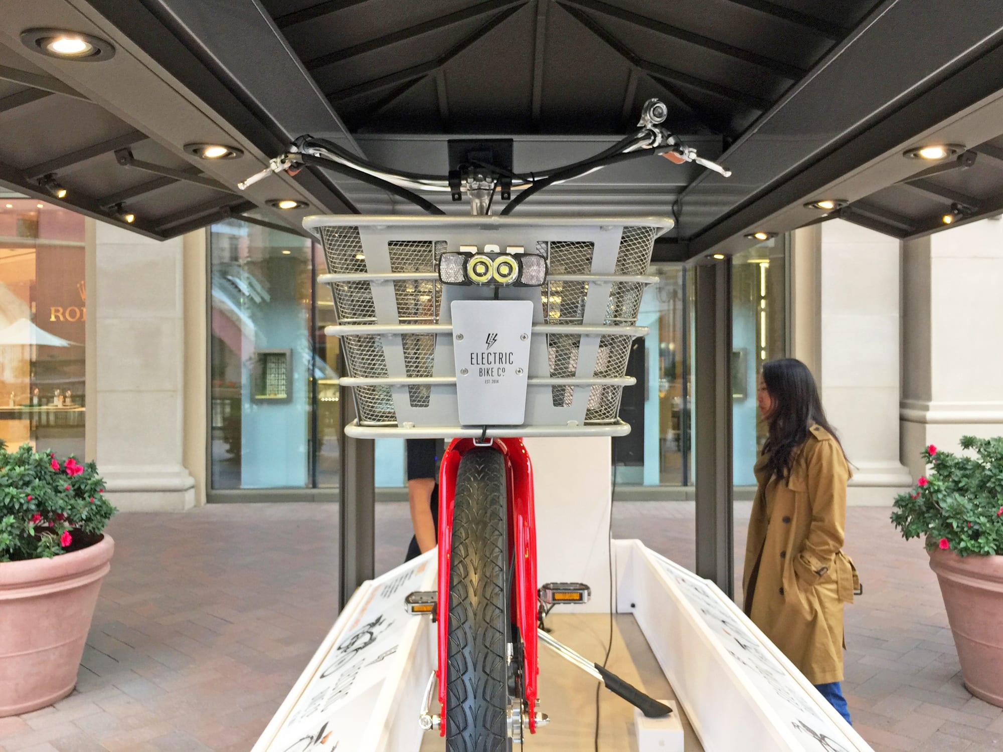

- The integrated lights work pretty well and run off of the main battery pack, so you don’t have to fiddle around with extra buttons or disposable batteries, I love that the Electric Bike Company sells an upgraded high-capacity battery for people who want to go further or use the lights at all times

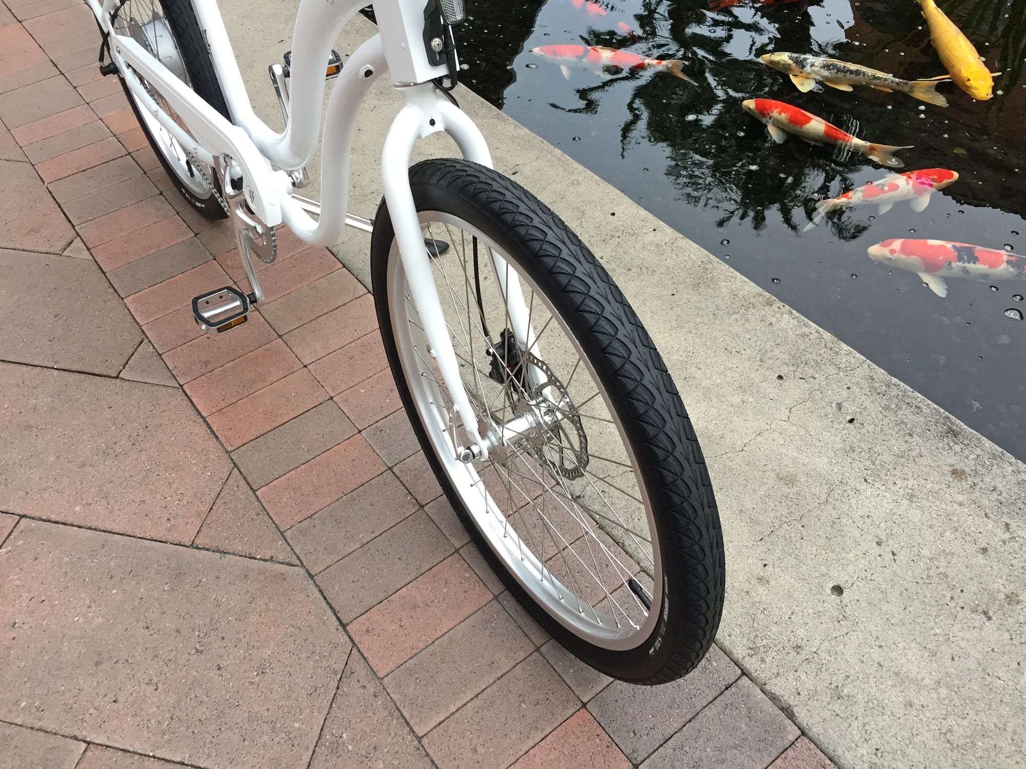

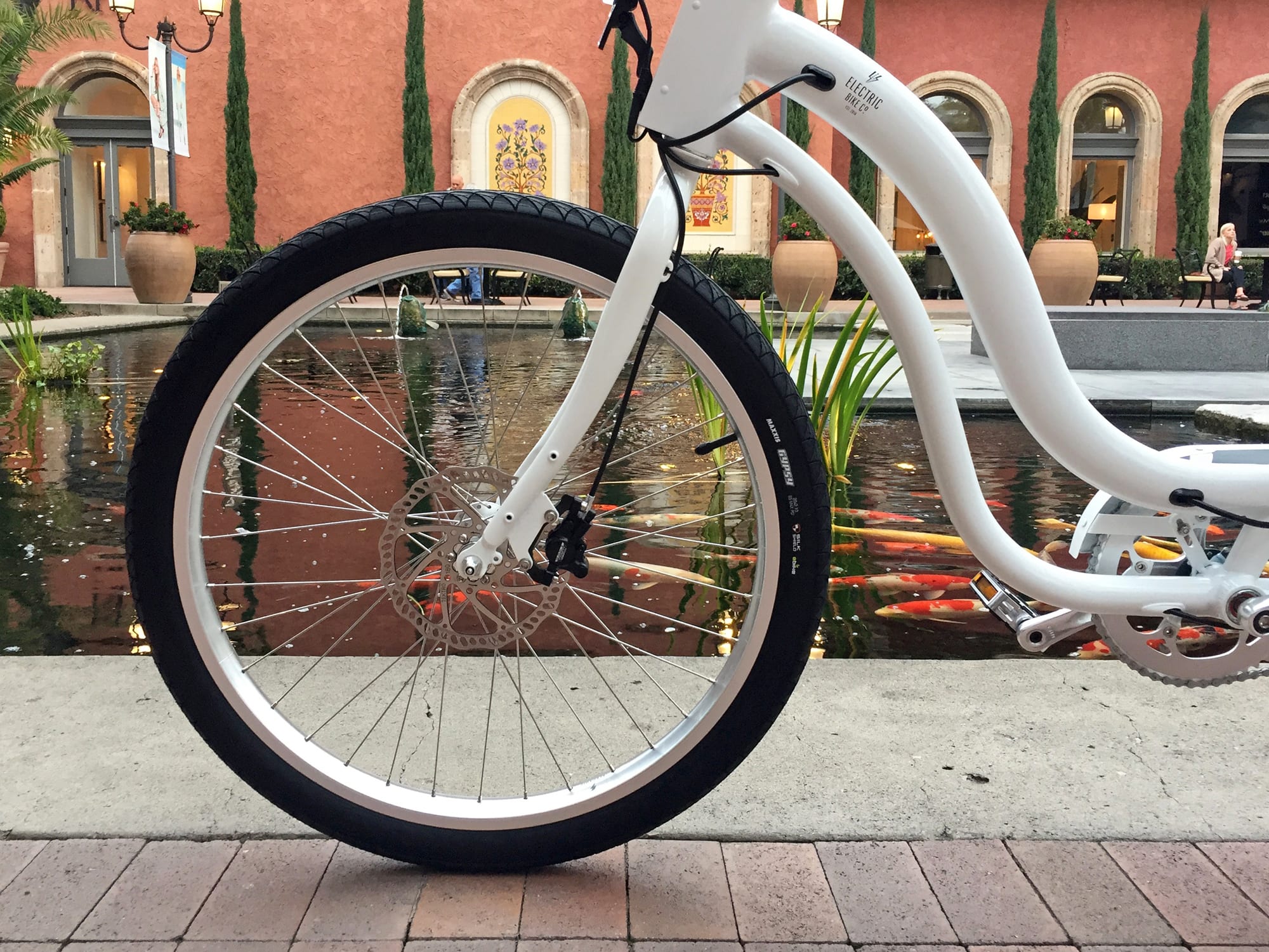

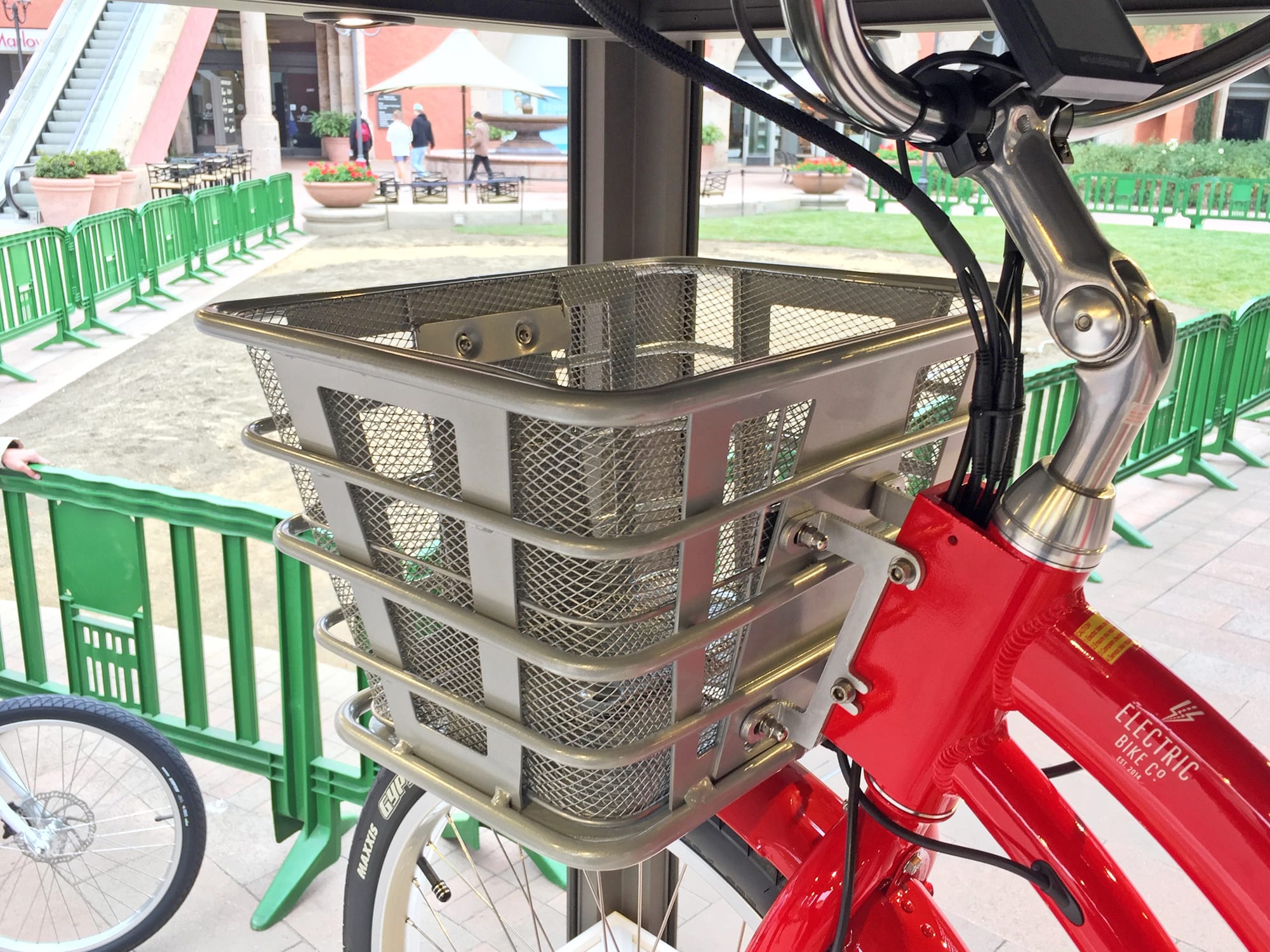

- For as powerful and heavy as this e-bike is, especially with the optional battery upgrade, fenders, and basket, it’s really nice that they opted for 180 mm hydraulic disc brakes to improve stopping power and reduce hand fatigue, the levers are adjustable for people with different sized hands or those wearing gloves

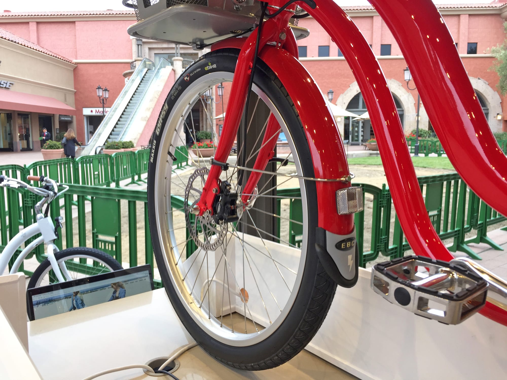

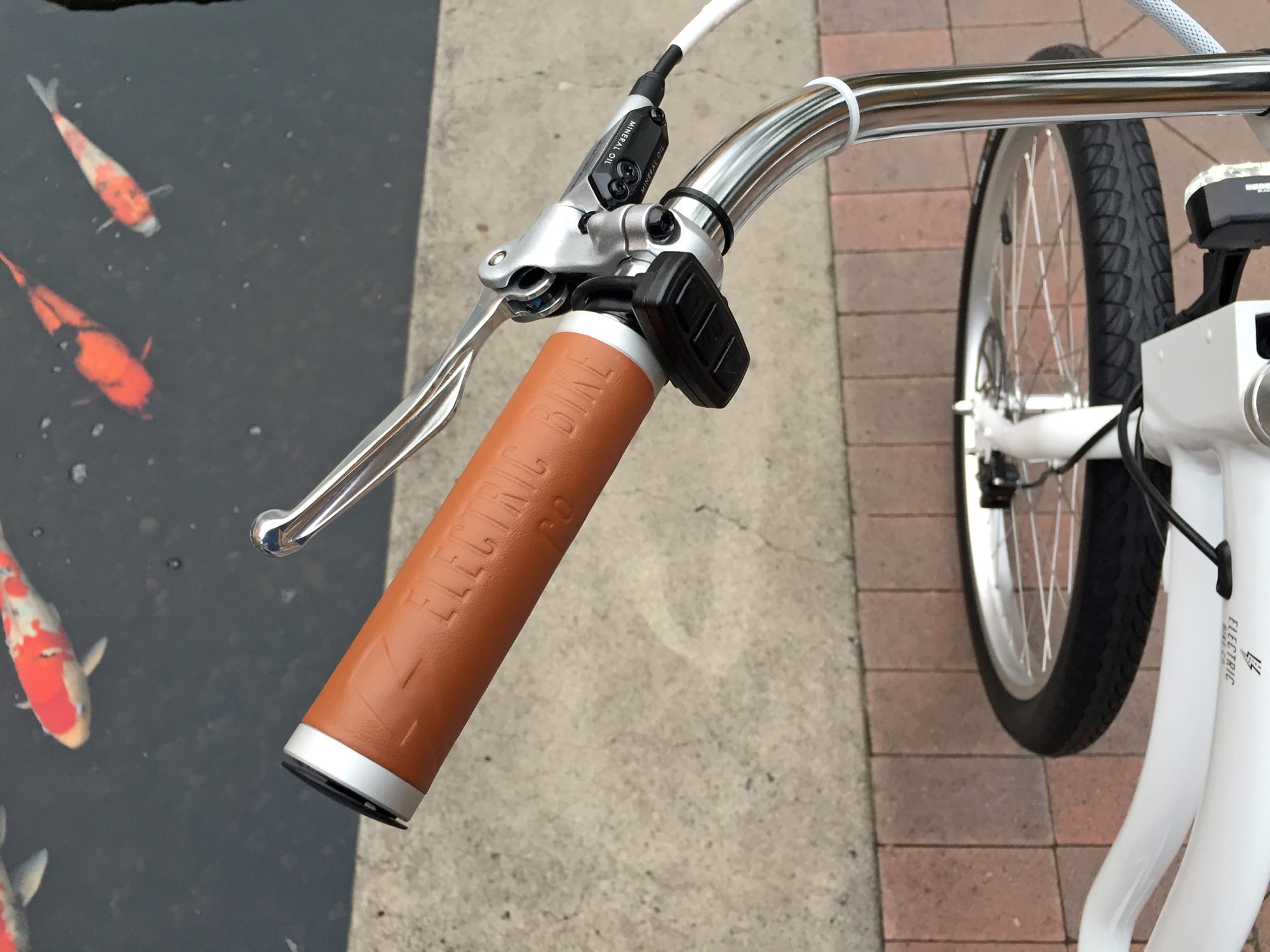

- The brake levers both have motor inhibitors built-in, so the motor will stop immediately whenever you need to stop or even start applying the brakes, that’s an important safety feature considering the 8-magnet cadence sensor and trigger-throttle
- The stock tires are fatter than average (which offers stability and comfort), they offer SilkWorm puncture protection, and the inner tubes have puncture sealant installed so you won’t get flats as easily or have to wrangle with the bike to change the inner tubes as often… just keep them inflated between the recommended PSI to avoid pinch flats

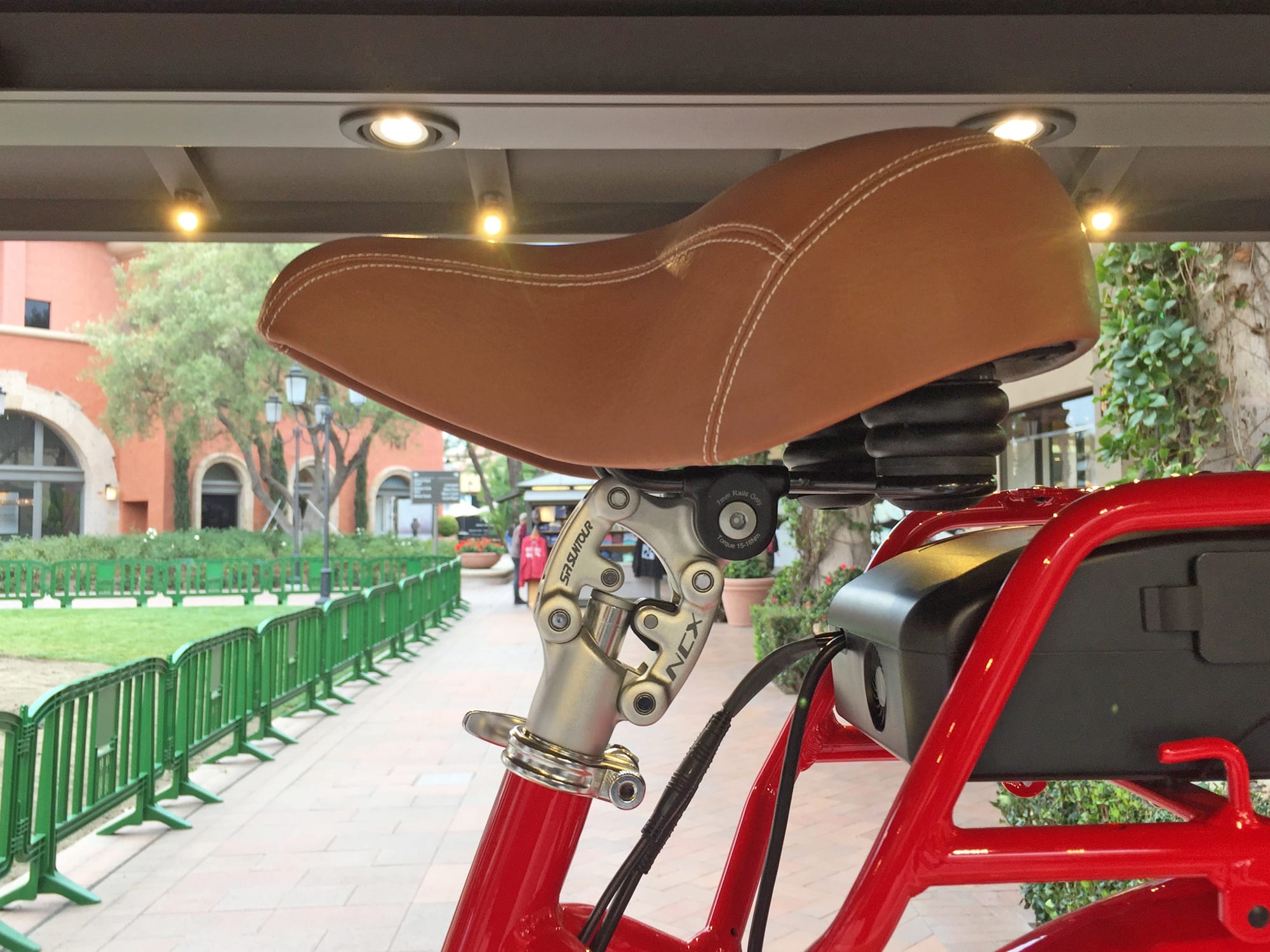

- The saddle can go very low on this bike, making it easier to approach and stabilize for many riders, because the rear rack is pushed out a bit and doesn’t block it

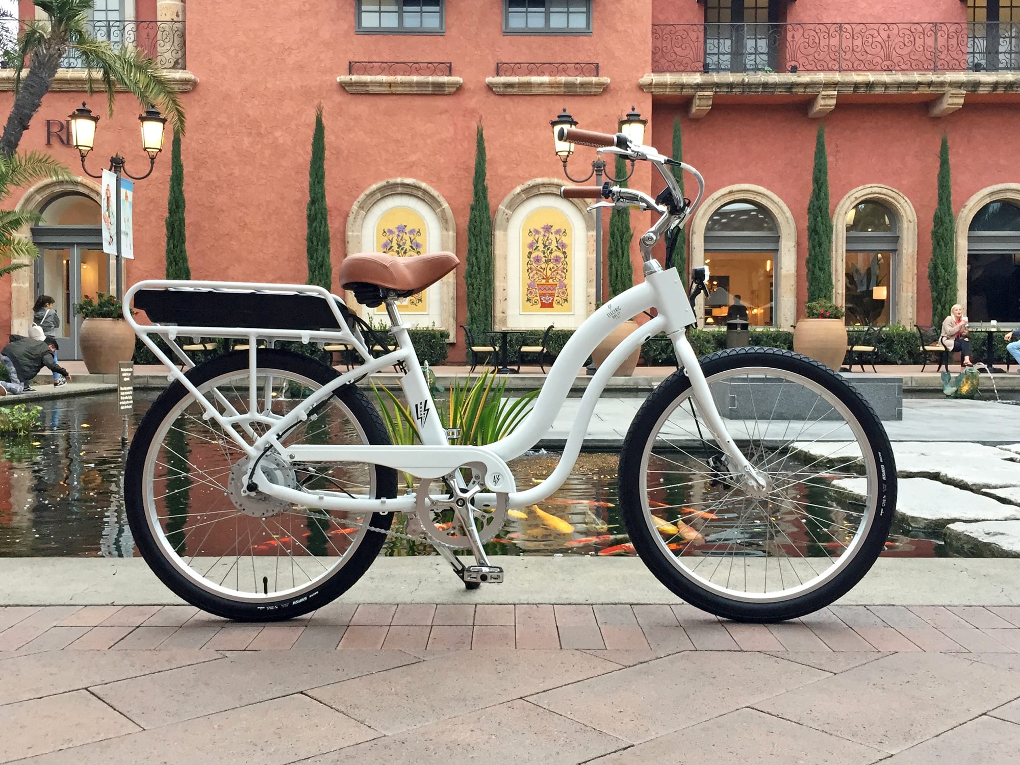

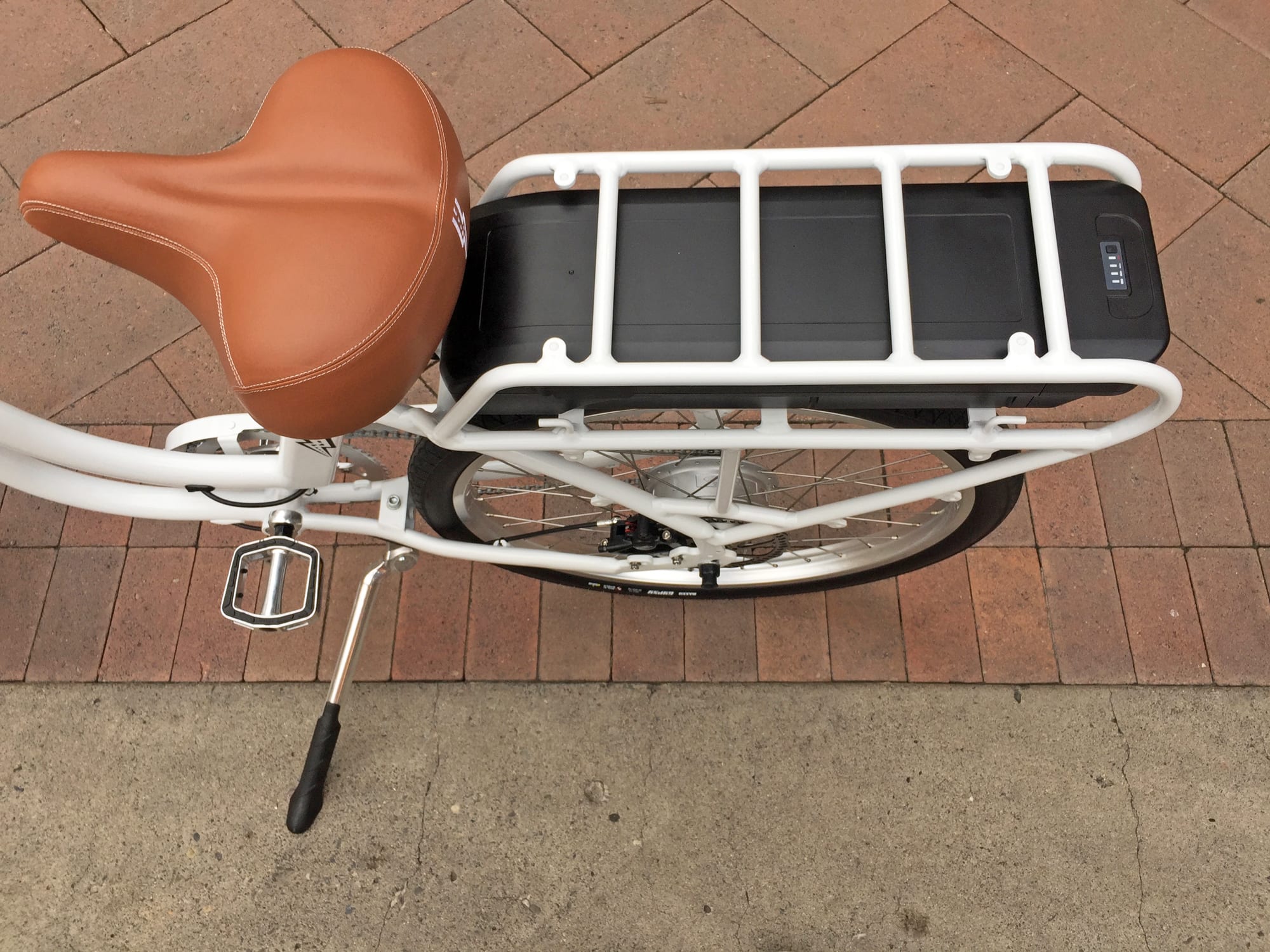

- These bikes are a bit heavier at ~60.5 lbs (without the fenders and baskets) because they come with a sturdy welded-on rear rack, integrated battery charger, longer handlebars, fatter tires, and bigger comfort-oriented saddle and grips
- You’ll probably rely on the throttle and electric assist more heavily with the Model S or C because they only come with one gear, that keeps the bike simple but makes it difficult to start from standstill without a bit of help… and could be a real bummer if you drain the battery all the way down to zero

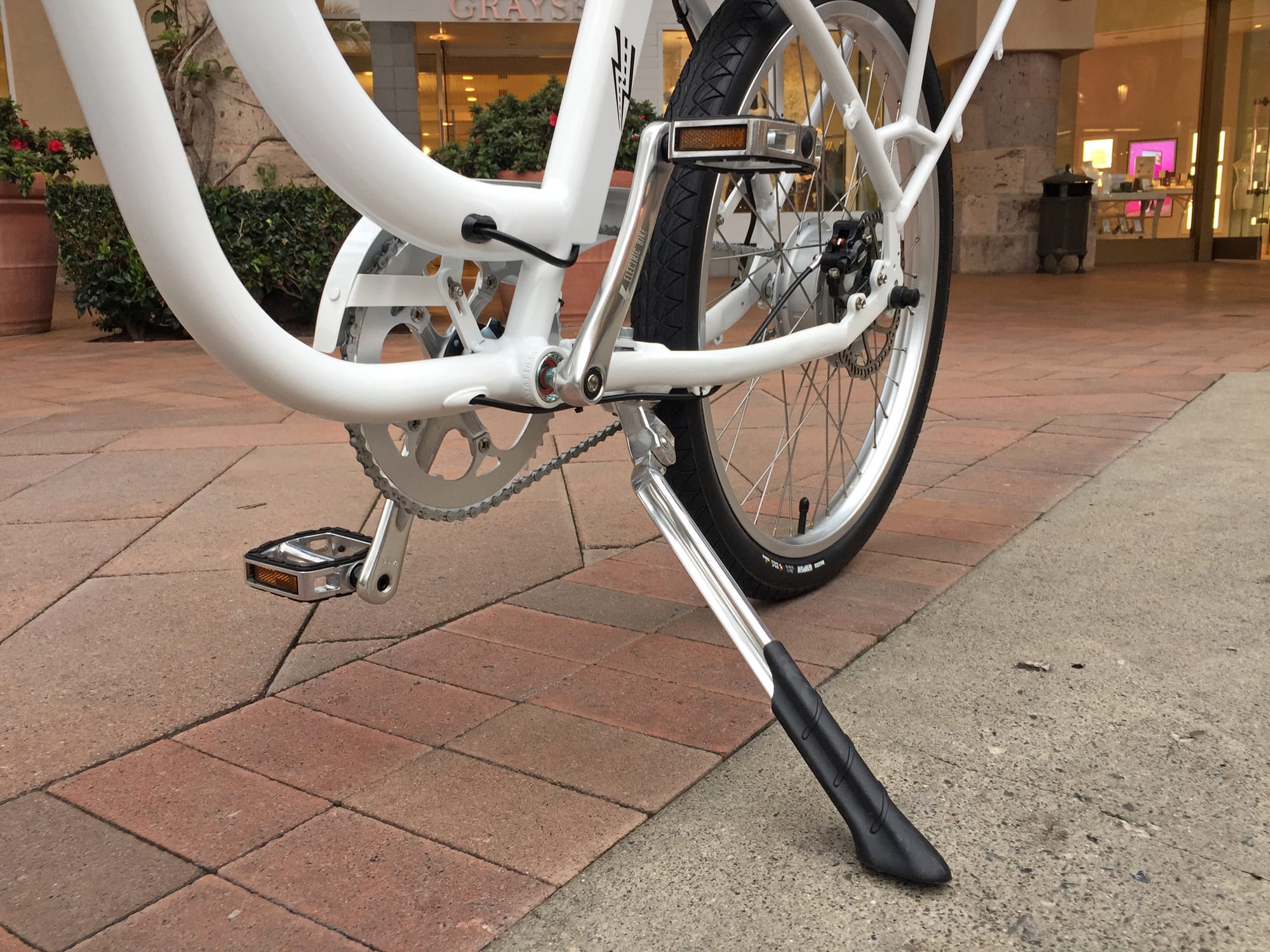

- I like how the kickstand looks, appreciate the adjustable length, and feel that it supports the bike well, but it is positioned in the center of the frame and can block the left pedal if you don’t stow it (especially when backing the bike out of a garage)

- Minor consideration, the headlight does not point where you steer because it’s mounted to the head tube or front basket by default, this can be a little disorienting when making sharp turns in the dark
- The frame only comes in one size, but at least there’s a step-thru and high-step option, as well as an adjustable-angle stem to dial in fit

- You can angle the display to reduce glare but it isn’t removable, this means that it could get scratched at the rack or take more weather wear when parking outside
- I think the integrated battery charger is neat, but it only offers a standard 2 amp flow and might take a bit longer for the big battery option, you need to spend even more money ~$99 to buy a stand-alone charger if you want to charge the battery off-bike but at least it puts out 5-amps which will fill the pack super fast

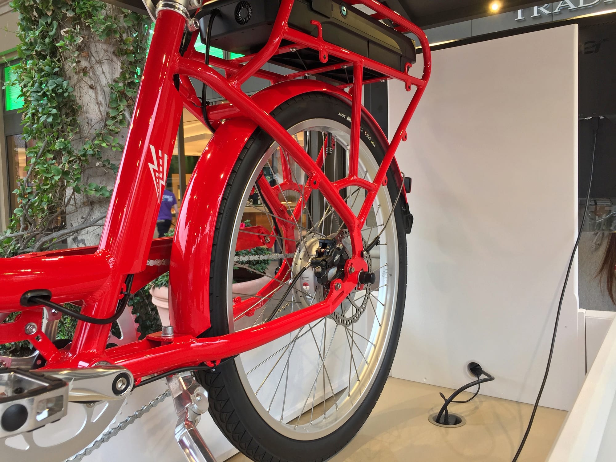

- Be careful with the right side of the rear axle because the motor cable protrudes here and could get snagged or bent if the bike tips over, this is a design vulnerability than many hub motors experience and just something to be considerate of

- We found a little quirk with the display during this review, you cannot get into the settings menu if the backlight is on… so hold the up arrow to turn backlighting off (if it’s on) then hold up and down to get to settings

My wife has had her EBC cruiser for over 6 months now and just can’t get comfortable with the swept back handlebars. She prefers the straight handlebar on my RadRover but she’s just 5’2″ and it’s just too big for her. Is the solution to just change the handlebar? Would you have a recommendation?
Court says
Hi Chris! Yeah, there are lots of different handlebars that can be purchased online or from ships… I think you’ll want to seek out a 25.4mm bore vs. 31.8mm, but as long as you get the right fit, it should work with this stem! Also, you could replace the stem entirely for something taller, shorter, longer, whatever you want. Please double check your handlebar thickness where the stem clamps onto the bar to make sure it’s actually 25.4mm, that’s just the measurement I got (you could also confirm with Electric Bike Company). Here are some bar choices for you ;)
