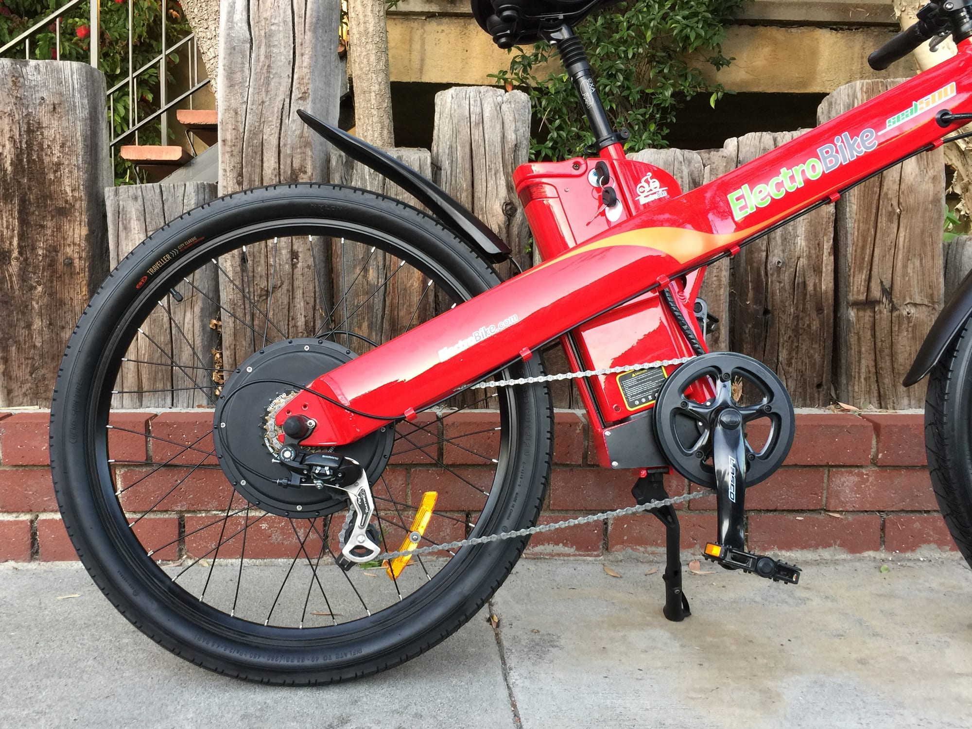

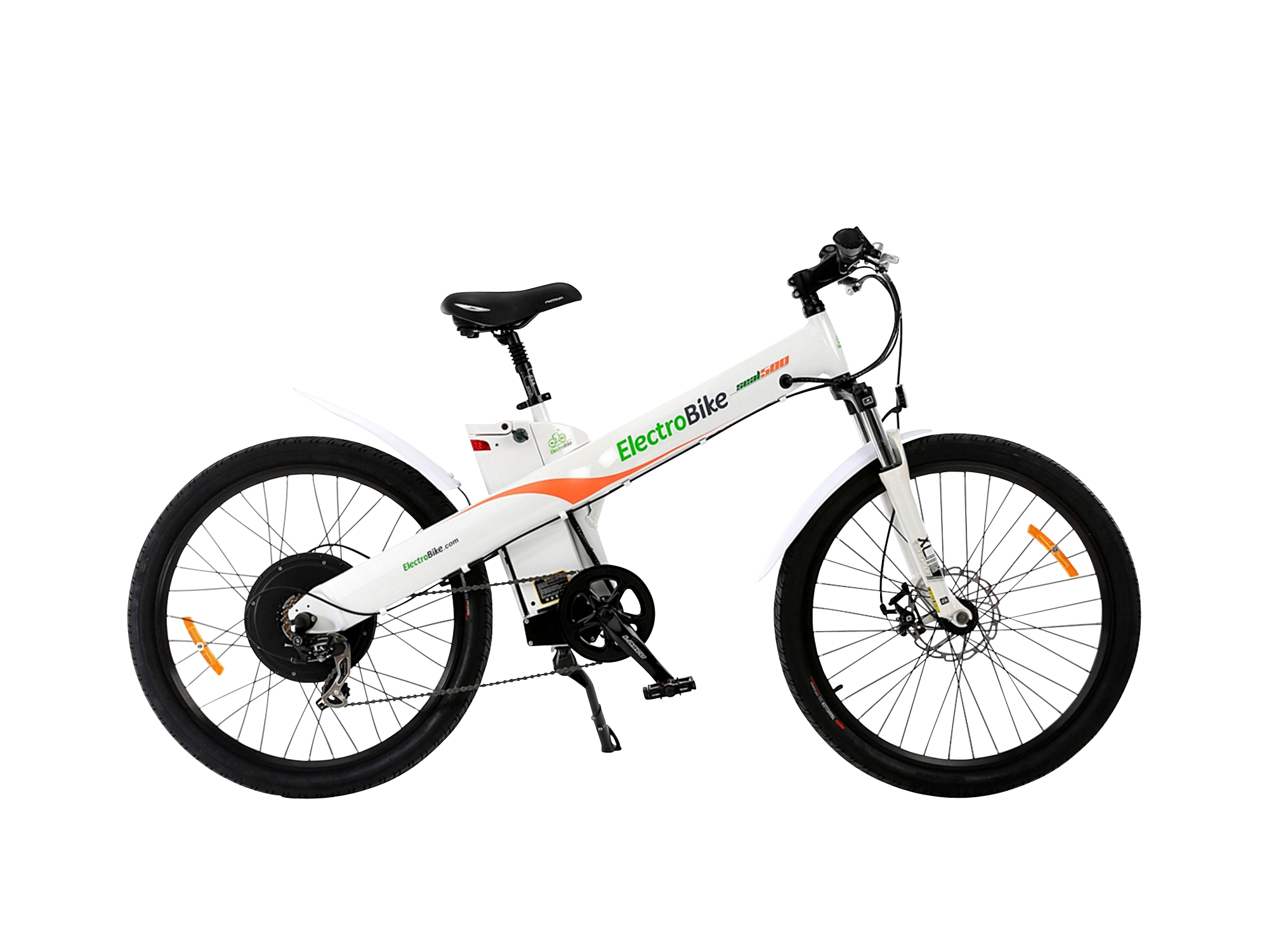

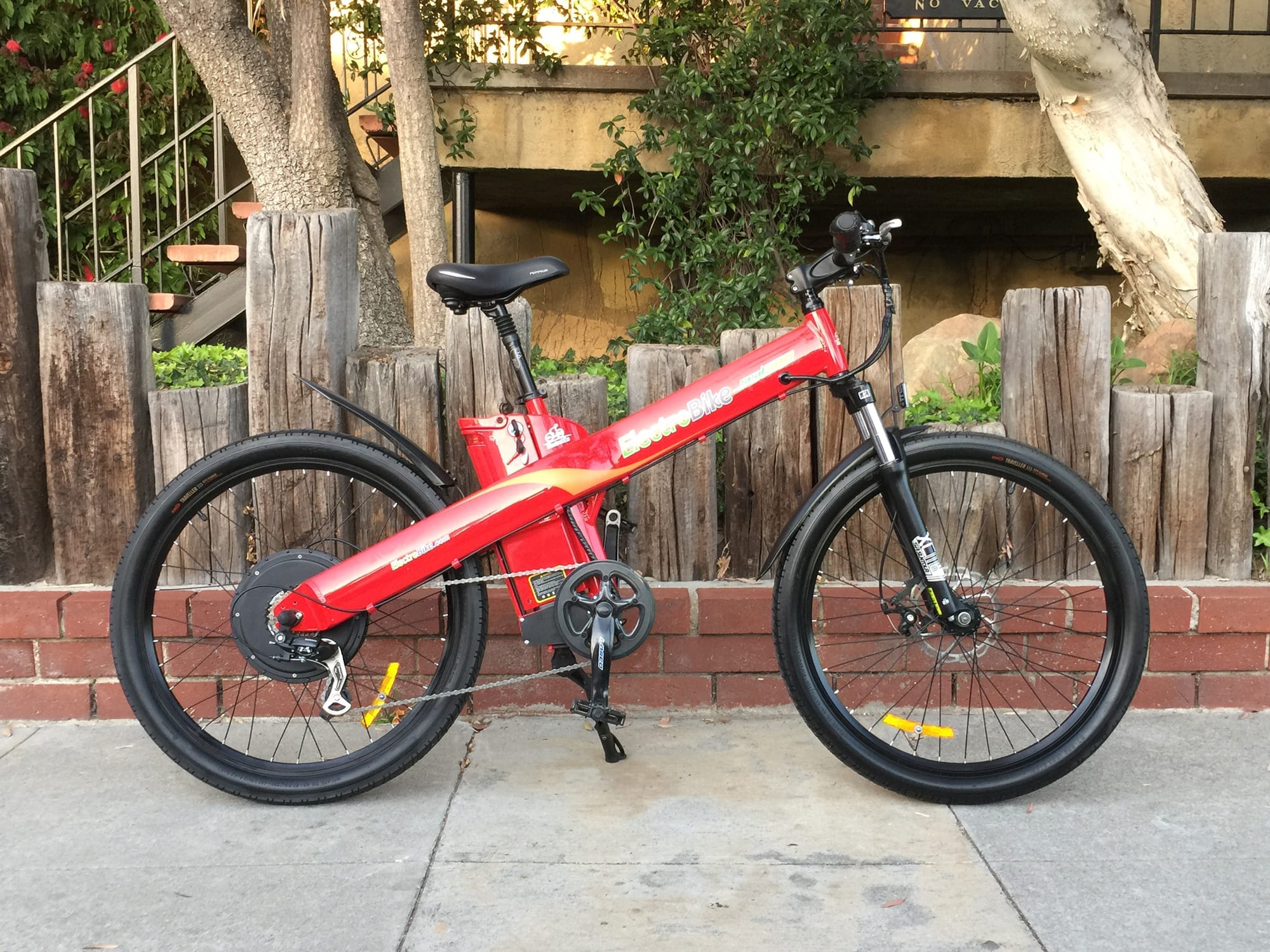

The ElectroBike Seal is my least favorite model in the Electro Bike family because it’s the most expensive but doesn’t deliver the performance it could. It offers a gearless direct drive motor that’s louder than I expected (given that there are no moving parts inside) and the battery powering it is average in terms of both power and size so you’re missing out on the potential and really just adding weight (gearless motors are larger and heavier than gearless). The frame is eye catching but not my favorite because the single-tube design sacrifices in the way of stiffness and again adds weight because it’s reinforced, not having supporting tubes.
This isn’t a bad electric bike, I just feel it’s overpriced and have many gripes about things like having to leave the key in the battery while riding, being fitted with basic more slippery pedals, short fenders that stick out more (and in fact block the rear light) and not having any rack mounting points or bottle cage bosses. You get pedal assist and throttle mode here but the throttle power output is pegged to the pedal assist levels and there is no throttle-only mode. The cadence sensor that activates the motor only uses five magnets making it slow to respond when you start and stop pedaling and the drivetrain uses a very basic Shimano Tourney derailleur. This thing is almost $2k and there are lots of other choices with similar entry-level parts that deliver a better experience.

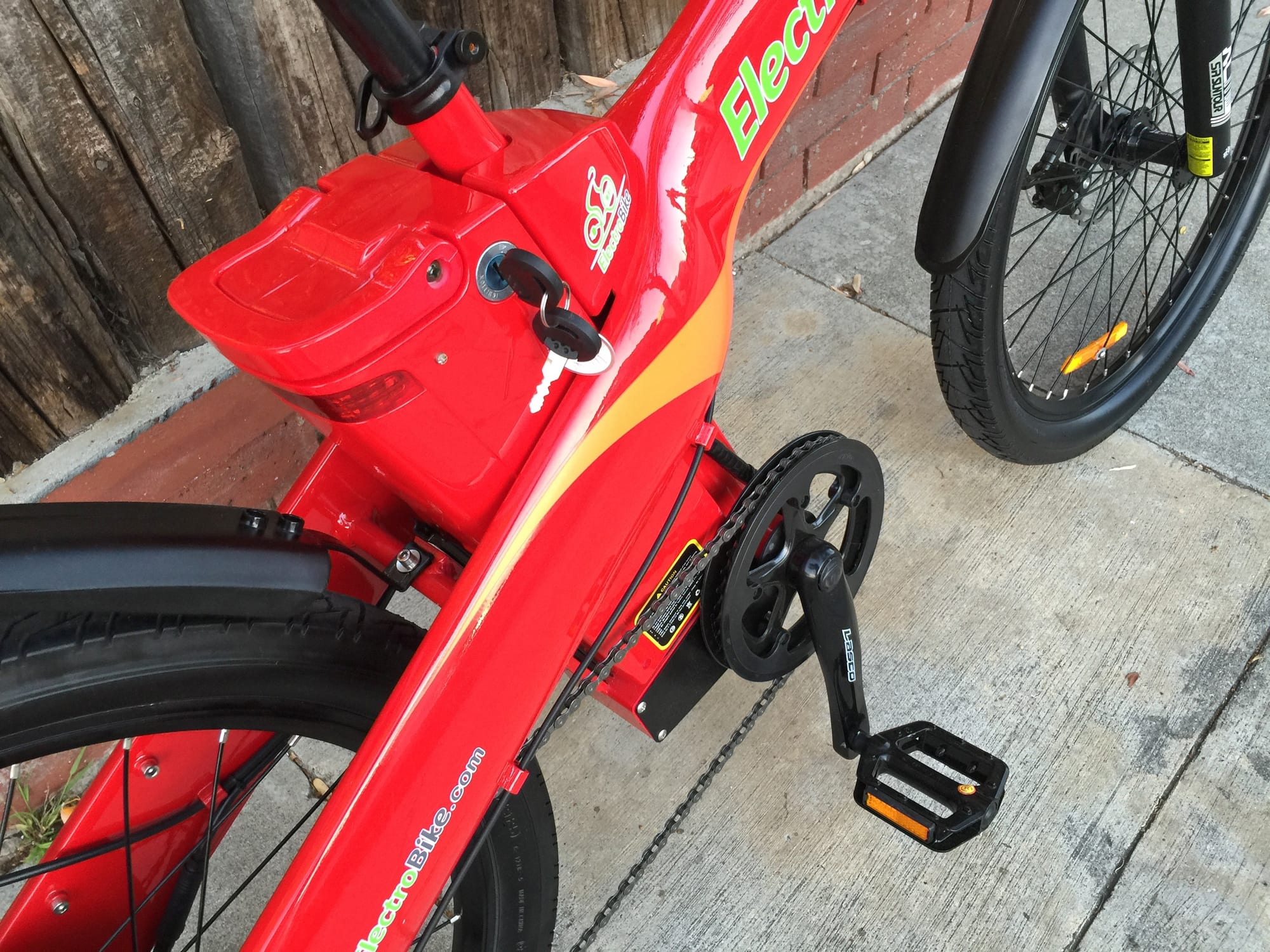

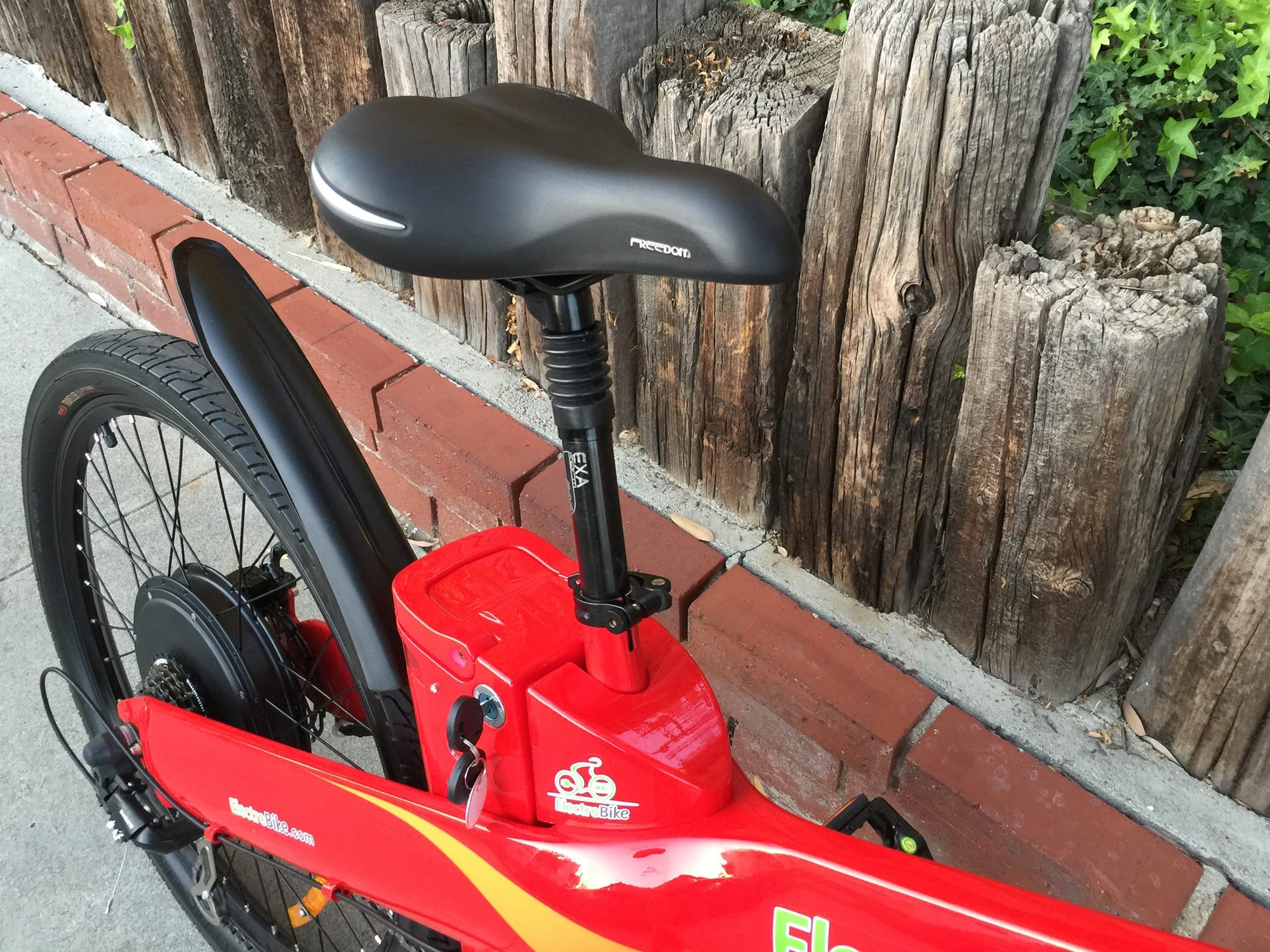

- I like the color matched battery pack, it looks better than a shiny metal pack that I see frequently in similar orientation but might not be as tough since the casing is plastic

- The integrated rear brake light is pretty cool… it activates when you pull either brake lever and runs off the main battery! It even has a light sensor built in so it should come on automatically when it gets dark outside. The downside here is that it’s partially blocked by the rear fender and you don’t get a headlight to go with it, consider something affordable and rechargeable to attach on the handlebar like this

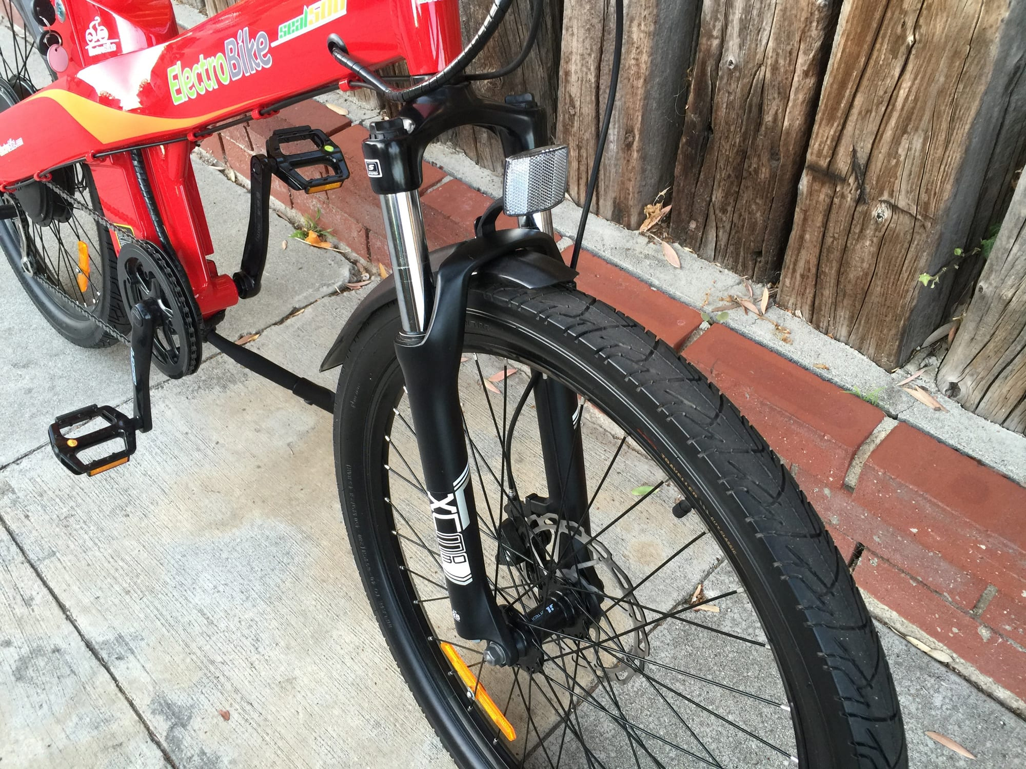

- I love that you get a quality gel saddle, suspension fork and seat post shock plus ergonomic grips because the body position is a bit more forward and that can lead to a stiff neck and back over longer rides, I’m surprised the suspension fork doesn’t have lockout adjust because this is more of an urban style bike

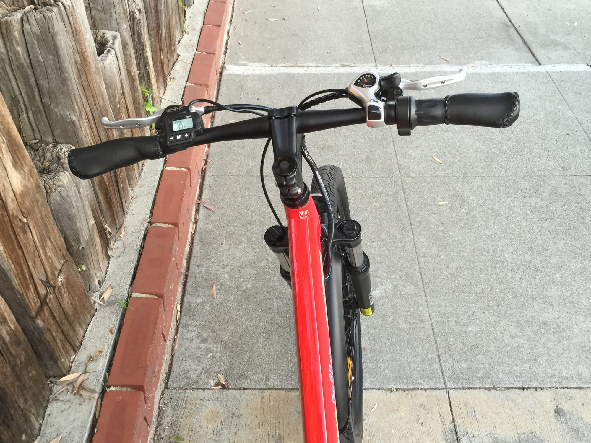

- The Seal features one of my favorite LCD displays from the Electro Bike family of e-bikes because it’s small but easy to read and reach while riding and it’s backlit

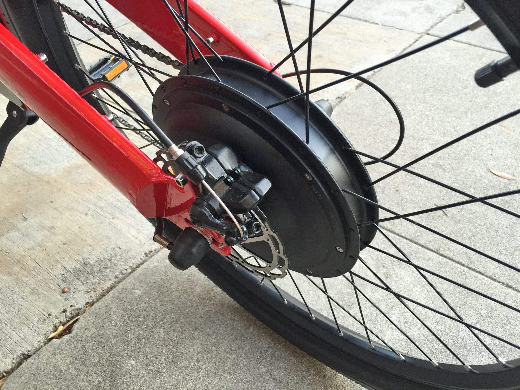

- I love that they chose to use larger 180 mm mechanical disc brakes vs. 160 mm on the Cross model because this is a heavier and slightly more powerful bike

- I’m usually not a huge fan of this frame style because it can flex side to side and tends to be heavier, it looks cool as a single tube but the trade offs aren’t worth it for going on trails or off-road, since the Seal is more of a city ebike it’s less of an issue
- Despite being a gearless, direct drive motor, I noticed zinging (possibly the disc brake) and more whirring while operating the Seal than with other motors like those from Pedego, Stromer or Specialized
- The fenders or “mud flaps” as I’ve heard them called, are more basic and don’t offer the same protection against water that tighter full-length fenders would, the front fender actually sticks out a bit and might be easier to clip with your toe when turning and pedaling simultaneously
- No bottle cage bosses or rack mounts on this ebike… you might be able to use a beam rack on the seat post but keep in mind, this will push the seat up given the integrated suspension element which also takes room and you’ll have to swivel the rack or completely remove the rack whenever you want to take the battery off for charging so a quick release beam rack like this might make the most sense
- The cadence sensor for pedal assist is very basic with only five magnets for the sensor to activate with, this means that you have to pedal more before the motor starts and wait longer for it to stop… thankfully the brake levers appear to have inhibitors to stop the motor more quickly in moments of urgency

- The key has to be inserted into the battery pack in order to operate the electronic systems which means they might jingle or get in the way, at least the key folds in this case and there is only one slot vs. some of the other ElectroBikes which have two locks (added weight and complexity)
