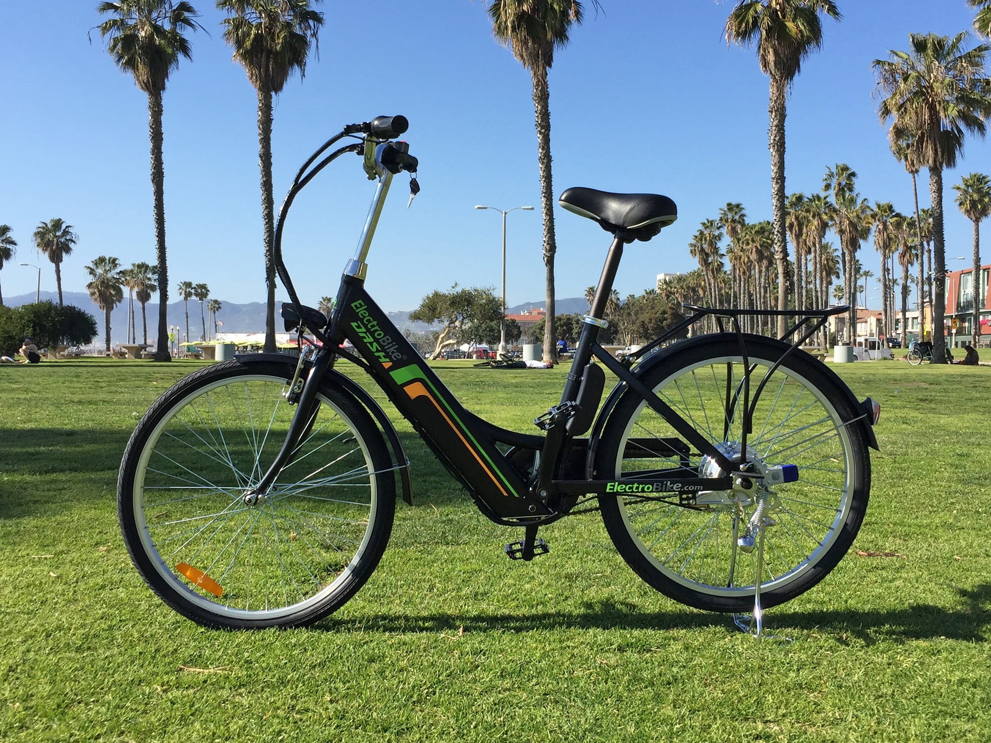

The ElectroBike Dash is one of the most affordable electric bikes I’ve ever seen… Many of the parts are generic and cheap (including the motor, battery cells and cadence sensor) but you get the utility of fenders, a chain guard and a rear rack it it would work well for commuting. There’s only one gear so pedal cadence changes as your speed increases or decreases and sometimes starting on an incline can be difficult but that’s where the throttle really comes in handy.

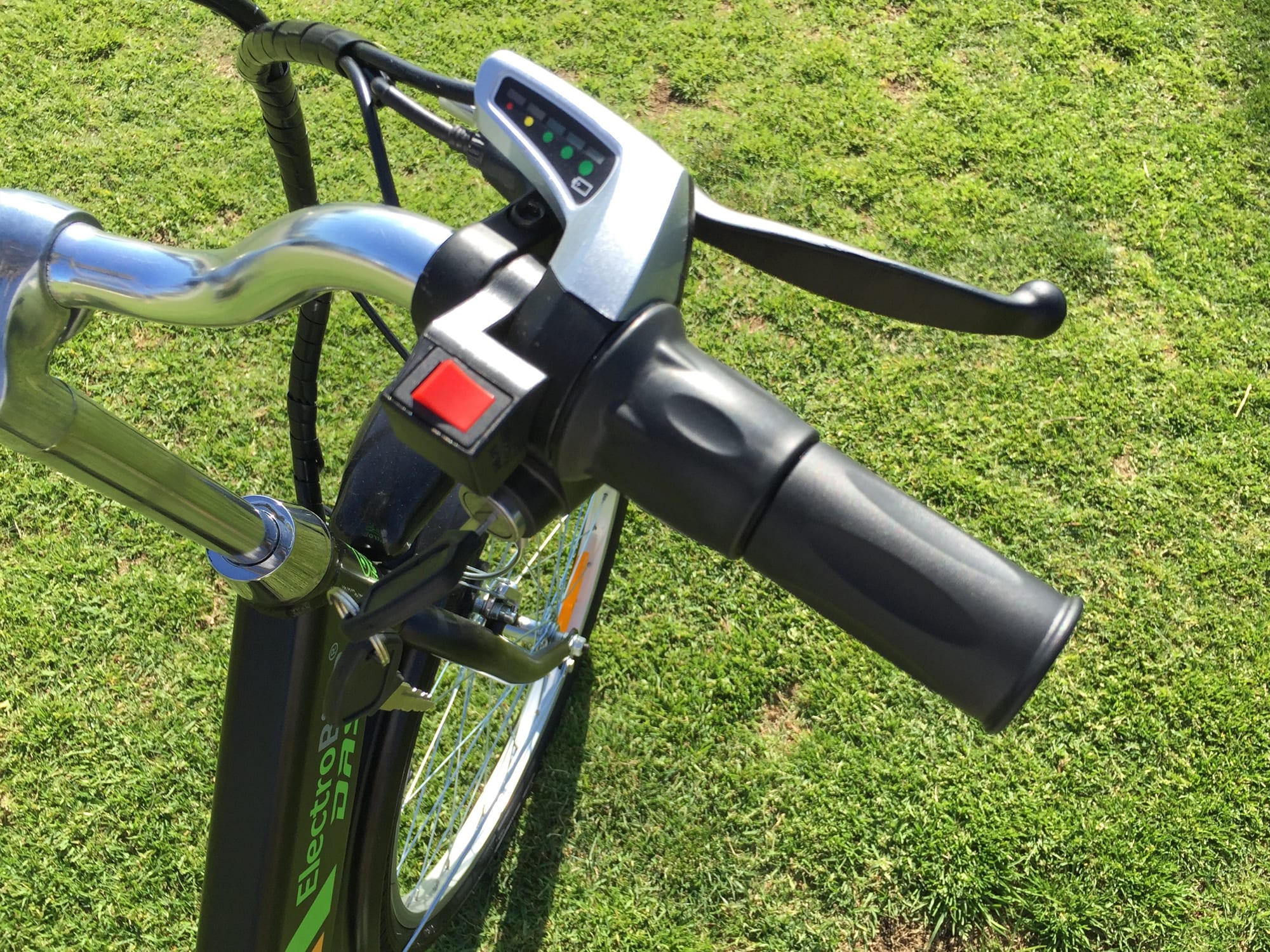

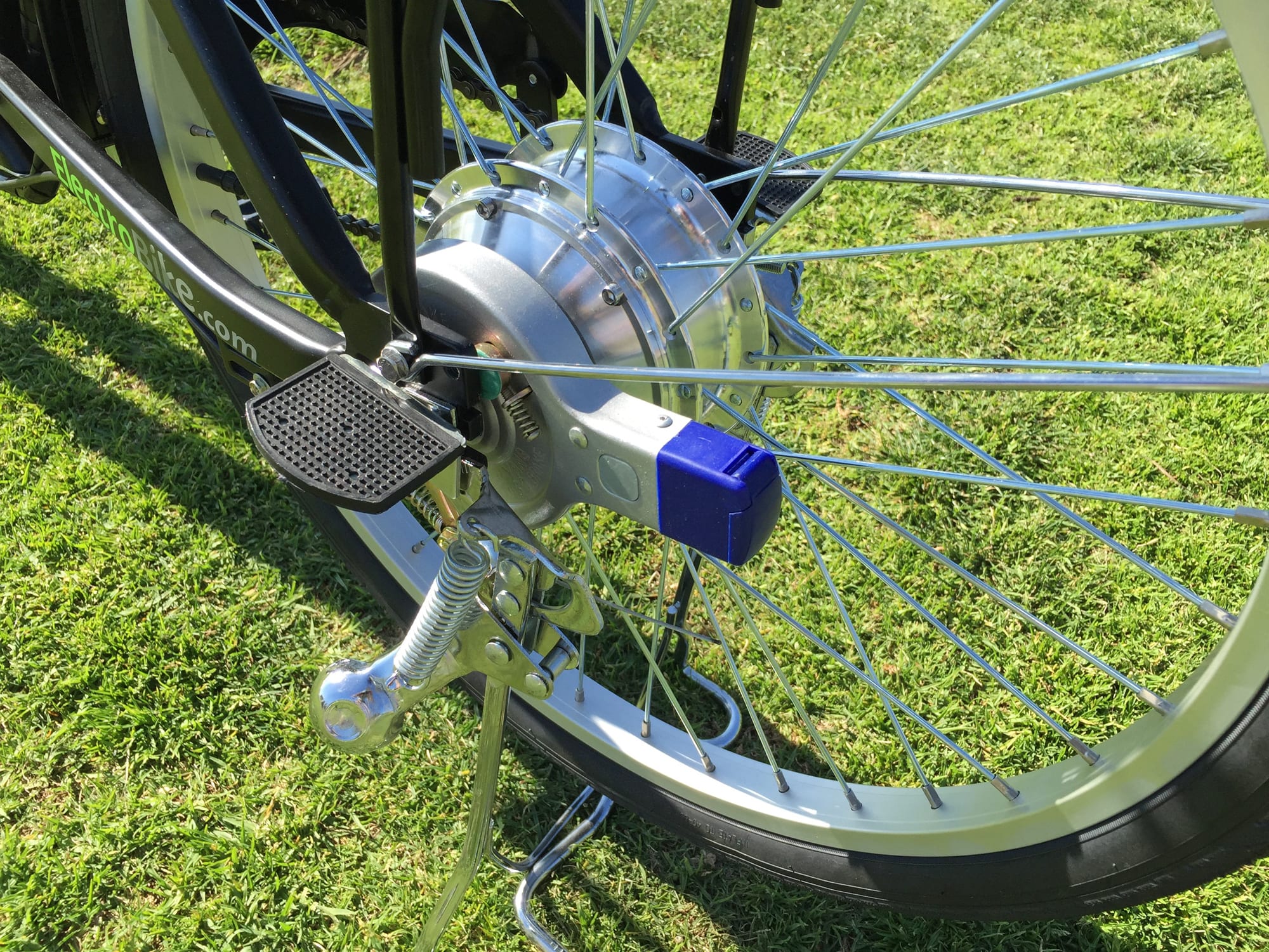

You get three levels of pedal assist which also control throttle power and speed output but you can override assist by twisting the throttle at any time. The motor is a bit noisier since it’s an internally geared design but that keeps it light weight and small. The bits that do add some weight are the steel fork and large locking stand at the rear. I’ve never seen a stand like this before on electric bicycles and it takes some practice to fold down and then unlock but it definitely keeps the bike stable. One thing that I regularly comment on with ebikes but noticed for most of the ElectoBike line is that you have to leave the key in while riding and that it kind of gets in the way or could jingle around if you’ve got a keychain connected.
The Dash isn’t especially heavy at ~48 lbs but that’s partially because the frame and wheels are small. An average sized bicycle wheel is ~26″ and these are 24″ so they keep the frame lower to the ground and this compliments the shorter step-thru frame. Given the price and this smaller size factor I think the Electro Bike Dash would be a great choice for young people including children, just be sure this is legal where you live or use only on private property. This is a Class 2 electric bike with a top speed of ~20 miles per hour (~32 kilometers per hour).

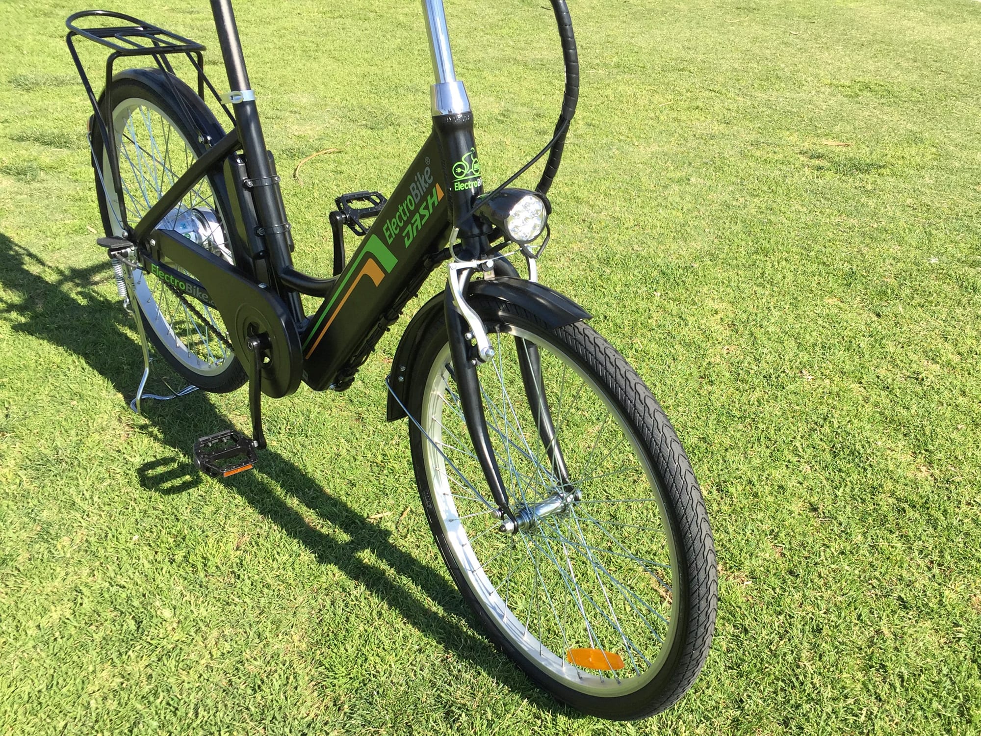

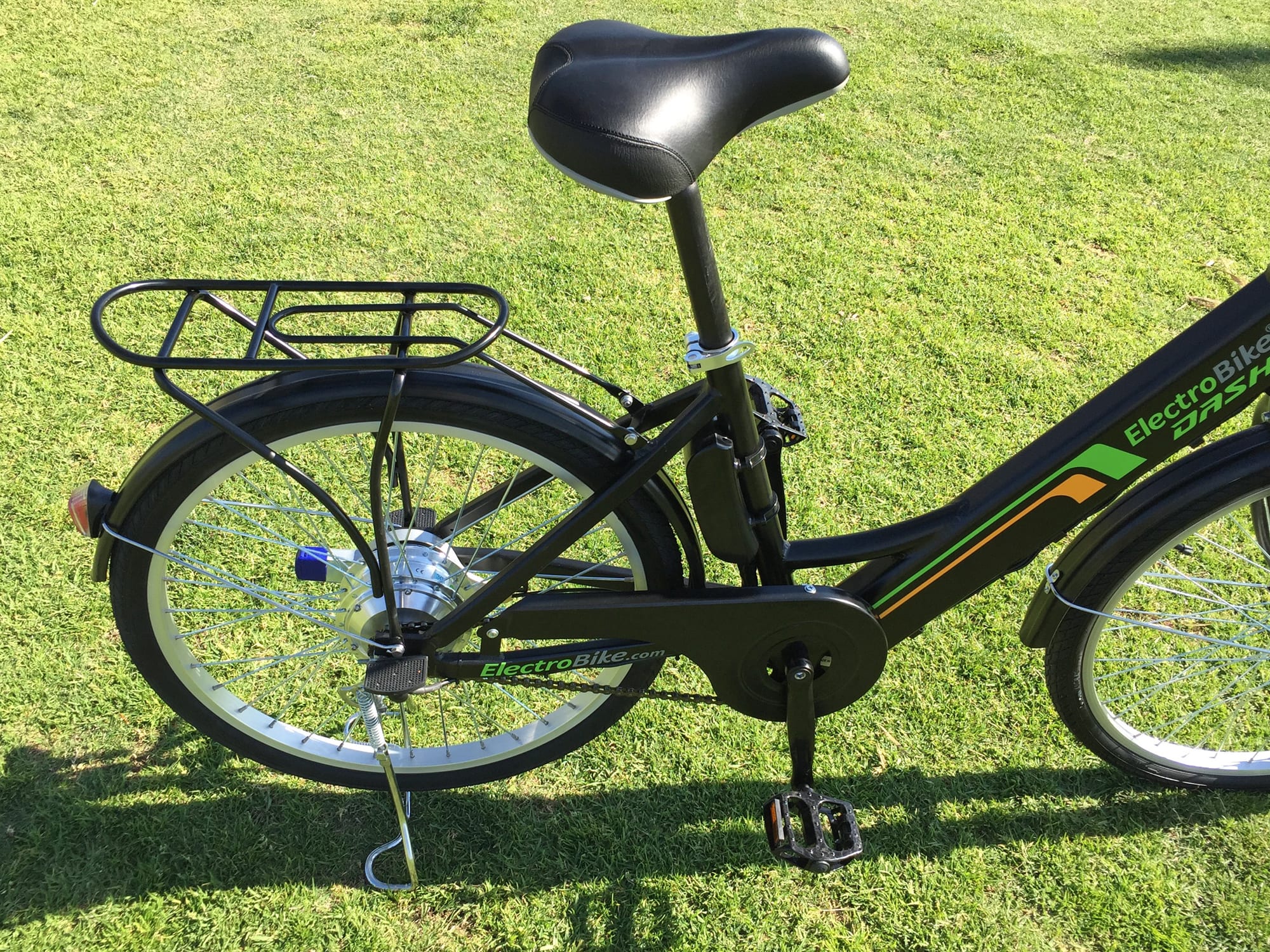

  • Great accessories including full length fenders and a chain guard to keep your pants and cargo clean as well as a cargo rack for carrying gear or panniers
  • The smaller 24″ wheels keep the frame lower to the ground improving balance and making it easier to mount and stand over, they also improve the leverage of the hub motor making it a slightly better climber than an ebike with 26″ or 28″ wheels

  • You get a large, very stable, kickstand with the Dash and it’s the only Electro Bike in the line with this feature, great for doing maintenance or just storing on less stable terrain but it does add some weight and the lock can take a bit of practice to figure out, you have to push in on the circle lever before the stand will go up, if you prefer a more traditional kickstand there is a mounting point just behind the bottom bracket for something like this
  • I’m not sure how much of a “pro” this is but the bike has funky little pegs near the rear dropouts that likely help to protect the motor cable but may also serve as a transport platform for a second rider to stand on, the second rider would have to be light weight and this may not be recommended by the company but is used regularly in China and other locales (I used to ride on pegs as a kid myself)

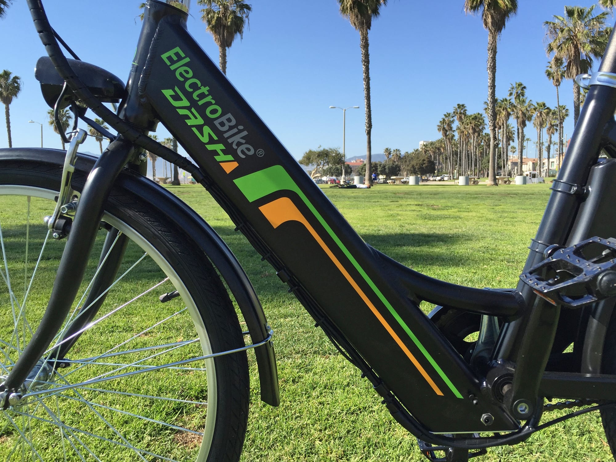

  • The battery pack is built into the frame and not easily removable… but it does look good and keeps weight low and centered across the bike vs. up high on the rack, it would be nice to have the controller box hidden as well but it’s mostly kept out of the way on this bike, plan on bringing the bike inside to charge or using an extension cord and know that it’s going to be heavier to lift with the battery always in

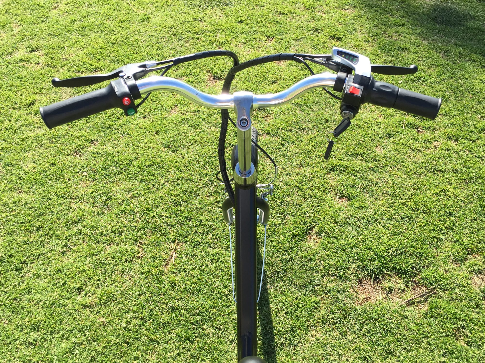

  • Very basic and limited display systems (no speed or range readouts, just LED lights approximating voltage), you also have to leave the key inserted while riding and the slot is near your right grip so a keychain would definitely get in the way… consider a small carabiner and key ring setup like this
  • I like that you get three levels of pedal assist for slower riding and to use less power but I wish the throttle could reach maximum power regardless of assist setting because it’s a twist throttle with its own variable speed output

  • The brake levers on this and other ElectroBikes for 2016 seem reversed based on what I’m used to, the right lever activates the front brake vs. the rear… maybe this is more common in Europe or Mexico but it threw me off at first
