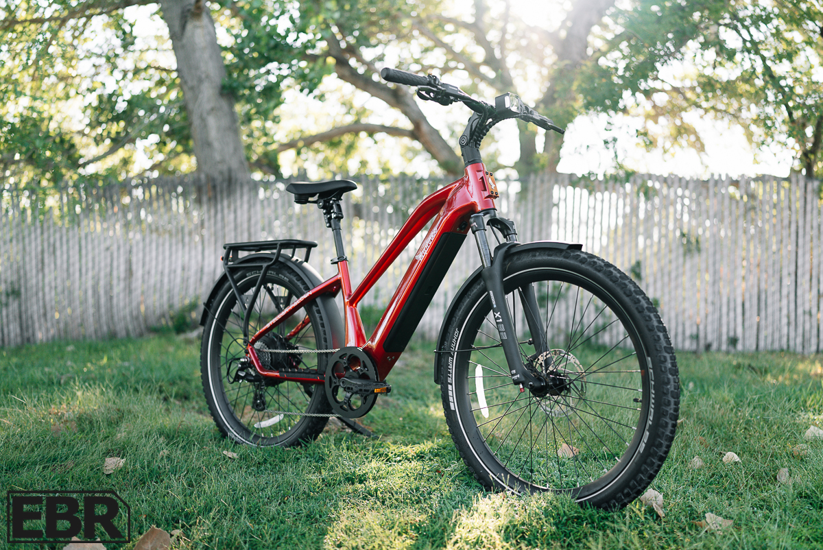

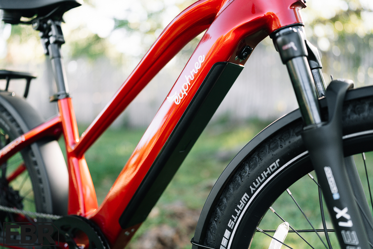

It’s hard to start yapping away at how the bike rides without addressing its curb appeal. The paint on the Stellar Falcon is a deep metallic paint with a nice layer of clear coat that impressed most of us here at the office. While the brand’s logo is on the bike, it’s smaller than most and not obnoxiously large.

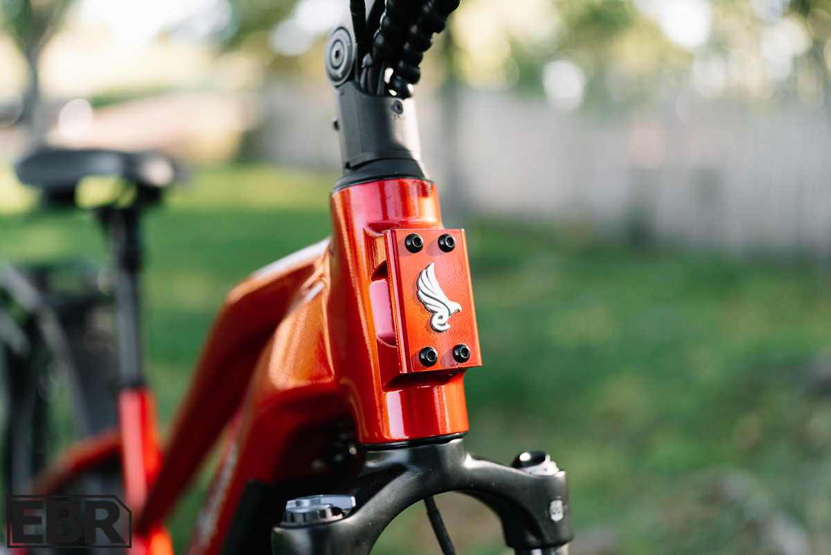

The cable management and wires are all nearly routed from the handlebars, down through the headset and inside the frame for a very modern, clean look we have come to expect these days but down always see.
This Mid-Step frame is advertised as fitting riders between 5′ 5″ and 6′ 4″, me being right in the middle of that at 5′ 11″, I found the fit to be very good for me with room to go in either direction. Plus, the Zoom 110mm stem has 90 degrees of adjustability allowing me to dial-in a good fit even further.
The riding position of the Stellar Falcon is upright, not quite cruiser upright, but also not so low that you look like you’re on a performance MTB, it’s more of a comfy hybrid position.

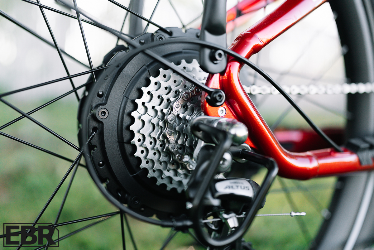

The Euphree Stellar Falcon comes with a geared rear hub motor made by Bafang. It has a nominal power output of 750W watts with the ability to peak at 1250 watts and has a very respectable 90 Nm of torque. Activating the motor, Euphree opted to give us both a cadence or a torque sensor to work with that can be selected at your convenience through the bike’s display.

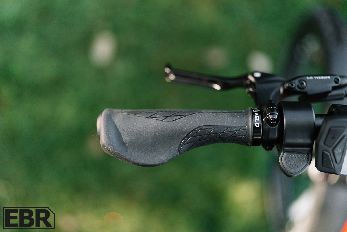

Starting with the cockpit, you have a flat bar with a slight rise, measuring 29 inches wide (around 740mm). The bar is outfitted with Velo lock-on ergo grips in black rubber, which I think feels comfortable and stable.
On the left side, you’ll find a push throttle and a small color display, while the middle section houses a Zoom 90-degree adjustable stem with an integrated SP Connect mount, perfect for securing your phone or GPS. On the right side, there’s a Shimano Index Shifter, a bell, and the Tektro E350 Brake levers.

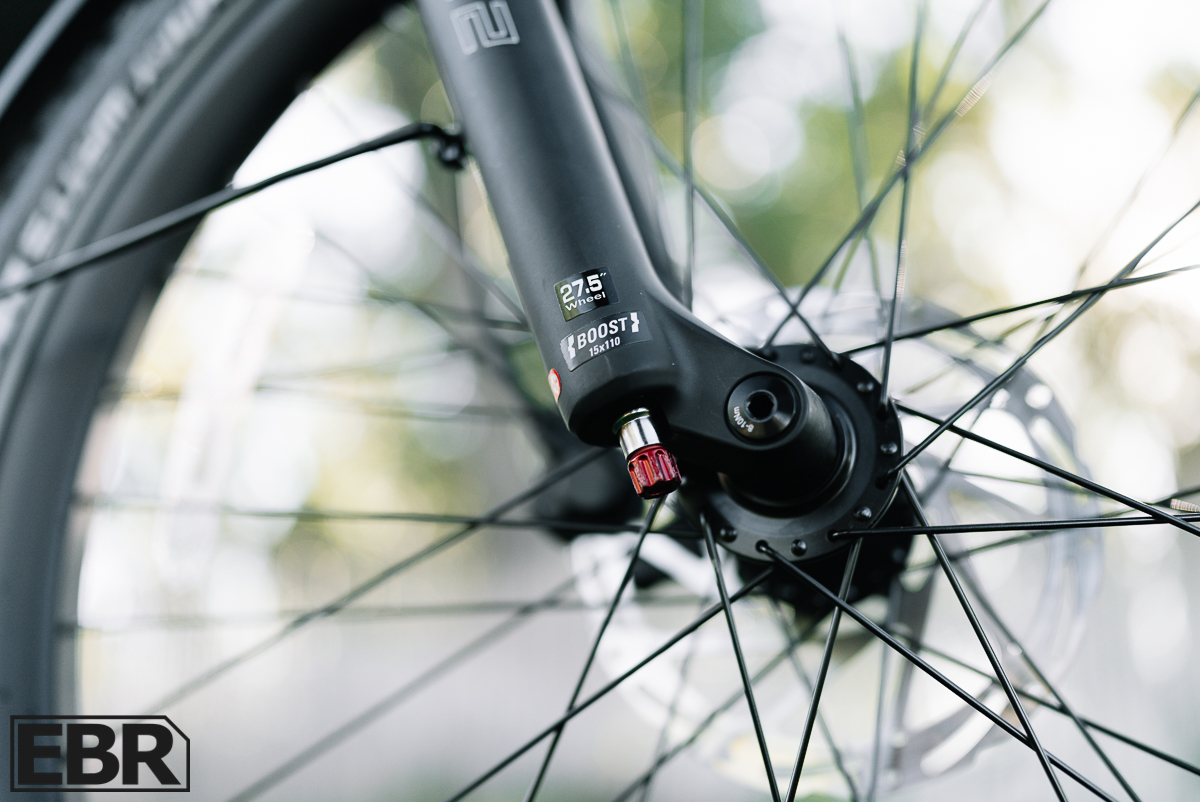

One of my favorite features of the Stellar Falcon is its suspension fork. Unlike many e-bikes in this price range that come with coil forks, this model is equipped with an SR Suntour X132 air fork, offering 110mm of travel along with preload, rebound, and lockout adjustments. The air fork provides a much smoother and more responsive ride, which is a welcome upgrade over the standard coil forks we often see at this price point.

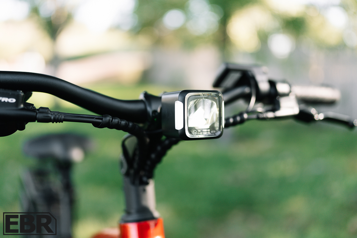

The bike is well-equipped for commuting, with front and rear LED lighting—200-lux for the headlight and an integrated brake light at the rear. It also comes with practical features like front and rear black alloy fenders, a rear rack rated for 55 lbs, and a mounting point on the front of the frame for an additional rack that can carry up to 25 lbs. The total payload capacity for the Stellar Falcon, in both frame configurations, is 350 lbs.

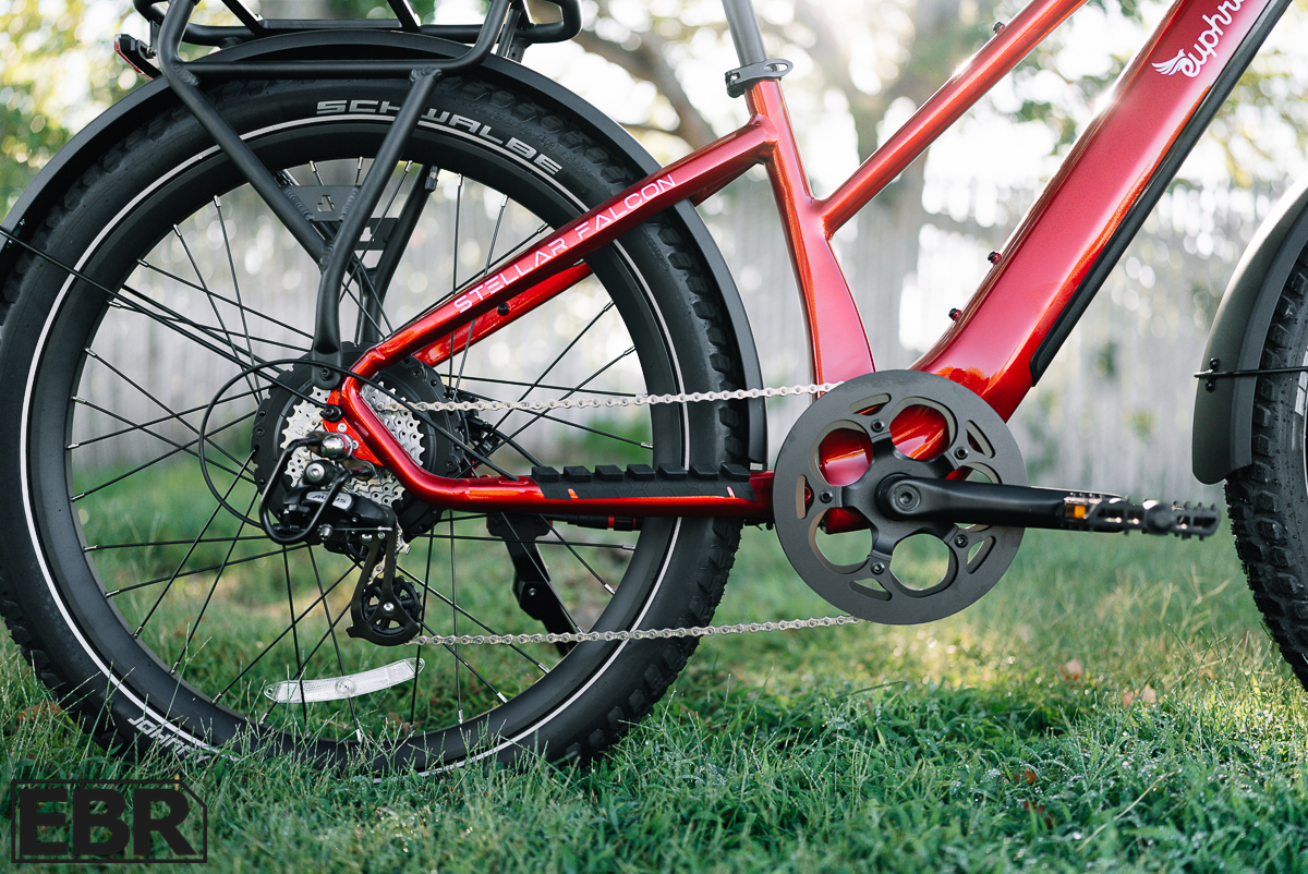

Finally, the drivetrain consists of a Shimano Altus 8-speed setup, featuring a 50T chainring, 170mm aluminum cranks, and an 11-32t cassette in the rear, offering a good range of gears for most riding conditions. I never felt the bike was undergeared or over-geared, it seems like a good sweet spot for this bike.

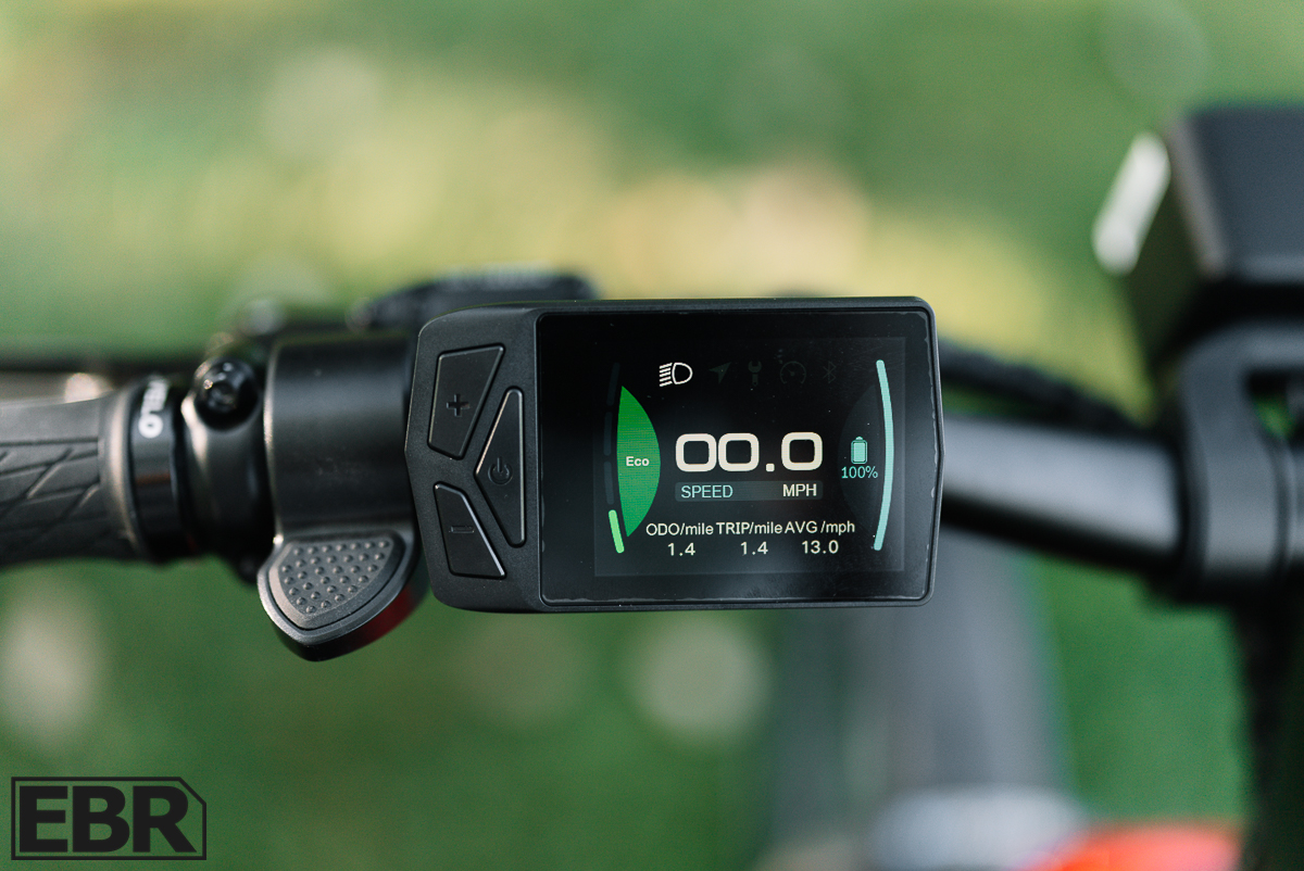

The Euphree Stellar Falcon features a color LCD display that presents all the essential riding data right on the home screen. You’ll find the speed, time, PAS level, odometer, battery level, and average speed clearly displayed.
For those who like to fine-tune their ride, holding the plus and minus buttons on the control pad takes you into the advanced settings. Here, you can adjust units of measurement, language, auto-off time, and display brightness. You can also switch between the cadence or torque sensor and customize the power delivery across the four riding modes, whether you prefer a fast, punchy ride or a more mild and relaxed experience—or anything in between.
