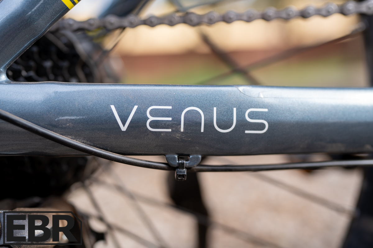

The new colors look great in person. My test bike came in Titanium Grey, but Heybike also offers Rose Gold and Pearl White, each with a subtle metallic flake and glossy finish that really pops when sunlight hits it. What caught my attention right away was the hydroformed frame. There are virtually no visible weld marks, and despite the step-through design, the frame feels stiff with no flexy or wandering sensation when you’re riding. It’s a noticeably cleaner look than most eBikes at this price point, and it handles the way you’d want it to.

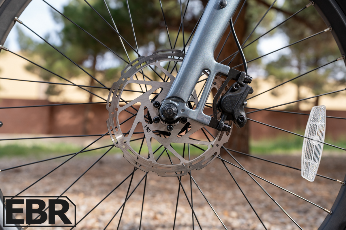

Braking is handled by hydraulic disc brakes, and at 50 pounds the Venus stops confidently. I did a few quick stops from over 20 mph during my test rides, and the bike never hesitated. The brakes have good modulation and plenty of power, which is what you want when you’re riding in mixed traffic or coming down a hill with some speed.

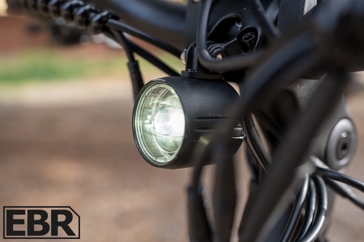

All in all, the Venus is a solid entry into the competitive city cruiser market. It has front-to-back LED lighting, new frame-integrated turn signals and taillights, the option to add fenders and a rear rack (both sold separately), and it comes in at a price that undercuts the competition by a few hundred dollars. It shows how far Heybike has come over the years, and that’s a good thing.

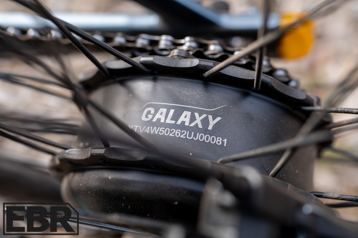

The Venus uses a 750W rear hub motor that Heybike calls the Galaxy eDrive System. It puts out 70 Nm of torque, which is solid for a hub motor in this class. That’s enough to get you moving quickly from a stop and handle moderate hills without much drama. The motor is designed to run quietly, which Heybike emphasizes throughout their materials. Hub motors are generally simpler and require less maintenance than mid-drive systems, and they let you shift gears while stopped, which is handy in urban riding.

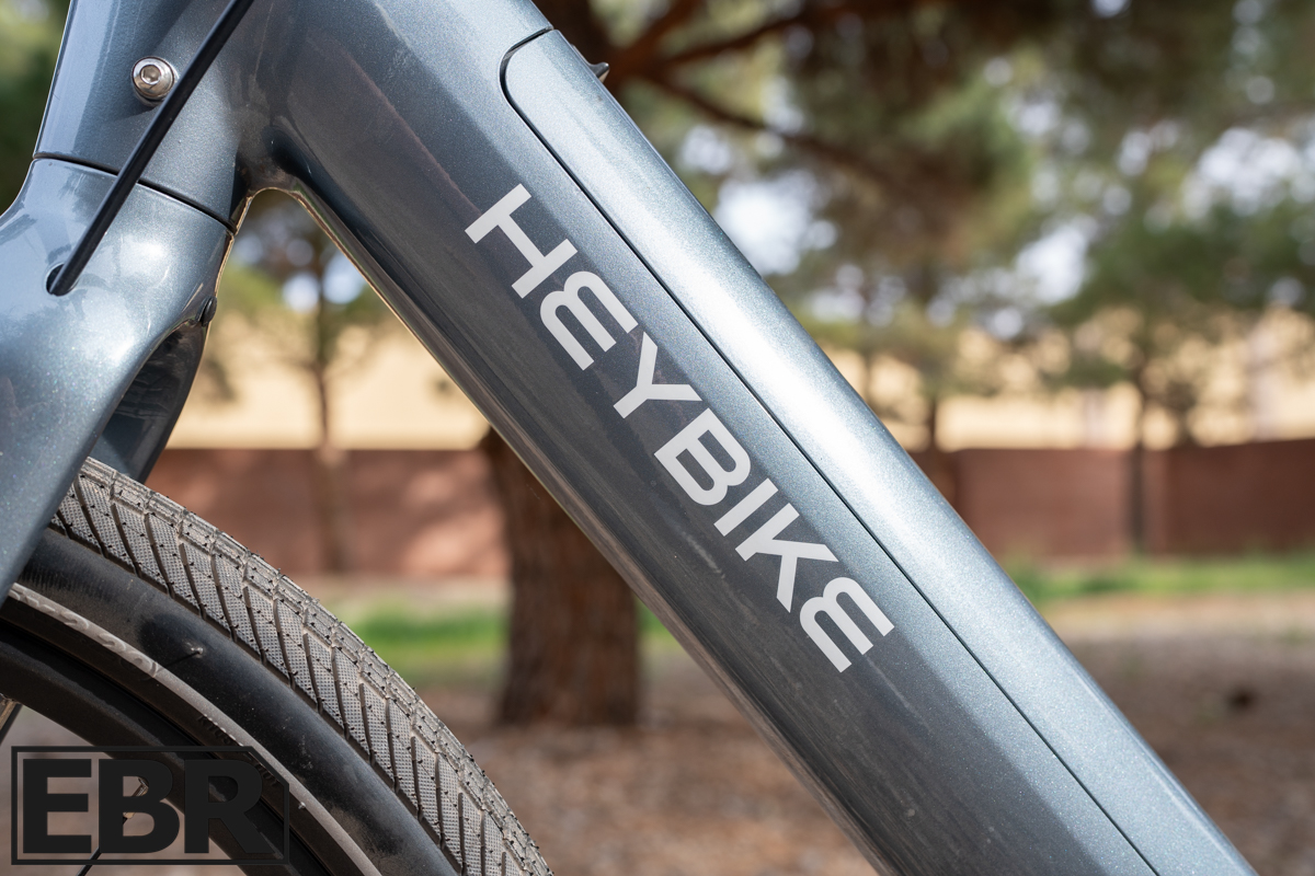

The battery is a 48V, 14Ah unit with 680Wh of capacity, and it’s UL 2271 certified. The whole bike is also UL 2849 certified, which matters for insurance, building storage rules, and general peace of mind. The battery is integrated into the downtube with a removable cover and a keyed lock. You can pop it out for charging indoors or leave it on the bike.

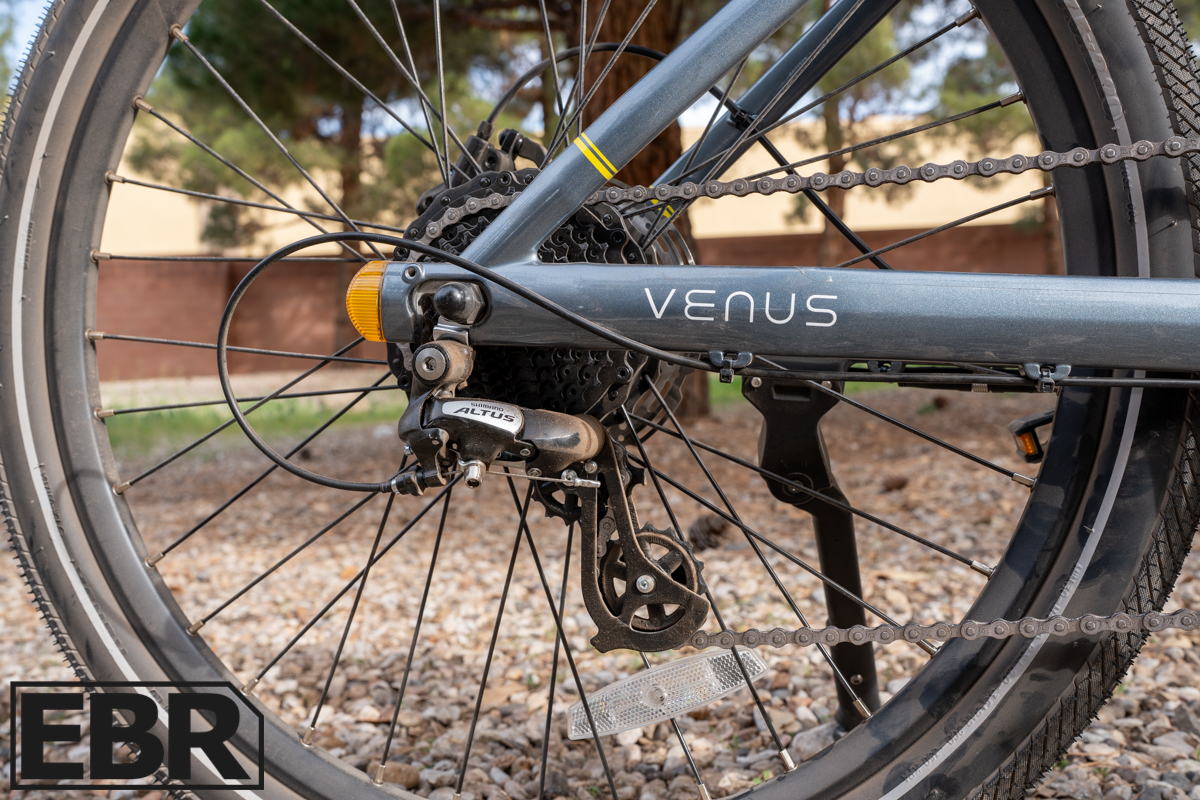

The Venus runs a Shimano Altus 8-speed drivetrain, hydraulic disc brakes and 27.5” commuter tires, which for a bike of this style and price point feels like a good setup.
The 48T chain ring and 11-32T cassette gear spread is wide enough to handle most situations, and Shimano Altus is reliable if not particularly fancy. What’s more interesting is the trigger shifter placement. Heybike mounted it under the handlebar instead of the typical top-mount position, and they claim it reduces shifting effort by 30%. I can’t verify that number yet, but the ergonomics make sense for an upright riding position where your wrists are already angled. The shifter also uses what Heybike calls a “refined” design that’s supposed to help you keep momentum when shifting under load, which matters more on an eBike than a regular bike since you’re carrying more weight and speed.
Braking is handled by hydraulic disc brakes with 180mm rotors front and rear. No brand specified in the specs, but hydraulic discs at this price point are a good sign. The 180mm rotor size is appropriate for a 50-pound bike that can hit 28 mph, and hydraulic systems give you better modulation than mechanical or cable-actuated discs. Given the target demographic here, confidence at the brake lever matters more than outright stopping power, though you’ll want both when you’re riding in traffic or coming down a hill with groceries on the rear rack.

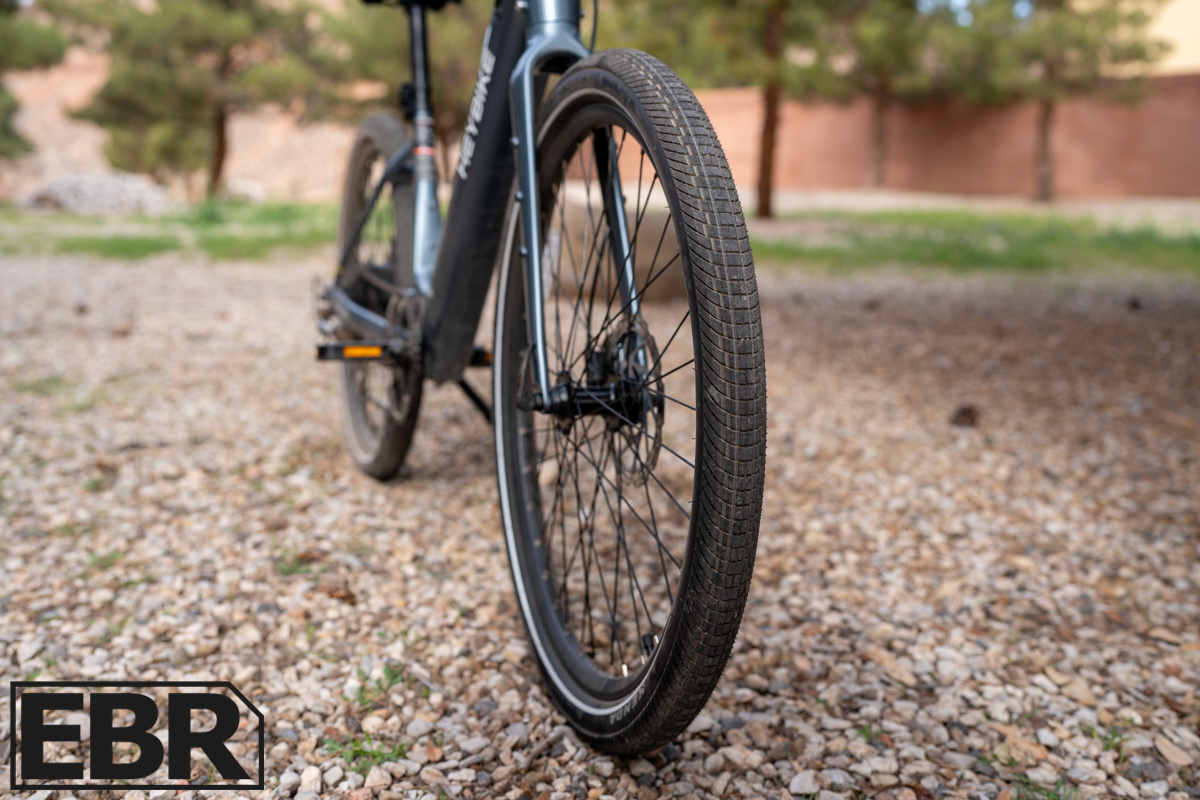

The Venus rolls on 27.5″ x 2.2″ Kenda tires. That’s a good middle ground for a dual-purpose bike. The 27.5″ diameter is smaller and more maneuverable than 29″ wheels, while the 2.2″ width gives you enough cushion for cracked pavement and light gravel without being sluggish on smooth roads. Kenda makes decent tires for the price, and the commuter tread pattern on these fits the bikes commuter/cruiser use case.

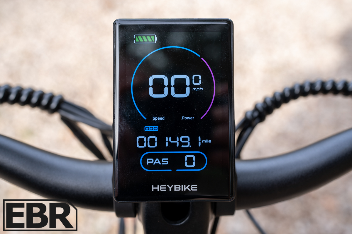

The HeyBike Venus has a LCD color display that sits front and center on the handlebar. On the main screen you have all the basics like your battery charge level, speed, power output, odometer and pedal assist level.
While there are some advanced settings in the display that can be altered, they are coded and require a manual to navigate. Fortunately all the same settings are in the HeyBike App which easily pairs and allows for all the same changes in a much easier way.

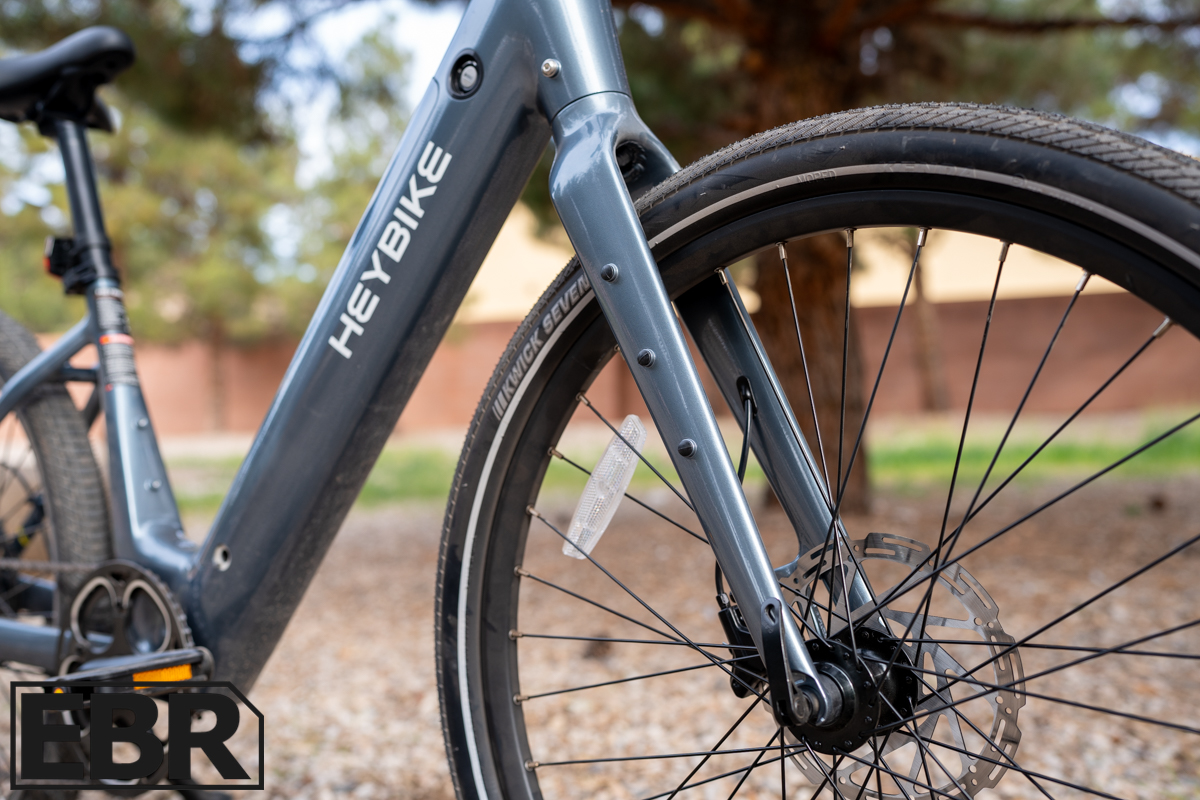

- New sleek hydroformed aluminum ST frame with no visible welds and modern look
