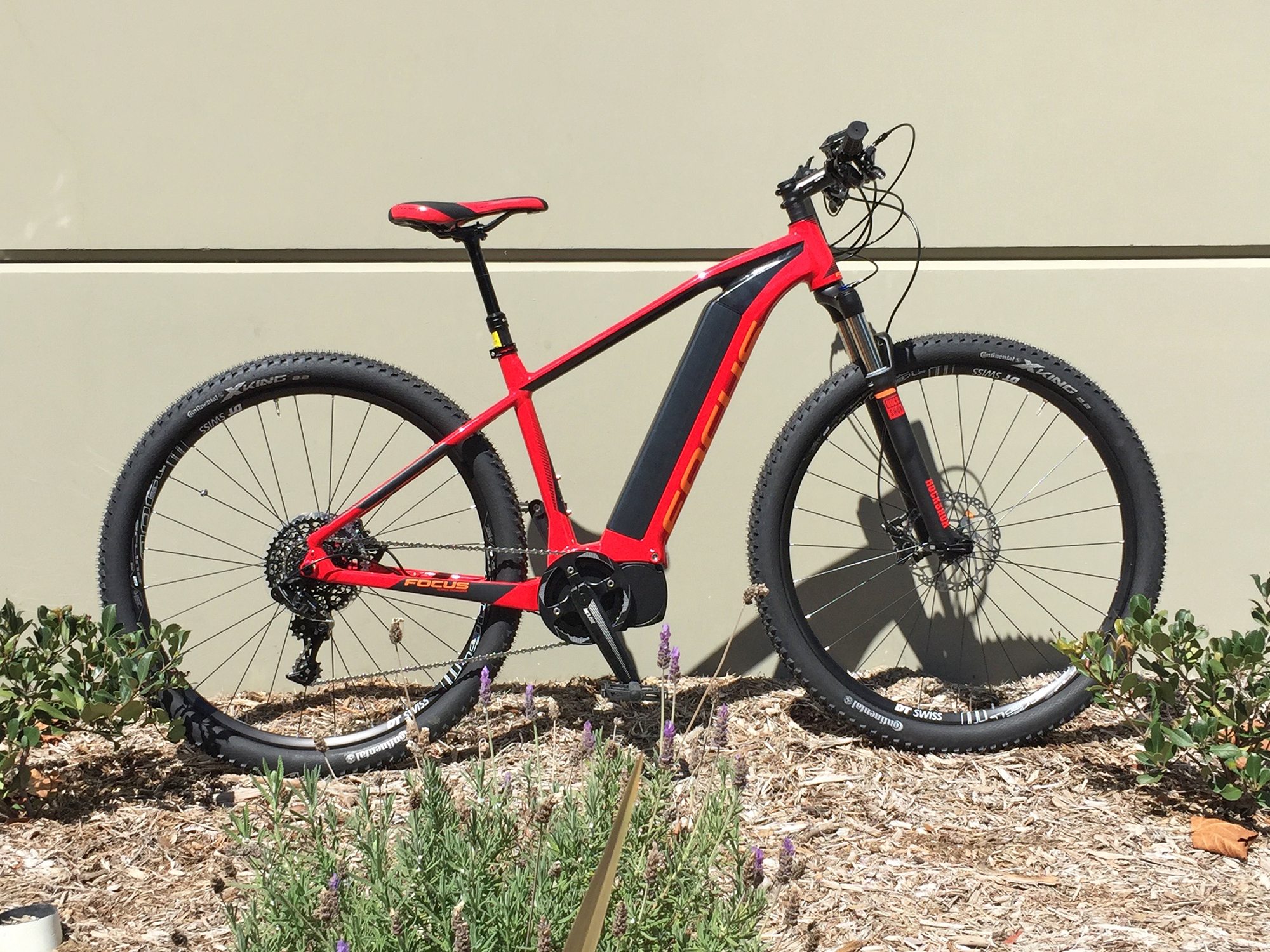

The Jarifa I29 Pro is a hardtail cross country style mountain bike with 29 inch wheels for smooth fast performance on trails. Driven by the new Impulse 3.0 mid-drive motor system, it operates efficiently (running off a 36 volt battery) and offers even more torque than some of the big competing brands like Bosch, Yamaha and Brose. Delivering up to 100 Nm of torque and leveraging 11 sprockets on a SRAM GX drivetrain. The bike is an excellent climber but it produces more noise than past Impulse systems I’ve reviewed. Coming back to the wheel size for a moment, more power is required to leverage and move the larger diameter and increased tire weight so some of the upgraded power is spent right a way there. It’s nice to see an update from one of the most compact and adjustable centerdrive systems on the market, and the motor casing looks great… blending into the bottom bracket area – not hanging below the chainring at all.

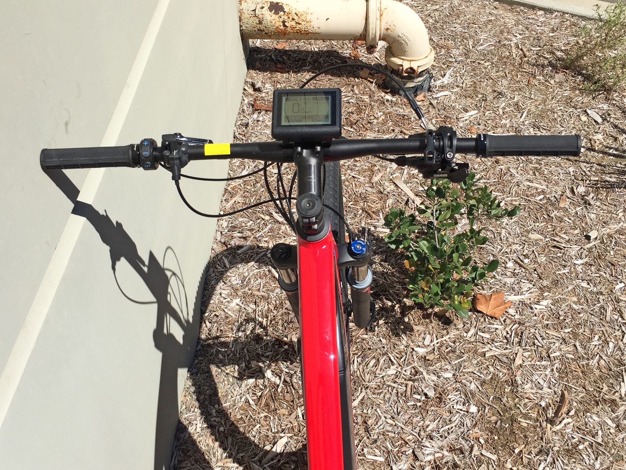

Unfortunately, in my opinion the Impulse display itself is a bit vulnerable because it’s more permanently fixed to the center of the handlebars which do not curve up around it, offering no protection in the event of a crash. Thankfully, the display does pivot forward and back to help you reduce glare and get a nice view but not being able to remove it sort of irks me. Especially given this is an off-road bike which is more prone to drops… it doesn’t even come with a kickstand. In my opinion, the display is also not that pretty, just thick plastic slab with grayscale readouts. It’s much different from the slim metal designs Impulse has used in years past and from the sleek designs of the competition like Bosch and Yamaha. This Impulse screen size is fairly large and you can adjust backlighting but the overall quality of the bezel doesn’t match the smooth aesthetic of the button ring used to operate it (mounted near the left bar) or the premium feel of the RockShox air fork and seat post dropper. Even the battery pack, which is perfectly integrated into the downtube, outshines the display panel.

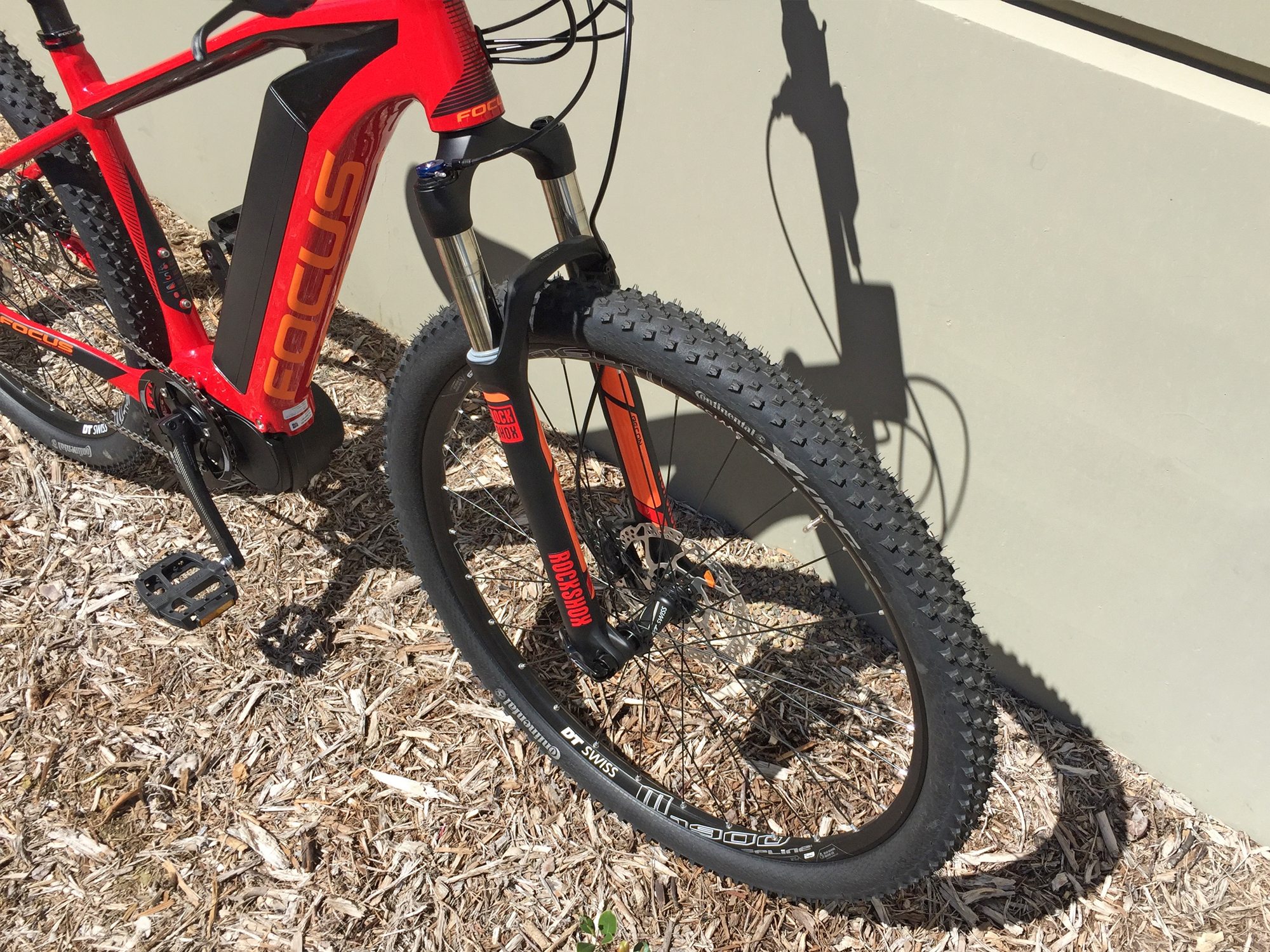

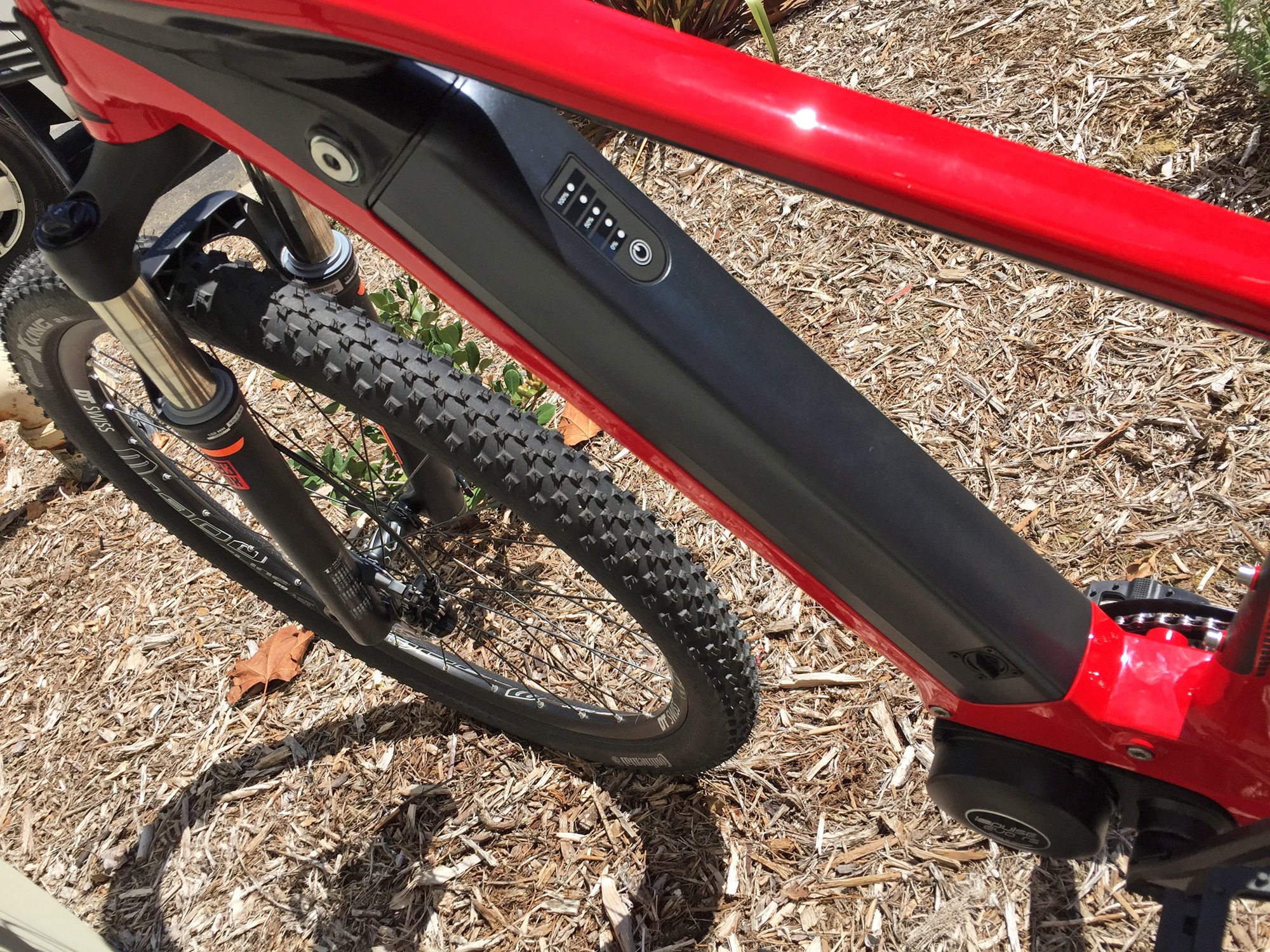

This ebike rides well, weight is positioned low and completely integrated with the frame. The battery pack swivels in from the side leaving enough room on the seat tube for a bottle cage or other accessory. I love that it includes bosses here for mounting. When charging the pack, there’s a magnetic EnergyBus port on the side that sends both power and data (useful for software updates or diagnostics) and of course you can charge the thing on or off the frame. Keep an eye on the little magnetic cap for the charging port however as this part frequently goes missing if you forget and put it down, a little string leash might help resolve that and I’d love to see an option like this not just from Focus but all of the brands that use the Rosenberger EnergyBus design. Given the more standard 36 volt rating of the pack I was delighted to see a higher amp hour rating of 16.75 ah. That’s over half a kilowatt hour of capacity total which means you can go further on each ride.
The overall weight of the bike is at ~50 lbs which is on par with what I’d expect and the traditional diamond frame is rigid and strong. They chose a gloss red color scheme here which follows some of their other unique paint jobs from the past (purple, dark green) and it’s balanced by the black battery and sparkly black accents. I’m not sure the sparkles were necessary and considering that they don’t match the battery shell… the whole thing left me delightfully confused. There were also seams on the paint in some places that made me feel like the bike was wrapped vs. actually painted and glossed over. The bike I tested was one of the first in the United States and I don’t want to get too hung up on the aesthetics because they might be refined with the final version but it certainly was different. Focus is a premium European brand that makes sporty ebikes, the kind of stuff you’d take on a trail or hit higher speeds with. The Jarifa I29 Pro goes up to 20 mph making it a Class 1 model, most widely accepted on trails in California and other states. With some adjustment, the system should be very responsive and overall it performed well for me but not perfectly. I had a better experience with some other Focus models using the same Impulse 3.0 drive system so I’m guessing that some of the settings had been changed before my test rides. I did try to adjust them myself on the fly but had limited success. Your feedback is welcome here and again, I trust the brand and enjoyed the product overall… just felt like a few things could use some refinement. I would love to see bosses at the rear for adding a carry rack because this would make an awesome commuter slash weekend warrior. As it stands, there are some bosses for a fender and support struts which might be adaptable for racks but might not. Given the ~$4,300 price tag, this is not a cheap electric bike, especially for a hardtail. There are competing full suspension models priced similarly that also come in a range of sizes but their build quality and component group is often lower. You do get a lot of unique drive modes and a custom battery pack here but the novelty of those design elements has been eroded by the Bulls system and others that are tightly integrated, quiet and responsive. The biggest difference here would be physical shift sensing which could reduce wear on the sprockets and chain while shifting off-road… it’s too bad I couldn’t demonstrate these systems more clearly in the video but I still enjoyed the bike. Big thanks to Focus for partnering with me for this review.

- Beautifully integrated battery pack, it blends in perfectly with the black paint accents on the downtube, you can charge it on or off the bike for convenience

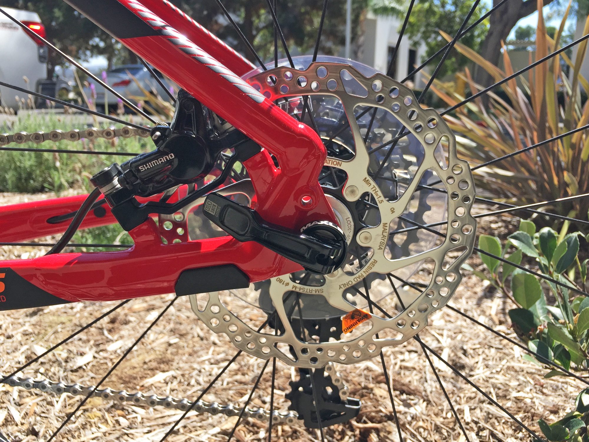

- Both wheels feature quick release! This makes for easier flat fixes on the trail and reduces space if you’re transporting the bike in the trunk of your car, the battery also comes off easily for reducing weight by about 7 lbs

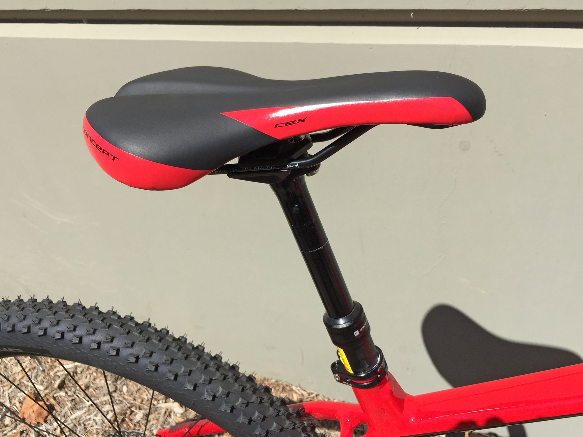

- The suspension fork and seat post have remote switches so you can lock them out or drop them respectively, this is handy when you’re really focused on riding a challenging section of trail or ging fast and want to maintain a balanced pedaling position

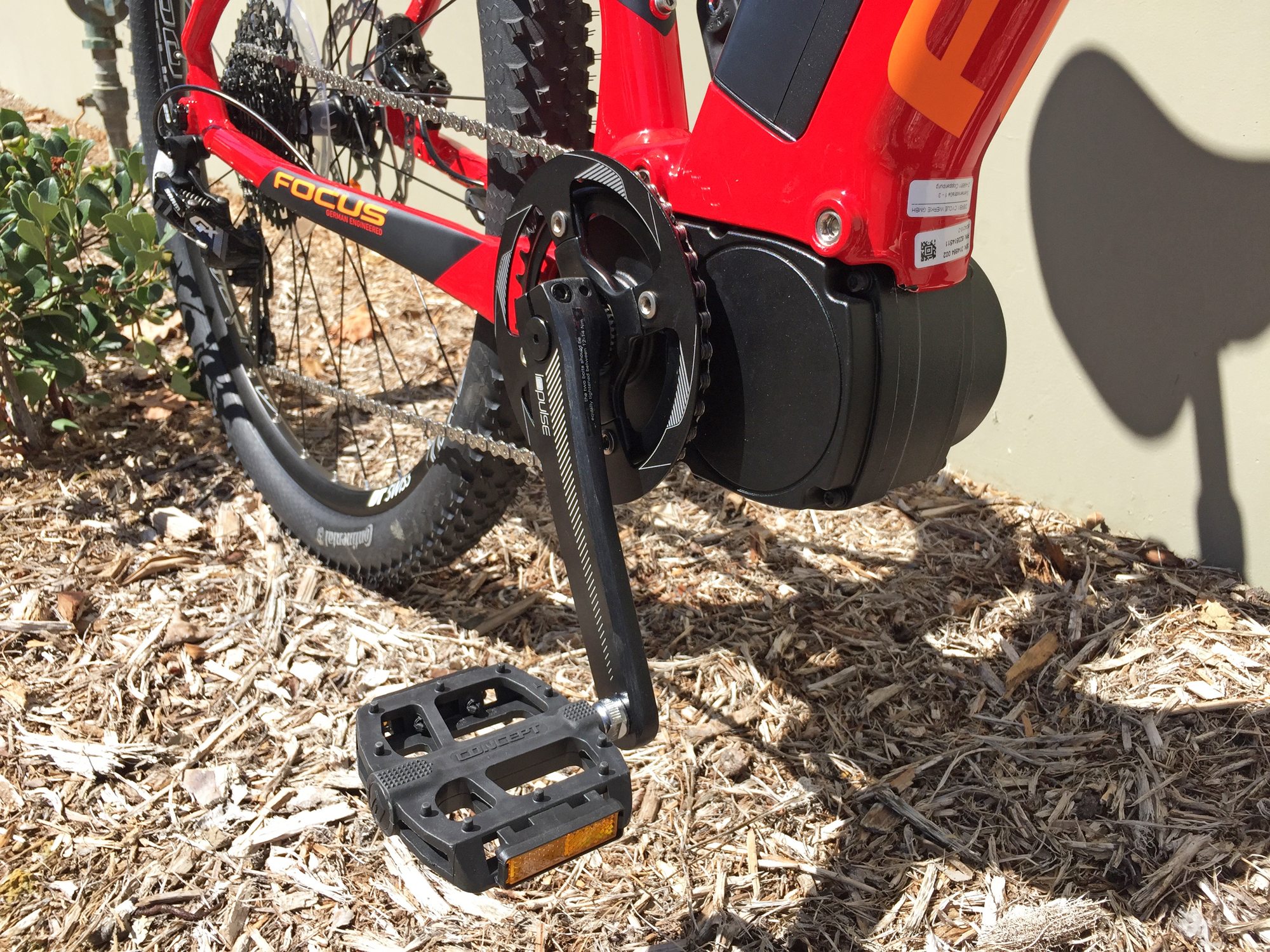

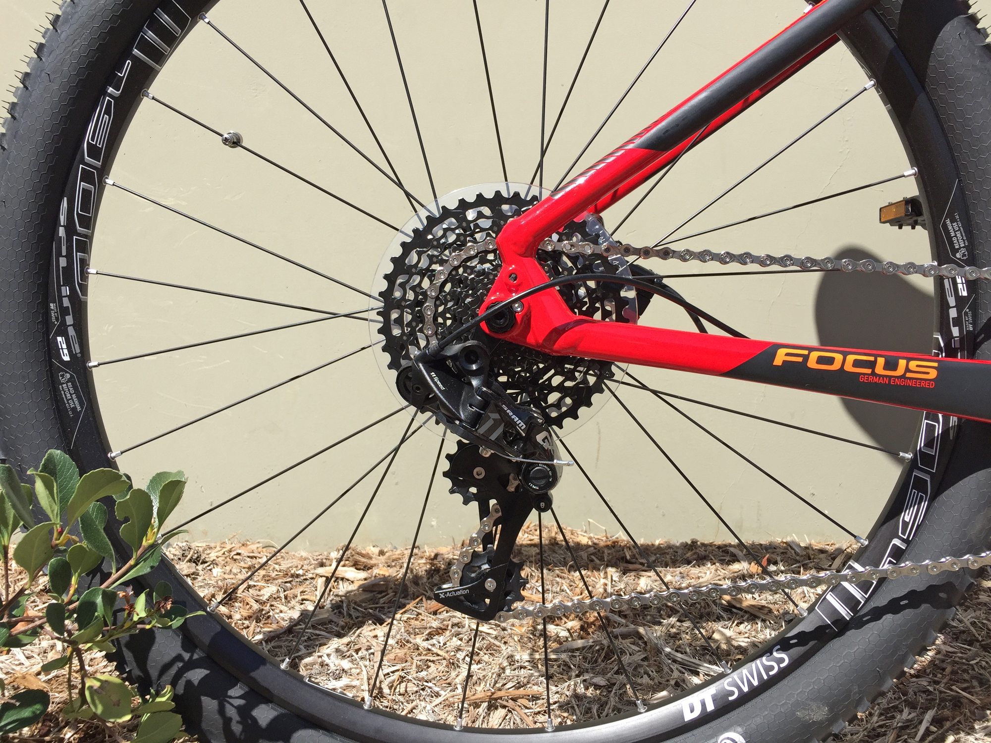

- Beautiful drivetrain with a quality SRAM 11 speed cassette in the rear (with SRAM GX derailleur) and a bash guard on the chain ring up front, the motor is integrated nicely – tucked up higher than the base of the chainring for maximized trail clearance and protection

- 15 mm thru-axle up front and 12 mm axle in the rear, these increase stiffness and wheel strength, great for off-road riding but also make it easier to line the wheels and disc brakes back up up if you take them off using the quick release

- The I29 Pro uses the latest third generation Impulse motor which offers 100 Newton meters of torque! That’s more than Bosch or Yamaha, I wasn’t able to test on super steep grades but it felt good around the streets and stayed fairly quiet (a bit louder than the older gen 2 motors)

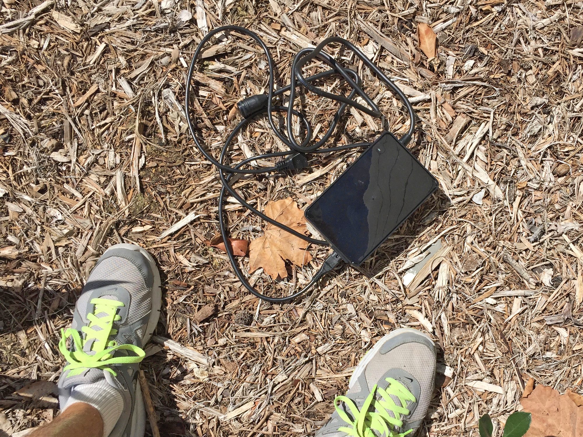

- The charger fills this battery 50% faster than most others I see because it’s rated at 3 Amps output, it looks nice and uses the EnergyBus magnetic port (so you won’t bend pins if it gets snagged or tripped over)

- The charger looks nice and isn’t especially heavy but isn’t as compact as some others I see, maybe they had to make it larger to dissipate heat since it charges faster? If you’re putting it in a backpack it could take up more space but I like that one of the plugs comes out of the side to make it more compact when coiling

- The display is sort of thick and chunky looking and I felt like the wires in the back could get bent if you angle it all the way forward, it’s also not removable… which could put it in harms way if you’re dropping a large hill and lay the bike down (some other displays can be taken off to avoid this sort of situation)
