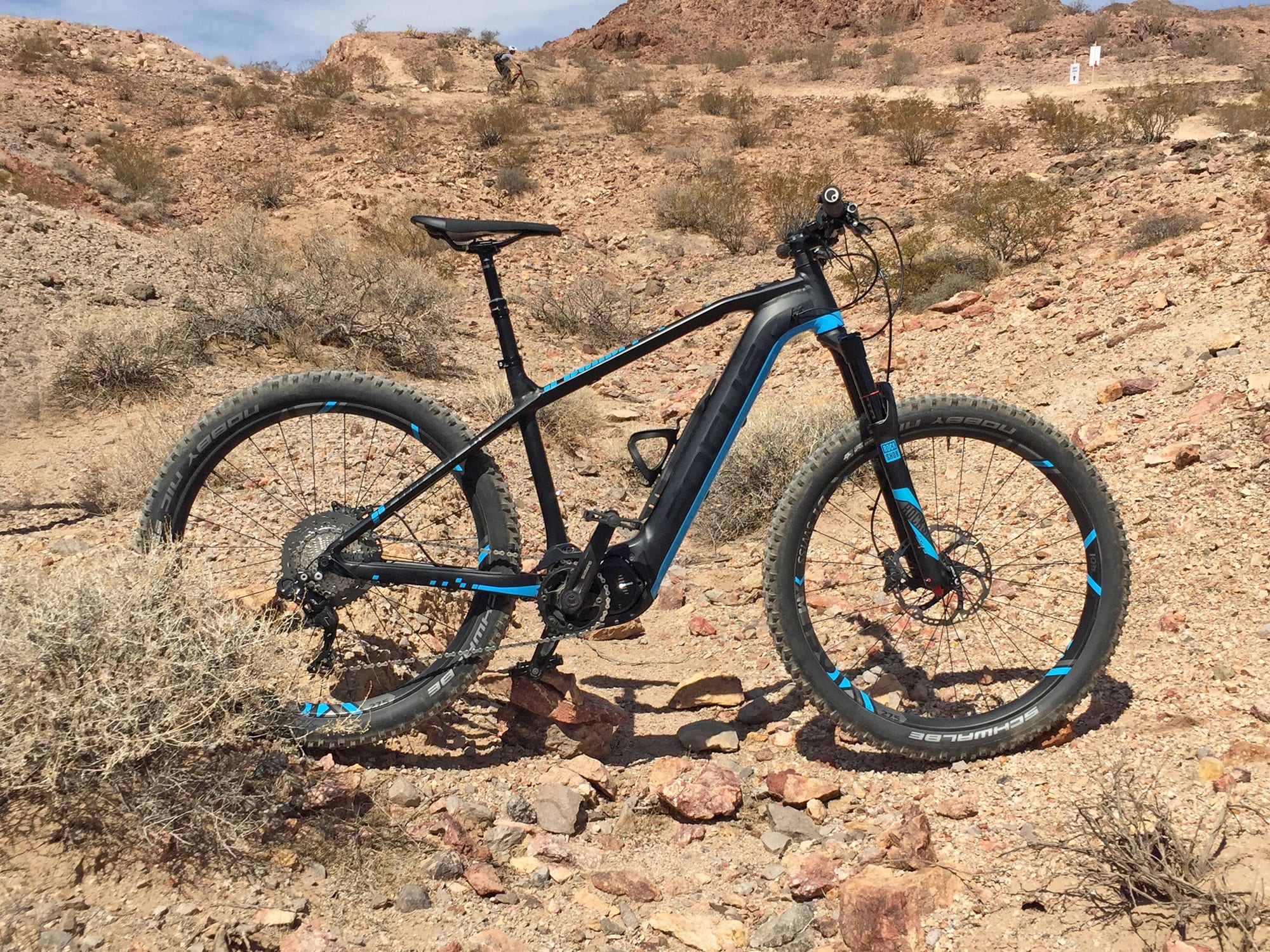

The BOLD² platform is a hardtail, cross country style, electric mountain bike built around the same geometry as the non-electric Focus BOLD. The idea here, is that Focus is “focusing” on building a well-balanced, high-quality bicycle… that can be utilized in two different ways, with or without pedal assist. Of course, the electric version will cost more because of the motor, battery pack, and I’m guessing lower volume. It retails for $4,899 which is not bad at all, considering it utilizes the brand new Shimano E8000 mid-motor and a custom-made downtube integrated battery pack. Note how clean the frame looks with internally routed cables, the hidden battery, and that compact centerdrive motor. In my opinion, they made a smart move going with black as the base color because it further blends the motor casing and cable housing, but the grey and blue accents are carried through the fork and rims so it does still have a sporty fun feel. The bike comes in five frame sizes, so you can really dial in fit, and even petite riders and some youth and teens could get in on the action with the extra-small 35 cm frame. To me, the best parts of this electric bike in order of importance are the way it looks, how lightweight it is (just 44 lbs thanks to the lower capacity primary battery), the strong reputation that Focus and Shimano bring (along with a two-year comprehensive warranty), and the ability to choose from plus sized 27.5″ wheels or taller 29″ for milder terrain or larger riders. A few nice-to-have features are the dropper seat post (which makes mounting easier), large 203/180 mm hydraulic disc brakes, optional Shimano Di2 electronic shifting that works with the main display panel (this option seems to be limited to Europe at the moment), an 11 speed drivetrain with traditional chainring and no reduction gearbox (easier to swap to different sizes), and the nifty click-on bottle cage adapter (which also works with mini-pumps and folding locks). In so many ways, this looks like the future of electric assist bikes. It’s beautiful, modular, focused on fit and performance, and it’s extremely capable.

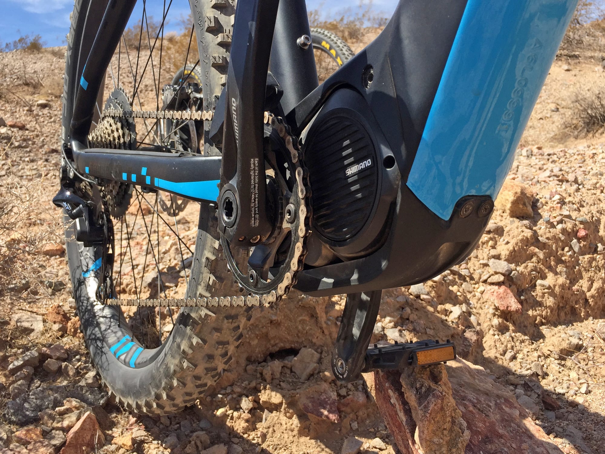

Driving this e-bike is the brand new Shimano E8000 mid-drive motor that was specifically designed for mountain riding. It offers up to 70 Newton meters of torque and some of the highest RPM support I have ever experienced. Where Bosch, Brose, and some other brands are able to deliver up to 120 RPM (allowing you to spin faster and still get power, not having to shift as frequently to hit high speeds), the Shimano E8000 was still helping at 140 RPM… Maybe not very much, but it was definitely on par with or slightly ahead of the Bosch CX motor and a step beyond the new Yamaha PW-X in my opinion. It’s not the quietest or loudest motor, the noise produced really depends on your RPM as shown in the video review during my pedal tests. The controller measures rear wheel speed, pedal cadence, and pedal torque to offer a dynamic and satisfying experience, but it wasn’t as smooth to start as Brose or Bosch. I definitely noticed, and actually felt, when the motor kicked in. There seems to be a torque threshold where pedaling without much effort (say, if you were coasting and just gently pedaling) won’t activate it. Once you do finally push, it felt like there was a click or a catch and then the motor feels fluid. Having tested both the European specced 25 km/h models (that’s 15.5 mph top speed) and then the US version specced at 32 km/h (up to 20 mph), I definitely preferred the US and found that I enjoyed riding in Eco and Trail mode… whereas, I was constantly in the highest Boost mode on the European models. Take this feedback with a grain of salt however, because I was riding all European models with some software updates for the “US” spec, and perhaps there was even some tinkering with the Shimano E-TUBE app to adjust Trail and Boost settings before we rode. I can say, I tested two versions of the BOLD² as well as the full suspension JAM² model. What you get with the motor system is a compact design, possibly the prettiest I have seen, high RPM support, no shift detection (so ease off when shifting to reduce mashing and chain wear), and a standard 175 mm Q Factore (the distance between the crank arms).

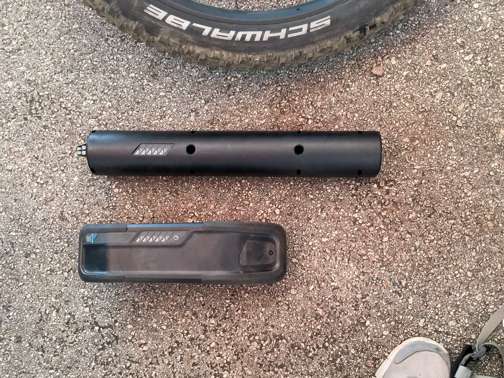

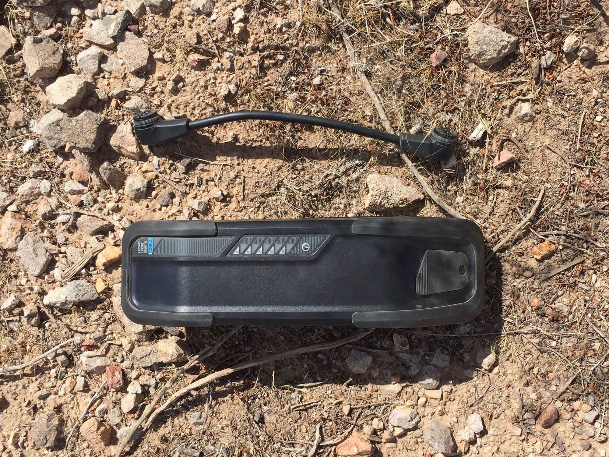

Powering the BOLD² is a custom, internally mounted tube battery that Focus designed and manufactures. Many of the other Shimano motor partners are using a downtube mounted pack that resembles a black box (similar to the Bosch Powerpack) offering 36 volts and 11.6 amp hours… You can see a picture of this pack with the older Shimano STePs E6000 motor on the Trek Neko+ here. So, you can really see how it cleans up the look and lowers the weight by going with the tube battery. The downside is that this pack only offers 36 volts and 10.5 amp hours of capacity, it’s not going to take you as far… but it weighs less. And this is where the really interesting stuff comes out. You can double the range of the Focus BOLD² by purchasing an additional battery pack called the TEC Pack (Tailored Energy Concept) which connects on top of the downtube and uses a magnetic plug to sync with the bike. The 378 watt hour TEC Pack weighs 0.2 lbs more than the integrated downtube pack and costs $699. Once connected, it completely switches the bike’s power source, so unfortunately the bike is not trying to balance both. I say unfortunately, because my understanding is that Lithium-ion batteries will last longer if you keep them between 20% and 80% vs. fully charging and discharging all the time. The way the modular battery design on the Focus bikes is setup, it’s like you would drain the main battery and then plug in the TEC Pack for a more series type approach vs. parallel. It’s a minor consideration, but becomes increasingly relevant when you notice that Bosch has gone with a parallel design for discharging and charging, so you can plug the bike in once and see both batteries filled… that’s nice convenience. In addition to powering the motor, the battery system on the Focus Squared models also powers the color, backlit display panel, and electronic shifting (if you get Di2) as well as lights if you work with a shop to have them installed. It’s so cool to see a Shimano drivetrain, motor system, battery, display, and app… but I do feel that theres some opportunity here for the shifting system to tell the motor what is going on so you can opt for some sort of drivetrain protection. Some of the older Focus models running on the in-house Impulse drive system offered great shift protection. You didn’t have to worry about the motor grinding your gears if you weren’t adept at shifting… but given the high-performance use case of this mountain model, maybe it’s not a big deal because riders should have more experience shifting and climbing simultaneously?

- The Shimano STePs E8000 motor is compact, tightly integrated into the bottom bracket area of the frame, it blends into the black frame color perfectly here, it’s also narrower than many other ebike centerdrives right now, supporting a 175 mm Q Factor so your feet position feel more like a traditional bike, and it supports seemingly above 120 RPM which is slightly better than the other leading motors such as the Bosch Performance Line, Brose, and Yamaha PW-X which assist up to 120 and then back off

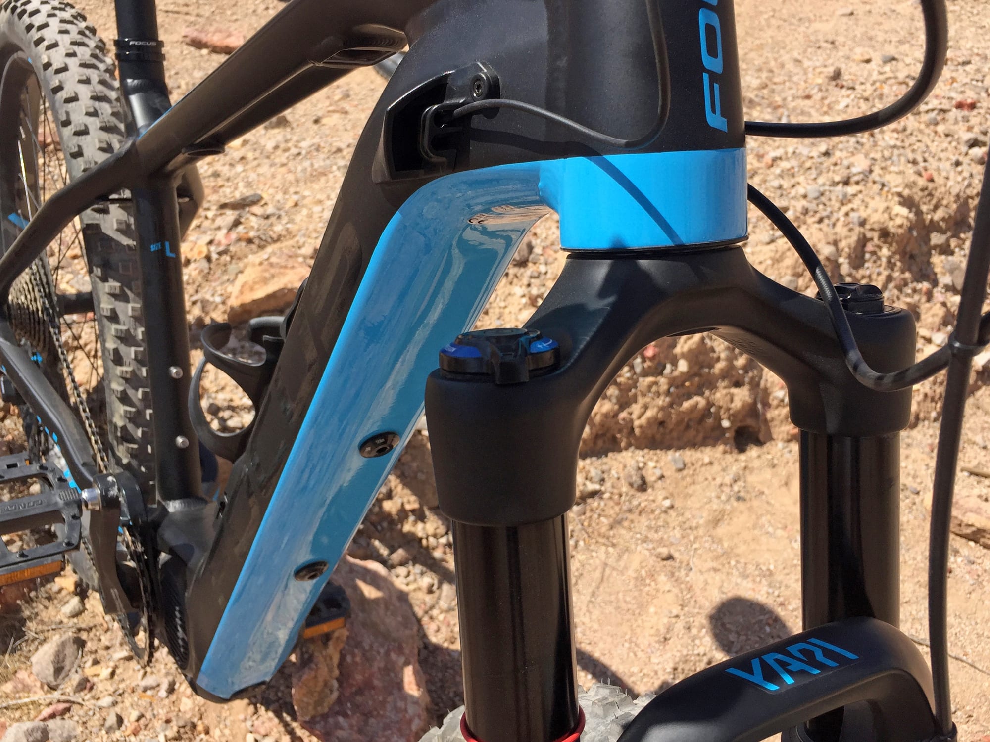

- The battery is completely hidden and protected inside the downtube, it isn’t designed to be easily removable and might go undetected for those who prefer a stealth looking electric mountain bike, Focus and Shimano have a close relationship and this battery design is unique to these bikes (the BOLD² and JAM²)

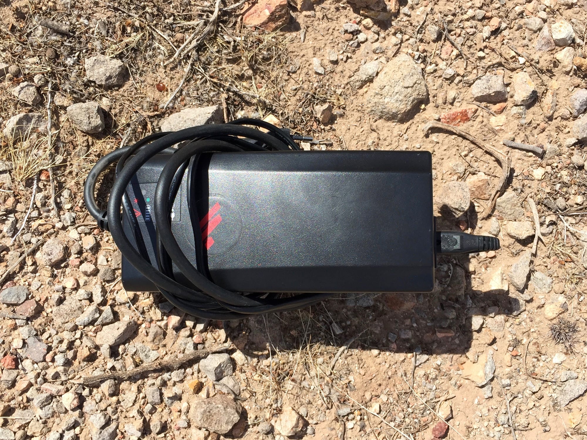

- The charger puts out 4 Amps, making it about twice as fast as most standard chargers, and it’s compact and lightweight at ~2 lbs, the plug connector is magnetic and will pop off vs. bending or tipping the bike if tripped over
- You shouldn’t have a problem with chain drops on this e-bike because the front sprocket uses narrow-wide teeth to improve grab and reduce slip, there’s also a plastic full-surround chain keeper where in place of a front derailleur
- I like that Focus is using a traditional sized chainring because it makes switching sizes easier than the proprietary rings offered by Bosch and TTIUM, there is also very little resistance when pedaling because there’s no reduction gear gearbox to match a stepped-down chainring

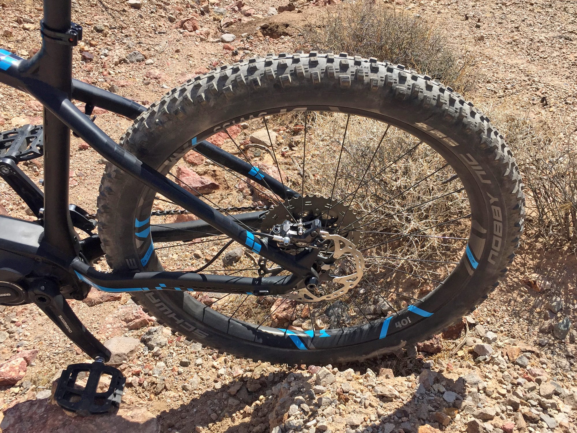

- I reviewed the Plus model which uses 27.5″ x 2.8″ Maxxis Rekon+ tires which offer improved traction, comfort on rough terrain, and rolling momentum for a nice all-mountain feel, Focus used Boost length axles with 15 mm and 12 mm thru-axles for stiffness, to accommodate the wider tires, and strengthen the spoke angle
- Great aesthetics, blue and grey accents cover the frame, fork, and wheelset, I appreciate the thick rubber slap guard on the right chainstay to reduce nicks and scratches

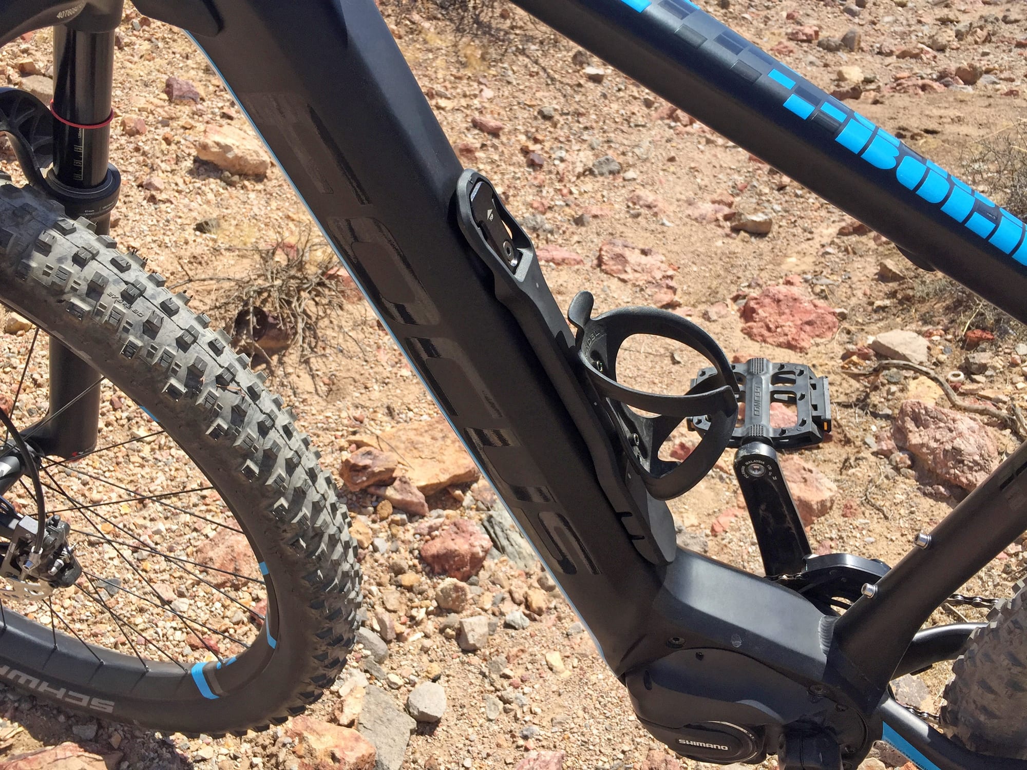

- There are air channels built into the upper section of the downtube that are designed to promote cooling on the battery pack and motor, it’s like a sport car with a hood scoop! I was told that water and dust can get in here without wrecking any of the electronics

- It’s really neat that the downtube railing system can be used for a second bottle cage adapter if you aren’t using the TEC Pack battery, so many electric bikes are not able to fit even one set of bottle cage bosses or they just skip them… so it’s cool that the BOLD² has two, and it looks like the downtube mount is adjustable and could work with a folding lock, mini pump, or other accessory using the same plastic plate

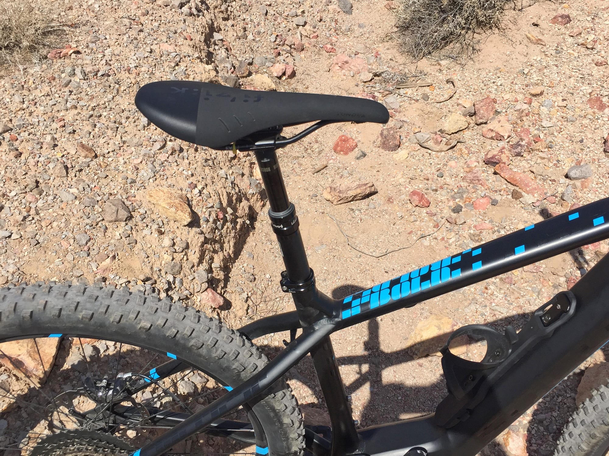

- I’m a big fan of seat post droppers, they make it easier to mount up and more comfortable to transition from bumpy or downhill sections and jumps to cross country or road… so it’s nice that you get one with this electric bike, even though it’s more of a cross country setup

- The primary battery is not designed for easy removability, it can be removed for replacement but this requires taking the motor unit off and sliding it out through the bottom, the downside is that you’ll need to park the bike closer to a power outlet or use an extension cord to charge vs. bringing the pack inside (keep the bike and optional extra battery in cool dry locations to optimize battery life, extreme heat and cold can be hard on them)
