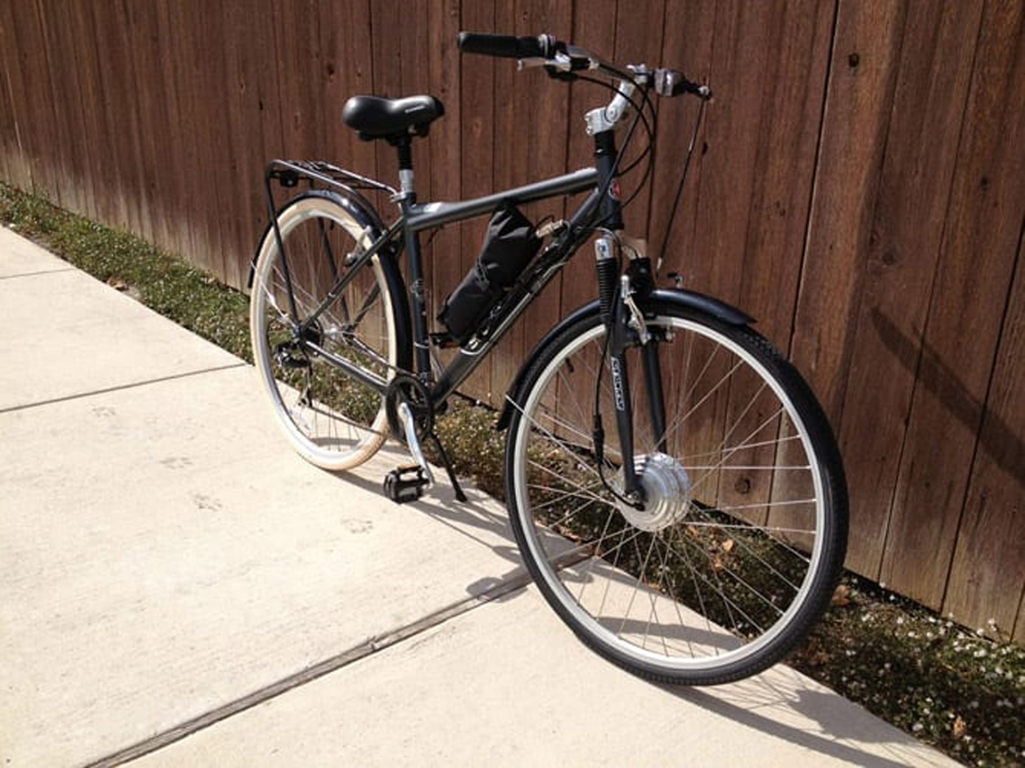

This kit will not turn your bike into a moped or carry you up steep hills, especially if you’re a heavier rider, but it will make riding and climbing a lot easier. In fact, one person who lives on the island of Bonaire added it to his tandem bicycle and was very impressed with how much easier it made the ride (especially on windy days) for him and his friend. The motor offers 250 watts of power and is paired with 24 volts coming from the battery, which is definitely on the low end for ebikes. Depending on the battery configuration you choose this bike could go from 8 to 40 miles and weigh between 8 and 12 pounds. Pricing for these kits ranges from $399 to $1,295. The motor is a geared 8FUN design that offers a bit more torque and runs relatively quiet and smooth.

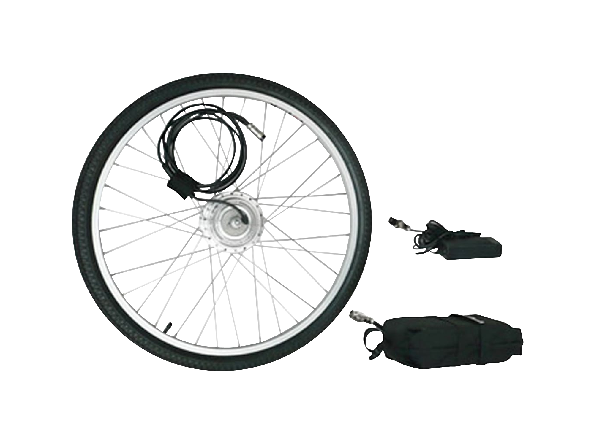

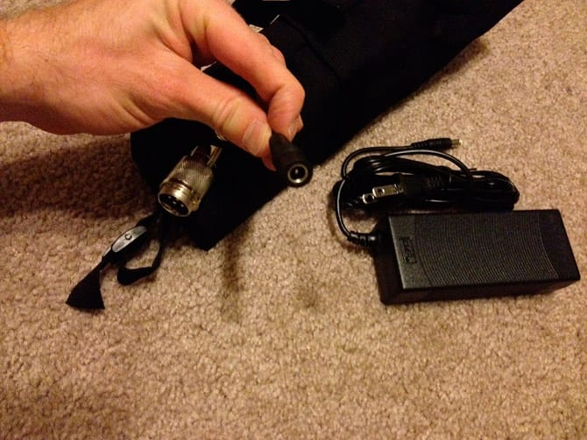

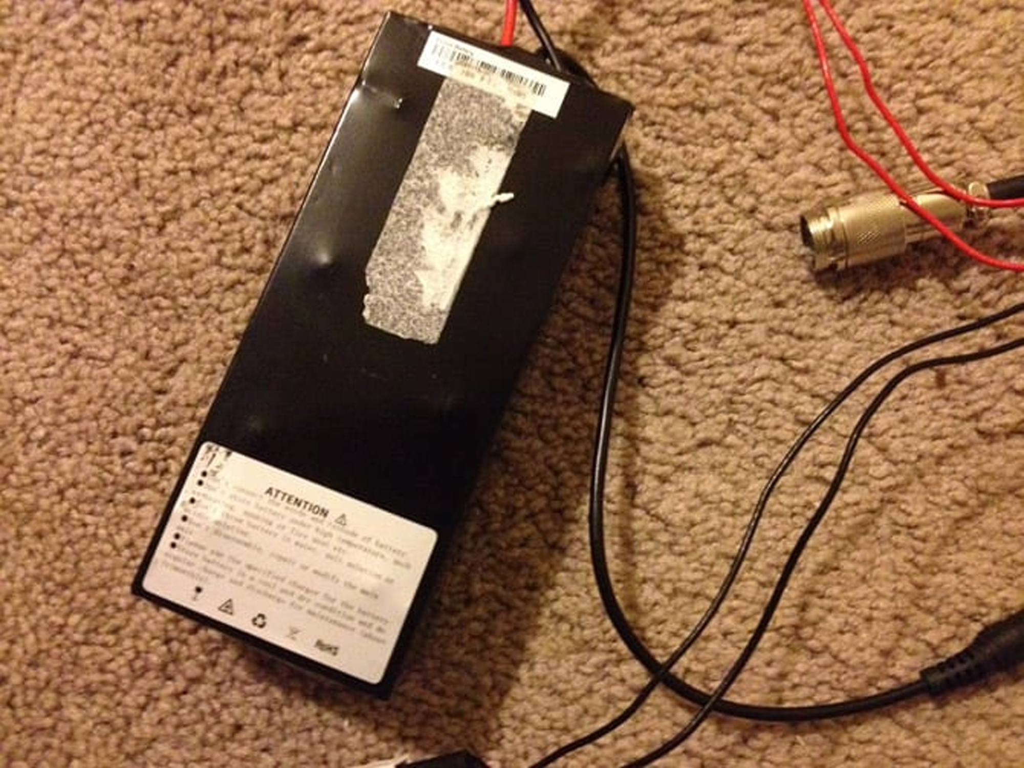

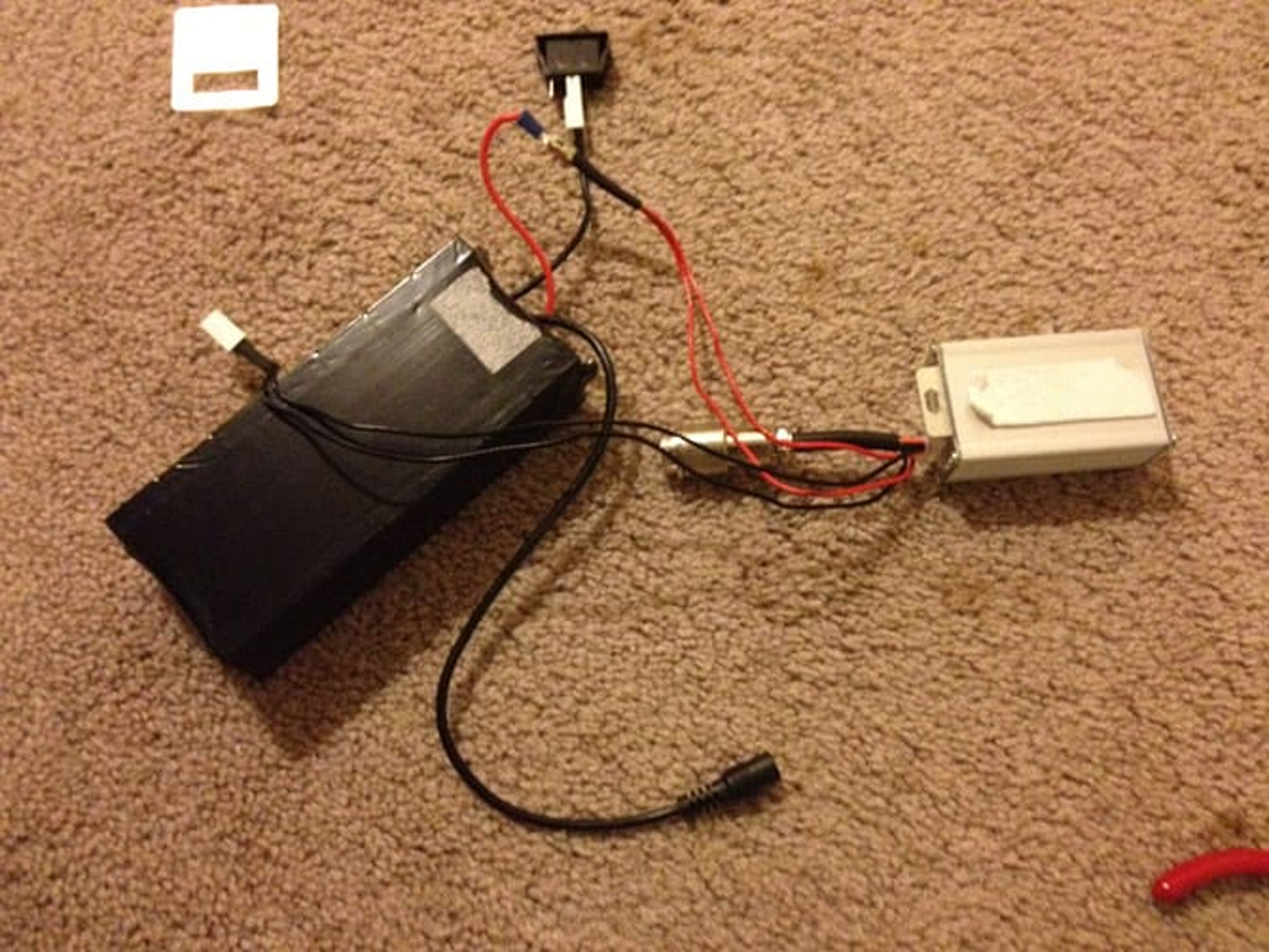

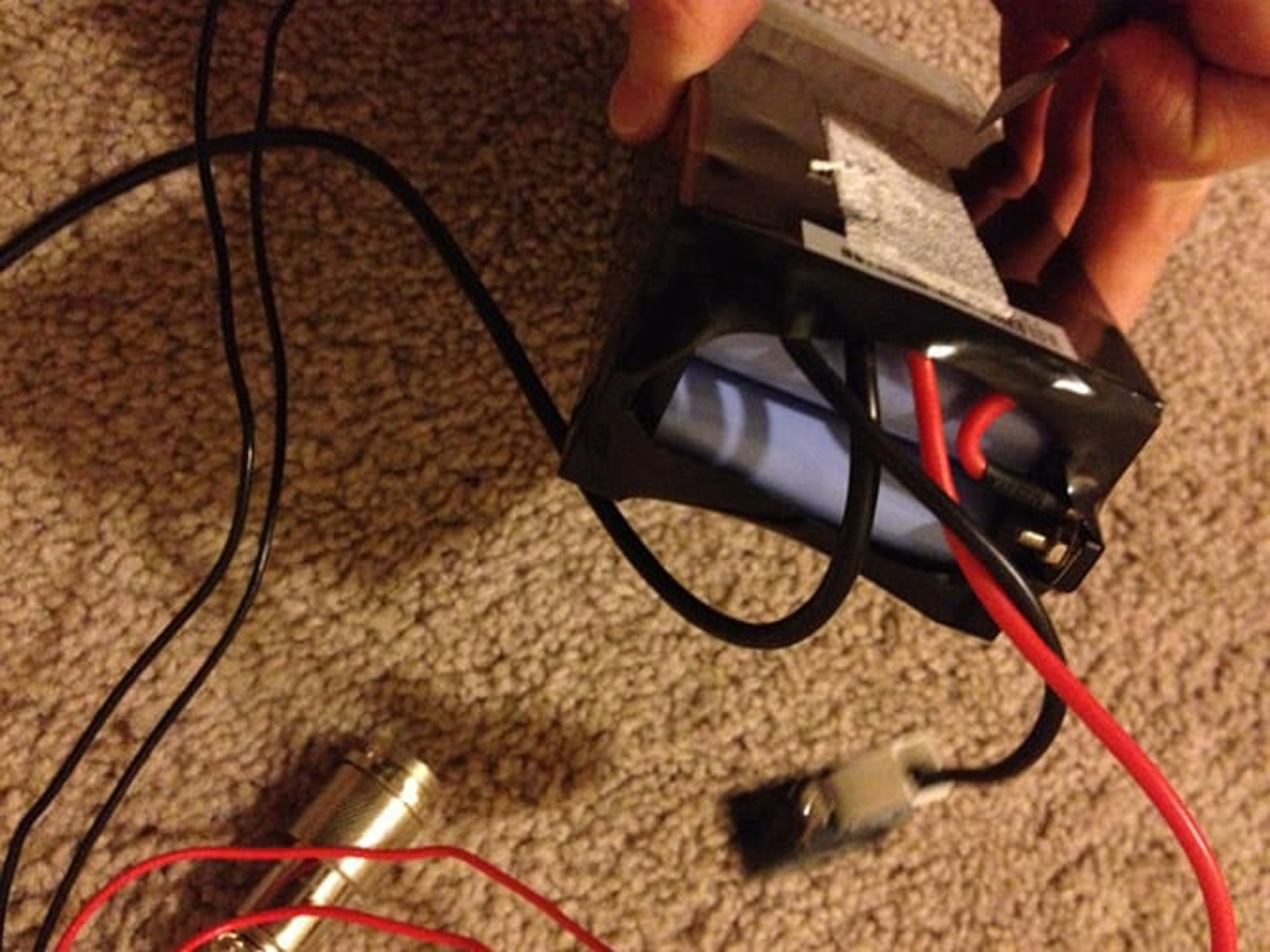

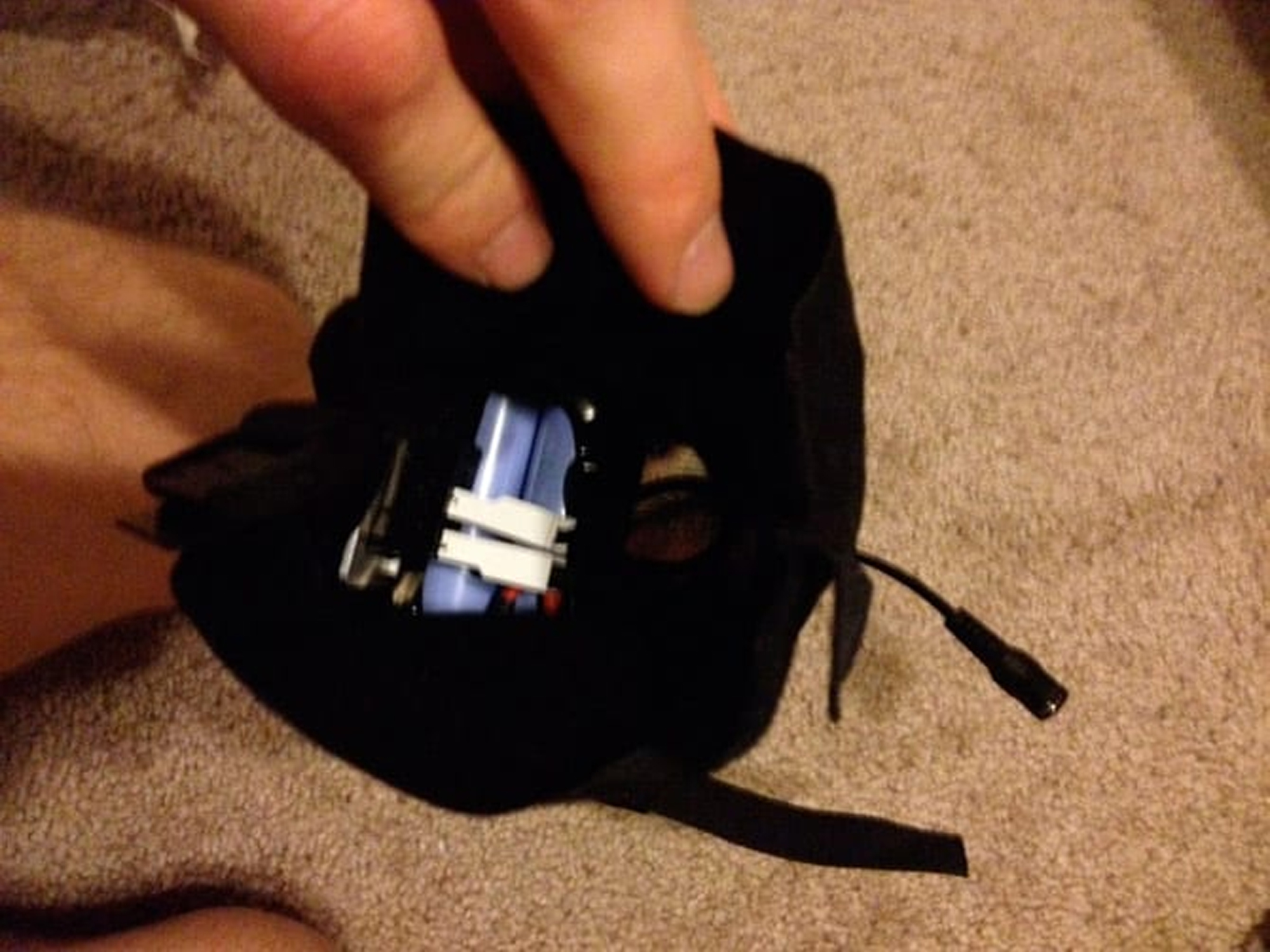

The battery pack is grouped together with the controller and battery management system in a little black bag. There are two wires protruding from the bag; one wire is for charging, the other connects to the bike for riding. The Lithium-ion batteries used in the Hill Topper are very similar to older laptop batteries and are fit into a brick configuration. The pack itself has straps that connect to your seat, rear rack or top tube. It’s a simple design that you can customize easily (as shown in the images and video above). I spent a lot of time trying to figure out how to cram my battery pack into a water bottle that could easily fit on the down tube but ultimately settled on a black canvas pouch instead because it looked better. I bought an adjustable Topeak Modula Java water bottle cage that could hold the canvas pouch and this worked great. I also considered the Salsa Anything Cage which could fit a much larger pouch but ultimately didn’t need the extra size. Another good option is the Battery Frame Bag from Leed, another ebike kit maker with very similar kits to the Hill Topper.

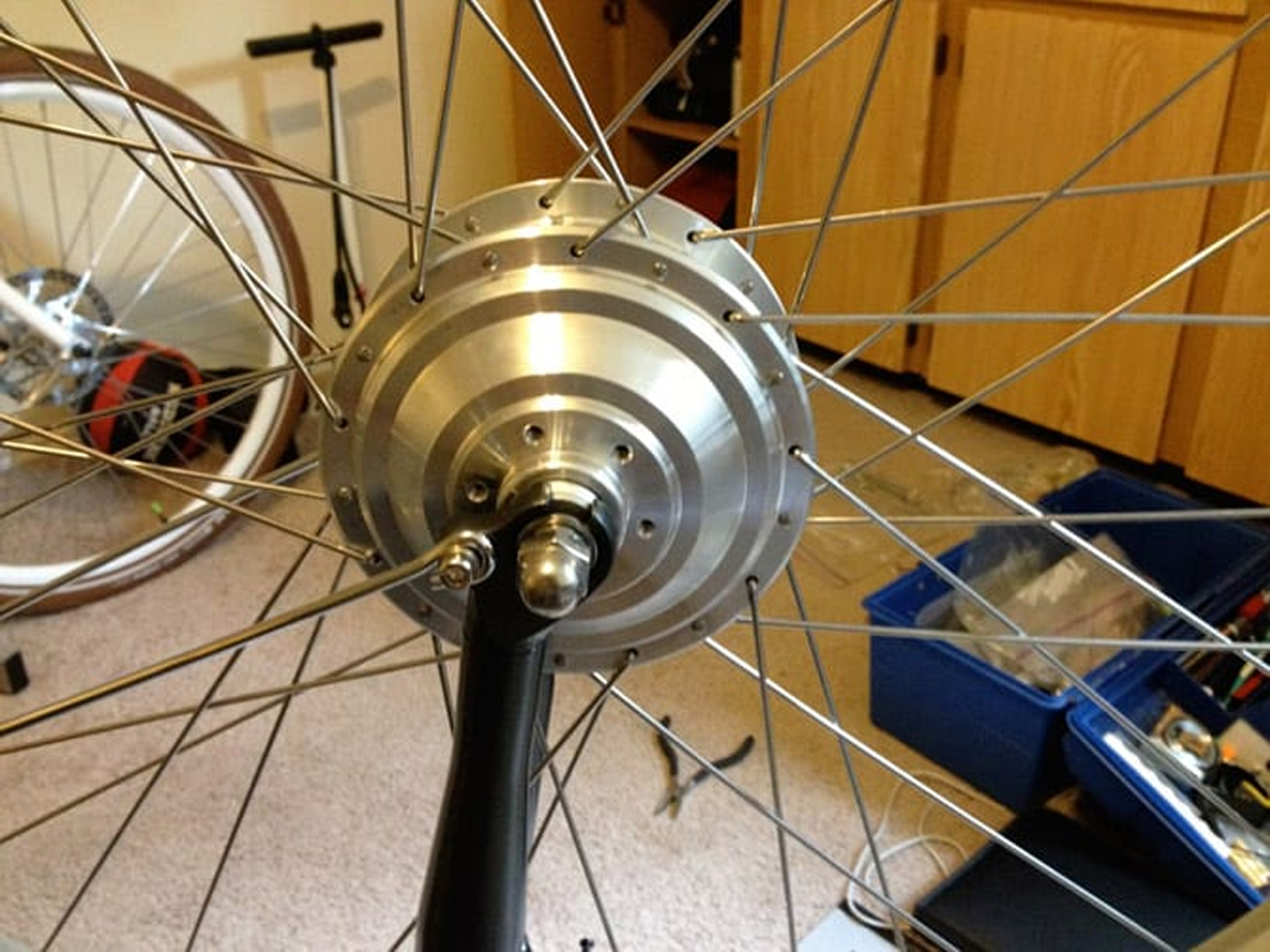

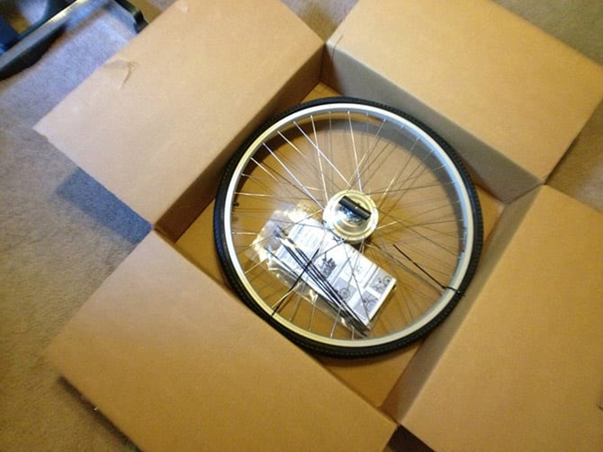

Before going too much further it’s very important to cover the hub motor and wheel itself. This is the core of the kit and is designed to easily swap out with your existing front wheel. Two important things to consider here… First, make sure your bike has a steel front fork or purchase one online to use instead of carbon or aluminum. You could take the risk and use a torque arm to lessen the impact on other fork materials but steel is recommended and it would be a bummer to break your bike and faceplant. The second important consideration is the width of your dropout notches. These need to be 7/16in (11mm) or you’ll have to file them down. I tried to use this kit with my both my Specialized Rockhopper mountain bike and Secteur road bike and they were too narrow at 5/16in (9mm). I ended up buying a Schwinn City 7 that worked great but required two extra washers to keep the hub from scraping the fork. Just look at the pictures here and the measurements provided, reach out if you have questions… it’s not a great feeling to get a kit and realize it might not work, or would require modification.
In summary, Clean republic has identified a lightweight minimal solution and packaged it into four kits by price, weight and range. This really speaks to the tinkerer inside of me that sees all of these very expensive full ebikes and wants to make one of my own. The front hub setup is a bit uncommon, but ultimately distributes the weight evenly across the frame which is nice. The battery pack and wires aren’t beautiful, but they get the job done and can be organized well enough with zip ties. The kit isn’t super strong but for what you’re paying it is very effective and on par with the standards in Europe that limit motors to 250 watts. Check that your bike will work then give one of these kits a try.

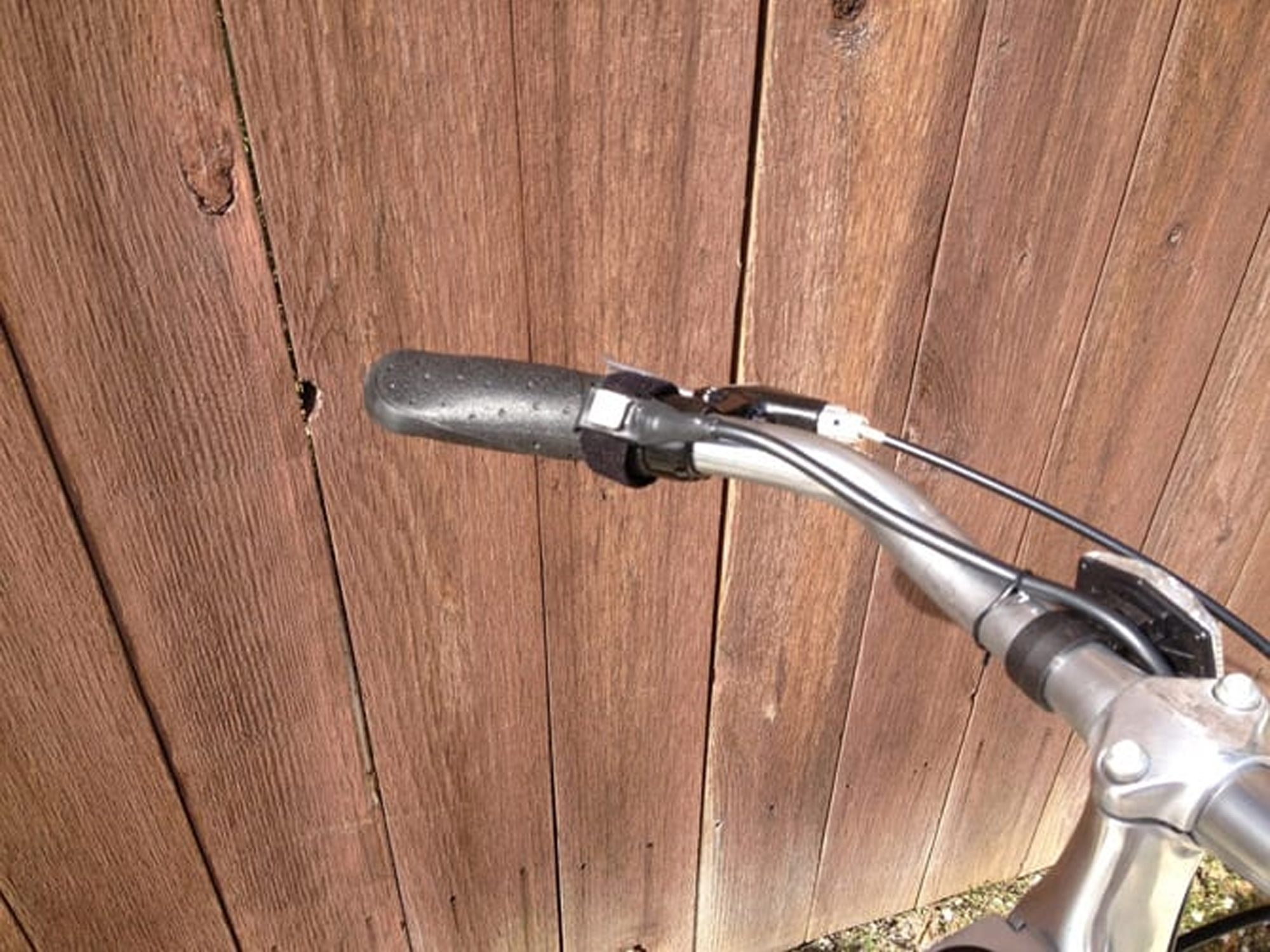

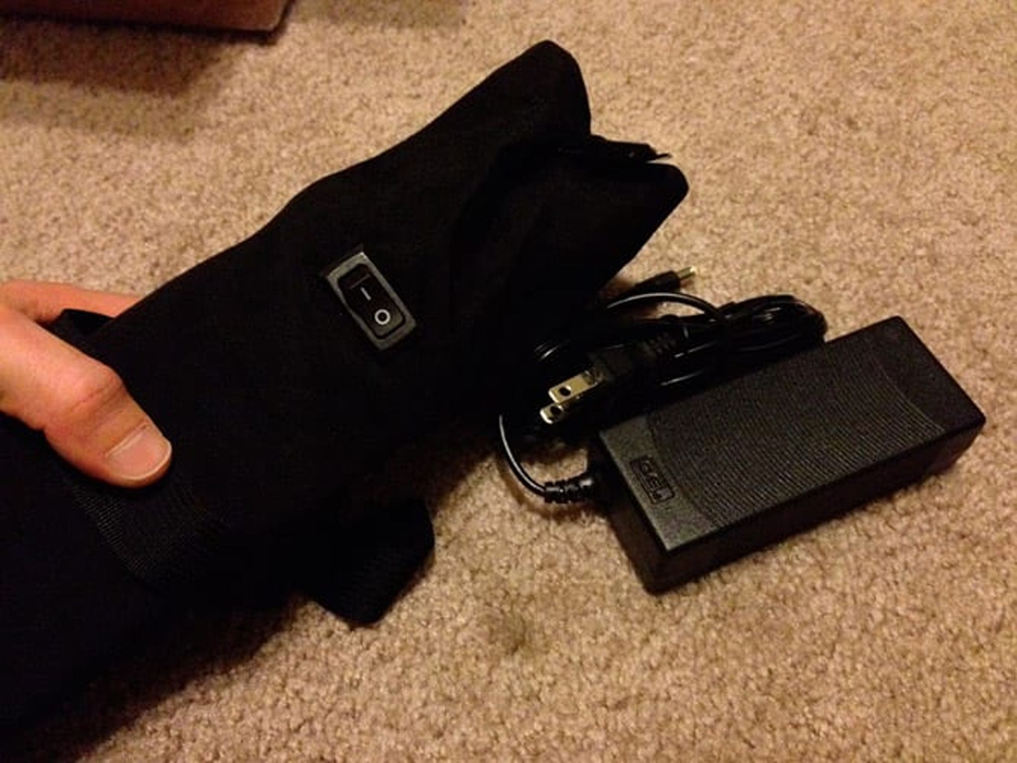

- The on/off button works well with drop bars or bar ends because it’s easy to position vs. many other kits that rely on plastic handlebar mounts
- The hub motor offers good torque and is lightweight, the wheel plus motor weighs just ~8lbs

- No throttle option or pedal assist, just an on/off button that mounts with velcro

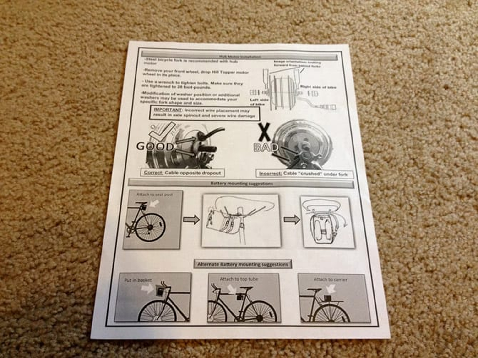

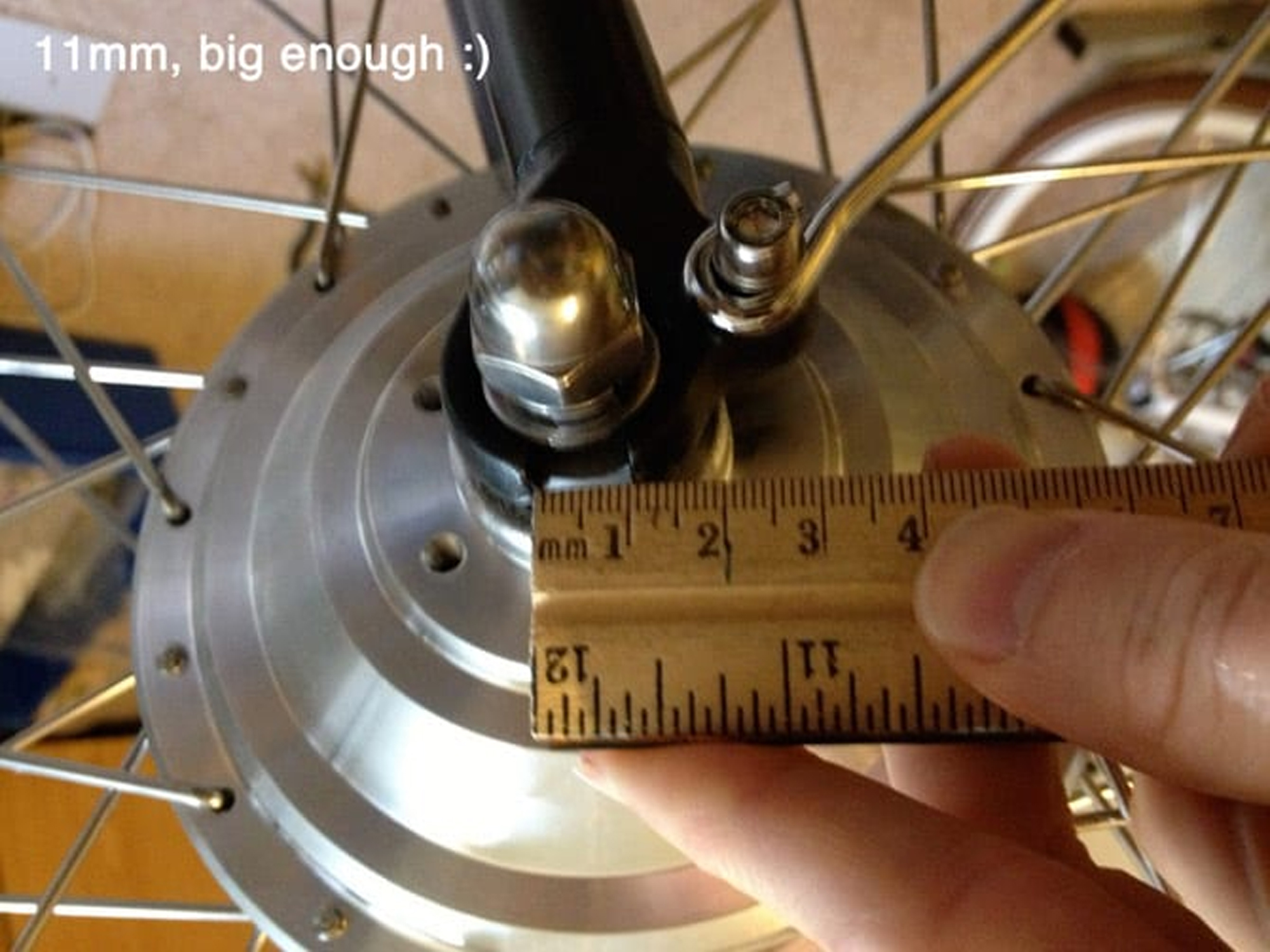

- The axle is pretty wide and may not work with your bike, check that your dropout notches are 11mm
- The kit may require some adjustments to work with your bike, depending on your fork you may have to get extra washers

- The wheel arrived in decent shape but needed to be trued after shipping, the spokes were just a bit off and I could hear my brake pads scraping on the uneven side of the rim

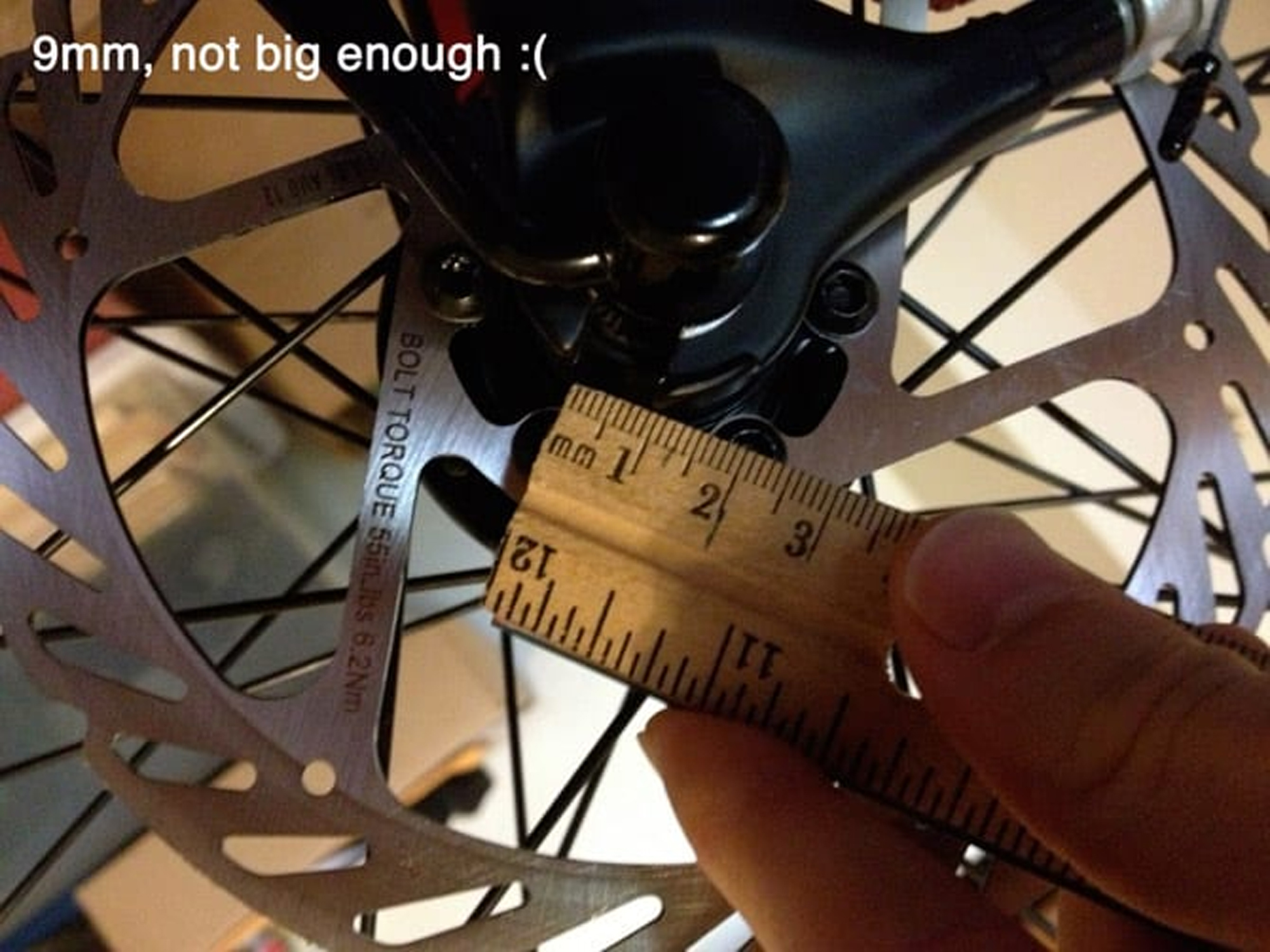

- The disc brake setup didn’t match the configuration of my road bike, it was too far out towards the side… required some washers and experimenting to get right

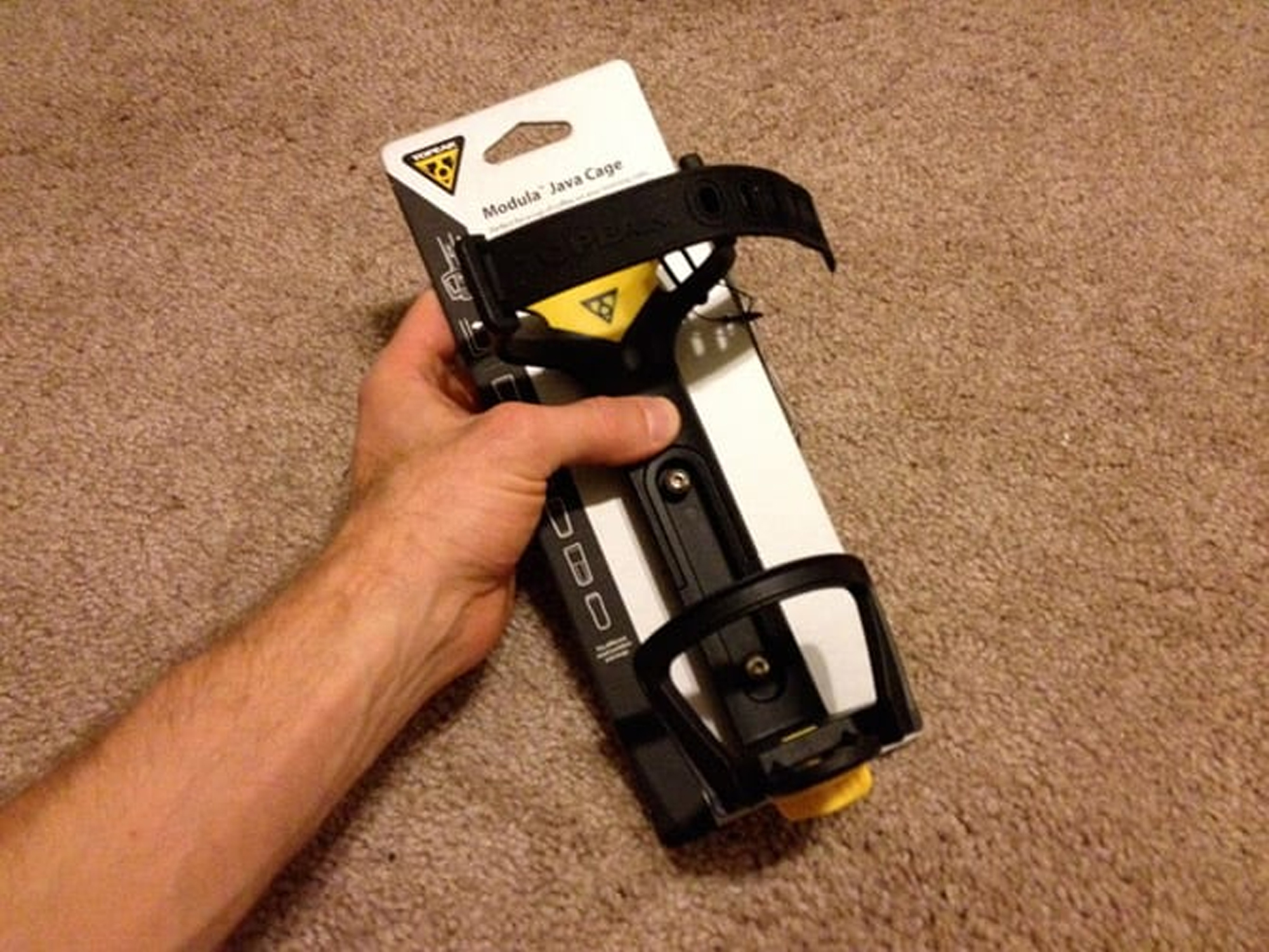

Nice complete video. What sort of bag did you uses for putting battery onto bottle cage? I like looks of your set up as opposed to on rear rack. Thanks Art
Court Rye says
Hi Arthur, great question. I tried a number of different racks, bottle enclosures and bags. I think the final canvas bag you see in the video is from Target. I believe it was designed to protect bottles of wine and had a fold-over velcro top.

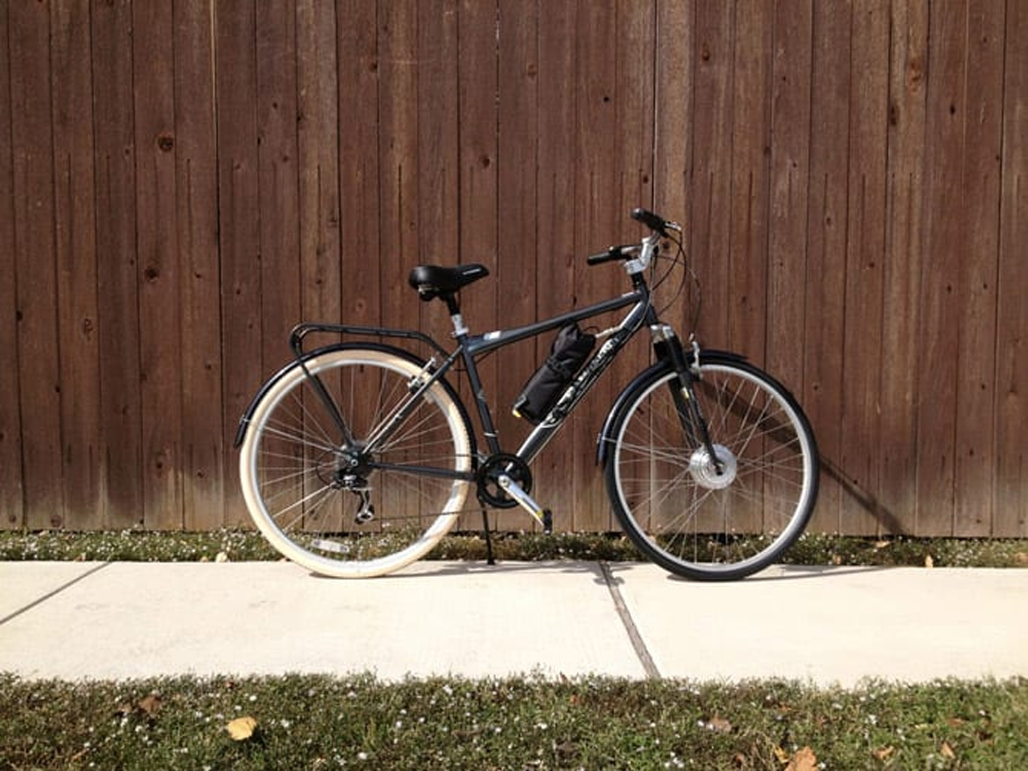

I just bought the exact same bike you used in your demo. I would like to keep the white tires that came with the Schwinn. How difficult is it to change the tire so it can go on the rim supplied by Hill Topper? Will it fit on the HillTopper rim? I will be commuting about 5 miles on city streets in Chicago which are very flat grade. Wanted to get the smaller Li-On battery to keep the weight down. I can recharge it at work for the ride home. I had the impression from your video that it definitely will pull you along on flat terrain. Great video by the way.
Court Rye says
Hi Garret! I’m pretty sure you can easily swap the tires so they match. Even though the rim and spoke patterns are not exactly the same I think it will still look great with matching tires. Changing the tires would be just like any normal bike and you can use tire levers to help, they are these plastic tools you use for leverage. Most bike shops carry them for ~$10.
I weigh about 131lbs and the bike had plenty of power and torque to move me on flat grades. Even if you’re heavier, I bet the system will work well. My preference was for the lighter weight battery pack and the benefit is that if you do run out of juice, the bike really isn’t that heavy to just pedal ;)
Your setup sounds good, let me know how it works out! Reach out with any other questions or thoughts!
Garret says
Thanks for such a quick reply! Thought it was such a funny coincidence that I bought the same bike prior to seeing your video. I understand that the HillTopper is a motor that allows the wheel to roll freely when under human pedal power only. I am about to pull the trigger on the exact motor you used in your video and battery. My remaining issue is: is it so noisy that I’d be better off with the other type of motor that makes it harder to pedal but is quieter running; and whether to go with a more powerful motor than the HillTopper.
Court Rye says
I think for the price, the Schwinn is a decent bike and it works well with the Hill Topper kit. The motor it uses is a 250 watt geared hub motor that’s built into the front wheel. There are two kinds of hub motors (geared and gearless) and gearless offers less torque but coasts smoother and is quieter. Since this is only a 250 watt having it be geared offers more torque and keeps it light weight. Now, it may wear out faster because those gears are rubbing and it won’t coast quite as smooth… but honestly it coasts just fine. I really like the kit shown in the video with the smaller lightweight pack. As long as you aren’t trying to have this thing pull you up large hills or if you weigh a lot and don’t plan to pedal along then you will be fine and it’s a good choice :)

Hi William! I can’t say for sure, it has been soooo long since I covered the Clean Republic kits and I wouldn’t want to lead you astray either way. Try emailing or calling them? They have a toll free number on their website here. Hope it works out for you! They seem like a good company and have been around for several years :)
Dave says
Hi William. I just dropped a 20 Mile Hill Topper kit into a Schwinn Tango folding bike (250W kit, 20″ wheel) a few days ago. I had no problem with the dropouts, it was a snug fit but the motor axle did drop in okay. I had a BIG problem fitting the motor housing itself between the arms of the front fork. My Tango has a very thick front fork and the arms of the fork barely taper at all as they approach the dropouts. The motor housing was rubbing against one arm and the bolts for the disc brake were striking the other arm. I got it working in the end but you might not be comfortable with the amount of filing I had to do (to the motor housing, the heads of the bolts and both arms of the front fork). There have been a few different series of the Tango folders, so your front forks might be different from mine. I would contact Clean Republic and send them a picture and measurements of your front fork (specifically the distance between the arms of the front fork just above the dropouts. Hope this helps.
Court Rye says
Thank you SO much Dave! Fitting the hub motor between my fork arms was also difficult, it rubbed at first on another bike I was testing which did not have suspension… more of a traditional light weight rigid fork with the tapering you describe, I think I tried using washers to spread the fork vs. filing the motor casing and screws. You described the issue and your solutions very well :)
