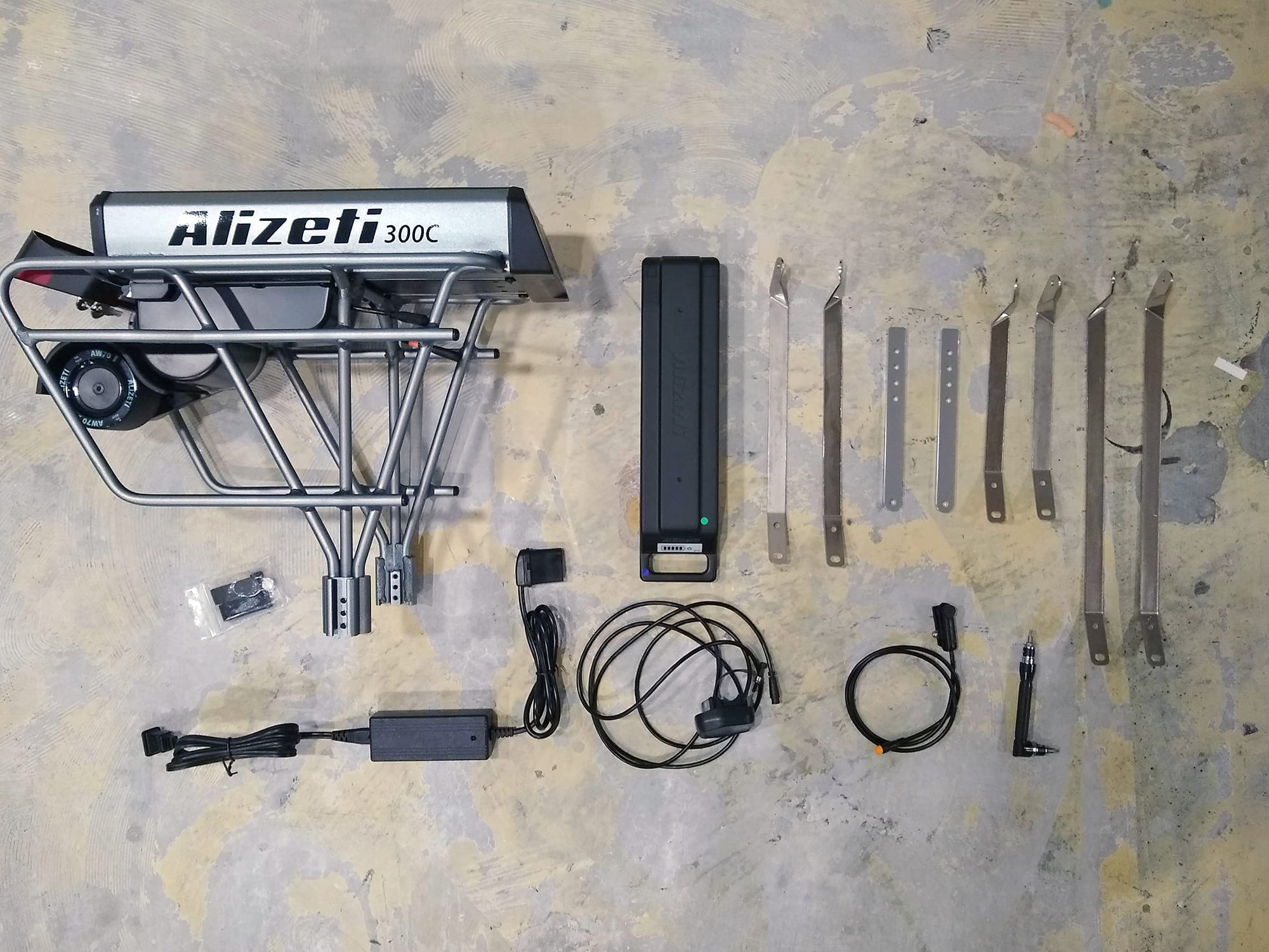

- A fully featured and complete friction-drive electric bicycle conversion kit that allows you take a conventional bike and upgrade it with an electrical system, is extremely versatile in application as well as options available to the consumer, applications range on any bicycle or tricycle that has a rear rack and drop out provisions

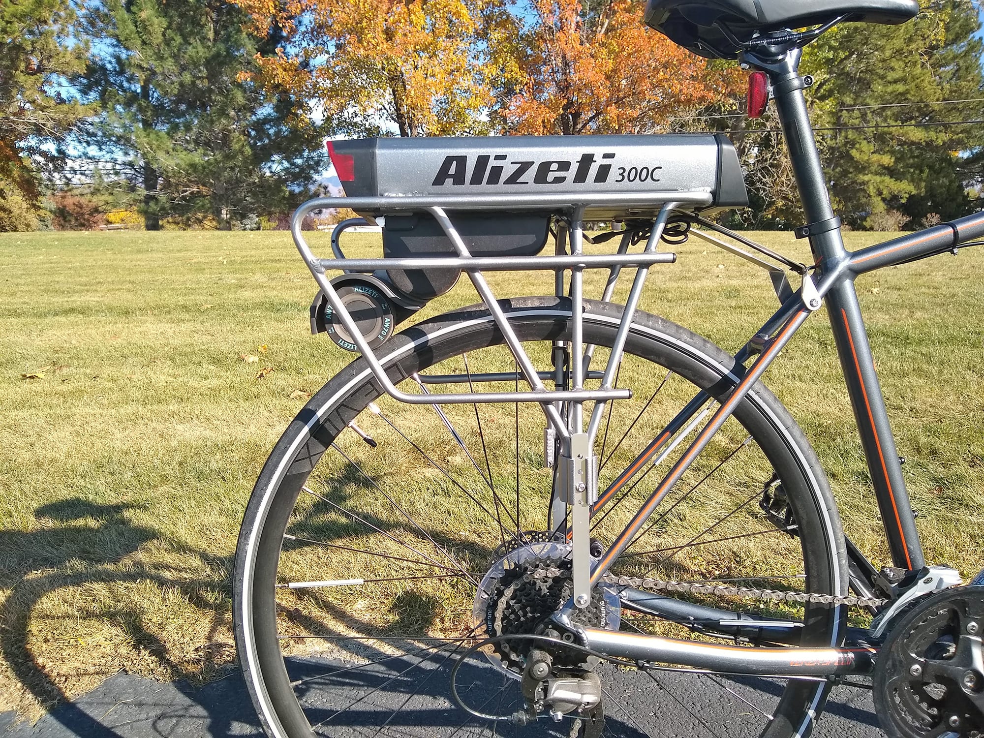

- The roller electronically engages by the arm extended from it by pushing up or down on the rear tire, this system can also lift it entirely so it has no drag for regular pedaling or if the battery is dead, this is a great feature if you want to walk the bike along without the friction

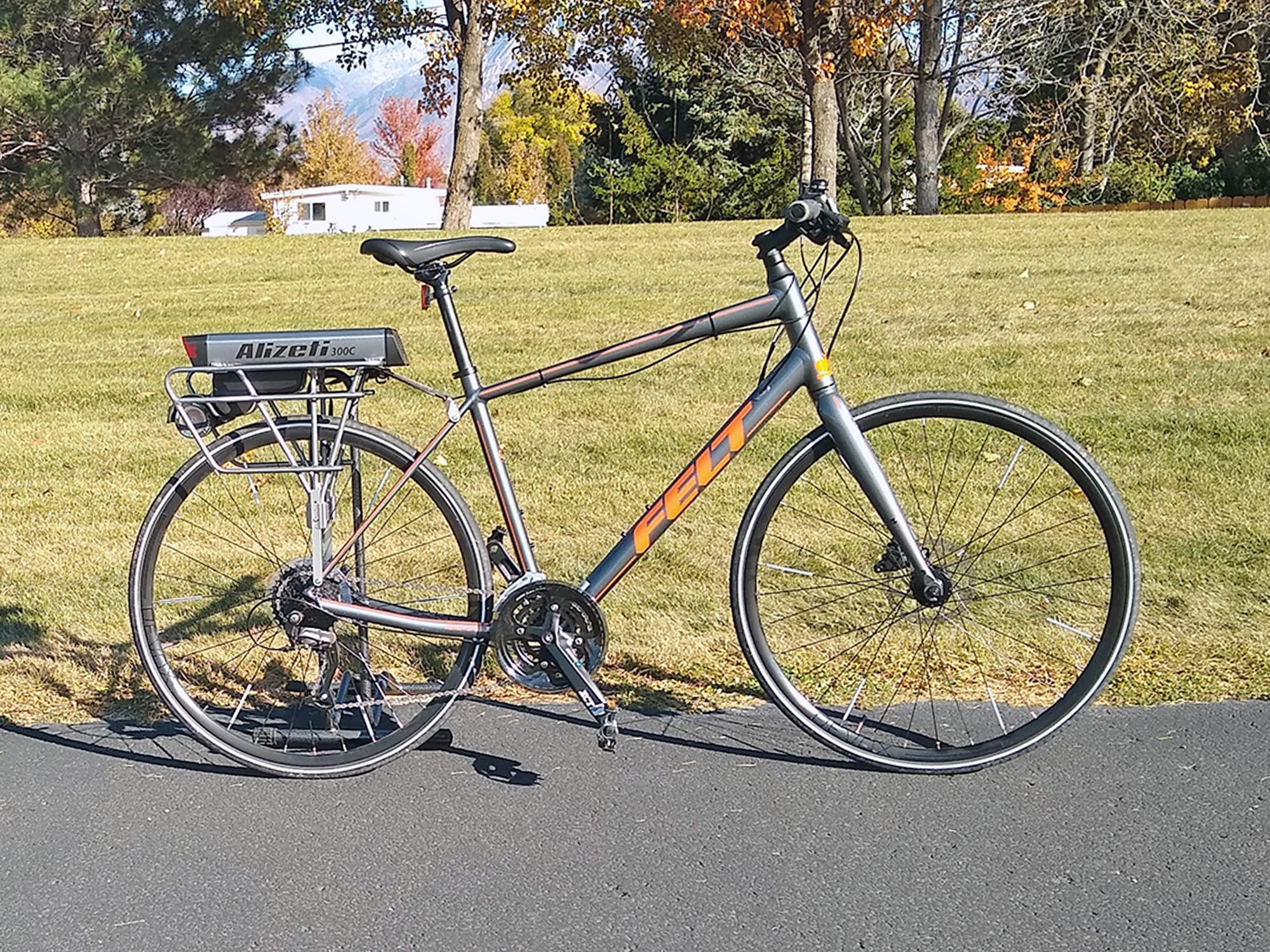

- For the review, I placed it on my 700c tire sized bike, and it should be applicable on most any common wheel sizes, this is great for versatility and getting the application on more bikes

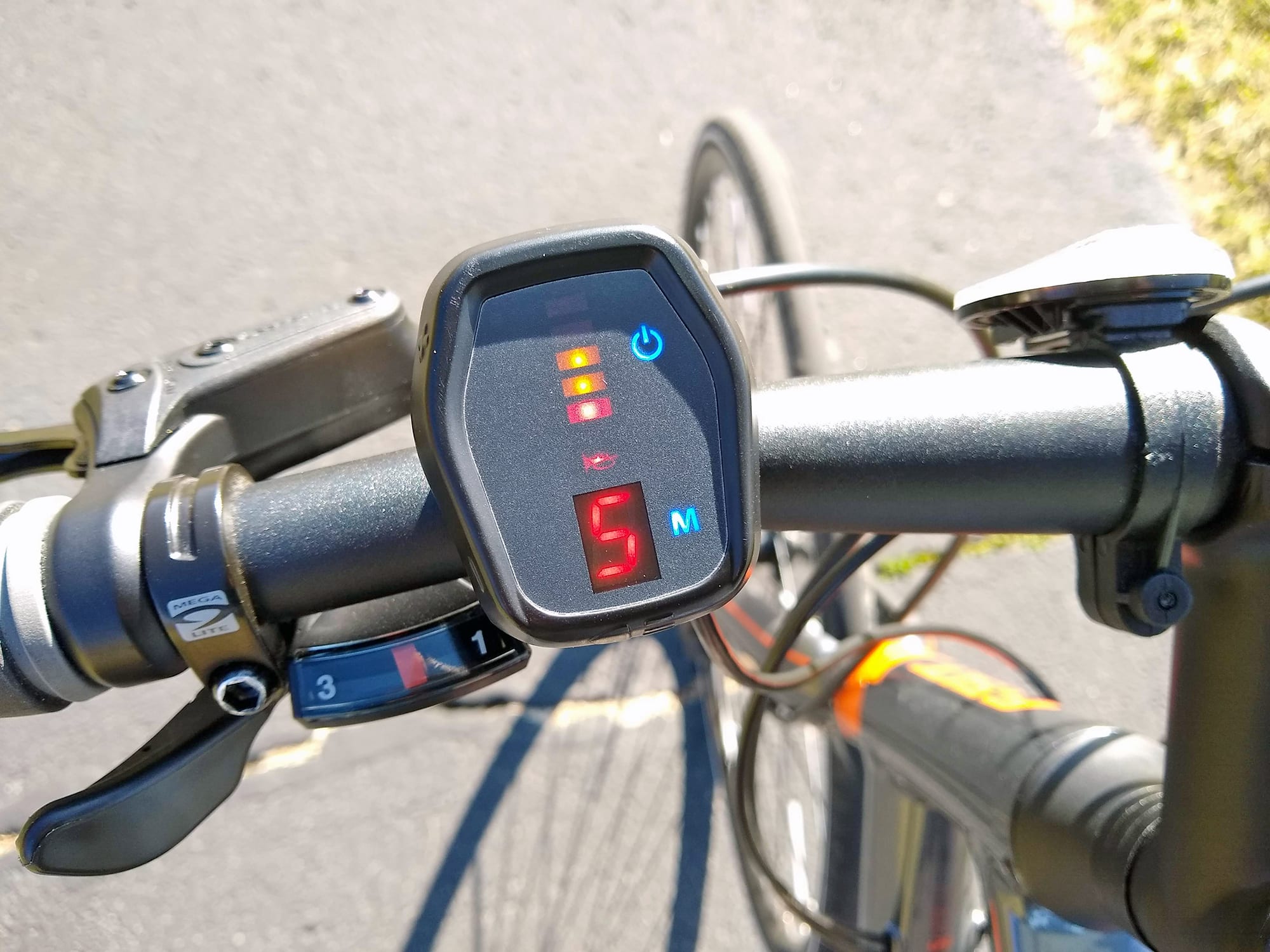

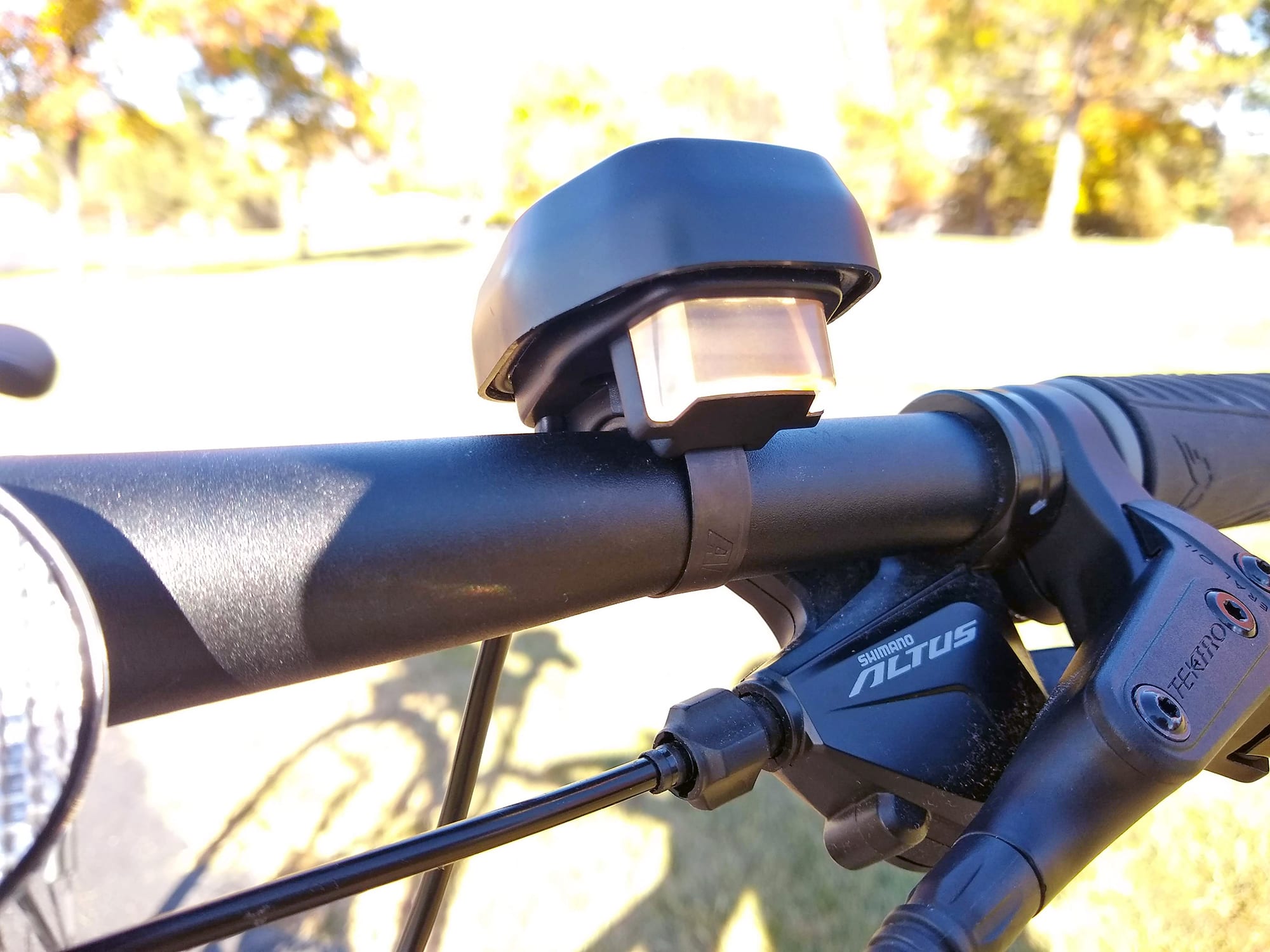

- This has an interesting user interface, the display is a small medallion type of surface where the border acts as buttons, I thought it was cool and easy to use, it shows 5 LEDs that correspond to your battery level, it also has a little letter display that will tell you what kind of modes you are in
- Some of the modes include L for lock mode, this presses the motor hard onto the tire with no electrical assist so that it drags heavily, this makes it very difficult to pedal or push, if they are able to push the bike a few rotations of the pedal, the speaker system will sound a loud alarm that is capable of going on and on for weeks with a full battery
- If you hold the down button it puts it into F mode for regen, this allows you to reproduce energy based on the friction from the motor, this does slow you down quite a bit however, and I am not sure how much it is generating, but it is great for hills and it is nice that you can change it on the fly

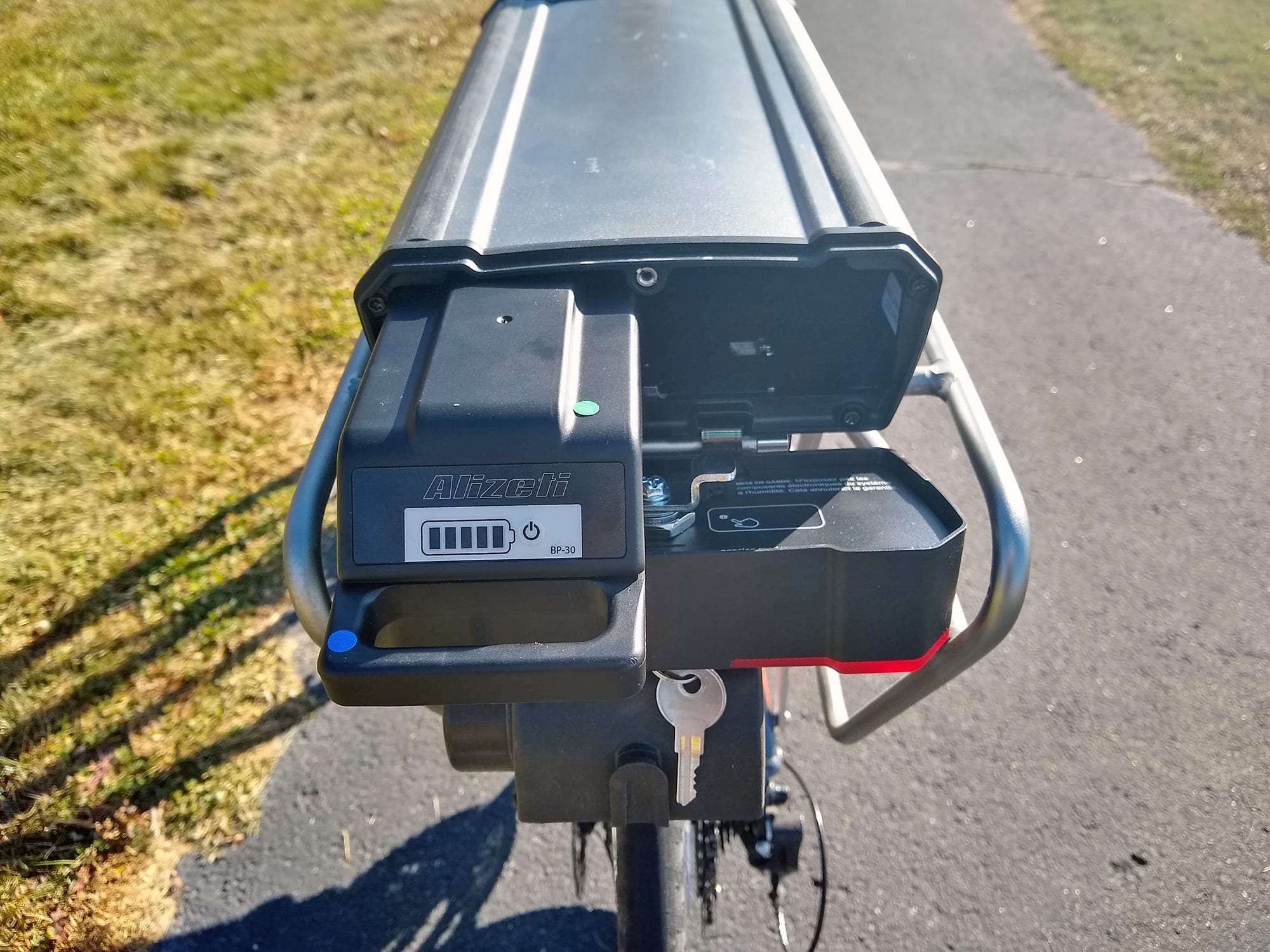

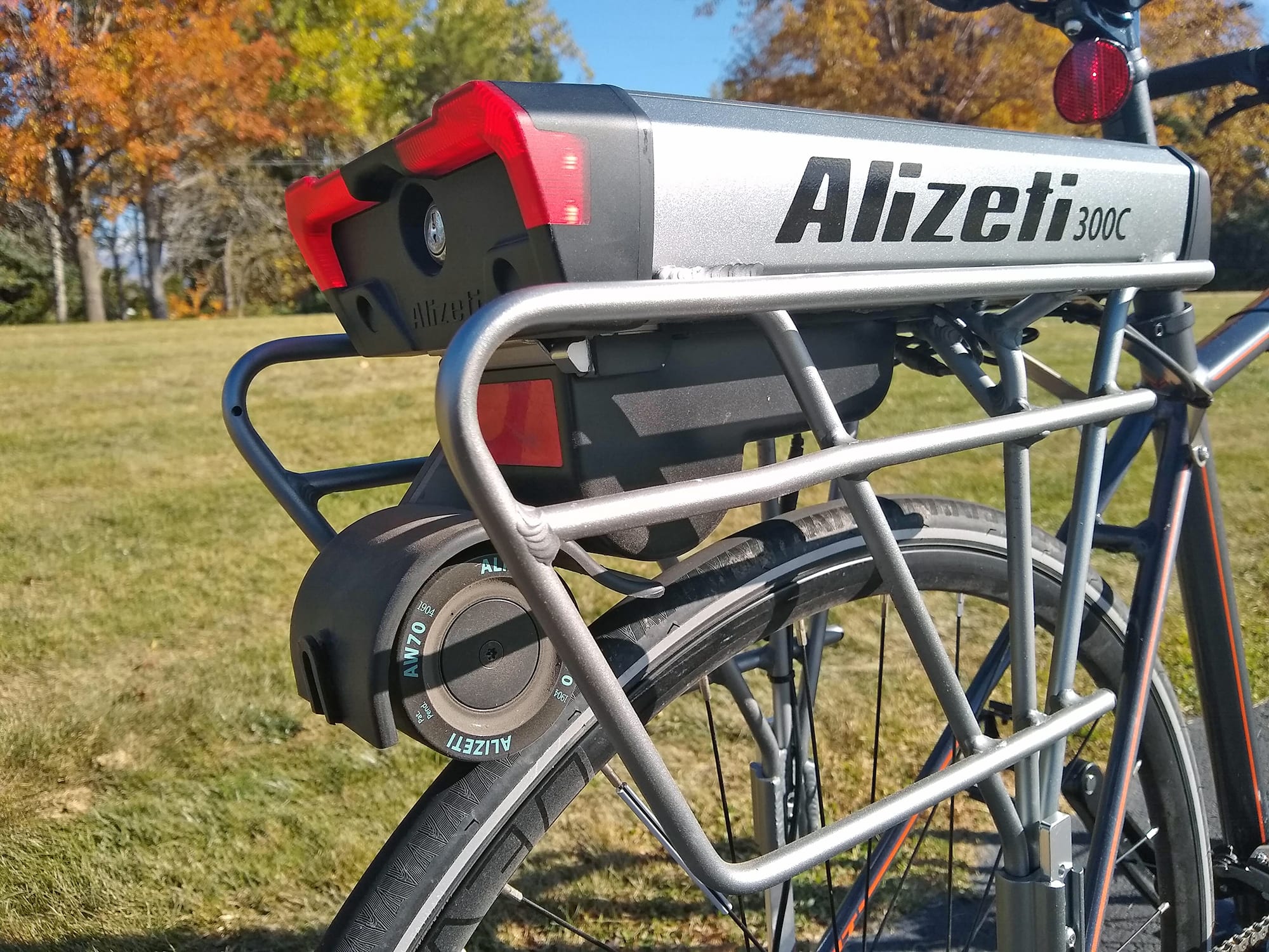

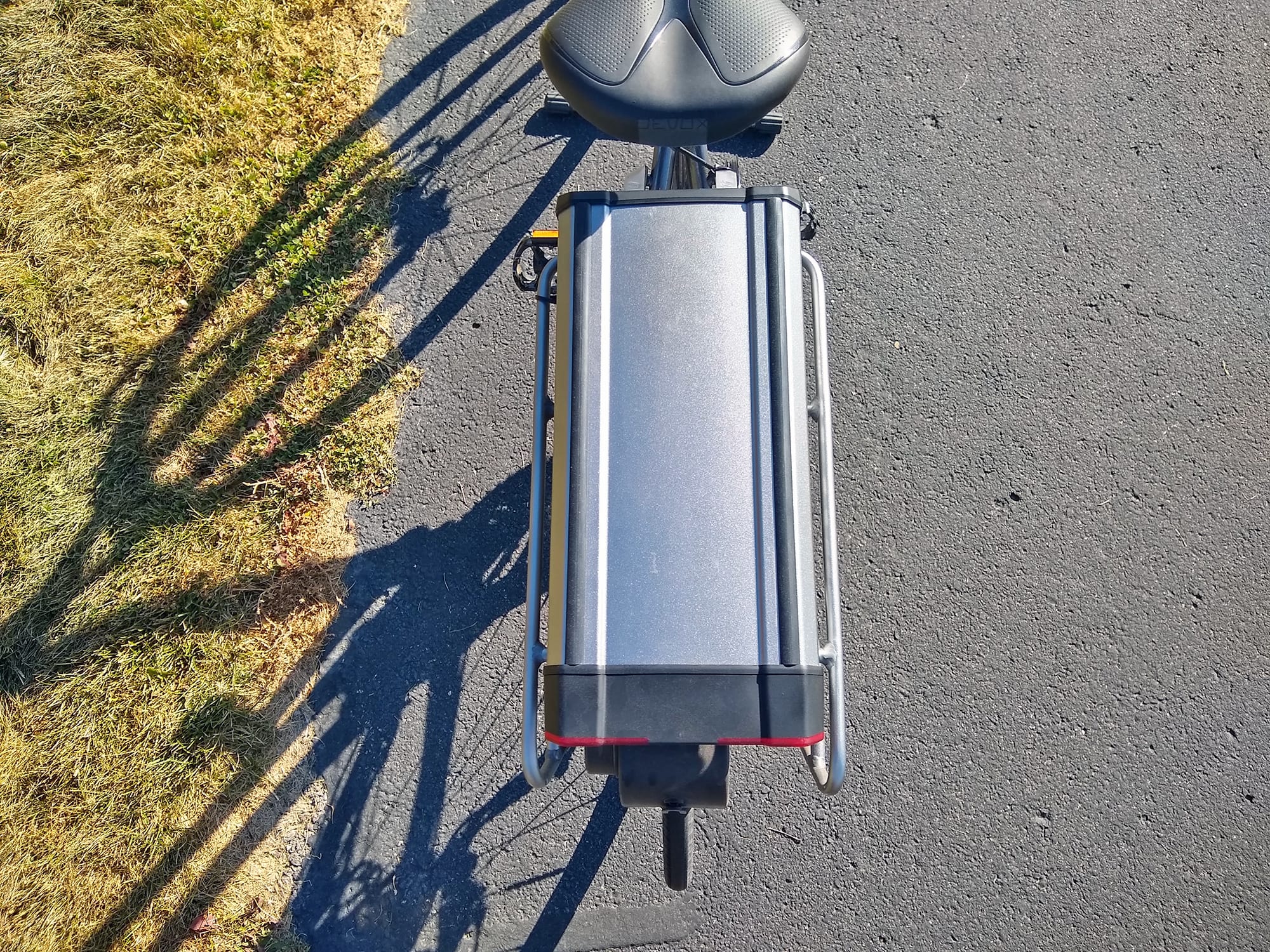

- The included battery is a 24v 11.6ah, that is a bit smaller in voltage for what we are used to seeing on pre-made ebikes, but the application works well here since all it is powering is the friction arm, a few different LEDs and a speaker

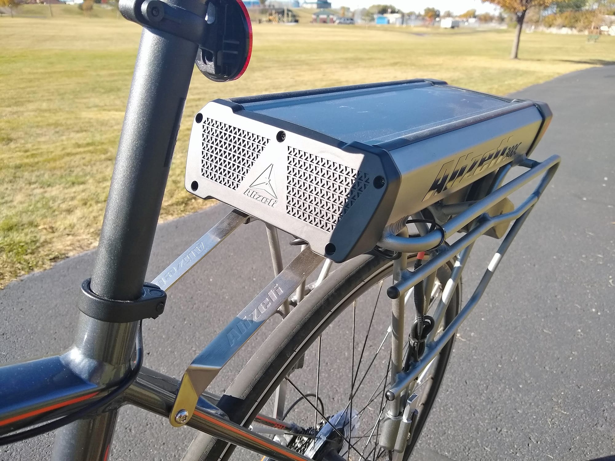

- I love that the battery is surrounded by this metal casing, it is also secured via lock and key, so there is a lot of piece of mind here, the battery slides in and out along this tray and has a second slot for up to two batteries to extend the range and make this a dual battery setup
- Charging is done with a small 2amp charger so that slower charge will help the battery life, to really care for this and other lithium-ion packs, I have heard that storing in a cool dry location vs. extreme heat or cold will extend the life and try to keep it about 50% full when not using for long periods so you won’t stress the cells, try not to let it run down to zero, because that’s really hard on the cell chemistry
- If you look closely, you can see a bit of a mesh grille on the battery housing in the rear facing the the front of the bike, this is a speaker system that will indicate an audible chime when you turn it on or off as a good indicator of whether the system is functioning or not, this also operates a horn which I found nice and loud, pretty handy, especially if your current conversion prospect doesn’t have a bell

- Going along with that, you also need seat stay provisions for mounting as well as a drop out (the drop out is a must) area, if not this kit will not work, you could maybe get a collar adapter for the seat stay mounting, but there is nothing you can do if you do not have a drop out section

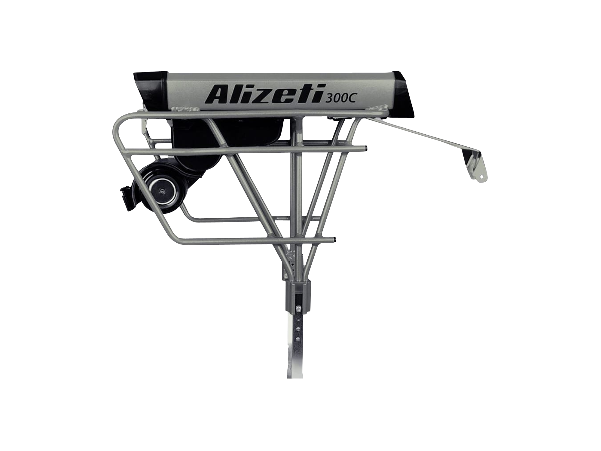

- The way the battery and system mount on the back make it look like a rear rack, but it is the battery housing, I would hesitate to treat this like a rack and put large weight on there, most racks are rated for 55lbs, and I imagine if you were to tax this with that kind of weight, it could really harm the system
- The display is kind of cool, but there is no speedometer at all to tell how fast you’re going, I have tested and ridden many bikes in my carrier and I would say that if I had to guess, the top speed on this kit is around 20mph, but keep in mind it will not tell you

The rear rack can support the additional weight. It has been designed with special channels as attachment points under the rubber strips on the top of the unit. Side bags can also be added to the rack as it has been designed to accommodate side bags and extra weight.
It is also true that the controller doesn’t have any indication for speed, but the FREE Alizeti mobile app acts as a cycling computer and can display all the important information required by the rider. The app also allows wireless software updates to be done via the optional Bluetooth module so any improvement can be implemented easily.
