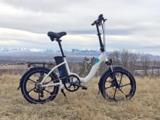

Total Weight:
61.3 lbs (27.8 kg)
Battery Weight:
9.2 lbs (4.17 kg)
Motor Weight:
8.5 lbs (3.85 kg)
Frame Material:
6061 Aluminum Alloy
Frame Sizes:
15 in (38.1 cm)Geometry Measurements:
15" Seat Tube, 21.5" Reach, 14.5" or 22.5" Stand Over Height, 65.5" Length
Frame Types:
Step-Thru, Mid-Step, Folding
Frame Colors:
Gloss White with Blue Accents, Matte Black with Blue Accents, Gloss White with Orange Accents, Matte Black with Orange Accents

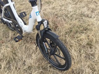

Frame Fork Details:
RST Carve Suspension with Preload Adjustment, 60 mm Travel, 9 mm Axle with Nuts
Frame Rear Details:
11 mm Axle with Nuts
Attachment Points:
Rear Rack Bosses, Fender Bosses

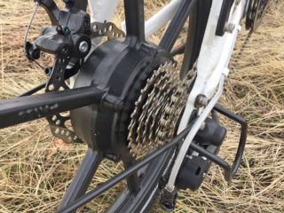

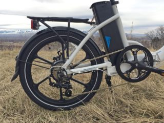

Gearing Details:
7
Speed 1x7 Shimano Tourney, 11-28TShifter Details:
Shimano RevoShift Grip Twist on Right
Cranks:
Prowheel SOLID, 165 mm Length, 52T Chainring with Aluminum Alloy Guide
Pedals:
Wellgo K20410, Folding Plastic Platform
Headset:
Neco 1 1/8"
Stem:
Aluminum Alloy, Folding with QR Telescoping Height (10" to 13")
Handlebar:
Low-Rise, 24" Length, Aluminum Alloy

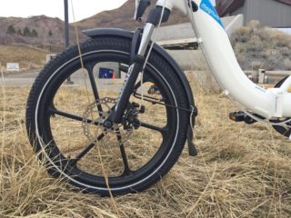

Brake Details:
Tektro Mechanical Disc with 160 mm Rotors, Tektro Levers with Rubberized Edge and Motor Inhibitor
Grips:
Ergonomic Stitched

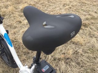

Saddle:
Selle Royal Look In Gel, Oversized with Rubber Bumpers
Seat Post:
Aluminum Alloy, Basic Suspension, Flip-Up Saddle Clamp
Seat Post Length:
350 mm
Seat Post Diameter:
27.2 mm
Rims:
Solid Aluminum Alloy, Black
Spokes:
Cast Radial Support Arms
Tire Brand:
CST, 20" x 2.125"
Wheel Sizes:
20 in (50.8cm)Tire Details:
Reflective Sidewall Stripes, 40-65 PSI, Nylon
Tube Details:
Schrader Valve

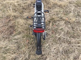

Accessories:
Flick Bell, Rear Rack with Pannier Blockers and Spring Latch 25 kg Max Weight (55 lbs), Single Side Adjustable Length Kickstand, Metal Derailleur Guard, Aluminum Alloy Fenders with Mud Flaps, Independent Spanninga GaLeo Headlight (2 AA Batteries), Independent Spanninga Back Light (2 AA Batteries), Support Bar on Bottom Bracket
Other:

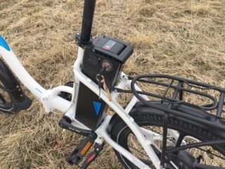

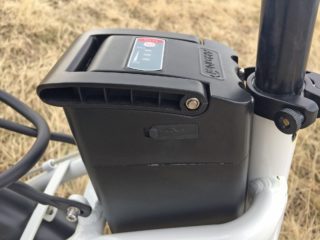

Locking Removable Battery Pack, 9 Mosfet 14 Amp Current Controller, 1.5 lb 2 Amp Charger, Max Weight Rated at 240 lbs

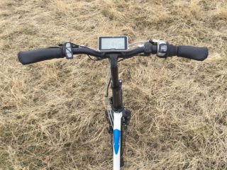

4 years agoI went and bought one of these, and it’s been very nice- one thing I wish they had was a manual that reflected the actual bike’s screen, which is not at all what they show in the manual. I’m trying to figure it out as I go… it appears that the 20-inch wheels may be limited to a top speed of 20 miles an hour, but I’m not sure what that screen is. I think it’s the 4th one… it shows 2 numbers, one of which seems to change the bike’s top pedaling speed, the other of which I’m not sure about. Possibly wheel size? Scratching my head here.
Aside from the instruction manual not helping at all with learning the settings, it’s a good bike. The rear wheel’s not easy to remove if you get a flat there, and the tire takes patience to get back on afterward. As far as flats go, the folding is a godsend if you need to call someone to come pick you up and get out of the rainy roadside.
But on the positive side, the range I’m getting out of it is at LEAST 40 miles with pedal assist, and around 2 bars of battery left after a day of riding. It’s been handy for small grocery runs and has given me the freedom to commute locally, which is a good thing for someone without a car and no public transport in town.
20 MPH has been a good, serviceable top speed for me. It’d be nice to get it a little faster as advertised, but I’m fine with this.
I don’t find myself using the throttle for more than short bursts, at times when I want to get off the line quickly such as crossing roads or starting on steep slopes.
Pedal assist 2-4 are most comfortable for me in terms of just riding around, 1 is good for starting up or just taking my time, and 5-6 are nice and effortless ways to get somewhere fast.
I’ve used the USB charging from the battery, and my Samsung Note 4 tells me this battery is only capable of slow charging- turns out to be maybe half the speed of its normal charger, if that. But getting 40% of my phone’s battery recharged did not seem to tax or noticeably drain the Magnum’s battery at all, so for topping off electronics or charging stuff like a Kindle as I ride to my favorite reading spot is perfectly doable.
On another note, no reading or texting on-bike: even without doing these things I managed to WHUMP! myself into a signpost and a parked car in the month I’ve had it. The bike and I were both fine after each incident, aside from the usual shattered-dignity bit. :)
I tend to ride my bike in Eco mode (Settings screen 5- hold Set, press Set until you reach screen 5, and press minus to toggle between the three modes), just because I want this battery to last, and because so far I can’t tell a difference between that and Normal in terms of acceleration or top speed. Still trying to figure this one out. I’m not sure how Power mode differs either.
It’s a fun bike, and is turning out to be pretty practical whenever it’s not outright raining (in which case no bike of mine is going outside for long.) I’ve even gotten some interested questions from strangers at the bike rack. It’s weird how much more expensive people around me tend to think it is, and how much slower and shorter-range. It feels good to give ’em a pleasant surprise with “Yes, it’s electric. …20 miles an hour, 40+ miles range. …Yes, it folds. …$2000 including tax.”
