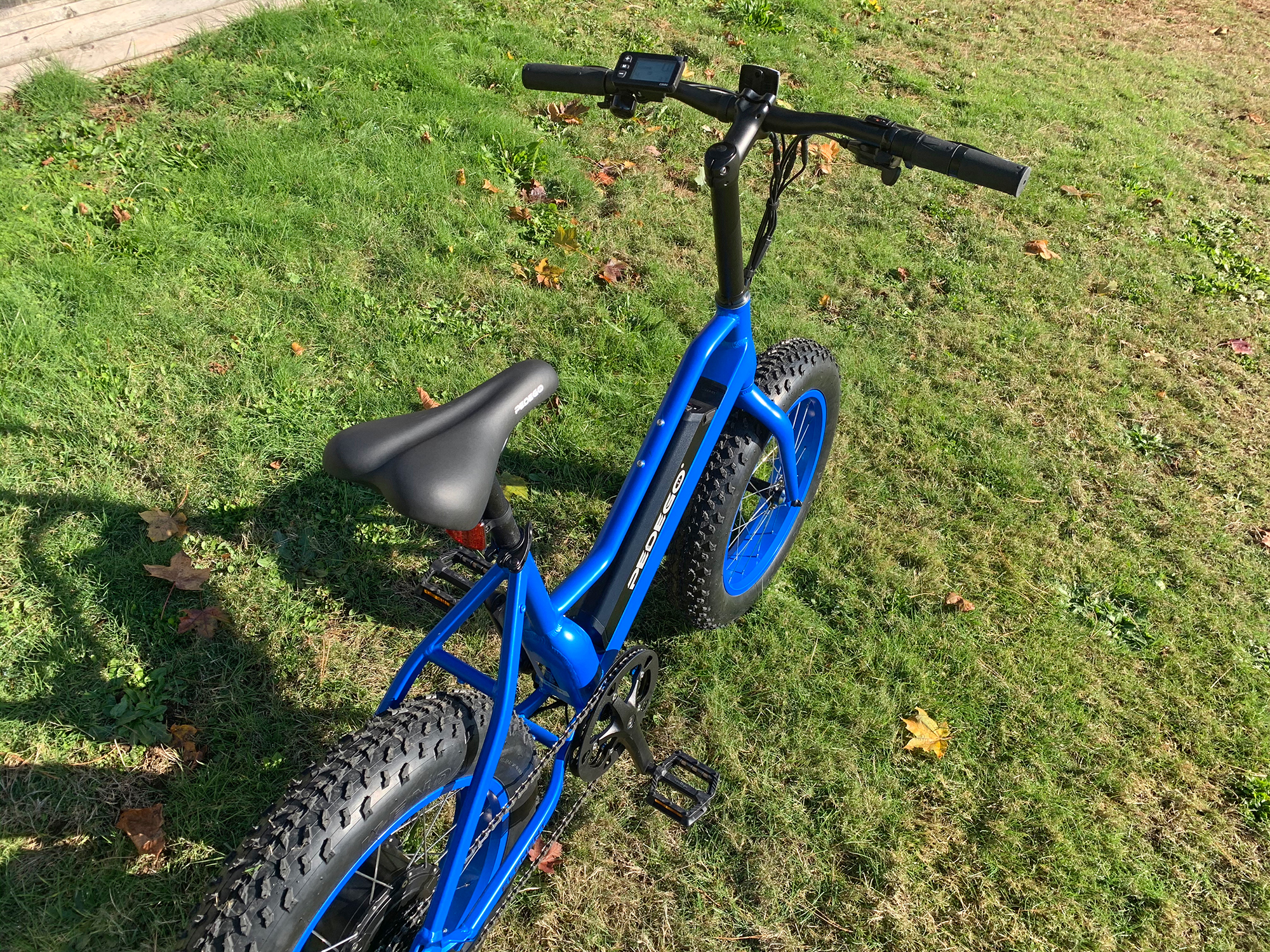

- The touch points are pretty good. The saddle, wide platform pedals, and flat grips all work well together. Despite not having suspension or ergonomic grips, the bike is comfortable because of the high volume 4″ wide tires.

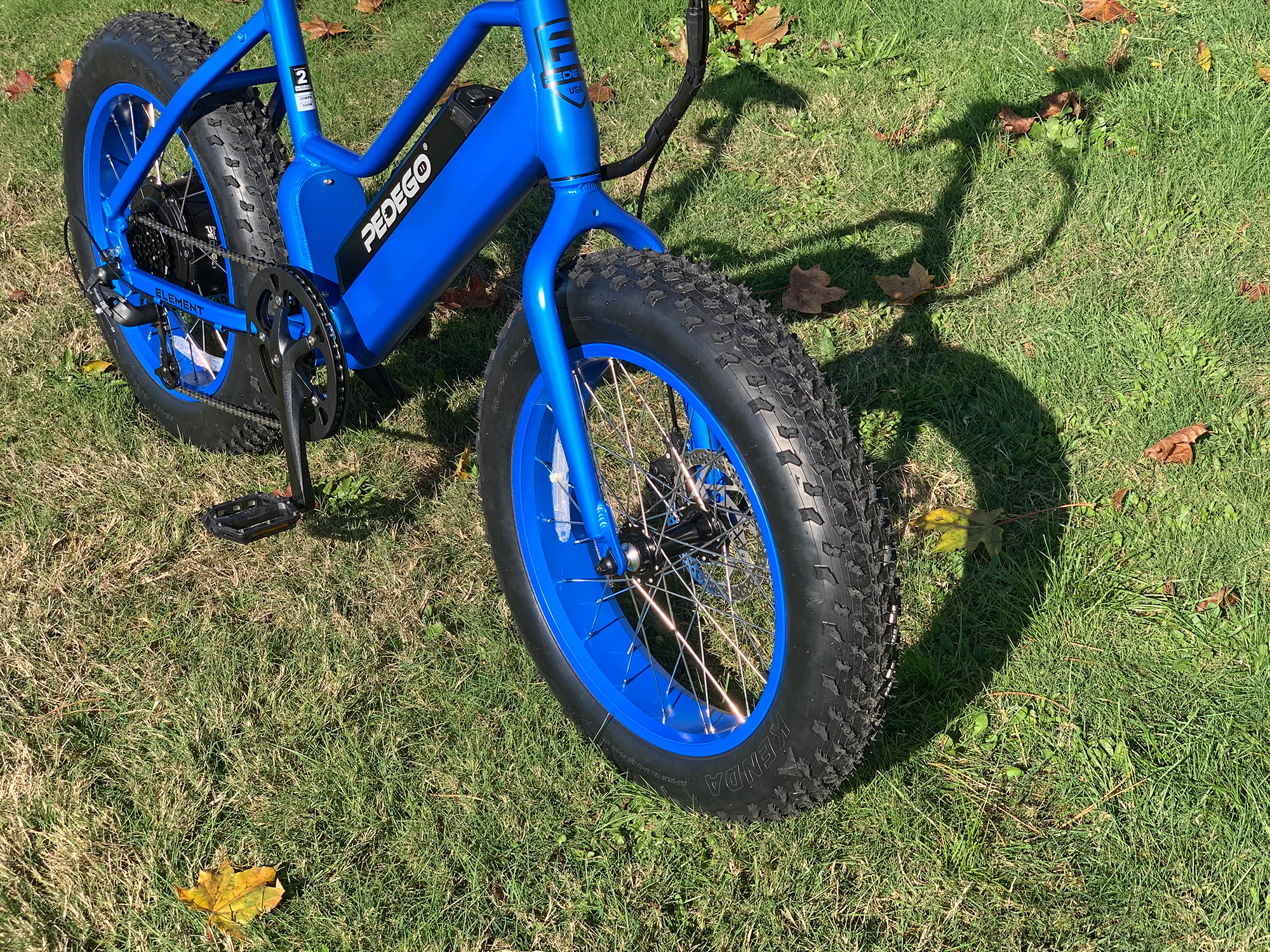

- Perhaps most owners will use the Pedego Element as a fun neighborhood bike, but it’s truly off-road capable. The knobby tires provide great traction and the wide 5PSI to 30PSI tire pressure range gives you options for riding in dry sand without sinking in or being super efficient to maximize range on paved surfaces.

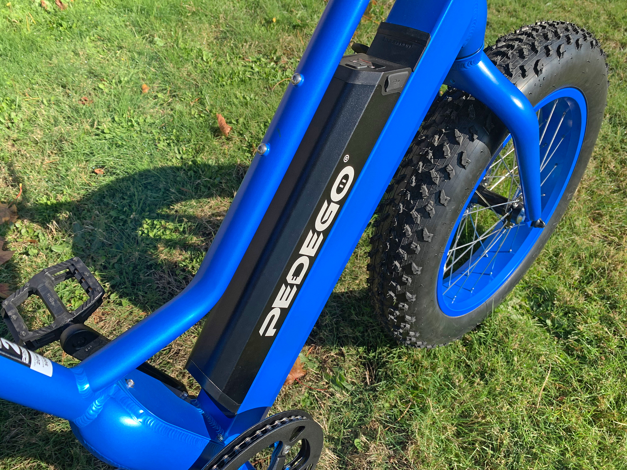

- The electronic systems are outstanding for this price point. Everything from threaded connectors with little washers to internally routed cables, a fully enclosed 18 amp sine wave motor controller, premium Samsung battery cells, two USB charging ports (one on the battery and one on the display panel), to the 45 newton meter rated Dapu geared hub motor.

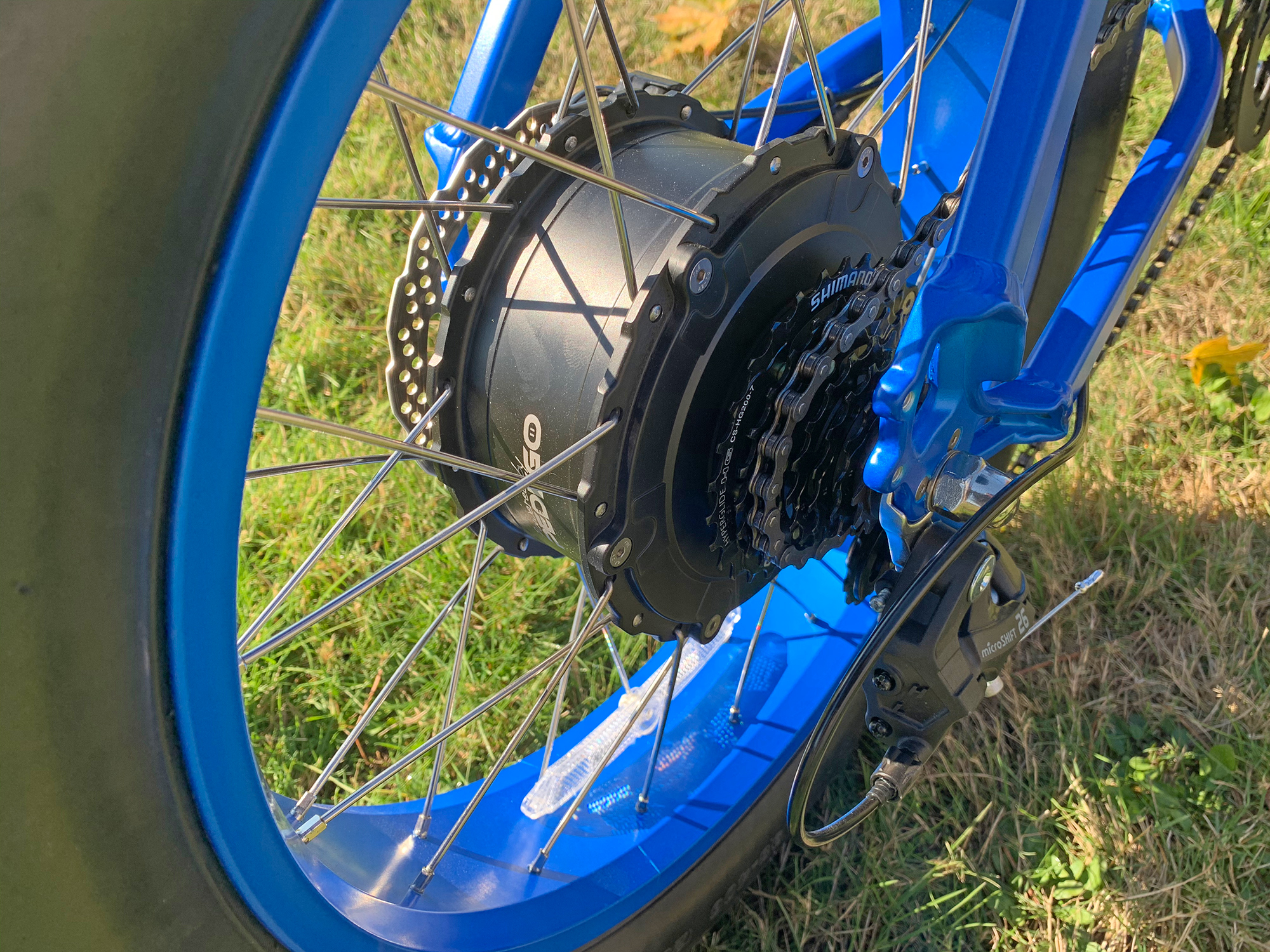

- The motor they chose looks great with the black casing and Pedego branding. It’s smooth, relatively quiet, and rated from 500 watts nominal all the way up to 864 watts peak. What’s really great about this setup is that the motor is spoked into a smaller 20″ wheel, so it gets a mechanical advantage for starting and climbing compared to a larger 26″+ wheel. This is great for off-road use, carrying heavy loads, or climbing hills.

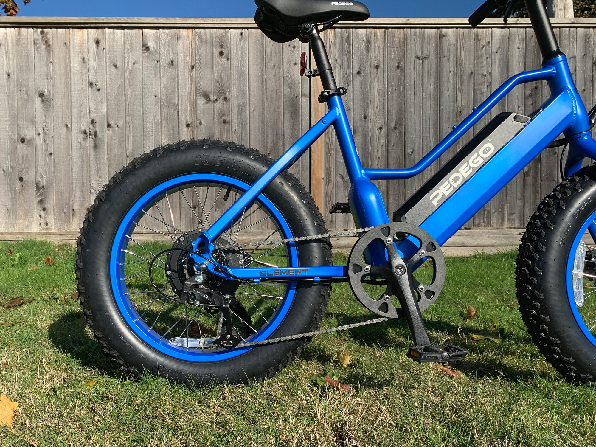

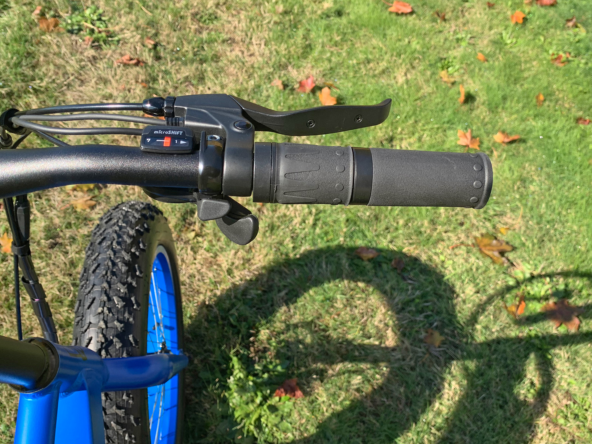

- Some companies have chosen a single-speed drivetrain for their value priced models, but Pedego went with a pretty decent seven speed! The trigger shifters work pretty well and the 12 to 28 tooth cassette provides a decent range for neighborhood and light off-road use. I really love the aluminum alloy chainring guard because it protects pants, dress ends, and reduces chain drops and chainring strikes if you go over tall logs… it acts as a bash guard for the bottom bracket.
- Pedego specced a high-resolution 12 magnet sealed cadence sensor on this bike, and it works very well. Note that both brake levers have motor inhibitors to override assist and throttle, and the bike starts in assist level zero for safety. You can adjust the top speed by entering display settings holding + and – simultaneously. Then navigate through the following items: Set 1 reset trip distance, Set 2 adjust throttle speed (can go down to 7.4mph), Set 3 adjust tire size (20″ is default), Set 3 choose units mph or kmh, Set 5 pedal assist top speed (on is US rated 20mph off is European 25km/h rated), Set 6 throttle top speed (on is US rated 20mph off is European 6km/h rated), L software version, C controller software version (good for diagnostics checking).

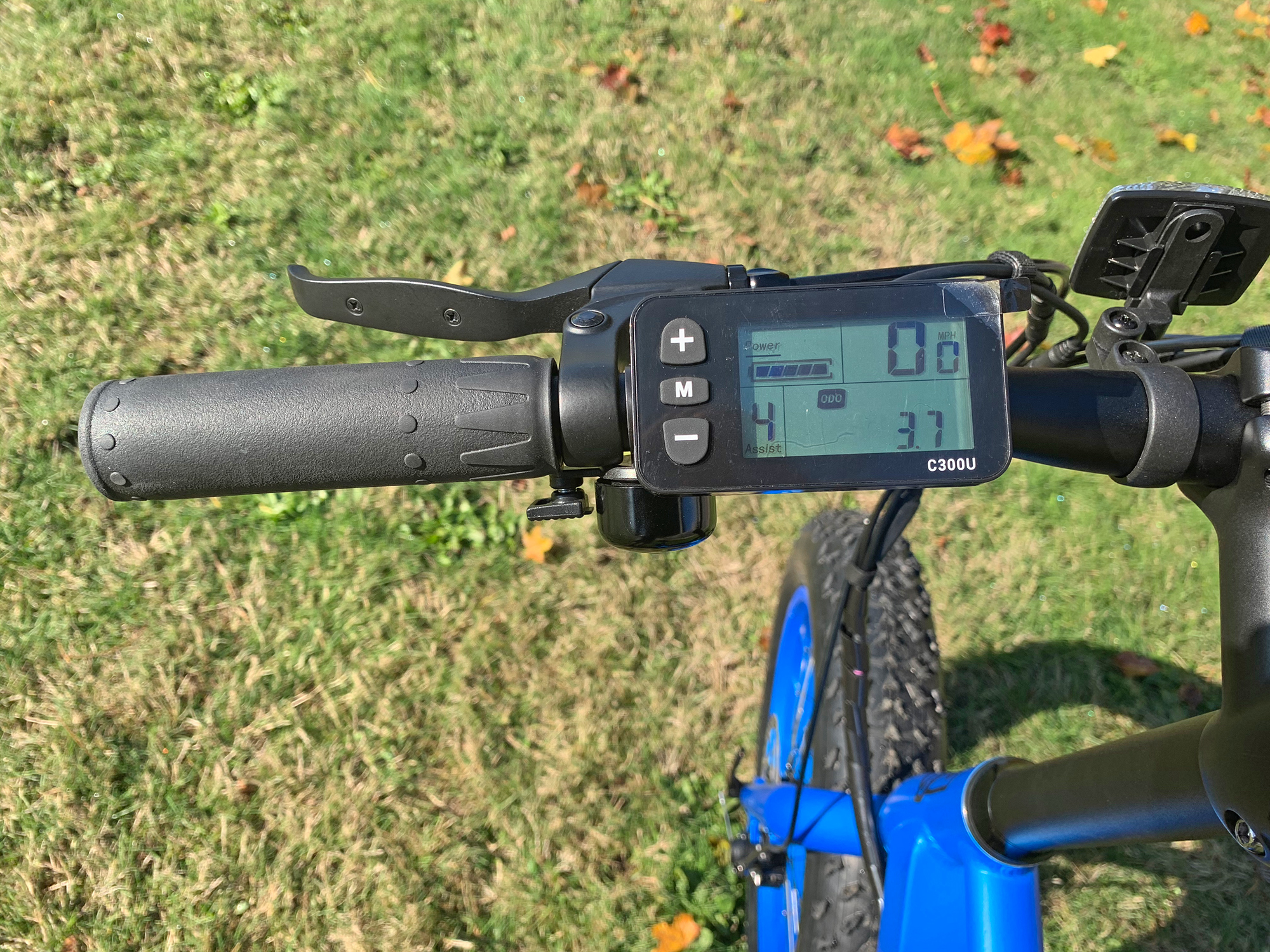

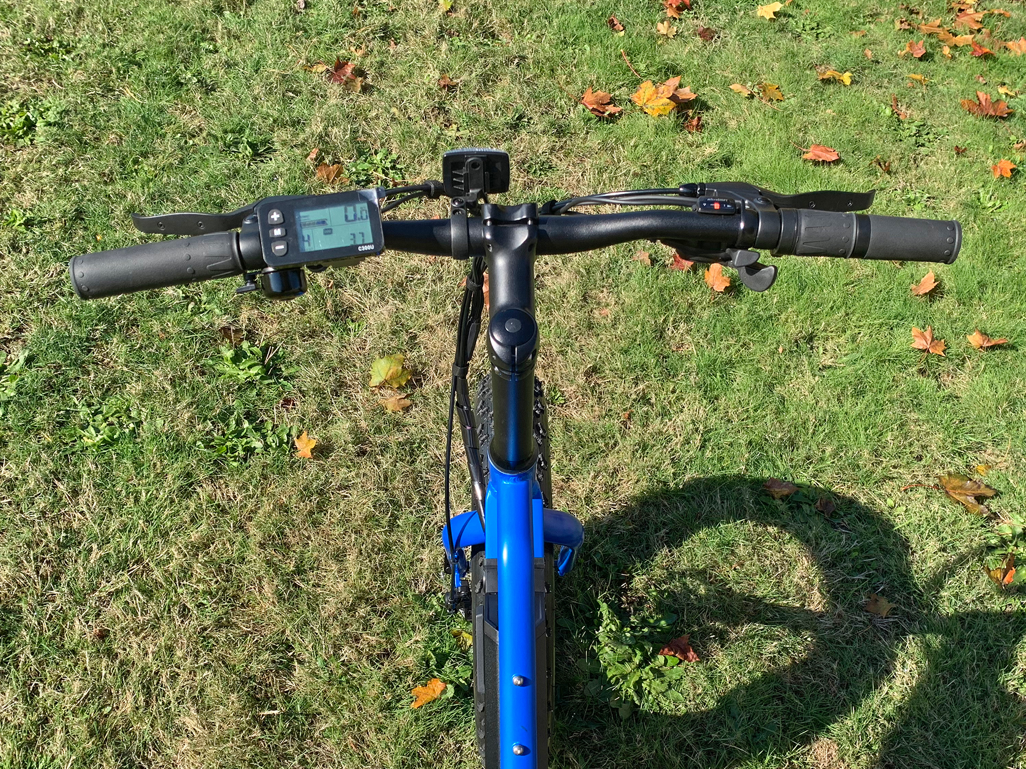

- The display panel is pretty simple by default, but has lots of settings options, as described above. It’s easy to see and reach, located near the left grip, and there aren’t too many buttons to distract you. I love that the twist throttle is connected to the right grip, it’s not two separate pieces of hardware… it feels solid and reliable. I love that they chose threaded, color-matched, water resistant connectors for all of the electronics.

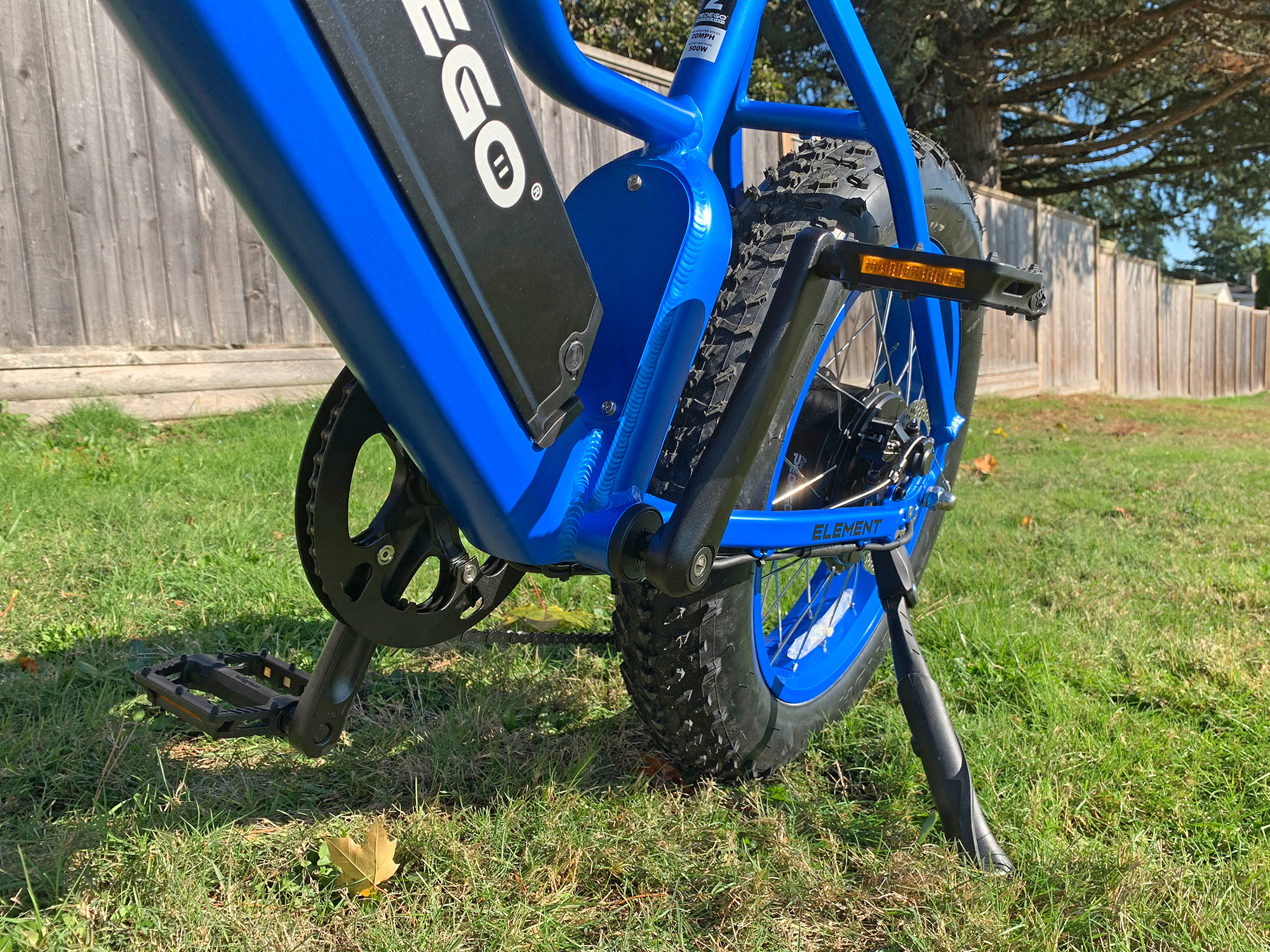

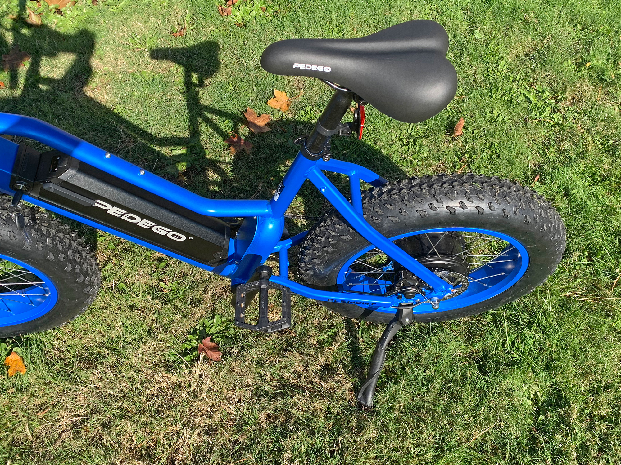

- It’s a little thing, but the kickstand they chose is great. It offers adjustable length and is positioned far to the rear, so it won’t cause pedal lock with the left crank arm if you back the bike up.

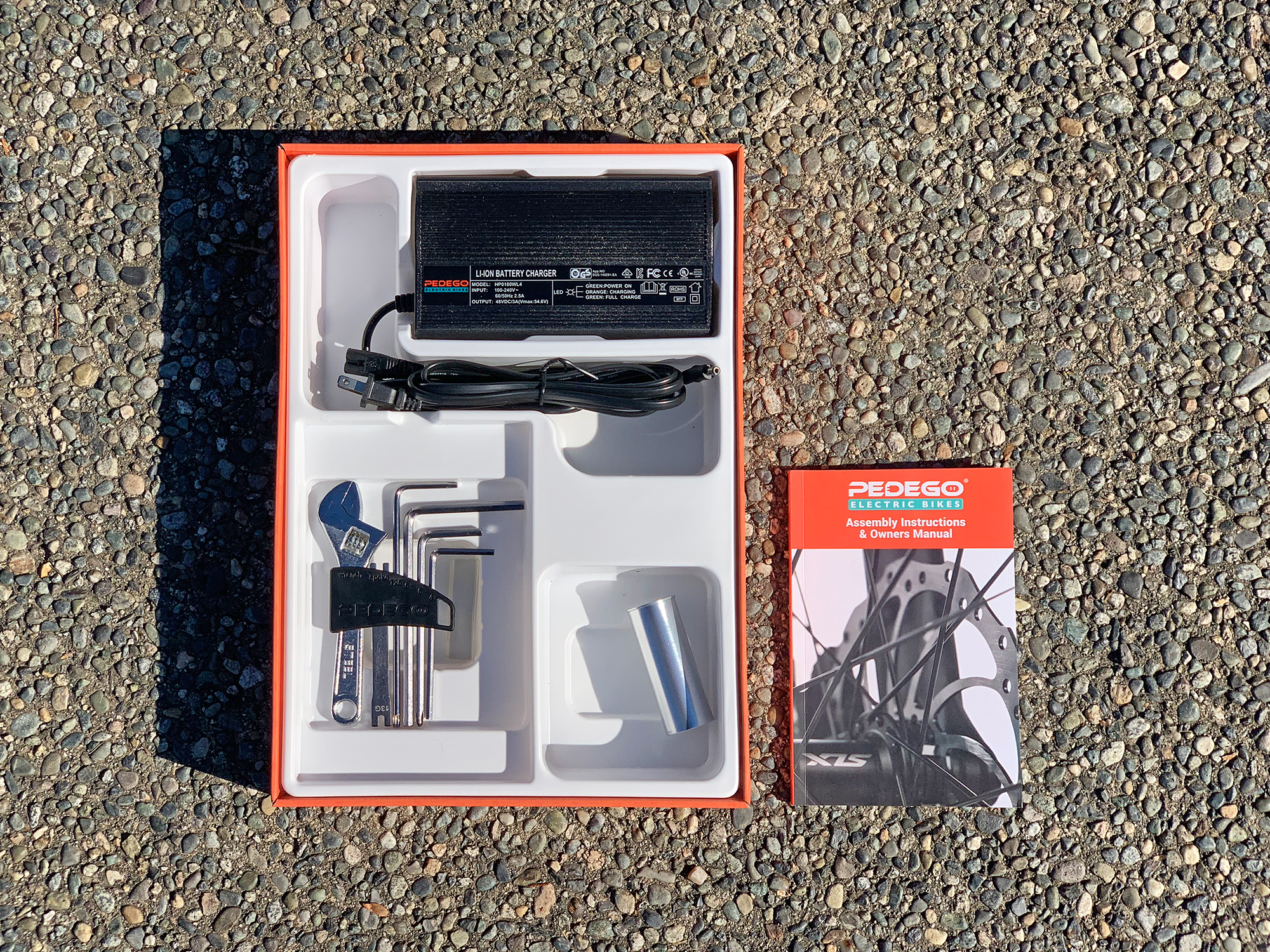

- Great battery charger, though it’s a bit larger and heavier than some at 1.9lbs, it offers 3 amp charging speeds vs. 2 amp so you can fill the battery in just 3.5 hours. I also like that the battery has a handle for easier release and transport and is mounted partially in the frame for improved aesthetic and lower weight distribution.

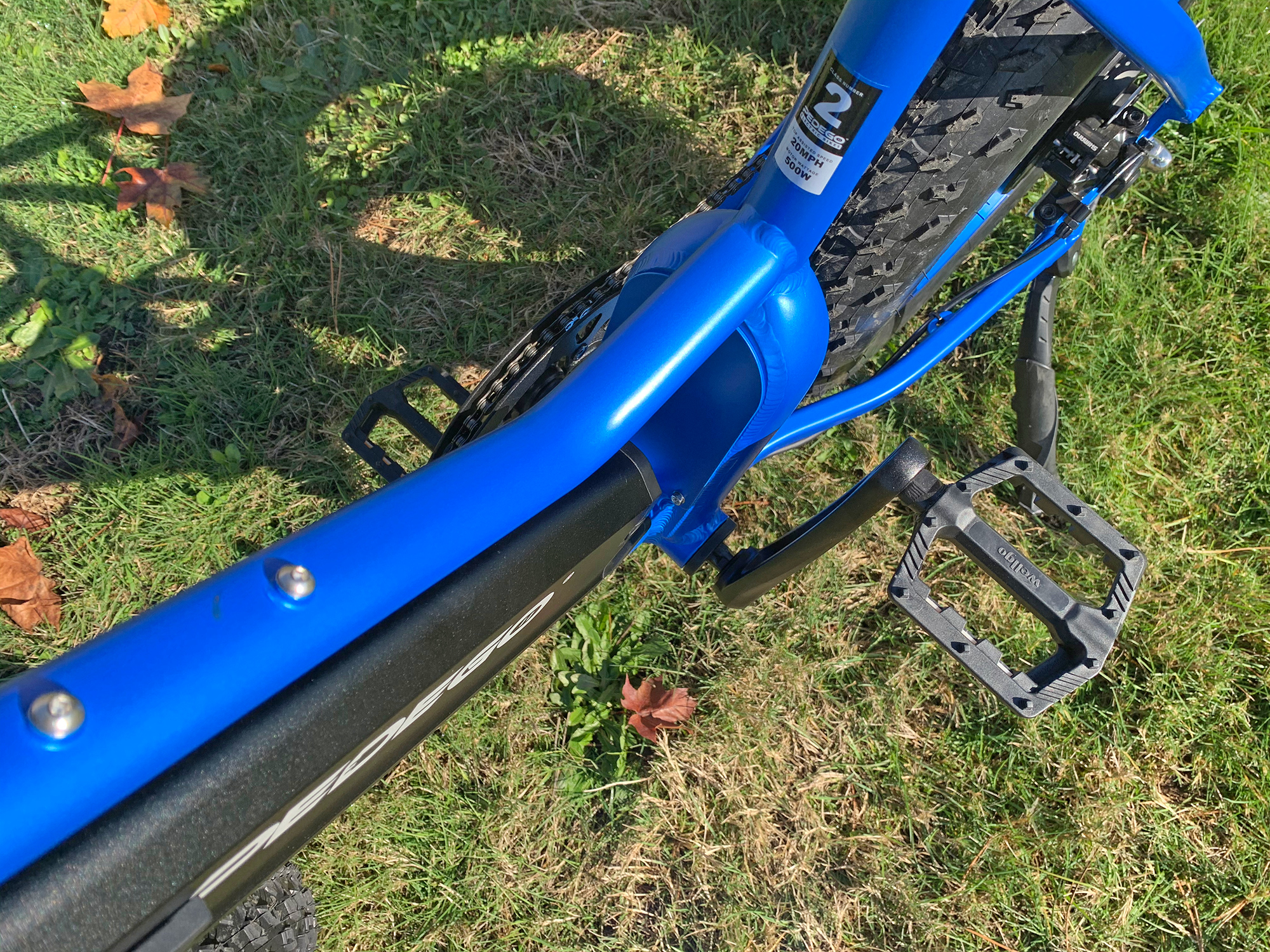

- This is a minor complaint, but the controller box that is built into the base of the seat tube blocks the seat post when you try to lower it all the way. As a result, if you want to achieve the very lowest saddle height, you may have to cut the seat post. Shops should be able to help you with this and replacement 30.4mm seatposts should be very affordable if you resell the bike to a taller rider someday.

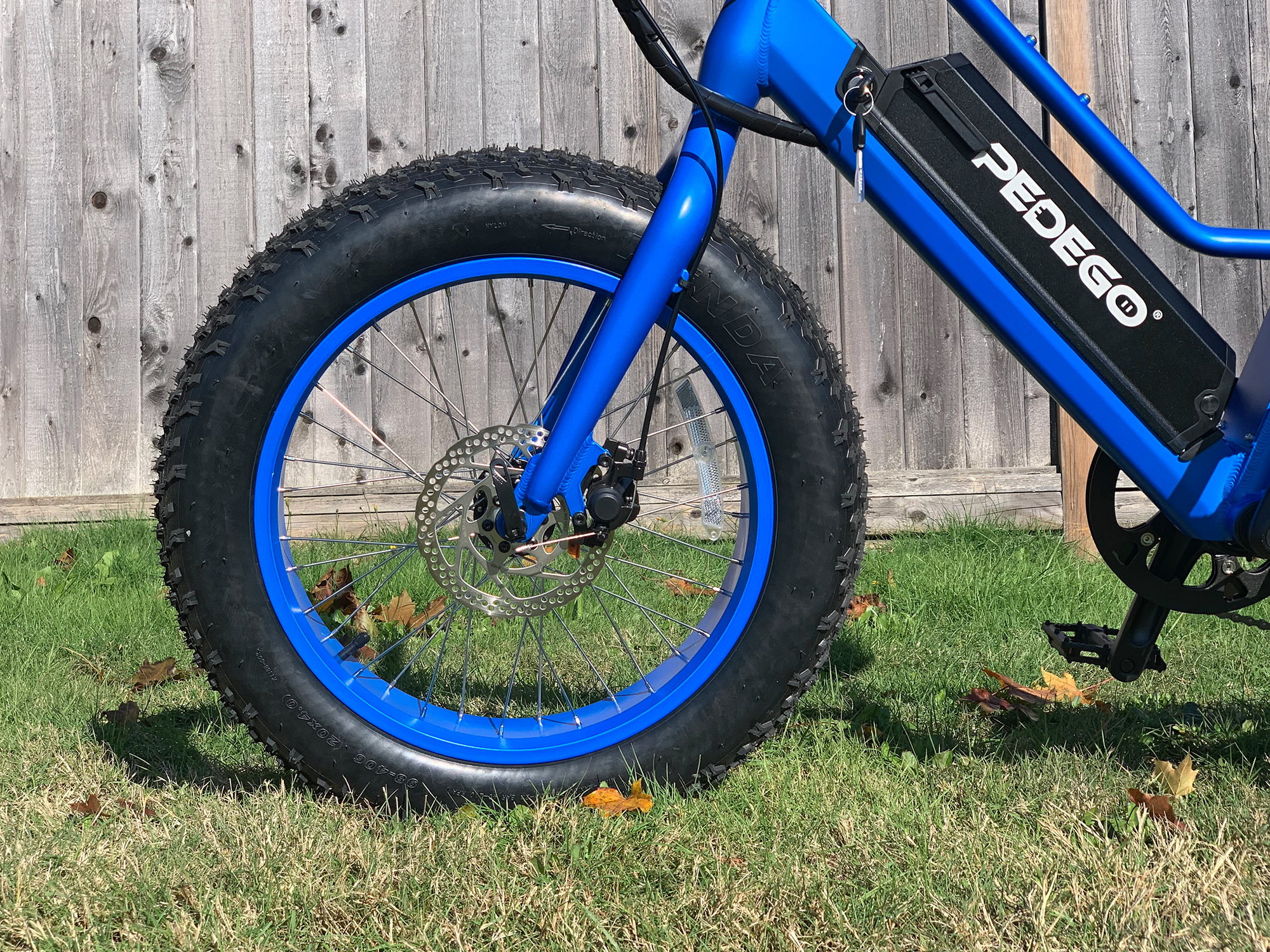

- The brakes used on this bike are just okay; you get 160mm mechanical disc brakes. The levers have rubberized edges for improved comfort and warmth, but they don’t offer adjustable reach or smoother easier actuation like hydraulic disc brakes would. The rear brake (right lever) will require more hand effort, since the cable stretches further. The rear brake cable housing is angled up so dust and water may accumulate and gunk up the line more quickly over time than if it was angled down.

- The tires come from Kenda, a reputable manufacturer, but they don’t offer puncture resistant lining. This means that if you ride off-road frequently or with lower tire pressures, there’s an increased likelihood of getting a flat. At least the front wheel has a quick release system for easier flat fixes. The rear has two 19mm nuts and easy disconnect for the motor cable… plus the shops should be able to help for a fee.
- This is a very minor gripe, but they did not include a chainstay protector sticker or neoprene wrap. The short chainstay and taller 48-tooth chainring may reduce chain slap, but it would be a bummer to have the nice paint get nicked up over time if you’re riding off-road a lot. Consider using a piece of clear box tape on top of the right chainstay as a cheap and easy preventative measure.
- Another minor consideration, the display panel lists walk mode if you hold the – button for a few seconds, but it doesn’t actually seem to work. I reached out to Pedego to ask about this and they showed me how to set the twist throttle at low speed to simulate walk mode and said that perhaps in the future they could enable it. Again, not a huge deal since the bike has a throttle, it just threw me off since the “6km” icon does appear when holding -, which is what shows on other models that do have walk mode functining.
