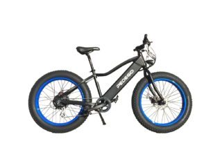

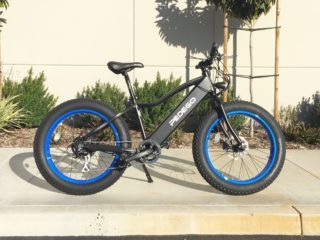

Pedego is offering something very special with the new 24″ Trail Tracker. It’s a medium sized fat tire electric bicycle that makes mounting, standing over, and controlling a lot easier for small and mid-sized riders. This is a large, relatively heavy, electric bike after all. The last thing you want is an off-balance stopped position or struggle even getting on. Amazingly, the company also offers a kid-sized 20″ Trail Tracker, and of course, they have the full sized 26″ model which is shown in the video review above to sort of contrast the size differences and show off a suspension fork add-on. All of these bikes share a similar look and have seen incremental improvements since 2013 when Pedego was using rear-rack batteries. By contrast, the newest models have downtube integrated packs that keep weight low and center and free up the back of the bike for swinging your leg over or adding your own aftermarket disc brake compatible rack like this. While this and other Trail Tracker models do not come cheap, they do offer excellent dealer support so you can get fitted and have somewhere to go if and when you need maintenance or upgrades. This is sort of a niche product, fat tire bikes were originally designed for use on sand or snow, but more and more people are buying them just for fun riding around the neighborhood. I love that Pedego opted for disc brakes given the larger size and continues to offer pedal assist and throttle so you get full power or efficiency based on your ride preference. They even threw on an integrated headlight to help you manage nighttime riding conditions… but you’ll have to use your own backlight. I often clip one onto my backpack or helmet. As a medium sized guy measuring ~5’9″ this bike felt great, and I had plenty of leg clearance. Note the 27.5″ effective standover height and measure your own inseam with shoes on to determine whether it would work for you.

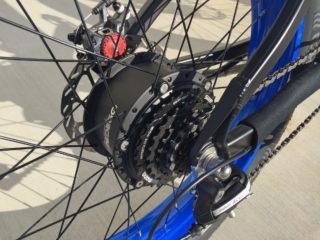

The drive system consists of a powerful, high-end, hub motor from Dapu rated at 500+ watts. What makes it nice is how compact and quite it is despite being so powerful. It can peak out at over 850 watts and offers a max torque rating of 35 Newton meters which is a lot for a hub. Many companies are now offering mid-drive motors in place of or in addition to hub motors (which tend to cost less), the advantage is that you can leverage motor power more effectively… but they tend to wear the chain and gears down more quickly and rarely have throttle operation as an option. With the Dapu hub motor, Pedego offers both drive modes and it really doesn’t matter what gear you pedal with, the motor offers a smooth steady output. I think it blends in nicely between the large disc brake rotor on the left and the seven-speed cassette on the right. Seven gears isn’t a lot but the top assisted speed here is 20 mph so it’s good enough and the derailleur is two steps up from the base Shimano offering. In all truth, it’s a low/mid level setup and the shifter is not performance oriented, but the larger thumb levers make it easier to use when wearing gloves. There’s also a large window with clear readout for what gear is in use. This choice was probably a cost saving, snow or cold weather capable, entry-level friendly choice and it performed well enough during my tests. The cockpit is clean and easy to understand. I love that both brake levers have motor inhibitors built in so that when you pull, they instantly cut power to the motor as well as stop the wheels.

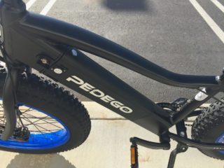

Powering the motor, backlit display, integrated USB charging port, and headlight is a custom designed downtube-inset battery pack. You can charge this thing on or off the bike, it has a little handle at the top for easy carrying, and while it does lock into the frame… you don’t have to leave the keys in to get it going (as some of the older Pedego models required). You get 36 volts, 11 amp hours to play with and I’d say that’s a touch above average in terms of capacity. The full sized Trail Tracker offers a 48-volt system which transfers electricity slightly more efficiently but that model also costs more and weighs about five pounds more. You’ll probably get a lot of attention and interest with the fat tires on their own so I like that the electric-bike aspect of this model is toned down a little, it just looks clean. The design also improves frame stiffness and spreads weight out evenly front to rear, making it feel more stable. Paul, the product manager, and designer for this bike, told me that they managed to shorten the wheelbase a bit for their 2017 Trail Tracker lineup and that the result was a tighter turning radius and more nimble handling.

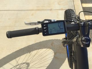

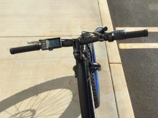

Operating the bike is a simple two-step process and there are a couple of fun tricks and extras that the display offers this time around. Once the battery is charged and mounted, just press the silver circle button near the top of the pack and then click the power button on the LCD display panel. The screen flickers to life and shows your basic speed, assist level, and battery capacity readouts. I love that you can click set and + together to switch from battery voltage to cycle count and percentage because the five bar infographic just isn’t as precise as I prefer, percentage is definitely useful for a bike that’s heavier and less efficient like these fat tire models tend to be. The bike powers on in level zero which is what Pedego calls “freeride mode” and that’s just basically “no support” but you do get the display showing stats and the headlight going. As you press the plus button up through levels 1-5 the pedal assist sensor activates and starts listening for crank arm rotation. The new cadence sensor is compact and less likely to get bumped or thrown off with mud and water accumulation. In any of these five levels you can use the half-grip twist throttle on the left grip for instant power. This is a wonderful tool for starting after a stop sign or adding power to climb a hill or catch up to a friend. Why not have a throttle?! Well, it does change the bike from Class 1 to Class 2 which is technically not allowed on some trails but in my experience, the motor is not powerful enough to spin out or cause trail damage so the distinction is a little silly. The top speed here is 20 mph but you can certainly pedal or coast faster than that… to a degree. The seven speed cassette is only going to let you pedal so fast. Anyway, the final setting is level six which is throttle only. This is nice if you get spooked with pedal assist and don’t want to be surprised when accidentally forgetting and moving the cranks. Note the USB charging port at the base of the control panel, this is great fo use with a smartphone GPS, extra lights (some users string Christmas lights on their bikes for fun) or a portable bluetooth speaker system.
Pedego tries to preserve the simple, clean look of their original bikes and create a sort of nostalgia for some classic beach cruisers. The Trail Tracker models look simple and sturdy to me but they don’t lack bottle cage bosses, rear rack bosses, fender bosses, drive mode options, or high-end drive systems. This is a capable ebike that offers on and off-road fun. You do pay a bit of a premium for the Pedego name, strong two-year warranty, and friendly network of dealers… but it’s worth it in a lot of ways in my opinion. Pedego shops often have ebike rental programs so you could try the bikes out and enjoy seeing a new city. They have some color options (in this case just the rim color) and they use standard bicycle parts that will be easy to work with for years to come. Their battery design is proprietary but uses high-end Panasonic cells with reliable Lithium-ion chemistry. And the bike will charge quickly thanks to a 3 Amp charger whereas most other electric bikes only offer 2 Amp chargers. If you’re on the market for a fun “go anywhere” electric bike that has a bit of comfort and stability mixed in, any of these fat tire bikes would fit the bill. With the 24″ Trail Tracker you get a suspension seatpost to further smooth out the ride and that sloping top tube and unique wheel size provides an awesome experience. It’s a solid electric bike.

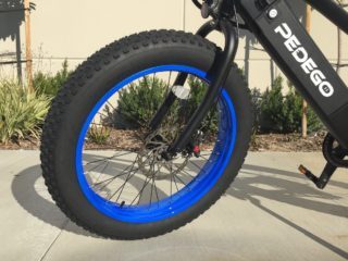

- Large 4″ wide tires provide excellent traction, a bit of comfort, and can be deflated slightly (5 to 8 PSI) to work on sand or snow

- Strong 180 mm mechanical disc brakes offer good stopping power for this 58+ lb ebike, they stay clear of water and mud much better than rim brakes

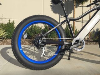

- Pedego redesigned the frame to create a shorter wheelbase which improves handling and makes the frame stiffer in general for efficiency

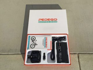

- I love that Pedego includes a thorough manual with their bikes, a small tool set, an extra fuse, and touch-up paint, it just feels like you’re getting more for your money and keeps the bike going

- You get throttle on demand performance which is great for starting or powering up a hill without having to adjust assist level (which can be distracting), the twist throttle is easy to use and overrides assist

- The power cable that runs to the motor is mounted to the left chainstay vs. the right which keeps the drivetrain less crowded, it is also tucked in near the frame better than the older cheaper motor cables that could get snagged or bent if the bike tipped
- The Shimano Acera drivetrain is two steps up from the base level component group and has a large thumb-shifter that is easy to use if you’re wearing gloves (which makes sense on a fat e-bike like the Trail Tracker)
- The battery seats into the frame really well, it clicks so you know it’s connected, and you don’t have to leave the key in while riding like you did on the older models

- I love how the display shows battery percentage as well as a battery infographic with bars, it’s just more precise with the percentage (press Set and + at the same time to cycle through to battery cycles and battery voltage from percentage)

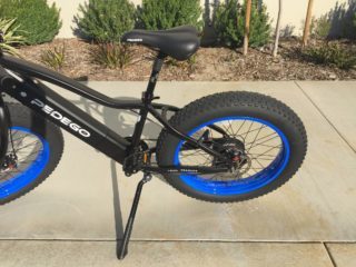

- The kickstand works well enough, it is extra large and adjustable, but is positioned at the bottom bracket where it can collide with the left crank if you walk the bike backward

thank you very much Court for all your wonderful reviews. I learned so much. But why did Pedigo put the twist throttle on the Left side? my left wrist is very weak because of being broken twice.
Court Rye says
Hi Rejean, my pictures show the twist throttle mounted to the right side, not the left. Did you see something different on their website or in person? Maybe the throttle can be moved to either side… Sorry to hear about your hurt wrist :(
Rejan says
Hello Court, You wrote in the review “You can use the half-grip twist throttle on the left grip” I guess you meant on the right grip. I should have looked at that picture more closely, lol, thanks for all of your amazing reviews, really appreciated!!! Rejean
