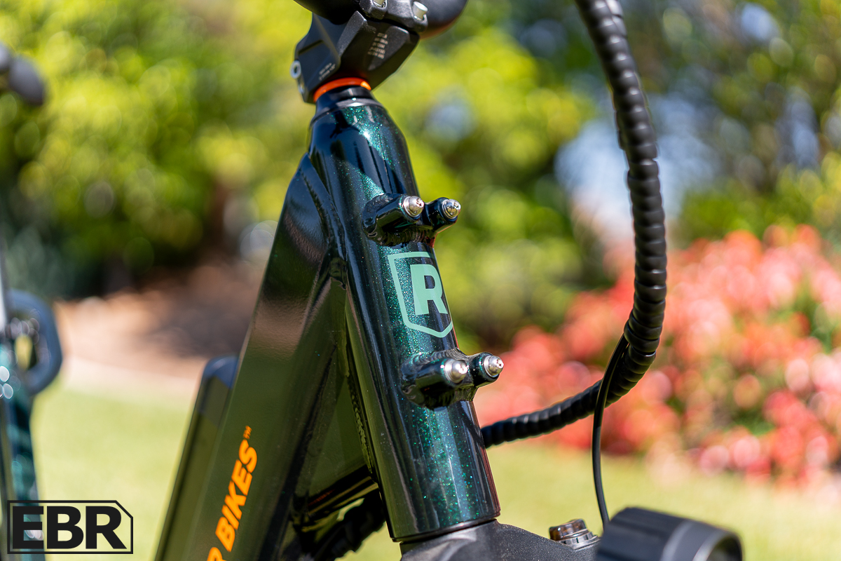

The RadRunner Max comes in a single color: Deep Emerald Green. It’s a metallic dark green with a subtle metallic flake that catches the light, giving the bike a polished, modern look without being too flashy. The open frame design is a practical win, making maintenance straightforward. Accessing cables or components is hassle-free since there’s no internal routing to complicate things, a win for DIY repairs or upgrades. It’s a clean, functional aesthetic that suits its workhorse vibe.

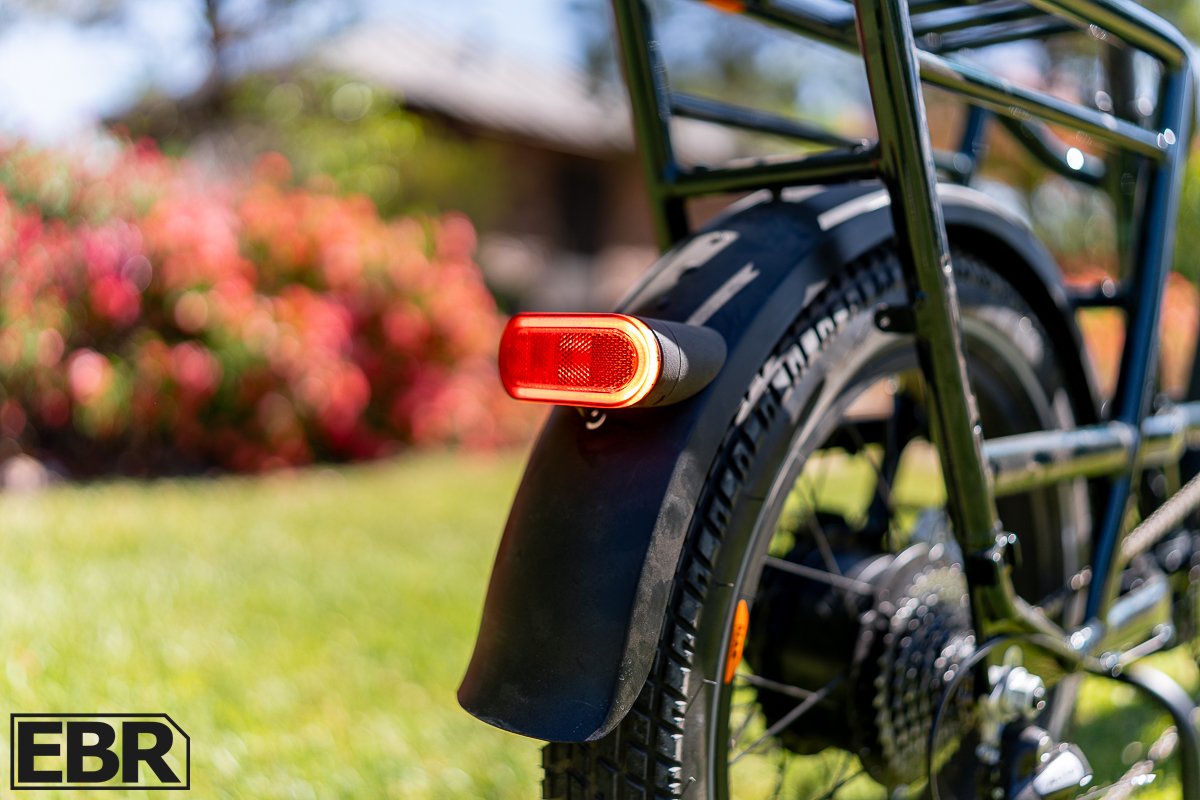

The RadRunner Max’s tech is where it stands out, particularly for safety-conscious riders. The lighting system is robust: a 450-lumen low-beam/750-lumen high-beam LED headlight with adjustable angle and auto-on ambient sensors, plus a rear LED taillight with turn signals activated via the control pad.
The star feature is the rear radar, integrated into the taillight, which scans traffic up to 100 meters behind. When a vehicle approaches, the color display shows an animation with the vehicle’s relative speed (e.g., a car at 35 mph approaching you at 15 mph displays as 20 mph) and a shrinking meter indicating proximity. This reduces the need for constant shoulder checks or mirrors, easing rider anxiety. The brake light also flashes to alert drivers, even if lights are off, adding visibility. It’s a smart, practical system for mixed-traffic environments.

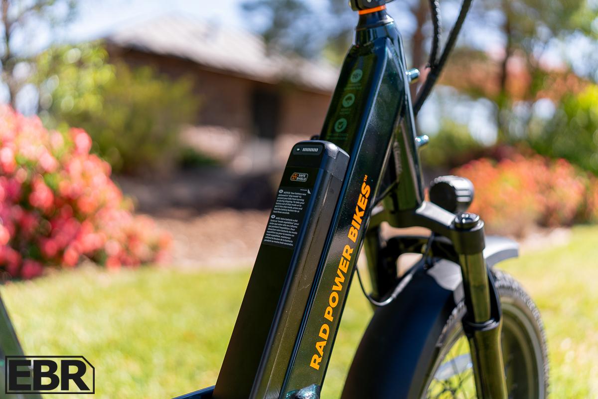

The battery itself is user-friendly, with a keyed lock for security (note the universal key’s limitations) and easy removal for charging. Charging takes about 6–7 hours with the included 2A charger, which is standard for e-bikes in this class. Overall, the Max’s range is a strong point, offering flexibility for most daily needs—whether you’re running errands or tackling extended rides—with the extender as a bonus for heavy users. Keep in mind that real-world range depends on how you ride, so adjust expectations based on your habits.
Power (Motor & Battery)
A 750W rear hub motor with 90 Nm of torque powers the Max, easily handling acceleration and steep climbs. The torque sensor ensures smooth, quiet, and natural pedal assistance, a Rad strength. Five modes—Class 1 (20 mph, pedal-assist), Class 2 (20 mph, throttle/pedal), Class 3 (throttle limited to 20 MPH and pedal assist to 28 mph), Class 3 Limited (25 mph), and California Compliant Class 3. In terms of PAS levels, you can opt between PAS levels 0 to 5 or 1 to 5 if you always want at least level 1 on giving assistance. Throttle on the MAX is a right-side mounted twist throttle alongside the grip.
The 48V, 14 Ah (672 Wh) UL 2271-certified battery claims a 19–60+ mile range. It’s semi-integrated, removable, and has a physical key for security. Rad’s Safe Shield technology pots each cell in a thermal barrier, adding fire safety by preventing thermal runaway if a cell overheats—a feature I appreciate and wish more brands used. Charging takes 6–7 hours. A Range Extender (sold separately) claims 120+ miles.

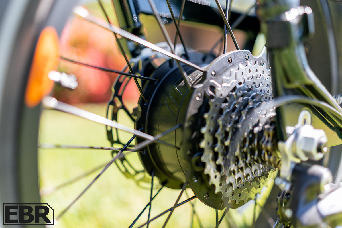

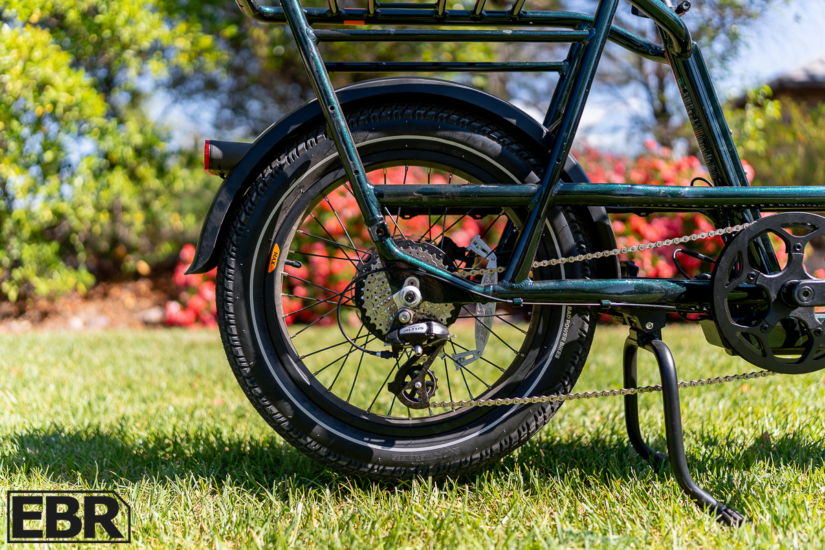

Starting with the drivetrain, the RadRunner MAX has a 8-Speed Shimano Altus derailleur and 11-34t cassette mated to a 50T chain ring with 170mm cranks and falt pedals. This combo is a good ‘do-it-all’ gear setup with enough range to tackle it all from flat cruises to steeper hill climbs.

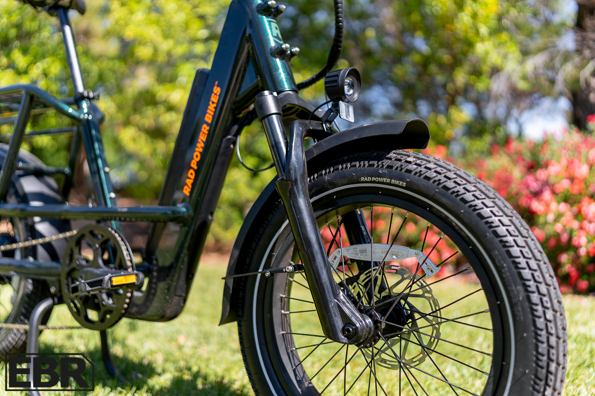

Braking is covered by the Gemma Hydraulic Disc Brakes. Both front and rear wheels are kitted with 2-Piston calip[ers and 180mm rotors with a thickness of 1.8mm. While the braking with this setup is sufficient and I never had any issues braking the MAX, I would prefer to see a 4-Piston caliper setup for beefier braking on a bike that weighs 80 lbs and has a 420 lb payload. But, again, that’s a want more of a need in this case as the braking is fine as it ships.
The Rad-branded saddle is padded and looks narrow, but its padding is top-shelf and I was surprised by how cozy it was. It’s these little things you learn about bikes when you sit on them for hours at a time with range testing. In the case of the RadRunner MAX, the saddle was a really good pick for this bike.
Speaking of comfort, the rest of the comfort package on the MAX is the 3.5” wide tires and suspension fork which team up for a smooth ride. The higher volume that 3.5” wide tires provide helps with cushioning while the 80mm of travel from the coil fork handles the big impacts. I like that Rad used a thru-axle on the front fork, giving a solid, yet, easy to remove method to securing the front wheel.

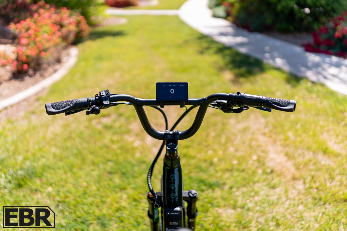

Up in the cockpit, the 28-inch wide alloy handlebar has all the controls for your ride on the MAX. On both ends are the lock-on rubber grips and alloy Gemma brake levers. On the left is the PAS and display control pad along with a bell, and on the right is the Shimano trigger shifters and twist throttle.

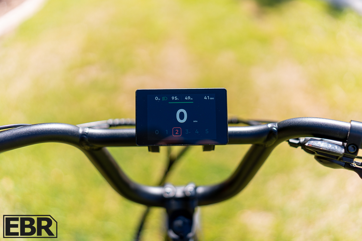

The full-color display has clear menus and a sharp interface, so checking speed, battery, or trip stats is a breeze, even in sunlight. There’s a USB-C port for juicing up your phone or GPS, which is clutch for long rides or navigating city streets. The display and PAS buttons also control the rear turn signals, which light up from the taillight. A screen icon shows they’re on, but you’ve gotta turn them off manually—unlike a car, they won’t stop blinking on their own, which might confuse drivers or sip a bit of battery if you forget.
The killer feature, as I noted earlier, is the taillight’s hidden radar, spotting cars up to 100 meters back. The display pops up a meter that shrinks as the car closes in, plus the speed gap (like, a car at 35 mph to your 15 mph shows as 20 mph). The taillight flashes to flag the driver, even if your lights are off, boosting safety for you and them by cutting down on shoulder checks and making you more visible in traffic.

There’s one frame size, built to fit riders from 4’11” to 6’2”. At 5’11”, I found it comfy, but the fixed stem felt a bit low, as I noted earlier, and taller folks around 6’2” might need to double-check the fit since the seatpost goes up but the stem doesn’t. The step-through frame makes hopping on and off a breeze, especially when you’re hauling gear or a passenger, and it’s sturdy enough for the bike’s 420-lb payload.
In terms of frame colors, you get one choice: Deep Emerald Green. It’s a slick metallic dark green with a subtle flake that pops in the light, giving the bike a sharp, modern look without being too loud. Unfortunately, if you don’t like this color, it’s the only one offered for now.

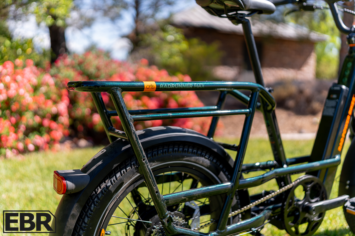

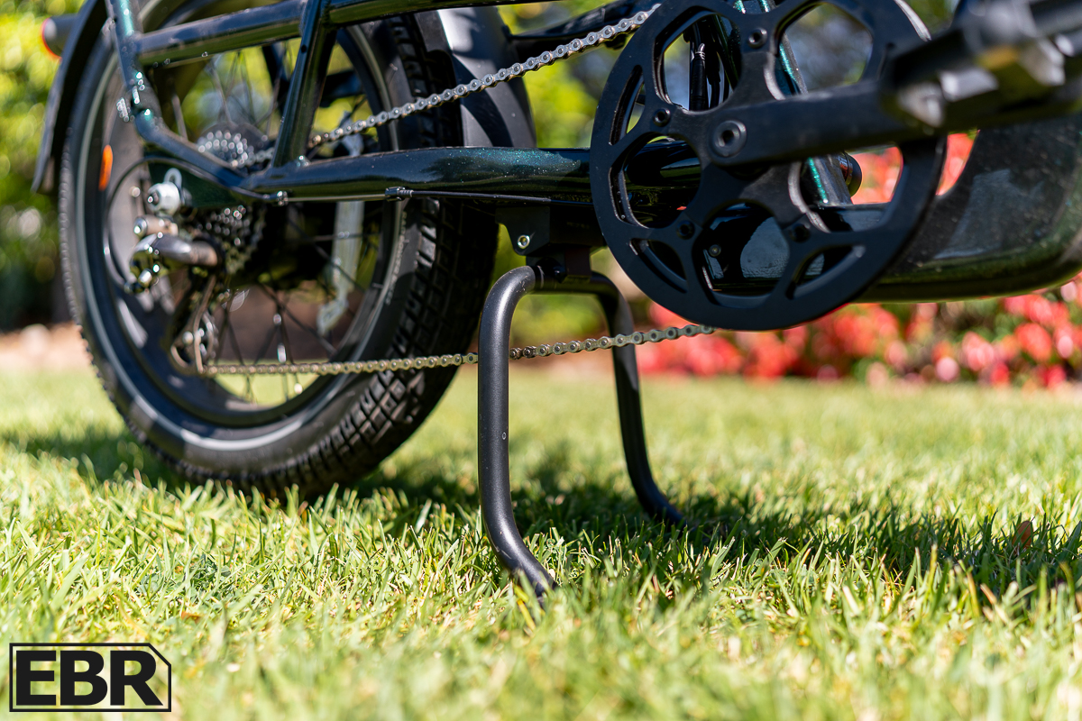

The Max comes ready to roll with full-coverage front and rear fenders to keep mud and rain off you, a must for year-round commuting or wet-weather rides. A dual-leg center kickstand holds the bike steady, even when loaded with cargo, and a handlebar-mounted bell adds a quick way to alert pedestrians. The integrated rear rack, rated for 120 lbs, is built for hauling—think groceries, work gear, or a kid’s seat. LED lighting (450-lumen low/750-lumen high headlight, rear taillight with turn signals) and radar are standard, boosting safety for night or traffic-heavy rides, as I covered in the Display section.
Rad has several optional accessories to tweak the RadRunner Max for your needs, though I didn’t test these. You can add a Range Extender battery (which mounts under the rear rack) for a claimed 120+ mile range. Cargo options like baskets, panniers, or platforms expand hauling capacity for errands or work. Passenger seats or foot pegs make it family-friendly, while handlebar bags or phone mounts cater to the more daily practical side of things.
