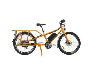

- This is the 4th generation RadWagon product! It was a solid product before, with all of the kinks having been worked out, but they completely updated it for gen 4 with a custom wheel size. The tires are small enough to keep it stable and make loading the racks easy, but large enough (and with special 3″ fat tires) to offer comfort, stability, and a lower attack angle for comfort. I would rate some of the hardware components as mid-tier to keep the price down… those include the non-locking grips, square tapered spindle, 9mm quick release vs. thru-axle, Shimano Acera derailleur, and freewheel vs. cassette.
- Rad Power Bikes introduced a new metallic head tube badge, updated headlight with LED light ring and focused beam, and smoother twist throttle that foregoes an on/off toggle switch for this generation of bikes. The reps I spoke with explained that the new throttle is more reliable and tends to be less confusing for riders who would occasionally turn off the original throttle by accident, and then become concerned. For European customers, the twist throttle changes to “twist power assist” that basically kicks the assist level up to 5 (the highest level) as long as you are pedaling… This way, the bike still qualifies as a Class 1 pedelec, but offers convenient access to power and speed without having to interact with the display and button pad

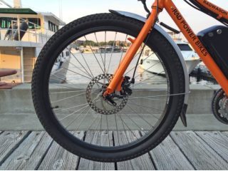

- The tires offer puncture protection and have reflective stripes on the sides, which greatly improves your visual footprint. I like that the front wheel has quick release, making tire and tube fixes easier, but the rear wheel can be more difficult because of the motor power cable and derailleur. There’s no quick release in the rear and this is one trade-off when compared to a mid-drive electric cargo bike… rear wheel maintenance can be more difficult (so make sure the tire pressure is kept between the recommended inflation of 35 to 65 PSI

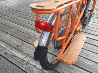

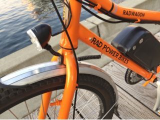

- All Rad ebikes now have integrated lights that run off of the main rechargeable battery pack. The headlight provides a focused 80-Lumen beam as well as a “be seen” LED ring that protrudes a bit from the housing. This keeps you visible from many angles and helps you stand out in broad daylight. The rear light only uses one LED but provides a large reflective surface. It’s protected by the rack tubing and positioned in such a way that child seats, bags, and panniers won’t block it. The rear light goes bright whenever the bike is powered on and the brakes are pulled (even if the lights haven’t been activated). You can also set the rear light to flashing mode by pressing a little rubber button on the lower left edge of the housing. In my opinion, these lighting solutions are way ahead of most competing electric bicycles, even some of the more expensive ones
- By default, the RadWagon come with durable plastic fenders. They’re extra wide to keep you dry (as I tested in the video review above). They are lighter than metal, but also very quiet because of the multiple attachment points.
- A big focus for the new RadWagon is the custom 22-inch wheel size and 3-inch tires. They elevate the frame enough to offer good ground clearance, but don’t go so high that the racks are difficult to load. They offer a lower attack angle than competing 20-inch wheels and tires, but would still be a little jarring if it weren’t for the increased air volume. The tires are stable, and provide a wide 35 to 65 PSI (air pressure) rating, so you can dial in comfort on an unloaded bike with lower pressure or raise it up to avoid pinch flats and rim dings with a fully loaded bike
- Rad chose a hybrid tread for their new tires, which reduces rolling resistance and noise. This sacrifices traction for dirt and gravel, but the wider 3″ sizing compensates… they performed well during my grass and gravel tests, even on softer terrain
- Despite not having a suspension fork, the bike is very comfortable. I think the increased air volume of the tires, tool-free adjustable stem, swept-back handlebars, ergonomic grips, and long telescoping stem all contribute. I do think it would be possible to use a seatpost suspension here, but the stock Satori telescoping post might have to have a set screw removed to make this possible at taller heights. Or, you could use a standard 34.9mm seatpost suspension and completely forego the extra length of the Satori telescoping design

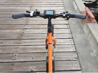

- I was told that the adjustable angle stem has been custom made to stay tight and uses hardened materials that won’t dull as easily as some competing parts. This is important to me, because the RadWagon is heavy and whether you’re lifting by the handlebars or just riding over bumpy terrain, some adjustable stems can get loose over time and start to feel unsafe
- By not using a suspension fork, the RadWagon saves money, weight, and improves overall stiffness and strength for hauling. It actually makes the bike feel more stable; I was able to ride no-handed without issue, and the frame didn’t flex very much at all when I shook it (which does happen on many traditional longtail cargo ebikes)

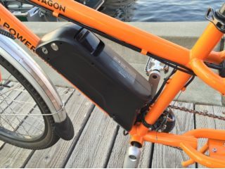

- I like that Rad Power Bikes is using the same battery pack for all of their 2019+ models. This means you can purchase a additional electric bicycles from them and easily swap the packs around, extending your adventures. The battery itself uses high-quality lithium-ion cells from Samsung, is warrantied for a year, and is cheaper to replace because it doesn’t contain the bike controller. You can charge this pack on or off the frame, and it has three key positions for unlocked, locked to frame but powered off, and locked to frame powered-on. This helps you to deter tampering with the bike without having to take the battery pack off. For best results, store the battery in a cool, dry location. Extreme heat can damage the cells and extreme cold will stunt them and limit your range temporarily
- Even though the battery and controller box are mounted externally, this is a purpose-built electric bike with internally routed cables and wires. The black wires and controller box are more prominent on the white and orange frames, so it’s neat that Rad is offering a limited run of black frames here. I found that the battery and controller box were very well protected by frame tubing, and positioned to keep weight low and centered on the frame. I also appreciate the flat portion of frame tubing and three-bolt mounting design for the battery pack slide
- Overall, the frame is very well balanced front to rear. I was impressed that it didn’t tip backwards when lifting from the nose of the saddle (as I weighed the bike). Considering that it uses a rear-mounted hub motor, it’s great that the bike isn’t especially rear-heavy
- Note the gussets and additional welds on the top tube and downtube to improve frame strength. Also, note the stainless steel torque arm on the left rear dropout that keeps the motor axle from chewing into the softer aluminum alloy over time. This is an important feature, especially given the high torque 80nm rating of the hub motor

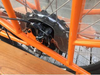

- One of the big changes from Gen 3 to Gen 4 for the RadWagon is going from a heavier and lower torque gearless hub motor to a geared one. It offers great power for starting, navigating soft terrain, and climbing (especially with the smaller wheel diameter). Offering the 750 watt max limit for US ebikes (500 watt for Canada, 250 watt for Europe), you get 80 newton meters of torque in all locales, which is very capable.
- Rad is using the same fat-bike specific geared hub motor for this bike as it uses on the RadMini, RadRunner, and full sized RadRover products. This means that they had to custom design the rear wheel with a wider 175mm hub spacing. Ultimately, this improves the strength of the wheel with a sturdier spoke bracing angle… and Rad chose extra-thick 12 gauge spokes

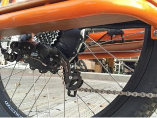

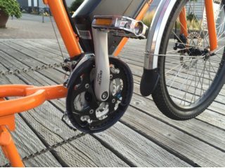

- I like the sturdy Wellgo platform pedals, alloy chain guide, and steel derailleur guard on this bike because it means you won’t slip off as easily, won’t have the chain bouncing off, and can keep the sensitive shifter parts and motor power cable from getting bent or snagged if the bike tips, is parked at a crowded rack, or gets tossed around in shipping
- In addition to the standard fenders, rear rack, and bottle cage mounts, this bike offers sturdy front rack mounts (for their optional tray or baskets) and a second set of bottle cage bosses to mount a folding lock below the downtube! Rad sells a bunch of accessories that all work well together on this and other models, they’re mostly interchangeable (except for the rear seat pads and bars). Note that if you remove the wooden deck, there are two child seat windows designed to work with Yepp products
- I love that the LCD display panel is fairly large, has adjustable backlight brightness, and offers a full size USB charging port built into the bottom. This is very convenient if you are using the optional phone mount for GPS and need a bit of extra juice for your mobile devices on long rides
- For me, the three-button control pad that’s mounted near the left grip is easy to reach and simple to use. You press up or down to raise and lower assist, you press mode to cycle odometer and trip meter, you hold up to cycle current speed, average speed, and max speed, and you can hold up and mode simultaneously to activate the lights or hold down to activate walk mode. Walk mode is especially useful if you’ve got the bike loaded up with gear or a child seat and just want to play it safe without over-exerting yourself up a hill or through a technical section of terrain. Hold up and down simultaneously to get into the settings menu and adjust wheel size, top speed, and backlight brightness
- The RadWagon uses a high-resolution 12-magnet cadence sensors, which makes starting and stopping more predictable. I love that they also included motor inhibitors on both brake levers (which also activates bright mode on the rear light!) It seems like they really dialed in the controller settings too, because the motor is smooth and predictable when starting vs. delayed or jerky
- The throttle setup on all of the Rad Power Bikes is perfect, in my opinion. It provides you with full power, anytime the bike is turned on. This means that you can zip around without pedaling in assist level zero, without worrying that you might accidentally activate assist by moving the cranks as you get on and off. It also means that you can override assist levels 1-4 with full power to climb a hill or catch up with friends… all without clicking buttons or looking down, just twist and it goes! For people who don’t want a throttle, there’s a quick disconnect cable right near the handlebar that’s easy to access, and doing this will convert the bike to Class 1, which is legal on more mountain bike trails

- A deflopilator spring (aka stabilizer spring) keeps your front wheel straight and stable when loading the cargo area and may also assist in steering heavy loads. You can see this spring connecting the front fork to the downtube in the stock photos above
- Great drivetrain on this ebike, Rad has chosen an 11 to 34 tooth freewheel over the conventional 14 to 28 tooth design. This provides a wider range of pedal options for easier climbing and more comfortable high-speed riding. The cogs are nickel coated, which makes them rust resistant and a lot smoother to shift. The Shimano Acera derailleur is lighter and more reliable than Tourney or Altus (the two lower levels)

- Extra-long compared to traditional bicycles, which could make storing difficult for some. The full length I measured was 79.75-inches vs. 72″ on a normal city bike
- Fairly heavy at 76.7lbs (that’s actually ~3lbs heavier than the original RadWagon), this makes lifting and maneuvering the bike difficult. You might removing the battery pack to shave ~7.7lbs off. The heavier weight is the result of additional tubing and gussets that reinforce frame strength for hauling, as well as larger tires, wider fenders, and the wooden deck
- Custom tire and inner-tube size means you’ll have to buy replacements from Rad Power Bikes vs. a local shop or Amazon. I’ve been told that they have a good supply ready, and I want to compliment how well they’ve supported past products (still stocking and selling last-generation batteries, for example)
- The battery and controller box are mounted on top of the frame vs. being integrated for a more streamlined stealthy look. By separating the pack from the controller, they make replacements a lot more affordable while also reducing heat buildup… so it’s a good design decision, and both seemed well protected by the frame tubing (should the bike tip over or get bumped at a rack)

- Rad Power Bikes has been using the large Shimano SIS index shifters since the beginning, and they present a couple of trade-offs. You have to reach up with your thumb to press the main paddle to get to lower gears, which requires a bit of hand flexibility and might compromise your grip. The shifter is also more exposed to damage at bike racks and seems to require more hand effort to engage. I much prefer trigger shifters, but they might not fit with the twist throttle and they could be less intuitive for new riders (often having smaller optical displays). One positive of the big shifters is that they are easy to click if you’re wearing gloves since the paddles are so large
- The Tektro Aries mechanical disc brakes get the job done, and I appreciate the large 180mm rotors and rubberized levers (that aren’t as cold or uncomfortable to pull as pure metal), but these brakes are definitely a price compromise. Hydraulic disc brakes would be easier to actuate and more consistent. The rear brake (right brake lever in North America) often requires more hand effort since the cable is longer. Hydraulic disc brake levers usually offer adjustable reach, which can be easier to use for individuals with especially large or small hands. It is possible to install hydraulic levers and calipers aftermarket, but requires additional hardware, an experienced mechanic, and some time to do… which might be better spent choosing another ebike with factory installed hydraulic brakes
- No suspension fork and extra effort required to add a suspension seat post. The Satori telescoping seat post is great, but the top portion uses a set screw that has to be removed (possible with a 2.5mm Hex Wrench) in order to mount a traditional 30.9mm seatpost suspension. Otherwise, you’ll need a 34.9mm post or shim to fit one into the actual bike seat tube, and it won’t reach as high
- The display is large and easy to read but not removable, so it could take extra weather wear and possibly get scratched at a bike rack. I appreciate that it’s well protected at the center of the handlebar, and that the electronics on the bike can be completely disabled by turning the key to the locked-off position (between locked-on and unlocked), so nobody can turn your bike on and mess with the throttle while it’s parked
- It would be nice to have more than five bars to indicate the battery charge level, on the LCD readout. As it stands, each bar represents a 20% drop vs. 10 bars representing 10% drops, or even a written percentage such as 42%. This could really help riders to make it home without completely depleting the battery

- All of the Rad Power Bikes use the same charger (just like the interchangeable battery packs), and it’s fairly lightweight, but it only puts out 2 amps, so charging can take up to six hours if the battery is completely drained. This would be faster if they used a 3 or 4 amp charger like some other companies have started doing, but it might raise the price
- The RadWagon no longer offers regenerative braking, since it switched to a geared hub motor vs. gearless in the past. Geared motors tend to produce more noise and wear down faster due to friction inside. This is still an incredibly reliable motor, and you get more power while reducing weight… but there are trade-offs. Most ebike companies have moved away from gearless motors in recent years

I like how you glossed over the wheel size like a true propagandist. 22″ wheels are a failed attempt at a new BMX standard from about a decade ago. Once again, Sad Power is leaving their customers and the rest of us bike mechanics holding the bag for their short arms and deep pockets.
I truly despise how they treat their customers like lambs to the slaughter. And you’re helping, Court. You’re helping extend the suffering of so many people out there. Life is too short for crappy ebikes that end up in a landfill 2 years out. If they’re lucky.
Court says
Hey Dirt, I didn’t realize that 22″ was a failed standard. I thought this was a new attempt to find a middle ground between 20″ and 24″ to keep their cargo bike closer to the ground but also raise the attack angle. My hope is that they are large enough (and committed enough) to support the standard well, as I’ve seen them do for their older battery packs. I agree that it’s a shame when some new companies or super cheap ebikes abandon support for a part and let their bikes turn into garbage vs. offering support and repairability. This is a big issue with mobile phones and the whole “right to repair” movement. I frequently link people to FTH Power as a battery repacking service, and have a free “for sale by owner” section in the forums here. Unfortunately, even the big companies sometimes abandon parts. I saw this on the original Specialized Turbo, which had a joystick display panel that would eventually wear out. I know of people who had the display fail, even though the rest of the ebike was perfect, and they became unrideable simply because they could not get a replacement display… Definitely a tragedy there, and I try to leave the comments here and in the forums open so people can express this. I’m not trying to be the ebike police or prescribe standards, but I do aim to communicate differences by recording all of the specs and pointing things out in my reviews. I appreciate your input as well!
