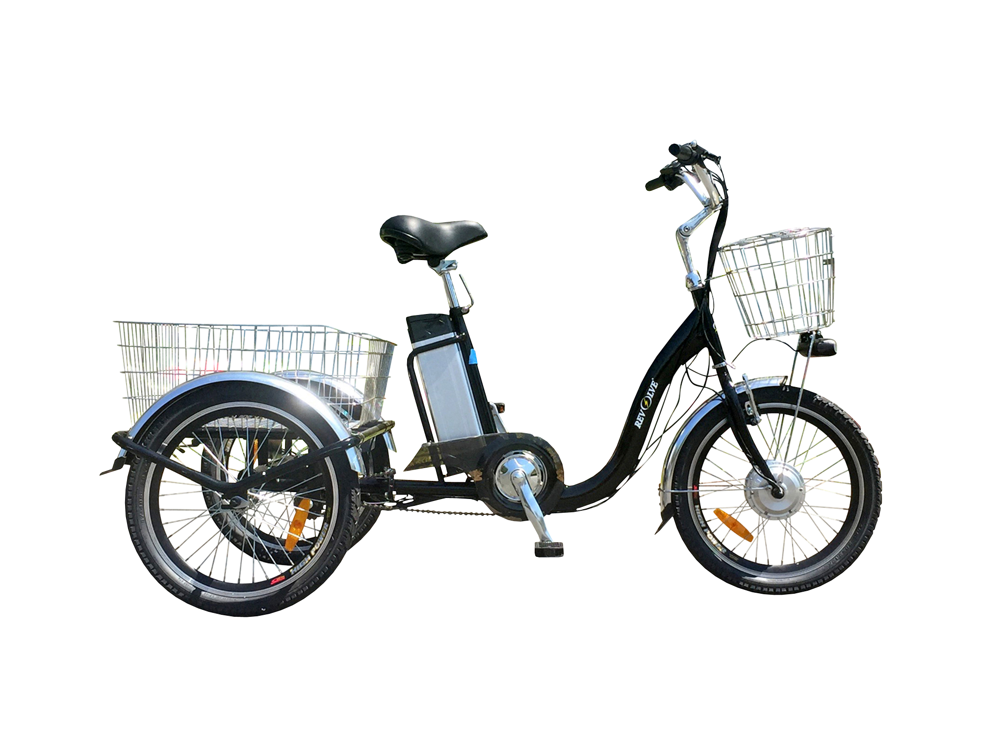

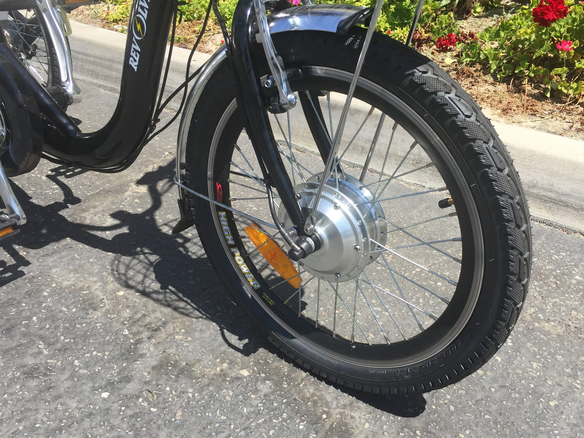

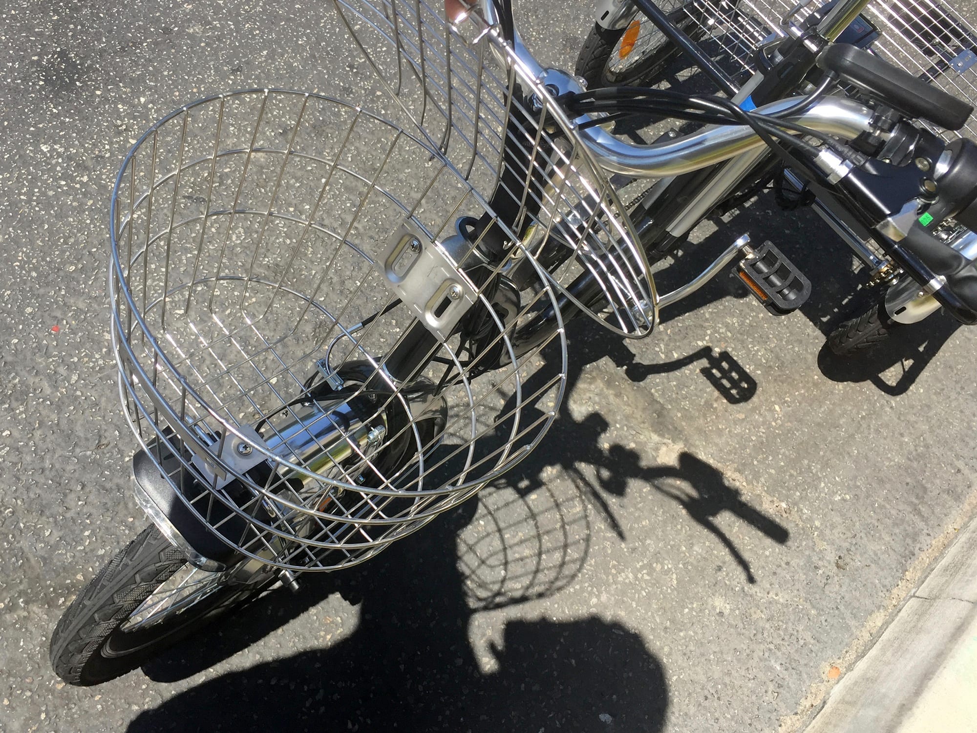

Driving this electric tricycle is a modest 350 watt internally geared hub motor, built into the front wheel, from an unknown manufacturer. These types of motors tend to be very reliable and are common on less expensive electric bikes because they don’t require a lot of frame modification to implement. It worked well getting me up to speed and then accelerating smooth and steady, but it did produce some whirring noise. I noticed that the power cable leading up to the motor was exposed on the right side of the fork… which is not uncommon, but you should take care not to kick or snag this cable because it could disable the motor. There’s enough power here to get going, but the torque wasn’t especially high and because it’s a front-wheel-drive setup, there may be situations where the wheel slips or spins compared to a rear-wheel-drive design. This is especially true if you have the rear basket loaded up with heavy gear and you’re sitting back and upright. You can help the bike by pedaling along but only the rear left wheel turns as you do this, you get three gears to switch through in order to make climbing and starting easier and I love that the trike uses an internally geared hub vs. a derailleur because it should stay cleaner and require less maintenance over time. Internally geared hubs can be shifted at standstill which makes starting a lot easier if you forgot to shift down before stopping. Imagine riding at 10 mph up a slight incline but then having to stop at a traffic signal, at this point you could switch down to gear 1 and use the trigger throttle to help you get moving again as you pedal. Part of me feels that they could have geared this motor for higher torque and limited the top speed to 15 mph vs. 20 mph but on the other hand, it did move Sam (who weighs well over 200 lbs) and the hub motor does already benefit from a mechanical advantage because it’s spoked into a smaller 20″ wheel vs. more traditional 24″ or 26″ wheels. These smaller wheels also lower the stand-over height of the trike and make it easier to load up with supplies. Balancing out power is stopping strength, and the v-brake up front and band brake in the rear are pretty basic in my opinion. I didn’t get to use them a lot but did notice that both levers have motor inhibitors for sending a “stop” signal to the motor whenever activated. They also have parking locks installed, so you can keep the trike from rolling away once you do stop. Before my test ride, one of the brake levers was locked and the throttle wouldn’t work as a result… it’s a good system that can help you avoid accidental starts and make mounting/dismounting safer. However, it could also be confusing at moments like this where you’re thinking “why isn’t the throttle working?!” so keep that in mind ;)

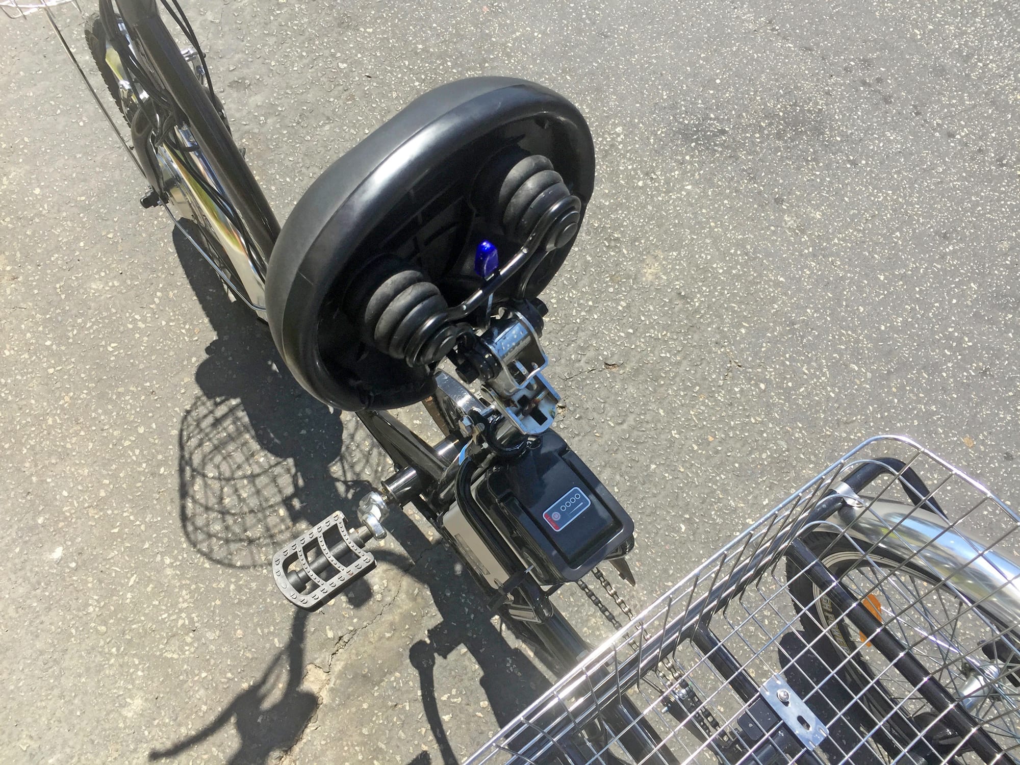

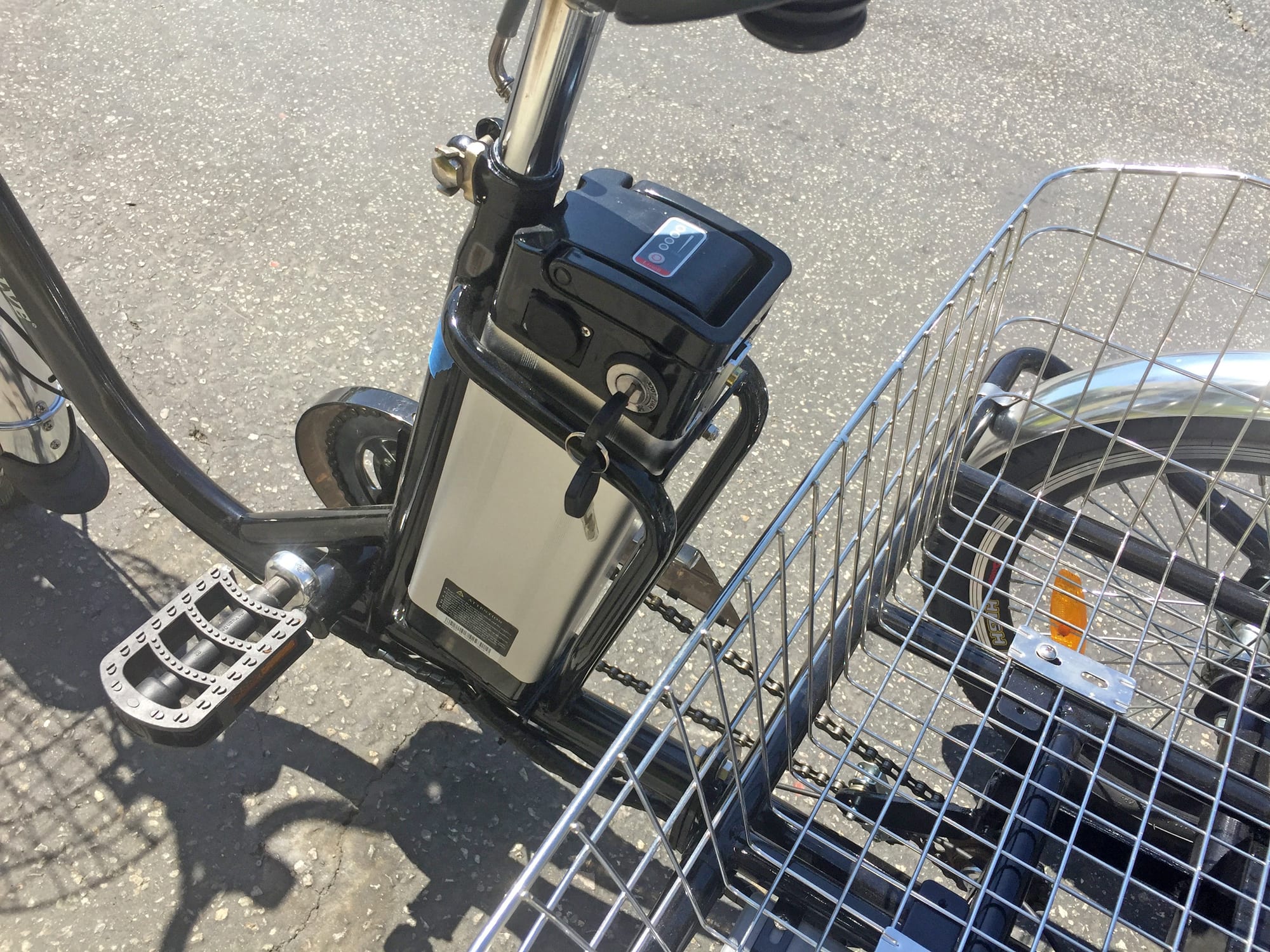

Powering the bike and its integrated headlight and backlight is a standard sized 36 volt 10 amp hour Silver Fish style battery pack. Sam communicated that this sort of battery design is more generic and widespread, making it easier to find and replace even if the company that made this trike, Revolve Electric Vehicles, discontinues the model or goes out of business. The battery slides along a metal rail, resting just behind the seat tube. It felt sturdy and was easy to access because it wasn’t low and hidden under the rear basket and it has a handle built into the top for easy lifting. If I can, I tend to leave batteries on my electric bikes and then plug them in directly, and that’s possible here, but you can extend the life of the cells by storing them in a cool dry location. If you live somewhere with extreme cold and heat, you might want to keep the bike in a shed or garage and then move the battery someplace else to charge it up. If you keep it from getting cold, the cells will help you go further on each ride. And, if you plan on storing the bike for several months (perhaps in the winter) you can keep the battery pack at ~50% to avoid stressing the cells and it will last longer. In conclusion, I feel like the battery mounts securely, is protected by extra frame tubing, is positioned to keep weight centered and balanced and is easy to access. My one complaint would be that the key must be inserted and turned to on for the battery to be active. This is a good safety and security measure but other ebikes allow you to completely remove the key AND keep the battery locked. Imagine having a keychain connected to the bike key which could get snagged or jingle around, and the flip side of this is a single lone key which could get misplaced easier. There’s a reason why none of the major ebike brands require you to leave the key in while riding but the Silverfish is a more basic part that hasn’t been changed for many years. It’s sold in bulk and used mainly on cheaper products like this.
Once the battery has been charged and mounted properly, and you turn the key to on, you’re ready to mount the bike. If you forgot to turn the battery on first, you might have to get off and bend down to do this step, which can be annoying. Bending down and twisting to get to the key could cause some instability or discomfort for riders so I recommend getting completely off. Before unlocking the brakes and pressing the power switch on the little plastic control pad, located near the left grip, Sam suggested that you put your feet up onto the pedals and hold the grips as if you were about to ride. This ensures that when you do turn on the display, if the throttle gets activated, you won’t have your feet in a vulnerable position. The display pad is pretty simple, there’s an on/off button, lights button (which turns the headlight and backlight on), and a mode button (which cycles through low, medium, and high power). Definitely use the low power mode at first to get used to pedaling, the 5-magnet cadence sensor isn’t super responsive and even though the motor starts up smoothly, it’s something you want to get used to. In some ways, I wish this ebike had a zero mode so you wouldn’t have to worry about moving the pedals and getting a burst of power unexpectedly when relying mostly on the throttle. It would also be nice to have a more precise battery indicator vs. the four dot 25% readout which could leave you feeling uneasy as the capacity drops to just one dot… does it mean you have 25% left or are you getting really close to zero?! Again, the trike is heavy and walking it could be difficult and unpleasant. There’s no speedometer, so it’s really more of a guess that you can reach 20 mph, and there’s no odometer, trip meter, timer, or other fancy readout. I don’t mean to be overly critical on this display because there are many older electric bikes that were similar, it’s a way to save money and I just want to be clear about the trade-offs. The trigger throttle is positioned on the left, in front of the display, and had more of a forward motion vs. down. I’m more used to having a throttle on the right side of the bars but that’s not possible here without pushing it way out (making it difficult to reach) because of the three-speed grip shifter there. Where it’s at, the throttle works fine, but it does push out the control pad a bit so you might have to stop and pull your hand off the grip before interacting with different power levels or the lights to be extra safe.

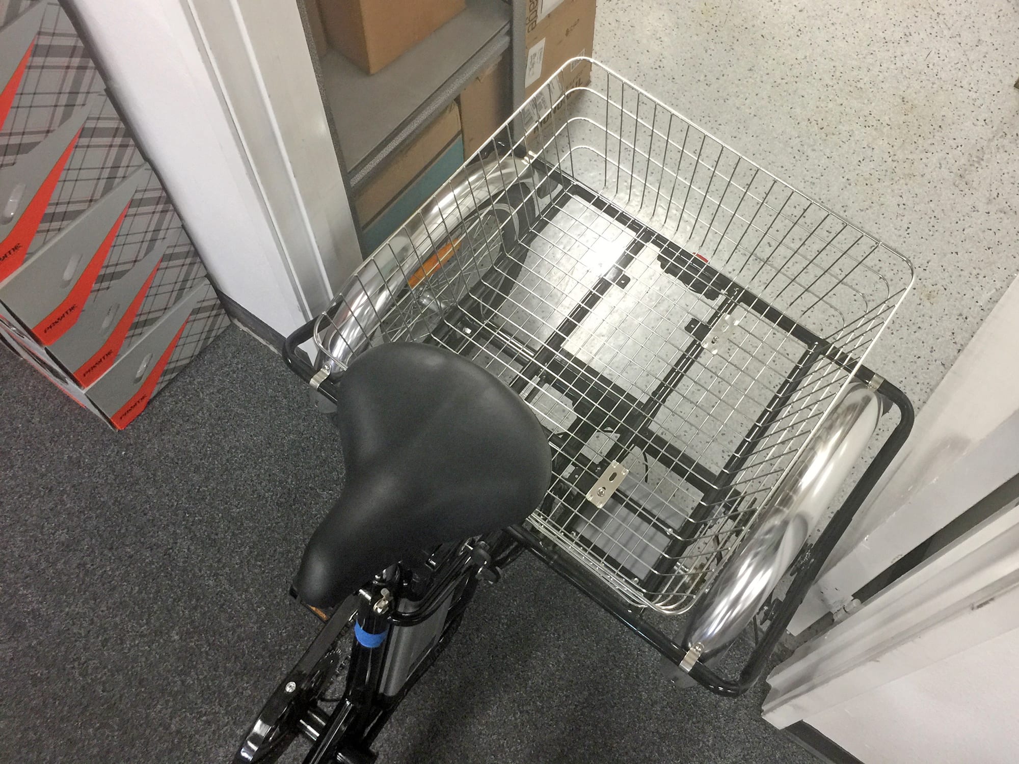

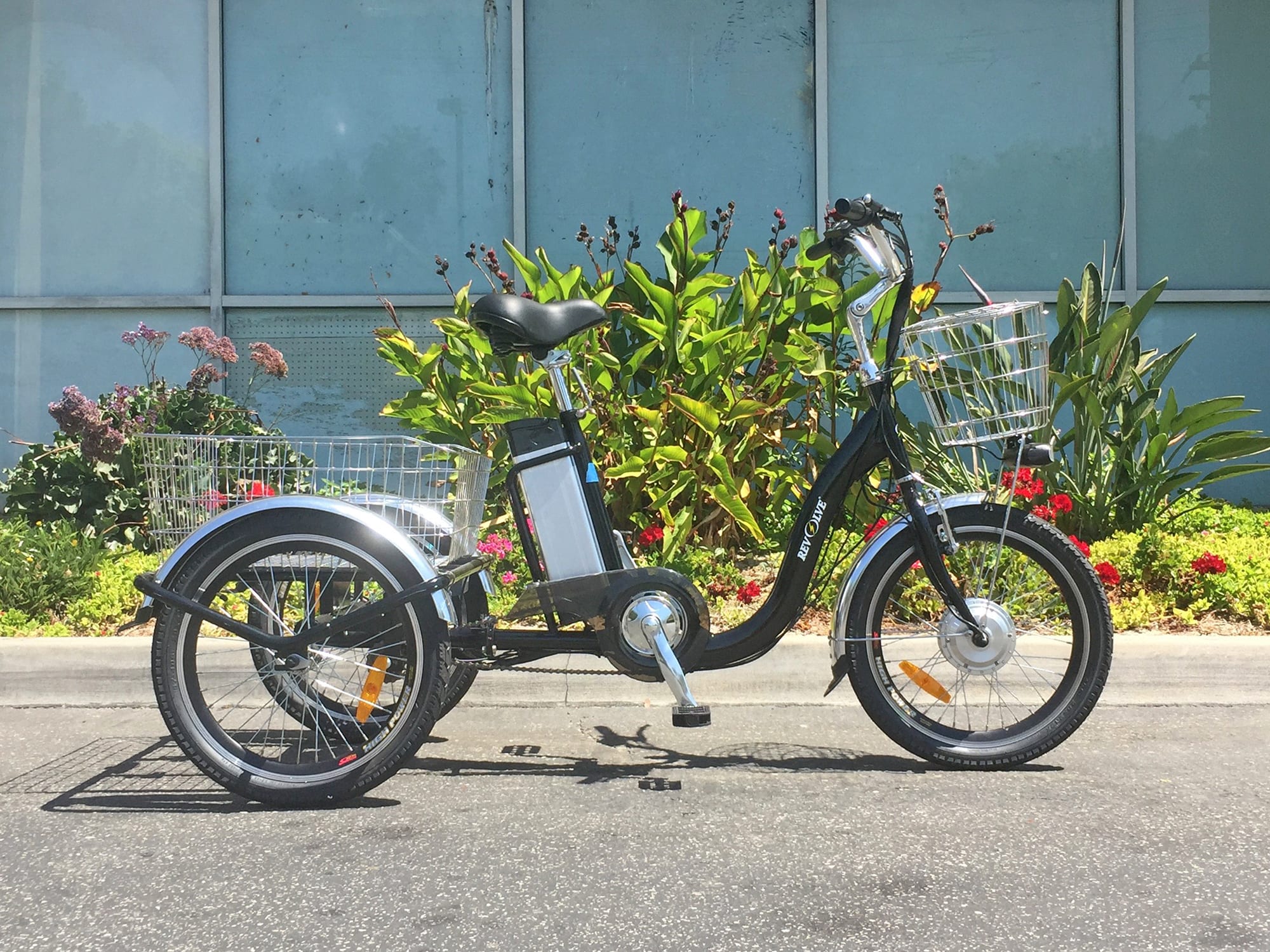

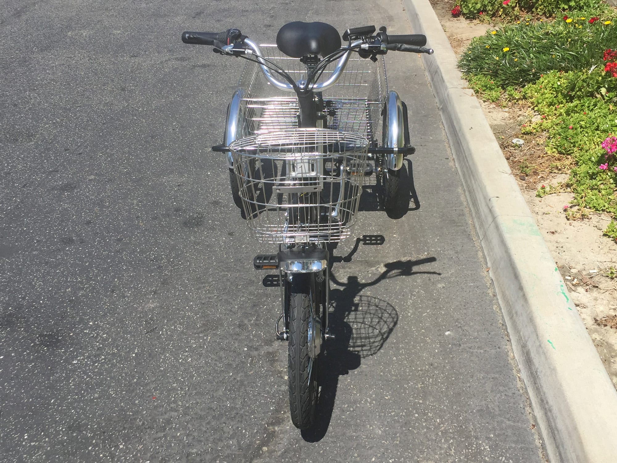

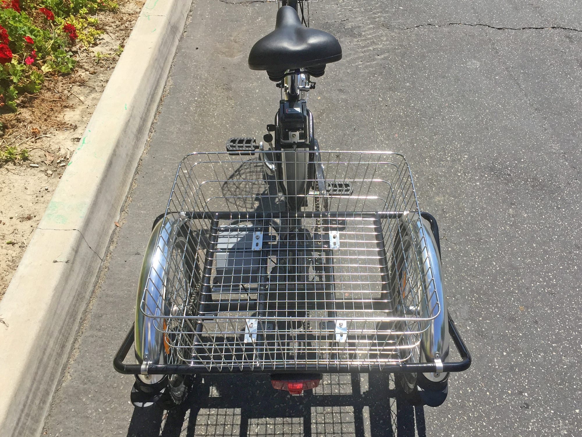

- Electric trikes like this are great because they offer a ton of hauling utility with both a front and rear basket, but they are also stable for loading and riding compared to many two-wheeled electric bikes
- The weight of this e-trike is pretty well distributed with the hub motor in the front wheel and the battery pack at the middle (just behind the seat tube) and that frees up the rear rack area to be lower because many other electric trikes put the battery in or below the rear rack

- All three wheels use the same inner tube size and tire type so you can rotate them or get replacements more easily, the thicker 13 gauge spokes and smaller 20″ diameter wheels improve strength and bring the trike and baskets closer to the ground for easy loading

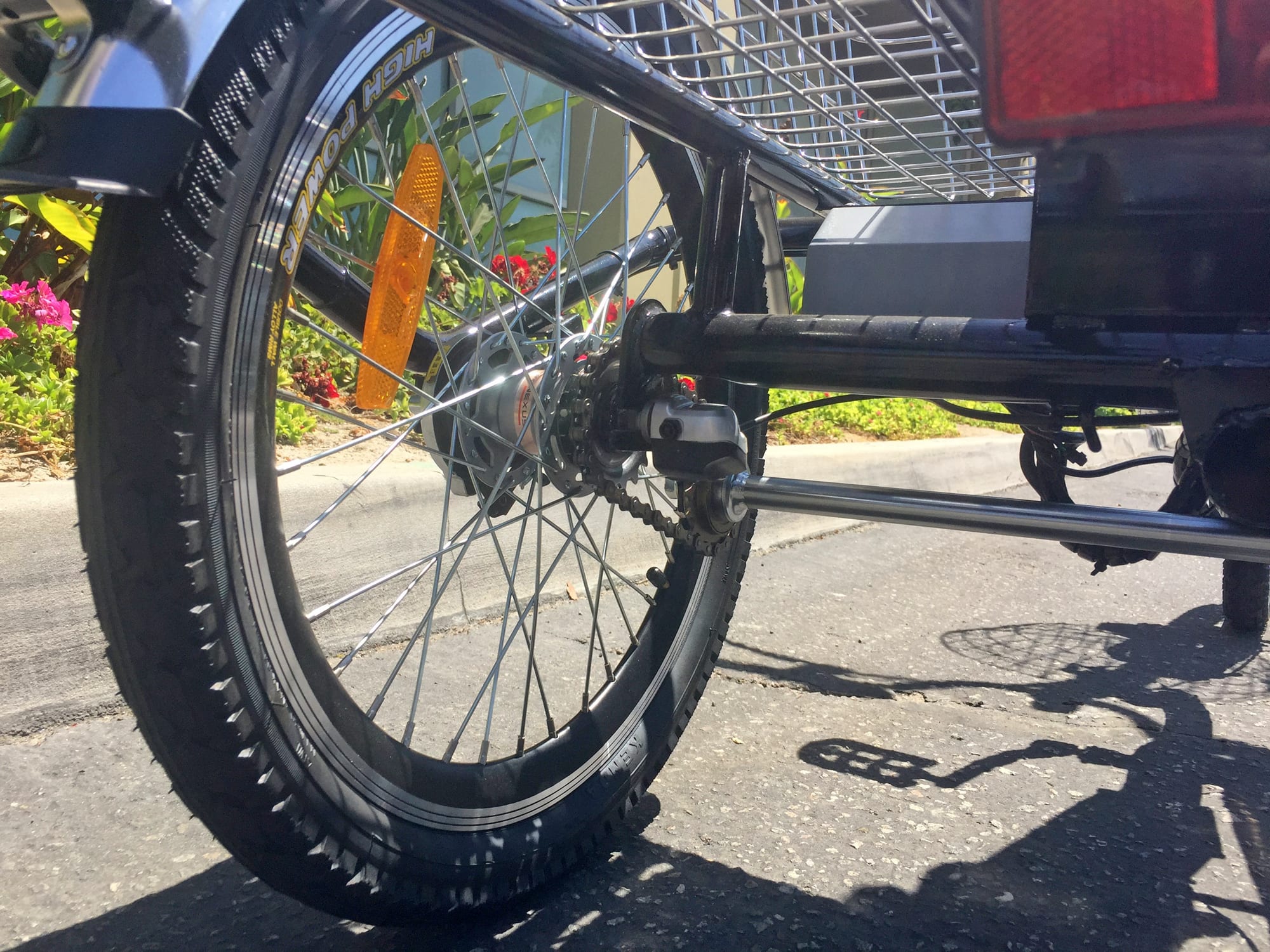

- Some tricycles only have one gear but the Revolve Steady Eddie has a three-speed internally geared hub which provides just enough range to help you start and go faster while also keeping it simple and cheap, internal hubs tend to be more durable and can be shifted at standstill
- I like how the frame tubing surrounds the rear basket and keeps the wheels and fenders protected from walls and other obstacles, I was amazed that the bike can just fit through most regular 36″ wide doors, but Sam told me he has to tip the trike in order to fit through some other doors, the handlebar can turn almost 90-degrees so the bike is easy to maneuver in tight spaces
- I think it’s great that you can charge the battery on or off the frame because you can extend the life of Lithium-ion cells by keeping them in a cool, dry location and then storing at ~50% full for longer periods, if you don’t take the battery off, at least it’s easy to reach where it’s mounted vs. some other designs that put the battery beneath the rear basket
- It’s great that the frame comes in two colors, the black is nice for blending the wires and cables but I might choose white to be extra visible in dark riding conditions
- The lights on this bike are pretty good, the headlight points where you steer and uses two LEDs, it’s mounted beneath the basket so it won’t get blocked, the rear light also uses two LEDs and has a big reflective area, both lights run off of the main battery pack and are operated with the main control pad, they won’t get stolen as easily, left on accidentally, or waste disposable cells like many cheaper lights

- The front wheel drive unit makes a lot of sense because it pulls the bike evenly vs. a hub motor in one of the two rear wheels or some complex two wheel rear-drive system… but it doesn’t get as much traction as a rear wheel because trikes tend to be rear-heavy, there are times when the front wheel might spin

- I like that the saddle can tilt up to allow for easy access to the battery but the seat tube collar is very tricky to use and I had a difficult time securing the seat post and saddle, a standard quick release mechanism would be much nicer in my opinion
- Normally, I’m not a fan of plastic pedals like this which can flex and be slippery when wet… but they also won’t cut your shins up and that could be good for an older rider with sensitive skin or Hemophilia, if you do want bigger gripper pedals then consider these

- Considering how heavy this electric bike is, the motor isn’t especially powerful (though it does get a mechanical advantage being in a smaller wheel) and the brakes are kind of basic, just a rim brake up front and a band brake in the rear, but I love that the brake levers have a parking lock and motor inhibitors that cut power to the motor when pulled for added control and safety
- Minor consideration here, pedaling only turns the rear left wheel vs. both wheels and this could impact steering and wear on the tires differently over time, many trikes do this to reduce complexity
- The battery pack requires you to leave the keys inserted and turned to “on” for the bike to be operational, this means the keys can get bent or snagged easier and will jingle around if you have a keychain attached

- The power cable that connects on the right side of the front wheel (to run the motor) seems a bit exposed and delicate, many hub motors have this vulnerability so just be careful not to snag or bend it because that would ruin the motor

- The front basket is very noisy if it has the lid attachment, I think the bike is going to be louder (like a shopping cart) no matter what because of the mesh baskets… and the motor produces an audible zippy noise as well
