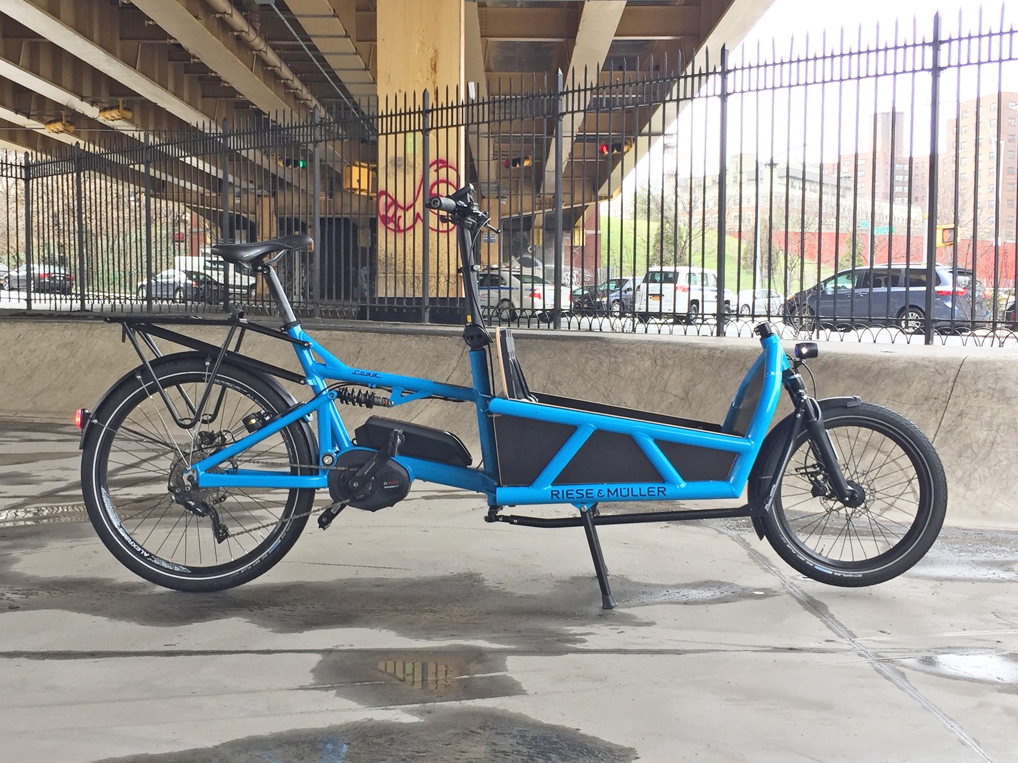

The Load is a spectacular electric bike… it’s an ebike with a trunk! A sporty, front-mounted trunk that’s suspended to protect your valuable items or little people. For this review, I met with Chris Nolte, the owner of Propel Bikes, under the Brooklyn Queens Expressway at the Golconda Skate Park in Brooklyn New York. It just so happened to be raining, so this covered skate park gave us an opportunity to stay dry and experiment with curbs and ramps, testing out the front and rear suspension systems. The Riese & Müller Load comes in four flavors, two with high-torque Bosch CX motors and two with the Bosch Performance Line Speed motor offering 20 mph and 28 mph top speeds respectively. You get to choose from a traditional ten-speed Shimano Deore XT drivetrain with sprockets or the NuVinci continuously variable transmission which is slightly heavier but can be shifted at standstill. Both use chain drives vs. belts because of the way the the rear swing arm is setup. The specific model I test rode in the video review was the Touring HS which is the 10-speed high-speed option. I wasn’t sure how I’d feel riding a cargo bike above 20 mph but came away very impressed and excited. This product behaves a lot more like a standard ebike than a cargo model, the two-wheel setup is easier to turn and maneuver than other three-wheled cargo bikes but you still get a front bucket that’s easier to manage while riding… you just look down. For those with an infant or young children, the front-bucket gives you more chances to communicate and eliminates the need to twist backwards or look over your shoulder and perhaps get distracted while also managing gears and assist level. While the frame only comes in one size, the extra-long seat post, telescoping stem, and adjustable angle on the stem make it versatile. You can adapt the bike to fit tall and short riders, and as the seat gets raised, it naturally moves backwards because of the angle. I enjoyed the soft gel saddle, ergonomic grips, and medium-sized city tires. They smoothed out the bumps but still felt efficient, and they also increased safety. Notice the silver stripes of reflective material lining the sidewalls of the tires? These strips are highly visible in low lighting conditions and compliment the front and rear LED lights that run off the main battery pack. These lights are thoughtfully engineered and upgraded from the generic products I see on entry-level ebikes. The headlight is mounted in such a way that it points where you steer, it has windows on the sides to help you be seen from multiple directions, and it has a cutoff section towards the top so it won’t blind oncoming traffic. By default, with the high-speed version of this bicycle, the lights come on automatically, any time the bike is powered up. The final safety option comes down to your style preferences, Riese & Müller offers the Load in four colors including white. This option would be the most visible at night when riding in traffic, but the Lime Green would also be a good choice and I have to admit, the Cyan Blue looks beautiful. I guess Black is alright for people who want a more masculine look or are going for timeless. The standard touch points are black and silver but Riese & Müller offers five alternative colors to really spice things up. If you choose one of these alternatives (including a replacement for the standard black) they install SALTPLUS BMX parts instead. And this brings us to one of the big considerations with any Riese & Müller e-bike product in the US, aside from price, you have to custom order it because they build to suit. This adds additional wait time (from one to two months) from the moment you decide to pull the trigger.

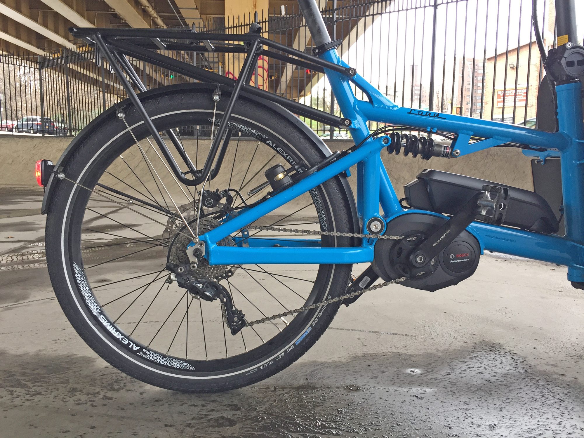

Driving the Load is one of two motors, as mentioned earlier, but they have a lot in common and I believe the underlying hardware is the same. Bosch is the maker, and they’re one of the best and most sought after in the market at the time of this review. You may have heard about Bosch before ebikes because they also make power tools, car parts, washing machines, and a whole range of other heavy duty hardware. This motor system is in its third generation and I hear from shops all around the world that it is one of the most reliable. The controller measures rear wheel speed, pedal speed, and pedal torque, one thousand times per second! It uses this feedback to help you start from rest more easily. And that’s a big deal given the 73 lb unloaded weight of the Load. If you’ve got kids or cargo in there and are starting on an incline, a motor like this is ideal… and perhaps the NuVinci CVT drivetrain, which can be shifted at standstill. In addition to pedal signals, the Bosch controller also listens for shifting signals and eases power off so the motor won’t strain the chain, sprockets, or derailleur. It’s not a foolproof system because you NEED to shift hard sometimes and it’s important to have motor power kick in based on riding first, so you can still mash the gears if you’re not thoughtful. I usually ease off a bit when shifting… it works pretty well and it’s something you get used to. This motor is positioned low on the frame and reduces unsprung weight compared to a hub motor. It improves balance front to rear and has a plastic cover to keep it protected from minor bumps and scrapes. Note that the chainring is extra small compared to traditional hardware. It spins at roughly 2.5 times your own pedal speed and produces a high pitched whining noise at the higher RPM levels. You can see and hear it in the video, and there’s a plastic cover to help your pants or dress sluff over the side vs. getting greasy and snagged.

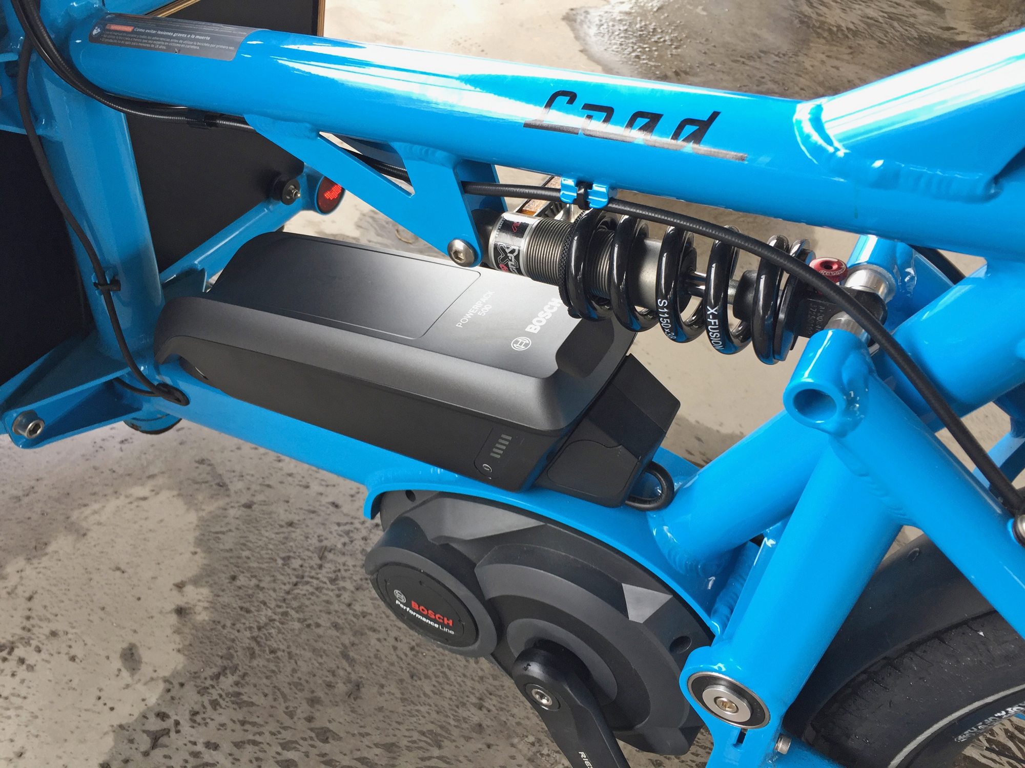

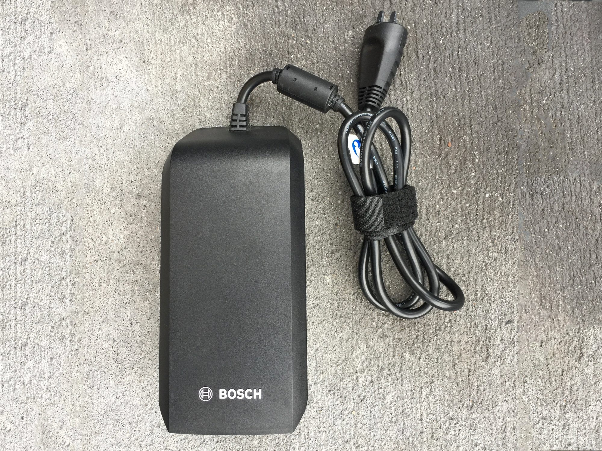

Powering all current versions of the Load is one or two Bosch Powerpack 500 batteries. This pack is 25% larger than the second generation pack which offered roughly 400-watt hours, but only weighs 0.3 lbs more. It looks nearly identical and the mounting interface is actually backward compatible so you can use older batteries you might have from previous electric bikes. While the pack is not as integrated as some of the fancier road and mountain bikes, it is easy to access, charge on or off the bike, and protected from all sides by frame tubing. If you opt for a second Powerpack 500, which must be done at the time of original purchase because it requires a different display, they will add a mount on the back-left of the cargo box. This does imbalance the bike very slightly, but keeps the pack out of harm’s way, protecting it from frame bumps and water. I love that all versions of the Load come with front and rear plastic fenders. These won’t bend like Aluminum, they won’t rust like Steel, and they tend to be very light… but can rattle. So R&M have reinforced them with extra support arms. Notice how quiet the bike rides in the video review when I mount my camera in different locations. The fenders are different sizes because the wheels are different sizes. From a design standpoint, this makes steering easier, allows you to see down in front of the bike easier, improves the strength of the front wheel, and lowers the center of gravity on the bucket. When you really study the frame, you start to appreciate the excellent ground clearance between the wheels but also how low the front box is, making it easier to load or climb into for kids.

- This is one of the only high-speed full suspension electric cargo bikes I have ever seen, and it feels stable at higher speeds vs. wobbly like a lot of others
- Nearly all of the hardware weight is suspended, even the optional rear rack, this allows the suspension to work more efficiently while protecting sensitive electonic parts like the motor and battery, many other e-cargo bikes use hub motors and have no suspension

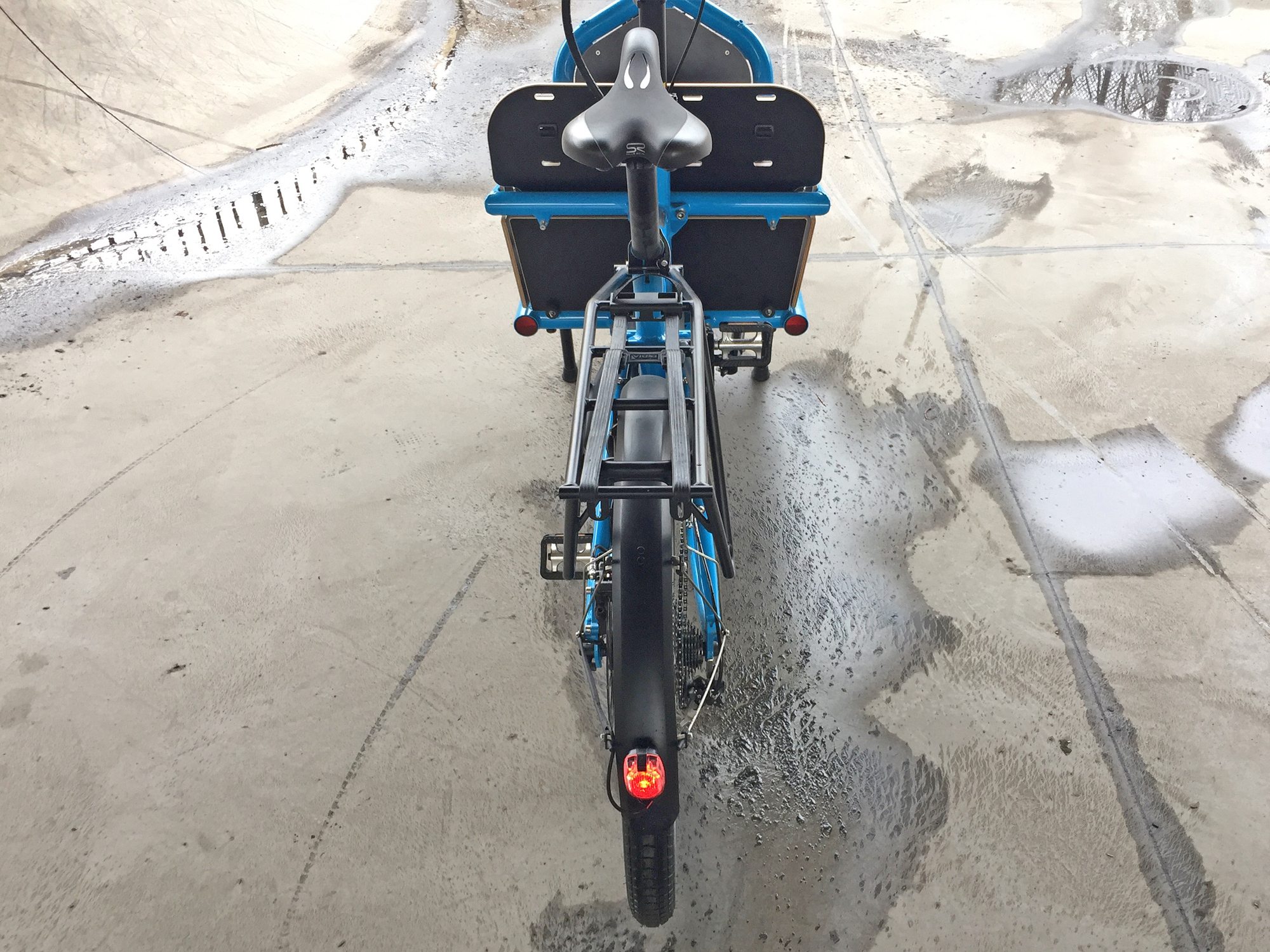

- Integrated LED lights help you stay visible, I love that the headlight points where you steer, the bike is offered in four colors choices including white, which would increase your visual footprint from the side in low light conditions
- Note that the headlight has two little windows on the sides, this allows cars to spot you from more directions,

- The suspension elements are adjustable, you can swap out springs to increase or decrease stiffness at the rear and fine tune preload on the fork (though it does not have lockout)

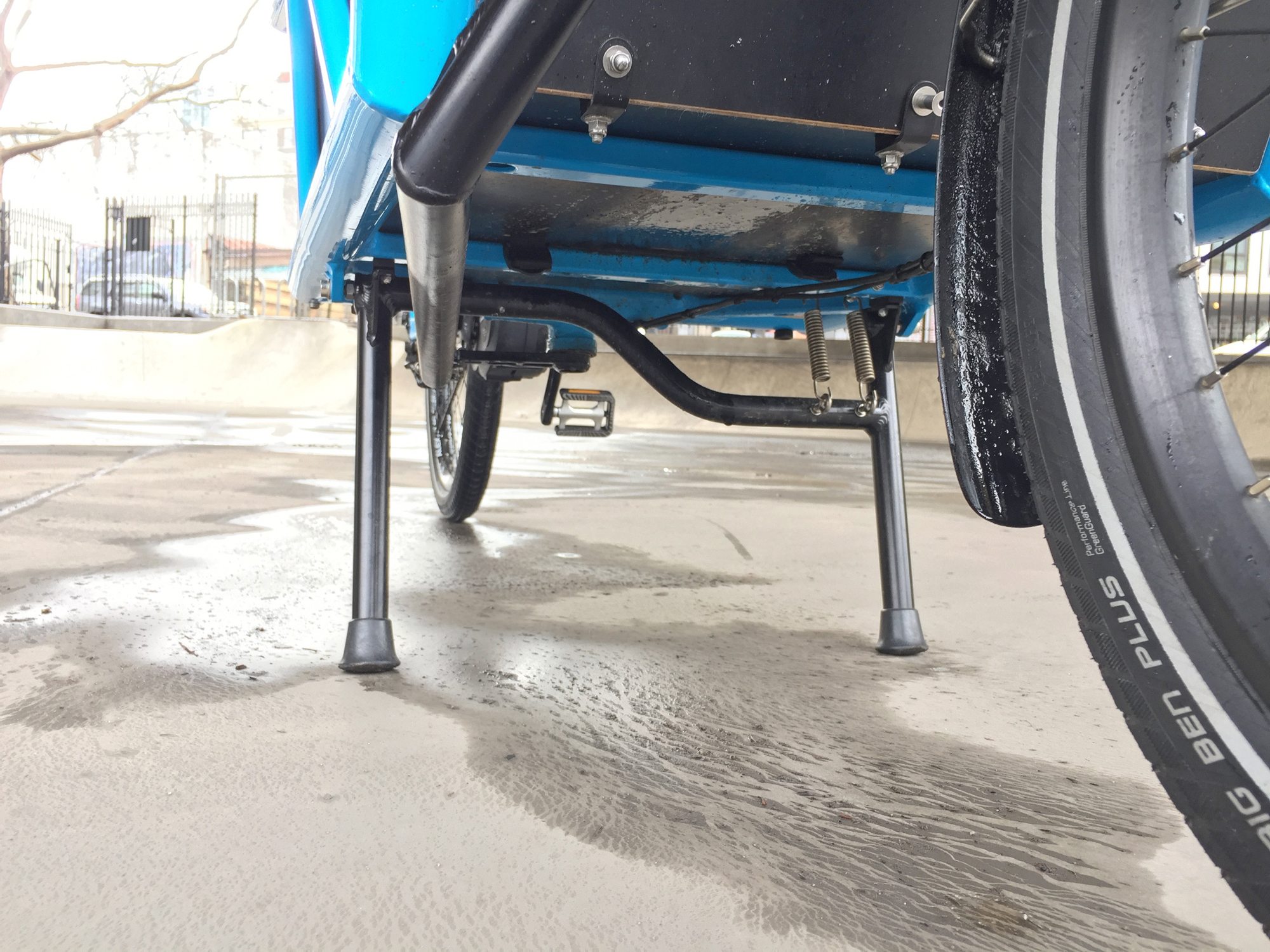

- A heavy-duty, custom made, double-leg kickstand supports the bike well, this makes it easy to load while parked but stows quickly by pushing the bike forward when you’re ready to go

- It comes stock with the latest Bosch Powerpack 500 which offers 25% more capacity than the older Powerpack 400,
this is especially useful in a hauling scenario or if you ride faster (as with the HS version here) because efficiency drops significantly above 20 mph due to air resistance - The Load can be fitted with a second Bosch Powerpack to increase range, they mount it to the back left side of the cargo box and you have to order it when you get the bike because it uses a slightly different display which balances the packs, using the second mount is nice because it locks the battery to the bike and might extend the life of both by keeping them in the 20% to 80% range vs. completely draining one pack then physically swapping in another

- Both the battery pack and display panel can be removed for charging, safe storage, and reduced bike weight during transport, I love that the battery has an integrated loop handle to reduce accidental drops

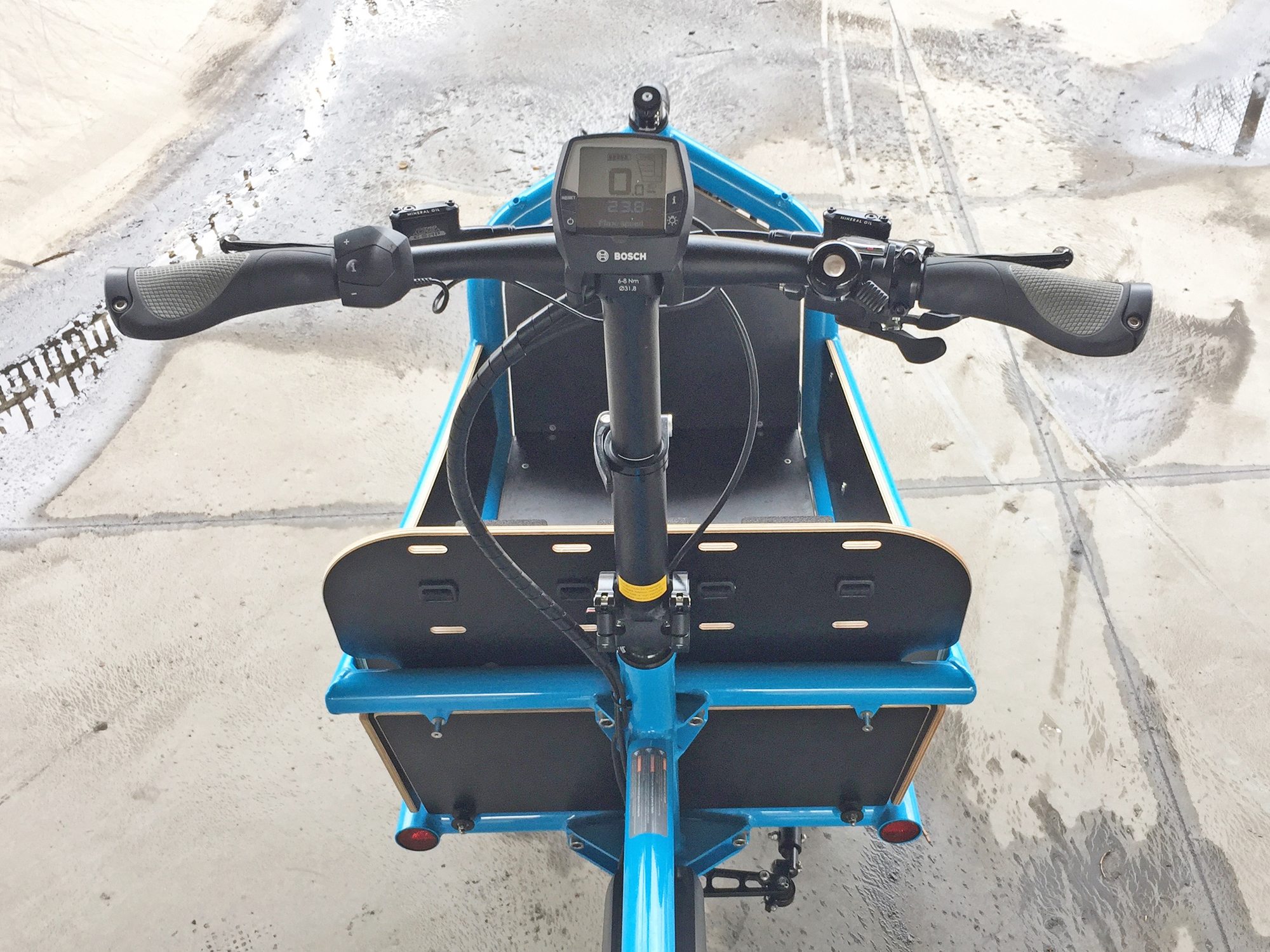

- The display panel is large, easy to read, and backlit for use in the early morning or at night, it has a five volt Micro-USB port on the right edge which can charge a mobile phone or other portable electronic device when riding
- Considering the extra focus required to balance (and perhaps monitor children) I feel that the Bosch drive system was an excellent choice because it is smooth, intuitive, and easy to adjust without looking down, you can memorize the up, down, and i buttons very quickly and they feel obvious and click when you press

but you should hit as many bumps with this bike as you might with a trike because the two wheels are easier to steer around obstacles than three - Given the added weight and potentially higher top speed of this bike, I was delighted to see upgraded hyddraulic disc brakes with 160 mm up front and 203 mm in the rear (that’s mountain bike sized), the adjustable-reach levers are nice for if you’re wearing gloves or have small/large hands
- If you go with the Touring models (which use a 10-speed Shimano Deore XT drivetrain vs. Nuvinci CVT) the front and rear wheels are both quick release which makes fixing flats, doing maintenance, and moving the bike faster and easier (though the wheels could also get stolen easier too)
- This bike has walk mode which is handy if you’ve got a bunch of stuff or a kid in the front and are trying to maneuver down a sidewalk or through a crowd, it lets you focus on stabilizing the bike without struggling to push at the same time (press the walk mode button on top of the button pad near the left grip and then hold plus to get it working)
