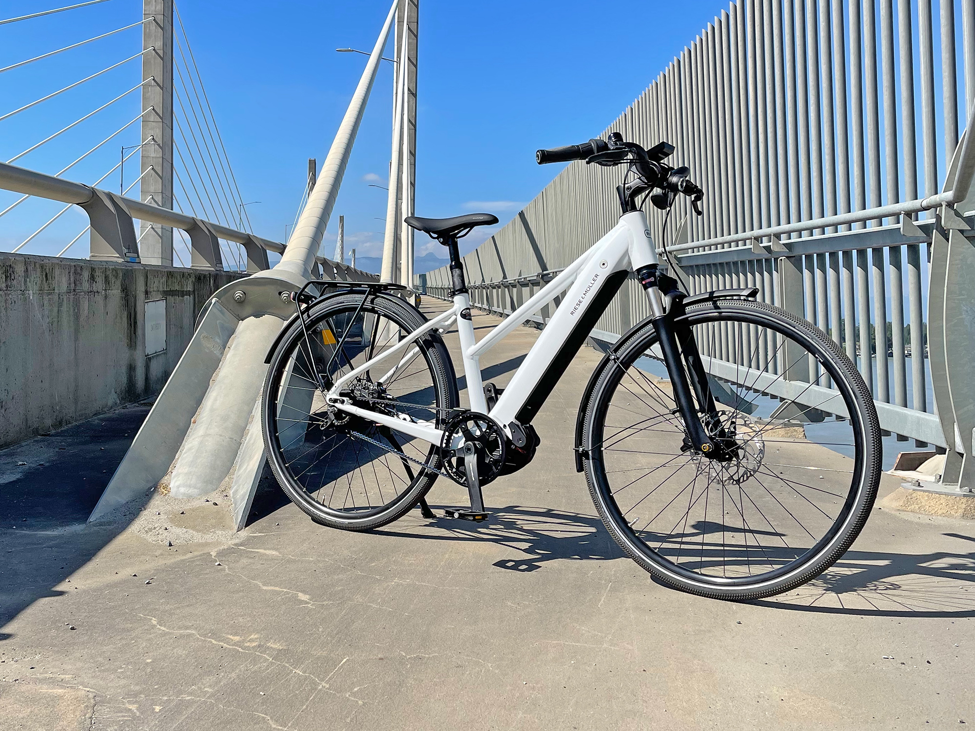

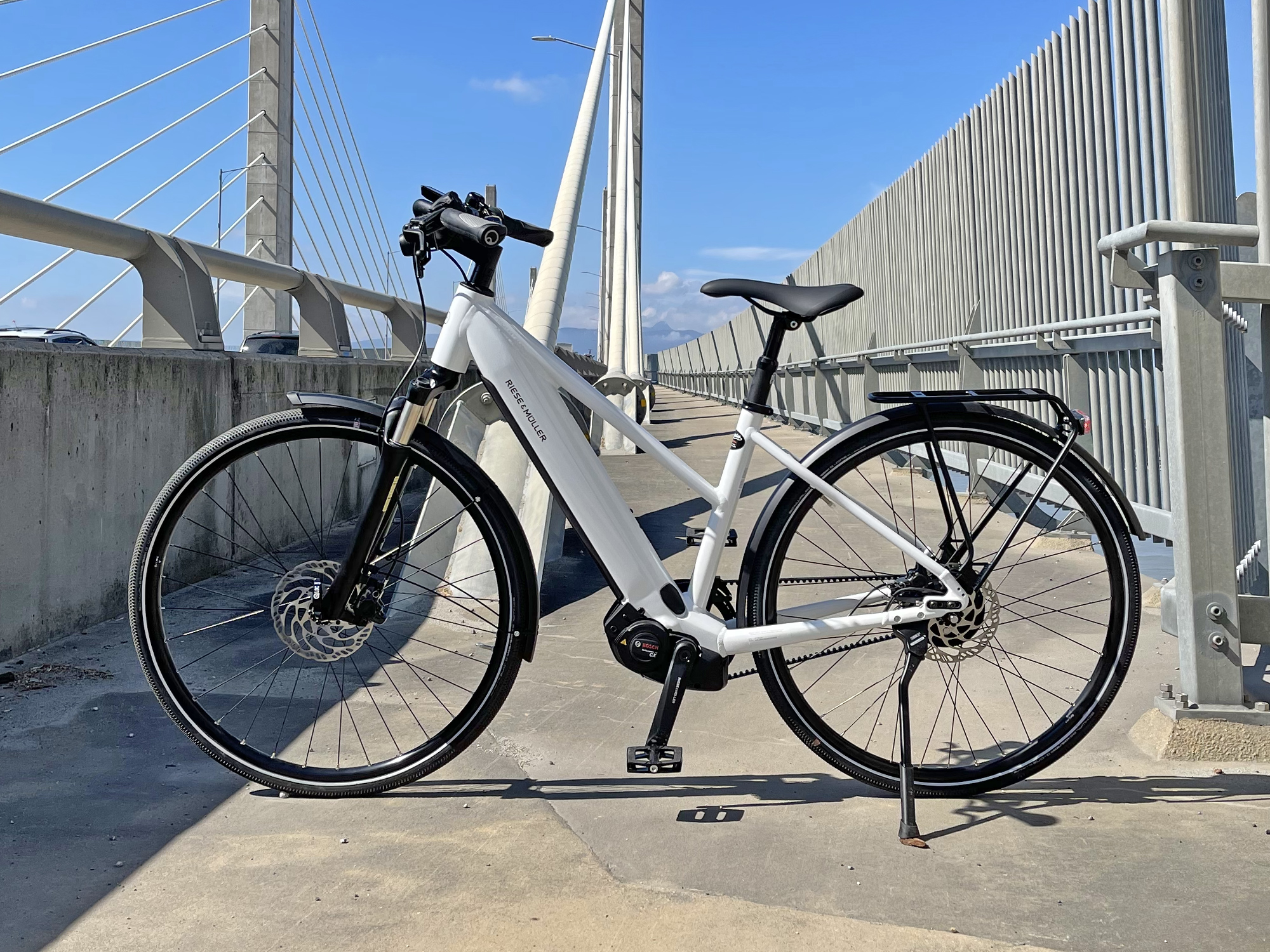

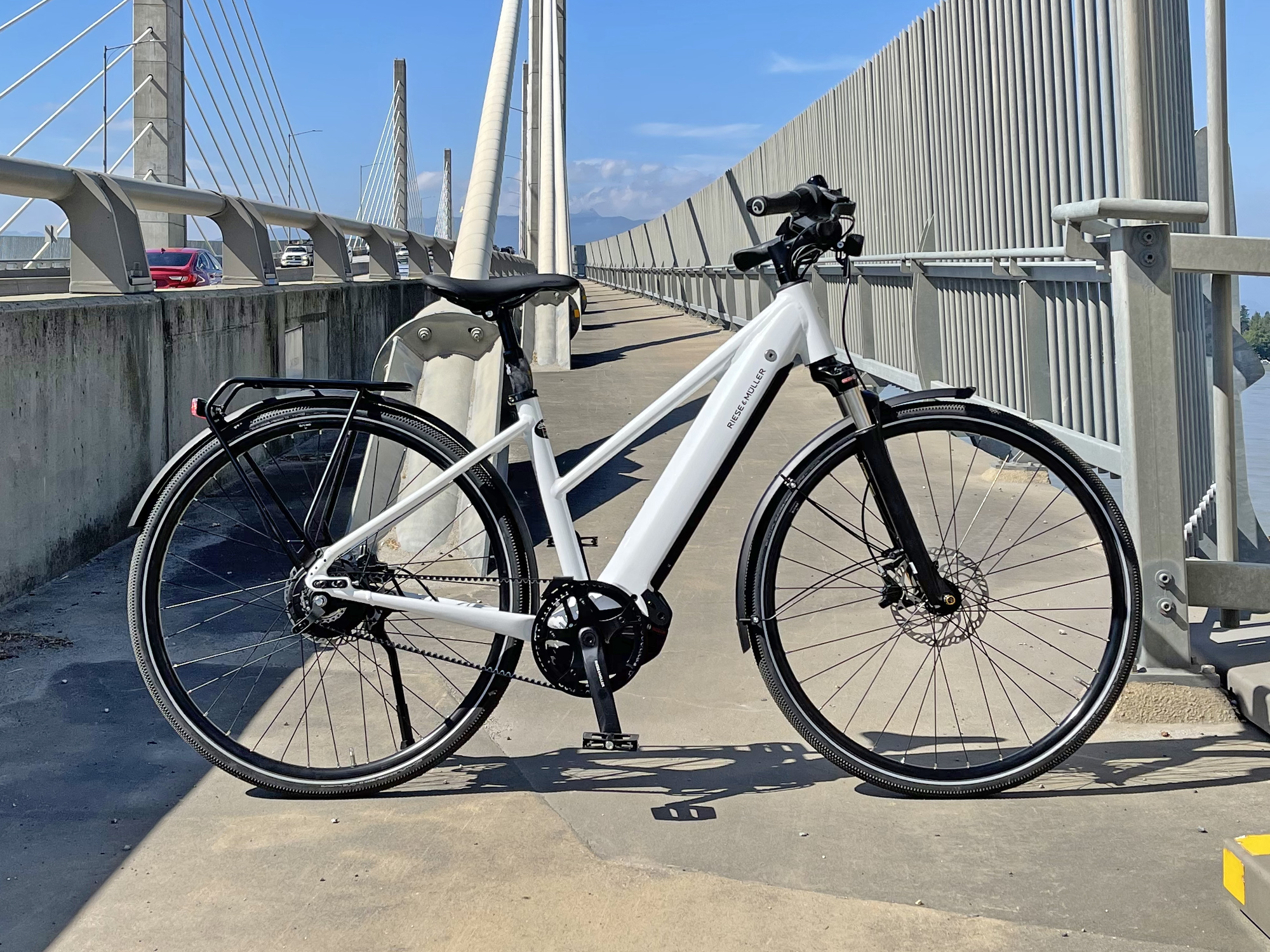

- The Roadster is available in high-step or mid-step “mixte” frame style. It comes in two sizes, to improve fit, and two colors. I test rode the smaller 45cm mixte frame in gloss white, and it had several upgrades including the rear rack with nicer 2-LED light, the comfort package with suspension seat post, swept back handlebar, and ergonomic grips, and the Bosch Nyon large color LCD display with mapping directions. These upgrades increased price by roughly $450 USD.
- The Vario word in the name relates to the Enviolo continuously variable transmission (CVT hub) that allows for stepless shifting. You can even change gears at standstill! It’s roughly equivalent to an 11-36 tooth cassette and adds about 2lbs to the total weight of the bike. You can go with the 11-speed version of the bike to save weight and get a wider 11-46 tooth spread, which also costs less but uses a chain instead of the Gates Carbon Belt drive. Depending on the country where you buy the bike, you may get the Bosch CX Class 1 motor or Bosch Speed Class 3 motor that goes up to 45km/h (28mph) but is otherwise roughly the same weight and produces very similar 85nm peak power output.

- An “all around” hybrid from one of the highest quality brands: Riese & Müller. The Roadster is sporty, works well on pavement, can handle gravel and light trails, and offers tons of utility. It comes in many configurations, and offers some unique hardware such as the Gates Carbon Belt drive and Enviolo CVT hub (both shown here).

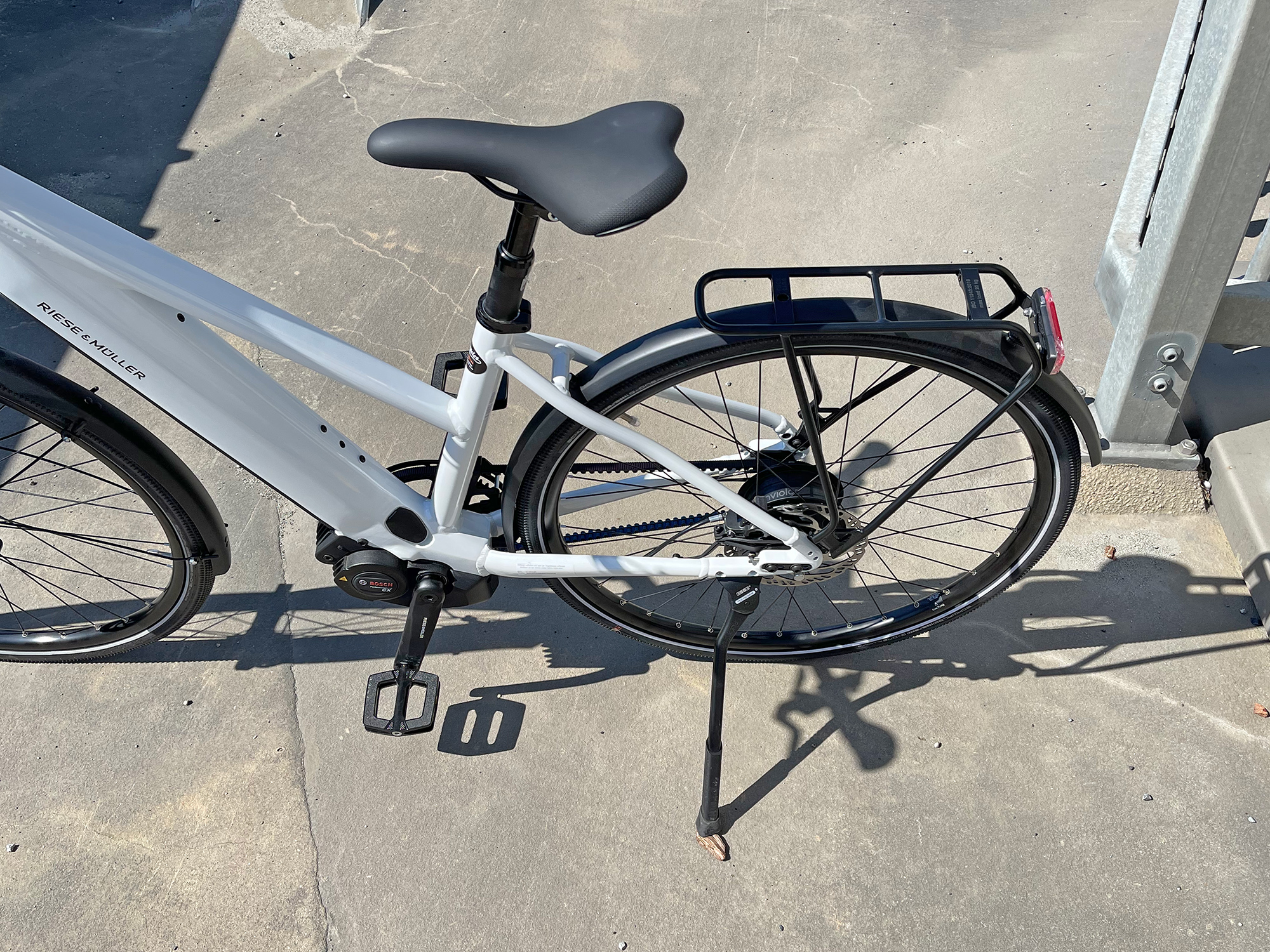

- In addition to the rear rack, there is also a front rack option for carrying even more gear. I love the bottle cage mount on the downtube, and appreciate how well the fenders are mounted. There are additional threaded eyelets at the rear for adding your own rack if you prefer that to the R&M RackTime option.

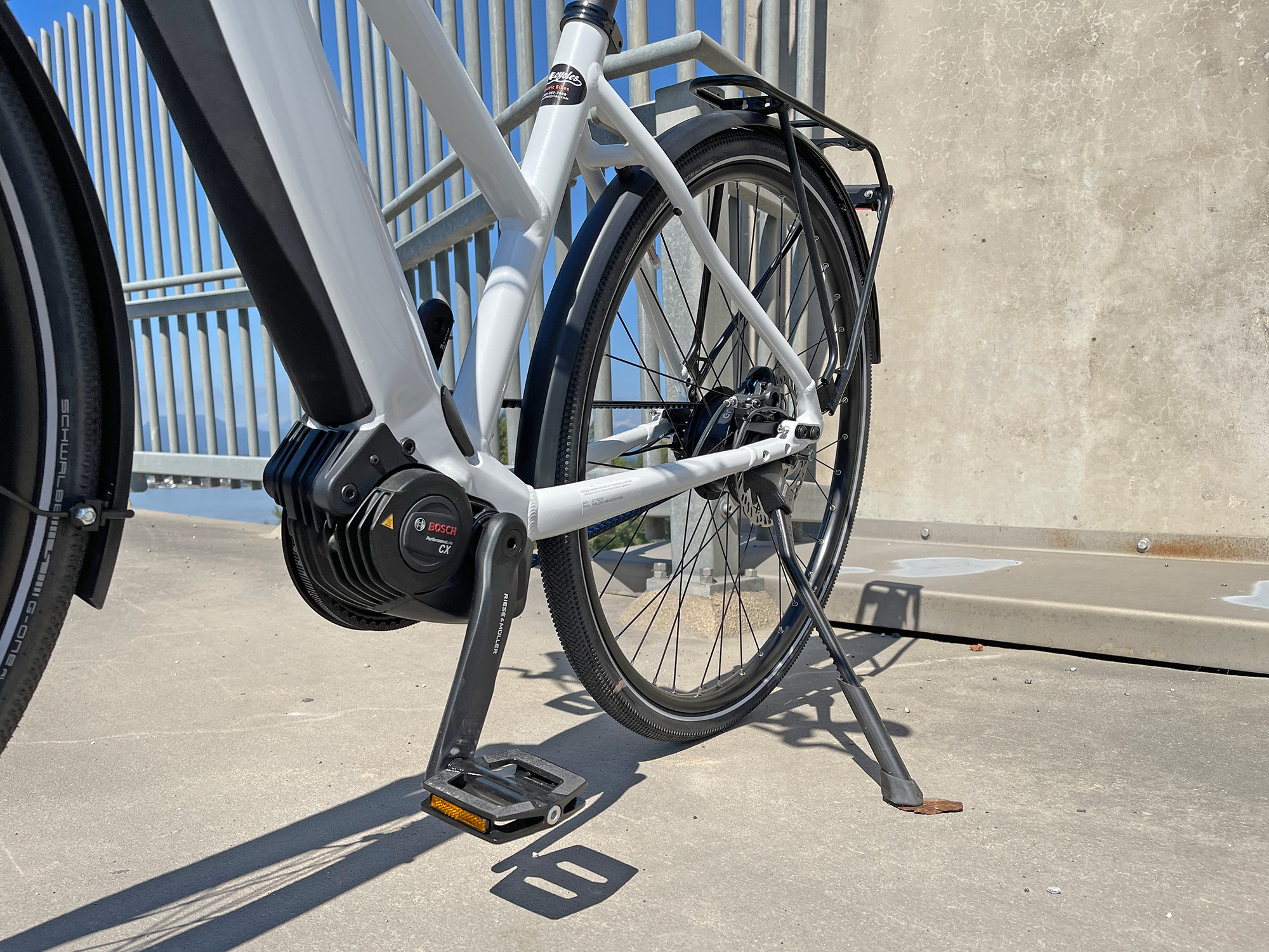

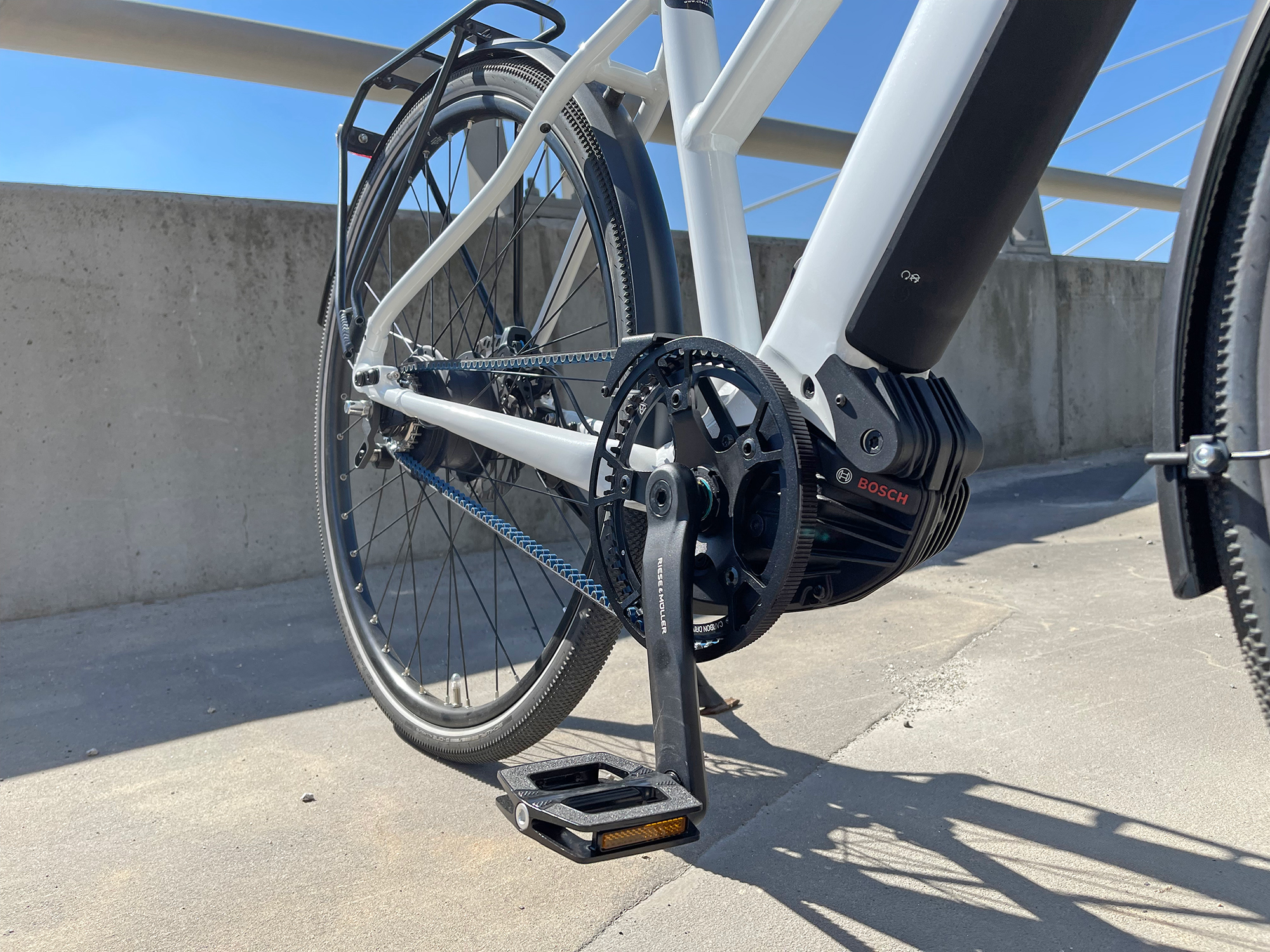

- The 4th generation Bosch Performance Line motor is compact and light at just 6.39lbs, because it has a magnesium casing. It measures rear wheel speed, pedal cadence, and pedal torque over 1,000 times per second, and offers shift detection to reduce drivetrain wear.
- The rear wheel speed sensor is more hidden and durable than the older spoke magnet design. This will reduce the possibility of read errors, and helps keep the rear wheel more balanced. I also noticed some minimalist plastic casing around the motor casing to keep dust and water out, and protect against trail contact.

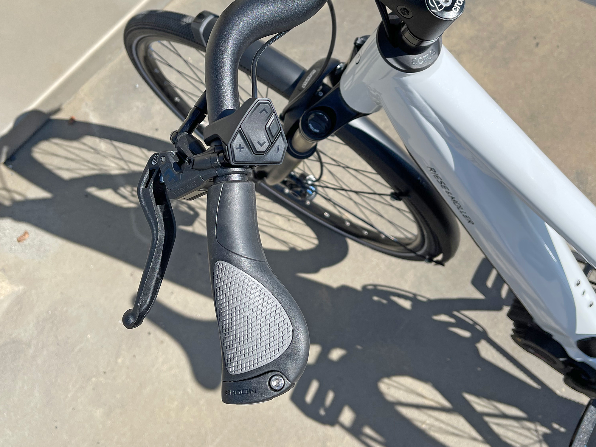

- Excellent touch points, I love the sturdy platform pedals with grip tape because they won’t damage fancier shoes but still provide great surface area and stiffness. The locking ergonomic grips from Ergon are excellent, reducing hand numbness and tingling.

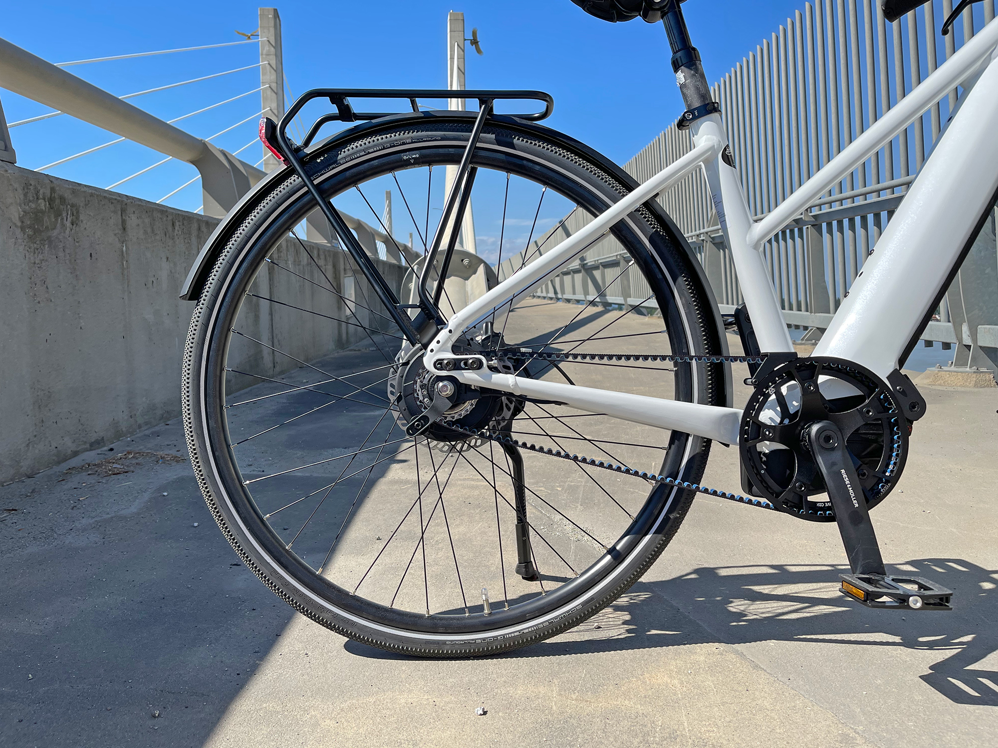

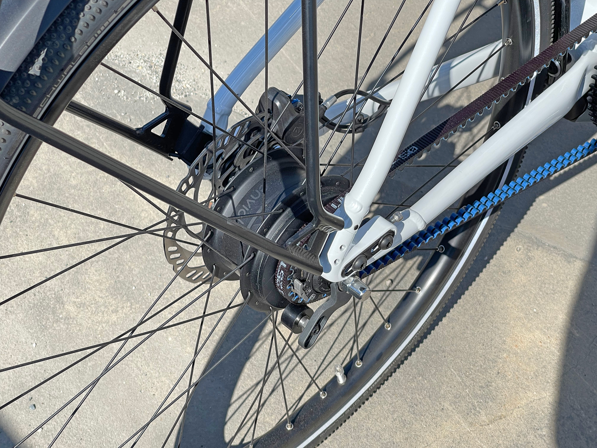

- For those who want a durable and clean drivetrain, the Enviolo continuously variable transmission hub with Gates Carbon Belt drive are perfect. There’s no derailleur hanging down that can get bumped at racks, and the belt will last longer and run cleaner than a chain. It’s super quiet and smooth, though it’s not quite as responsive or efficient as a chain in my experience.
- Notice the metal chainring guard that protects the belt and bottom bracket. The metal guide on top, that clears debris and reduces any kind of drop (possibly clearing pants and dress above too). And, there’s a belt tensioner at the rear. R&M go above and beyond here, especially for a hybrid model. The drivetrain on the Vario setup is thoughtfully done.

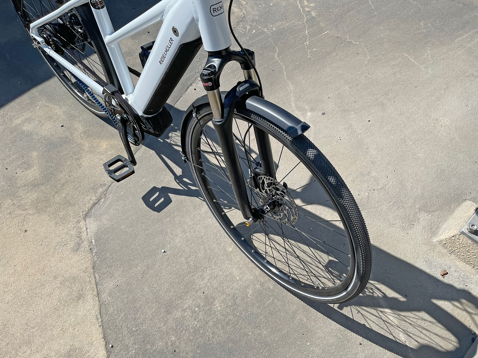

- Excellent kickstand positioning and adjustability, as yo’d expect. It doesn’t get in the way, and doesn’t bounce around while riding off-road. I want to call out the front fender attachment as well, because the support arms mount to the metal housing directly with bolts vs. plastic cuffs and have two support arms on each side!
- Very high quality hydraulic disc brakes from Magura. The MT4 and MT5 levers actuate very smoothly, and have adjustable reach levers. If you get the Speed motor, the levers also activate the rear light like a brake light. Large 180mm rotors provide a good mechanical advantage and cooling properties. The calipers are also great, with larger pistons and contact pads.

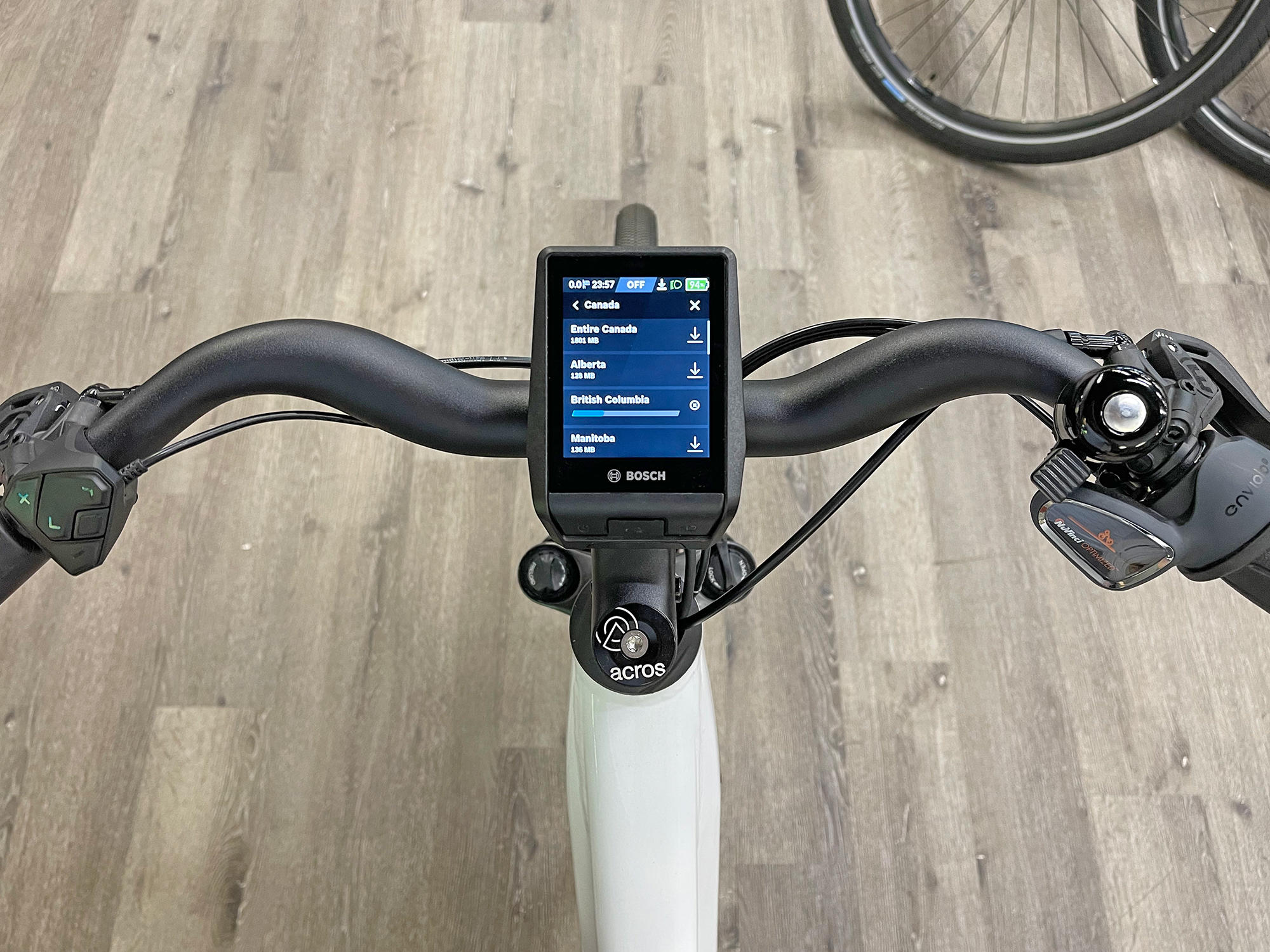

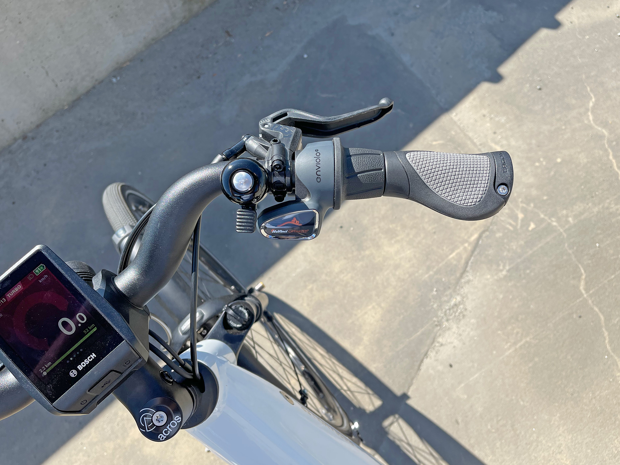

- Whichever display you choose, the Bosch ecosystem is reliable and intuitive. I really like the Purion for how simple it is, but the Smartphone Hub and Nyon in particular are my favorite. You get turn by turn directions, can charge your smartphone, get access to motor tuning, sports integration, and over the air updates.

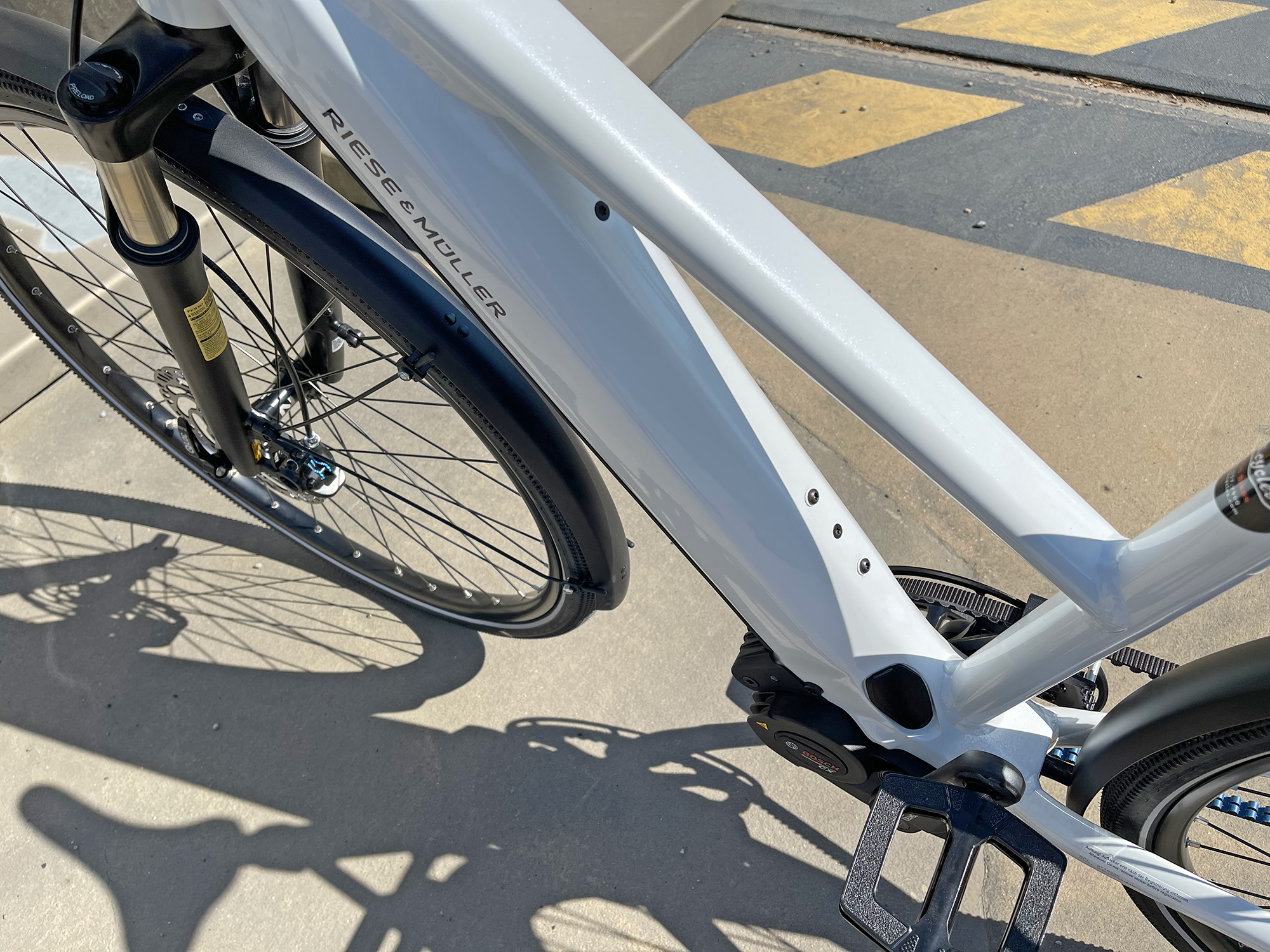

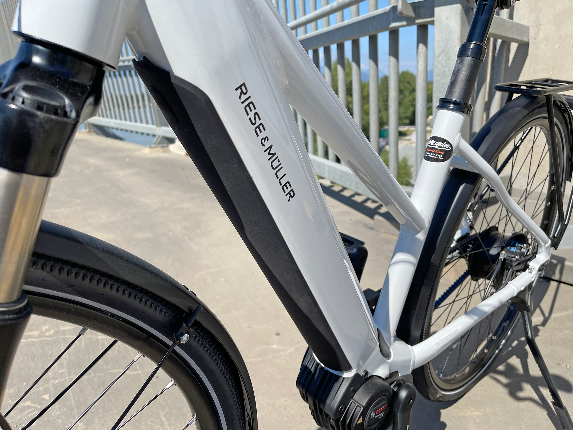

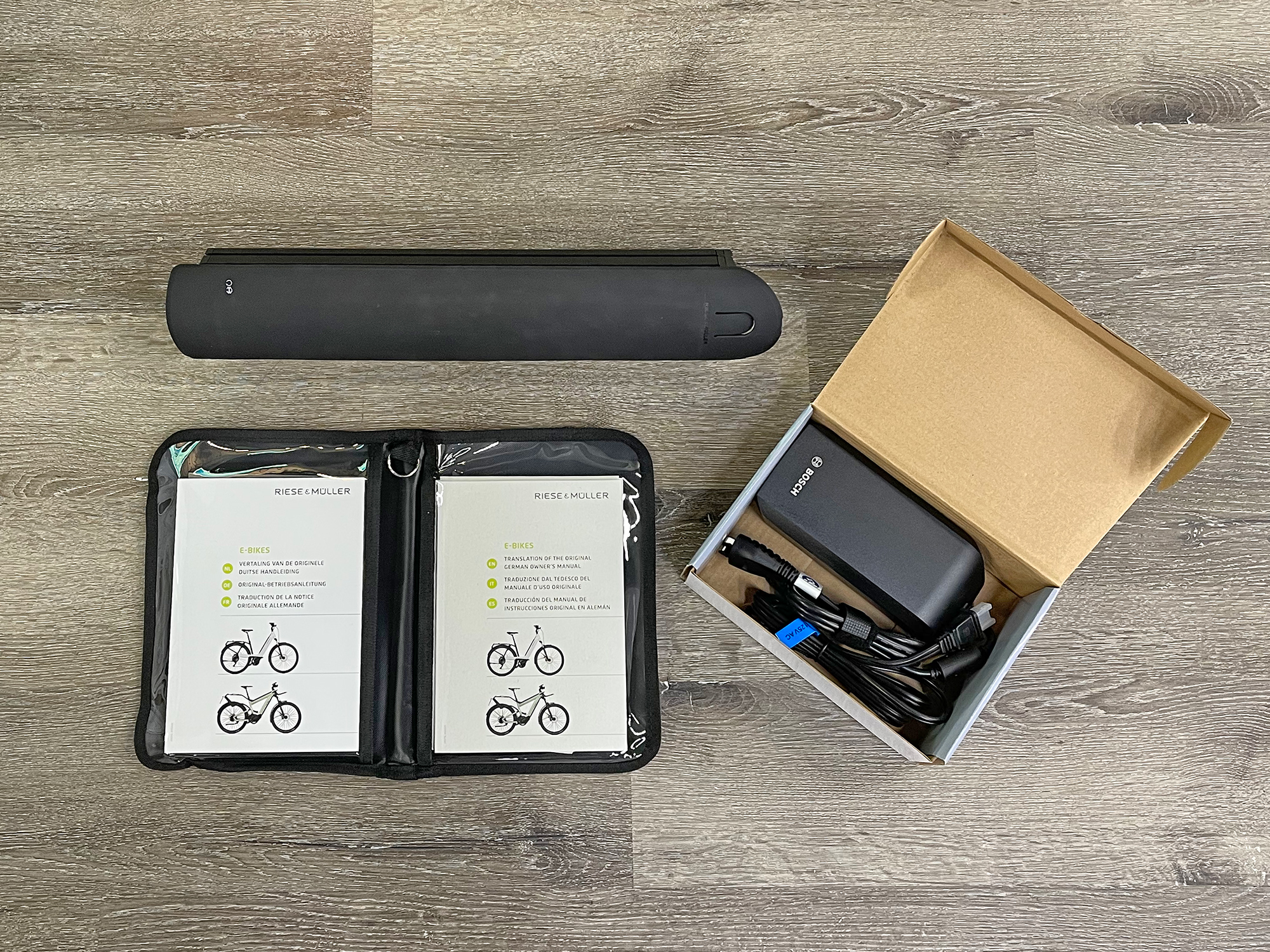

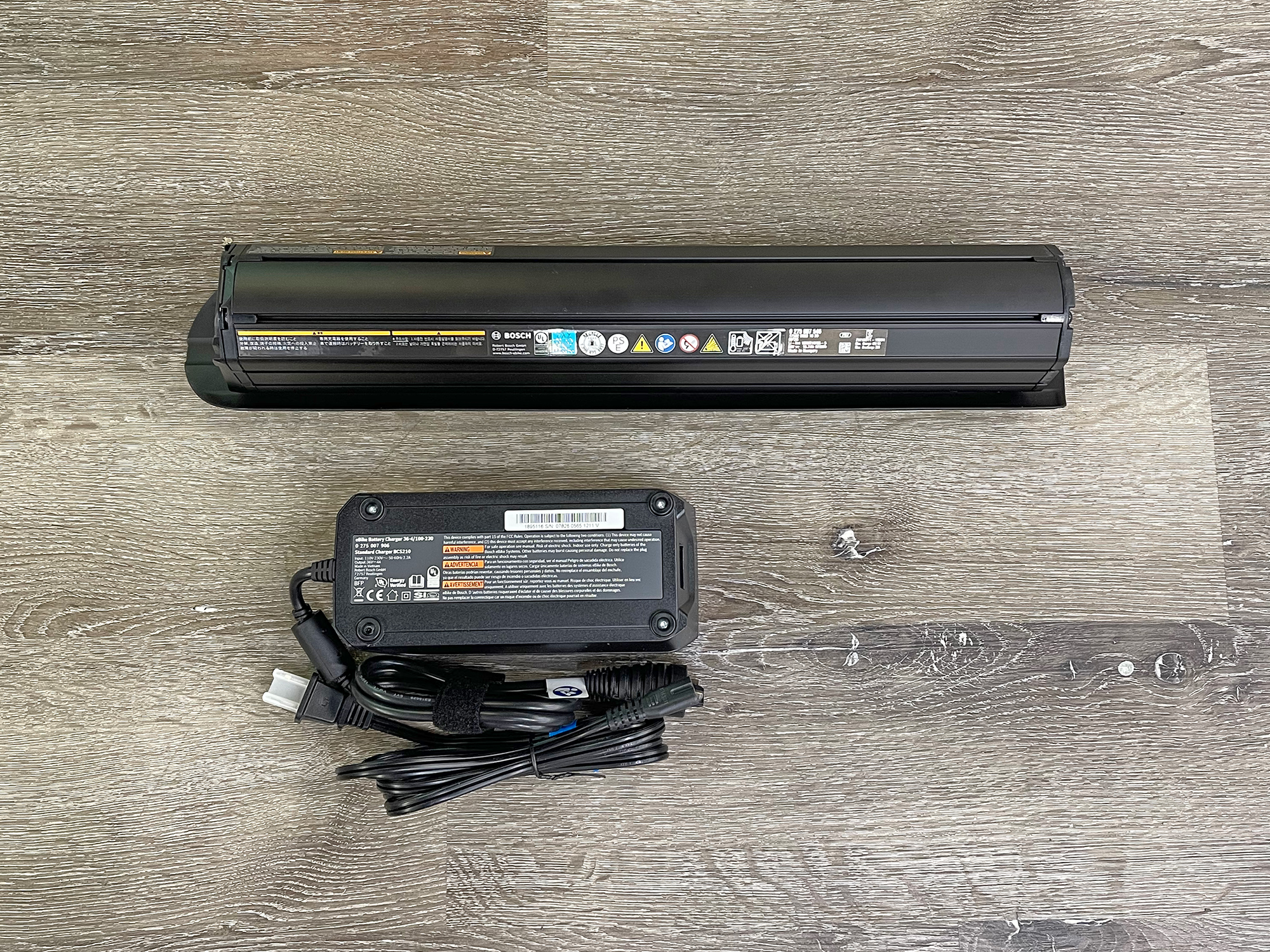

- As nice as the PowerTube batteries look, they can be difficult to mount because of limited clearance between the downtube and front fender. To actually get it into the frame, you have to actively twist the key while inserting the battery. Thankfully, the pack can be charged while in the frame. That said, the charging port is pretty low on the left side of the frame and in the path of the crank arm, so it can get a little crowded.

- If you choose the most basic Purion display or the fancy Nyon system s hown here, it won’t have a USB charging port. To get that, you need to pay more for the Smartphone Hub. Both Smartphone Hub and Nyon are compatible with smartphone apps.
Alex says
Thanks for the review Court! I want to share a correction – the microUSB port on Nyon display can NOT be used to charge other devices – it only suitable to charge Nyon itself when it is not mounted on the bike. Know this for sure since I got Purion -> Smartphone hub -> Nyon on my bike and rode with all of them for a while. Bosch is pretty disappointing in this aspect unfortunately.
Court says
Oh wow! That’s crazy, thanks for checking in… I should have tested this but didn’t have the correct charging cable (Micro-USB to iPhone Lightning plug). The port is so prominent, I just assumed it would work. Thanks Alex.
Alex says
This is total wasted opportunity for Bosch here! Their lower end displays like Intuvia and Kiox has charging feature, so everyone would assume that newer and more advanced display will also have it. But Bosch is Bosch and they totally screwed this part up :( This was discussed multiple times on forums here and was confirmed by Bosch guys.
Court says
Thanks for the link Alex! It’s confusing to not see charging here when it was available before and competitors like Giant offer it. Most of the more affordable ebikes do seem to offer it as well.
