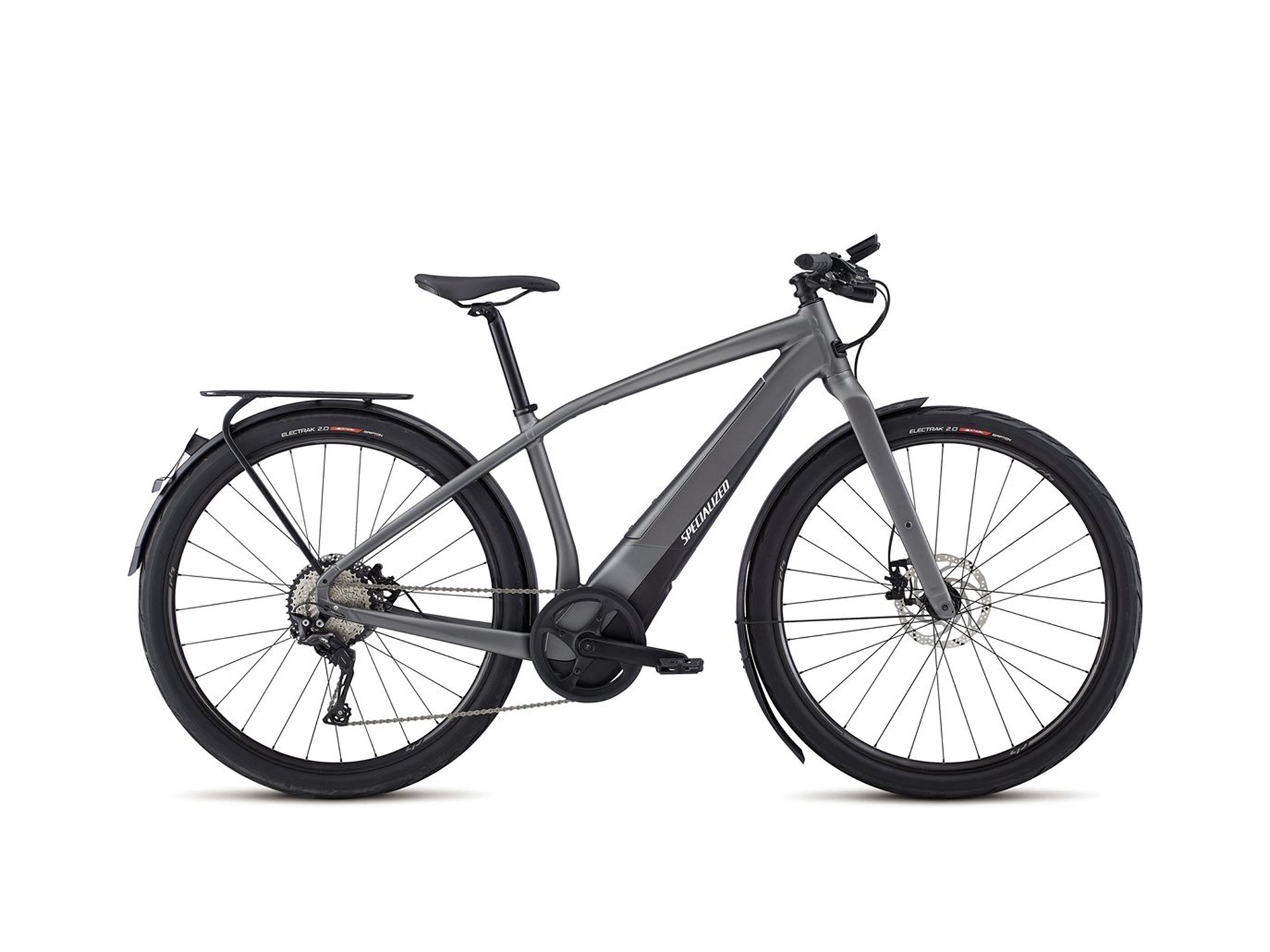

Total Weight:
55.4 lbs (25.12 kg)
Battery Weight:
6.6 lbs (2.99 kg)
Motor Weight:
7.5 lbs (3.4 kg)
Frame Material:
Aluminum Alloy, Smooth Welds
Frame Sizes:
15.75 in (40 cm)17.72 in (45 cm)19.69 in (50.01 cm)21.65 in (54.99 cm)Geometry Measurements:
Medium 45 cm: 17.72" Seat Tube, 32" Stand Over Height, 44.3" Wheelbase
Frame Types:
High-Step
Frame Colors:
Satin Slate with Limon Accents, Gloss Satin Dream Black with Black and Rocket Red Accents
Frame Fork Details:
Rigid Aluminum Alloy, Post Disc Mount, 100 mm / 15 mm Thru Axle, Sealed Bearings Hub
Frame Rear Details:
142 mm / 12 mm Thru-Axle, Sealed Bearings Hub
Attachment Points:
Bottle Cage Bosses, Rear Rack Bosses, Fender Bosses
Gearing Details:
11
Speed 1x11, Shimano Deore XT Shadow Plus SGS cage, Shimano SLX M7000 11-42T CassetteShifter Details:
Shimano SLX Triggers on Right
Cranks:
Custom Alloy, 48T, Narrow Wide Chainring, 104 mm Bolt Circle Diameter (BCD), Single Xsync Style 10- / 11-Speed
Pedals:
Custom Specialized Fitness, Nylon Platform with Grip Traction
Headset:
FSA 1-1/ 8" Upper and Lower, Cartridge Bearings
Stem:
Alloy, 7-Degree Rise, 31.8 mm Clamp, 60 mm (S) / 70 mm (M) / 80 mm (L) / 90 mm (XL)
Handlebar:
Specialized Alloy, 9-Degree Backsweep, 4-Degree Upsweep, 680 mm Width, 31.8 mm Clamp
Brake Details:
Tektro Zurich Hydraulic Disc with 180 mm Rotors, Tektro Zurich Levers with Tool-Free Adjustable Reach, Four-Piston Calipers, Integrated Read Switch on Both Levers for Rear Light Bright Mode
Grips:
Specialized Body Geometry XC Contour, Ergonomic, Black
Saddle:
Canopy Comp, Hollow Cr-Mo Rails
Seat Post:
Alloy, 2-Bolt Clamp, 12.5 mm Offset, Anti-Corrosion Hardware
Seat Post Length:
350 mm
Seat Post Diameter:
30.9 mm
Rims:
6061 Aluminum Alloy, Double-Wall, 40 mm Width, 28 Hole, Reinforcement Eyelets, Reflective Stickers
Spokes:
XDB Stainless Steel, 15 Gauge, Black
Tire Brand:
Electrak 2.0 Armadillo, 28" x 2" (700 x 51c) (51-622)
Wheel Sizes:
28 in (71.12cm)Tire Details:
30 to 65 PSI, Armadillo Anti-Flat Technology, Gripton Compound
Tube Details:
Presta Valve
Accessories:
Custom Specialized Rack with Racktime Snap-it System and Integrated Rear Light (22 kg / 48.5 lb Max Load), Tubular Alloy Fenders (Extra-Long Flextender Multi-Plastic Lower Piece), Integrated Specialized Headlight with Aspheric Lens Technology (12 Volt, Two-LED, 600 Lumen, IP67 Rated, Aluminum Die-Cast Body, Stem Mount), Custom Specialized Side Mirror (Alloy and Glass), Rack-Integrated Specialized Backlight with Lightguide Technology (12 Volt, 8 SMD LED, Clear Window, IP67 Rated, Plastic Injected Housing, Aluminum Rack Attachment Studs, Inner Cable Routing in Left Stud), Plastic Chainring Guard, Transparent Slap Guard Sticker, 40 mm Spaced Standard Rear-Mount Kickstand, Electronic Horn (Mounted Below Bottom Bracket), Optional Replacement Battery Pack $800
Other:
Locking Removable Battery Pack with ABUS Locking Core, 1.9 lb 42 Volt 4 Amp Charger with Rosenberger Plug (Magnetic EnergyBus Standard), Optional 1.3 lb Portable 1.6 Amp Travel Charger, IP67 Water and Dust Protection Rating on Battery Pack, Battery Stops with 4% at Top and Bottom to Avoid Straining Cells, Internal Cable Routing, Shimano CN-HG601 Chain
