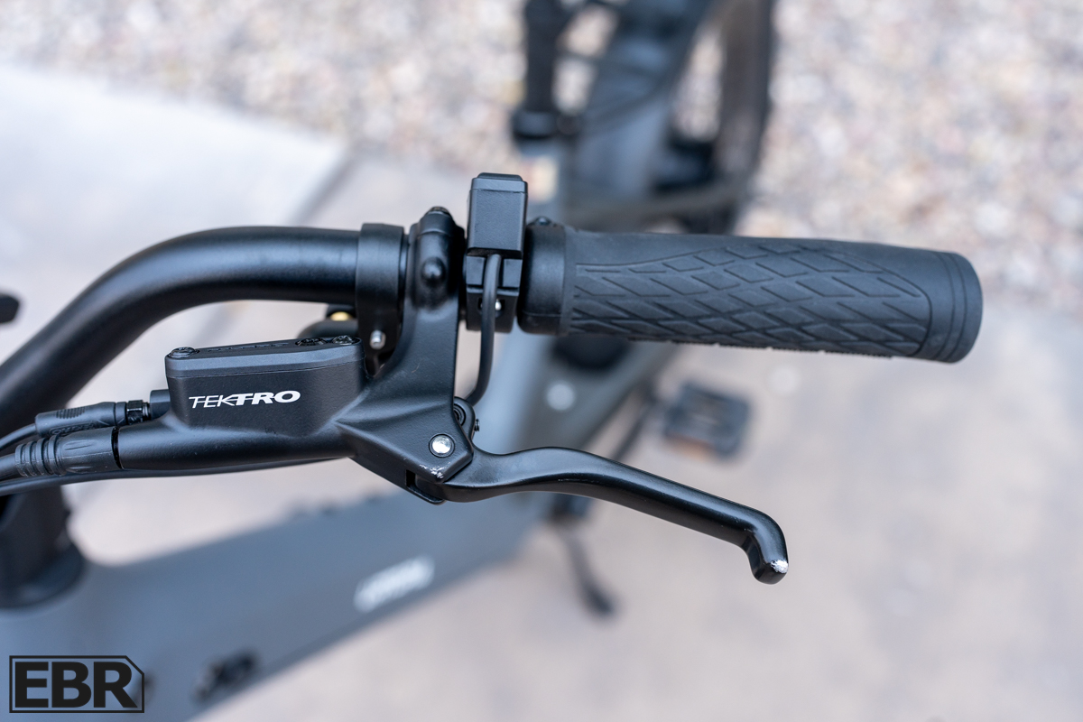

The braking has been excellent. The Tektro hydraulic system with 180 mm rotors gives steady stopping power, and the motor cutoff sensors react the moment the levers are pulled. This helps in tighter areas or when making quick stops. The drivetrain also feels well matched to the bike’s size and purpose. The torque sensor delivers power smoothly and avoids the overly punchy feel that some hub motors have. It ramps up at a natural pace and holds speed without any surging. It will not win many hill climb tests, but it maintains speed with confidence and does not feel strained – and also still climbs hills very well.

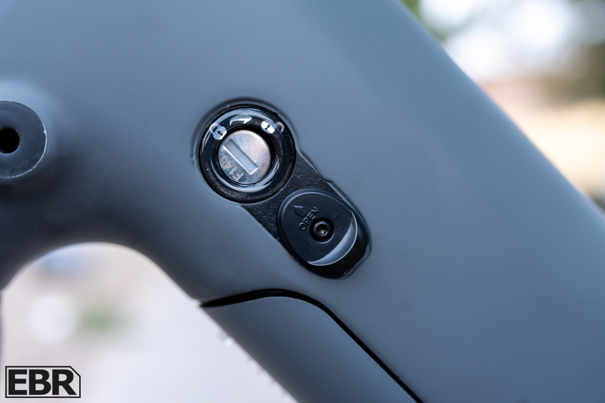

Urtopia included a hidden AirTag mount under the saddle, which I appreciated. It keeps the tracker out of sight and out of obvious locations, and it adds some peace of mind in case the bike ends up somewhere it should not.

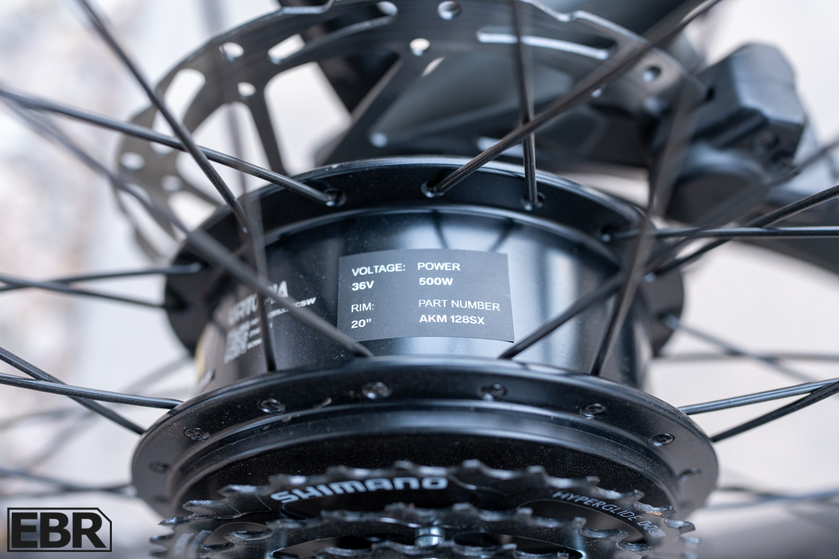

The Urtopia Carbon Joy Ultra uses a rear hub motor that is rated for 750 watts at peak output and 60 newton meters of torque. On paper this puts it in line with most Class 2 utility style e-bikes, but the Ultra stands out a bit in how smooth it feels. The torque sensor plays a big role here. Instead of a sudden jump when you start pedaling, the power comes in gradually and builds with your cadence and pressure. It feels controlled, predictable, and very natural for a hub motor.

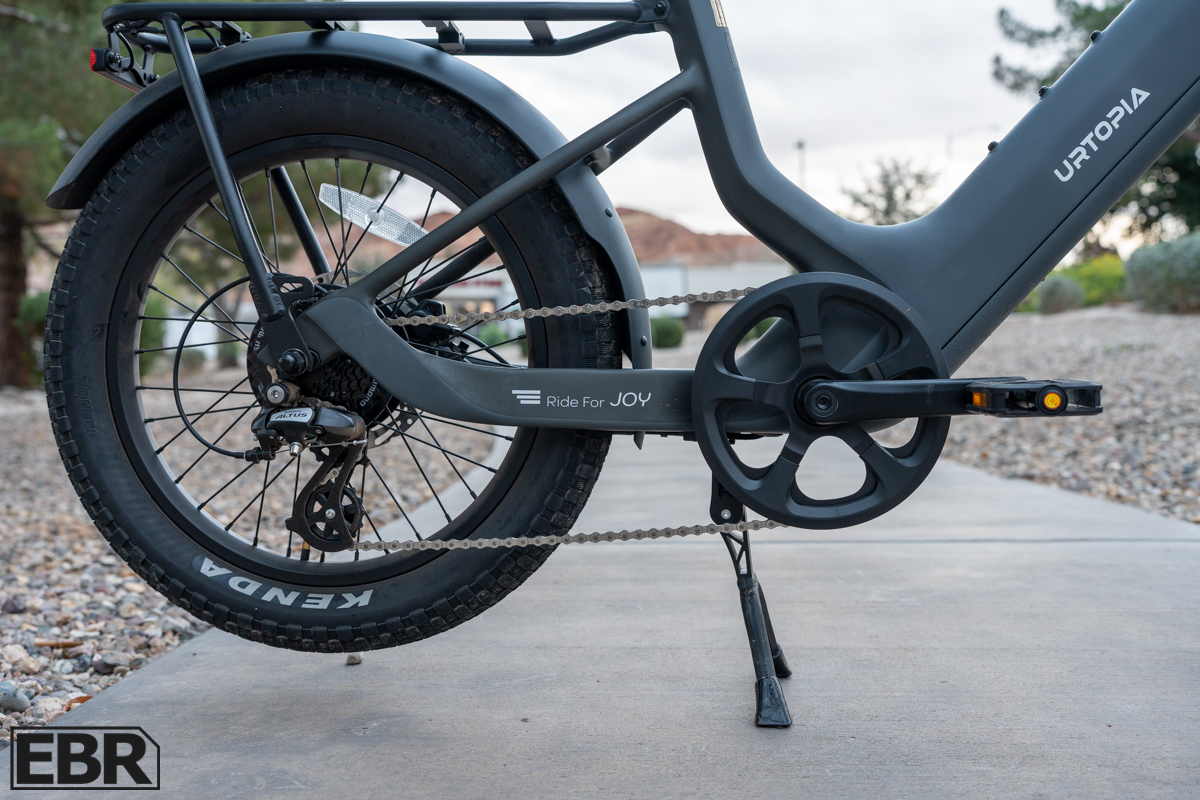

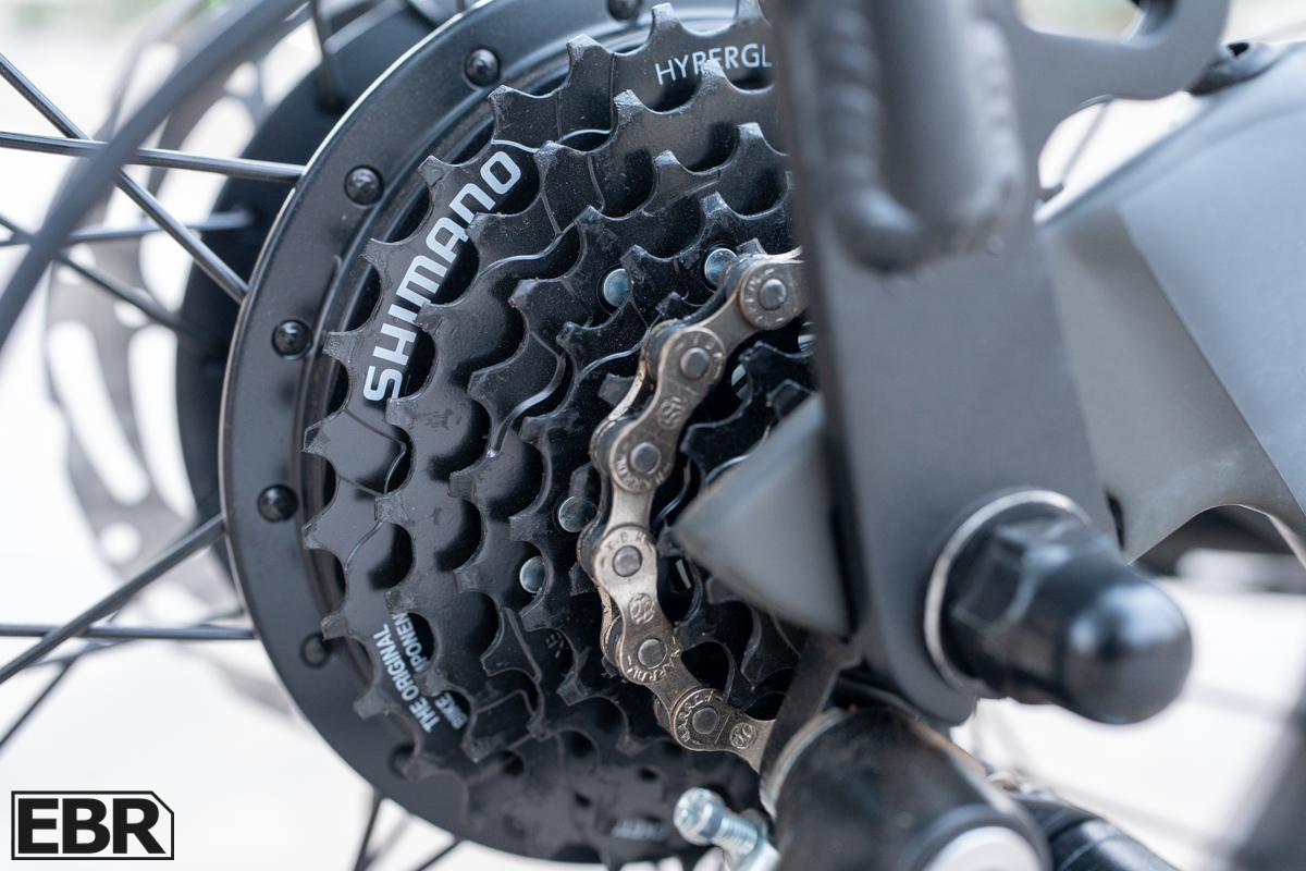

The Urtopia Carbon Joy Ultra is equipped with components that match its goal as a compact and lightweight cruiser / utility bike. The drivetrain uses a Shimano 8 speed system with a Shimano Altus rear derailleur, a 50 tooth chainring, and a 12–32T cassette. This gearing fits typical day-to-day riding whether that be on your local bike path each weekend or stop-and-go rides in the city.
The braking system uses Tektro hydraulic disc brakes with 180 mm rotors that measure 2.0 mm in thickness. This is a fairly standard setup for many e-bikes and provides consistent stopping power without requiring frequent service. The brake levers include e-cutoff sensors that kill motor power the moment the brakes are pulled even slightly. This is helpful for safety when maneuvering at low speeds or when making quick stops.

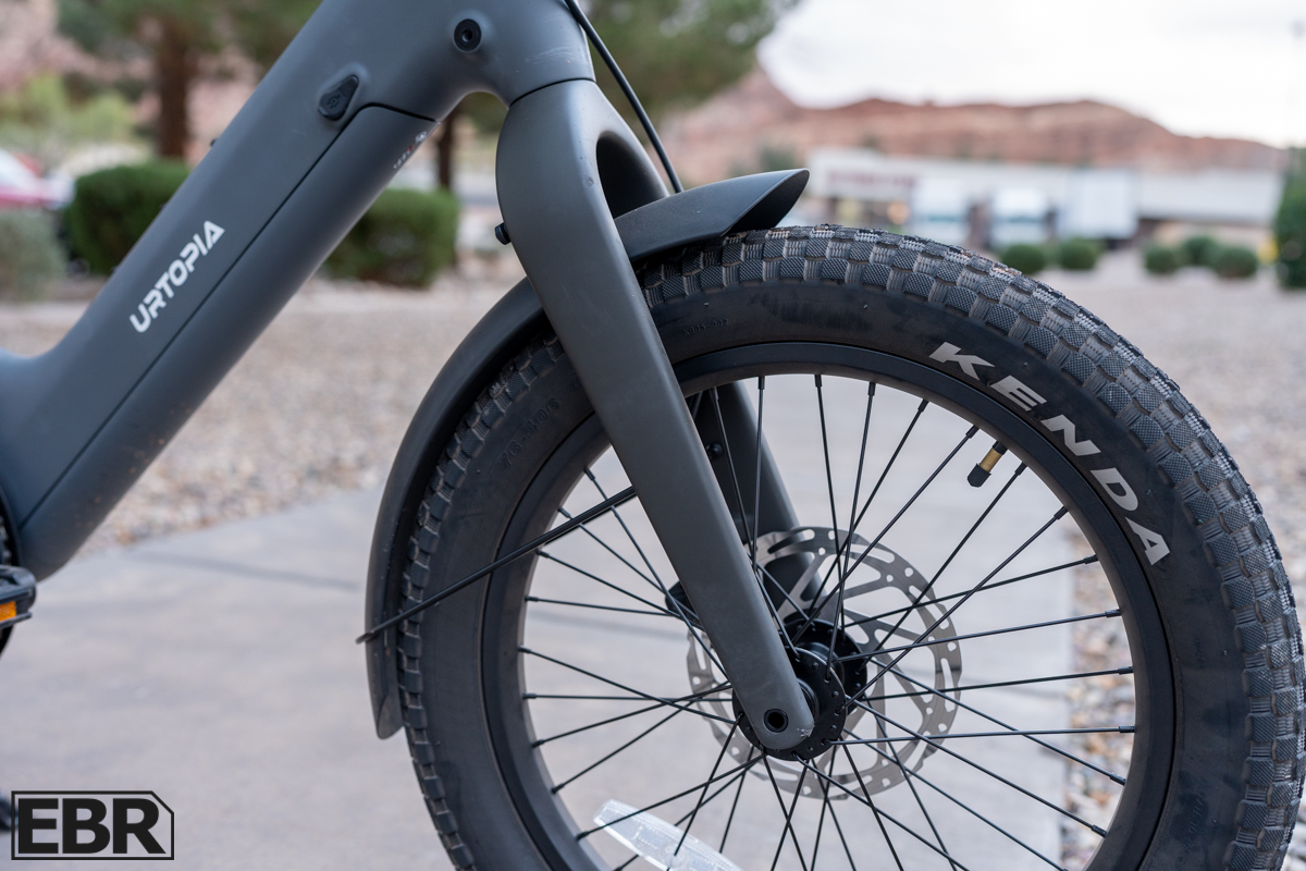

The wheels use thru axles for better alignment and improved rigidity. The 20″x3.0″ Kenda tires provide a wide contact patch along with predictable traction on pavement, paths, boardwalk style surfaces, and compact dirt.

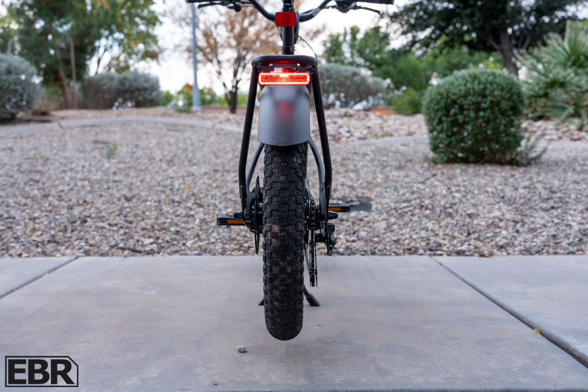

The bike arrives with full coverage fenders and a rear rack that includes an integrated rear light. Urtopia also offers a front platform rack and modular cargo bags that attach directly to the mounting points on the frame and rack system. These allow the Carbon Joy Ultra to carry a variety of loads without adding excessive weight.

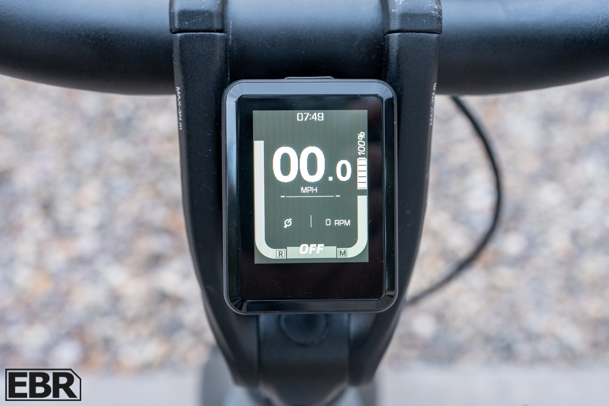

The Carbon Joy Ultra uses a color LCD display that is simple and easy to live with. It is bright enough to see in sunlight, the layout is clean, and the buttons sit right next to the left grip so you do not have to look down much once you get used to it. You get all the basics you would expect, like speed, battery level, assist level, trip readings, and a few status icons.
All of the important settings live directly in the display menu. Screen brightness is easy to adjust, and the speed limit can be set anywhere between 15 mph and 25 mph. We did not run into anything confusing and found everything we needed within a minute or two.
Urtopia does have an app, but in our testing we were not able to pair the Ultra to it. Scanning the QR code on the bottom bracket did not connect, and manual searching in the app did not find the bike either. It is possible this will change with an update, but at the moment the Ultra’s settings are easily adjusted via the display.
