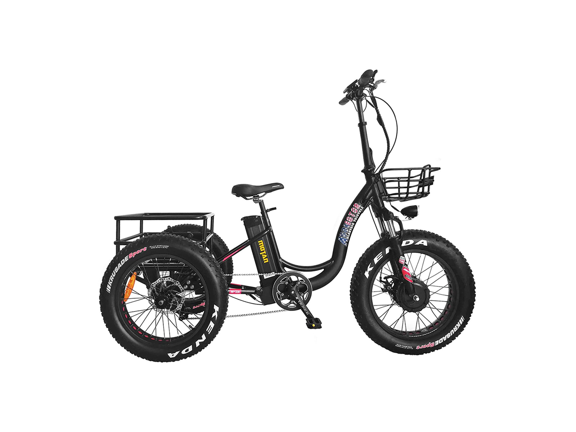

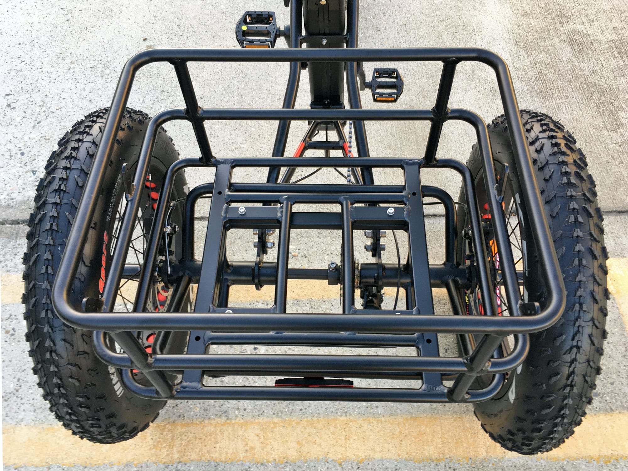

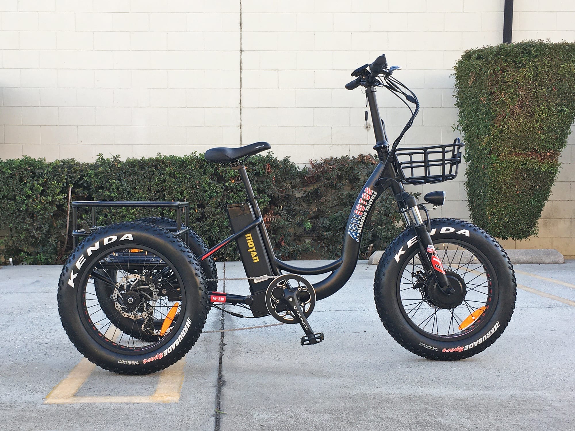

- The M-330 P7 is a powerful hauling machine, the included front and rear baskets and sturdy frame mean that you can carry a lot of cargo in addition to yourself. The official weight capacity is 350 pounds, which seems a bit conservative to me since the frame is built with grade 7075 aluminum alloy (tougher than the 6061 we usually see for bike frames)

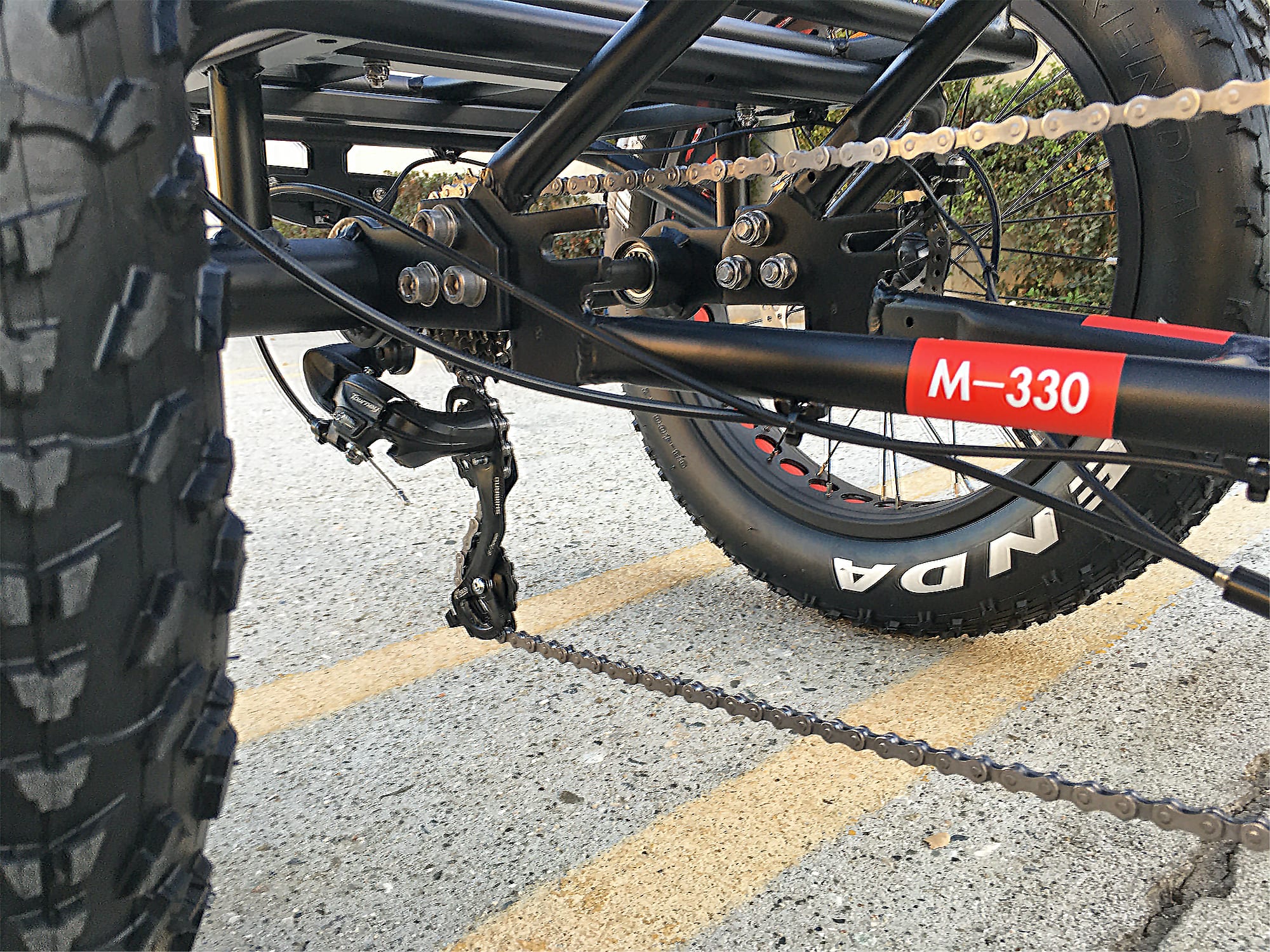

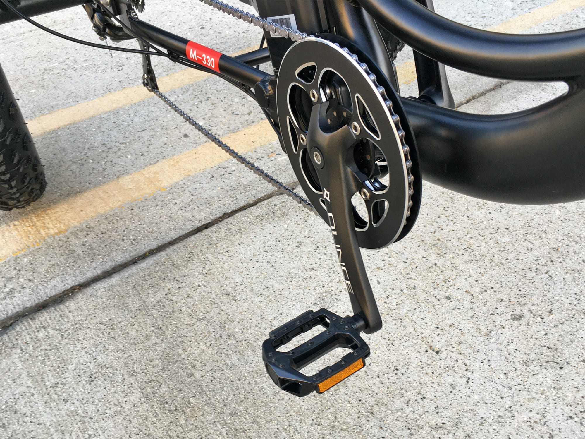

- The Shimano Tourney derailleur is the entry-level option from Shimano which helps save cost while still being reliable, this is a pretty basic setup that has a range of 14-28 teeth across 7 speeds. This gets the job done for a trike where the shifting and pedaling range needs are lower than on a standard bicycle, and I appreciate the double-sided alloy chain guide that will keep the chain from jumping free, this is especially important on a trike since the chain is longer than standard

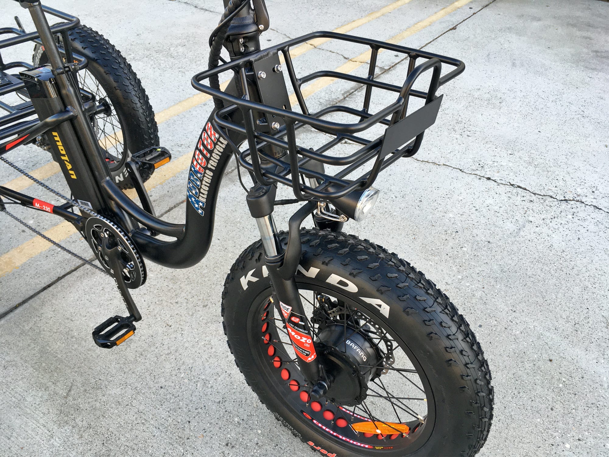

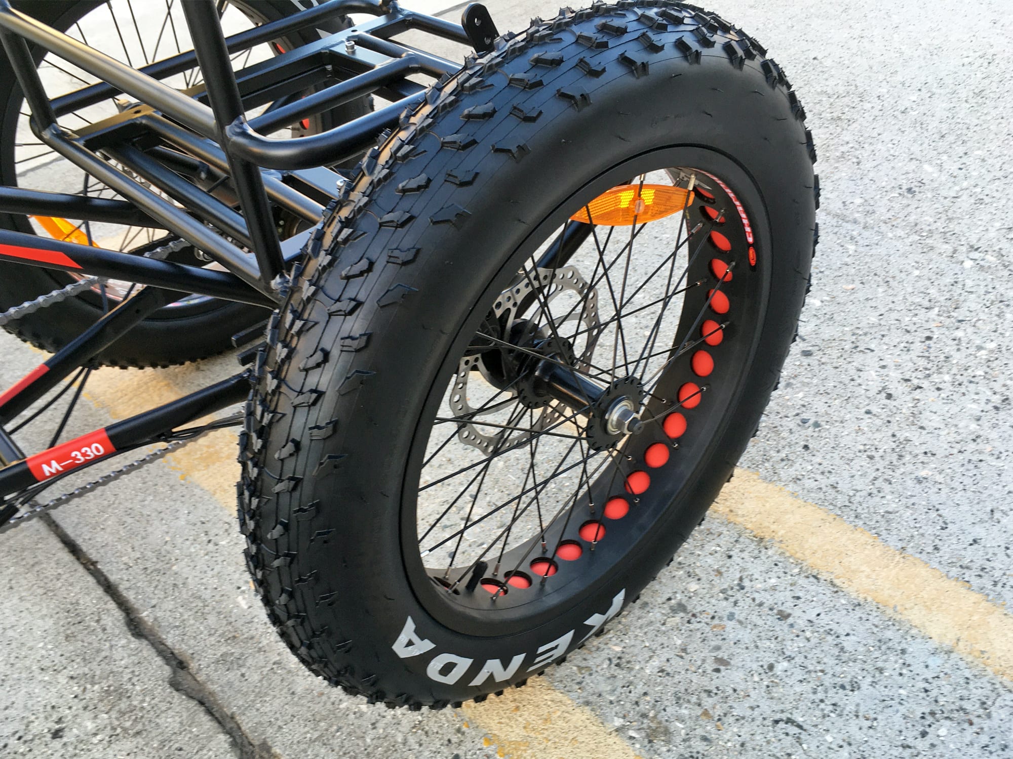

- The ride experience is quite comfortable thanks to the upright riding position, suspension fork, and fat tires. The MoZo fork is spring suspension and fairly basic with only 50mm of travel, but it pairs well with the Kenda Crusade Sport fat tires, these provide a great amount of cushion and you can also lower the pressure down as far as 5psi for riding on really bad terrain such as snow or sand. Keep in mind that this is a trike, you should not be riding at high speeds on rough terrain due to tip-over risks

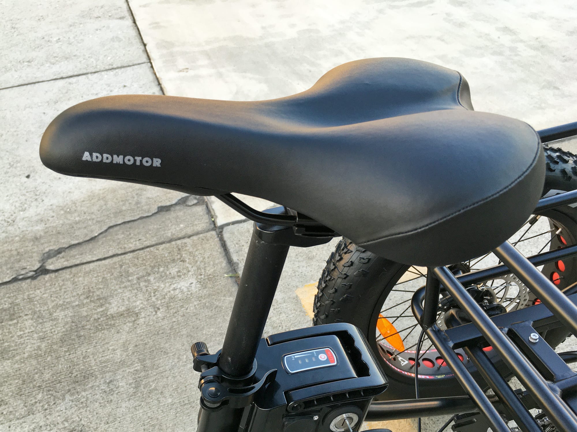

- Helping out on the comfort side of things are the Velo saddle which is wide, soft, and very comfy to sit on, plus the ergonomic grips that also feel nice. These grips aren’t locking, but the upright relaxed riding position and trike use case means that you really aren’t going to be bearing down on the grips enough to get them to twist

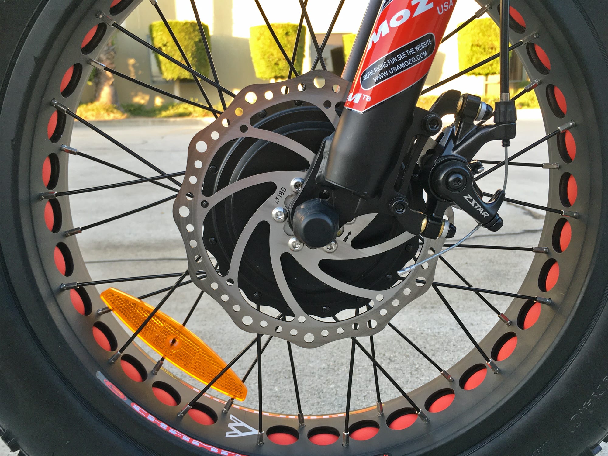

- The mechanical disc brakes provide plenty of stopping power thanks to four-finger levers which provide a mechanical advantage combined with a 180mm rotor in the front and twin 160mm rotors in the rear. These are Tektro MD300 brakes, these are reliable brakes found on many bikes – just remember that mechanical brakes require regular tightening and maintenance to keep them performing optimally! These brakes do have motor inhibitors which means that they will cut power to the motor when you actuate the levers, a necessity on such a heavy vehicle with a cadence sensor

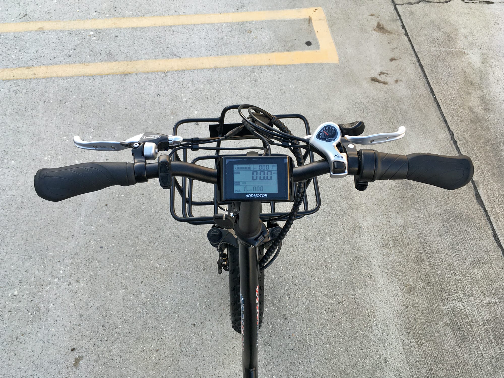

- The display is easy to see in direct sunlight, center mounted and while it is not removable it is adjustable for angle so you can position it to remove glare. It also has a full-size USB port on the bottom, great for charging mobile devices while you go… but don’t get too excited if you’re an iPhone user as the port only supplies 0.5 amps of power which will charge an Android but not an Apple device
- The combination of a 12-magnet cadence sensor and a twist throttle is one we see on many bikes, it’s a winning combination that keeps costs down while providing adequate performance, you can use the throttle when getting started to compensate for the delay inherent to all cadence-based sensor setups. The twist throttle has a kill switch and starts in the “off” state, I appreciate this for safety so that the trike won’t take off unexpectedly if you accidentally twist the throttle. One last note here, AddMotoR configures their bikes to have full throttle power from any assist level, I prefer this configuration compared to other bikes which tie the throttle power to the current pedal assist level

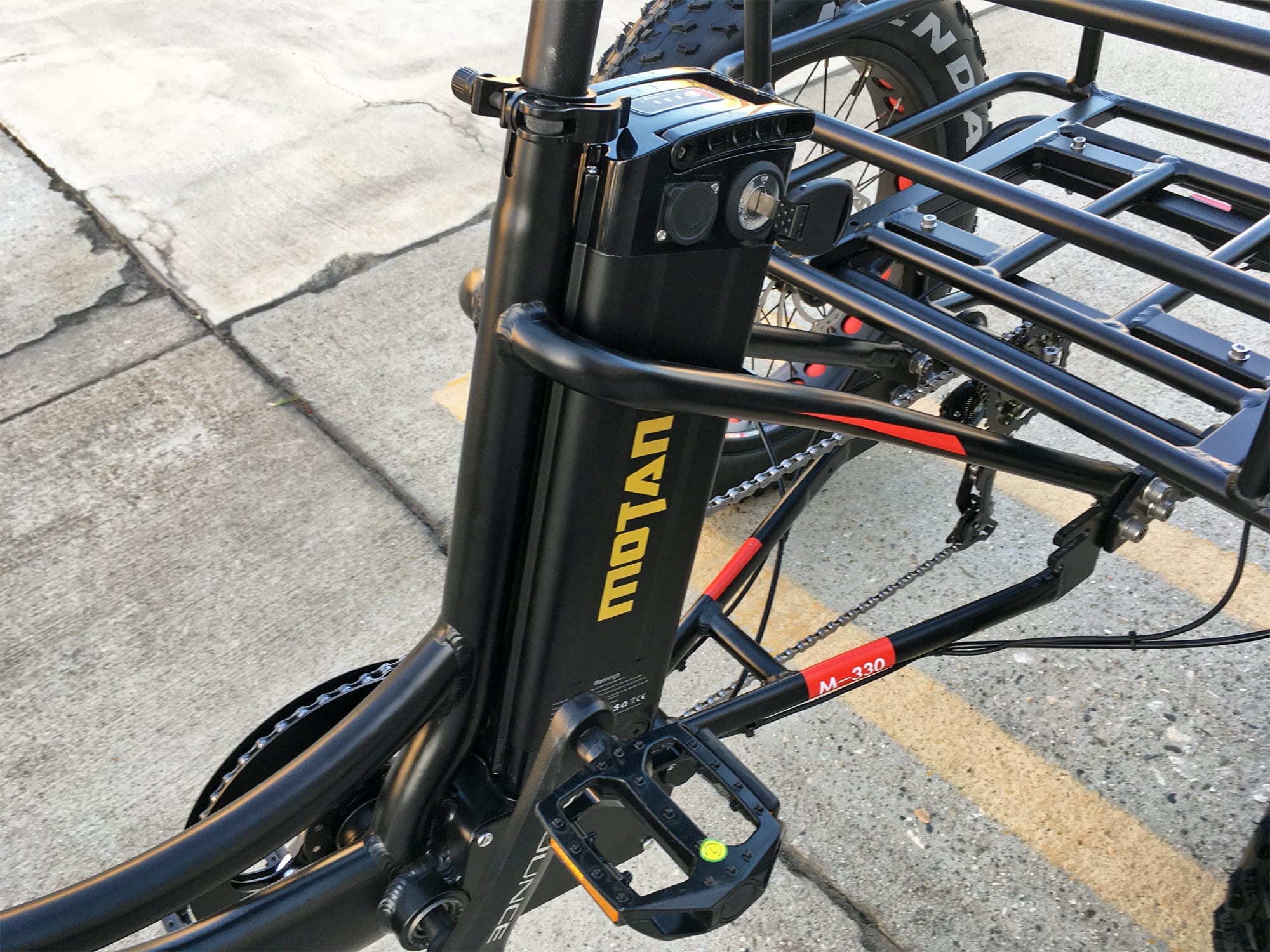

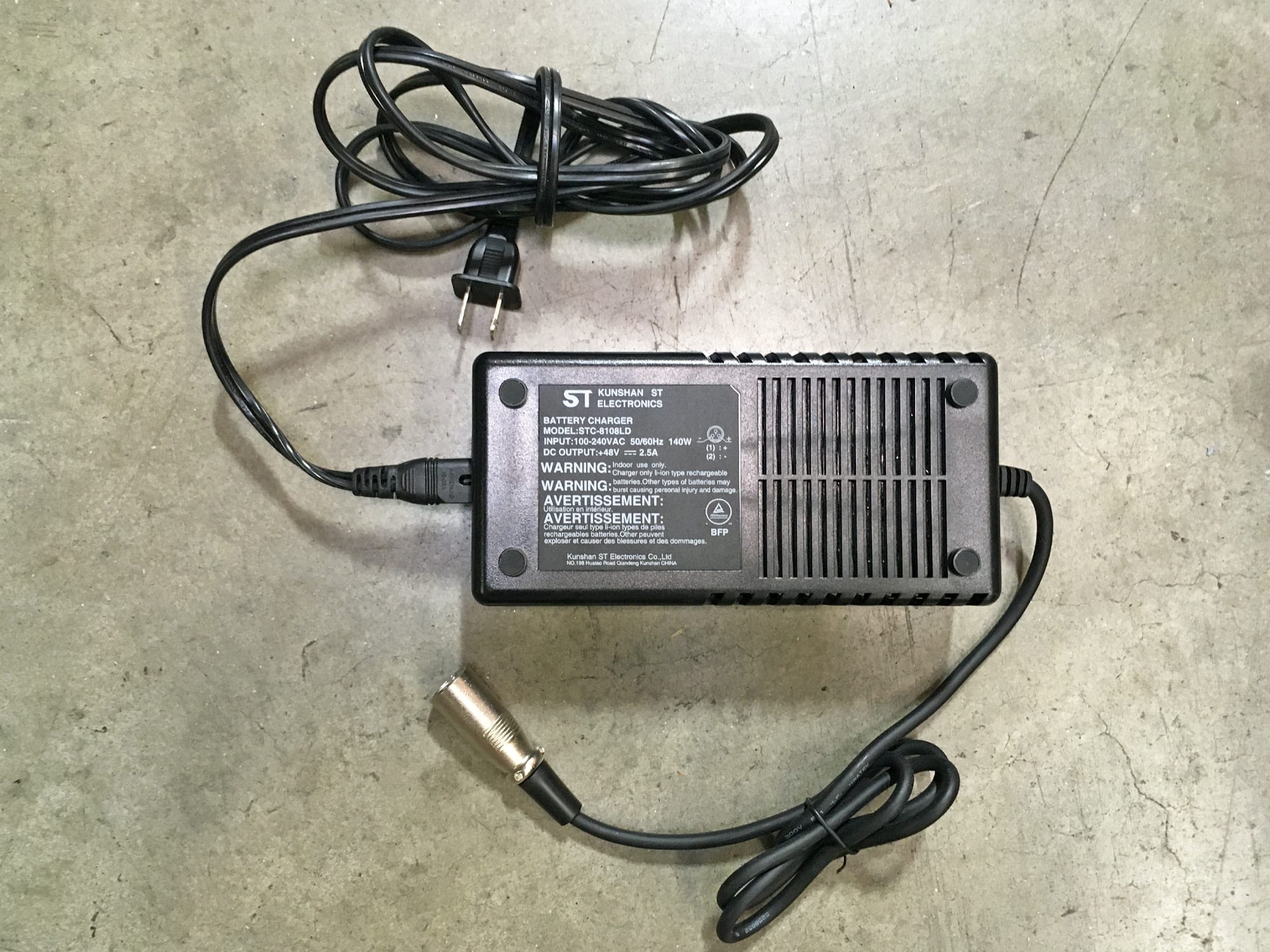

- The battery is high-capacity at almost 700 watt-hours, and while it is fairly heavy at 9.1 pounds it is easy to remove thanks to the grab handle on top, and I appreciate that while it is mounted on the trike the charge port is well away from the crank arms to prevent any damage while charging on the trike

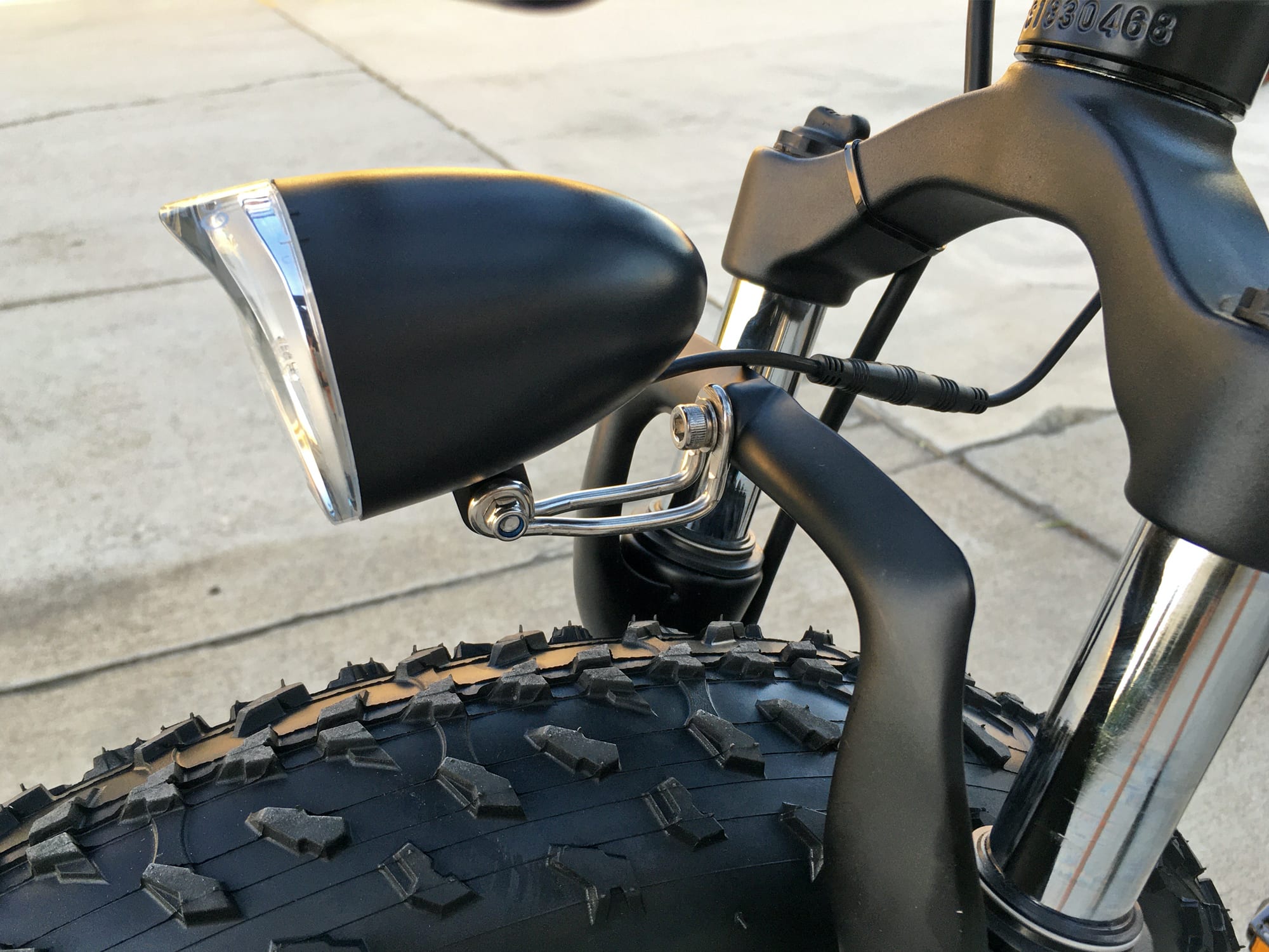

- Integrated lights from Spanninga and Blazelite are welcome accessories, both are nice and bright and can be easily operated from the control pad

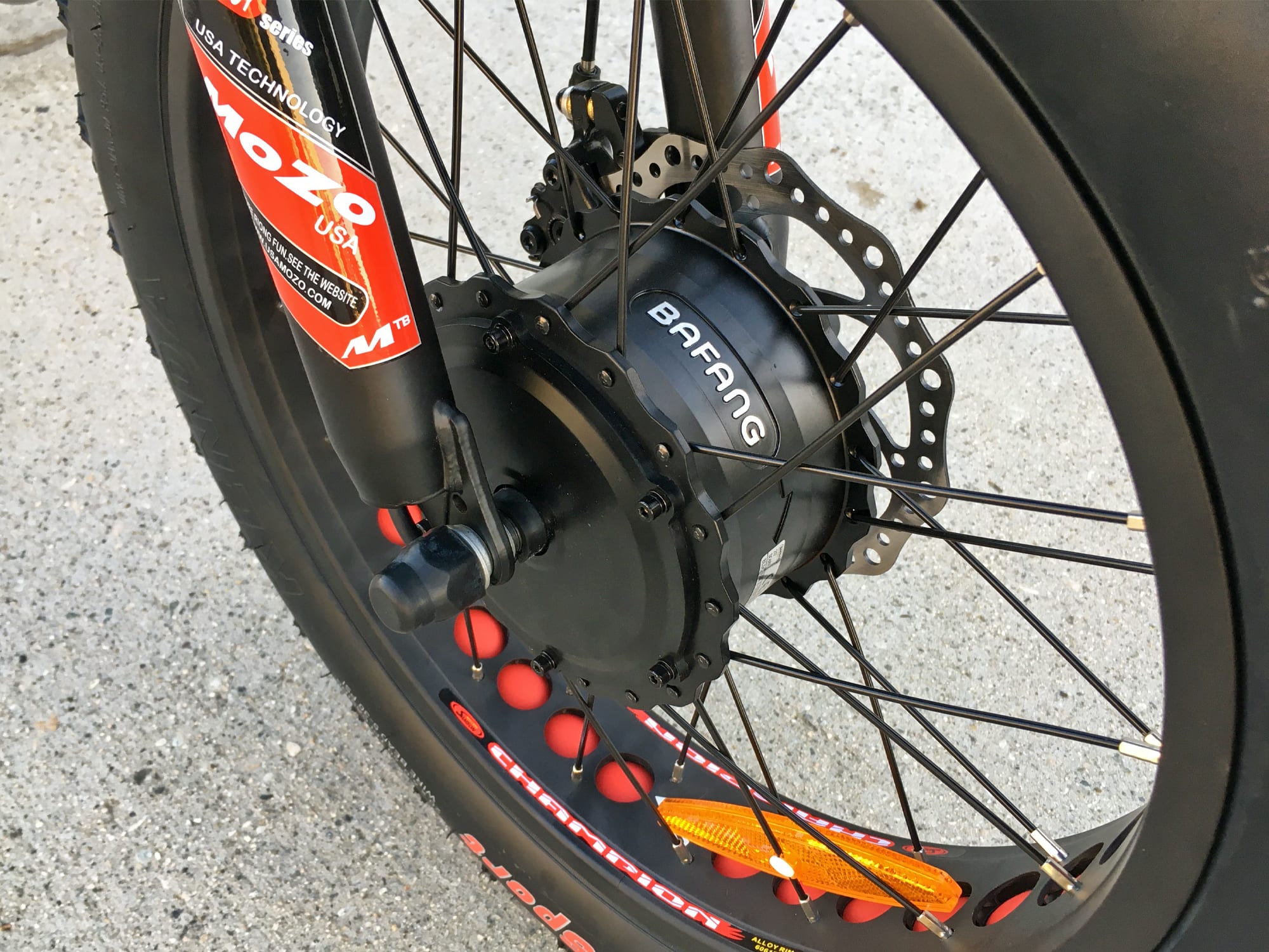

- Simply massive amounts of power from the 500-watt Bafang geared hub motor, this is a fat tire specific motor that is mounted in the front wheel. Riding with myself and a backpack (about 205 pounds of weight) I could twist the throttle and “peel out”, granted some of this is due to the motor being in front while most of the weight is in the rear… but the motor is very powerful, it is rated for 80 newton-meters of torque so it will have no problem with heavy loads and steep hills

- Fairly heavy at 74.1 pounds, this combined with the trike form factor means that the M-350 is difficult to maneuver in small places such as the garage or the bike rack, not to mention storing inside your house or transporting in a vehicle. Fortunately, there is a “walk mode” available to help while moving the trike without riding it. Obviously, the M-330 would not be easy to pedal home without electric assistance, fortunately the high capacity of the battery means that getting stranded is unlikely if you make sure to charge up before every ride
- Mechanical brakes require regular tightening and more frequent maintenance than hydraulic brakes, and the length of this trike means that the cable for the rear brakes is long which causes a slight delay when braking. Of course, the four-finger levers give a mechanical advantage so these are still fairly easy to actuate, but if you have any problems with grip strength these may require too much force
- The tires don’t have reflective striping on the sidewalls, nor do they have included puncture protection. Of course, fat tires are naturally somewhat puncture-resistant due to their thickness and the size of the nubs, but you may need to add sealant or protective liners if you ride in an area with lots of puncture hazards
