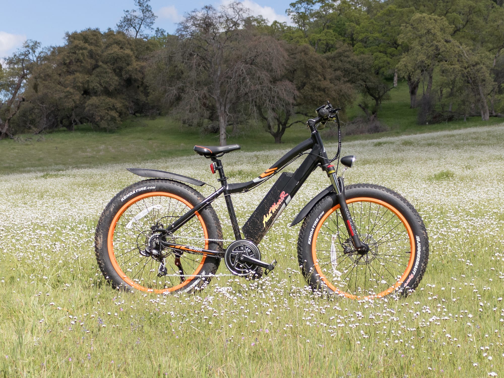

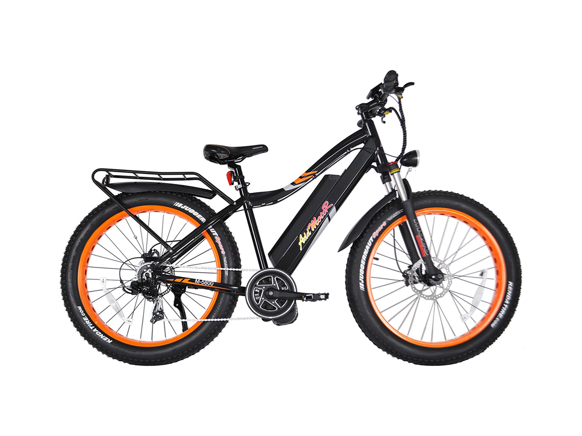

Hey guys, this is Brent! The MOTAN M-5800 is the second electric bike from Addmotor that I’ve tested and is by far my favorite so far. Aesthetically, I really appreciate the black with striking orange accents, and I also dig that this electric bike is one of excesses. It has a larger than average battery capacity of 17.5 amp hours, more powerful than average 1,000 watt motor offering up to 160 newton meters of torque, higher top speed of 30 mph with the throttle, huge 4” wide tires and decent suspension with 100 mm of travel and lockout. It’s just all around fun to ride. However, one thing to point out with this bike right off the bat is that because of the “more than” features here, it’s beyond class, which means it’s likely not going to be legal on sidewalks, bike lanes and most trails. If this were my bike, I’d carefully check my local laws to be sure it’s legal to ride where I want, and then I’d also check out my local OHV parks to see about riding there. I hate being a negative nelly, but the reality is that with a bike like this, with so much power and top speed, there’s definitely some potential legal ramifications if I were to get into an accident. Injuries aside, having a lawsuit on my hands would be seriously unfortunate. Another interesting point that comes along with this bike, and all other bikes offered from Addmotor, is that they are a direct order company. This is great when it comes to price as it typically affords companies like Addmotor to shave down the price since they don’t have the overhead of physical shops. I think this is evident with the MOTAN M-5800, which runs for $2,699. That’s definitely not the most affordable price, but I think if I were to pick this electric bike up in a shop it would cost quite a bit more. Now, there’s also a handful of downsides to this setup as well. First and foremost, I’ve found there can be somewhat of a language barrier when trying to communicate with the company. This is of course no fault of there own, but it can make getting specific details about a bike before pulling the trigger to order it a bit difficult. Assembly can be another downfall to ordering direct. Not only can it be time consuming (the first electric bike I put together took me about an hour, but now it takes me only around half an hour) but there’s also the aspect of not having it pro tuned from a shop. Specifically, I find there’s a little bit of rattle in the brakes in almost every bike I put together myself. This can be worked out by carefully adjusting the front wheel, and even the calipers if needed, but it is time consuming and sometimes a pain to get just right. Lastly, and this is something I experience with the MOTAN M-5800, sometimes the accessories don’t fit exactly right. In this case, the included rear rack just didn’t want to fit. The included screws were just a tad too short to thread into the rear rack bosses, and the rear rack itself seemed like it was too narrow overall. I spent about 45 minutes trying to make it work, but just couldn’t get the screws to set. I’m not trying to bag on direct order bikes — actually I think they can be a great money saver — but I just want you guys to be aware of the potential pitfalls, as well as the potential benefits. Getting back to the electric bike at hand, there’s quite a few cool features about this one that I really enjoy. So here we go!

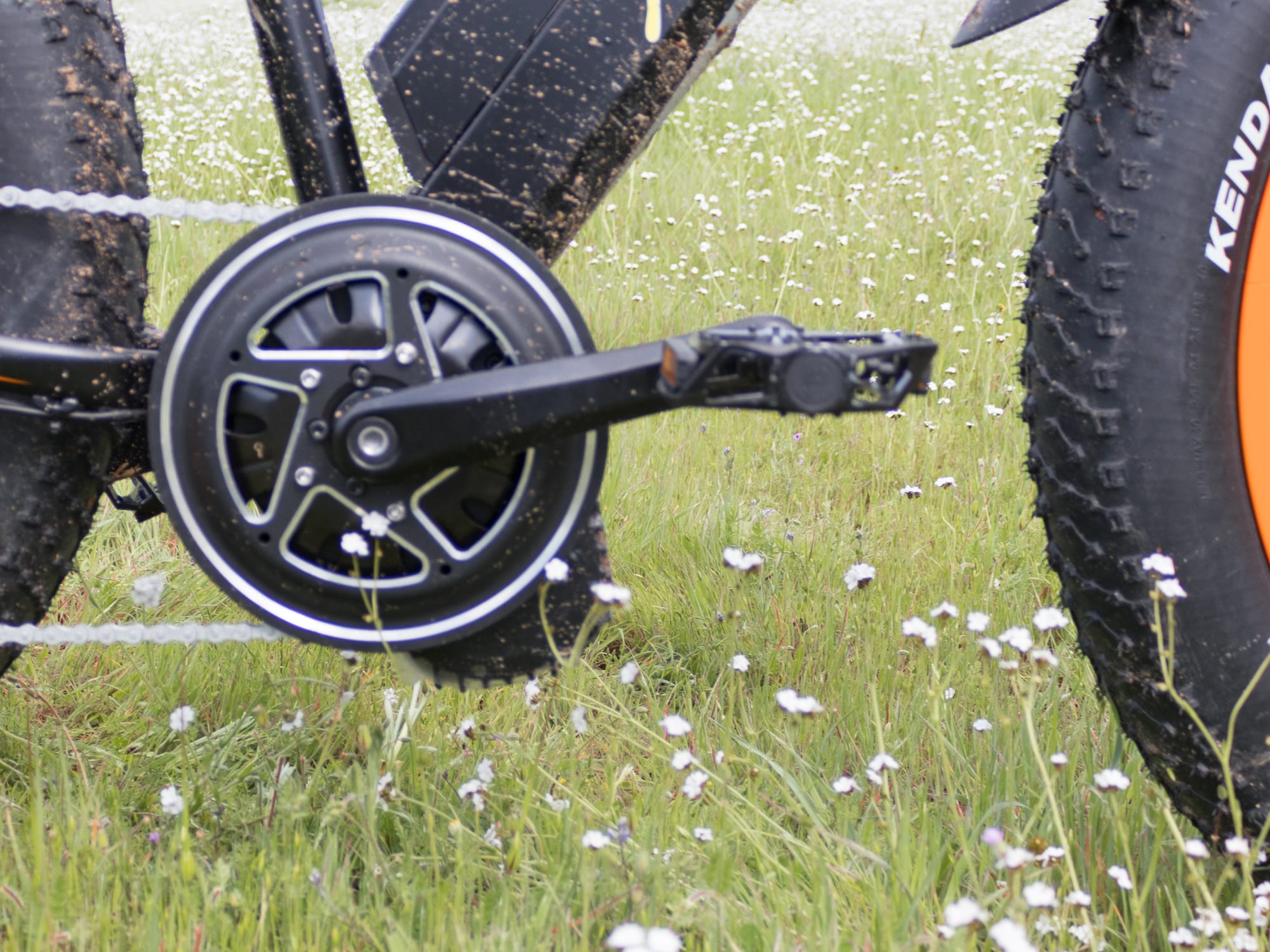

Driving this bike is a super powerful and torquey Bafang 1000 watt mid drive motor with 160 newton meters of torque. Yes, 160. I tested a similar Bafang mid drive motor (the Ultra Max) on the FLX Blade and loved it just as much then as I do now. I think this motor is a good choice for this bike. It almost needs this big of motor to deal with the 4” wide tires and a larger rider like me, who weighs ~200 lbs. Those tires are dope and offer tons of extra suspension thanks to their massive air volume and lots of traction because of the huge surface area. But that extra surface comes at a cost: drag. I can definitely feel the extra resistance with these tires, even when they’re inflated to the maximum recommended 30 PSI (they can go all the way down to 5 PSI for those extra soggy trail conditions), and that 160 newton meters of torque is great for helping get this bike started from a dead stop and for powering through mud, snow, sand, gravel, etc. You’ll still want to shift gears to the lower ones to really empower the motor though. It’s more like a manual transmission car with the mid-motor than hub motor setups like the Surface 604 Hunter that Court reviewed. Anyway, I think this Bafang middrive motor is apt for this particular bike because of how heavy it is. The M-5800 weighs in at 67 pounds and it is a heavy beast. Not only was is difficult for me to load and unload into my truck, but that extra weight means the motor has to work that much harder to drive it. The torque sensor on this motor is effective and does a good job of quickly giving and cutting off power when I start and stop pedaling, respectively. This motor can get the M-5800 up to a top speed of 30 mph with the throttle, or 20 mph with the pedal assist. And again, because there’s so much power on tap, I was able to hit the top speed pretty easily. Given I weigh 200 pounds, that’s a pretty cool feat. Another great aspect of this motor is that it’s a mid drive, so I can really leverage the gearing to be efficient and get decent range. I think this is particular important given the philosophy of use for this bike, which I think is going through slushy terrain like mud, snow, sand, gravel, etc. and for hunting or bikepacking. Being able to really leverage the power against the gearing is important for when I’m trying to get through those extra muddy sections. One thing I worry about with this motor, and all mid drive motors really, is the potential for a rock or log strike. This motor hangs pretty low and there isn’t any sort of protection underneath it. So if I get a strike on a rock, log or whatever, it’s going to come in direct contact with the motor casing itself. This could crack the casing or even potentially damage the internal gearing if it’s severe enough. Granted, this bike isn’t a stump jumper or anything, but it’s definitely something I would keep in mind while riding. The good news is, if I do damage the motor or anything else on this bike, Addmotor offers a 1 year comprehensive warranty… I haven’t tested that out, and given the communication barriers, I welcome your feedback if you have had any issues with the company.

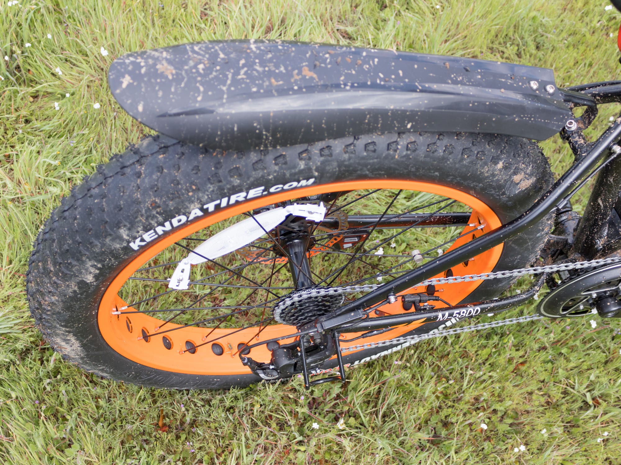

- The black color scheme helps to hide cables, the battery, and motor casing but I like the sporty orange and yellow accents (reminds me of the Toyota Prerunner paint job that Ivan Stewart drove)

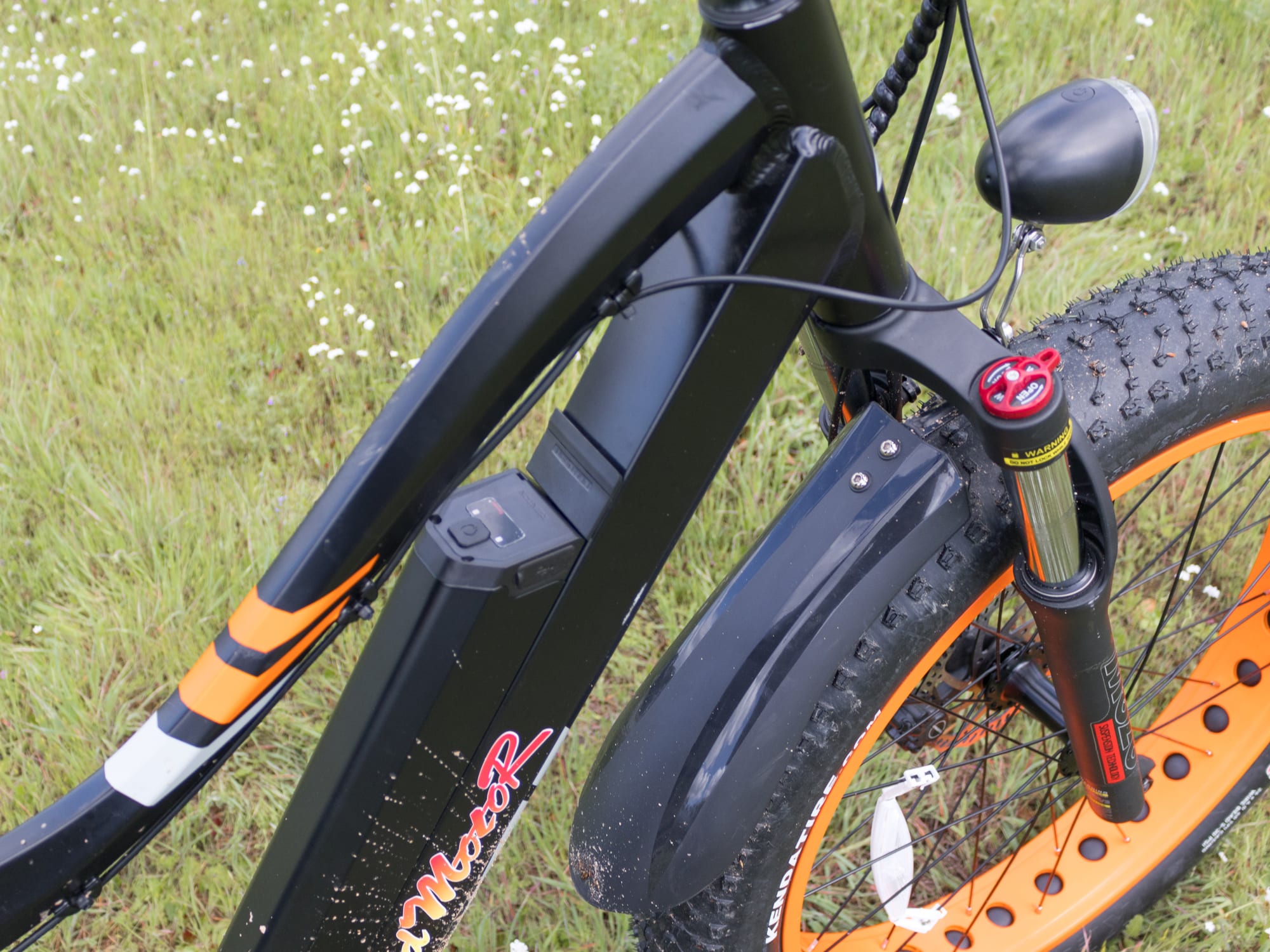

- Comes standard with front and rear fenders and a rear cargo rack, and since most of the weight is kept in the middle of the bike, adding weight to the rear shouldn’t make it too unbalanced

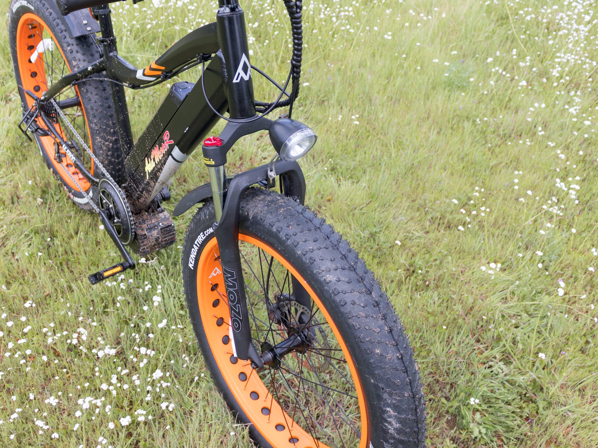

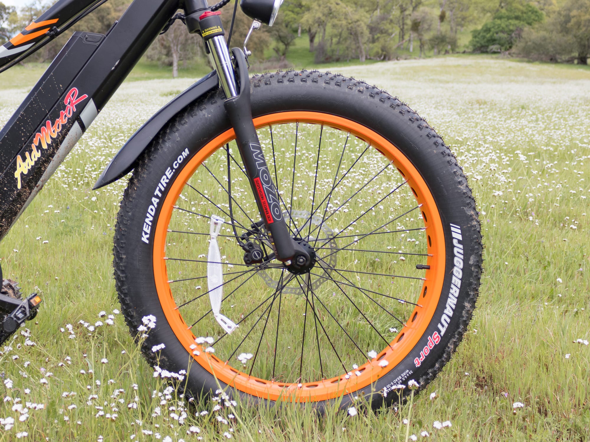

- Larger four-inch wide fat tires add more cushion because of their increased air volume and add tons of extra traction thanks to the increased surface area, making traveling over mud, sand, snow and gravel a breeze (especially with lowered tire pressure)

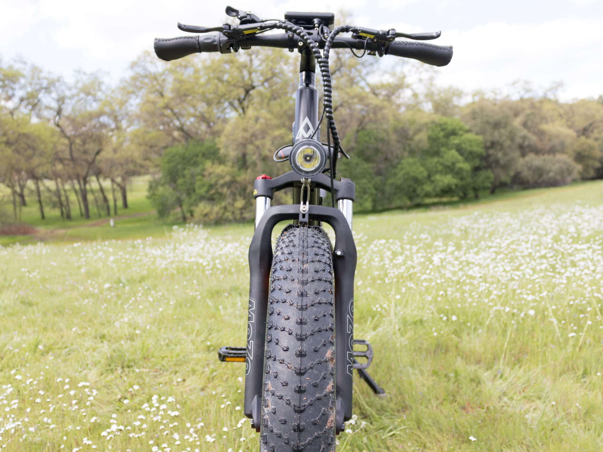

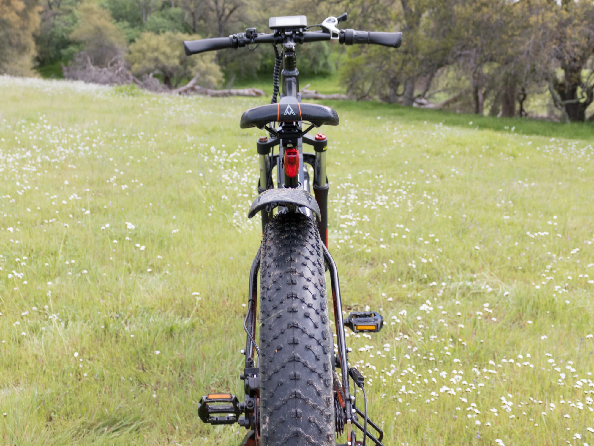

- Includes an independent headlight and taillight to increase visibility in low light conditions, improving overall safety for those who like to ride at night
- Front suspension coupled with the large tires makes for a cushy ride overall, and the wide seat adds further to the comfort but you could take an additional step by adding a seat post suspension
- Powerful middrive motor gets the bike moving fast if you’re in a low gear and allows the gearing to be leverage agains the power of the motor as you shift (these tend to be more efficient than hub motors), the low and centered location of the motor is ideal for handling and stability
- Larger than average capacity battery means the bike can travel further if you don’t max out the speed (it will still lose some efficiency because of the tires), hunters could always bring a second charger to go deep into the woods or buy a solar charger like one of these
- 180 mm hydraulic disc brake rotors do a good job of stopping this bike, which is important given its very heavy curb weight of 67 pounds and higher top speed, the hydraulic brake levers allow for adjustable reach (which could be handy if you’re wearing gloves and want to bring them in)

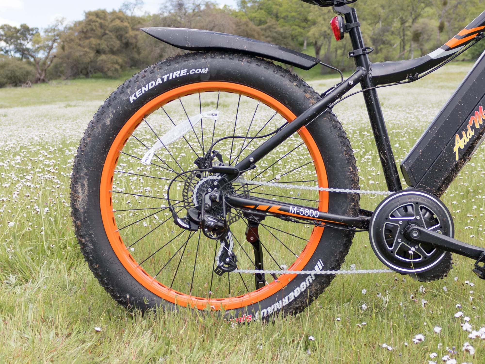

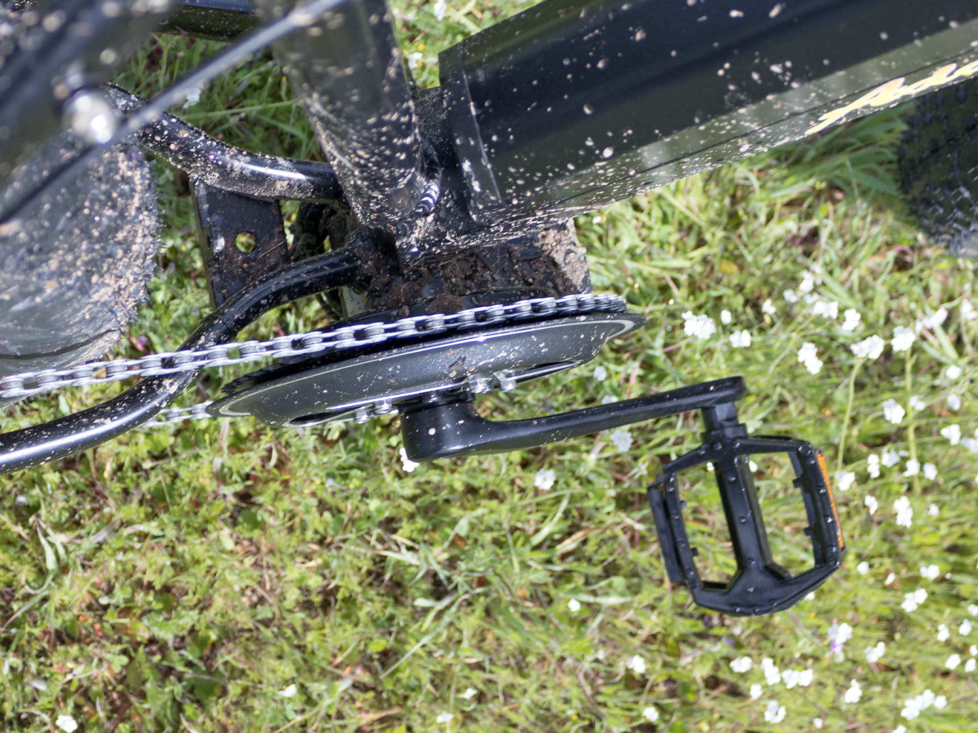

- Aluminum chain guard should help keep the chain from popping off towards the outside, as well as provide some protection to the chainring itself (acting as a bash guard)

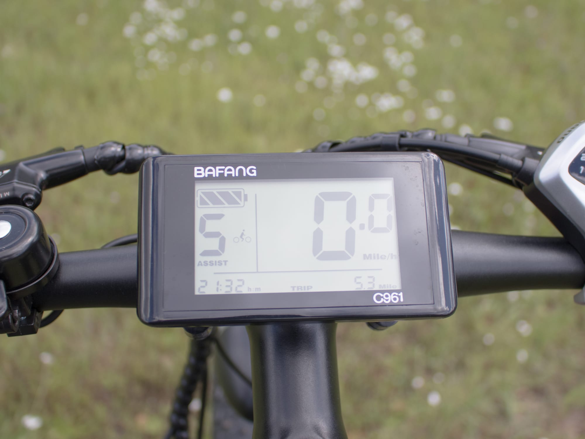

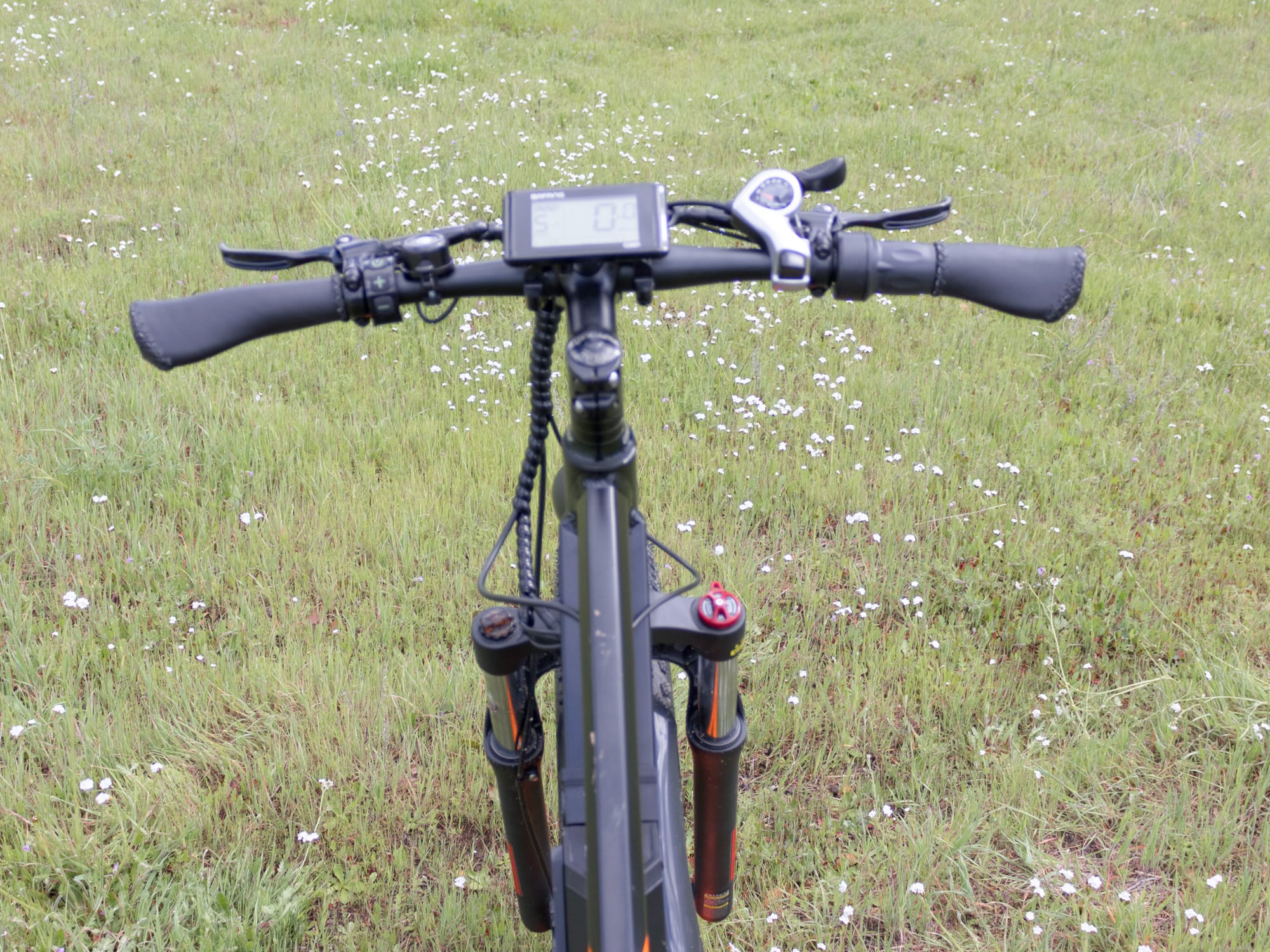

- The control center is backlit and easy to operate, the screen is large and easy to see (which is nice if you’re wearing glasses or goggles), I appreciate the independent button pad because it’s easy to reach without taking your left hand off the grip

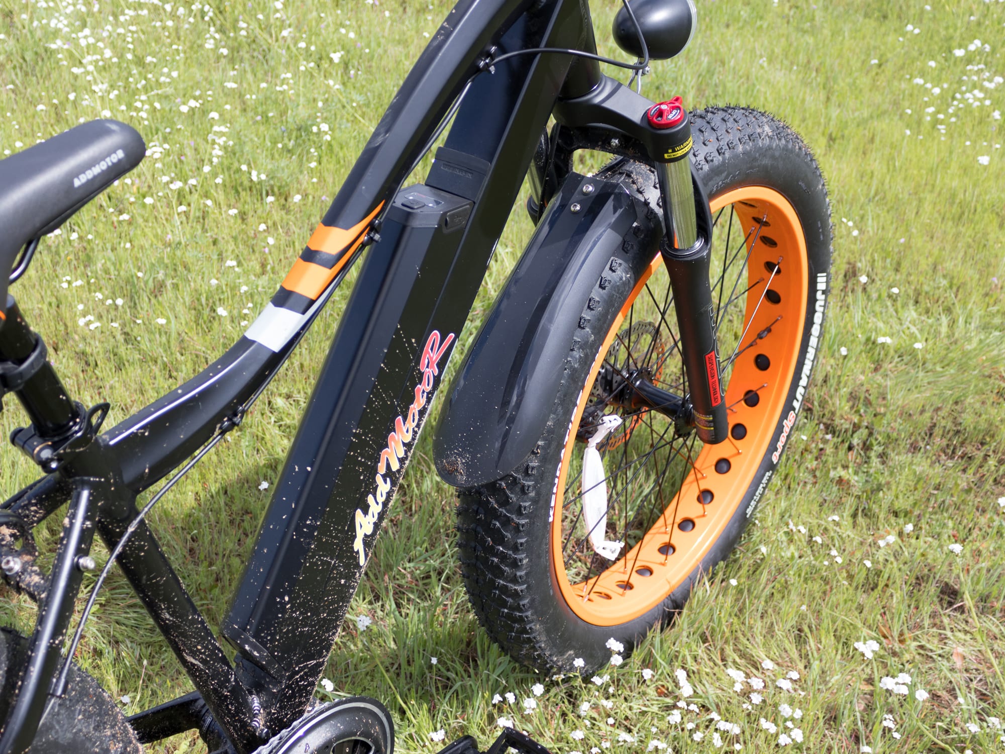

- Bike feels overall well balanced despite its heavy weight, and because the battery is removable it makes it easier to load and unload into a truck or onto a bike rack, no quick release on the wheels, so bring some tools if your truck bed or cargo space is limited
- Steel derailleur guard extends over the derailleur to add protection against strikes, this piece should also help protect the power cable that feeds into the motor

- Very heavy at 67 pounds, especially considering that it has punched out rims, the weight makes transporting and servicing the bike more difficult, but most fat tire ebikes weigh more (the high capacity battery and spring fork add to the weight)
- Rear rack was difficult to install, which is one of the potential pitfalls for bikes that are direct order, brakes also rattle slightly since they weren’t pro tuned in a shop (a complete tuneup can cost $100 at mainstream shops)
- Both the front and rear lights are independently powered by AAA batteries, you have to remember to press the button to turn on and off which can be tedious and easy to forget, it’s nice to have integrated lights (especially with such a high capacity battery pack) but those can get damaged easier in shipping, installation, and rugged use

- The motor hangs low on the frame and has no skid plate or roll cage to protect it from strikes, leaving it vulnerable to being smacked by rocks, logs and other obstacles if you truly are riding through the woods
- Big 4-inch tires are great, but they come with much more rolling resistance and reduced maneuverability compared to normal sized tires, you don’t want to run out of juice and have to pedal home with these, they also create a bit more noise on paved roads
- No chain guide leaves the chain vulnerable to popping off towards the inside, especially since the chainring doesn’t have a narrow-wide tooth pattern, the rear cassette and derailleur are entry-level components with larger steps between and a limited gear ratio range

- Control center isn’t removable or adjustable without a tool so angling it to eliminate glare or removing it when parking isn’t convenient, for off-road use it could be exposed to more scratches or damage if the bike crashes, smaller sturdier displays are being used for higher-end off-road models from other companies

- It may be difficult to replace the stock suspension fork with a lighter (and nicer) air fork because it uses a straight 1-1/8″ headset vs. tapered 1-1/8″ to 1-1/2″ and 9 mm skewer vs. 15 mm thru-axle
- The grips aren’t locking, so they might twist and spin if you really bear down, and the ergonomic stitched design feels pretty hard, they’re just cheaper parts

This bike does not seem to be full suspension.
court says
Thanks Peter! You’re totally correct, that was my mistake… It’s fixed now ;)
