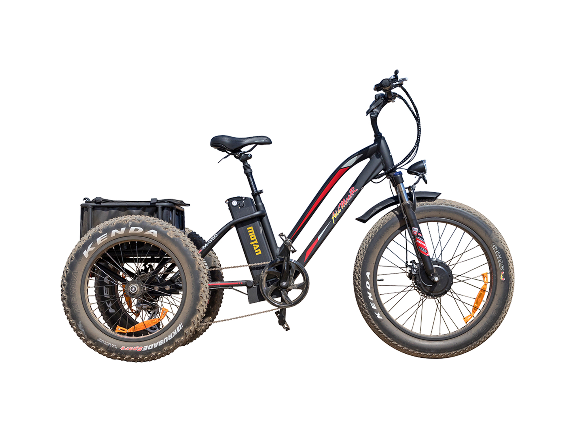

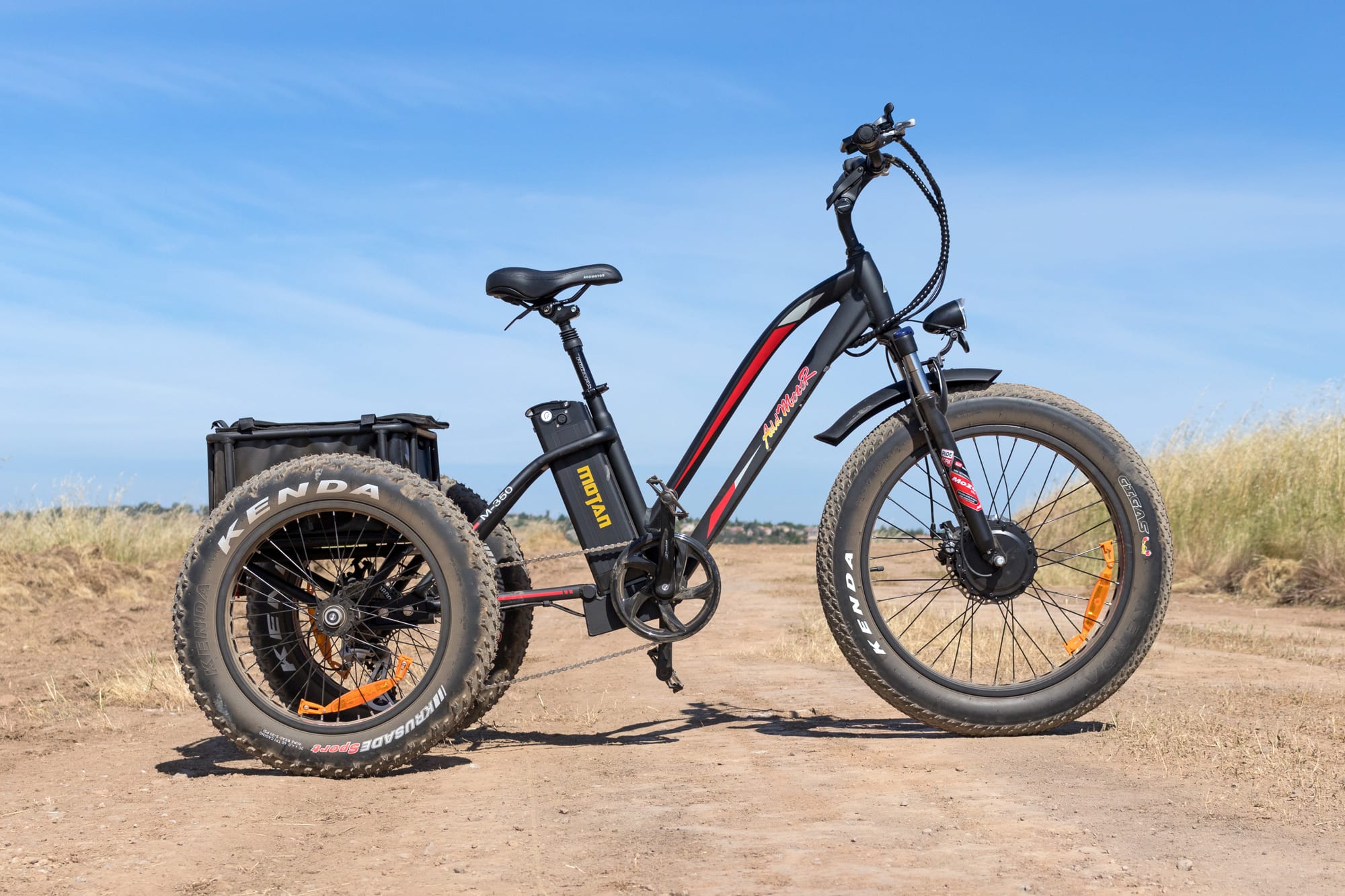

Hi everyone! This is Brent. The MOTAN M-350 from AddMotoR is an approachable fat tire electric trike that offers good power thanks to the Bafang 500-watt front hub motor and a comfortable ride thanks to the front suspension and seat post suspension, not to mention the extra cushy fat tires. At the time of this writing, the 500 watt version of this bike is priced at $2,599, but interestingly the 750 watt version, which also has a lager capacity battery, is on sale for $2,099. The front suspension has 80 mm of travel, and in conjunction with the high air volume of the front 24 inch by 4 inch front tire, tackling small bumps feels like almost nothing at all. The seat post suspension has about 30 mm of travel, which may not sound like a lot but it does a fair job of soaking up some of the extra shock that the rear 20 inch by 4 inch tires miss… And, that’s a good thing because the body position can be more upright with tricycles, and you can dial this in with the adjustable stem. All in all, it’s a pretty soft ride and the bike is incredibly approachable. It has a sort of mid-step frame with a low stand over height of 22 inches. I’m 5’10” and it’s very easy for me to stand with both feet flat on the ground without hitting the top tube. It’s also easy to balance at a standstill since it has three wheels! This bike screams “fun” and it has been just that for me. It reminds me of riding three wheelers when I was a kid — super stable at low speeds but boy do those rear tires love popping up when taking turns. This of course is true of all three wheeled vehicles that have only one wheel in the front, so it’s not unique to the M-350, but I definitely want to caution against the tendency for this trike to tip on uneven ground at medium and high speeds. I really needed to throw my weight from side to side when going over uneven sidewalk entrances, for example. Thankfully though, despite the M-350’s hefty curb weight of 82.2 pounds, the bike is pretty well balanced since the motor is in the front wheel and the battery is located behind the seat post. I haven’t loaded up too much weight into the included rear cargo rack, but I suspect that loading it to the 350 pound capacity will make it feel quite back heavy, as well as increasing the potential for the front wheel to lose traction on loose terrain.

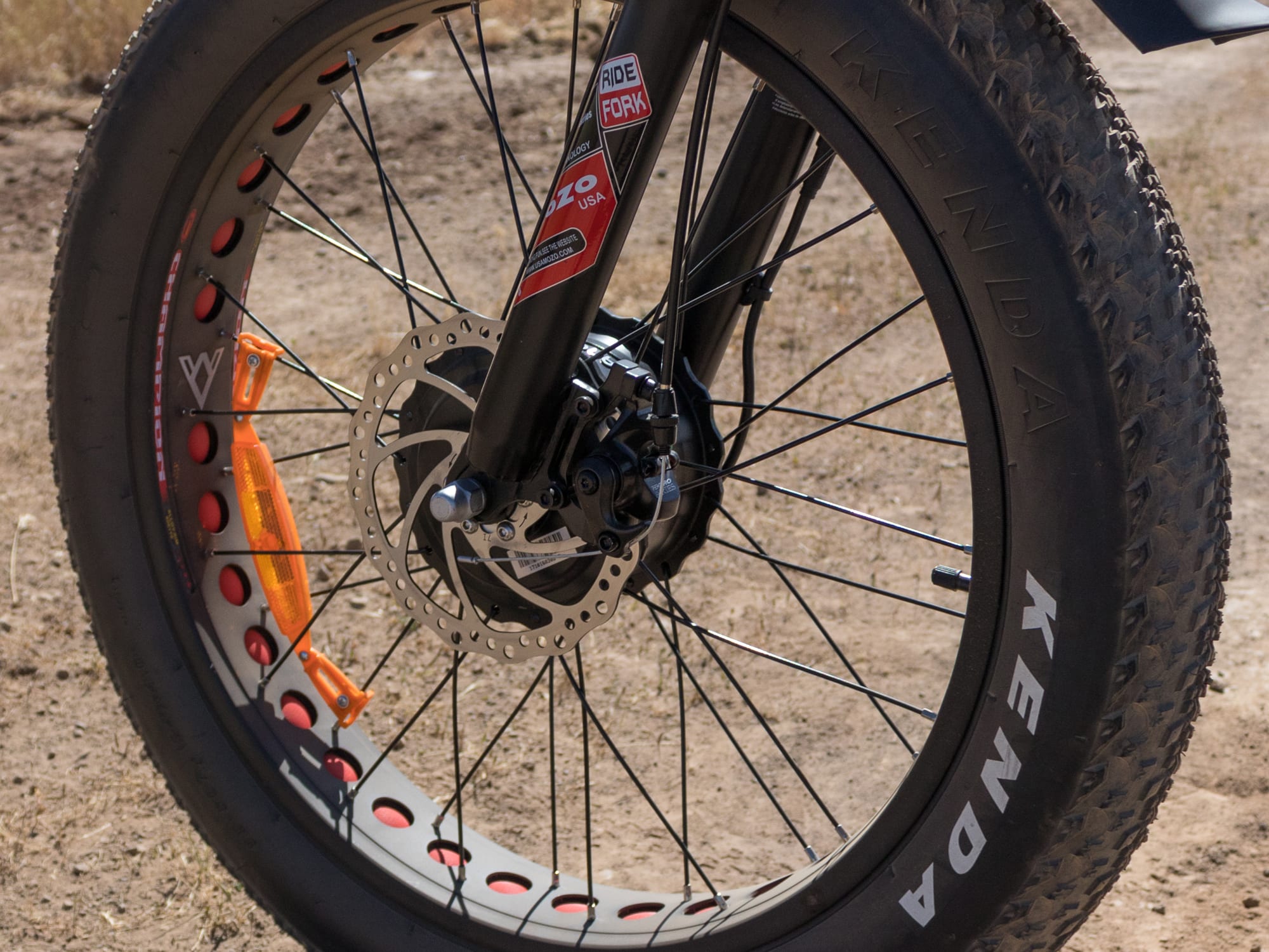

The brakes on the M-350 are mechanical disc style with a 180 mm rotor in the front and a 160 mm rotor on the rear. Since these brakes are mechanical, it does mean the brake levers aren’t as adjustable or easy to pull as hydraulic, which might make them difficult to use for riders with extra small weaker hands (especially with the heavier weight of the bike). Also, the rear brake only applies pressure to the right rear wheel, leaving the left rear wheel to spin freely. I closely inspected the rear axle to see if there was a screw or something I failed to tighten, or perhaps something I didn’t assemble correctly, but it appears this is by design. I found that having brake pressure applied to only one of the rear wheels makede for uneven stopping, leaving the bike with a tendency to sort of sag and pull towards the right when stopping. That being said, I feel the braking power with this bike is ample when there is not weight in the back, but again, I’d caution against going too fast when this thing is fully loaded as the brakes are not exactly overpowered. I’ve been running through the AddMotoR line and reviewing all their bikes (I think this one makes number 6) and there’s a few interesting talking points about assembly and the company I want to bring up. First and foremost, AddMotoR is a direct order only company with no physical brick-and-mortar shops at this time. Generally speaking, this means the prices are going to be noticeably lower compared to if they did have brick-and-mortar shops, which require more inventory around the globe (or country depending), more employees, and all around more overhead. Adding to the savings, AddMotoR doesn’t charge for shipping in the US! I’ve seen other companies that compensate for lower prices by charging several hundred dollars fo shipping. So the potential savings is a huge bonus. However, direct order only does come with some potential pitfalls. Namely, and this is true of my experience with AddMotoR, there can be a communication barrier that makes getting clarification on certain specs difficult. This might be an issue for some folks who want to really do their research before swiping the card to buy a bike, and since there are no shops to see the bikes beforehand, the company itself is one of the few lifelines for information and warranty support. Furthermore, with direct order only companies, there’s also the assembly to consider. The M-350 assembled fairly easily and all the components fit together well enough. However, on some other AddMotoR bikes, I have seen issues with tolerances for fenders and racks, and getting them to fit was difficult. Also, the box for this bike is quite large and looks almost like a refrigerator. I had to get this thing up my stairs and into my apartment and it was, without exaggeration, the most difficult thing I’ve brought up the stairs so far. With two people it would of course be easier, but this is just an experience I wanted to share with you all incase anyone else lives on a second story or higher. A couple more things I want to point out before really diving into this review here… the M-350 only comes in one frame size — 16” — and one color: matte black with red accents. Having only one frame size will limit a bit who can ride this bike — extra tall or short riders might not be comfortable — but thankfully, the stem is adjustable and can be lowered to extend reach and lower the posture, or raised to shorten the reach and raise posture. Ok, let’s dive in!

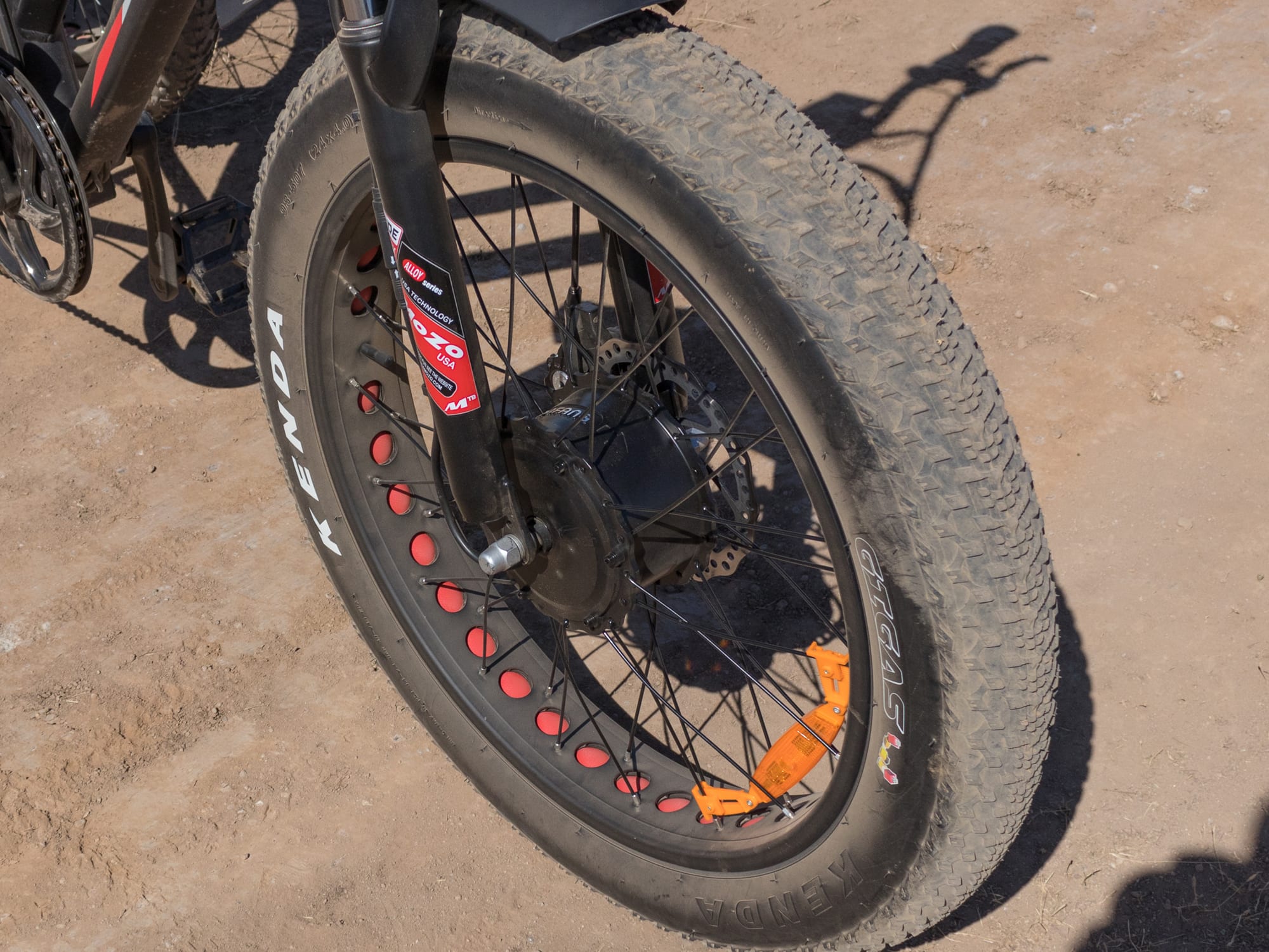

Driving the M-350 to a top pedal assist or throttle speed of 20 mph (the top speed can be adjusted to 25 mph in the settings for those who want to go a bit faster) is a Bafang 500 watt geared hub motor in the front wheel. This motor is actually quite peppy, especially off the line thanks to the 80 Newton meters of torque it can crank out. Accelerating fast like this however, will drain the battery faster. In pedal assist mode, the motor responds to a 12-magnet cadence sensor. This has a higher resolution and is more sensitive than the common 6 magnet and 8 magnet cadence sensors I’ve seen elsewhere, but it is still slow to start and stop power from the motor compared to a torque or multi-sensor. From a dead stop, it takes about .5 second to 1 second before the motor kicks on. The throttle was defective on the M-350 that was delivered to me, but based on the other AddMotoR bikes I’ve reviewed, this throttle is likely live at 0 mph, which is great to override the pedal assist and get the bike moving from a standstill. I think this would be especially useful when there is heavy cargo in the back or if you position the saddle low for easier mounting and stability (which would limit pedaling comfort and leg extension). The motor itself one of the louder Bafang motors I’ve tested and has a noticeable buzzing whine at the higher RPMs. Also, since this motor is located in the front wheel, there’s a higher chance of slippage compared to a rear hub motor, particularly on looser terrain — which this bike can definitely tackle thanks to the suspension and fat tires. I wouldn’t be too concerned about slipping, however, because the front wheel is larger 24″ vs. the smaller 20″ which keep the basket lower and provide more stability. With a larger front wheel, you get a lower attack angle and more stable turning. I haven’t noticed any slippage whatsoever on pavement so far in my rides, probably because the tire patch is just so large and the trike weighs more than average.

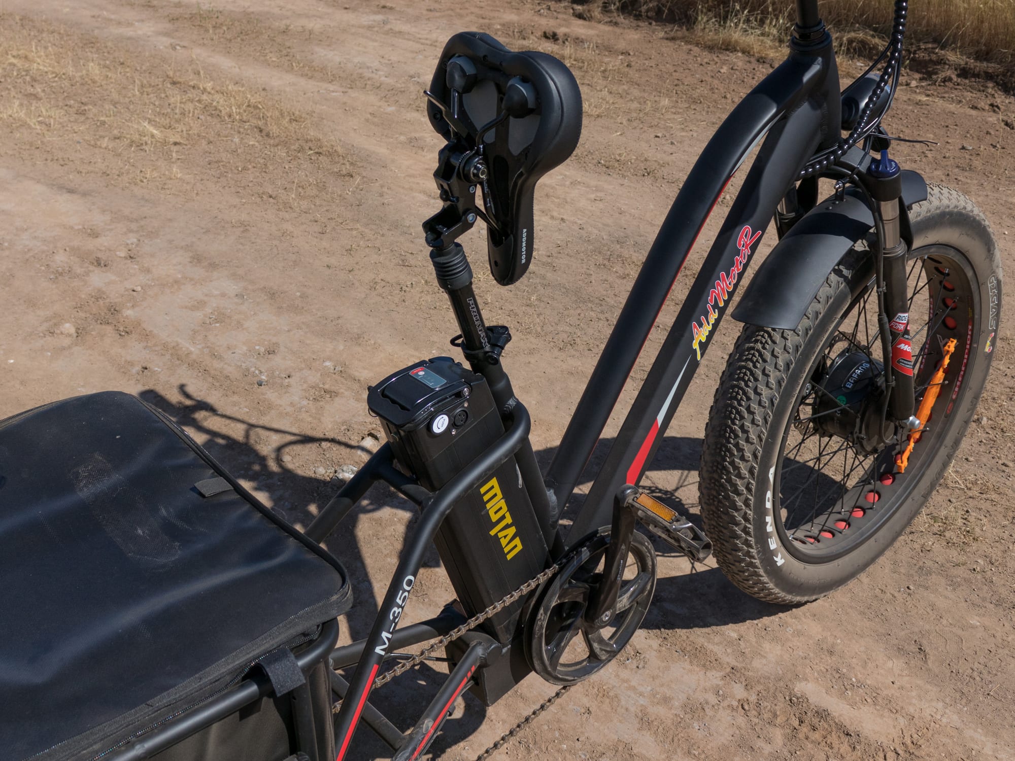

Powering the M-350, the integrated headlight, and the backlit LCD display panel is a 499.2 watt hour silver fish style Lithium-ion battery pack that weighs approximately 7.4 pounds. Normally with these silver fish style batteries, the seat post has to be completely removed before the pack can be taken off. With the MOTAN M-350, there’s a quick release on the seat post to flip up the saddle forward and make room to slide the battery up. Nice! The headlight is a Spaninga Trendo and has a fair beam pattern with a focus on throw and some spill that looks striated, kind of like a bar code. It’s not optimal in my opinion, for illuminating my path, but it does do a good job of increasing the overall visibility of the bike, especially since this is a black frame which is harder to see at night compared to brighter colors. The headlight is mounted to the arch of the suspension fork, so it may bounce up and down more than if it were positioned on the handlebar or steering tube of the bike. There’s also an independent taillight that takes two AA batteries and turns on and off with a depressible button. It’s a steady on and doesn’t blink. With trikes, the rider is usually positioned a bit lower, so the inclusion of lights is a great way to improve safety… but the rear light will be easier to forget (both turning on and off) because of the manual button there… it doesn’t run off of the main battery pack like the headlight and could easily be forgotten and drained to zero if you aren’t really paying attention. It’s nice that the main battery is removable to allow for charging separate from the bike, especially since the M-350 is wide and heavy. And on that note, I want to mention that the width of the M-350 is just about 30 inches, which is also about the same dimension for the handful of door frame that I’ve measured. I’ve tried pulling this bike through the house and have found that it fits through some doors, but not all. Just something to keep in mind! The charging port on battery is located on the top, which is great for keeping the cord clear of the cranks when it’s on the frame and plugged in. In order to operate the electronics on the bike, the key must be left inserted into the battery. I’ve noticed that with this type of setup, my ankle and shoe can sometimes strike the key when pedaling (especially if there’s a keychain attached). I haven’t found that to be the case with this bike, but just throwing it out there as it would be unfortunate to have someone hurt themselves or damage the battery itself… and you may still get some key jingling as you ride.

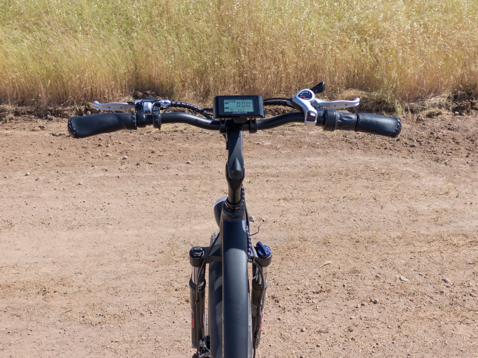

The control center is a Bafang C01.UART backlit LCD display that has a full size USB Type A port below and a good amount of information at the ready. However, it’s not adjustable without tools, which means angling it on the fly to avoid glare is a no go unless it’s not tightened down all the way. Normally at this point I talk about how the screen can get scratched as well if it’s left at a public bike rack, but that might not be as much of an issue with the M-350 since the wide back end will likely force other bikes to give it space on the rack. The readings for this display are assist level (0-5), current speed, max speed, average speed, battery level (4 Bars), odometer, trip meter, timer and watts. Holding up and the Mode button activates the lights, holding up toggles between current speed and max speed, holding up and down enters into settings, holding down enters into walk mode, and tapping the Mode button toggles between tribometer and odometer. Whew! That was a lot. :) Out of the box, the M-350 has a top speed of 20 mph making it a Class 2 product because it also has a throttle, but that can be adjusted up to 25 mph in the settings menu. I’m not sure I’d want to raise it at all though, because there’s a higher potential to tip as you raise the speed. The pedal assist modes feel unique, with 1 being noticeably tamer than 2, 3, 4 and 5, respectively. Also, in order to use this bike without the motor, it must be placed in 0. Interestingly, this is the first electric bike where I DON’T want to keep it in the top pedal assist mode because it’s too powerful and too fast. It just gets moving too quickly for me and at higher speeds and the trike configuration can feel a little squirrely. Instead, I would prefer the more controlled and possibly gentle acceleration of the twist throttle (just based on twisting slowly) but again, the throttle on my demo unit didn’t work. The button pad is on the left and snugged up nicely to the edge of the grip, and I can hit the buttons without having to reposition my hand which makes it feel safe and controlled. There’s a bell built into the left brake lever that is easy to reach and satisfying to chime, I really like this configuration because it doesn’t clutter the bars or force the control pad in further.

- Display is pretty bright and can be seen in broad daylight and also at night since it’s backlit, also has quite a bit of information on hand and is larger which makes reading easy

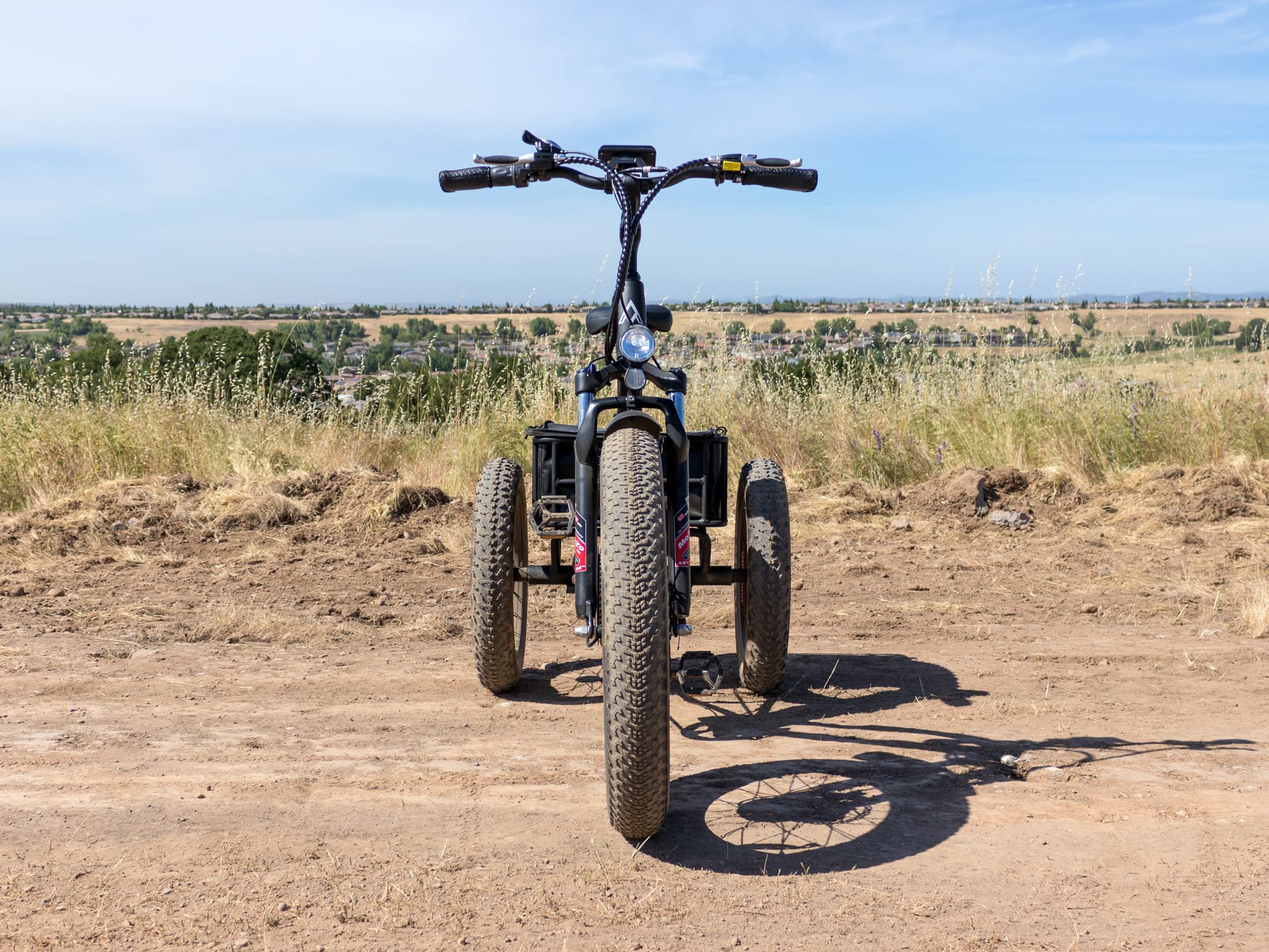

- Fat tires offer tons of traction and increased suspension thanks to the high air volume, they also help to ensure the front wheel doesn’t slip since that’s where the motor is located, if you lower the tire pressure this e-trike can actually ride on softer sand, snow, or loamy trails

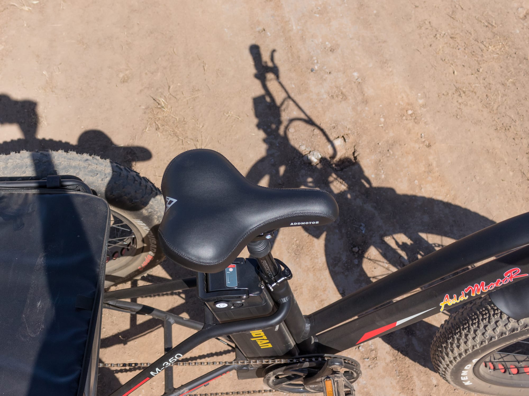

- Seat post has suspension and quick release to adjust the height, as well as a hinge to flip the saddle forward for removing the battery without having to take the entire seat post out, the suspension here helps make for an even smoother ride as well
- Battery is locking and removable and has the charging port at the top so it stays clear of the cranks when it’s plugged in, this helps ensure the cord doesn’t get snagged when it’s plugged in which could potentially damage the battery

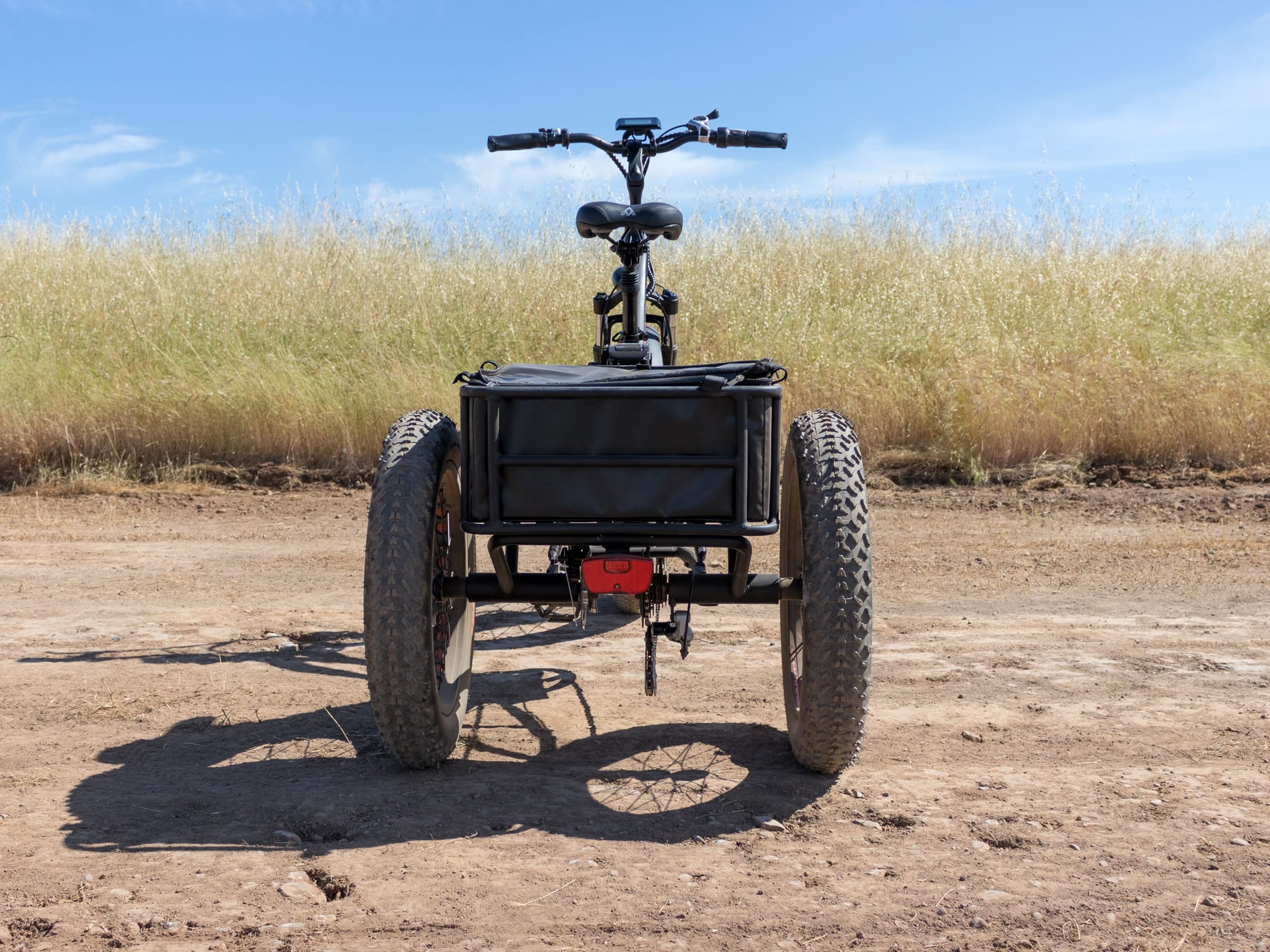

- Included rear cargo rack bolts down to the frame to keep it nice and sturdy, it also has an included liner with a vinyl coating to help keep rain and moisture out and reduce rattling, theres also a zippered top which helps to keep cargo safely inside the bag and lower the center of gravity for improved stability
- Bike is surprisingly well balanced despite the 82 pound curb weight as the motor is in the front and the battery is behind the seat post

- Display isn’t adjustable without tools and can’t be angled on the fly to eliminate glare, I do love that it’s large and easy to read, and the integrated USB port below

- Motor placement in the front wheel makes the wheel more prone to slipping when tackling loose or wet terrain, motor is also quite noisy at higher power and speed compared to some others I have tested

- Rear brake rotor is smaller 160 mm and only applies braking pressure to one of the rear wheels, this makes the bike pull towards the right side when braking and can increase the tendency for it to tip if braking while turning
- Trike design is prone to tipping and this can be extremely dangerous for people unfamiliar with this design, strong caution is recommended to riders for when they first try this bike out and I probably wouldn’t raise the top speed

I think the only issue so far is that the battery pack is difficult to remove from the bike. Not an issue for him since he just charges the battery while still on the bike. Other than that, he really loves it.
court says
Yeah, this style of battery is fairly common in the industry and can be tricky to slide up and down. It’s easier to repair and replace, keeps weight relatively centered on the frame, but isn’t as elegant or simple to use (having to flip the saddle up to get it off, and not every ebike has a swivel saddle mount like this MOTAN M-350)
