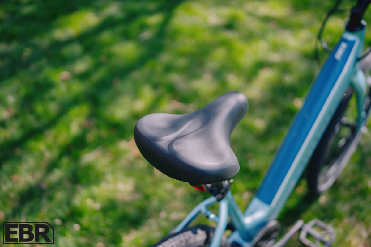

Comfort in all other areas of the pace 4 is spot on and plenty comfy. The saddle is plush and complimented by the suspension seat post. The lock-on rubber grips have a nice feel and add to hand comfort, especially in wrists and joints, an area common for frustration among those of us that ride often enough.

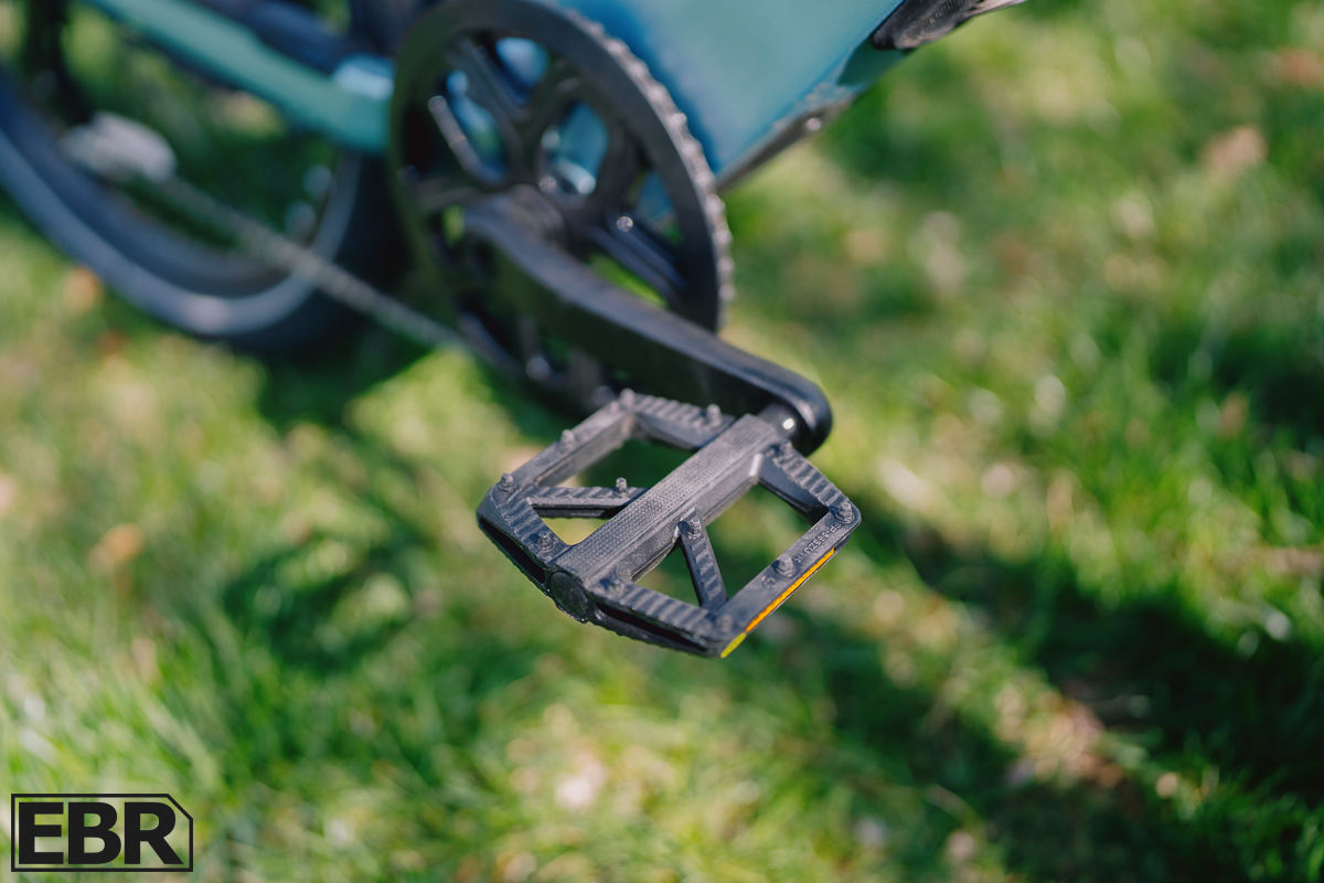

Aside from the new tech and handlebars, the component basics are all in place, we have an 8-Speed Shimano drivetrain built on the same 48T chain ring with a 12-32T cassette with a 3-piece crank and 170mm alloy cranks. Pedals are the flat composites with slight studs and reflectors for some added traction and visibility.

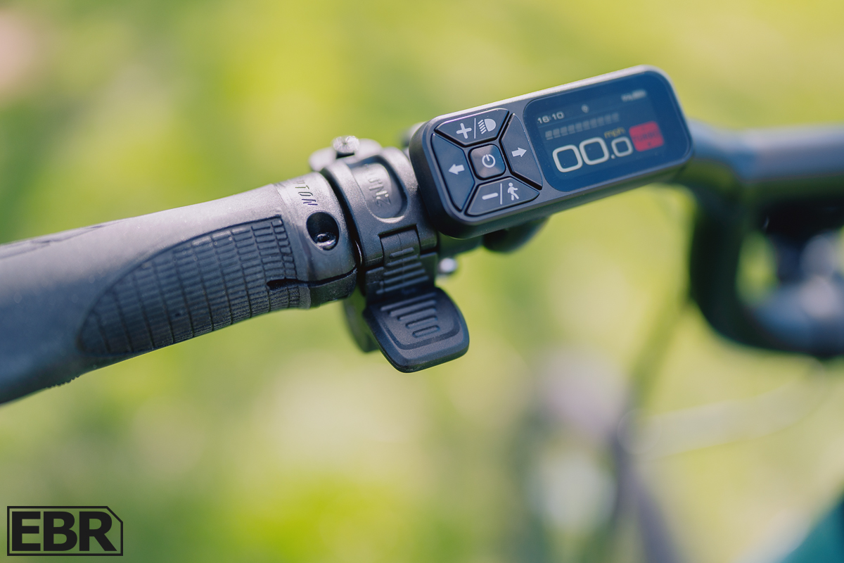

Beyond its MP3 player aesthetic and control of the ACU security features, the BC147 display displays all the needed info for your rides like speed, time, battery level, PAS and Riding modes. Holding the ‘+’ button will activate the lights and holding the ‘-’ button will activate walking mode, a subtle 3 – 4 MPH pace so you can walk with your bike somewhere instead of dragging or pushing it. Holding both plus and minus will allow you to tweak additional settings like speed, display brightness, battery release and more.
The Aventon App quickly and easily pairs to the bike via a QR code through the app and with it connected, a suite of new options is at your fingertips. Aside from the security features already discussed, you can also adjust speed and power, do a little motor tuning yourself to tweak the torque and power to match your style. Plus, the app has the ability to quickly locate all the Aventon dealers and service centers nearby. And if you are really in a pinch, you can access Aventon support right from the app as well.

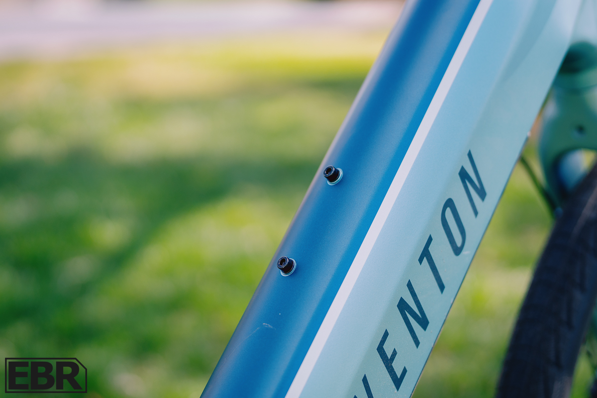

In terms of accessories, Aventon let me know there are no new ‘Pace specific’ accessories, but the bike comes equipped with several mounting points so you can equip the Pace to match whatever your day has in-store. Mounting points are along the front fork arms, on the seat tube and points for fenders and racks.
