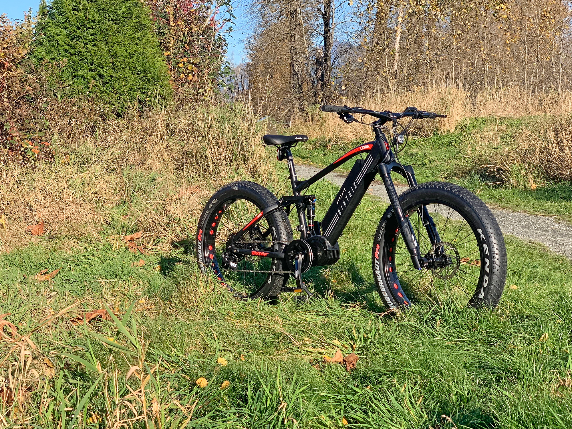

- The Biktrix Juggernaut Ultra FS was overhauled for 2020 / 2021 with an entirely new frame geometry. We reviewed the 2019 version a while back, and I was excited to see this new model because there are very few full suspension fat tire ebikes in existence today. This one has a powerful multi-sensing mid-drive with physical shift detection! That makes it powerful, well balanced, and fairly durable. The biggest downside I saw was that the power of the motor sometimes flexed the rear swing arm, causing the gears to “phantom shift” and cause crunching / mashing. This is especially true for heavier riders or when operating at full power and ascending.

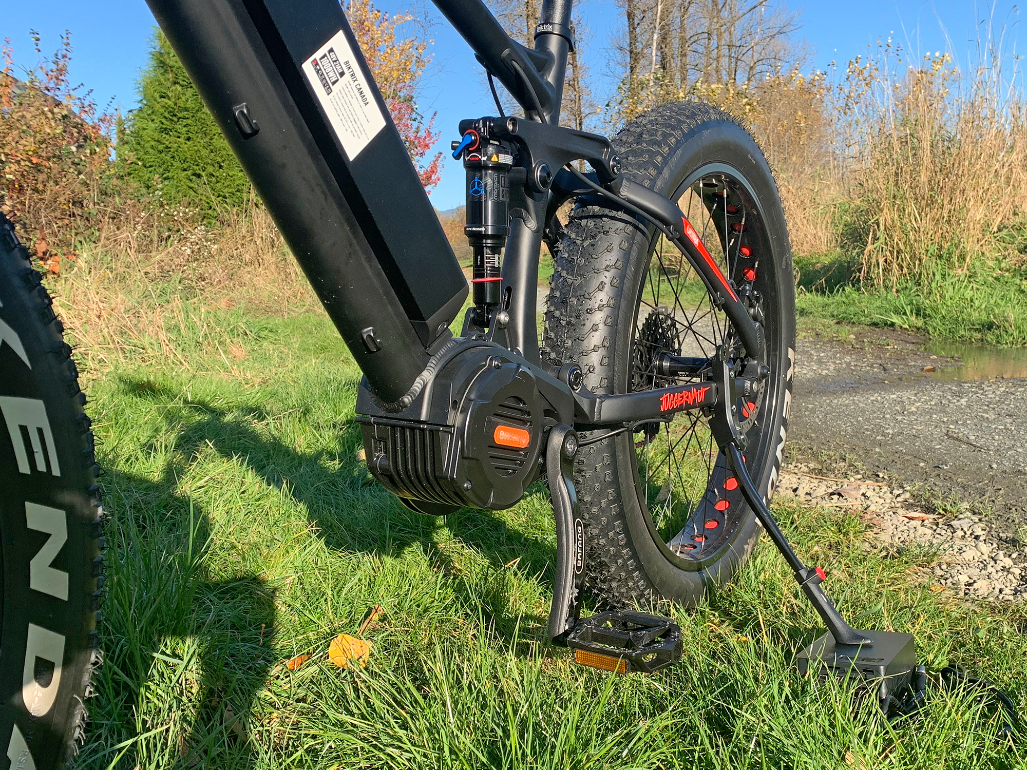

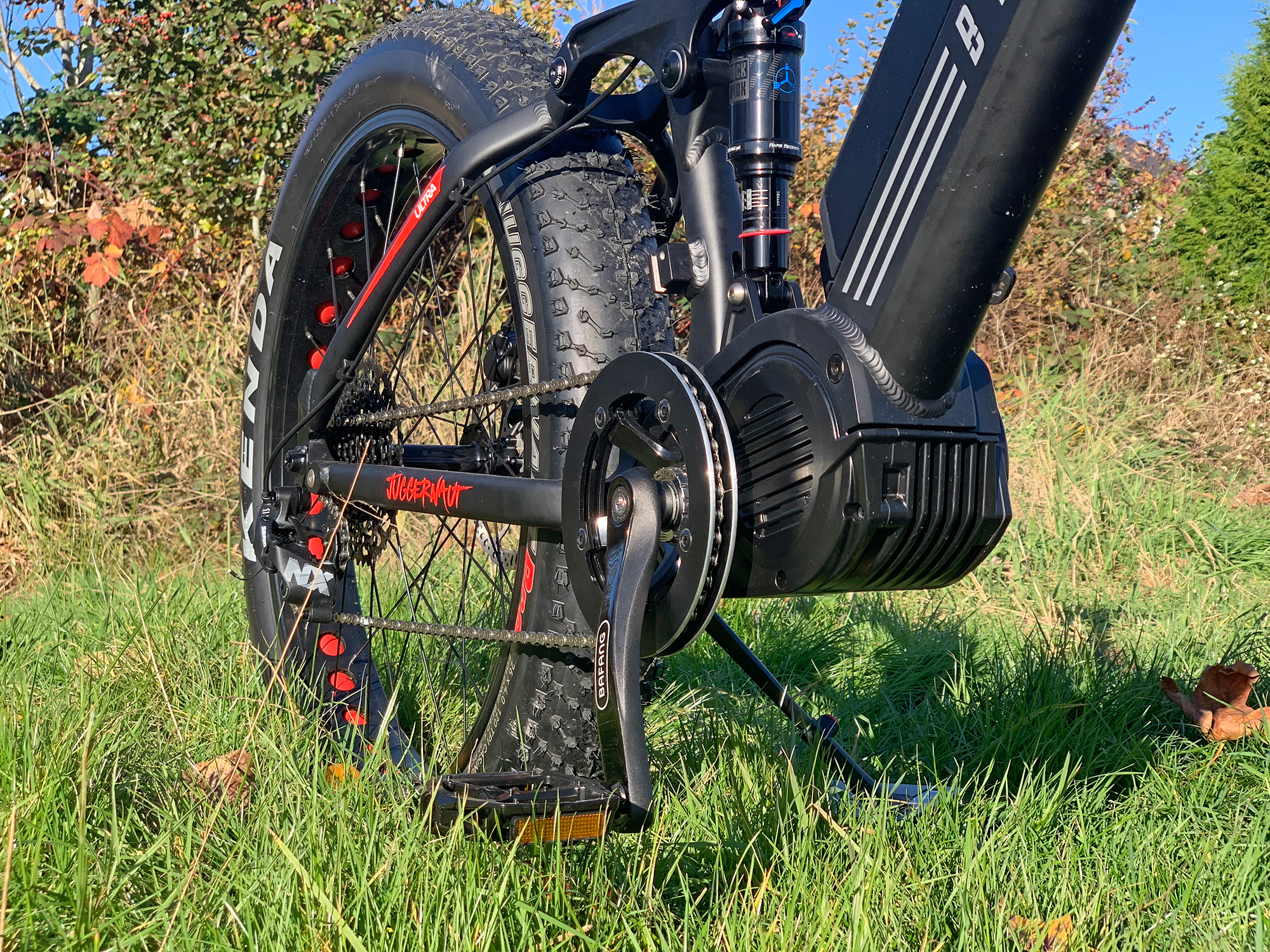

- Great motor choice, given the heavier weight of the bike and possibility of larger tires (like the 26″ x 4″ on my demo model) the Bafang Ultra M620 was a good choice. It delivers an incredible 160nm of torque and the motor controller listens for rear wheel speed, pedal cadence, and pedal torque.

- For this review, I was riding the 17″ small-medium frame size in black. Biktrix also produces a 19″ medium-large and both can be had in black or brushed aluminum alloy. Coming back to safety, the brushed alloy will probably offer an improved visual footprint and just be brighter for cars to see, but even the black has some nice white accents.

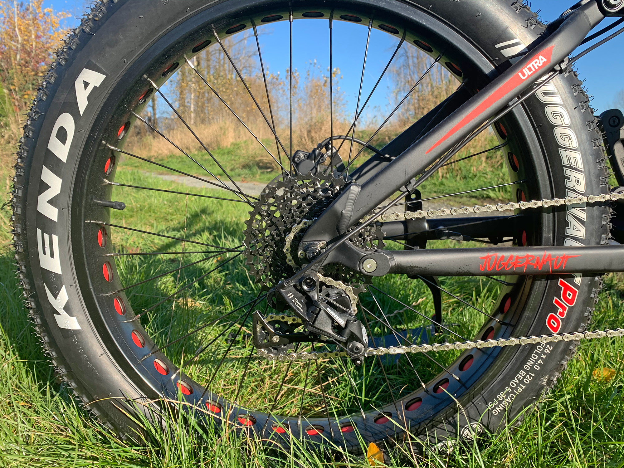

- The 11-speed drivetrain is pretty great. It uses a SRAM NX derailleur and offers an 11 to 42 tooth spread for comfortable pedal cadence options when climbing or riding at high speeds. This bike can go up to 35mph when unlocked, after all. The steel chainring uses a narrow-wide tooth patter than really grabs the chain, and also has a thick aluminum alloy guide that doubles as a bash guard for off-road use.
- One of my favorite parts of this bike is the physical shift detection setup. This significantly reduces wear on the chain, derailleur, and rear sprockets. It’s a must-have for such a powerful motor, but wasn’t completely necessary given the multi-sensor torque sensing motor controller. Biktrix used the part and also added motor inhibitors to both brake levers. Great job here!
- The motor itself is very powerful, but not super loud. The motor controller measures rear wheel speed, pedal cadence, and pedal torque. Aside from being a fairly heavy and large motor, I love everything about it! It offers 110 RPM pedal support and up to 160 newton meters of torque… which is incredible. Most ebikes I test only offer 80nm or possibly 90nm. Thankfully though, it’s the kind motor and controller setup that lets you go slowly and gently even in the highest assist level if you aren’t applying a lot of pedal pressure, it’s great for more technical riding, or doing wheelies ;)

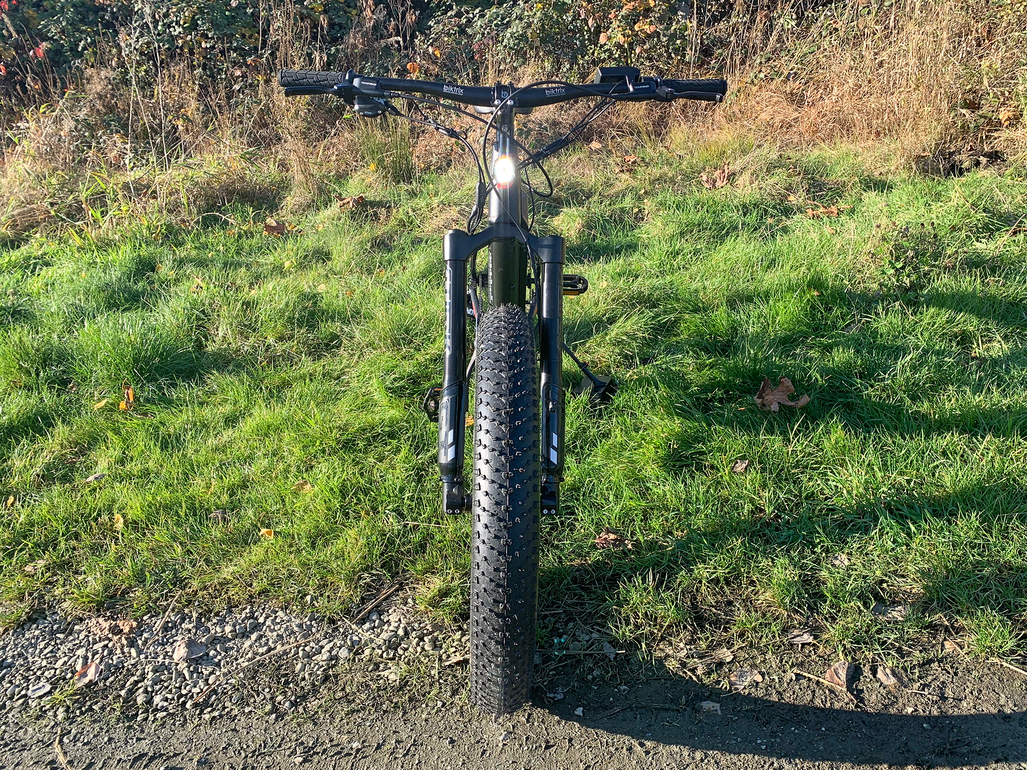

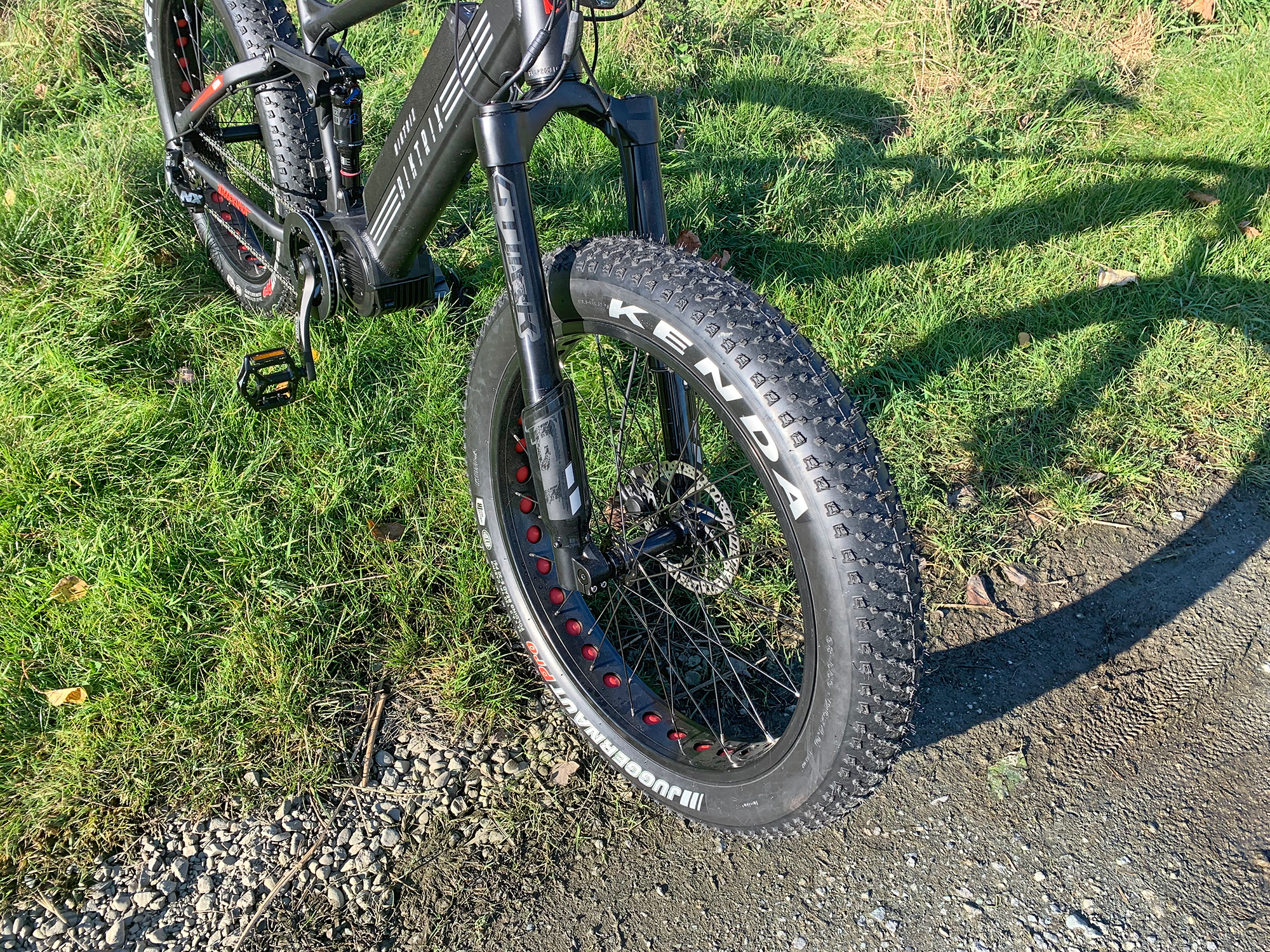

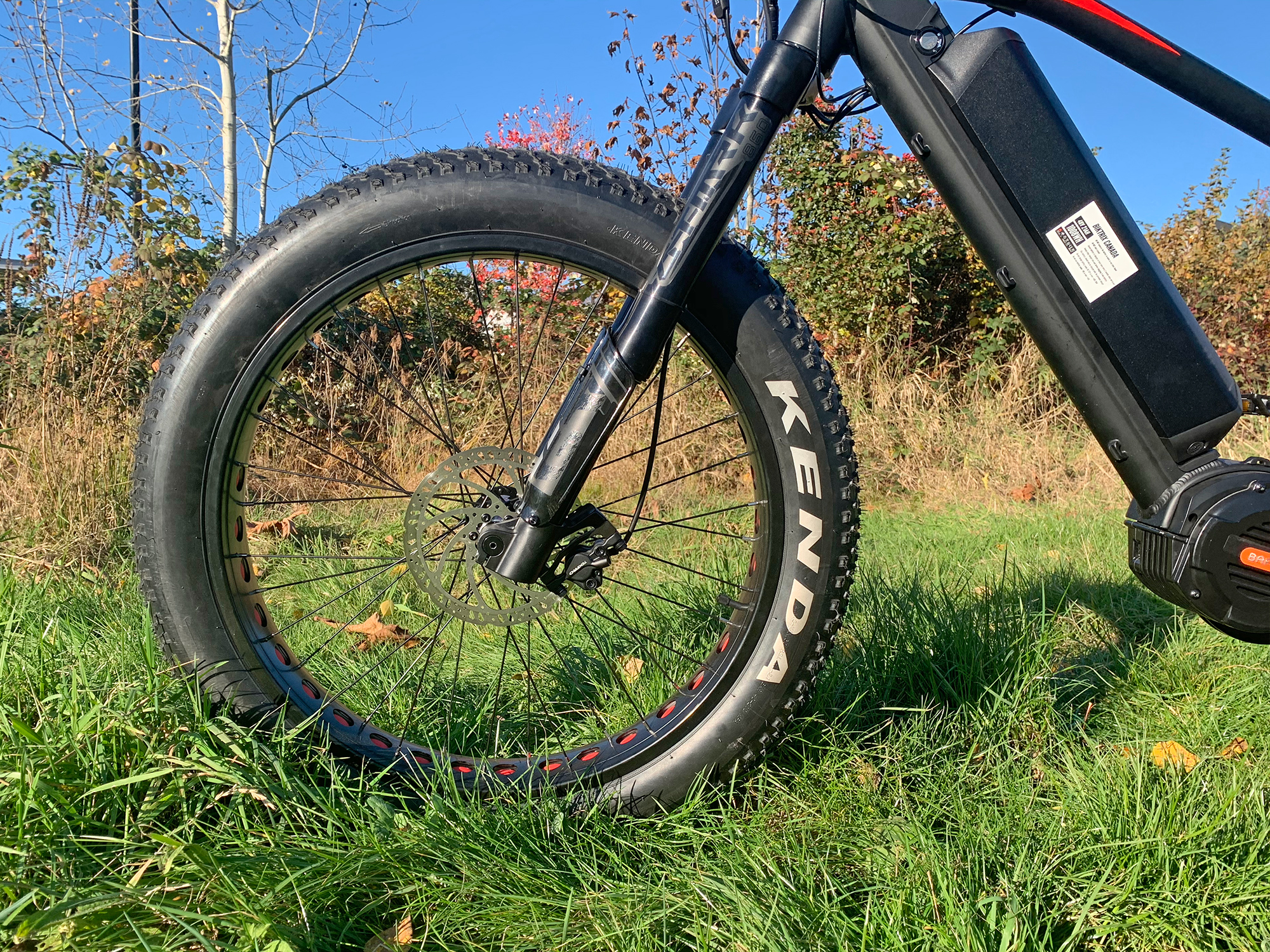

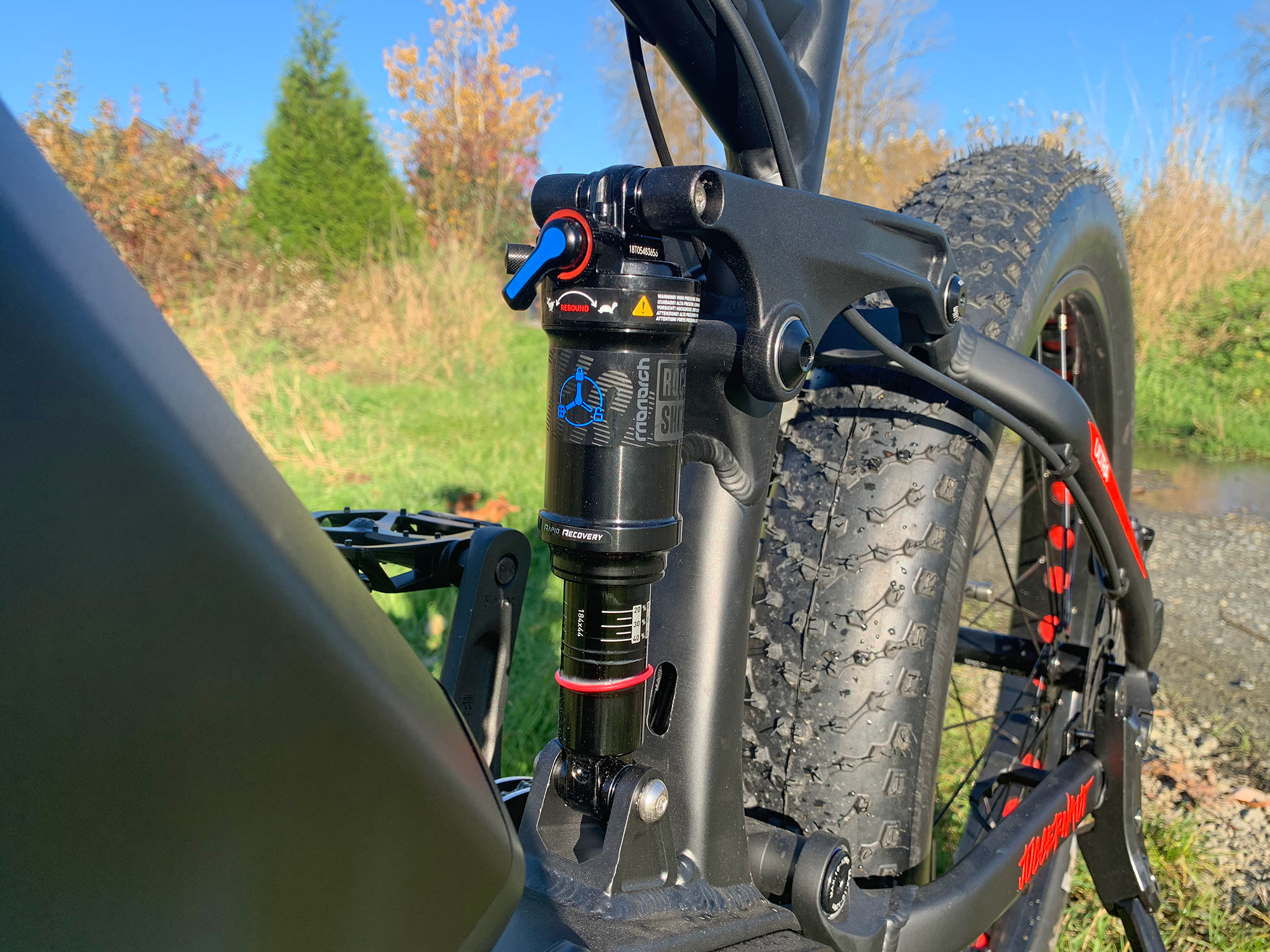

- Given the power and weight of this bike, combined with the heavier wheel and tire options (4″ fat tires), I love that they chose an inverted suspension fork with sturdy 15mm thru-axle! Inverted suspension is stiffer than traditional, and the stock suspension fork offers compression adjust, rebound adjust, air pressure settings, and it has lower stanchion protectors with black anodized stanchions. It’s pretty sweet, and not something I’m used to seeing outside of downhill bikes. The stock suspension and first level upgrade offer 100mm of travel, but the highest level WREN upgrade offers 130mm of travel. As cool as it all is, the rake is a bit relaxed for me, and the longer travel WREN could change the frame geometry. I feel like this is a half downhill half cross country hybrid that is a bit awkward at times.
- If you do choose the tire, suspension, brake, or battery upgrades, Biktrix will install them all for you. This isn’t the kind of ebike where you get it in multiple parts and have to do a lot of work to get going. Just attach the front wheel, turn the handlebar, put on the pedals, and maybe do a once-over inspection to make sure everything else is secure and shifting properly.
- One more thing about the tires, the fat Kenda Juggernaut Pro tires come tubeless ready (so you can convert to tubeless). This allows them to ride at lower pressure without the risk of pinch flats, and it also reduced the weight of the tires which reduces the overall weigh the bike but also reduces the work that the suspension has to do by lowering unsprung weight.

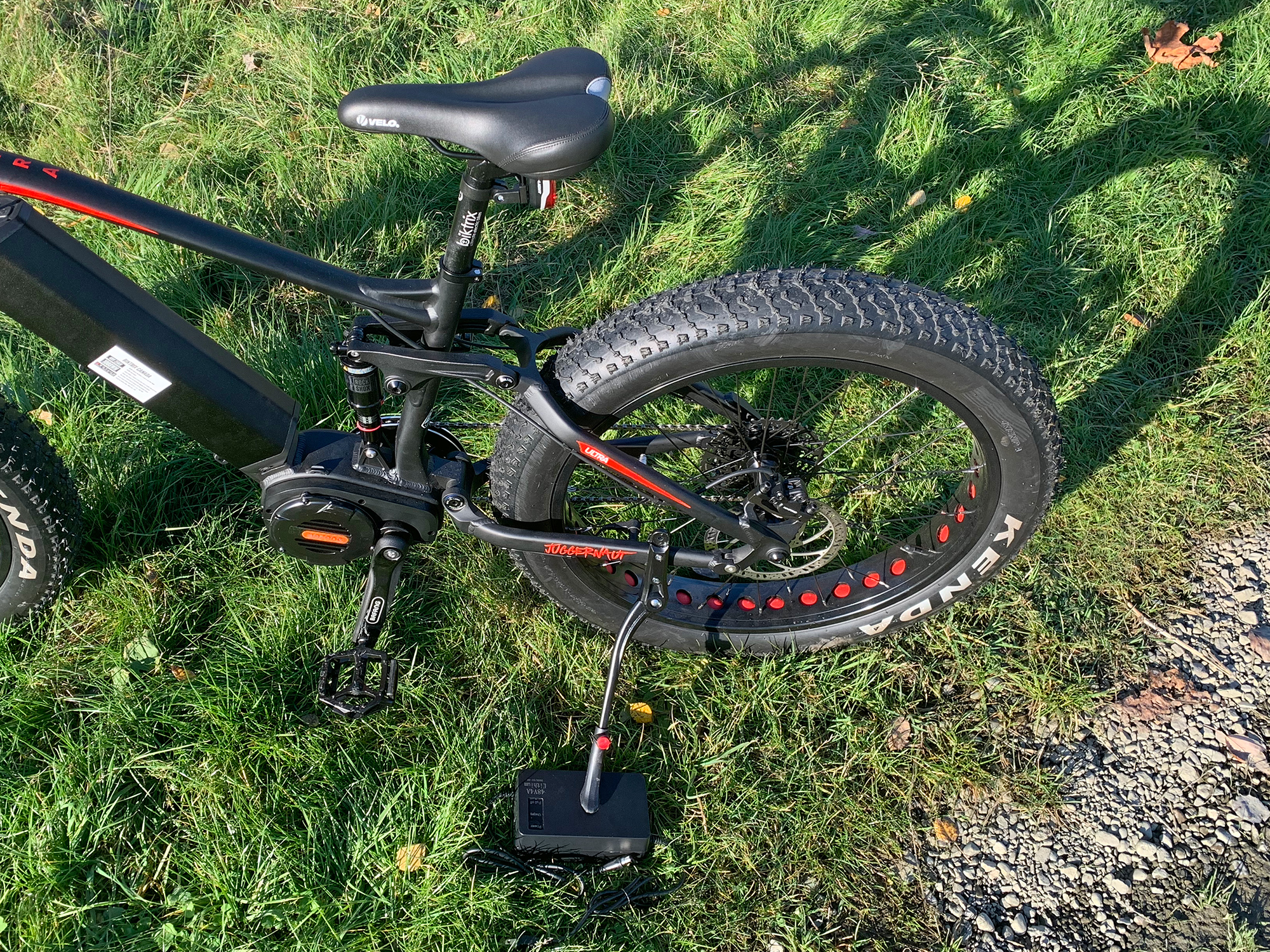

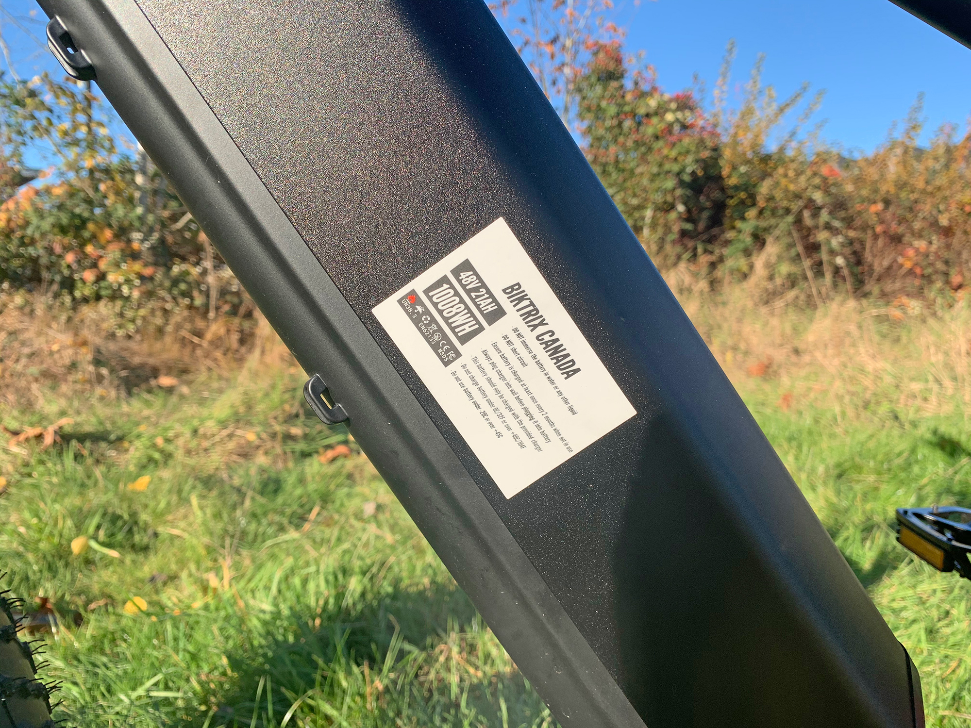

- I like that the Reention Dorado battery packs all have a full sized USB Type A charging port on the top right hand side. This could be useful for charging a phone while riding (just don’t snag the cable), or as a power bank if you go bikepacking and need to run a small light in your tent.

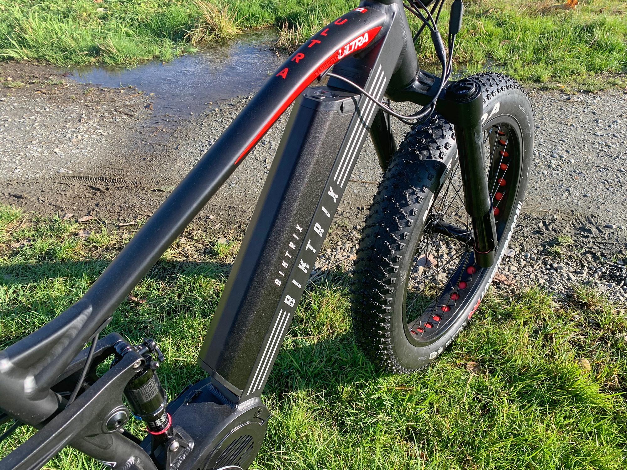

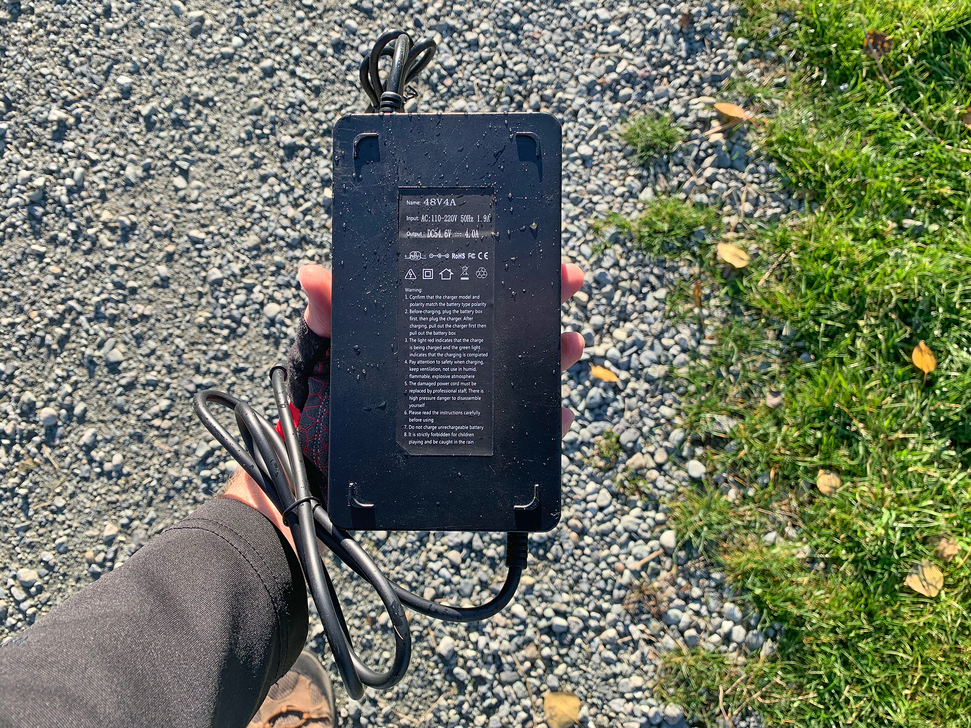

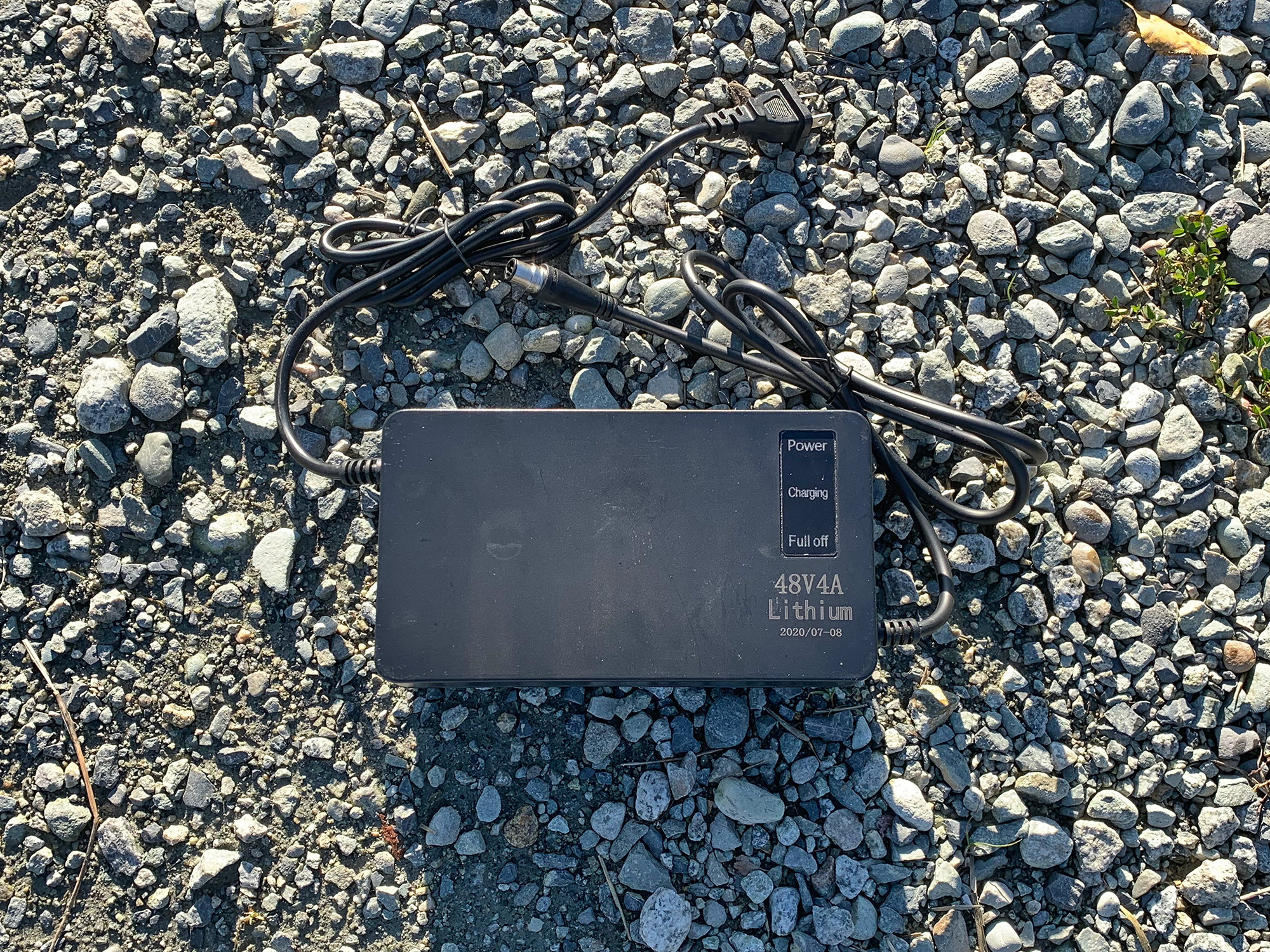

- Having a removable battery and 3.5 or 4 amp fast charger is great, because it lets you protect the battery cells from extreme heat or cold, and spend less time in between rides. Many comparable ebikes come with slower 2 amp chargers, but Biktrix starts with 3.5 amp and then upgrades to 4 amp for free along with their larger battery packs.

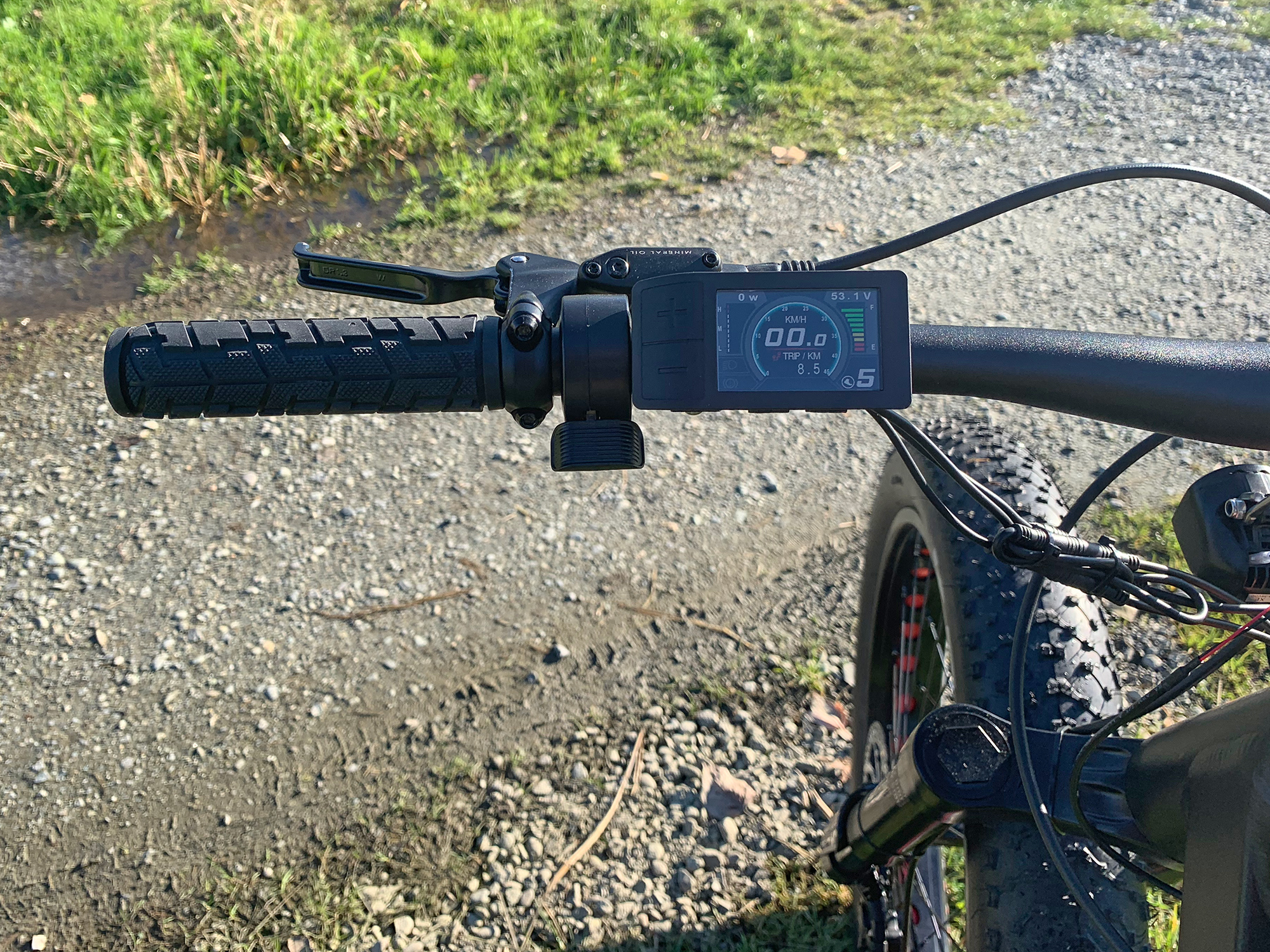

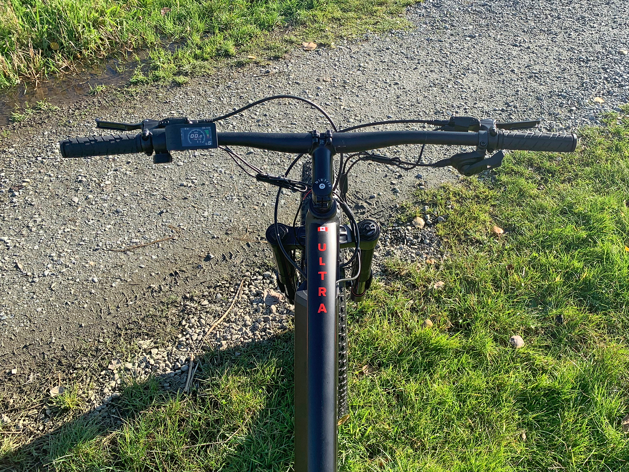

- The stock display is pretty nice, it’s large and produces some haptic buzzing feedback when buttons are pressed. I was told that Biktrix also has an optional replacement called the Bafang 500C for those who prefer a different menu system. I was fine with the stock display, which is shown in the pictures and videos above.
- I love that Biktrix offers shorter 152mm crank arms for this bike, because it allows people who want to pedal through turns to do so without creating pedal strike. It’s a unique offering that I rarely hear mentioned, and it speaks to the different type of riding and advanced torque sensing drive system on offer here. I was told that compared to the prior 2019 model year frame, the latest version has 1″ increased ground clearance as well.
- Other upgrades for this new model include new bushings, new suspension geometry, shorter chainstay (for stiffness and quicker turning), slacker head tube angle to increase stability at high speeds (they say it’s more planted)

- The biggest downside to this setup that I and my friends noticed after taking multiple test rides is that the powerful mid-drive motor pulls so hard on the drivetrain, that it flexes the rear swing arm a bit and can cause phantom gear shifting if you’re in the highest gears. This can damage the chain and rear sprockets, you can hear them crunching during parts of my ride test when I climb a very steep hill at 30:47. You can reduce this by accelerating more gradually or using the lowest gear (or gears that are more inline with the chainring). The phantom shifting may be more pronounced for heavy riders, those operating in the highest level of assist, and those climbing steep hills.

- This is a very minor complaint, more of an awareness point to be shared, but the extra large battery pack upgrade for this bike is not symmetrical. It will bulge out to the left side of the frame which could compromise handling a bit and become prone to kicks and scratches.
- The battery charging port is very low, positioned near the left crank arm. This makes it vulnerable to snags and bumps by the cranks, and difficult to see and reach when charging. It definitely helps to have a kickstand to balance the bike when plugging in and charging, and that will cost extra! I recommend the kickstand for urban and light cross country use so you don’t have to lean the bike over or risk having it tip as easily. For those taking on all-mountain or downhill conditions, the kickstand could bounce a lot more and crank arms could strike… so consider their shorter 152mm crank arms and then be careful when leaning the bike over and charging… ideally you’d lay the bike on the non-drivetrain side, but again, this is where the charging port is, so maybe just remove the battery pack to charge each time.
- Other minor complaints include the display not being removable (you can swivel a bit to decrease glare), the lack of a derailleur guard for off-road riding and protection during shipping, and lack of any bottle cage mounts.

Court, as I posted in the forum here, I think a close examination shows that it’s not that the rear swing arm is deforming, but that the pivot points for the rear suspension have some play in them. Take another look and let us know what you think.
Court says
Oh yeah, I agree with you. I saw the frame shots and see how the flexing appears to happen at the pivot points mostly, not the alloy tubing. I think that I just used the wrong words to describe it, or was generalizing… like saying “the swing arm” incorporating all of those parts together as a unit, not specifying where the play was happening exactly. Thanks for your input!

Hey Court, amazing review! Very detailed, definitely the depth this bike deserves. Just got one question. The 2019 model had eco/tubro modes for the motor, making it more of a 10 level pedal assist rather than just 5. Did they get rid of that in the new model?
Court says
Hi Robert, that’s a good question. I try to go very deep when exploring displays and testing bikes, but this is something I didn’t notice and couldn’t recall from memory… so I decided to call Roshan and ask for you :D
He told me “YES” it still has two power modes like you described. You just press and hold the + button to enter into sport mode or press and hold it again to go back to eco mode. Roshan said that the screen turns to a red color scheme for sport mode and that it’s green for eco, so that’s another visual cue. It looks like I missed this in my review, sorry about that Robert! Great question though :)
Robert says
Thank you for looking into that, Court! I have the 2019 model so I was surprised why they’d limit such a powerful motor to just 5 modes in the new model. Turns out everything is as it’s supposed to be. This is just a minor miss though, your review is as always incredibly thorough and helpful!
