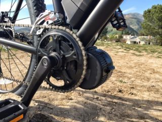

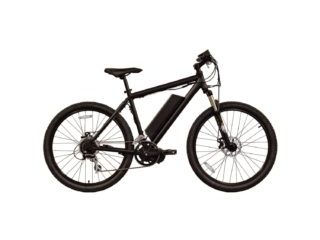

The BM-Shadow is the most affordable offering from BMEBIKES, an electric bike company based in North Los Angeles that’s dedicated to off-road electric bikes. Their slogan is “electric mountain bike specialists” but to me, the Shadow is more of a trail bike because it uses the standard (larger) size front chainring that comes stock with the BBS01 mid-drive motor from Bafang (8Fun). That’s not a bad thing, in fact this model performs well on street, trail and even light mountain terrain but may struggle with prolonged climbs and ultimately overheat. That’s why all of the other BMEBIKES models come with an aftermarket Raceface NW sprocket in the front that’s a smaller diameter with fewer teeth. The Shadow 1.5 is an exciting model to me because it looks great, is well balanced, has a premium battery and comes in multiple sizes (17″, 19″ and 21″). You get a lot for your money here and there’s no reason you couldn’t pay a bit more for the smaller chain ring if you intend to climb a lot (these guys do custom orders) and upgrade the fork independently at a later date for improved performance, weight savings and lockout.

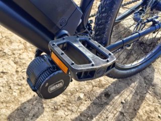

Driving this bike is a BBS01 middrive motor that’s mounted to the bottom bracket. It’s a compact, versatile drive system that keeps weight low and centered on the frame while leveraging your rear cassette for efficiency and strength. Even though it’s not as sophisticated as a Bosch or Impulse centerdrive, it’s a big step up from the older EVELO and iGo mid-drives I’ve tested. While it offers throttle on demand and pedal assist modes (using a built in cadence sensor) it does not include shift detection and may strain the rear derailleur, chain and cassette if you don’t shift gears carefully. To minimize this I found myself letting up a bit on the pedals while shifting and occasionally tapping the brakes (which have a built in motor inhibitor switch). The motor itself is compact, quiet and surprisingly strong for a 350 watt design… in practice I regularly topped out at over 600 watts when climbing so perhaps the rating is a bit misleading. I was told the amp output is slightly higher than average at 18 amps which might account for the increased power. For the money, the BBS01 is a solid aftermarket motor and the stock black casing matches the flat black color scheme that BMEBIKES is known for.

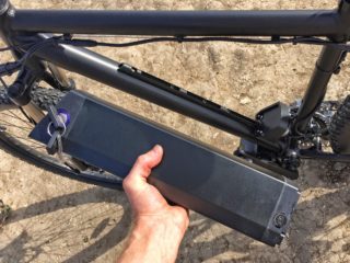

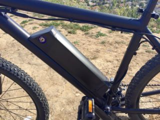

The battery powering the BM Shadow electric bike uses premium Panasonic cells that deliver a higher discharge rate (higher C Rating), offer higher energy density (lighter for the same amount of stored energy) and extended life (should age well). To really take care of the pack, store it in a cool dry place when not in use and try to keep it between 20% and 80% charged when not in use. The cells are all 18650 sized and are packed into one of the sleekest aftermarket packs I’ve seen. It slides easily onto a metal rail that’s mounted to the downtube and includes a keyed lock for security. Unlike some other packs, this one does not require you to press an on/off button before activating the display panel and that saves time and avoids confusion when troubleshooting. I really came to appreciate this battery for the price, weight, aesthetic balance it offers and even though it’s about average with 36 volts and an 8.8 amp hour capacity, you actually get a pretty decent range depending on how you ride. For a 170 pound rider on flat pavement I’d estimate 20 miles using throttle only… but if you switch to pedal assist and just tap the throttle occasionally to start or get up a small hill, you could easily double that.

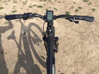

The drive system on this bike offers a lot of modes but really isn’t that complicated to use and the cockpit is clean and intuitive. Once the battery is secured to the frame you press a rubberized power button on the button pad (mounted near the left grip). This activates the backlit Bafang display panel (front and center) and shows your speed, battery level, assist level (preset 1-3 but configurable to 5 or 9 levels), watt output and trip distance. Unfortunately, the display doesn’t swivel easily and is not removable but otherwise it’s sleek and easy to read. When you first turn the system on, assist is actually set to zero and unfortunately you cannot activate the throttle in this mode… that’s one of my gripes because sometimes you don’t want assist to accidentally kick in while navigating difficult terrain. Once you click up to 1, 2 or 3 then pedal assist becomes active and anytime you turn the cranks the motor begins to spin. In any of the assist levels you can also use the trigger throttle for an extra boost as an override but power is somewhat limited by the mode you’re in. This is another area where I feel like the system could be improved, I’d prefer the throttle just go to full power in any assist mode because it’s a variable speed design and I might need the extra power in a pinch. I do like that they chose a trigger throttle here instead of a half-twist design because this keeps the grips more secure feeling. As mentioned earlier, the mid-drive motor helps you pull the chain and therefore benefits from the rear cassette just like you do. If you’re climbing a hill, just switch to a lower gear to help the motor (and you) make it up. With eight gears to choose from the system is very capable and offers a smooth cadence from zero to ~25 mph when pedaling (the motor cuts out around 20).

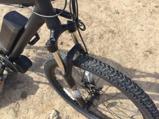

While the BM-Shadow probably wouldn’t be my first choice for true mountain biking given the basic suspension fork and speed-geared sprocket, it’s no slouch on the trail and performed quite well for the video review. I love that the battery mount was designed with extra rivet nuts for strength and that the brake levers offer a motor cutoff switch because the BBSO1 is known for a slight lag in cutoff (the motor keeps going for a moment even after you’ve stopped pedaling). Some of the components here are basic but they get the job done and were chosen carefully to match the look and perform well. These include the rubber semi-ergonomic grips and entry level Zoom mechanical disc brakes. With this electric bike you’re basically getting a solid drive system mated to a traditional mountain bike frame and that means the wires aren’t integrated as nicely as something like an Easy Motion EVO Cross. I love that you get a six month warranty on the batter and motor here (the frame is warrantied for a year). And I love that the frame is available in three standard sizes for those shorter or taller riders. This could be an excellent first electric bike that doesn’t cost so much and is capable of double-duty as a commuter given the mounting points at the rear (for adding a rack).

- High quality battery made with Panasonic Lithium-ion cells, they should last longer and have a higher discharge rate than cheaper packs, I also like the the pack doesn’t require its own on/off switch
- Sturdy reinforced battery bracket, in addition to using the standard braze-ons BMEBIKES also adds rivnuts which create more mounting points on the downtube for strength

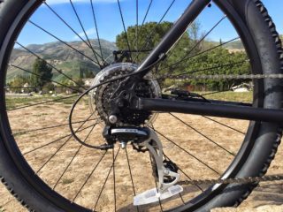

- Decent components ranging from an 8 speed cassette with Shimano Acera derailleur, 160 millimeter mechanical disc brakes and a backlit lCD display panel

- Standard BBS01 chainring is a bit large for off-road riding and the motor may overheat and shut down if you aren’t pedaling while ascending large hills

- The BBS01 mid-drive motor does not offer shift sensing and may mash gears as a result, ease off the pedals or tap the brake to cut power while shifting to reduce wear on the chain and sprockets
