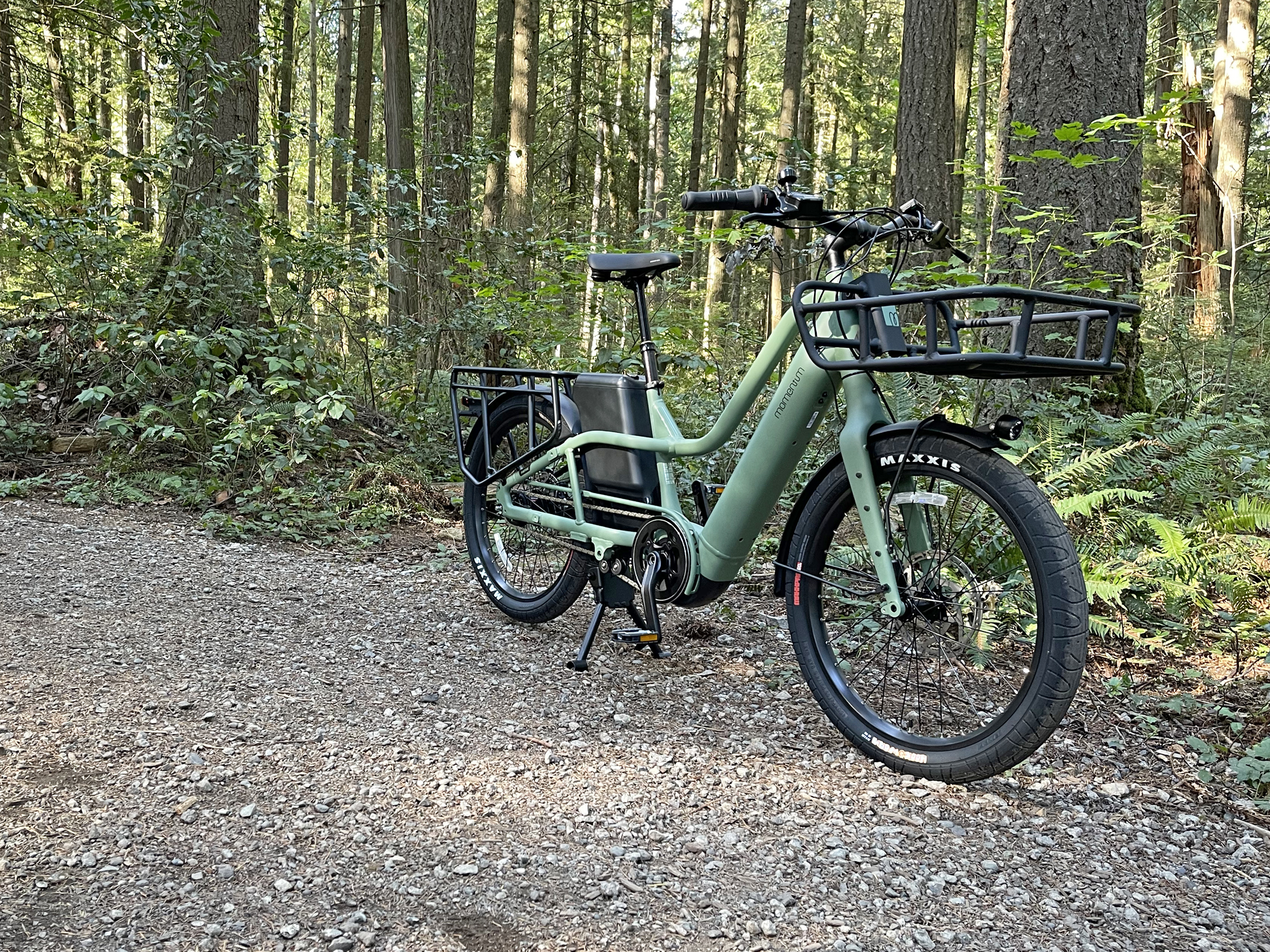

- This Momentum PackYak E+ is extremely well done, one of the nicest electric cargo bikes I’ve ever seen. I feel that the price is justified, and it will hold up very well over time. I love that it comes in two colors, and understand that they focused on one frame size to keep costs lower but optimized with the seat post dropper to accommodate a wider range of body types.
- The bike is sold globally, and customized for each geography! If you get it in the United States, it will be Class 3 for higher speed riding. This makes it a great choice for commuters or those who are interested in long range touring. Although it may have the higher speed rating, the motor is still extremely powerful for hauling and climbing.
- The frame is purpose built with internal cable and wire routing that looks great and reduces the potential for snags. Motor and battery weight is positioned low and center to maximize stability. A special headset was chosen to slow steering a bit and help the front wheel return to center, which also improves stability when the bike is heavily loaded.
- The frame design is stiff and handled well at speed and off-road. I love that Momentum chose thicker than average disc brake rotors to reduce warping and zinging. They also chose boost hub spacing for the front wheel and a thicker 15mm thru-axle vs. traditional 9mm skewer.
- Excellent wheel size and tire choice. Momentum chose a smaller 24″ wheel that brings the frame closer to the ground, making it easier to mount and load with gear, but they didn’t go all the way to 20″ which has a high attack angle that can feel more jarring. The tires are brand name Maxxis Hook Worm with sturdier build and wide 2.5″ that increases air volume, acting like a shock absorber.

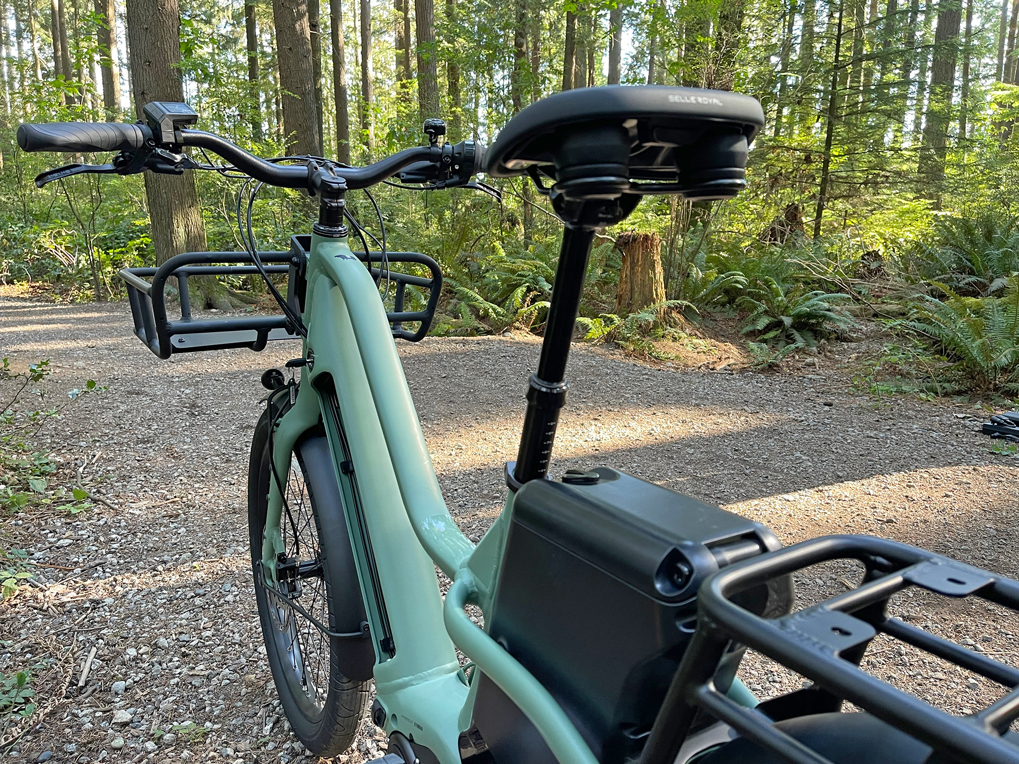

- Speaking of comfort and shock absorption, the seat post on this ebike provides 70mm of heigh adjustment as well as 40mm of suspension travel! It allows different sized riders to use the bike easily and improves overall comfort when riding on rough terrain.

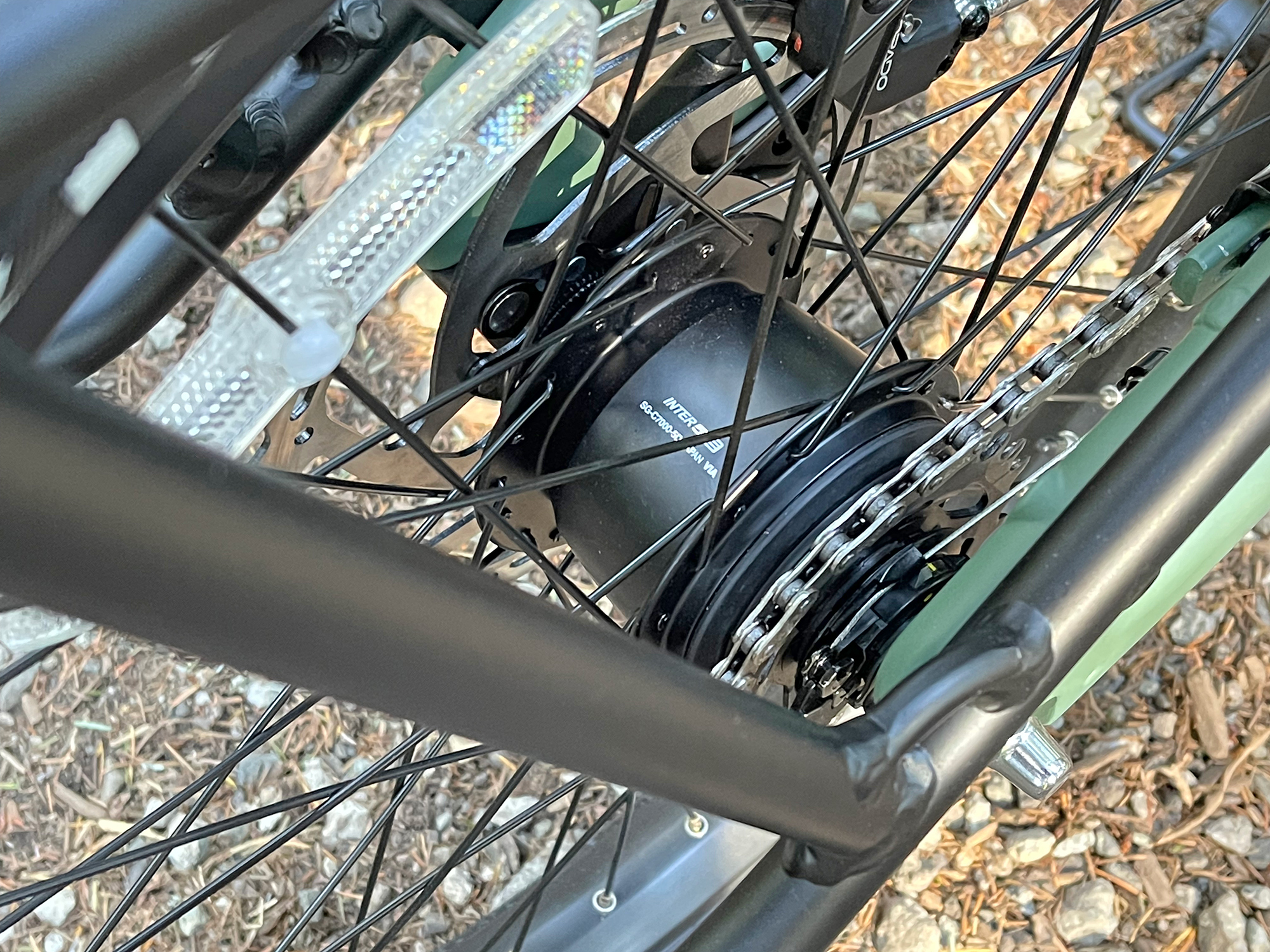

- Awesome drivetrain setup here with the narrow-wide tooth steel chainring, alloy chainring guard, and paint-matched alloy chain cover! The extra-long chain does not bounce around because of the single rear sprocket and double pulley guide system. The Shimano Nexus 5E is ebike specific to be sturdy and shift under load… and it really works. While 5 gears isn’t a whole lot, this thing is tough and allows for shifting at standstill. Sometimes low cargo bikes can have the derailleur get bumped on curbs and other obstacles, so the IGH is just cleaner.

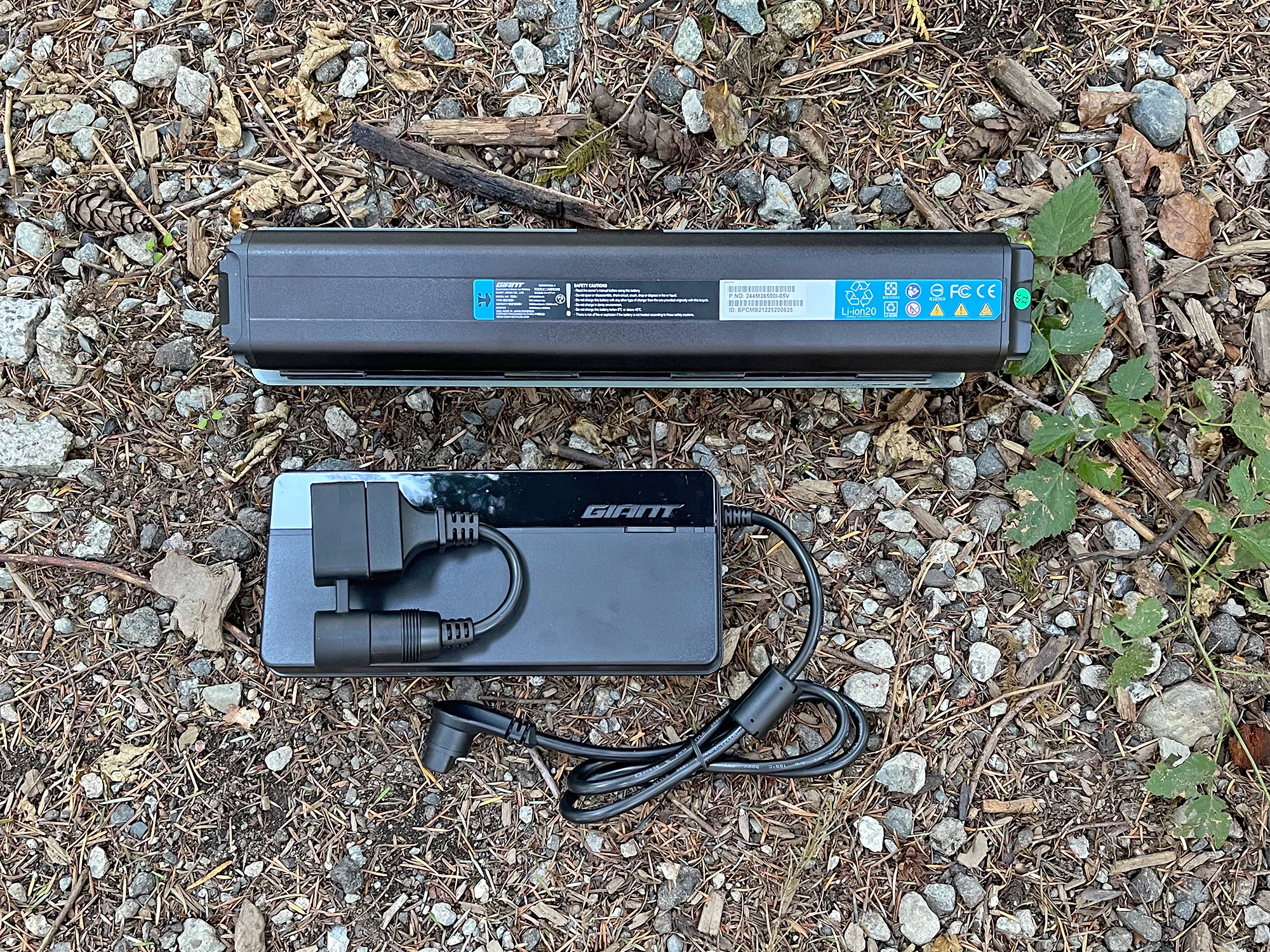

- While I do have some complaints about the size and weight of the charger, it is nice to see a fast device like this which can reduce your times between rides or fill the double battery option more quickly. It offers 6 amps vs. the more common 2 amp or 3 amps devices I usually see.

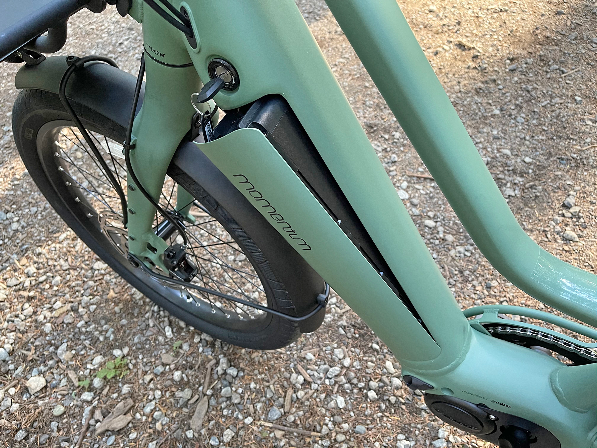

- I appreciate that the battery cover is securely attached to the pack vs. being one that anyone can tamper with at the bike rack. The color matched cover is nice, and the side-mount design of the battery is easier to work with than a bottom mount design in my opinion. It’s setup so there’s a half-step when unlocked, so the pack won’t just tumble out!

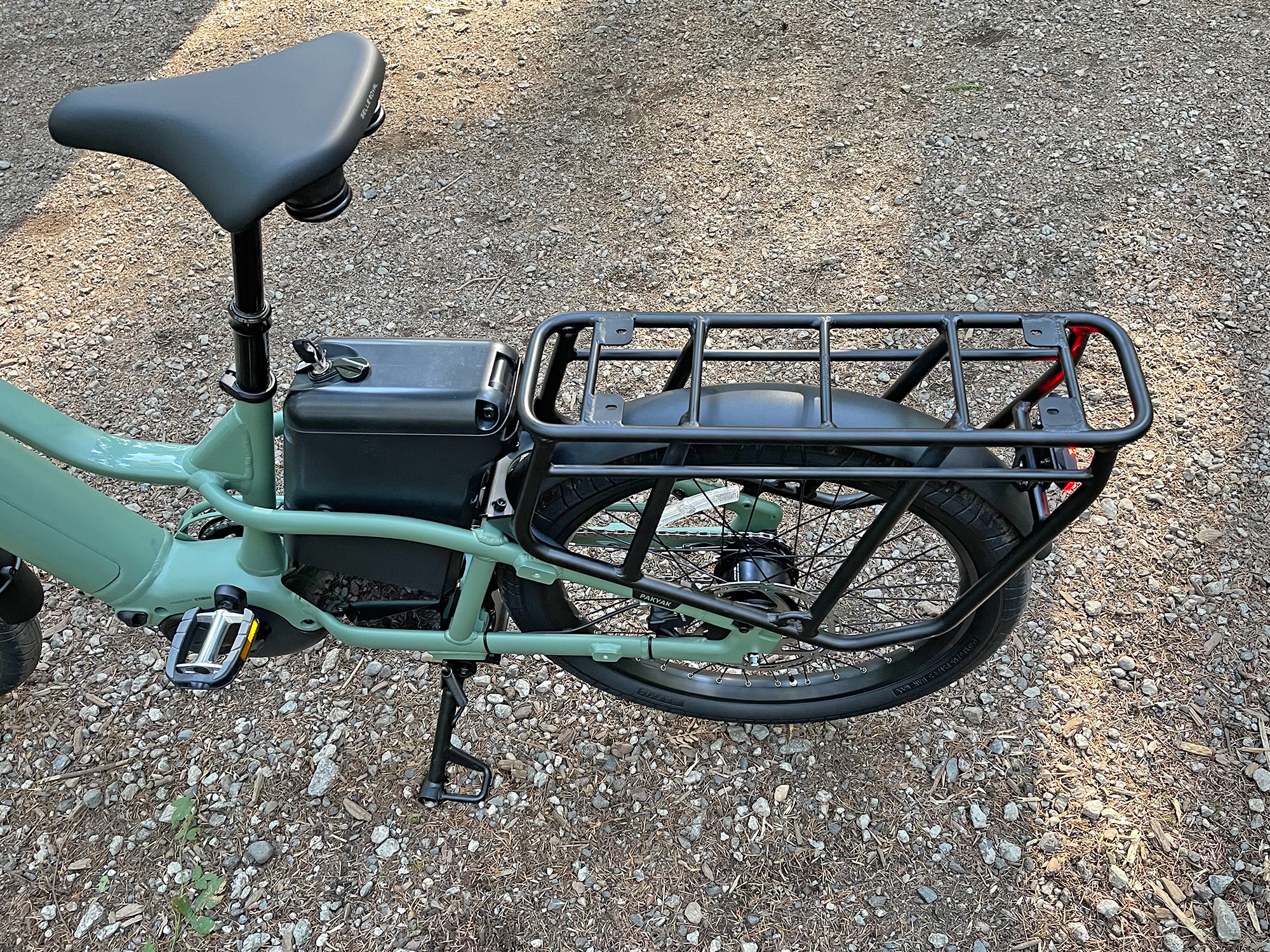

- The bike comes with a black storage box with a key-matched lock! It’s perfect for storing gloves, jackets, and other loose items, and this is also where you can put the optional second battery. I think there is still some space in there, even with the battery! Cool concept, great execution.

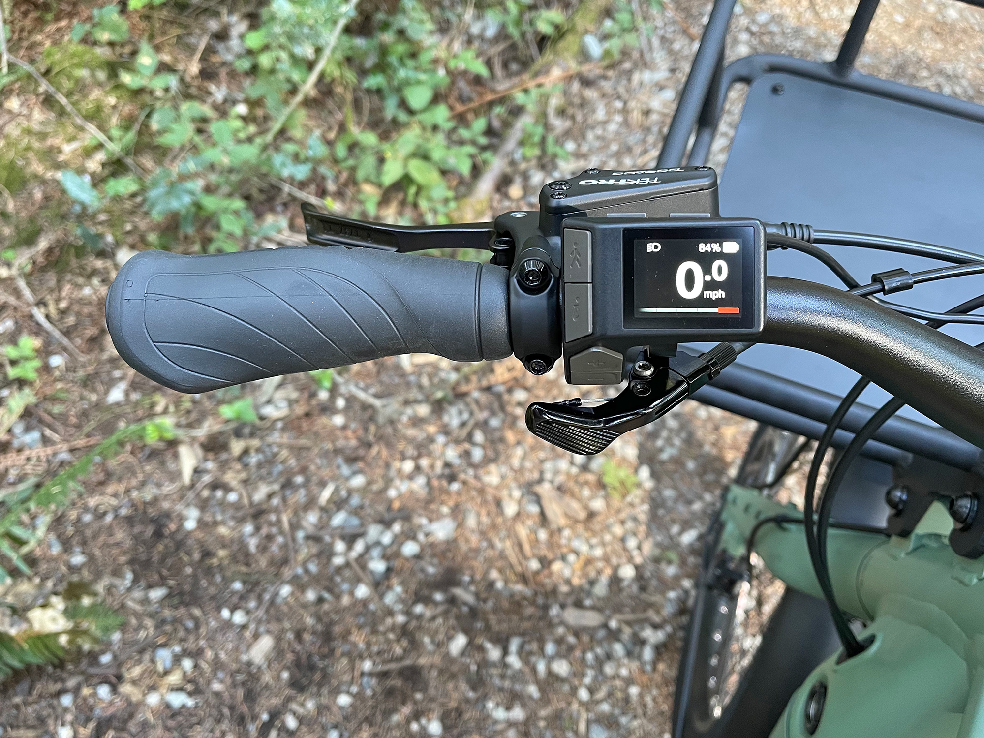

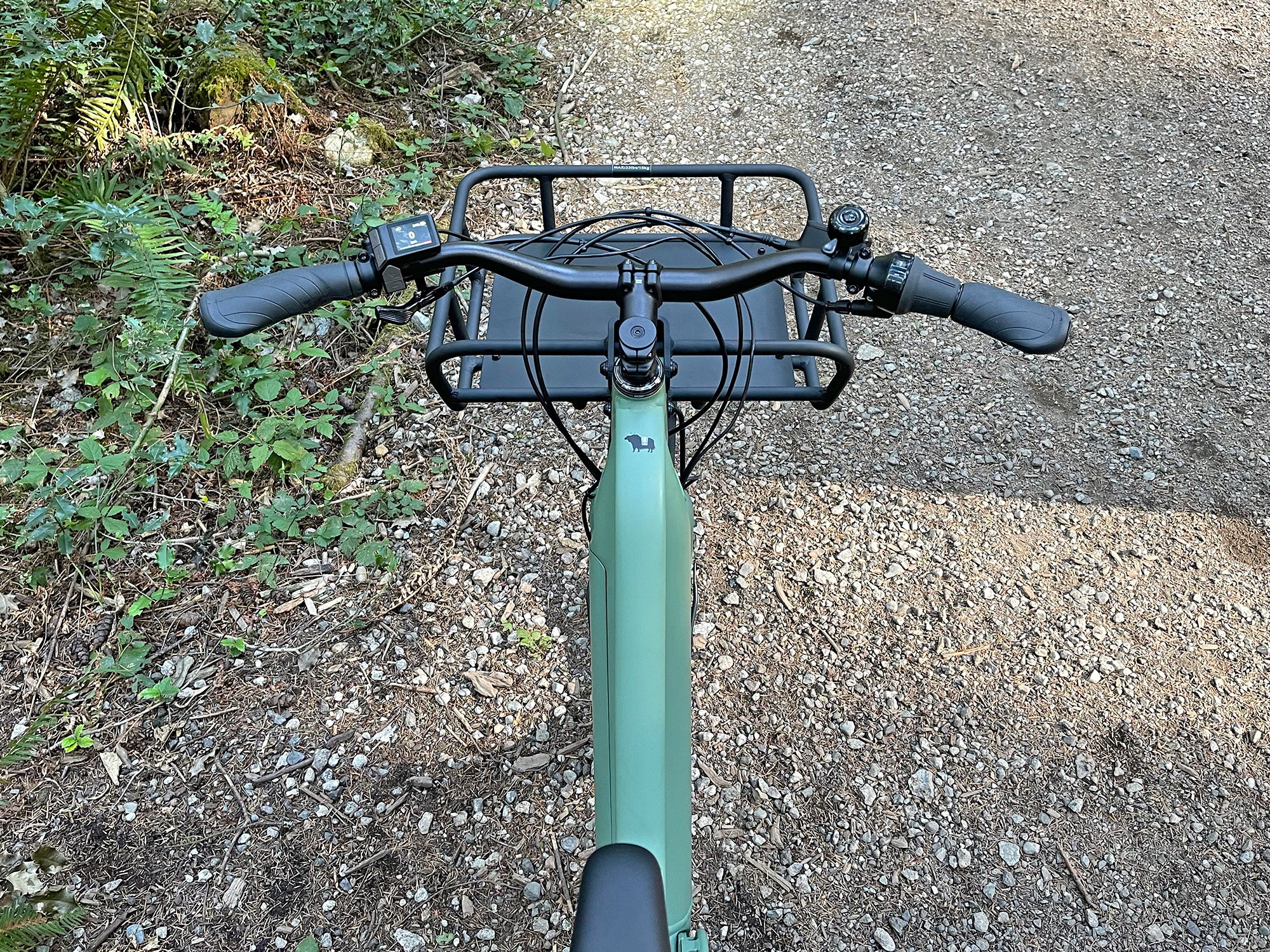

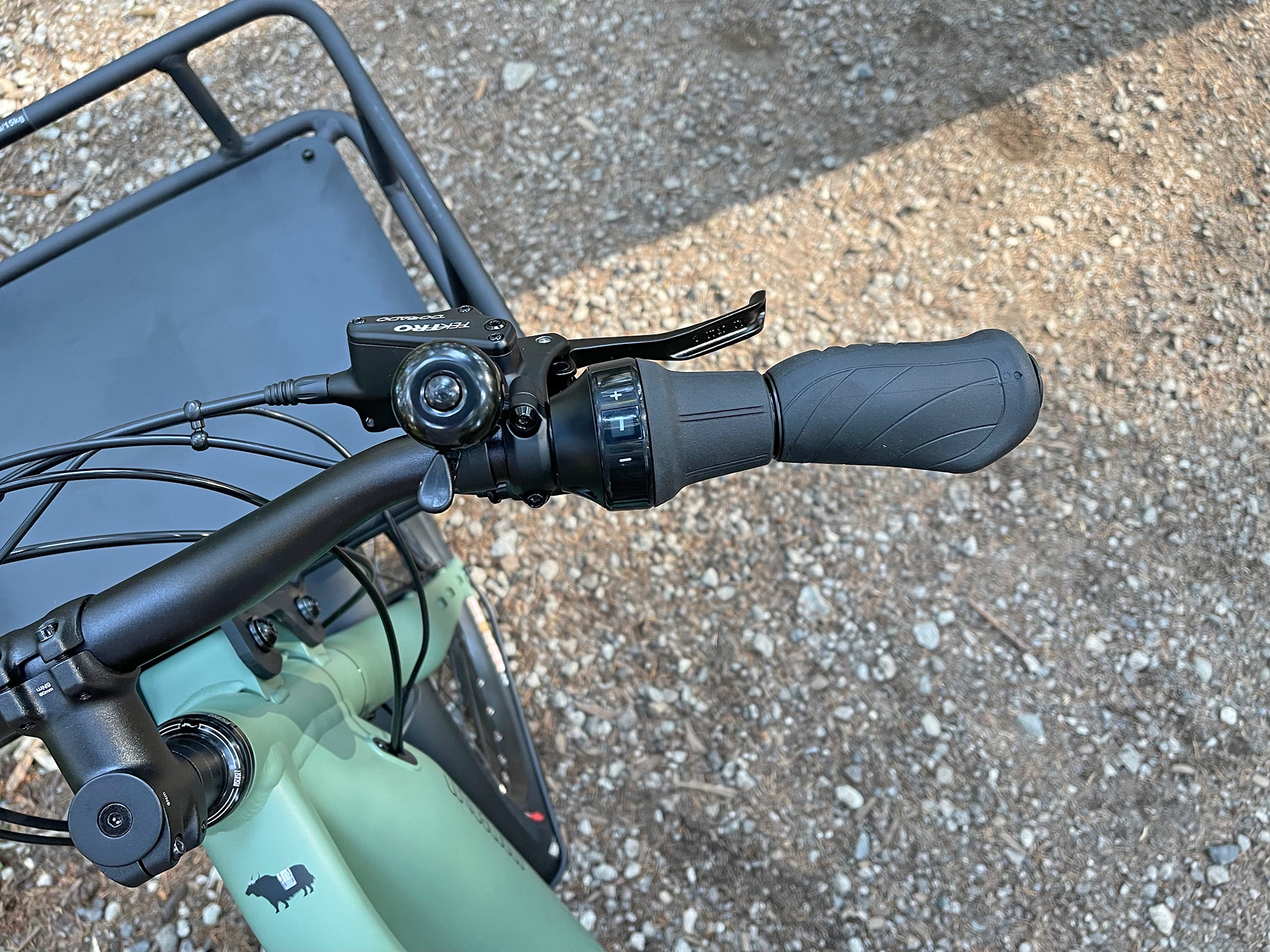

- I really like the display panel and button pad. It has dedicated buttons for walk mode, lights, info, as well as the standard + and – for assist levels so you don’t have to memorize combination presses. The control pad has a 1amp USB C charging port built in to maintain portable electronics. The LCD readout uses colors to communicate concepts vs. making you squint to read details, and there are three brightness levels so you don’t lose your night vision! I love that there’s a percentage based charge level indicator here vs. a 5 or 10 dot readout, and a range estimator!

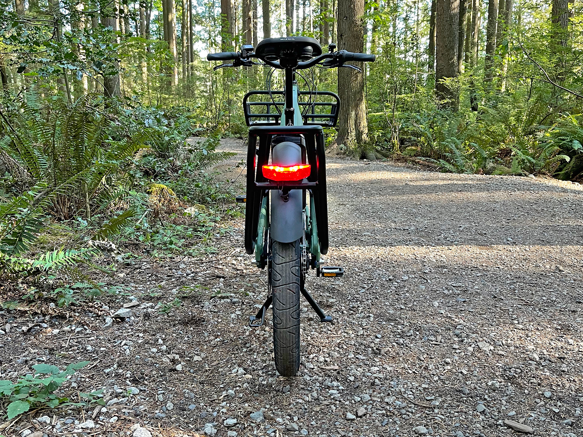

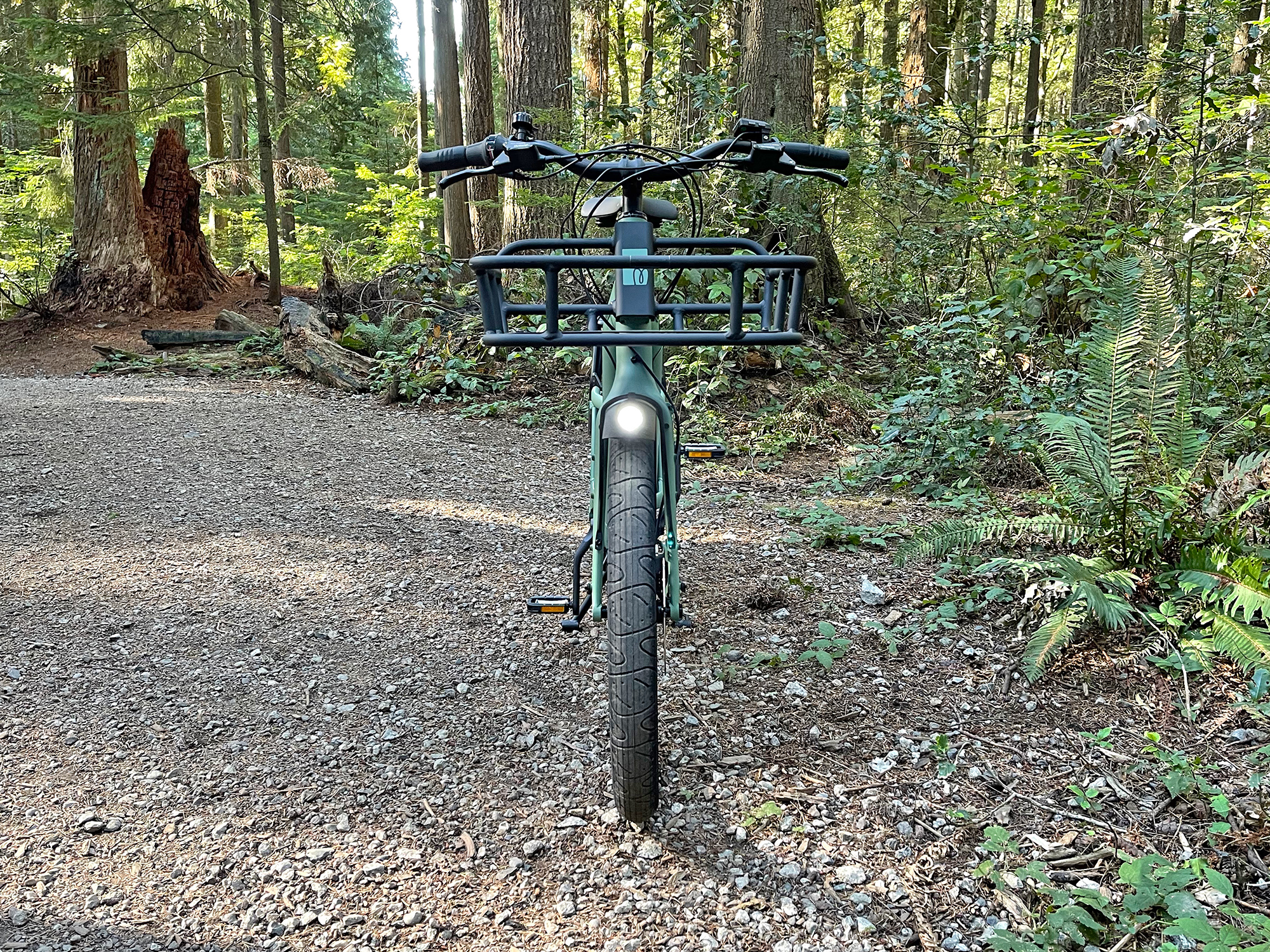

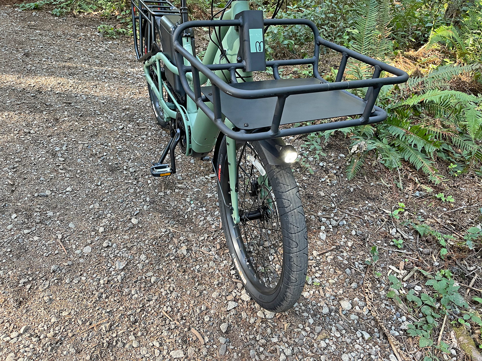

- Great headlights here, the rear light has two LEDs and is protected by the rack. The headlight is extra bright with 550 lumen output, and is positioned on the fender vs. the rack, so it points where you steer.
- Great fender design, they are sturdy enough and well supported enough to not vibrate and make noise when riding off-road. The front fender supports the light, and I didn’t see it bouncing very much.
- I appreciate that Momentum added two bottle cage mounting points on the included front basket! This keeps the frame stronger, the stand-over position clear, and still keeps the bottles within reach.

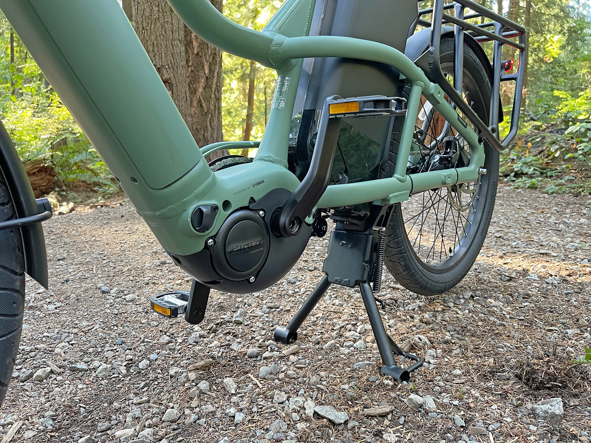

- The custom kickstand is very well done. It uses steel legs that are super strong, and has rounded bottom portions that roll easily into standing or out to riding. There’s an extension on the left side of the kickstand that can be stepped on to increase leverage, making it easier to lift the bike up into the standing position.
- Nice touch points: the saddle looks good and felt comfortable to me, especially with the suspension post. The grips are fairly basic, but still feel comfortable and are ergonomically shaped.

- The included rear rack can support two child seats, a custom made pair of pannier bags, and also has a support rod for third party panniers! There’s an optional deck saddle, a child surround, and running board pieces. It’s fairly comprehensive and all of the accessories that I saw were done very well. Higher than average 102lb weight limit on the back rack and up to 33lbs on the front rack.
- Momentum says that the bike can support up to 361lbs total, riders between 5’2″ and 6’3″ because of the seat post adjustability and lower mid-step frame.

- The motor controller measures pedal cadence, torque, and rear wheel speed. The motor performance felt dynamic and responsive, I was even able to go up a curb and climb off road at very low speed! The bike climbed very capably, and shifting gears was smooth.
- I trust Yamaha motors because shops have told me that they are reliable, and the PW-X (which the SyncDrive Pro is based on) is very proven. Giant tweaked this motor a bit to create their SyncDrive Pro. It has a narrow 168mm Q-Factor, is fairly lightweight, and similar to other high out put motors in terms of noise. You get up to 80nm of torque and 360% power output relative to your pedal input.

- This is a minor gripe, but the grips are pretty basic and do not lock. They feel good and are setup to work with the half-grip shifter, but they aren’t very premium given the price of the bike.
- The 5-speed drivetrain seemed to be geared high, I was using the first gear more frequently than expected and struggled to climb steeper grades from standstill. I think it’s setup to support the 28mph Class 3 speed pedelec use case, but compromised on the low end a bit. Internally geared hubs also weigh more than cassette and derailleur setups.

- The battery packs charge and discharge sequentially, starting with the main downtube battery. That means you will probably end up cycling that one more completely, more often, which leads to faster degradation. Ideally, batteries are kept between 20% to 80% and I’m not sure when the ebike controller decides to switch to the second pack. If it drains the first one completely, that could cause premature wear vs. a balanced charge/discharge design.
- The charging port for the batteries is positioned low on the left side, which requires bending down. This port is in the direct path of the left crank arm, which could snag the charger cable. I hit my head on the handlebar when bending down to plug the bike in because it’s so wide, please be careful!
- The battery charger is very large and heavy, possibly the largest and heaviest I have seen for the past few years. It does put out more energy, charging faster, but it’s just less portable than some competing designs.
- The charging port on the bike frame is different from the battery interface, so you need a dongle adapter to charge the pack when off the bike. This dongle is an extra step and can be lost vs. just having one plug… and it adds more weight. I am thankful that Momentum has a plastic leash clip thing that allows you to connect the dongle to the main charger :)
- Since the main battery pack has a plastic shield semi-permanently fixed that matches the frame, it’s not as convenient to switch batteries if you want to change the charge order and cycle the second pack more frequently. It may also fade differently than the metal frame, and could be difficult to replace down the line if scratched as colors may change or the bike design may change. I’m a fan of the matched color, but appreciate the utility of a universal battery cover.
- If you choose to purchase a secondary battery, it appears that the seat will have to be raised to its maximum position (or twisted to the side) in order to insert the battery into the storage box. I discuss this in the video review above at 12:14
- This is a very minor consideration for me, but the LCD screen is fairly small. This makes it less prone to scratches, and leaves plenty of room for a phone or other handlebar mount accessory if you wish.

Court says
Hi Zach! If you look at the 13th photo in this the gallery of my review (if the first white background photo one is counted as zero) you can see a view from behind the seat post looking at the left angle of the rack. I realize it’s a bit dark, but if you enlarge the photo to full size by clicking the “expand” icon in the lower left, then zoom in a bit, you can see two threaded eyelets for mounting a bottle cage! I believe that both corners of the rack have a bottle cage mount like this that would orient your drink in an upright position and the bottle would sit just below the handlebar so as not to impede steering. I do not remember as much about the battery pack mounting, seeing any gaps, or having any other issues. This seemed like a unique cargo ebike due to the dropper post and high speed operation… but if you’re willing to go with standard Class 1 speed, then there are lots more options including Tern and Yuba at the high end. Here’s the full category of my cargo ebike reviews, but also consider Rad Power Bikes and Magnum if you’re alright with a hub motor. It’s great that you can visit your local dealer and are paying such close attention to the details. I appreciate your comments and insights!
Zach says
Hi Court! As before, thanks again for taking the time to answer my questions and for the info you provided.
I went back to the local bike shop here and test rode the Pakyak again after the shop changed out the handlebar stem. They replaced it with a taller one as the stock stem is too short for me. I am 6’4″ with long arms! They had also maxed out the seat post but with this it was still not comfortable. A mechanic there then suggested that they also swap out the handlebars for one with more of a rise and a tad wider. This ended up working very well for me. The only thing is that the post was extended to the max height and as such then had a bit of play and then with the slight suspension it ended up being too short but just by a small amount. The mechanic then suggested removing the dropper post and going with a rigid post that is longer given that I will be the only one riding the bike. He also pointed out that taking a bike of that design down a very step decline, where one would want to be able to lower the post quickly, is not likely as it would be a heck of a ride!!
I heard back from Giant and they said that the gap with the battery cover is normal and won’t affect anything. I disagree and it’s just enough of a gap that dirt and mud will likely build up inside the frame and around the battery. I am going to investigate further, to see whether or not the battery mount inside of the frame can be moved back into the frame a bit more. I had a look at your video review and the battery cover appears to be flush with the frame without any gaps.
