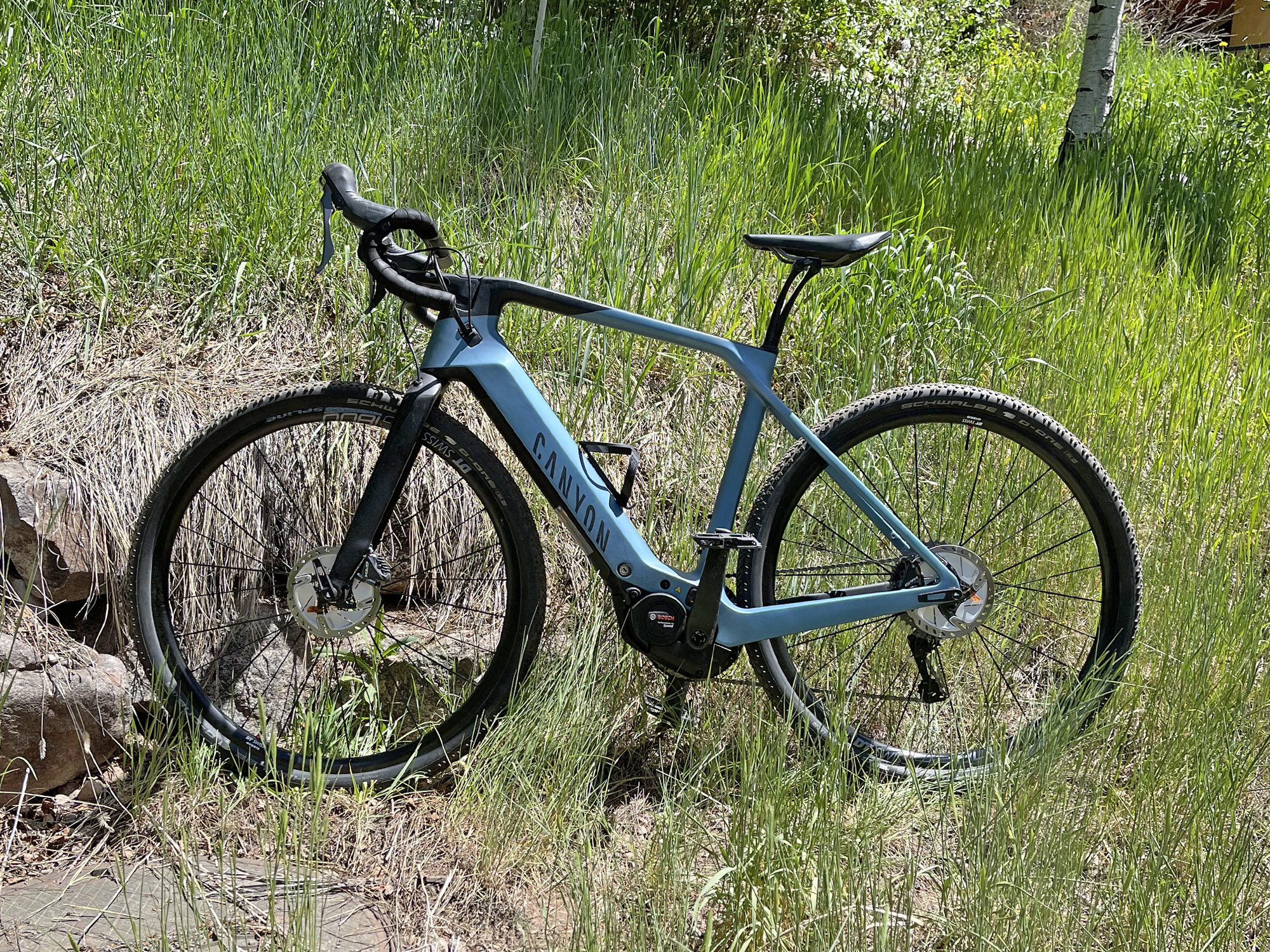

- This was my first time reviewing a CANYON product, and I was very impressed with the range of sizes and quality of components. CANYON is a German company that has been around for many years and sells direct. The Grail:ON is an electric version of the Grail gravel bike, which stands out for its unique double decker carbon fiber drop bars.
- The Grail:ON comes in two flavors, and the CF 8 is the more affordable $5,799 USD model. If you pay extra for the eTap model, priced at $6,999, you get a SRAM drivetrain with electronic shifting and DT Swiss HGR 1400 carbon fiber rims that are lighter and more aerodynamic. The eTap model comes in a champagne metallic tan color with black accents vs. metallic blue with black accents here. Both models ship with the Bosch Performance Line CX motors in Europe, but are upgraded to Bosch Performance Line Speed motors for faster Class 3 performance in the USA.

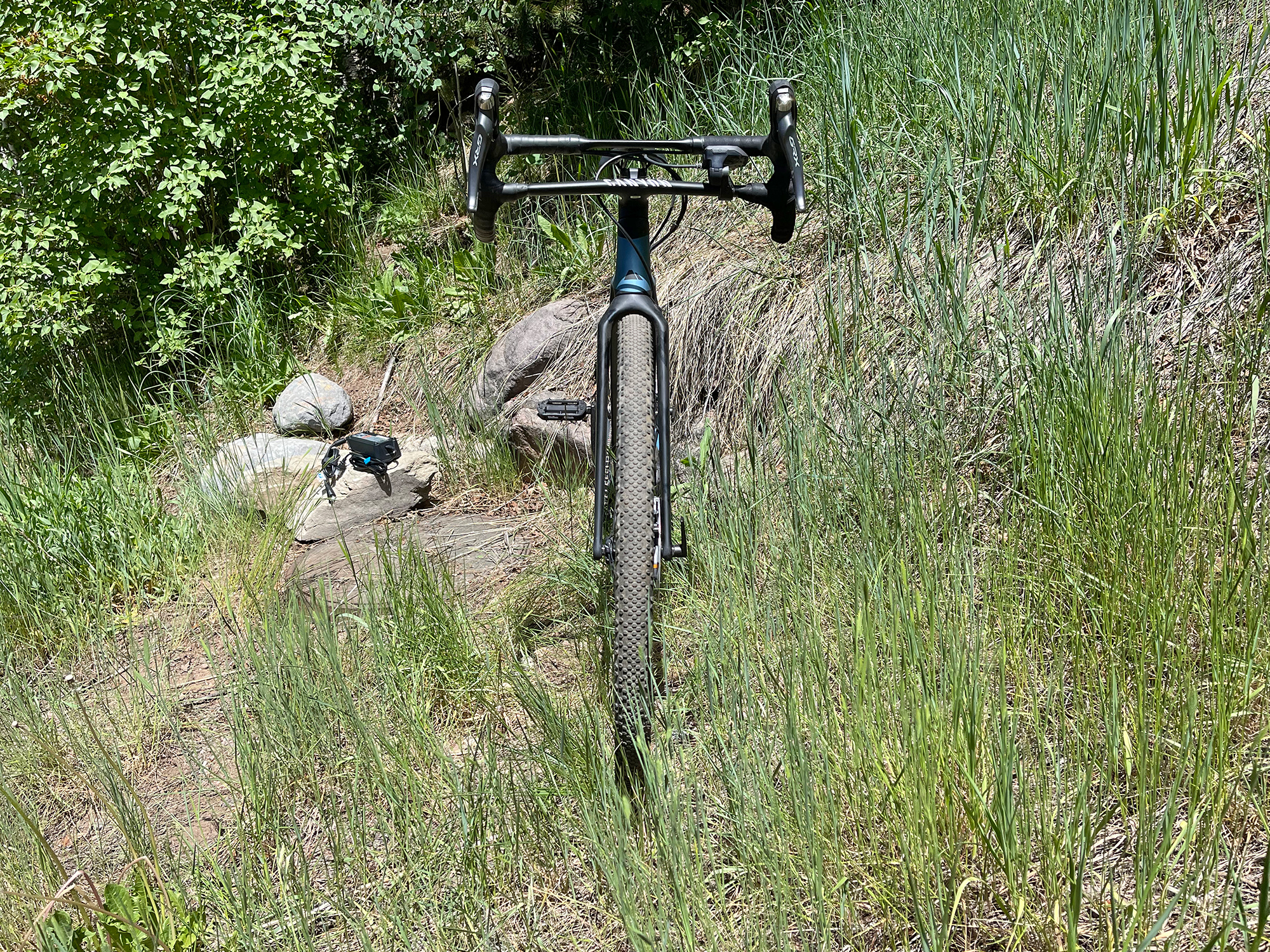

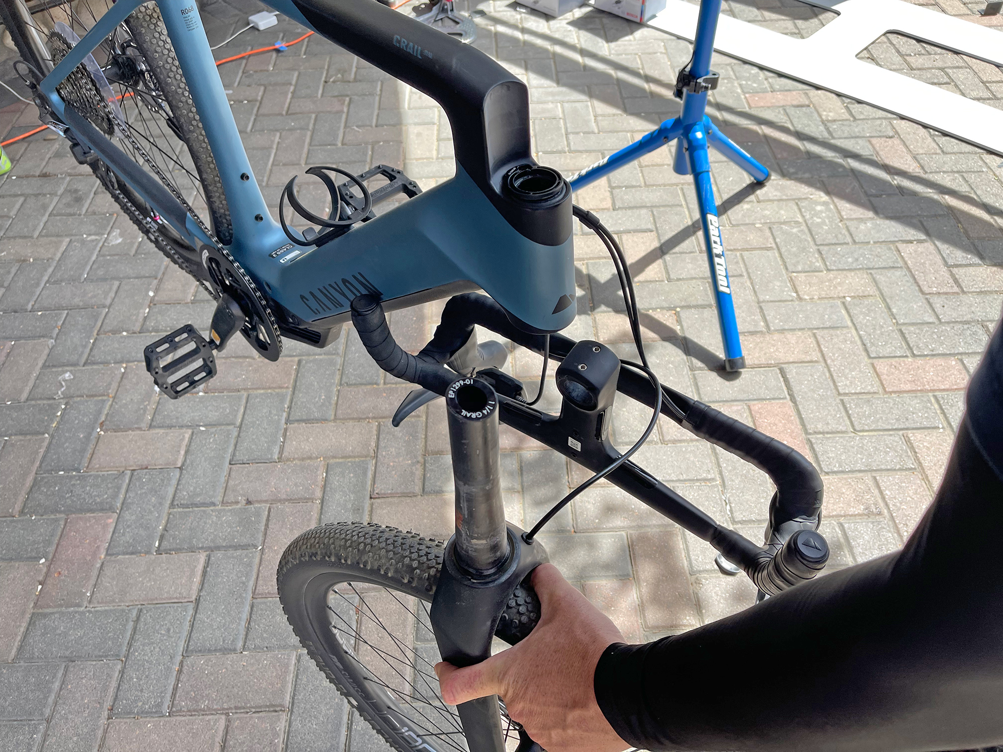

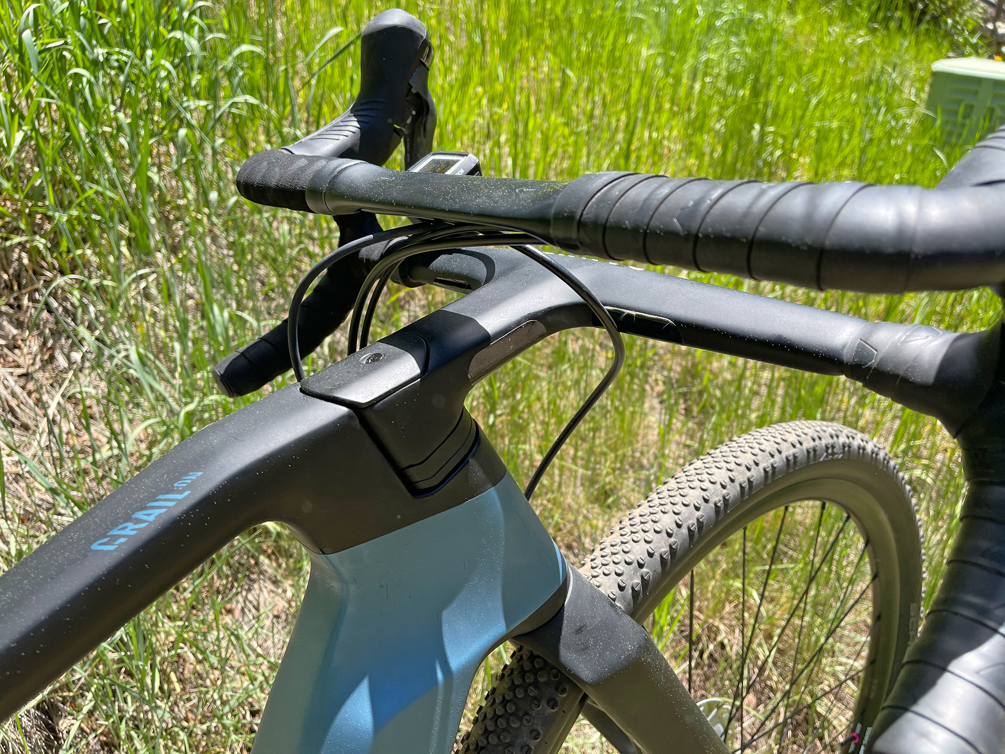

- Beautiful frame, fork, stem, and handlebar design. The custom stem and double decker handlebar integration almost look like a triathlon bike with aerodynamic qualities… and the bike is extremely lightweight at 37.3lbs (16.9kg) for the Medium that I tested (with aftermarket platform pedals).

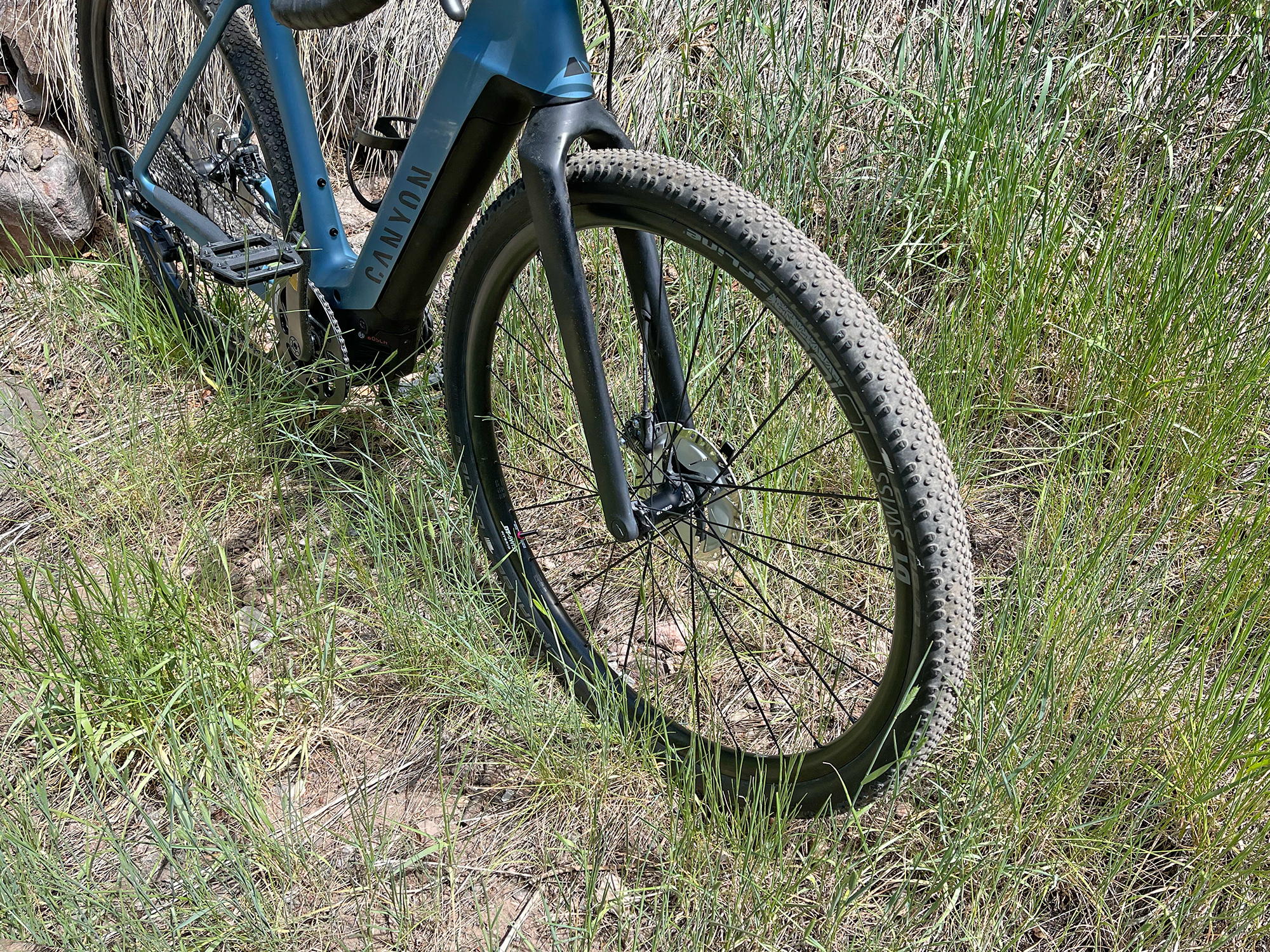

- Sturdy 12mm thru-axles front and rear add strength for off-road use, it’s exactly what I’d expect for a quality gravel grinder and I love that they use quick release maxles. The tapered steer tube gives more options for upgrading the fork to something like Lauf.
- When I first saw the seven frame sizes, I was floored! They even offer different wheel sizes to suit the frames (700c vs. 650b on the 2XS through Small) and different crank arm lengths (175mm vs. 170 on the 2XS through Small). However, three sizes were out of stock… I specifically asked the CANYON rep about this and he confirmed that they do actually produce seven sizes, but that many are only available in limited quantity and can sell out quickly.

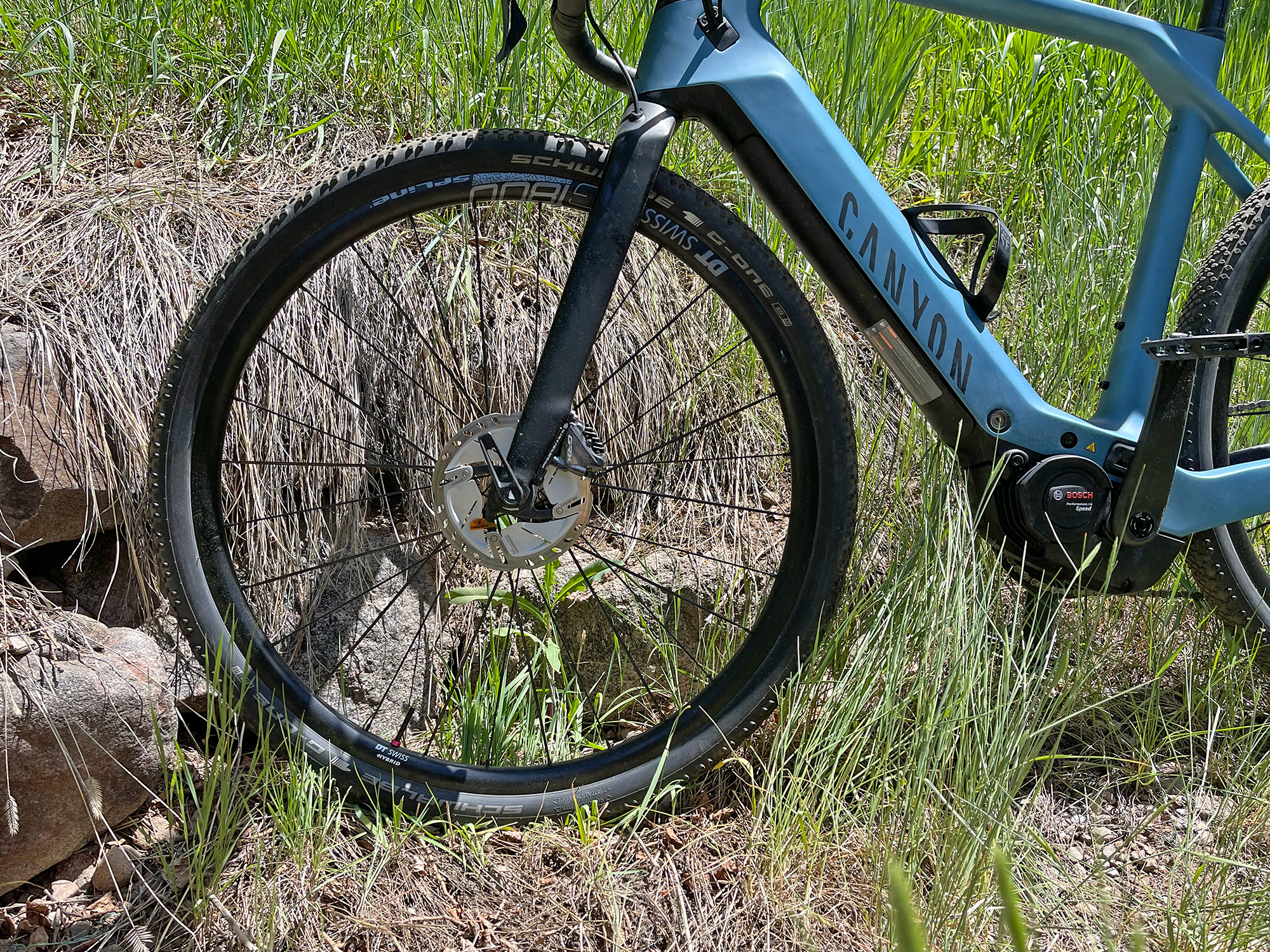

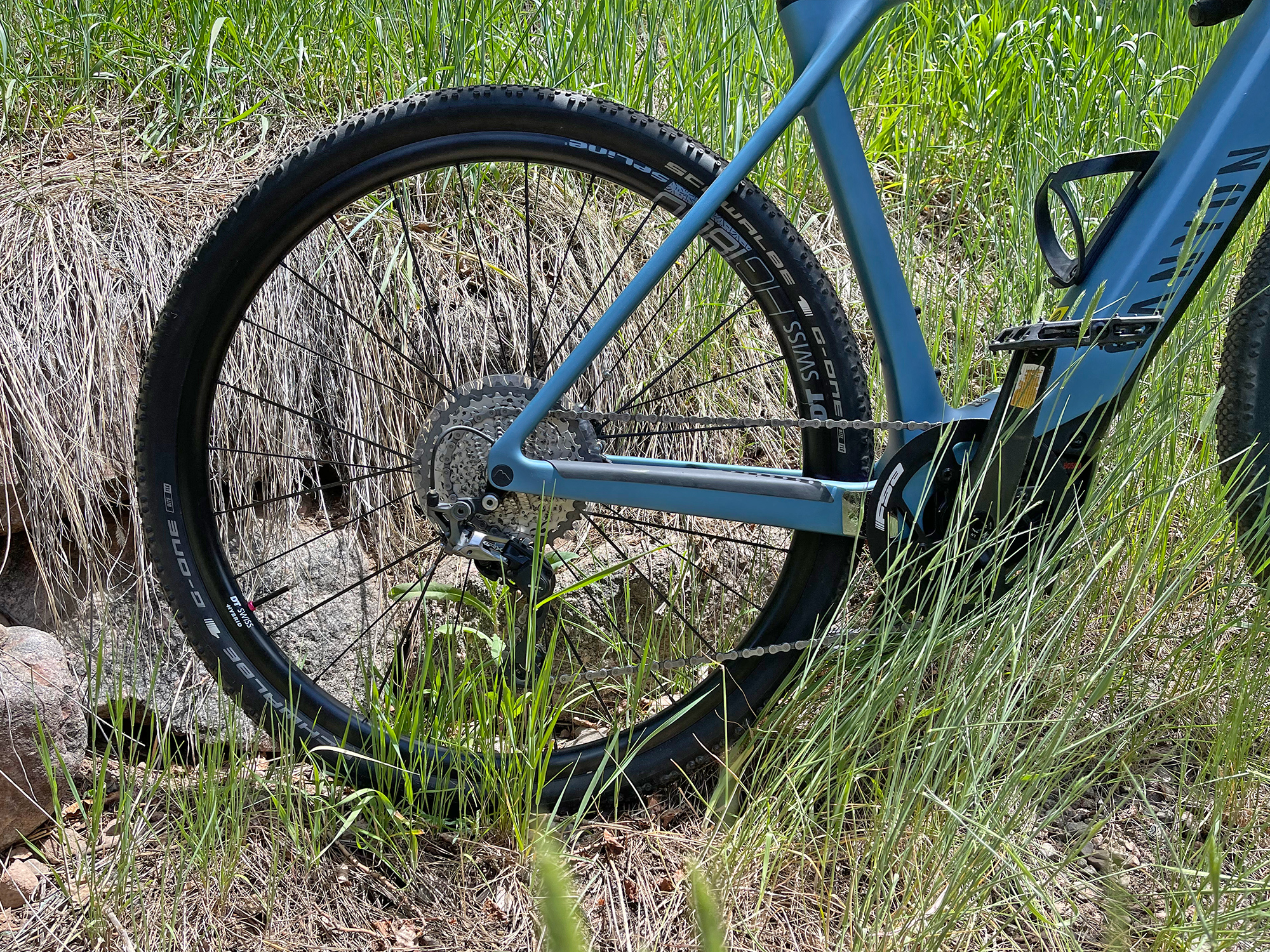

- Even though the brake rotors are just 160mm here vs. 180mm on some competing electric road bikes and gravel grinders, CANYON chose Shimano ICE-Tech with aluminum carriers, carbon steel rotors, and calipers with heat dissipating fins. The design of the rotors circulates air and is designed to stay very cool. So, you get high performance without as much weight. The smaller size is less likely to get bent or dirty since it doesn’t stick out so far.
- The entire Bosch drive system (battery, charger, motor etc.) are UL certified and Bosch is the only company to have achieved this level for their ebike systems from what I understand. That means reliability and quality, which is especially nice on a high priced, high speed, performance ebike like the Grail:ON.
- My understanding is that the tires chosen for this model are off-road specific, and may guard against punctures a bit. They are also TLE (tubeless easy), so you can reduce some weight and ride at lower pressure if you decide to remove the tubes and add some sealant.
- Nice bladed spokes and upgraded aluminum alloy rims reduce drag and weight, but the premium carbon fiber rims on the eTap are definitely a step up. I do wish that CANYON had been able to integrate the rear wheel speed sensor into the disc brake setup the way that BULLS and some other manufacturers have done, to keep the wheels balanced and reduce sensor read errors resulting from loose magnets and debris.

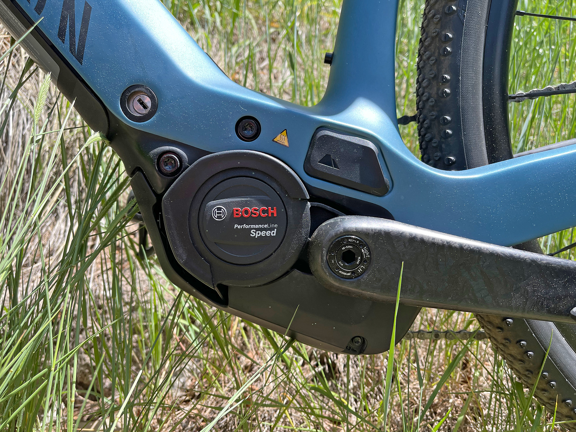

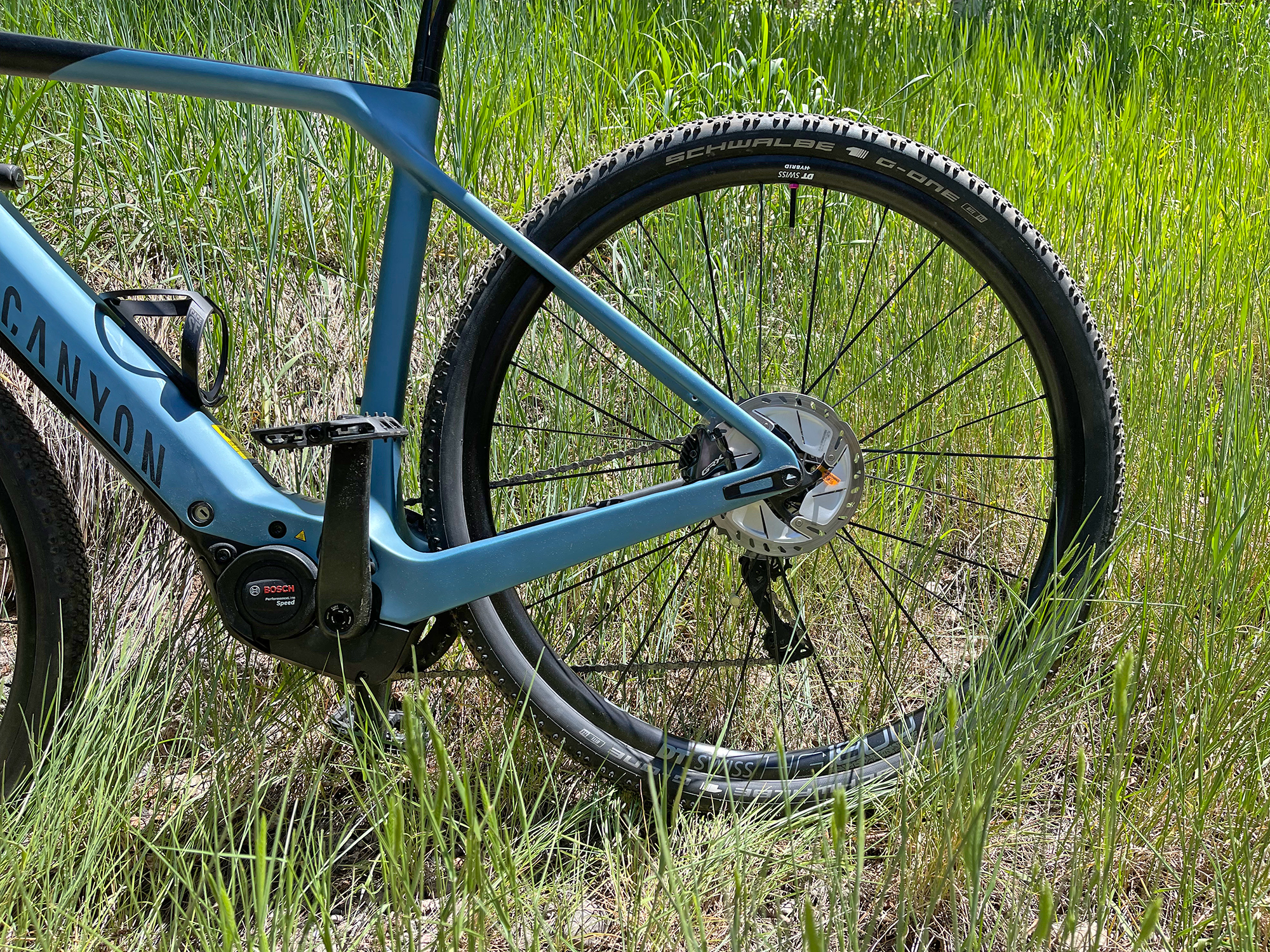

- The Gen 4 Bosch Performance Line Speed motors are smaller, lighter (6.3lbs vs. 8.8lbs), use standard sized chainrings vs. a reduction gear (so no drag here), deliver more power (85nm vs. 63nm of torque), and support over 120 RPM (pedal strokes per minute) compared to the Gen 3 motors, so they perform great all around and won’t struggle as you downshift in preparation for a climb. This is one of my favorite motors of all time.
- I really appreciate the narrow-wide chainring that was chosen for this bike, because it really grips the chain and reduces the potential for drops when riding off-road. CANYON added an aluminum alloy chainring guard as well, so your pants won’t get dirty or snagged, and it acts as a bash guard to protect the chainring and chain.

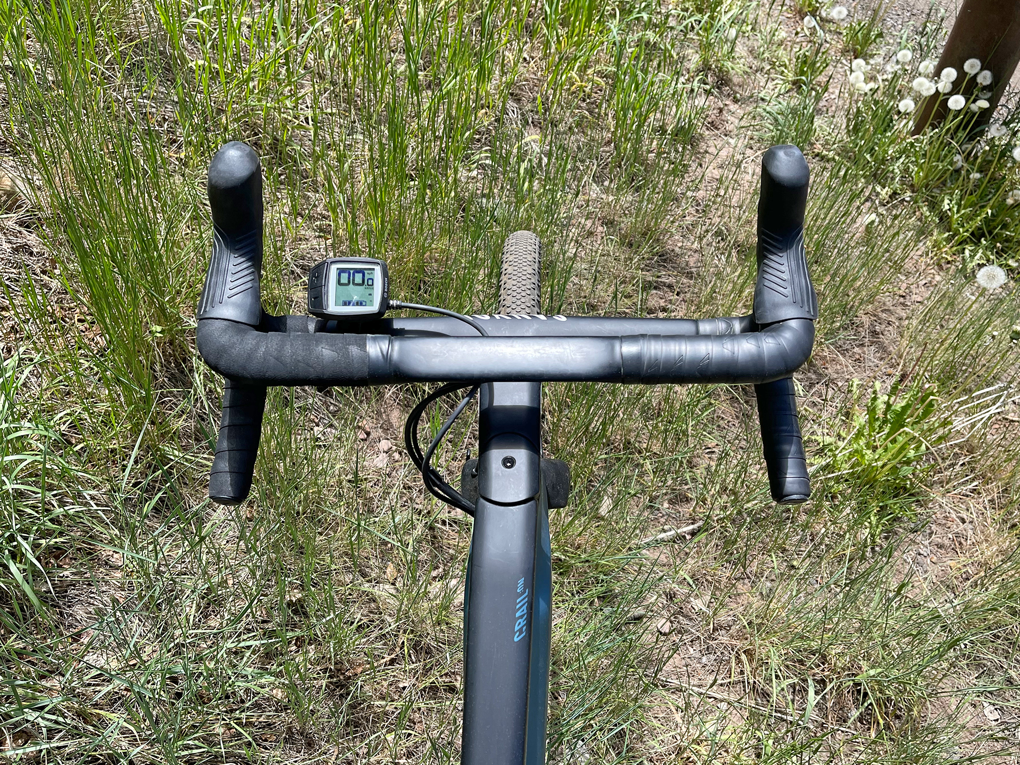

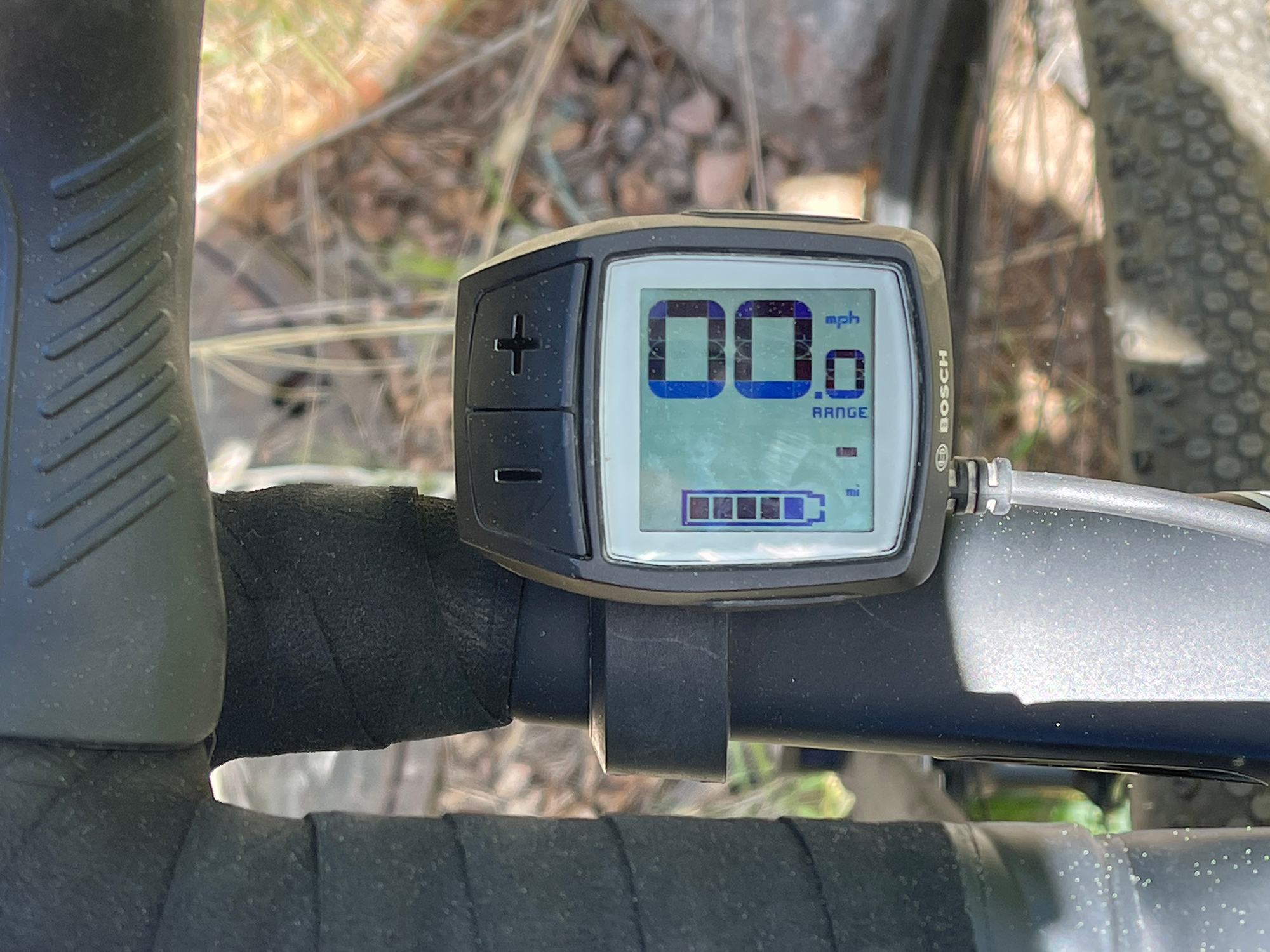

- The Bosch Purion display and integrated button pad lack some features and menus, but is very easy to read and understand. I found that it performed well during my test rides, and is a step above some competing displays from other companies.

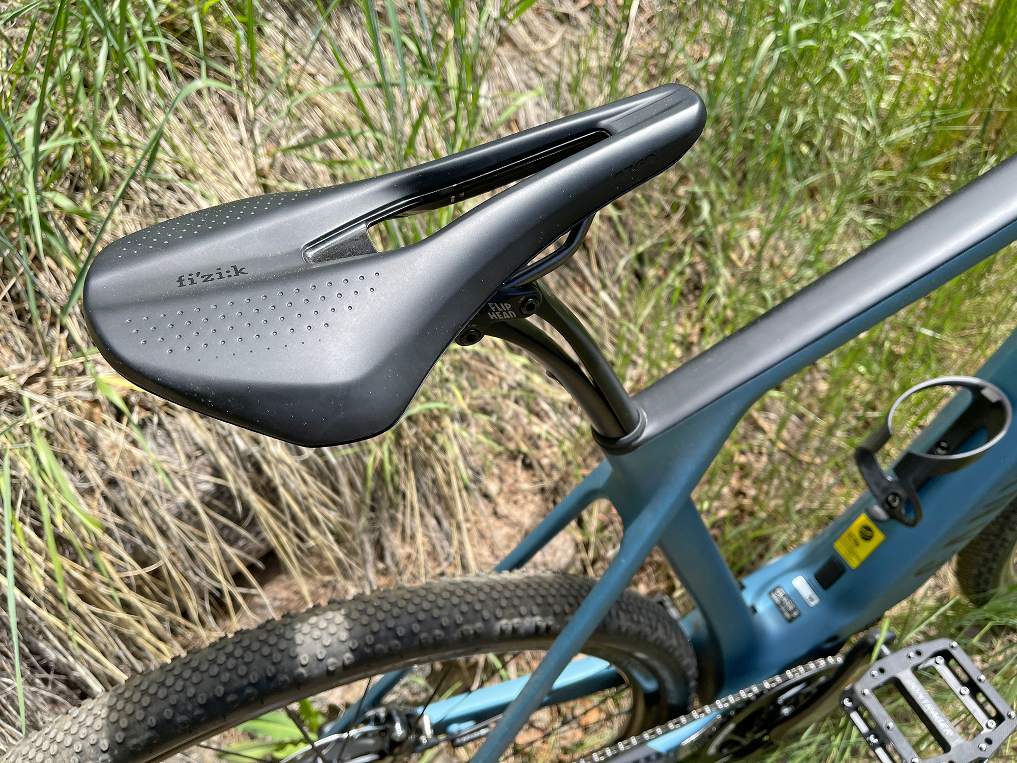

- Great attention to detail all around, comfortable grip tape, saddle, and they included a long rubberized slap guard on the right chain stay vs. letting the paint get chipped up. My favorite parts have to do with comfort, and that includes the carbon fiber double decker handlebar that introduces some flex and vibration dampening, along with the splayed carbon fiber seatpost that almost acts like a suspension post.

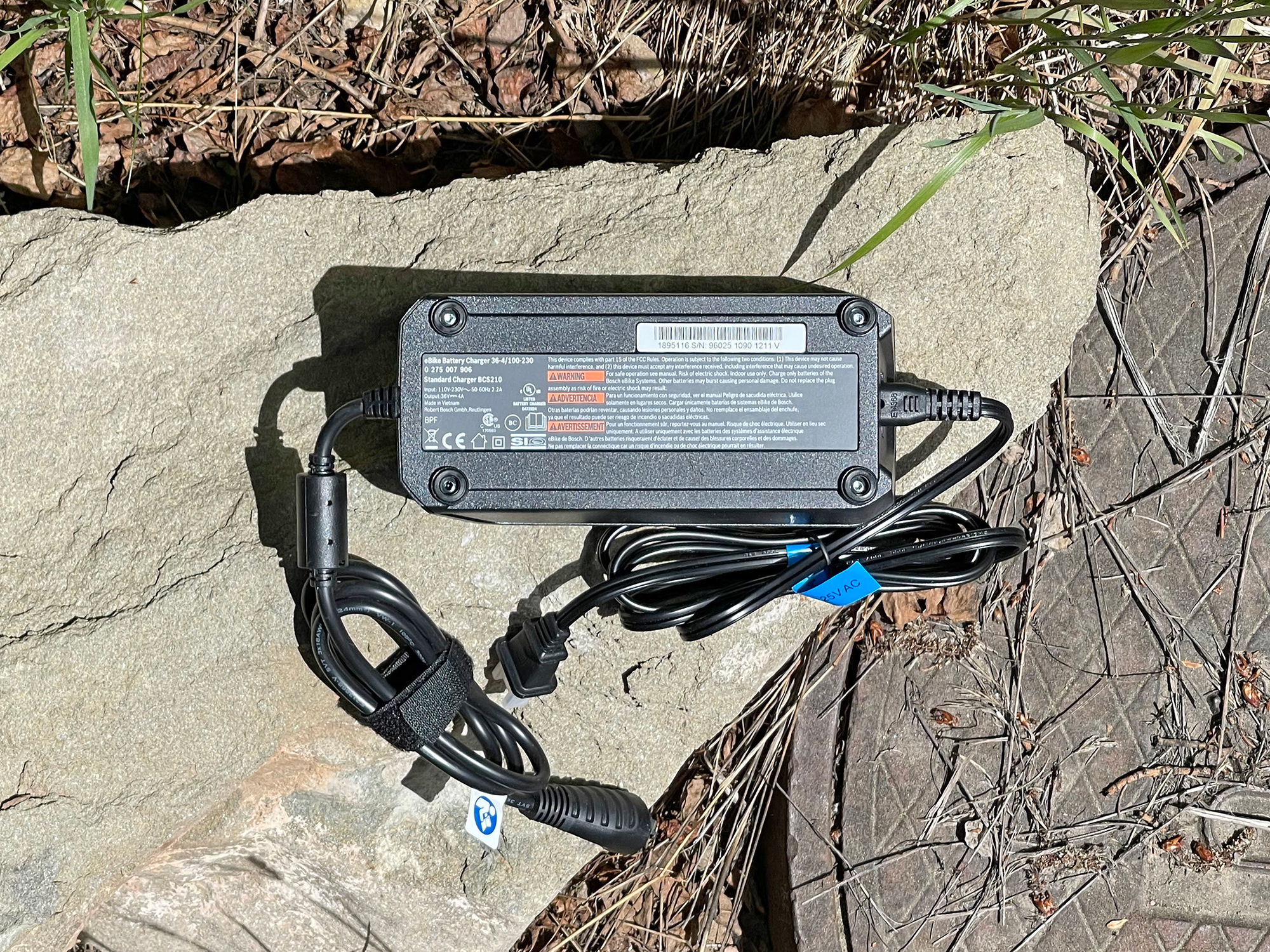

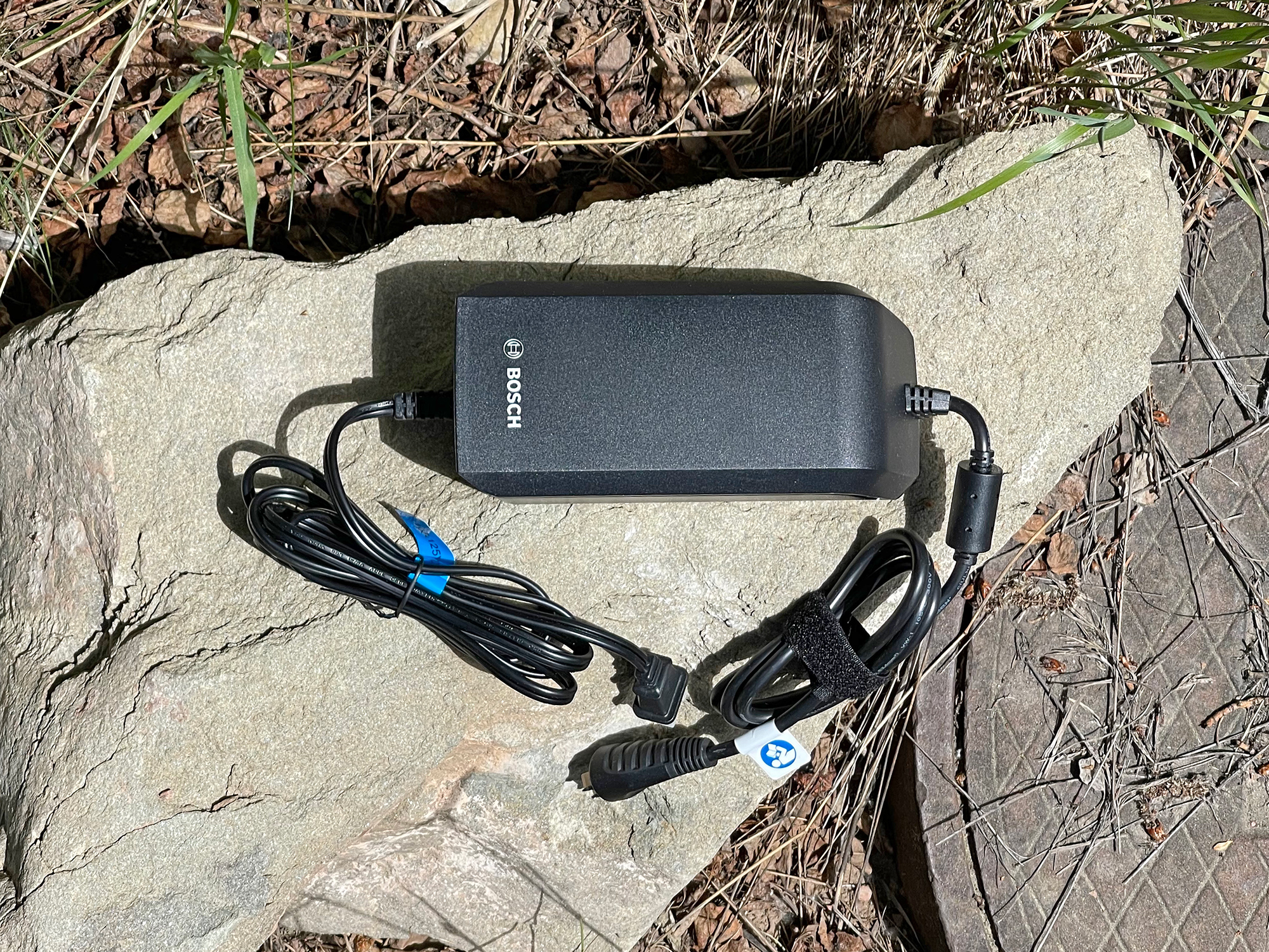

- Excellent battery charger, Bosch has designed a compact, relatively lightweight (1.7lb) charger that delivers fast 4 amp charging and uses a durable proprietary plug interface that won’t get mixed up with other chargers in your house and also plugs into the battery and frame charging port without the use of a dongle… it’s one of my all time favorite chargers in the entire space. Some companies opt for the cheaper 2 amp charger from Bosch, but I’m glad CANYON did not, given the higher capacity 500 watt hour battery used here.

- While the stem and double decker handlebar save weight, look awesome, and might introduce some aerodynamic qualities, they are not adjustable and upgradable the same way that a standard stem and independent handlebar are. Good thing there are three hand positions to rotate through.

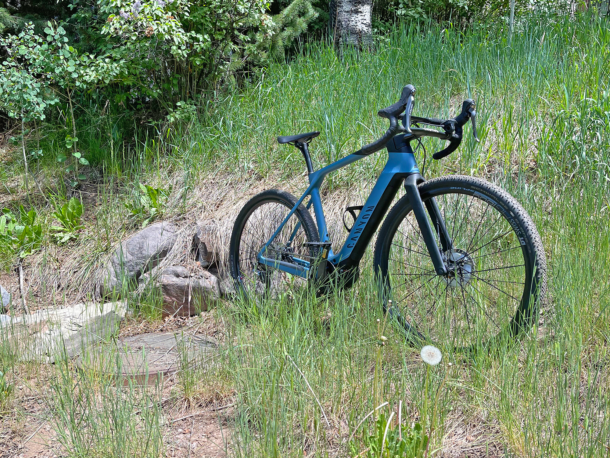

- The lack of availability for all seven frame sizes frustrated me, maybe that has more to do with supply chain constraints during 2020/2021? Four sizes were available for the CF 8 while only two were available for the eTap at the time of this review.
- Very high standover height on this frame, it’s only available in high step and the top tube isn’t sloped down very much. The splayed seat post offers some comfort, but it cannot go down as far and significantly raises the minimum saddle height. You could always swap it out for a rigid post, this is not an uncommon issue for seat post suspensions and may not be super relevant to riders who are seeking out such a sporty bike.

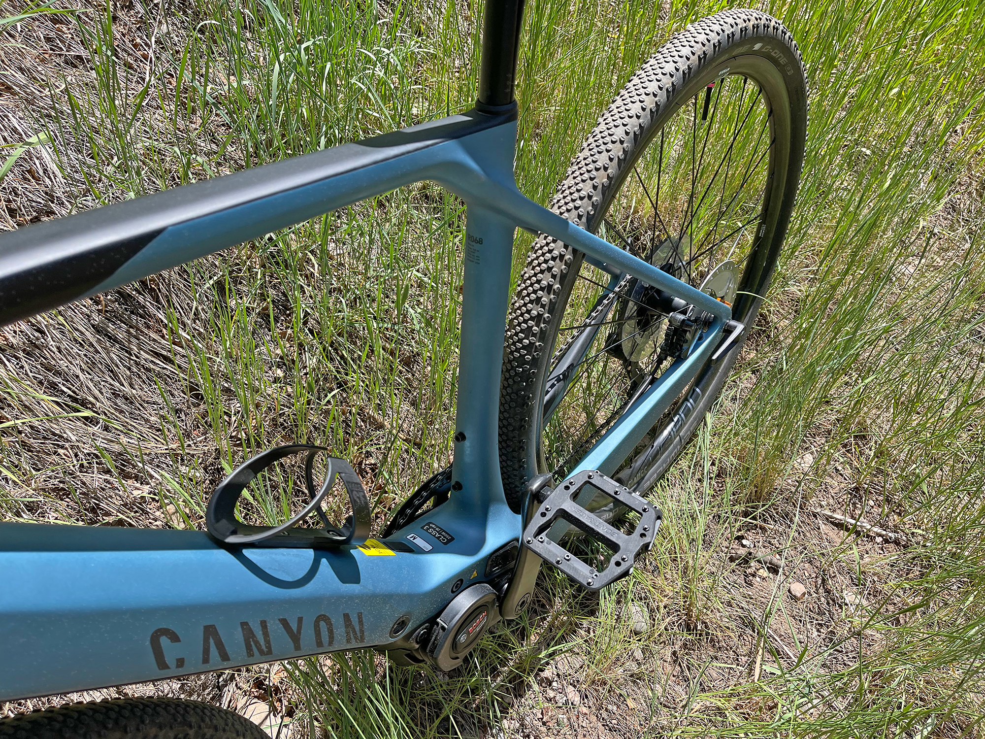

- Unlocking the battery pack or plugging it in to charge (while mounted to the bike) requires you to bend way down to the bottom bracket on the non-drivetrain side of the bike… This is the safest side of the bike to lay down in order to keep the derailleur from getting bent. Bosch, CANYON, and others should really consider putting the locking core and charge port on the drivetrain side, in my opinion. This ebike doesn’t have a kickstand, leaning it against a wall seems precarious (especially with a long cord attached for charging), and I dislike having to bend way down and stabilize the bike when plugging in. Removing the battery to charge separately is also possible, but that requires the key to unlock and then balance the bike and remove the battery which is actually more time consuming and difficult than just plugging in the charge cable. Do consider storing the battery separately to reduce exposure to extreme cold and heat, and maintain at least 50% when not in use for long periods.

- As with most drop-bar electric bikes, the button pad is not reachable in all hand positions. I found it somewhat awkward to use when riding, and I wished that they chose the Kiox because it’s compact but has a USB charging port and is compatible with the Bosch smartphone application. You can upgrade to this and other displays for more money and some help from a local shop.
- The Bosch Purion display does not have a battery percentage readout, average speed, max speed, or clock, and lacks the ability to connect with a heart rate monitors. At least it shows your range estimate in addition to the 5-bar battery capacity infographic… so you can plan your rides easier. Hold the – key to cycle through menus to see range. Despite being mounted near the grab points on the handlebar, there are some hand positions where it can be very difficult to reach.
- I don’t think that the bike comes with pedals, perhaps they expect most people to use clip-in or buy their own, it’s a minor thing but worth mentioning, this is how many high-end bikes are sold.

Great review and a very nice German carbon ebike for a great price imo. Question, is the display upgradeable to NYON? Also, your hard work to do this reviews, edit, etc… that should not be free! Ads and reputable reviews are worth a lot of $ for companies.
Court says
Hi Ebiker01! Great question… Yes, I feel pretty confident that the Bosch Purion display can be upgraded to Nyon. My friend owns a shop in Southern California and he has done this before. You would need to pay for the part and some service, but I think it’s possible. Perhaps you could contact a local Bosch ebike dealer to ask about ordering and installing :)

I would like to change display to Cobi or Nylon not sure what it will take or possible. If anyone knows how or if possible I would like to hear. Also is possible to put on 48 tooth front sprocket on the GRX?
Ge says
Hi, I spoke with a rep from Bosch and she says if it is a performance line speed motor paired with a Purion display it IS upgradable to Nyon system. That would be really nice to be able to set your assist levels for each 4 assist modes is I believe how that works. But, she said it is not compatible with the PLS motors with the Smart System (and another app ebike flow app) and display and assist control. Really sad the new display and pad look like something that should come on a neophyte’s bike or the many pedestrian bikes you see around and it is a brand new display and controller. Give them a call I was surprised how helpful they were for technical questions when I ask for someone that was…

You’re right on, Ge! The last generation of ebike systems from Bosch was considered Generation 1 (even though it had four generations within it) and they were compatible with the eBike Connect smartphone app with limited features (map, ride tracker, heart rate). The new Generation 2 is called Smart System and uses a different charger, battery, and motors (even though the motors are basically the same from what I can tell, they just have a new communication system and work with the eBike Flow app). The new app lets you adjust assist levels and provides more feedback to brands who can make their own branded apps.
