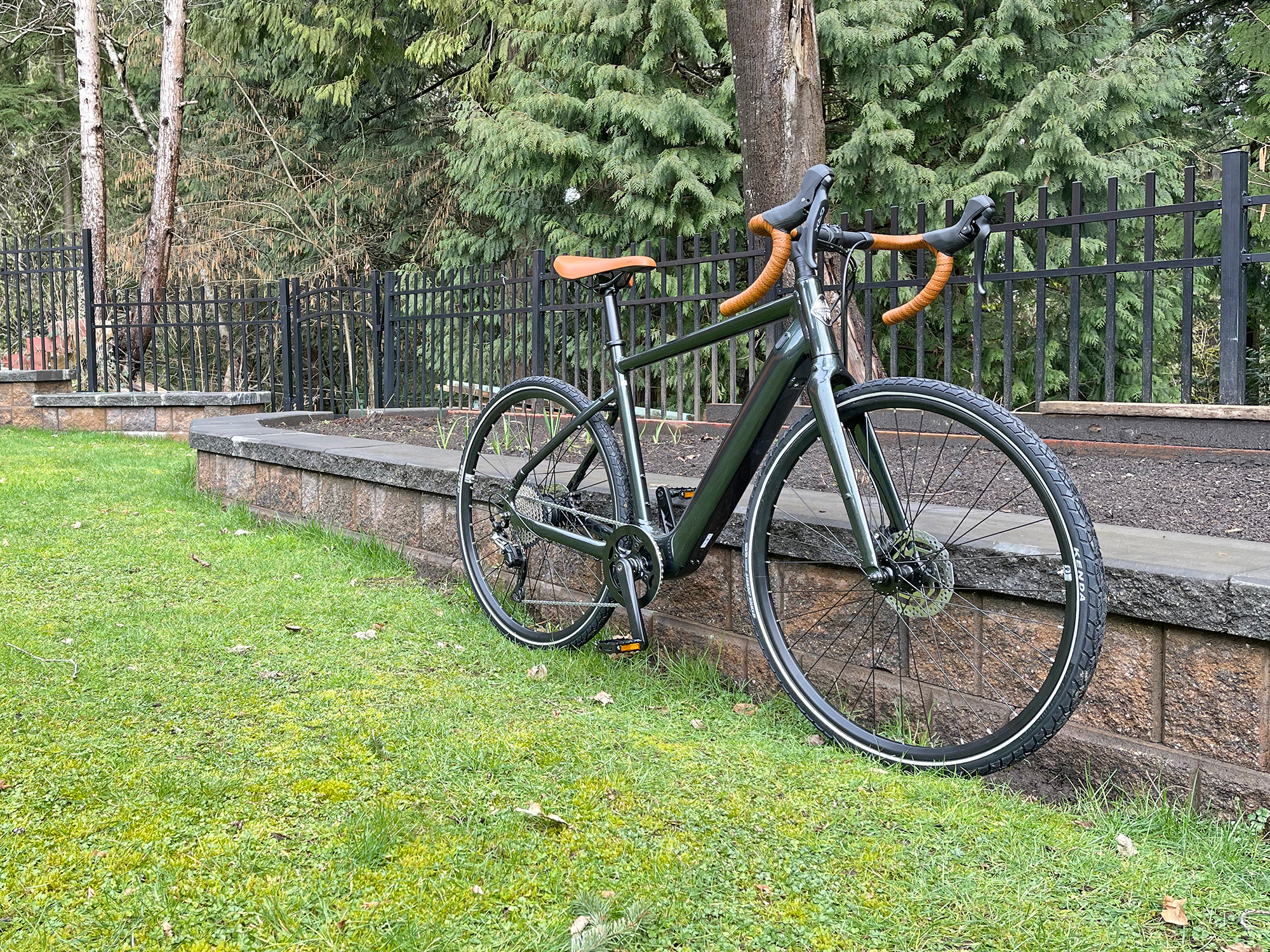

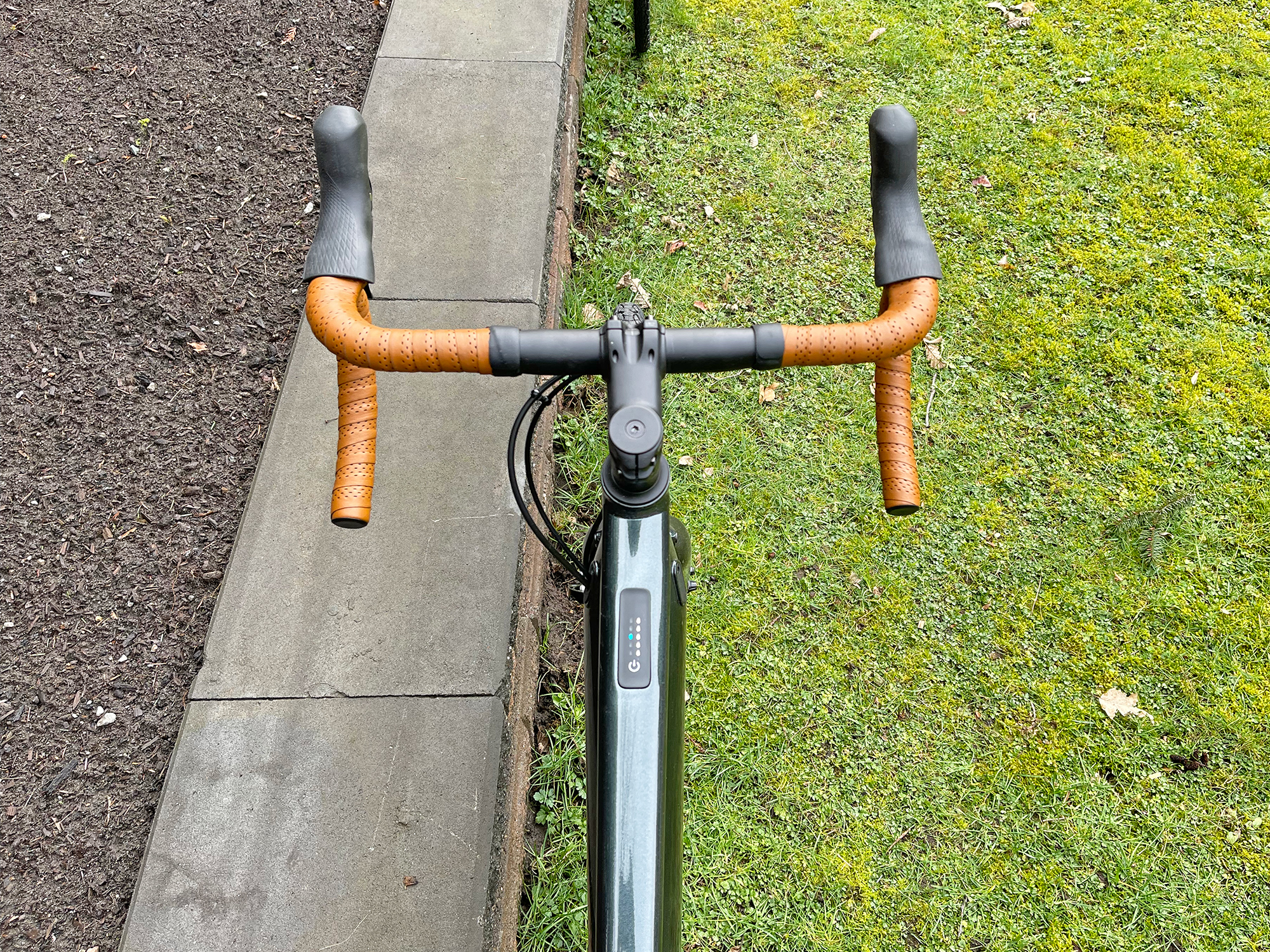

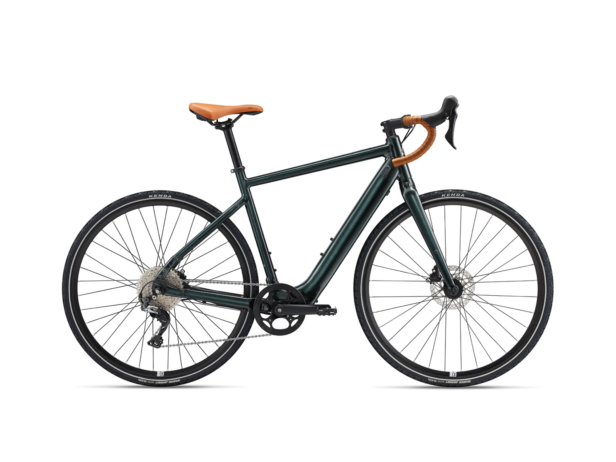

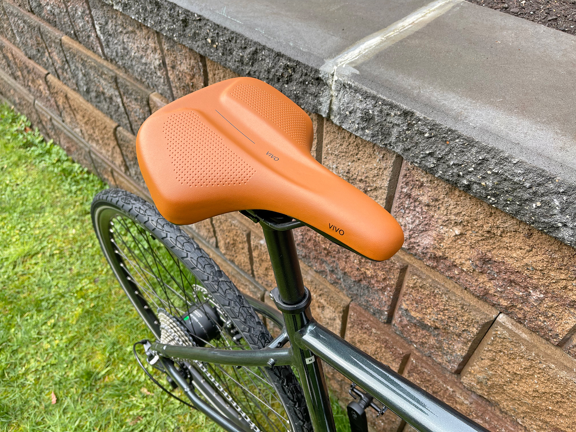

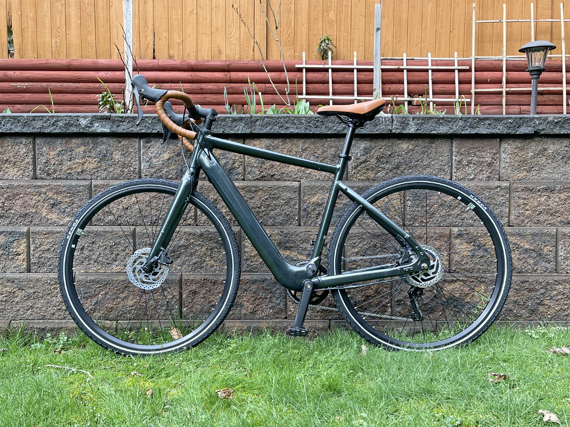

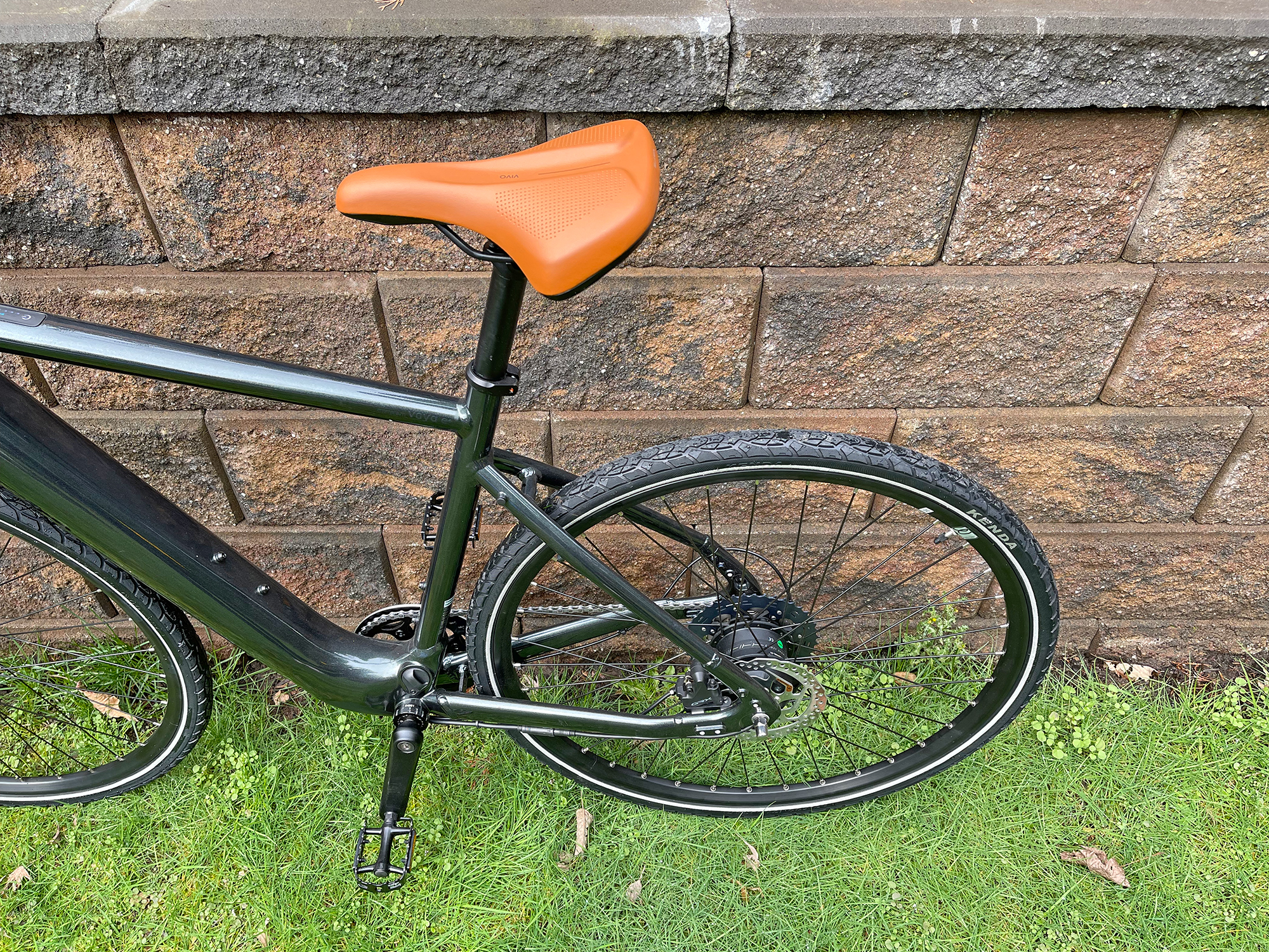

- I enjoyed riding the bike, even unassisted, and feel that Momentum achieved the sporty light weight design very well. It wasn’t as uncomfortable as some of the other road bikes I’ve tested in recent years. The stem spacers, shorter stem, flared gravel style drop bar, and hybrid saddle are on point. By comparison, most road bikes have very narrow firm saddles. Having three frame sizes to choose from really makes a difference since the Voya E+ only comes in high-step.

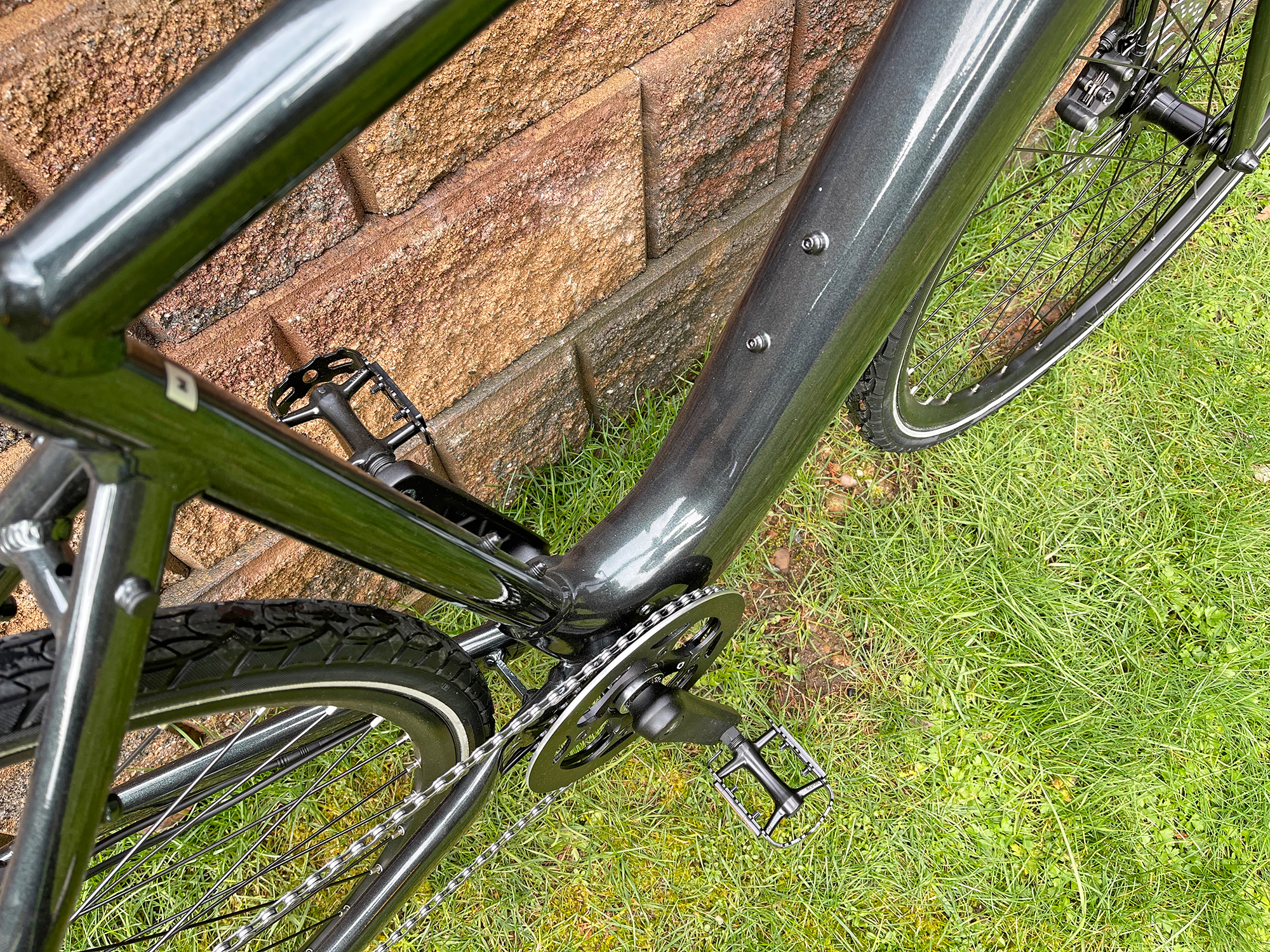

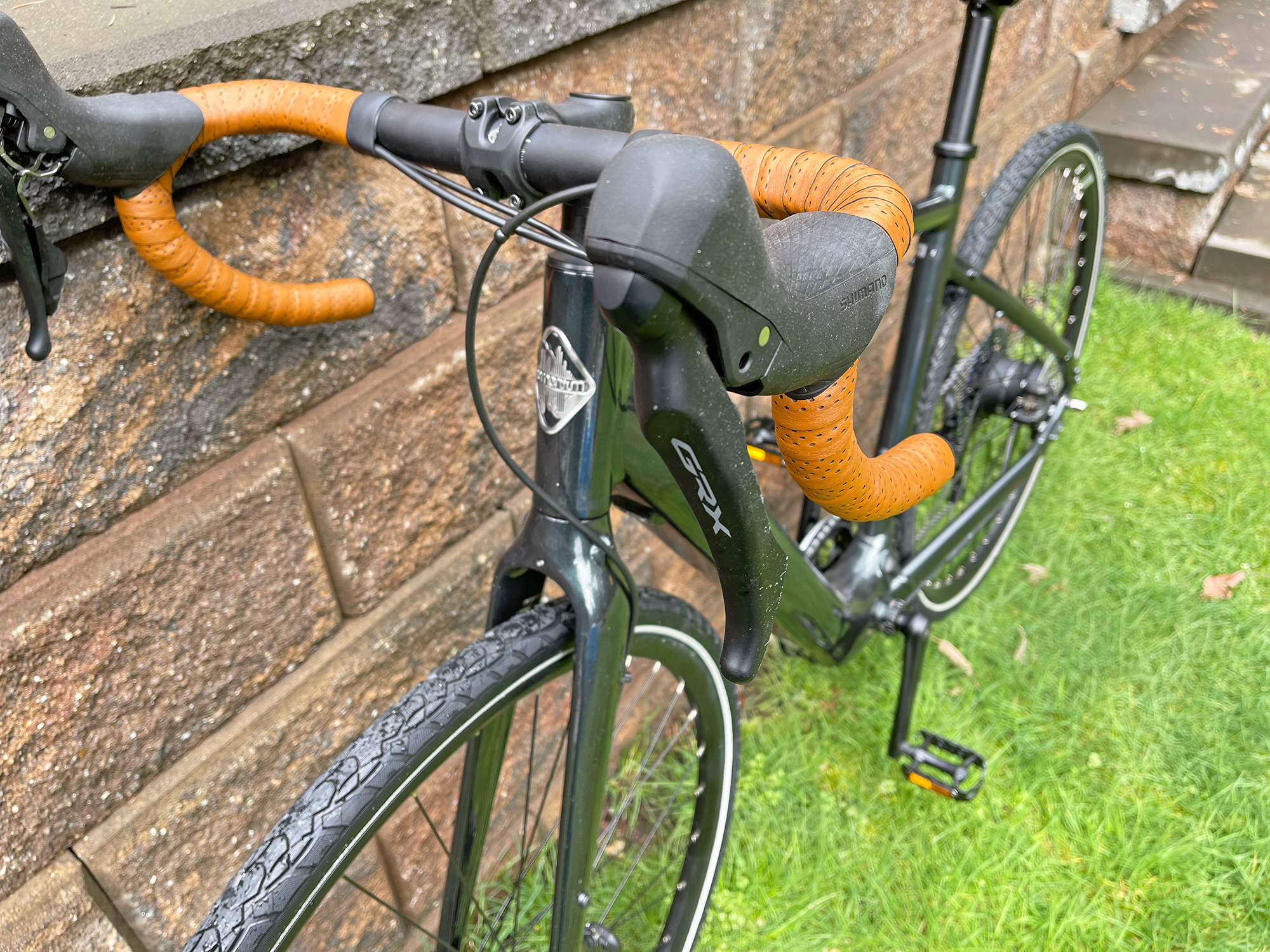

- Most of the cables and wires are internally routed, so the bike looks beautiful and won’t get snagged or damaged as easily at bike racks. The motor power cable has a quick disconnect for easier servicing, is positioned on the left side of the frame, and doesn’t stick out at all. This adds convenience, reduces clutter near the derailleur, and reduces the potential for damage.

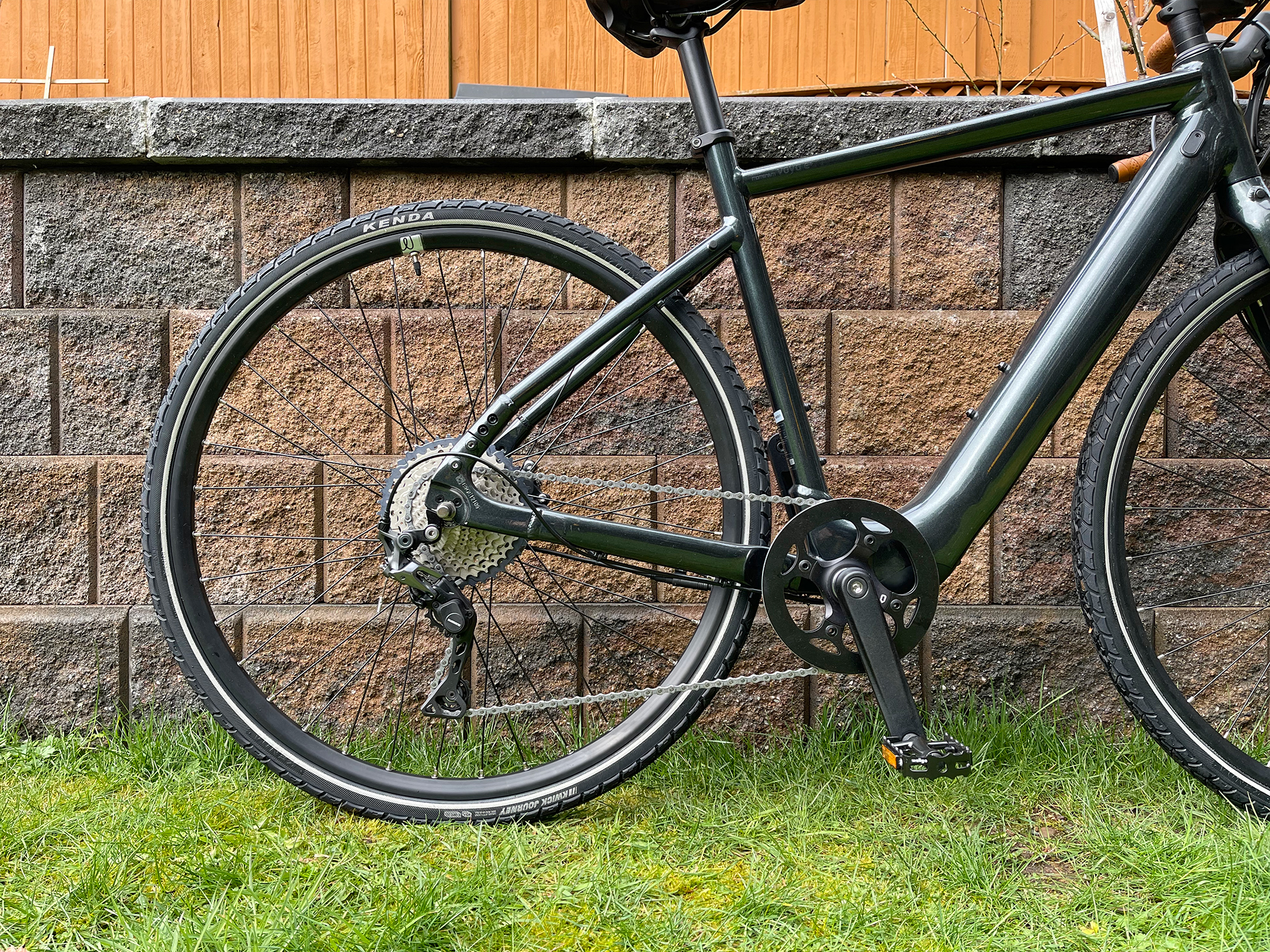

- Momentum chose Shimano for the drivetrain on the Voya E+ 1 while going with microSHIFT for the E+ 3 (the flat handlebar model). Both derailleurs have a clutch system that reduces chain bounce, but still allows for easy rear wheel removal and maintenance. Both offer a good range of 11 to 42 teeth, so climbing feels comfortable as well as higher speed cadence. The Shimano GRX groupset provides 11 gears, so you get more cadence options than the microSHIFT 9-speed on the E+ 3 model.
- I noticed a clear plastic sticker on the chain stay, meant to protect it from chips and scratches resulting from chain bounce. This is great news if you plan to ride off curbs occasionally, or outfit the bike with gravel tires and go off-road. Note the color matched fork, and the two color options… both look very nice, I’m partial to the matte indigo because it probably reflects more light for improved safety during evening rides.

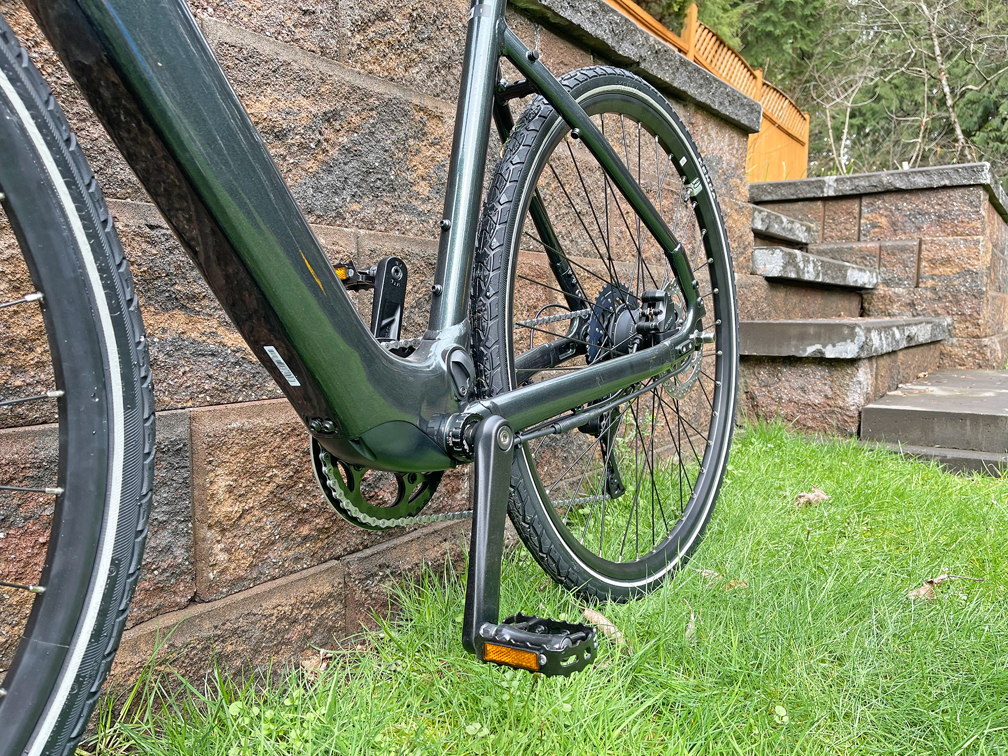

- It’s not relevant for the North American models right now, but the bike frame actually has a break point on the right seat stay. This enables a belt drivetrain to be used vs. a chain. This kind of thing adds cost, but I actually think the price point is pretty good. Giant has economies of scale, being one of the biggest bicycle manufacturers. So by extension, so does Momentum as a child brand.

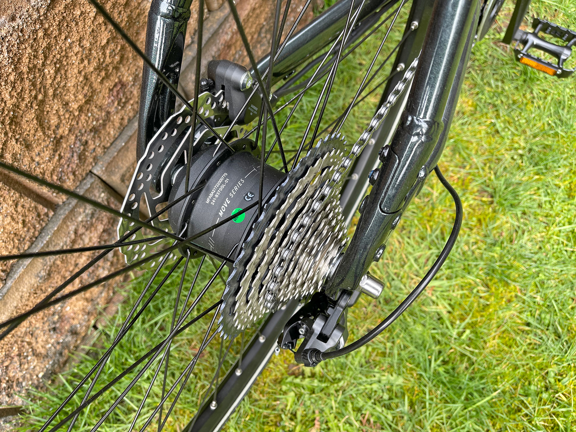

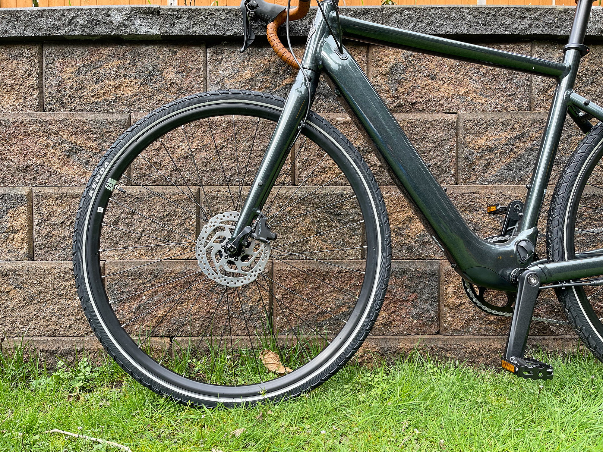

- I noticed that the front wheel uses fewer spokes and narrower gauge wire that reduce weight and add some flex for comfort. The rear wheel, where the motor and optional cargo rack are, requires more strength. The rear hub spacing is Boost 148mm which provides extra width for a sturdier spoke bracing angle. The spokes are thicker 13 gauge, and there are 36 vs. 32 up front. The rear rim has reinforcement eyelets that reduce the chances of cracking. It’s a nice setup and I appreciate the attention to detail.
- There are lots of mounting points on the frame for adding accessories like fenders, front and rear racks, a rear frame lock (sometimes called a cafe lock), a rear or center kickstand, and two bottle cages! There are even some mounts on the right side of the frame that I’m not familiar with… I really appreciate the mounts, because they add a lot of utility and potential for creativity that would otherwise be missed, and is often not present on light road bikes.
- The stock tires are great. They provide an efficient quiet tread pattern that still offers some grip. They are skinny, but provide a good pressure range of 50 to 85 PSI, so you can lower them for comfort if you wish. They are ebike rated for high speed use 50km/h, have puncture protection, and offer reflectivity for safety.

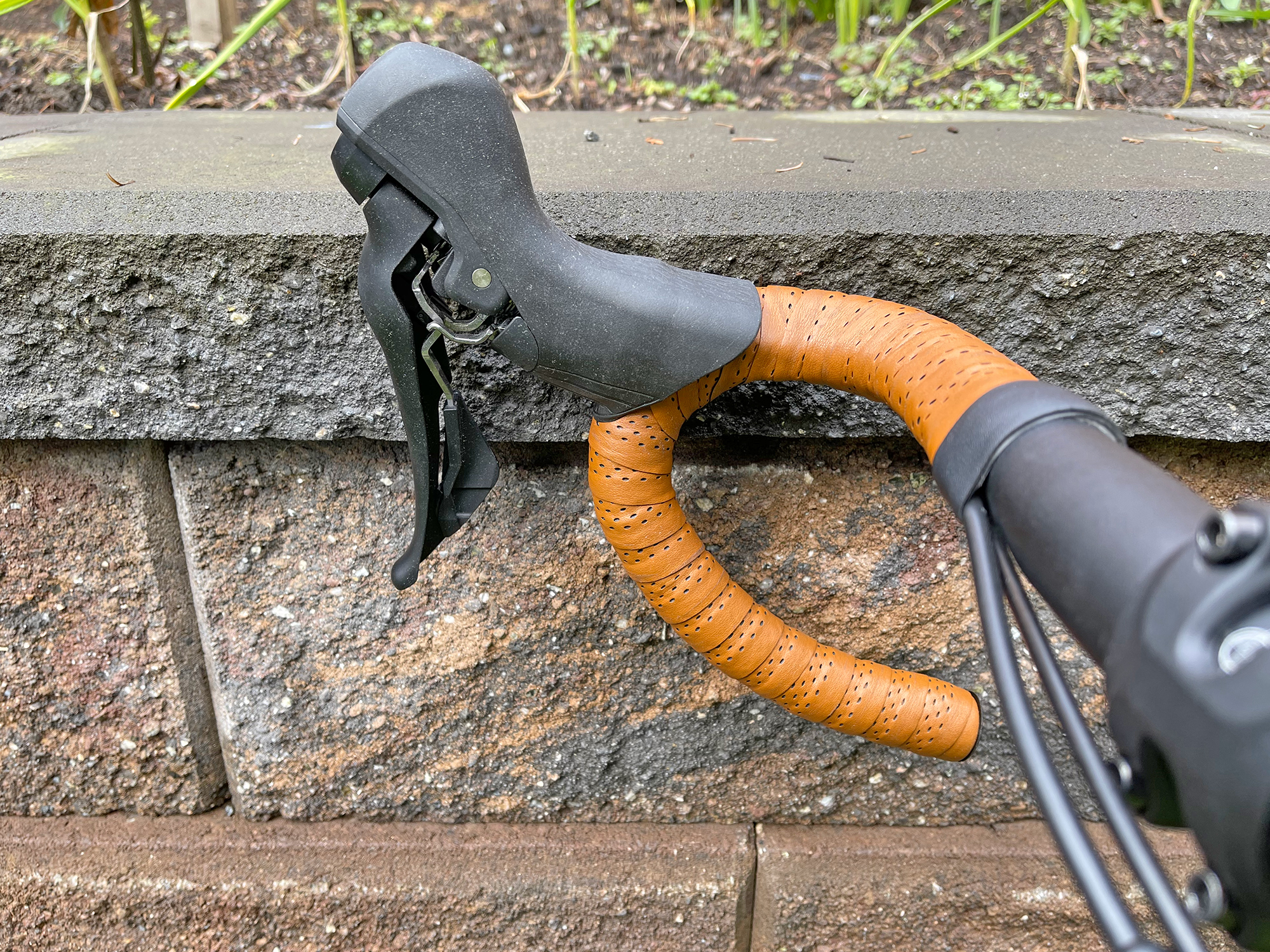

- Even though the motor system is designed for Class 1 20mph top speeds (25km/h in Europe), the bike can easily be pedaled faster. The gearing is comfortable beyond 20mph, and the shifters are easy to reach and actuate. It’s a paddle design where the smaller inner paddle shifts to higher gears and the entire brake lever shifts to lower gears.
- The Shimano GRX hydraulic disc brakes offer a decent 160mm rotor and standard dual piston calipers. They will stay cleaner than rim brakes, are easier to actuate, and the smaller 160mm rotors won’t get bent as easily at bike racks or if the bike is laid on one side. Given the added weight of an ebike vs. standard road bike, and possible higher speeds, I’m glad they went with hydraulic disc brakes here vs. mechanical.
- The bike frame is well balanced front to rear, I was able to lift and balance the frame by holding the top tube near the center (just in front of the saddle nose). The hub motor only weighs 3.7lbs according to the Momentum specs, and the battery is positioned low and center in the downtube for a low center of gravity. I’m guessing that the battery only weighs 5lbs.

- The motor was fairly quiet, responded very quickly because of the four sensor design, and is small and hidden visually. The bike almost doesn’t seem electric, it’s very stealthy and blends in… I feel like it could level the playing field for people of different ages and abilities to keep up on hills, in the wind, or on longer journeys.

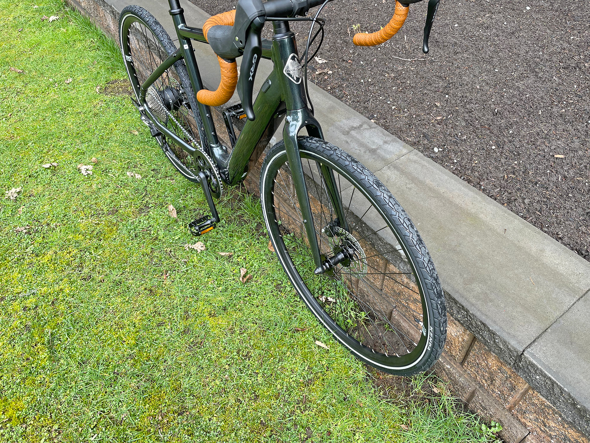

- The all-aluminum frame and fork are less comfortable than steel, and don’t offer any suspension. The narrower tires don’t help a lot, but the taller wheel size does lower the attack angle, and there appears to be enough room to swap in higher volume treaded gravel tires as mentioned previously! I would also consider a 30.9mm suspension seat post if you plan to ride on bumpy terrain. Thankfully, the geometry is fairly upright and the saddle is very comfortable. The drop bar offers three hand positions so you can adjust for comfort as you ride.

- This is a minor detail, but I’m not a huge fan of the pedals included here. The center portion is aluminum alloy, but the surrounding platform is steel. The steel can get bent if the bike tips, and can get scratched and sharpened, and rusty over time. I’ve seen it happen a lot, so it has turned me off on this style.

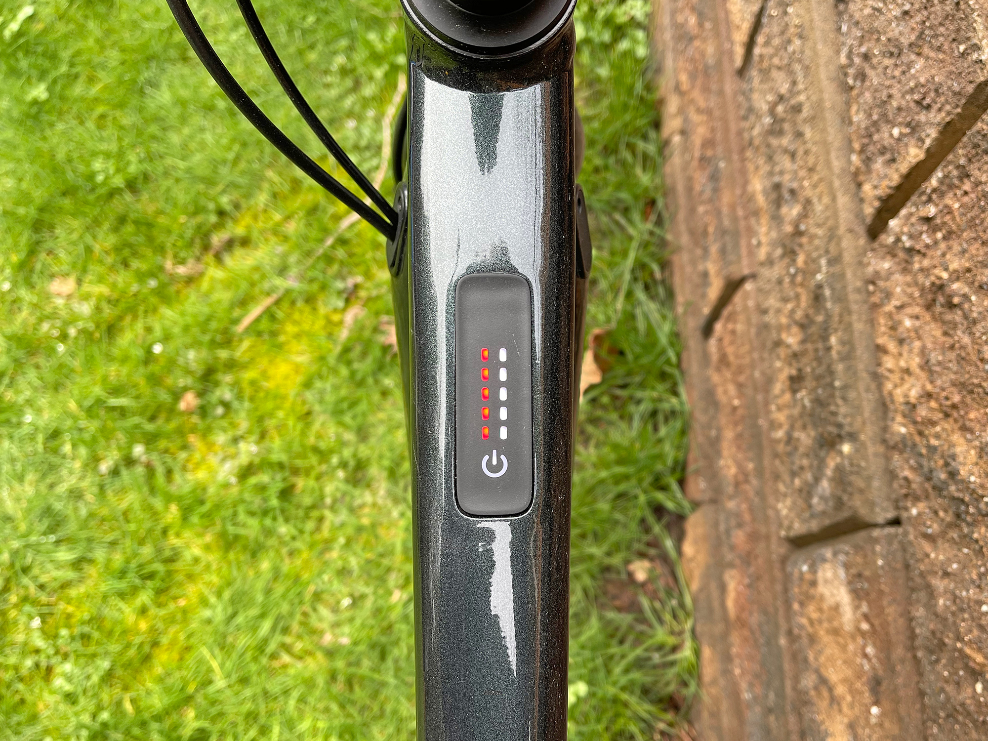

- The RideControl Go LED display is positioned on the top tube vs. up on the handlebar, so you have to look farther down to read the assist level and battery charge level. Furthermore, in order to change assist levels while riding, you need to take one hand completely off the bar and reach. I’d probably stop before pressing the button, or consider paying extra for the RideControl Ergo 3 button pad that can mount near the left grip (I’m actually not sure if that accessory works with this drop bar setup).
- The battery pack is semi-permanently mounted inside the downtube. You can take it out of the frame by using a hex wrench on some bolts securing a plastic shield at the bottom bracket… but this is mainly for repairs or replacement. Ultimately, it’s best to keep Lithium-ion battery packs maintained 20% to 80% and stored in a cool dry location. Extreme heat and cold can negatively affect lifespan and range. This means you need to put the whole bike in a cool dry location, which could be difficult and create messes inside vs. if the battery was simply removable.

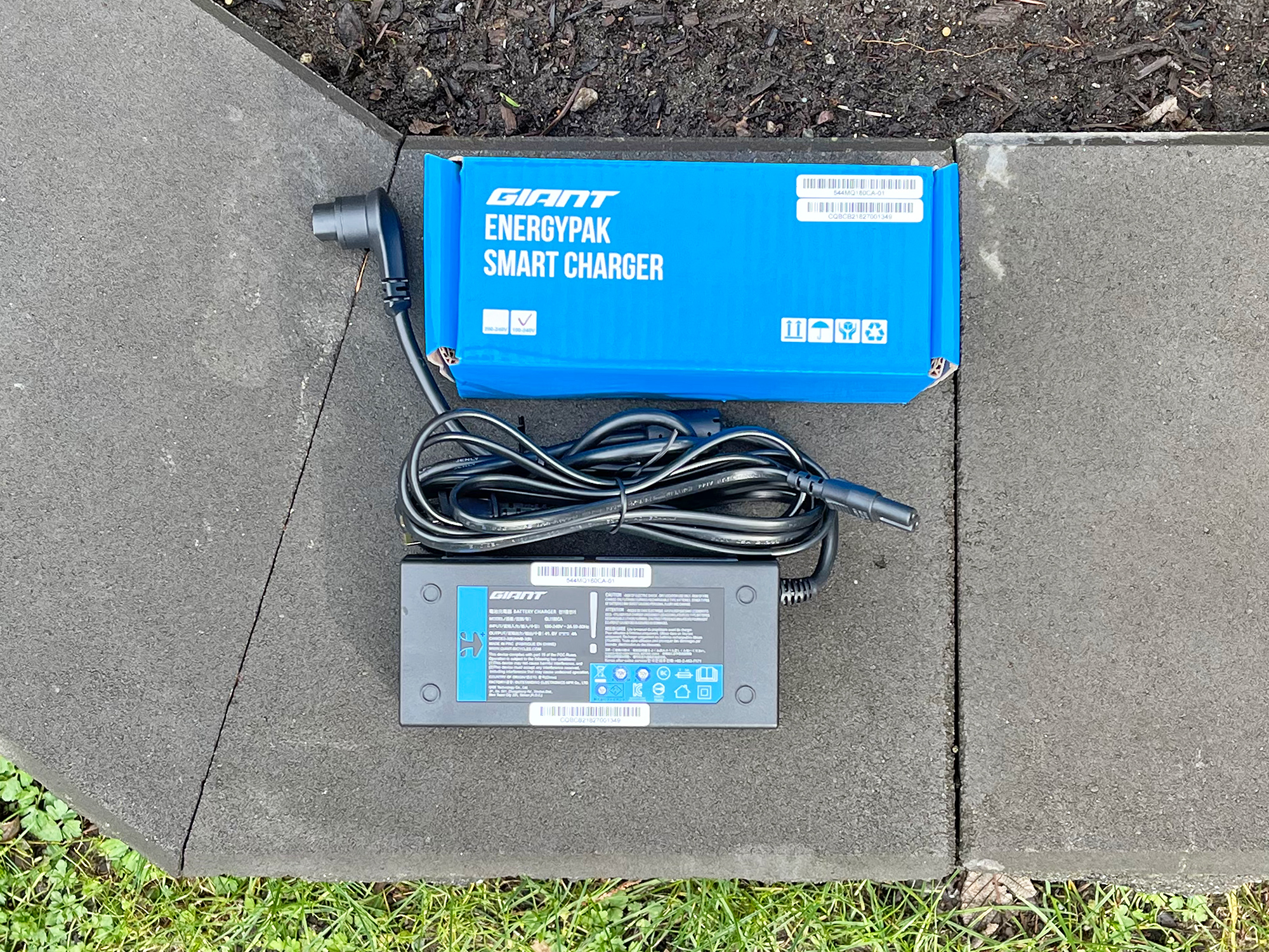

- Charging the battery can be difficult since you basically need to bring the entire bike near a plug. It means that you might not be able to charge at school or work during the day, if there isn’t a plug near the bike racks. The charging port for the frame is also a bit inconvenient, located very close to the spindle on the left side of the frame. It’s directly in the path of the left crank arm.
- I was surprised that the front wheel connects with a quick release skewer while the rear wheel and seat post clamp use hex bolts. I’d either appreciate the convenience of a quick release seat clamp for adjustability, or the security of a locking front wheel so nobody will tamper with my bike.
