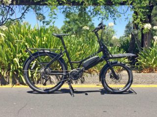

Total Weight:
58.2 lbs (26.39 kg)

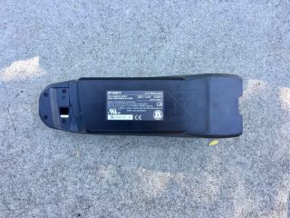

Battery Weight:
5.7 lbs (2.58 kg)
Motor Weight:
6.35 lbs (2.88 kg)
Frame Material:
6061-T6 Aluminum Alloy
Frame Sizes:
18.5 in (46.99 cm)Geometry Measurements:
18.5" Seat Tube, 14.5" Reach, 21.75" Simulated Top Tube, 20.5" Stand Over Height, 34" Minimum Saddle Height, 43" Maximum Saddle Height, 28.5" Width, 70" Length, 45" Wheelbase
Frame Types:
Mid-Step

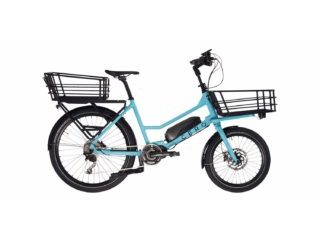

Frame Colors:
Halo Blue, Shio Grey

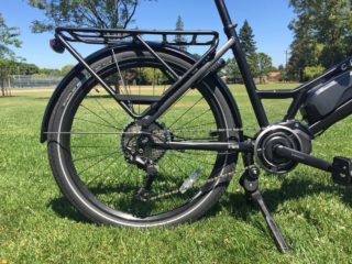

Frame Rear Details:
135mm Hub Spacing, 12mm Threaded Slotted Axle, Floating Dropout
Attachment Points:
Rear Rack, Fent Tray, Bottle Cage Mount on Right Side of Tray
Gearing Details:
5
Speed 1x5 Shimano Nexus Inter-5E Internally Geared Hub SG-C7000-5D (263% Gear Range), 32 Tooth SprocketShifter Details:

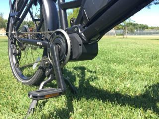

Cranks:
Shimano STEPS FC-E6100, Aluminum Alloy, 175mm Length Crank Arms, Gates Spider (4 bolt 104mm BCD) 39 Tooth Chainring with Aluminum Alloy Guard
Pedals:
VP-831P K1283 Nylon Platform with Sandpaper Grip

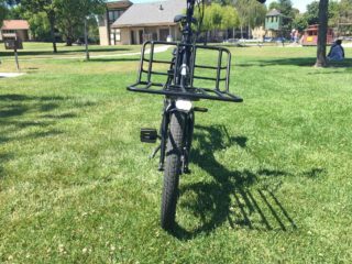

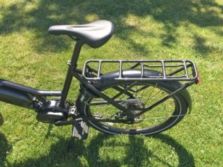

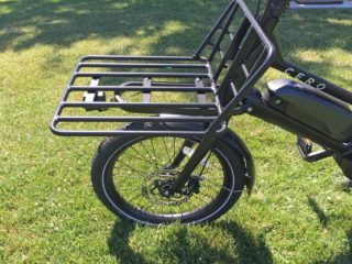

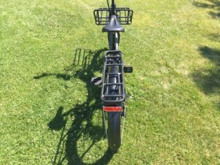

Accessories:

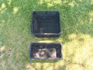

ABUS Battery Locking Core Keyed to Match ABUS Shield Plus 5750 Cafe Lock (Optional Chain Connector), Massload Double Leg Kickstand, Sunnywheel Custom Plastic Fenders (80mm Width, Matte Black), Removable Alloy Rear Rack with 14 Threaded Bosses and Pannier Blockers and Yepp! Seat Window (55lb 25kg Max Load), Removable Alloy Front Rack Frame Mounted (55lb 25kg Max Load), Integrated Spanninga Axendo 80 Headlight (80 Lux, Two-LED, Aimable), Integrated Spanninga Solo (One-LED), Nuvo Flick Bell, Reflective Logos (Head Tube, Downtube), Optional Small Basket with Net Liner, Optional Large Basket with Net Liner, Optional ABUS Frame Lock Chain, Optional ABUS NutFix Front Wheel Lock, Optional ABUS NutFix Saddle Lock

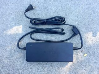

Other:

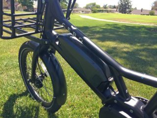

Locking Removable Downtube Mounted Battery Pack, ABUS Plus Code Keys (Match Battery and Frame Lock), Shimano EC-E6002 1.4lb 42 Volt 1.8 Amp Charger, Gates Carbon Drive Belt with CDX Center Track, Maximum Total Weight Rider and Cargo 300lbs (136kg)

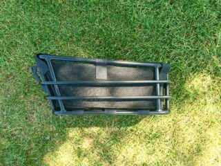

2 years agoThank you for this CERO One e-Bike Review. You help me make the decision. I bought a CERO straight from the company. The people are super nice. They’re honest and forthright. I opted to put the large basket on the front and I can use it to carry my 3 year old beagle. I like the build quality! They also use all Shimano parts. If you’re thinking about it, go for it. You’ll be happy.

I got the large basket and am glad I did. I often have either my backpack or groceries in it. I can’t imagine being happy with the smaller basket.

I’m interested in the Cero One, but need my 7 year old daughter to ride on the back occasionally (under 55lbs). She’s too big for the Yepp child seat. Seems like we could buy a random rack cushion, seatpost-mount handlebar, and wheel guards on Amazon, but…
We’re coming over from a non-electric Yuba Kombi and wondering if any of the accessories would screw into the Cero rack (ex. the “deck”, “ring”, or “monkeybars”). And if it’s a “no” on the Yuba accessories, any specific recommendations on how to have a kid sit safely on the rear rack, if possible?
ReplyCourt
2 years agoCool! I wish I had some tips for you Eric, but this is not an area I’ve explored much. I do know that Yuba and Xtracycle both sell electric versions of their cargo bikes. I think they would be compatible with your old accessories vs. adapting to CERO. Here’s the cargo category so you could explore products that might suit your needs better… that said, they will be longer and much different than the CERO One. You might be able to explore the forums or other sites to get some ideas on alternative racks, or ask CERO directly for input. They seem to be very responsive and open to talking with customers from what I’ve seen :)
ReplyEric Heaton
2 years agoThank you for the reply! I’ll check out the forums and see if others may have solved this issue (or can tell me it’s not possible). Btw, the Cero folks emailed me back — very response, as you said — and their answer was that they can’t comment on any accessory that they don’t sell on their site.
