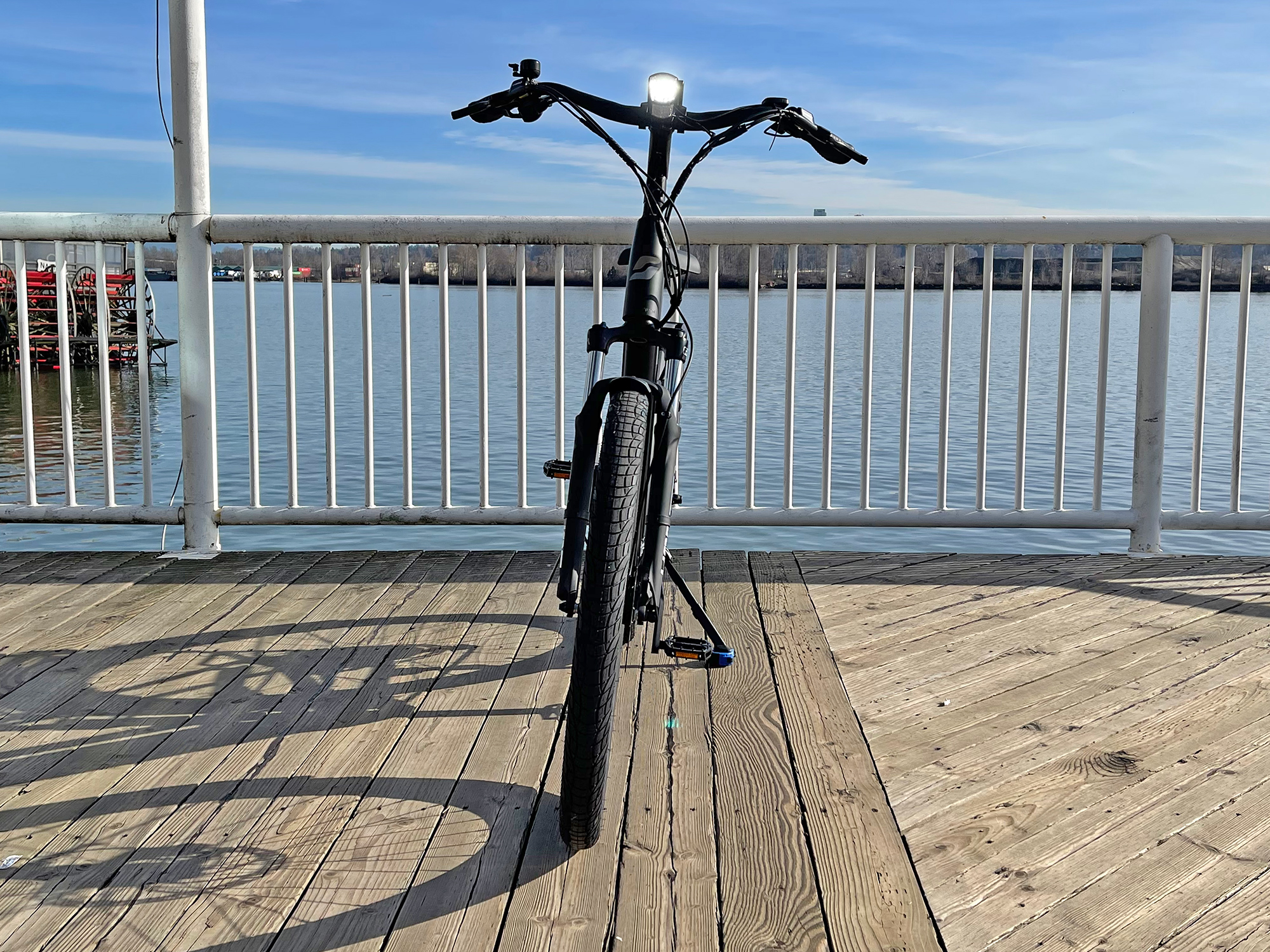

- My favorite upgrade for the Rook and Colt models is headlight placement! Not only does S604 use a high quality light with side windows, making it visible from more angles, but they’ve also placed it up high on the stem vs. down on the suspension fork arch where it used to be. The rear light is also very good because it uses two LEDs, and flashes when the brakes are actuated.

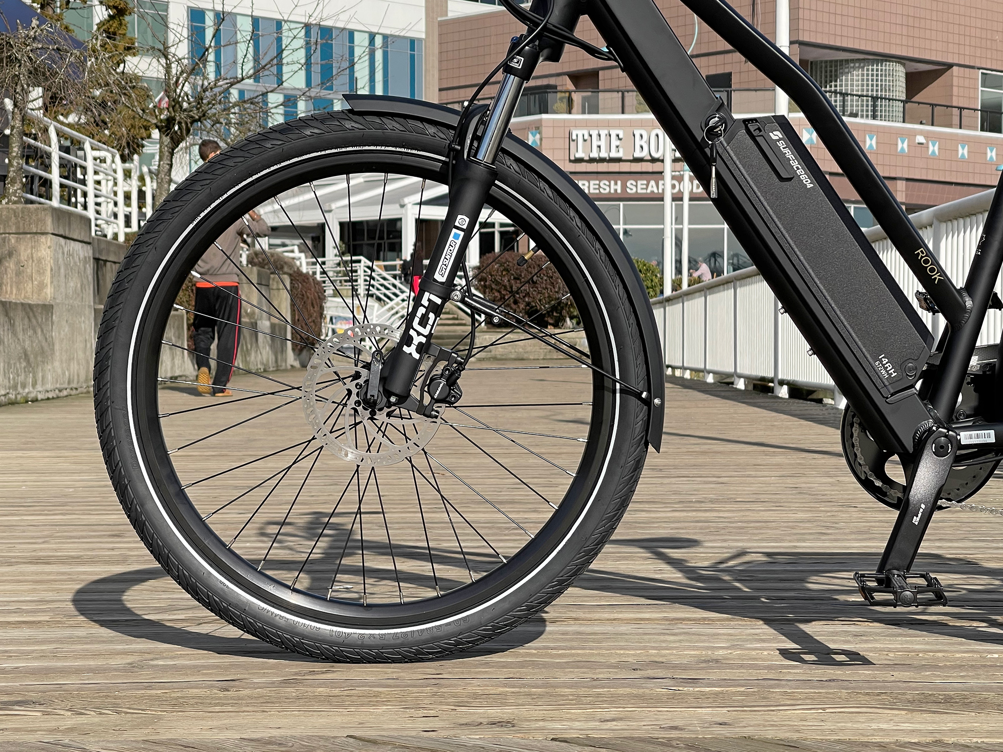

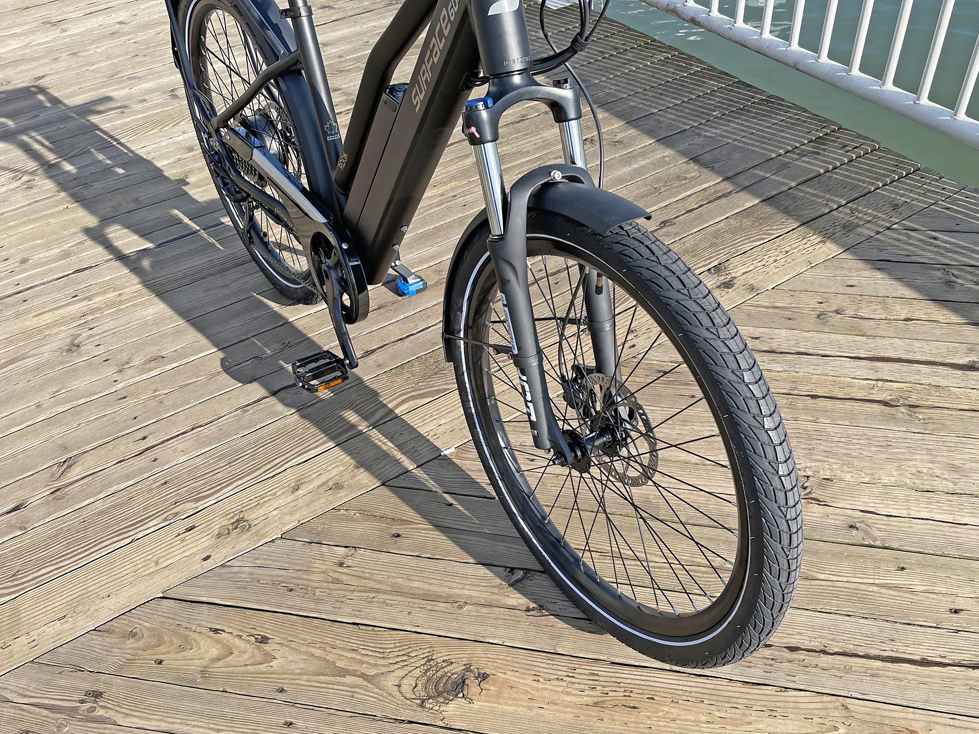

- I appreciate the adjustable spring suspension fork here, offering lockout and preload to support different loads. Surface 604 specced a taller 27.5″ tire that lowers the attack angle for comfort, and they use 2.4″ width for improved stability and vibration dampening. When you combine the fork with the tires and add in the name brand Selle Royal saddle, you end up with a very comfortable hybrid bike.

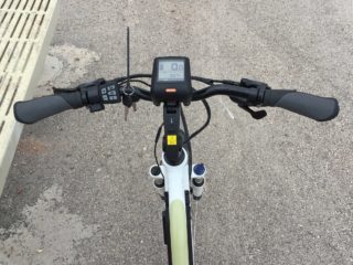

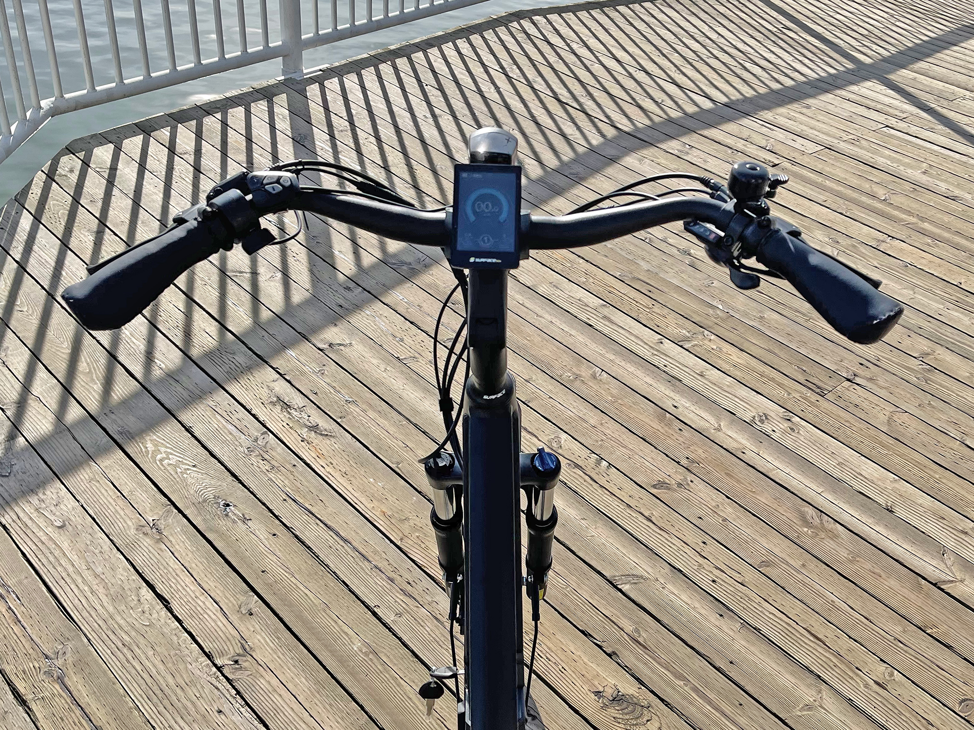

- The handlebar has been refined a bit since the last generation and now sweeps back more. This pairs nicely with the adjustable angle stem, which is quite long. I feel like these bikes fit a very wide range of people because of the two sizes, adjustable stem, and the new handlebar. They’re almost setup as a blend of city and cruiser, which I like.

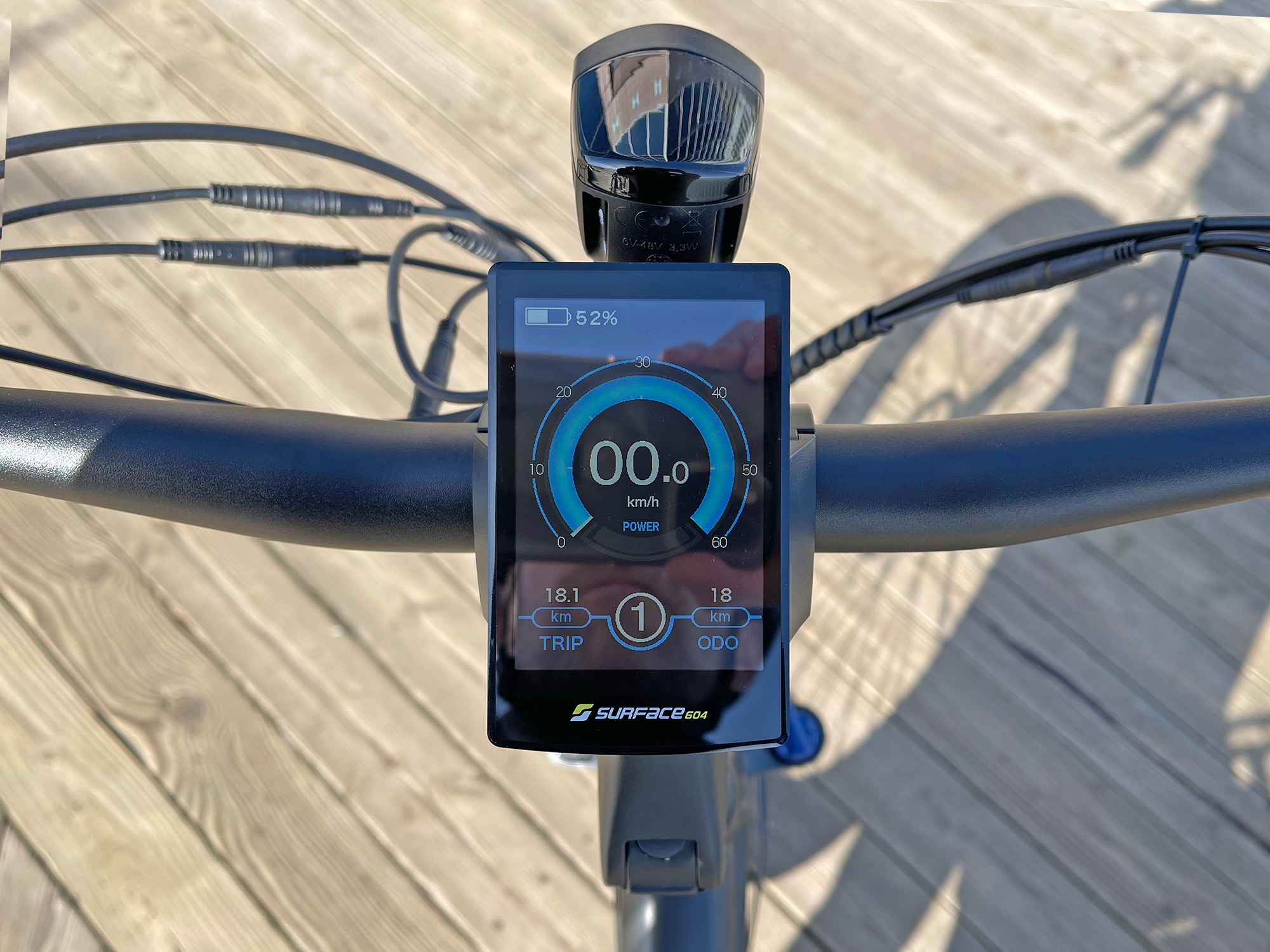

- I love the large color LCD display panel used here! The 3.5″ color LCD screen is positioned high, so it’s easy to read, and includes brightness adjustability in the settings menu (hold + and – to access this menu). They set it up to stay bright even when the lights are activated, since many people like to ride with lights on during the day for added safety. I love that there’s a precise battery percentage readout, that the display has a full sized USB type A port at the base, and that you can adjust how many levels of assist are offered (0-3, 5, or 9) and even adjust top speed.

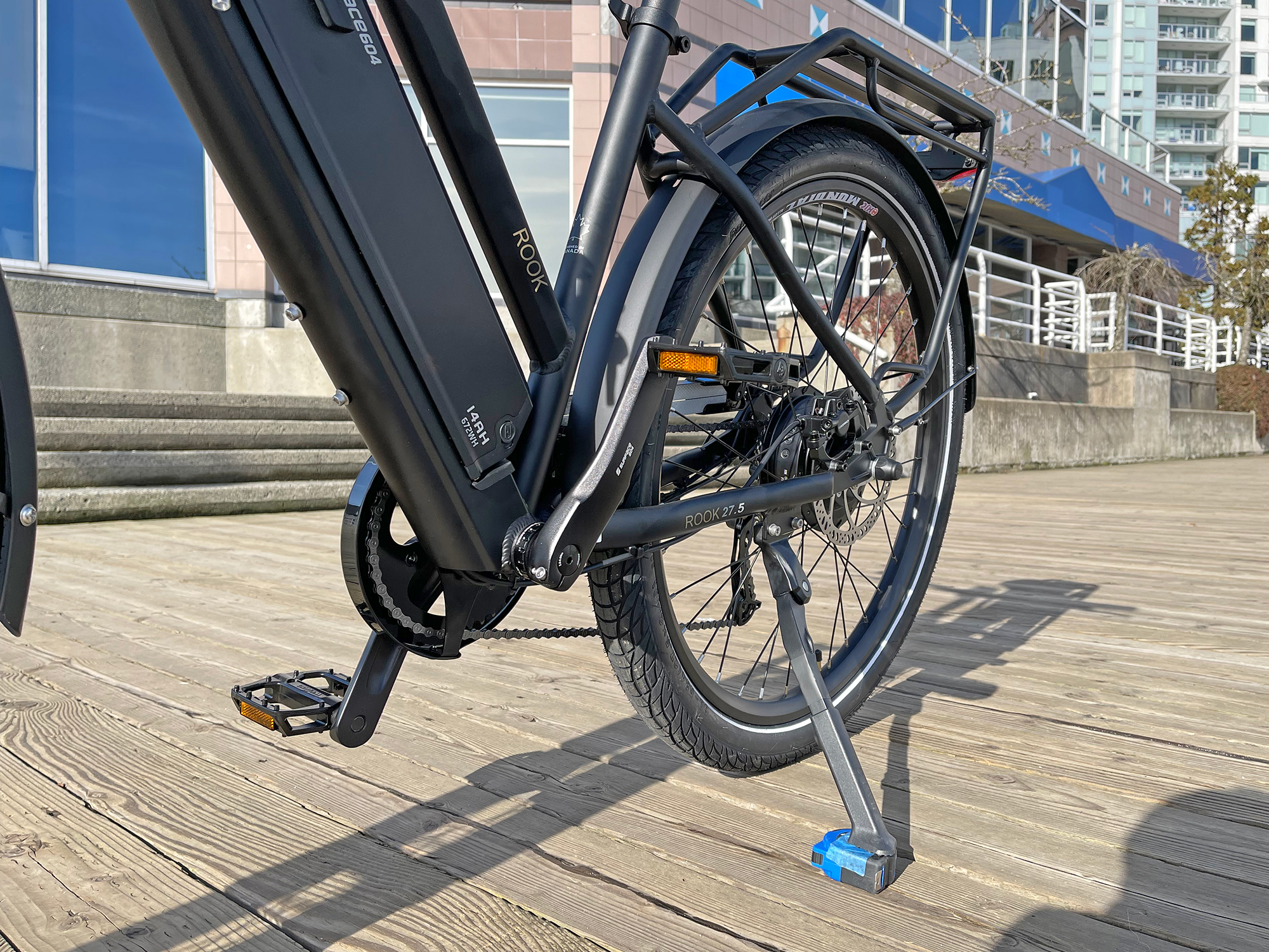

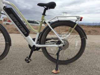

- I appreciate the kickstand choice here, because it offers adjustable length. It’s mounted using a standard 40mm bolt spacing, which makes it easy to replace. They positioned it far enough back that it won’t cause pedal lock when backing the bike up, and it should support a loaded rear rack well.

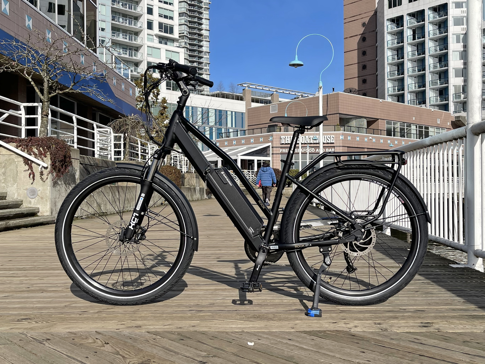

- The step-thru Rook frame is very approachable, but still stiff and sturdy feeling. Sometimes I’ll test a step-thru that has a flexing frame, other times the double tube frame has a high standover because of how the battery mounts. I feel like Surface 604 found a sweet spot between stiffness and battery access… and I appreciate that they added bottle cage bosses below the downtube in case you want to mount a folding lock, mini pump, or water bottle (even though it wouldn’t be that easy to reach).

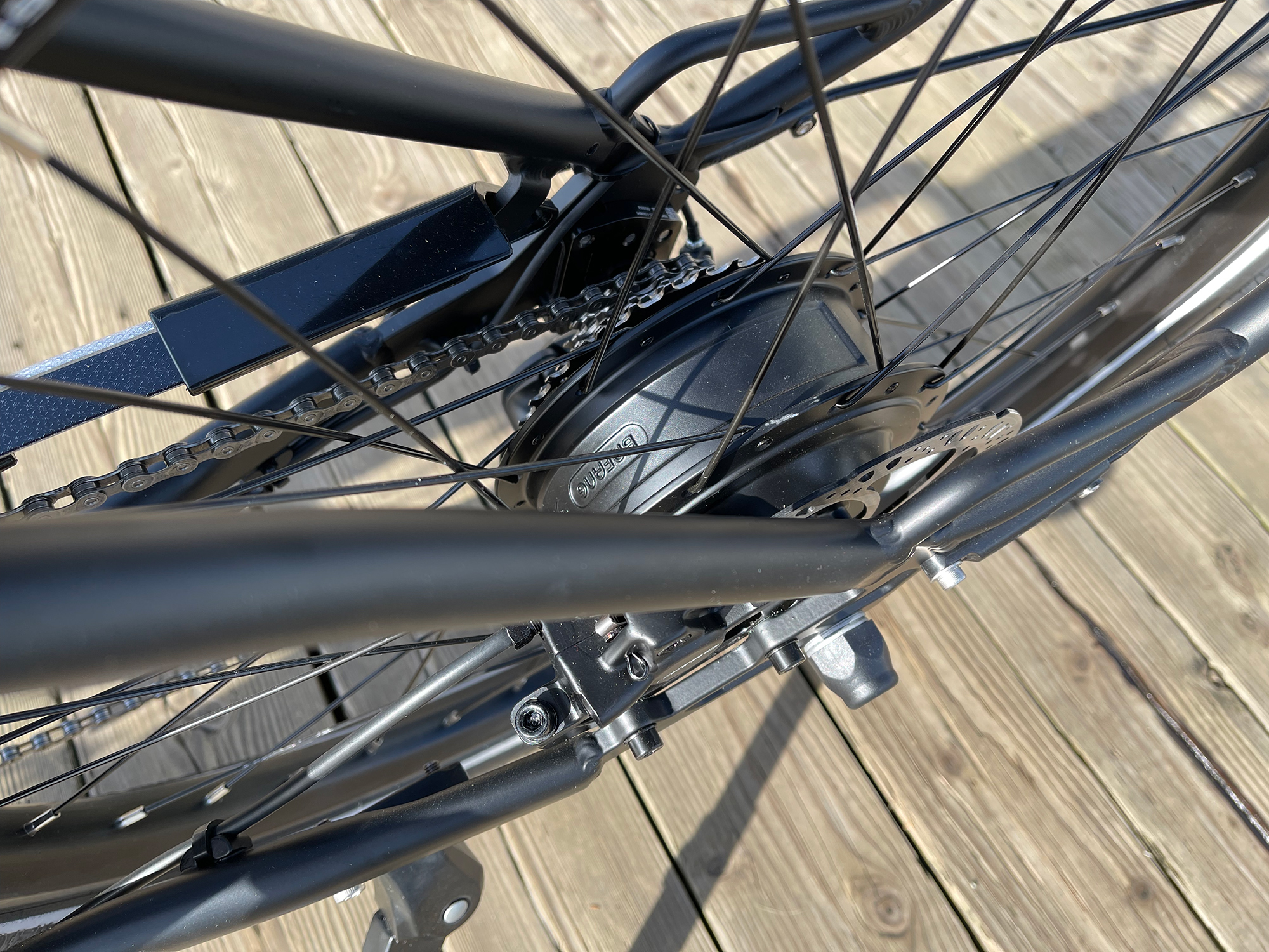

- Given the larger heavier wheel and tire combination here, I was impressed by the motor power and torque. Surface 604 reps told me that the motor can produce up to 45 newton meters of torque and peak out well above 500 watts. My experience riding was quite satisfying, and I think part of this has to do with the torque sensor. Keep in mind that I’m 5’9″ tall and weigh about 135lbs (61kg).

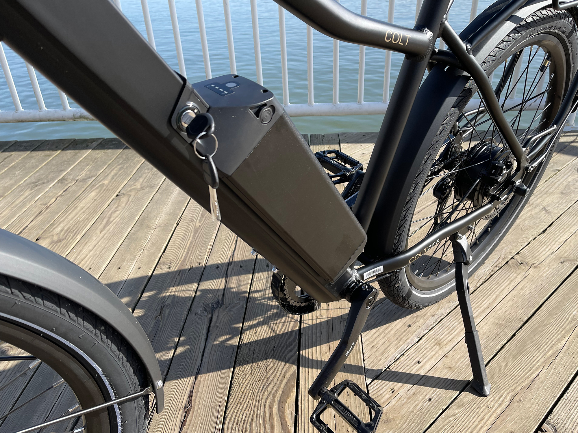

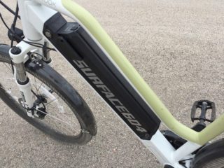

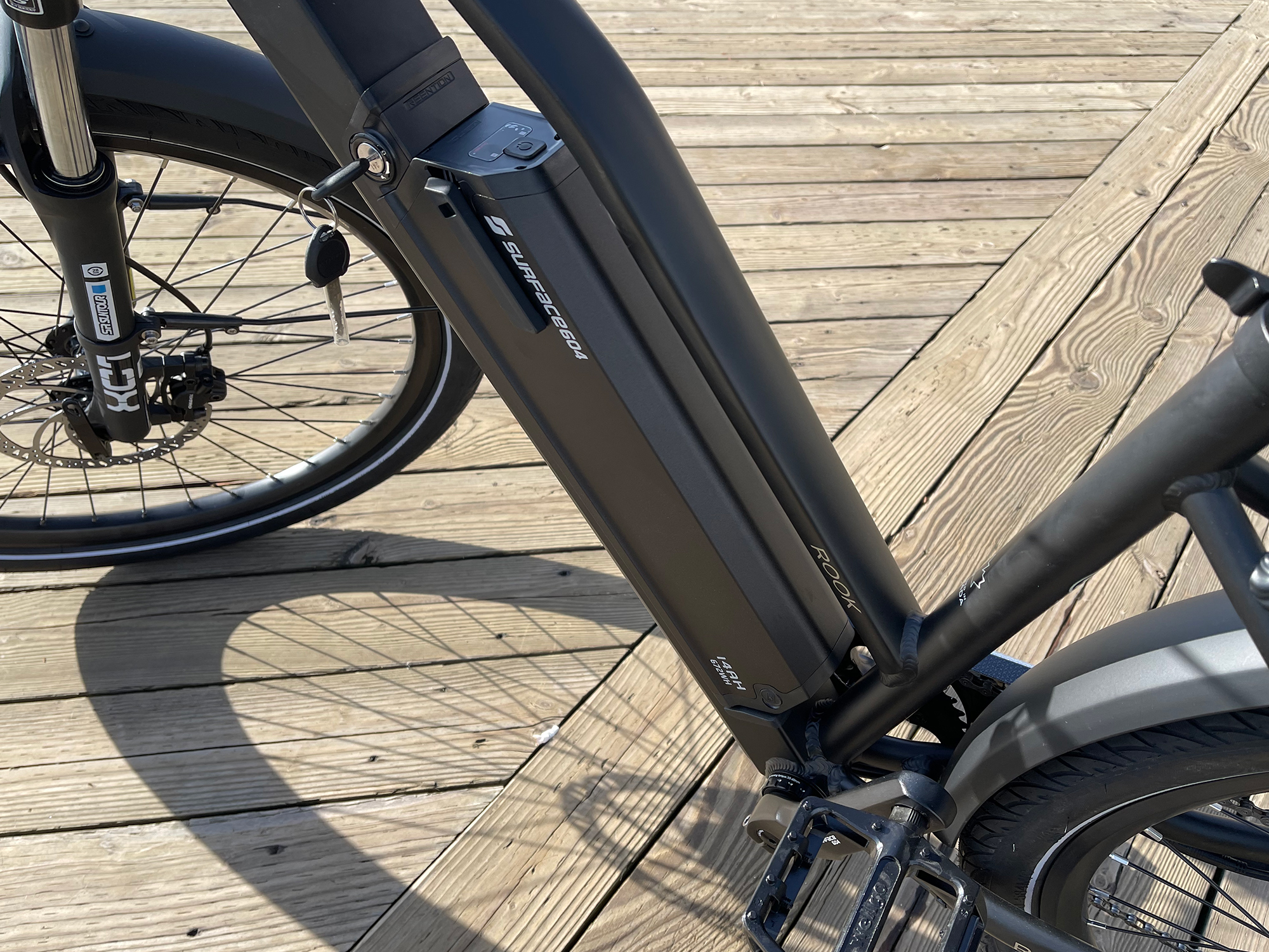

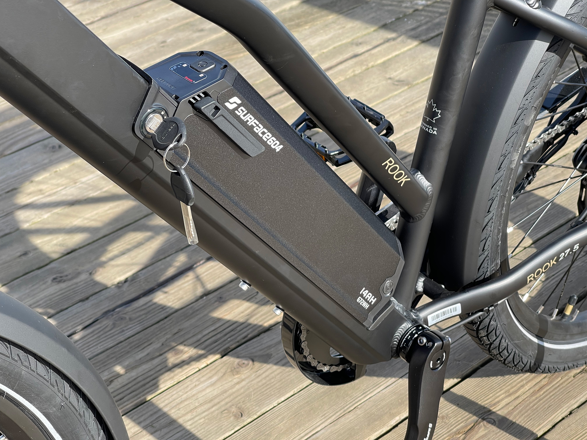

- I love that the company offers two battery pack sizes! The standard 672 watt hour is already above average, in terms of capacity. If you want to go even higher, the 960 watt hour pack is a great option and only adds a few pounds. Both packs also have USB ports built into the right side, so you can use them as spare power banks when off the bike!
- My understanding is that many of the Surface 604 bikes now use the same Reention Dorado battery interface, so the pack can be shared between friends or family members! This is a more open battery standard, which means you can have the batteries repacked or purchase them from generic suppliers someday if S604 changes their design or stops selling them.

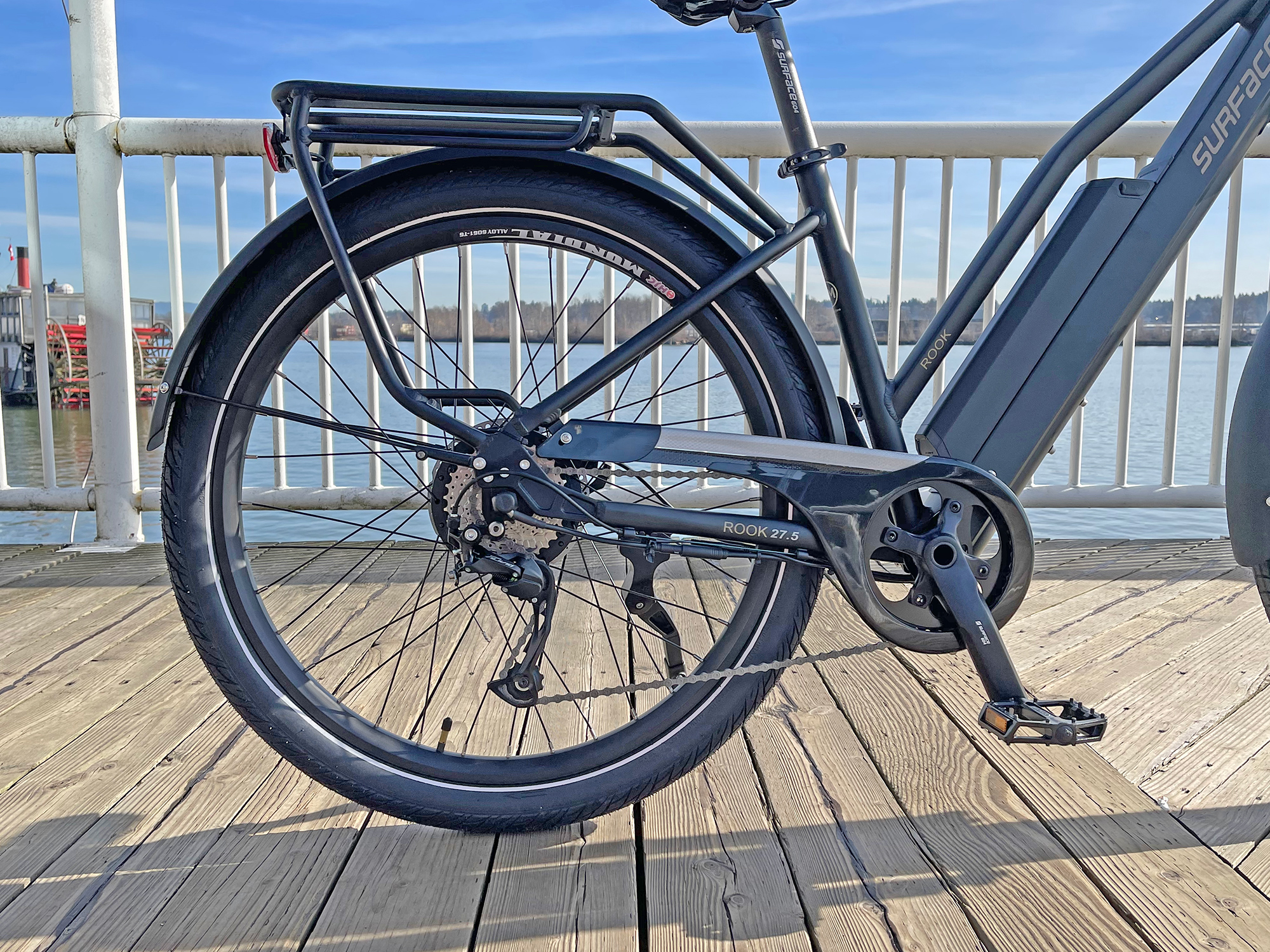

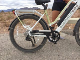

- In addition to the full length fenders, this ebike also comes with a plastic chain cover to keep your right pant leg or dress end from getting greasy and snagged on the chain and chainring. The cover has a reflective section as well, which adds to the visual footprint created by the reflective tires and side-visible lights.

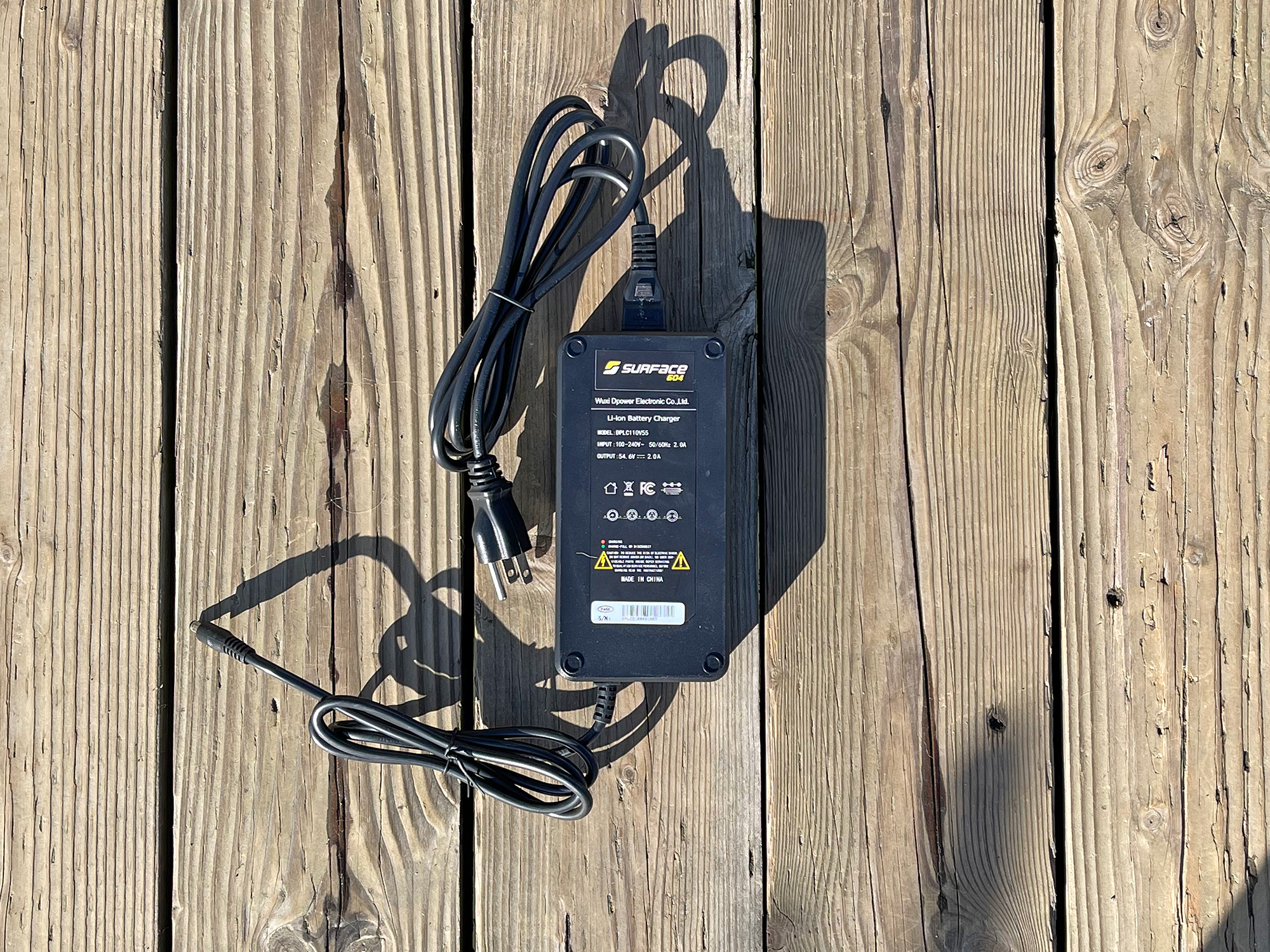

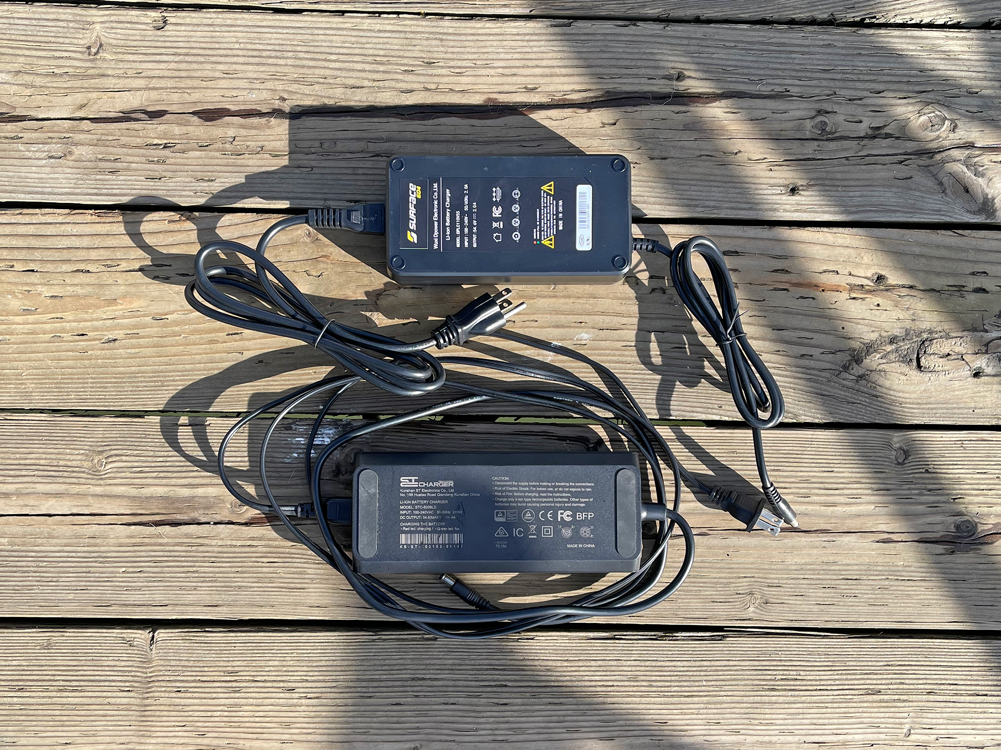

- The charger for this ebike is pretty basic, though I do appreciate the branding they did. It’s fairly compact, has a removable wall-side cord to reduce length, and it only weighs ~1.4lbs, but it only puts out 2 amps. Thankfully, they do sell an optional 4 amp fast charger now that is ideal if you get the high capacity 960wh battery pack… they just cost extra.
- I appreciate how battery weight is kept low and center on the frame, and partially integrated into the downtube, but I noticed that the upgraded pack spills out on the left side and is not symmetrical. Functionally, the bike still handles well and I didn’t bump my leg or anything, it just looks a bit odd.
- The charging port on the default sized 672wh battery pack is positioned low on the left side of the frame, directly in the path of the left crank arm. This could cause the cord to get snagged or cracked if the crank arms turn while the bike is plugged in. If you pay more for the larger upgraded 960wh pack, the charging port is up high near the battery lock core. Ideally, both the lock and charging port would be up high and on the right side of the bike to be less vulnerable and easier to reach.

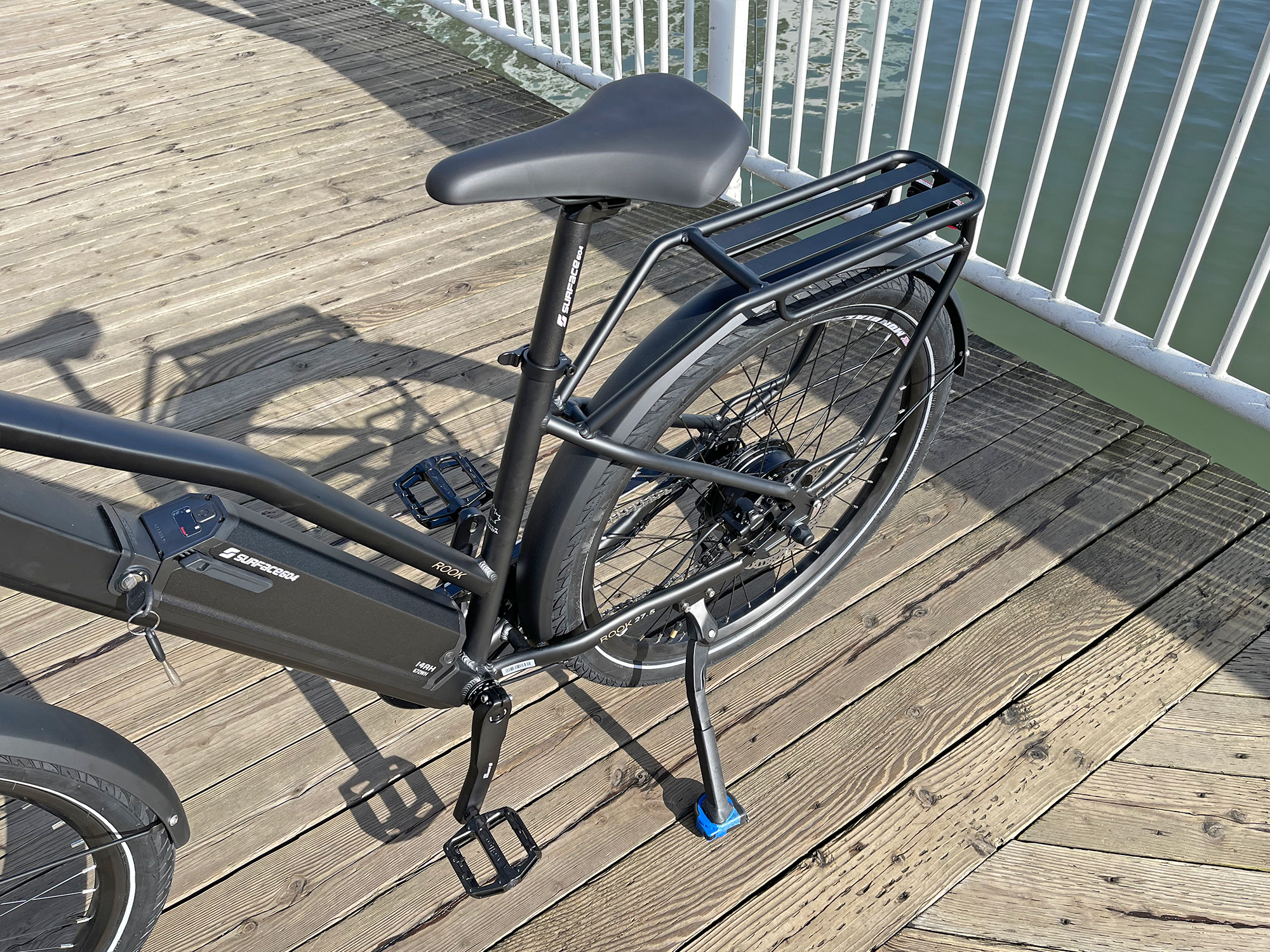

- The rear rack is welded to the frame, which means it cannot be removed and adds weight to the overall build. The upside is that it won’t rattle loose over time, it’s color matched and has the pannier hangers, bungee loops, and flat slats on top, and is rated to 50lbs (22.6kg). This rack would probably work well with child seats like the Thule Yepp Nexxt Maxi, and is a sturdy mounting point for the included rear light.

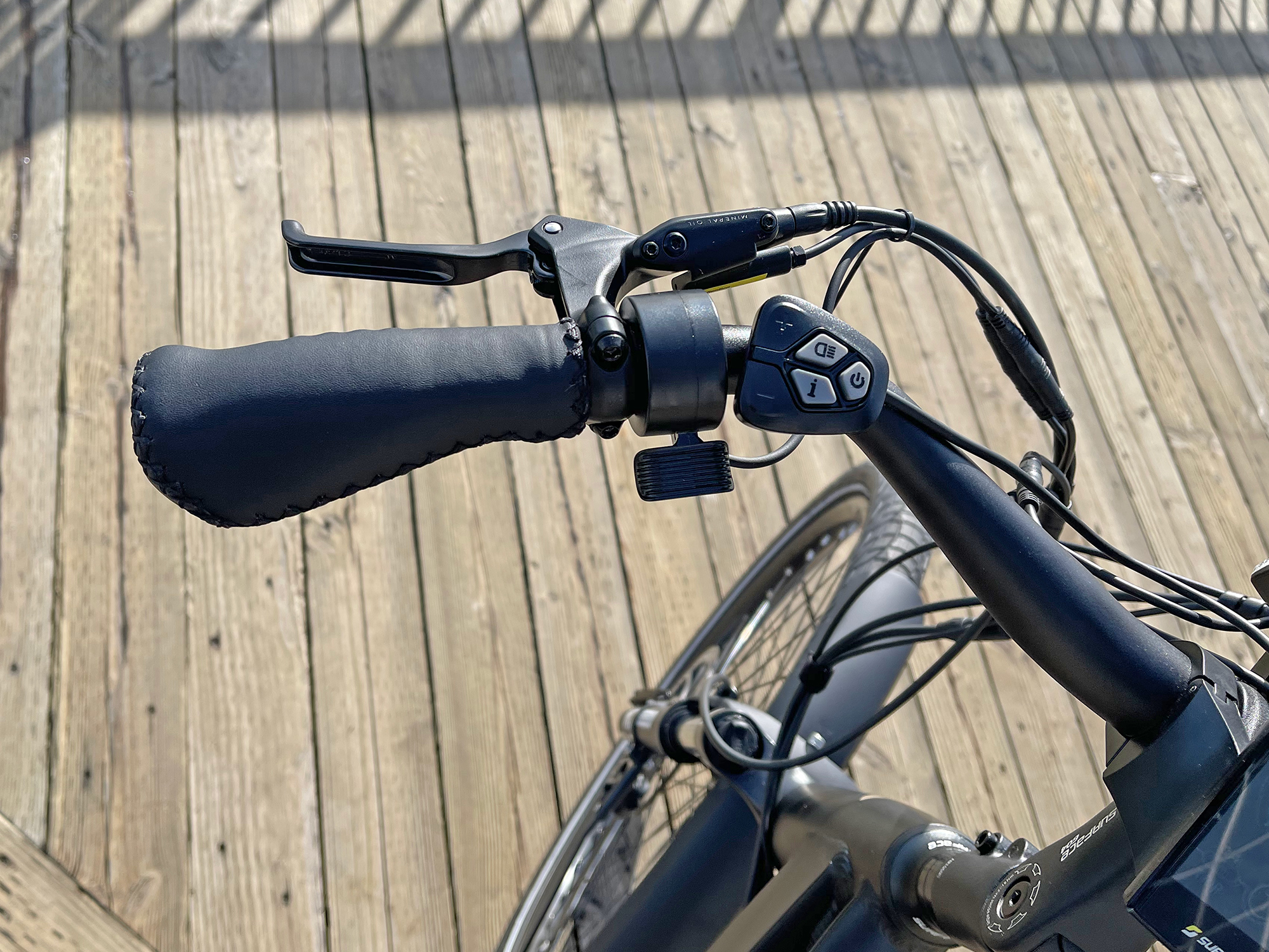

- The ergonomic grips are not locking, which means that if you bear down on them you can twist them forward and back (or even slip them off the ends if you really go for it). Fortunately, the relaxed position of the riser stem and handlebar mean that you won’t be bearing down on the grips the way you might with a mountain bike. Grips are pretty affordable to upgrade if you want locking, consider the Ergon GP1 for example.
- I was surprised to see that there was no slap guard sticker on the right chain stay. This is a minor annoyance, but it does mean that the paint could get chipped off if the chain is bouncing up and down a lot while riding off-road. Consider using piece of clear box tape or aftermarket velcro slap guard like this if you plan to ride fast and on bumpy terrain.

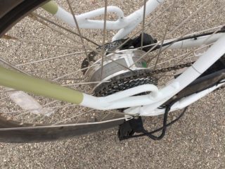

- The rear derailleur and motor power cable are not protected by a derailleur guard, which mean that they could get bent during shipping or if the bike tips over to the right. just be careful not to snag the wires, and consider using extra zip ties if your cable protrudes a lot. The demo bikes I rode had the cables pretty close to the frame so it didn’t seem like a major concern.
- One drawback to torque sensing pedal assist is that the controller may think you’re pedaling when it’s really just the chain bouncing around. The strain plate (mounted on the inside of the right chain stay) can also be more sensitive to over-tightening the rear bolt and doing wheel maintenance. I guess it’s the trade-off for a more responsive system compared to a standard cadence sensor.
- Hub motors are zippy, work well with throttles, aren’t as hard on the drivetrain, and cost less than mid-drives, but usually do not allow for quick release axles (which is the case here) so only the front wheel has that feature. It just adds time and requires tools to work on the rear wheel and motor. Also, given the high power of this motor and no torque arm system, be sure that the rear bolts stay tight so the axle doesn’t rock back and forth and chew into the aluminum alloy frame.

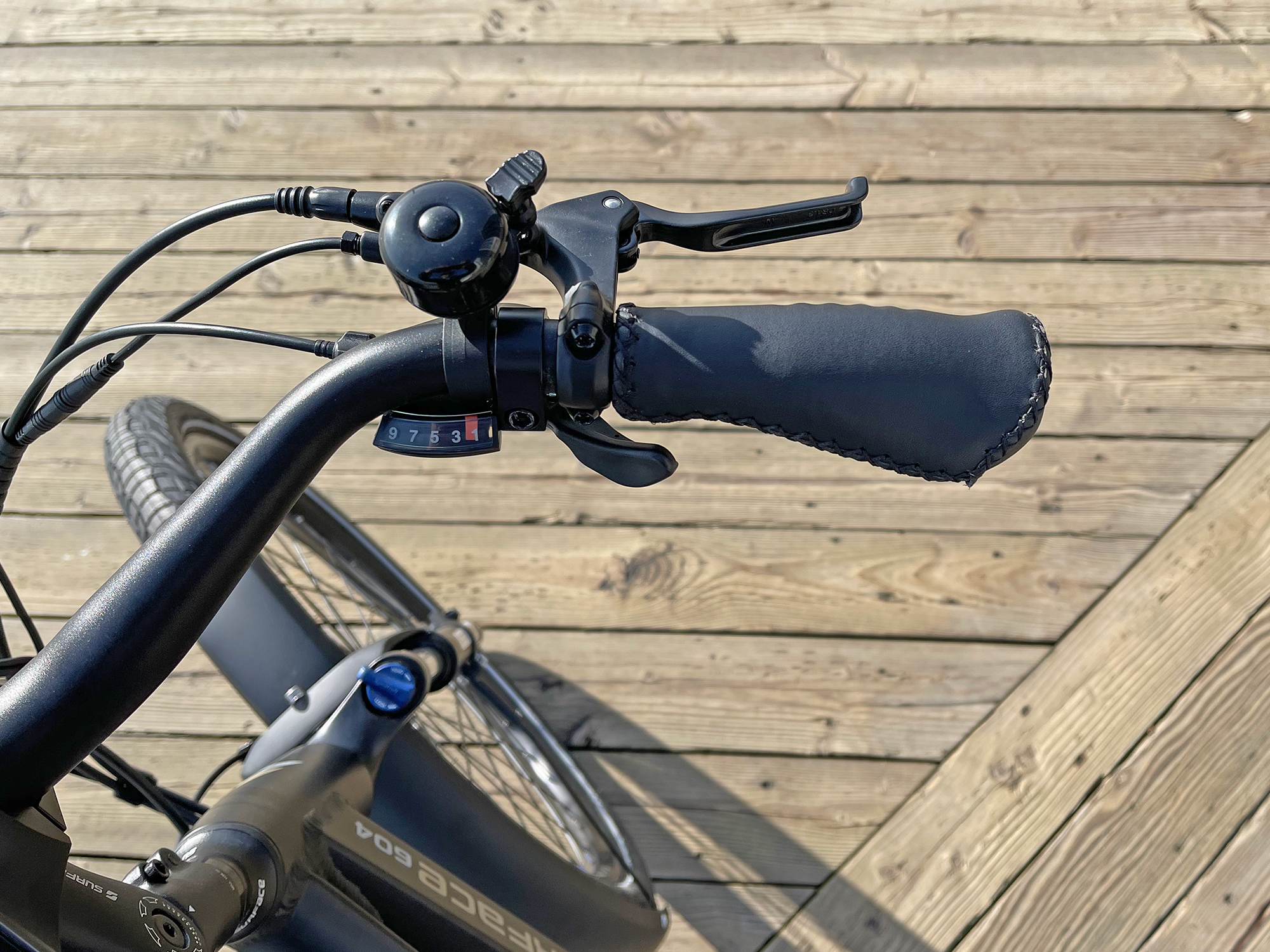

- The trigger shifter has a multi-shift low lever, but the high lever is just one way, so you have to use your pointer finger. I like the upgraded shifters that allow for high and low shifting using your thumb, because this allows the pointer finger to stay on the brake lever if you wish.
- I like how wide the metal fenders are, and they didn’t rattle much when going off the curb or down the steps… but the front fender is connected to the lowers of the suspension fork with plastic cuffs vs. threaded eyelets. It’s just a bit less sturdy and clean, but the stays don’t stick out on the back, so it’s a decent solution.

I’m a bit confused by the battery case spec. Is the basic battery a Reention Dorado?
Court says
Yes, I believe it is a Reention Dorado battery pack. Perhaps you could confirm this with Surface 604, but that’s my best guess ;)
