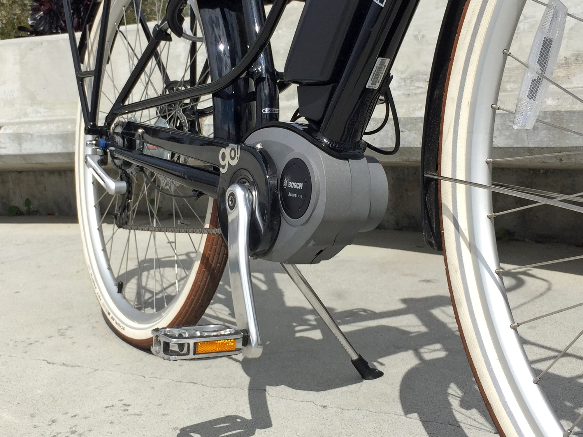

Driving this bike is a first generation Bosch Active Line Cruise motor. It’s one of the primary differences between the Loft Go! 8i and Townie Commute Go! 8i, and will almost certainly be replaced in future generations. Bosch split this single motor option into two smaller, lighter, quieter, and more efficient motors in 2018… but there’s still value in the old design. The chainring is smaller, and spins 2.5 revolutions for each crank revolution (because of a reduction gearing design inside). The smaller chainring is extremely responsive, provides great chain retention, and allows for a smaller chain cover. This drive unit offers up to 50 Newton meters of torque, whereas the newer generation can be 40 Nm or 50 Nm depending on the model, and this one offers 105 RPM pedal support, slightly faster than the 100 RPM on current generation. You should be able to expect the same great support and warranty coverage from Bosch, this motor relies on most of the same hardware that the Performance Line motors all use… and they can be found on hundreds of different electric bike models from many brands, all around the world. The big consideration here is whether a little bit more noise, and a tiny bit of pedal drag is a deal killer for you. All of the current generation Electra models use the reduction gearing smaller chainring setup, but some other brands have switched over to the smaller Active Line motors, which could save you a pound of weight. Maybe that was way too technical, I just want to highlight what makes this bike so special. The motor controller is measuring rear wheel speed, pedal cadence, and pedal torque, 1,000+ times per second and offers shift detection, to protect the gearing. With the Shimano Nexus eight speed internally geared hub, you can shift gears at standstill and not have to worry about damaging the chain or sprockets. There’s no derailleur, just a sturdy chain tensioner, so the bike won’t take damage as easily if tipped onto the right side. The one, possibly alarming, characteristic about this gearing setup is that it may click repeatedly if you shift under heavy load. This includes climbing hills or simply pedaling hard. The internally geared hub has a self-protection feature that keeps it from shifting until the load is reduced. So in summary, both the motor and IGH are designed to be durable and should last a very long time. The chain will probably never fall off and the chain cover will keep your pants or skirt from getting greasy and snagged.

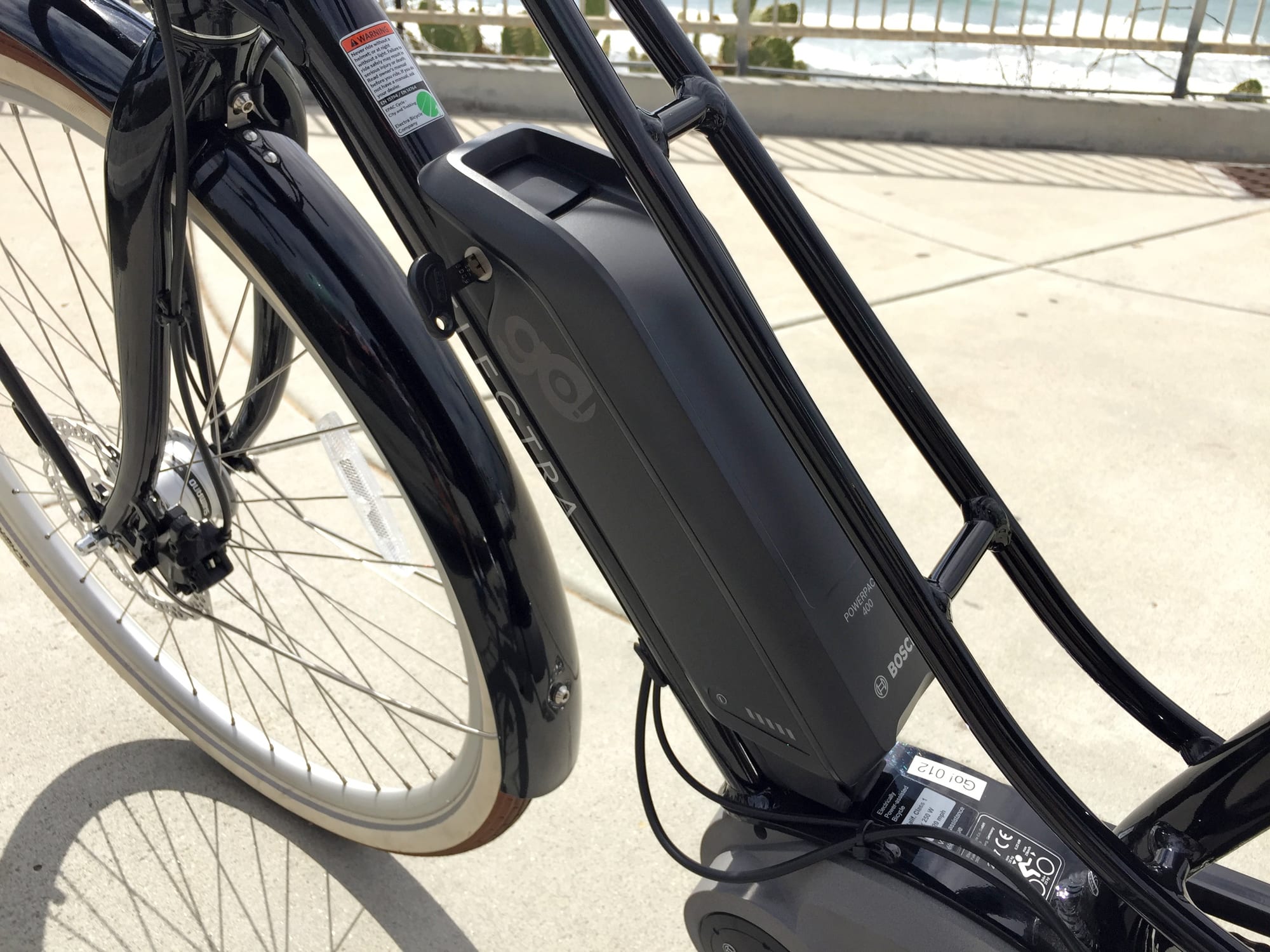

Powering the Loft Go! 8i is a modest Bosch Powerpack 400. It’s less expensive and less heavy than the newest Bosch Powerpack 500 (which offers more juice), but with the power-sipping Active Line motor, it does great. The neat thing about all of the current generation Bosch Powerpacks is that they are built into the same casing design. This means, you could always upgrade to a Powerpack 500, and have it work with the same bike. I really appreciate that this pack has an integrated plastic handle-loop at the top, because it may prevent drops. High capacity Lithium-ion batteries like this are expensive and this one weighs ~5.5 lbs. It seats down into the dock on the downtube of the bike, and there isn’t much room between the top of the pack and the double top-tub frame. I found that it was a bit tight and tricky mounting and dismounting the pack… really be sure to push down and hear it click into place before riding off, a replacement could be ~$800 all by itself. You can leave the pack locked to the bike if you want, it can be charged there pretty easily because there’s a plug near the lower portion that uses the exact same charging interface plug design as the battery itself, when taken off the bike. I appreciate how Bosch has simplified their chargers, and you get the lighter Compact Charger with the Electra Loft Go! 8i, possibly another cost saving measure. This charger puts out 2 Amps vs. 4 Amps on the full sized charger, but with the smaller battery capacity, it’s not a huge deal. I showcased the neat trunk bag in this video review, and was delighted to see that the charger, a chain lock, and two cup holder mounts, all fit easily. The cup holders are a nice accessory to consider because the bike doesn’t come with bottle cage bosses. I like how Electra’s branded accessories all match and that the bag has hidden handle straps and a neat click-in design. I got to meet the CEO of the company while visiting their headquarters, and he explained that this is really a lifestyle company. You can see that in their designs, but are also benefitting from the massive supply chain and dealer reach of their parent company, Trek (the second largest bicycle brand manufacturer in the world after Giant and before Specialized). The battery pack also has a 5-LED light on the left side that will illuminate to show charge level… and this mirrors the display interface.

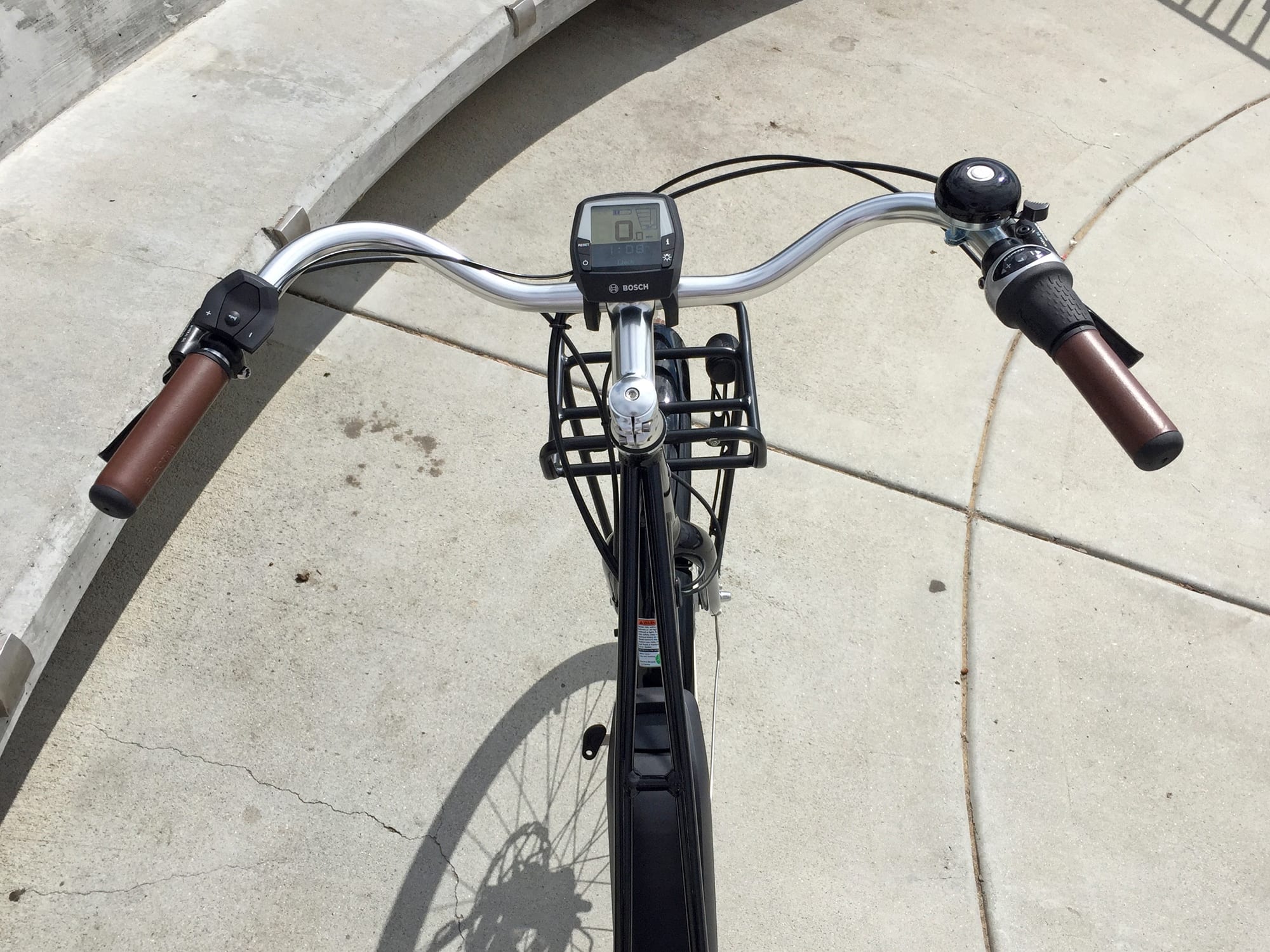

Powering on and interacting with all of the Electra e-bikes is a snap because they use the Bosch Intuvia display panel, my personal favorite in the whole industry! This thing is big and easy to read, it swivels to reduce glare, and it can even be removed. There’s a Micro-USB charging port built into the right edge, so you can plug your smartphone, GPS, speakers, or additional lights in for charging on the go. The display does have its own internal battery that may eventually run out, so be sure to check that first if your display ever seems like its broken (the dealers can help you here, which is nice). Once the battery has been clicked into the frame mount, just press the power key on the lower left area of the display. The monochrome LCD screen blinks to life, showing your 5-bar batter level (representing 20% steps), current speed, assist level (Off, Eco, Tour, Sport, Turbo), a little power meter (indicating how hard the motor is working), and a bunch of trip stats down below. You can raise or lower assist levels by pressing the + and – keys on the remote button pad, mounted near the left grip. I like that you can simply pedal this bike on human power but still run the lights by turning the display on and pressing the light button on the lower right area of the display. Note that the display itself produces a faint blue glow at all times, it will not turn off if you de-activate the lights, which could be a little distracting on a moonlight ride where maybe you want to be completely dark and focus on your surroundings. I believe you can adjust the brightness to a degree, along with the mph vs. km/h units and language by entering the settings area: hold the reset and i keys to get into this. The i key is very useful, and that’s why it exists both on the display panel and the remote button pad. When you click it, the lower menus change from trip distance to odometer, average speed, max speed, clock, and range. This range menu is very cool, because it’s dynamic. Based on your battery level, the last mile of riding, and the level of assist in use, the bike can estimate pretty accurately how far it thinks you can go. This is way more useful than the five bars on the battery infographic, and unique to the higher-end electric bikes. This, the reliable motor, internally geared hub, stylish design and safety features, paired with the warranty and dealer network is what makes the bike cost more than some competitors.

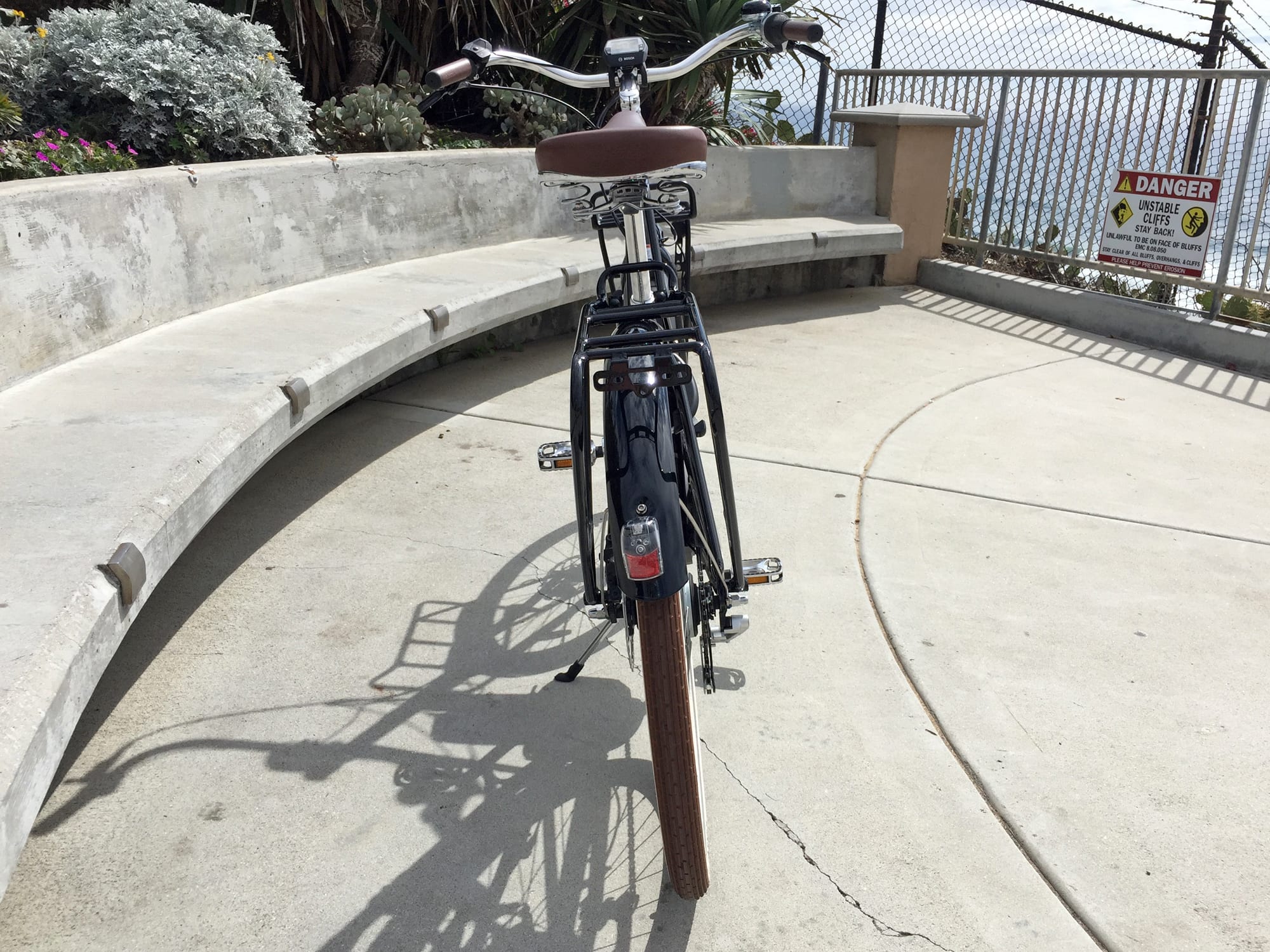

- The rear rack is awesome because it can hold up to 55 lbs, uses standard gauge tubing that’s compatible with most clip-on pannier bags, has a lower loop for use with bungee cords, and is positioned far back enough that the saddle can go all the way down!

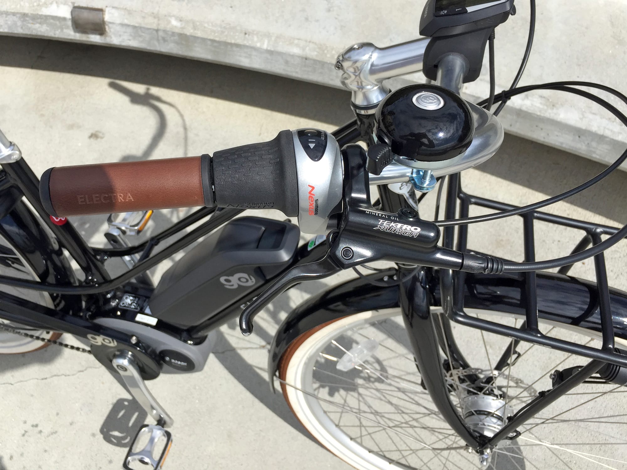

- Some of the other Electra ebike models use band brakes, but the Loft Go! uses nice hydraulic disc brakes with a larger 180 mm front rotor for faster stops and easier brake lever operation (you don’t have to pull as hard and can even adjust the reach of the levers for smaller hands or if you wear gloves)

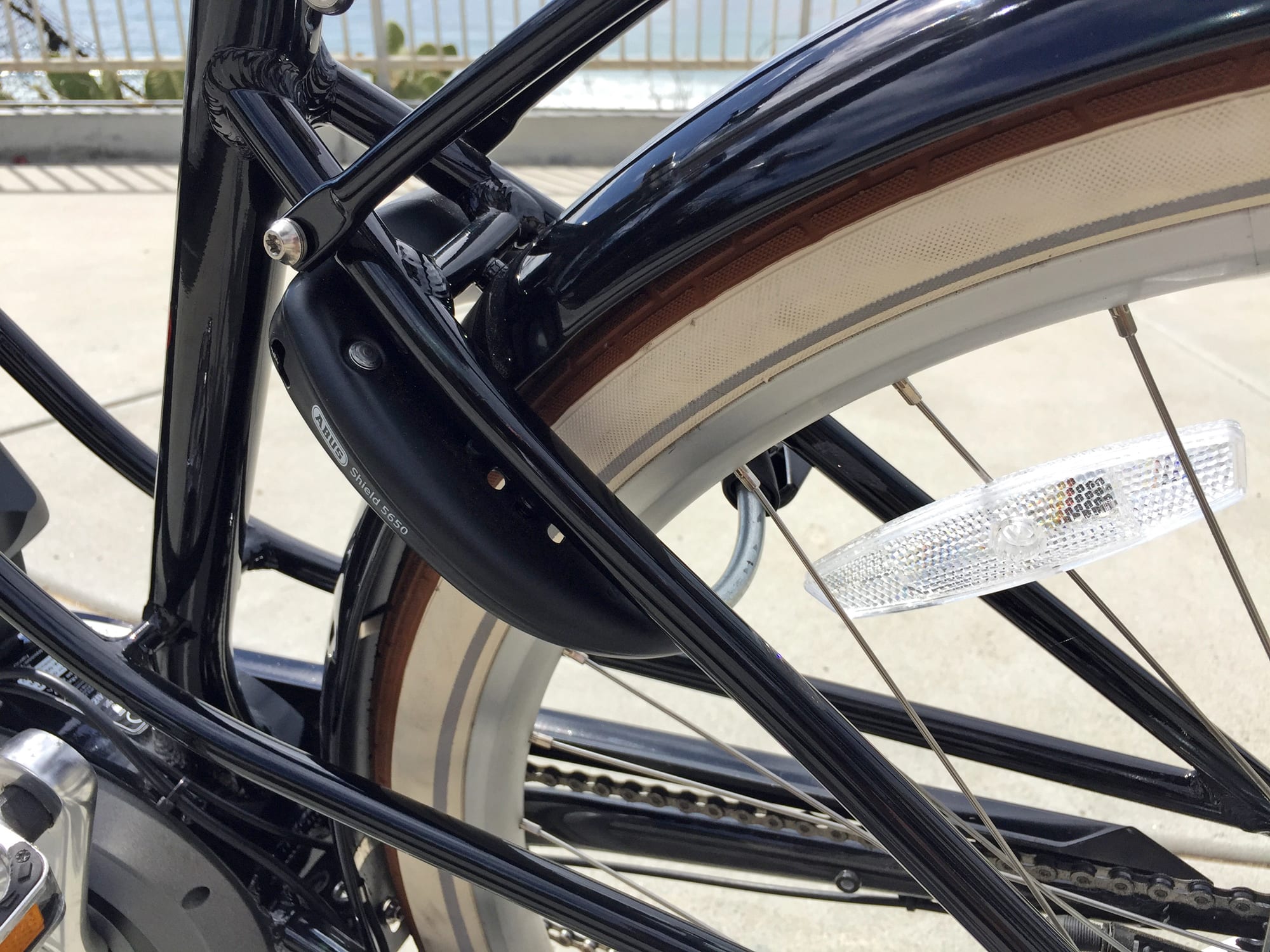

- The bike comes with a cafe lock (also called a frame lock) that disables the rear wheel, it’s useful for quick stops since the bike cannot be ridden away and would be difficult to lift at ~58.3 lbs, I especially like that this cafe lock uses the same key as the battery and that Electra sells an optional $40 chain that connects so you can actually fix the bike to a pole or rack, note that both wheels are secured with nuts vs. quick release (making them difficult to steal) but the seat post collar is QR, so consider a locking collar or security hardware to protect the nice saddle if you park in a rough area sometimes

- You can shift gears even when the bike is stopped, the internally geared eight speed hub stays cleaner than a cassette, won’t get damaged as easily if the bike tips, and should reduce chain drops (because there’s only one rear sprocket), but it does weigh a bit more

- I love the Bosch Intuvia display panel because it’s large, removable (to keep safe if you park at a rack in the city), and has a built-in Micro-USB port for maintaining a phone or other portable electronic device on the go, I have found that the button pad for this display is also very easy to press and to use without looking down because of how it’s laid out

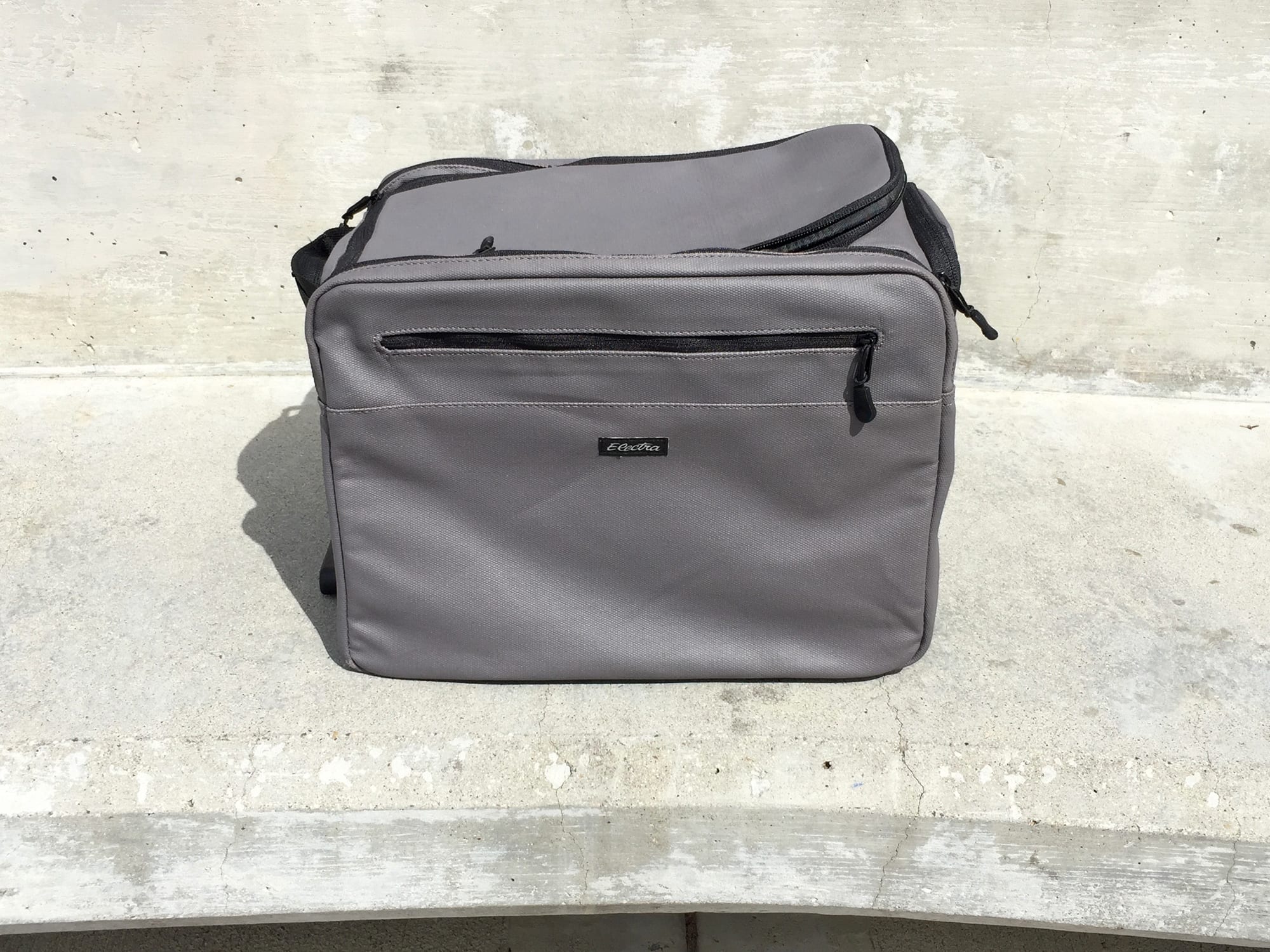

- Electra has a really cool trunk bag accessory (called the Commuter Rear Rack Bag) that just clips right into the rear rack, it’s way more convenient than bags with velcro straps and I like how it’s water resistant and has two handle straps that are hidden but make it easy to carry, there’s a front bag option too, and just a lot of cool accessories at their website

- The Loft Go! 8i that I reviewed was using the older Bosch Active Line motor which has a reduction gear, so the chainring will spin 2.5x for each pedal revolution and that produces a bit more noise and drag than the newer models, it’s still a great system but it weighs a bit more (but also gives you a bit more power)

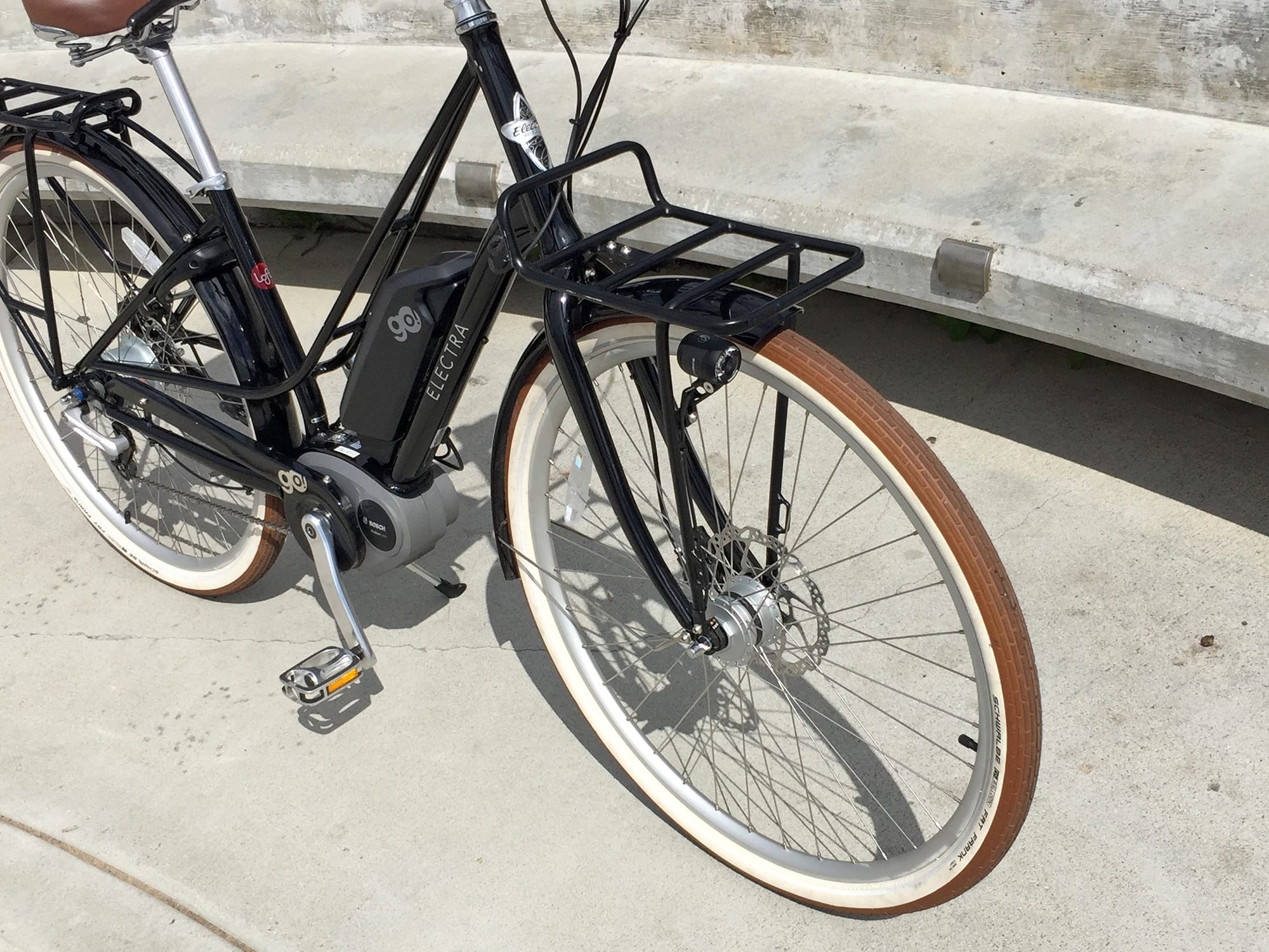

- The front rack is stylish but fixed to the for, so it turns as you steer the bike and can add weight and slow your steering down a bit, it may also dump to the side when you park, a more balanced design would be a steering-tube mounted rack that always straight
- Probably in order to keep the price down, Electra opted for the smaller Bosch Powerpack 400 vs. the newer 500, energy is used efficiently by the Active Line motor, and this pack weighs less, the good news is that the interface also accepts the Powerpack 500 if you want to upgrade someday or already have that pack (or rent one while traveling)

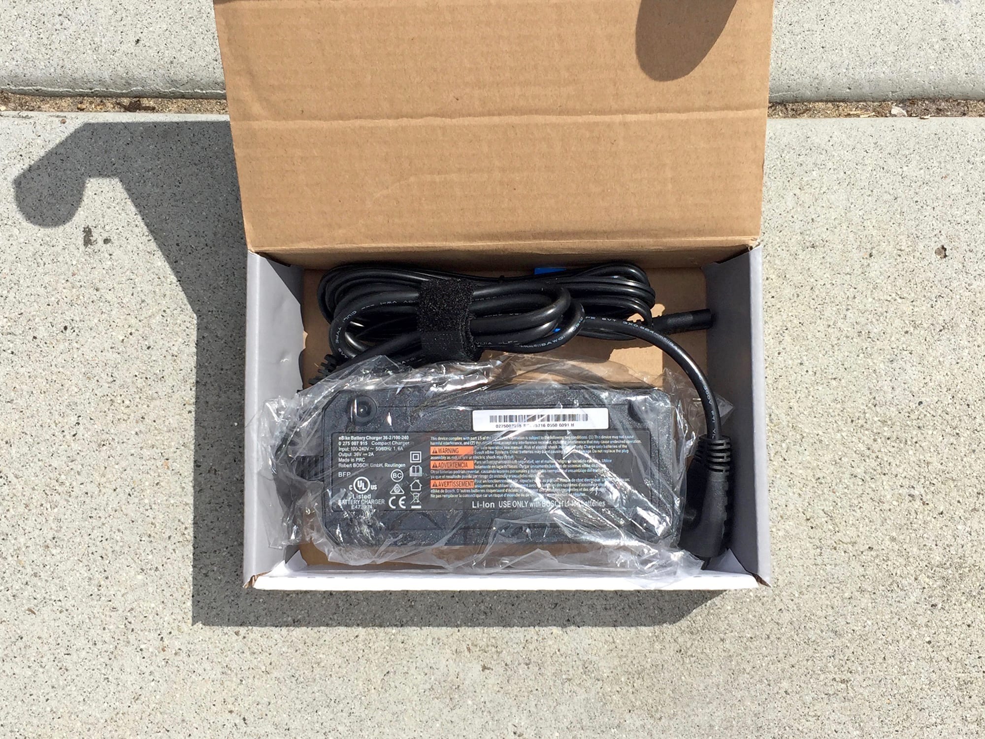

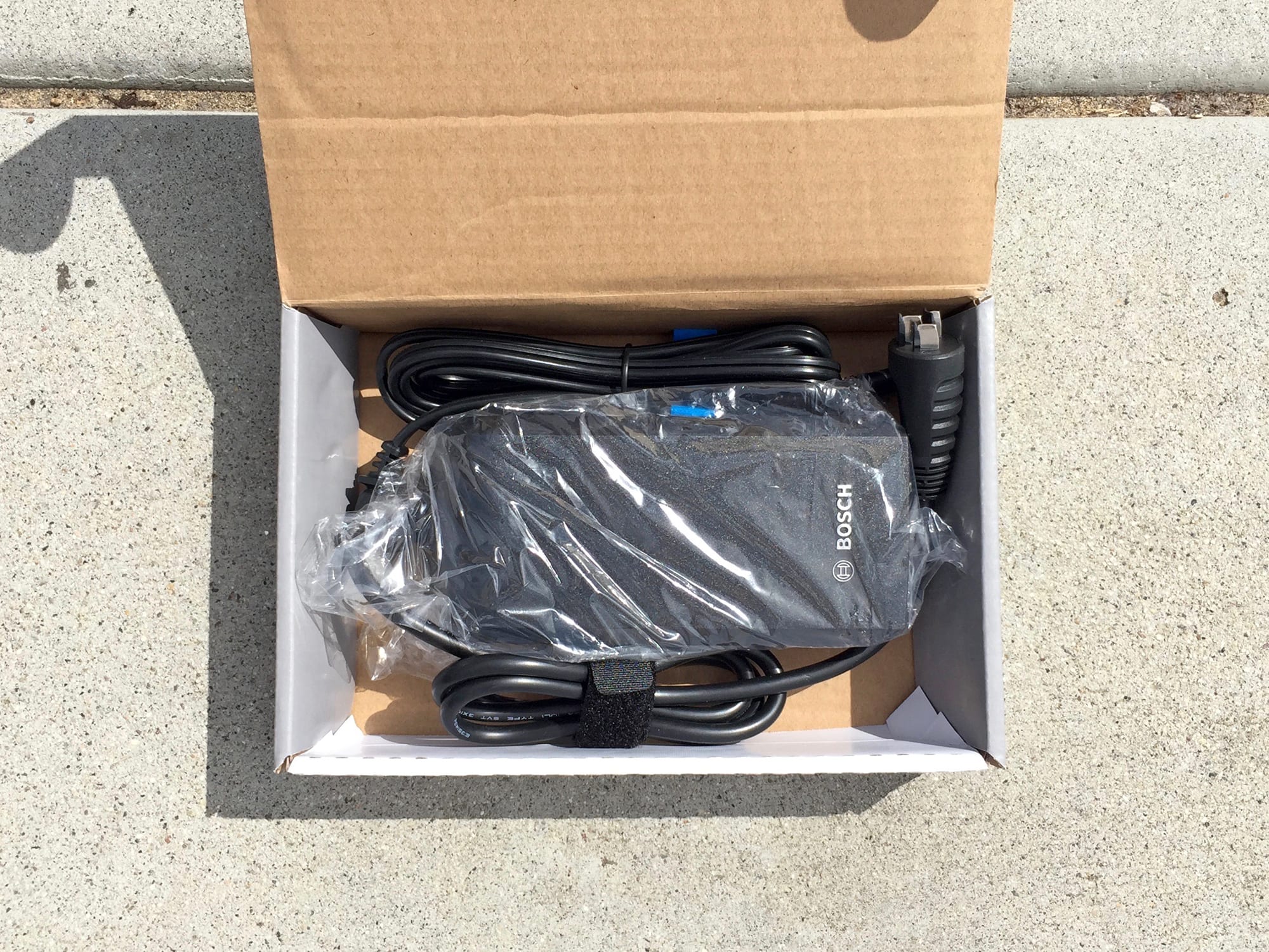

- Minor gripe, because the bike comes with a smaller battery pack and probably also to save money and space, they decided to include the compact 2 Amp charger instead of the faster 4 Amp charger, the good news is that most electric bikes only use a 2 Amp and it still fills within five hours or so if completely empty
- Once the key has been inserted into the ABUS Shield 5650 cafe lock, you can’t pull it back out unless the lock has been activated… it’s a neat way to keep the key from getting lost (and remind you to lock the bike) but if you have a keychain connected to the key, that could dangle around and make noise or get snagged more easily, maybe a small carabiner could be a good solution

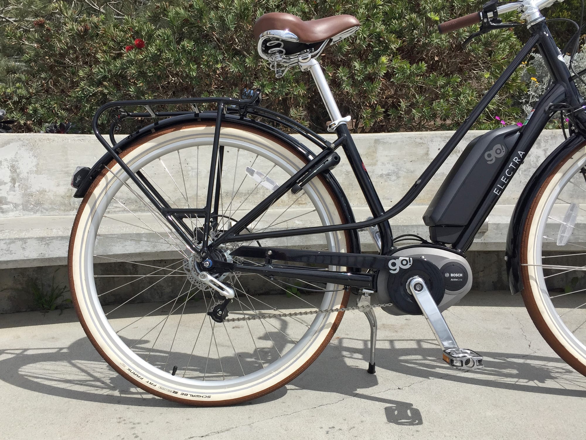

jeff robinson says

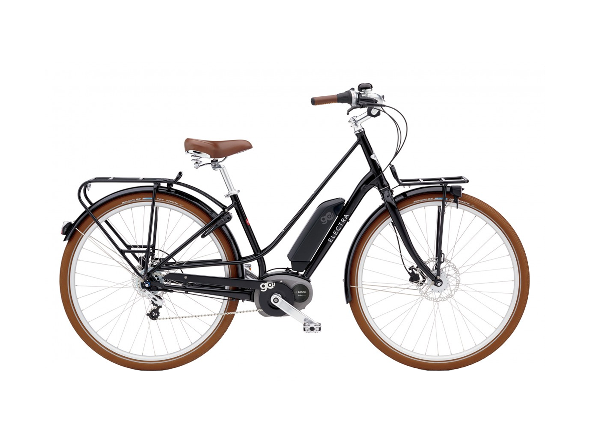

Your review of the Loft describes an internally geared rear hub, but the photo shows a derailleur. Is it an out of date stock picture?
court says
Great question, Jeff! That’s actually a chain tensioner, it allows the frame to use a more traditional vertical dropout vs. a horizontal dropout. It might make servicing the bike a little easier and means that Electra can reuse this frame with a cassette and derailleur if they want. There may be other reasons as well… but yeah, it’s not a derailleur. You can scroll through the photos I took and see the internally geared hub there along with the tensioner up close. I hope this helps :D
