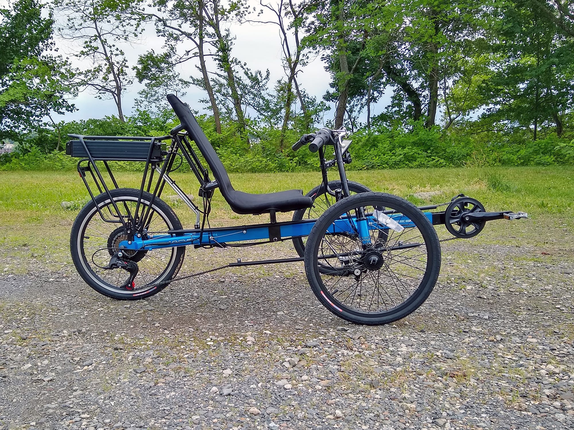

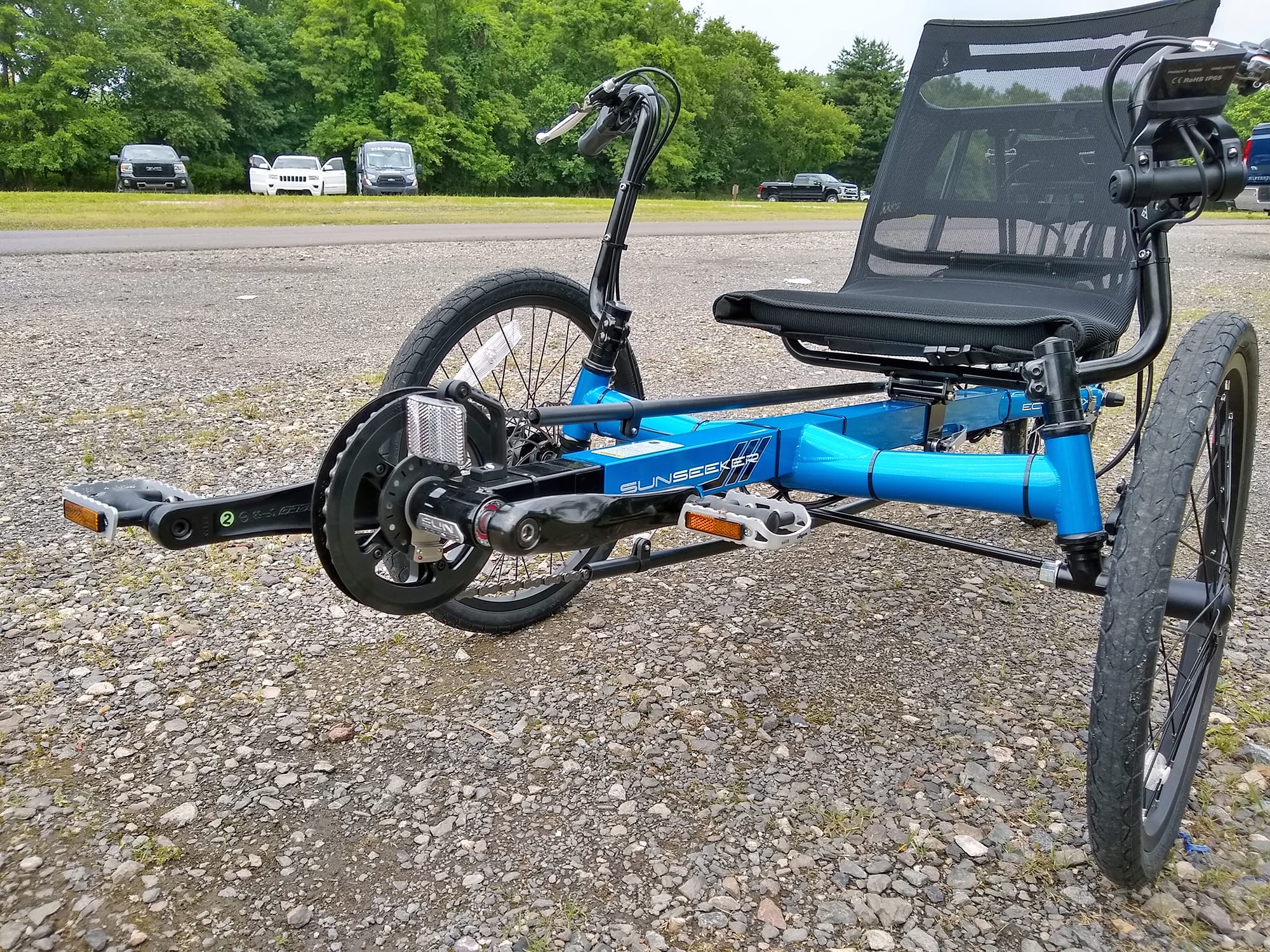

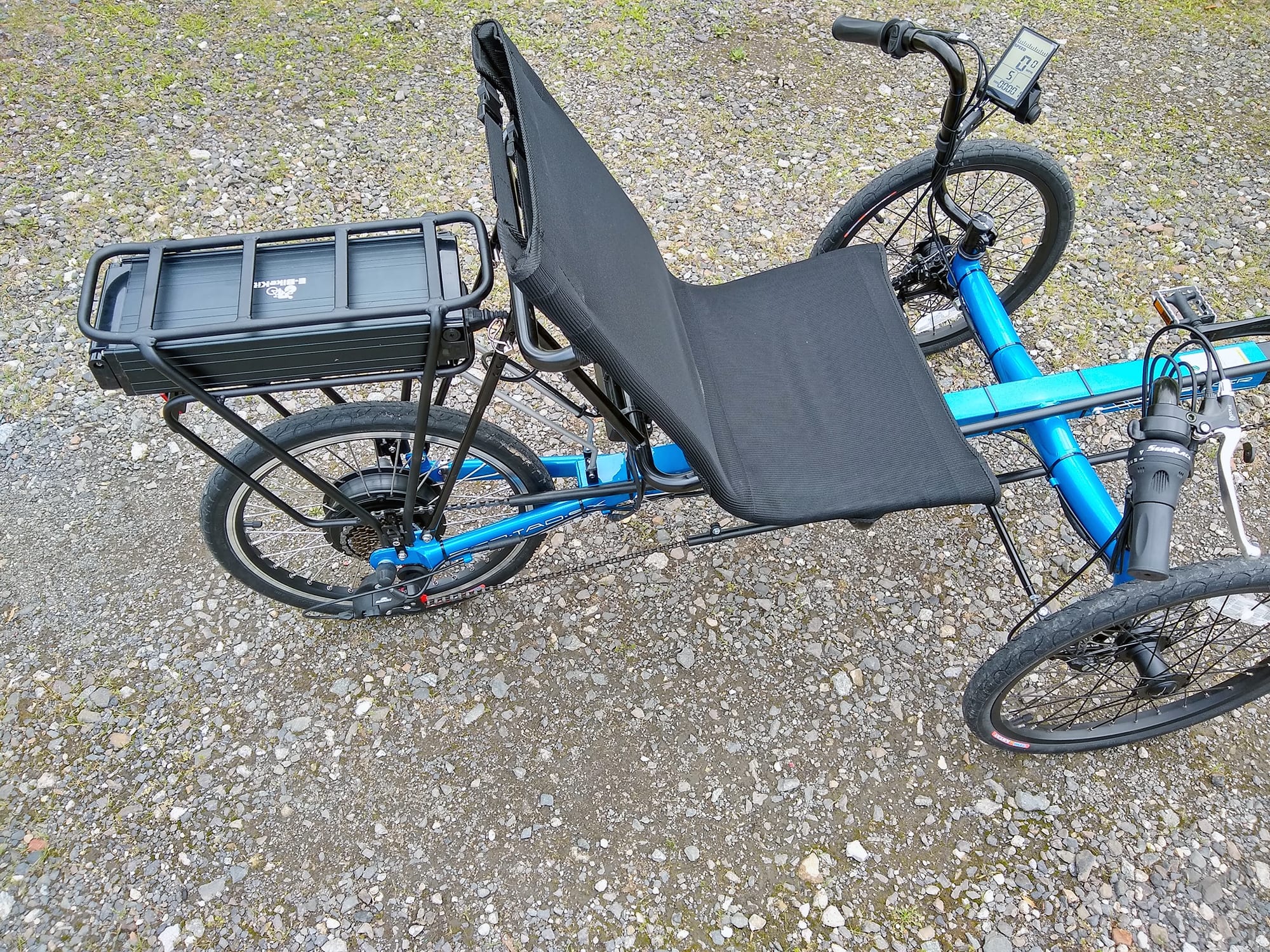

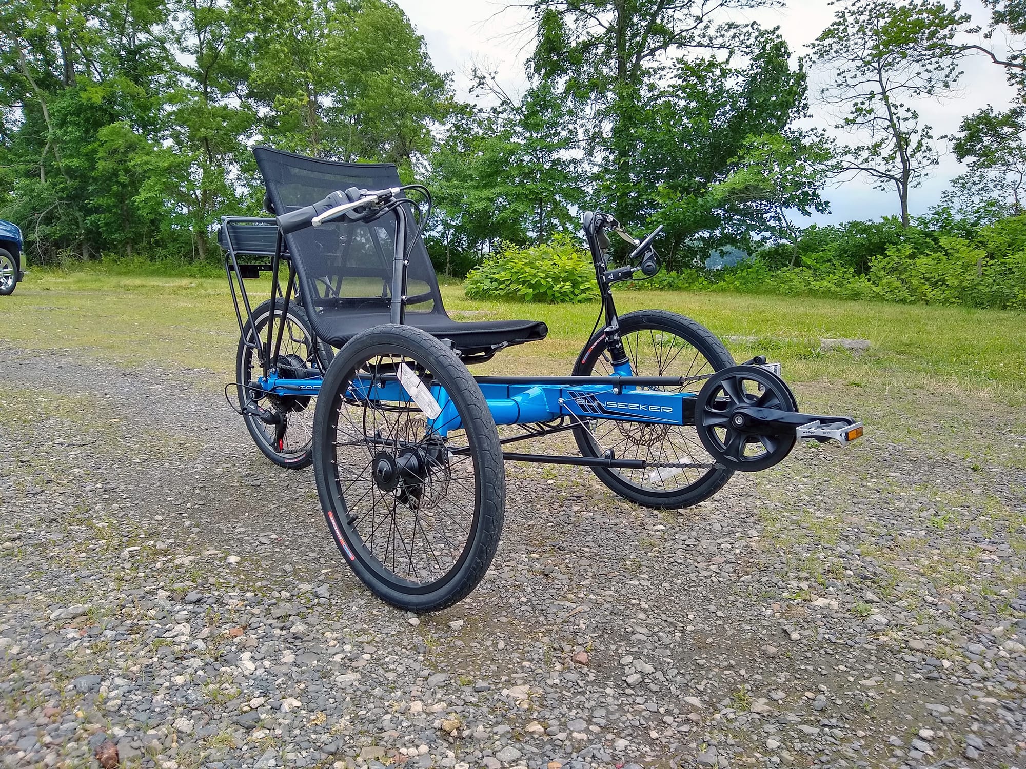

Electric Bike Technologies has definitely become a leader in trikes thanks to products like the Eco Delta and Liberty Trike. Today we are looking at the Eco Tad Trike, a tadpole style trike made with stability and value in mind. Right off the bat, you will notice the efficient tires. These are a 20” x 1.5” Kenda Kwest set that do great on the road and get that stand-over height nice and low at 15”. The trike is kind of stripped down to save money, but you still get a lot of comfort with the steel frame… this combined with the recumbent style seating means more pedal torque and power from the rider as well. The trike is very easy to mount with its recumbent design and even keeps the handle bars within easy grasp since they are mounted up in front. It is quite an impressive design with an overall focus of adjustability, comfort, and reliability. As I just mentioned, the handlebars are uniquely mounted, they sit independently from each other on separate head stems, but this allows the rider to get on and off very easy and positions them for this seating that thankfully resembles more of a lawn chair than a narrow bicycle seat. As a matter of fact, I love the laid back seating position… this makes it low impact on the joints, gives it great balance, and is very approachable, especially for people with physical considerations. Once seated the you can see the display on your left and throttle on the right. The seat here is very comfortable… it features mesh backing with a lot of bracing and has a feel akin to that of a hammock. The seat is adjustable in reclining positions, but the real adjustment is going to be the pedal extension which is done at the ‘boom’ of the trike (the front crank arm section). I love all the other little touches here like the tubing around the chain to keep your clothing and legs clean from grease, really such a simple touch that goes a long way. There are plenty of bottle cage bosses, even some on the seat… and I have to call out this separate controller. This helps keep maintenance costs down while making battery replacement cheap and easy as well. Also, Electric Bike Technologies dials this trike in when you buy it, it can be sized up for specific customers and comes fully assembled. The version we tested has a rack that comes with the battery, another handy feature if it suits your needs.

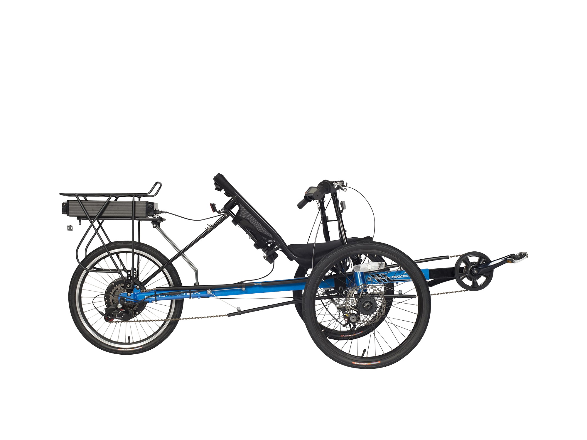

Driving the trike is a rear hub-drive 500 watt geared motor. This works great in this application and gives it a smooth handling feel, thanks to that long wheel base. You get a throttle override and 5 modes of pedal assist. The pedal assist is powered by a cadence sensor, so as you apply gentle pressure to the pedals, the electric motor will quickly jump in and take over. The top speed is 20mph out of the box, but you can configure it to go faster and Electric Bike Technologies will even help you with that. Mechanically, the trike is operated by a 7 speed system with 14-28 tooth cassette and a 38 tooth chain ring in the front. Actual shifting is done via the grip shift on the right handlebar and feels quite natural. Stopping the trike is done in the front, you get 160mm mechanical disc brakes and a motor inhibitor in the right brake handle. There is no brake in the back, but that is not needed as much with a tadpole style trike like this. I should also mention the parking brake that is included too.

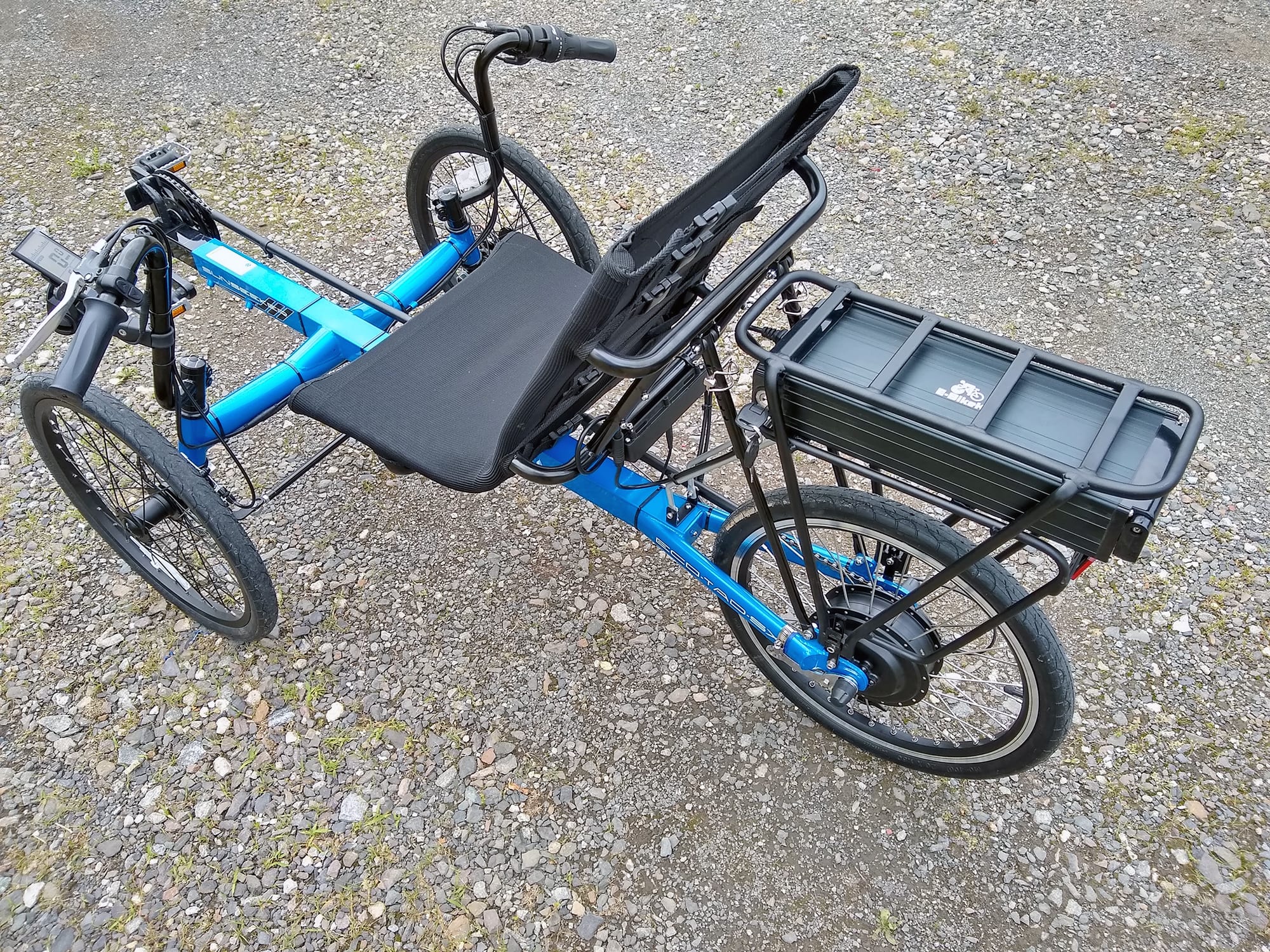

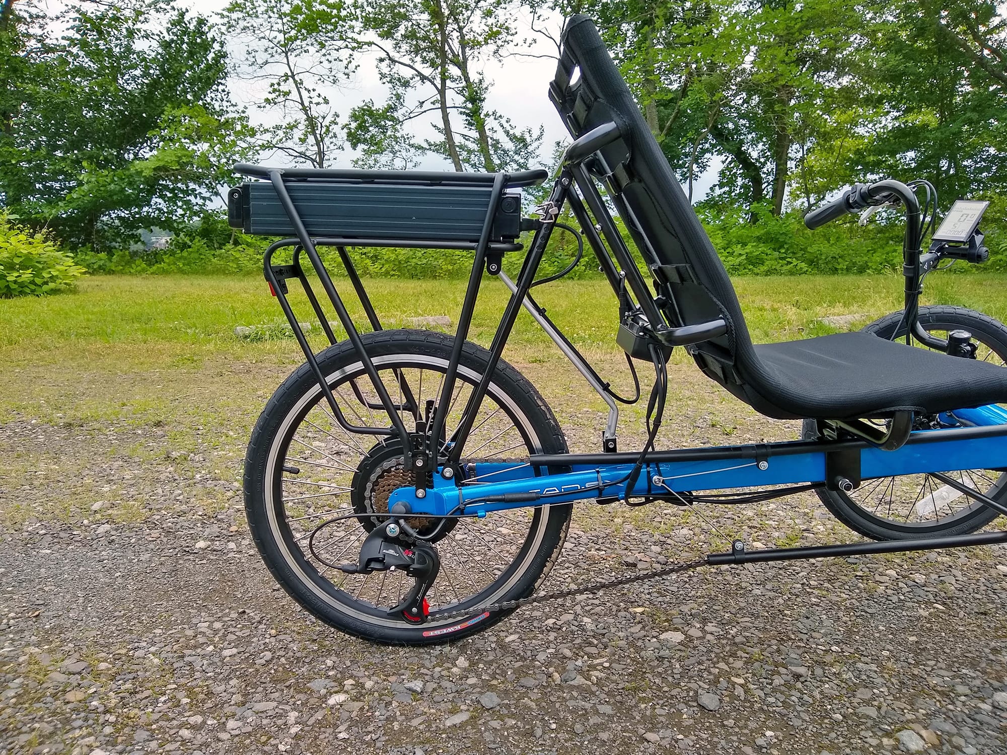

Powering the trike is a rear mounted lithium ion battery pack. As tested, we went with the 48v 10ah pack which comes in this great metal case. It is secured via lock and key and slides in and out of this rear rack housing easily. Electric Bike Technologies does offer both a 9ah version as well as a massive 20ah version on their site. The former option would be great if you want to cut overall cost on the trike while the later option will grant you more range on a single charge. It should be noted however, that the metal casing is only for the 10ah version we tested. Both the lower 8ah version and higher 20ah version come in a zipper bag rather than a metal case. To really care for this and other lithium-ion packs, I have heard that storing in a cool dry location vs. extreme heat or cold will extend the life and try to keep it about 50% full when not using for long periods so you won’t stress the cells. Try not to let it run down to zero, because that’s really hard on the cell chemistry.

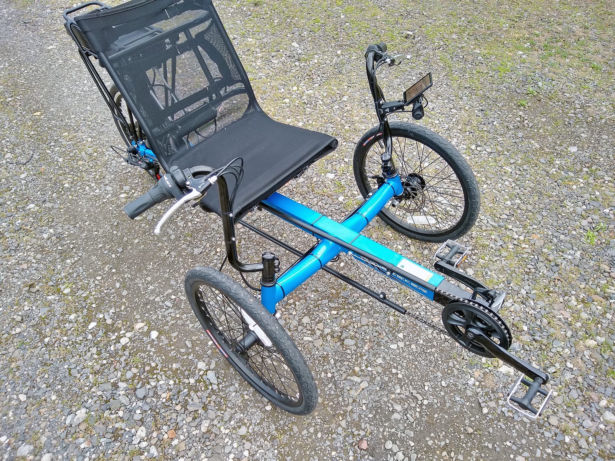

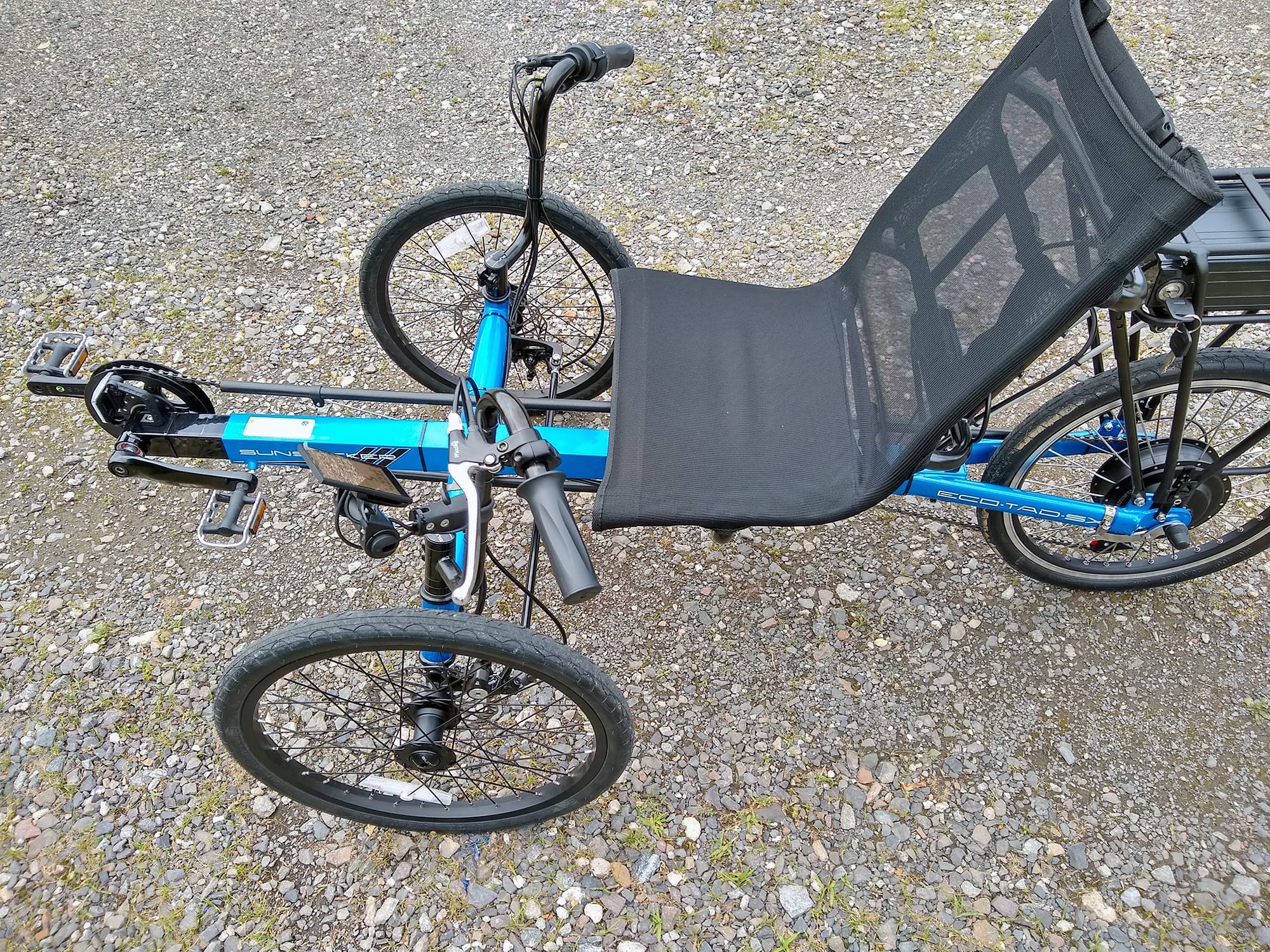

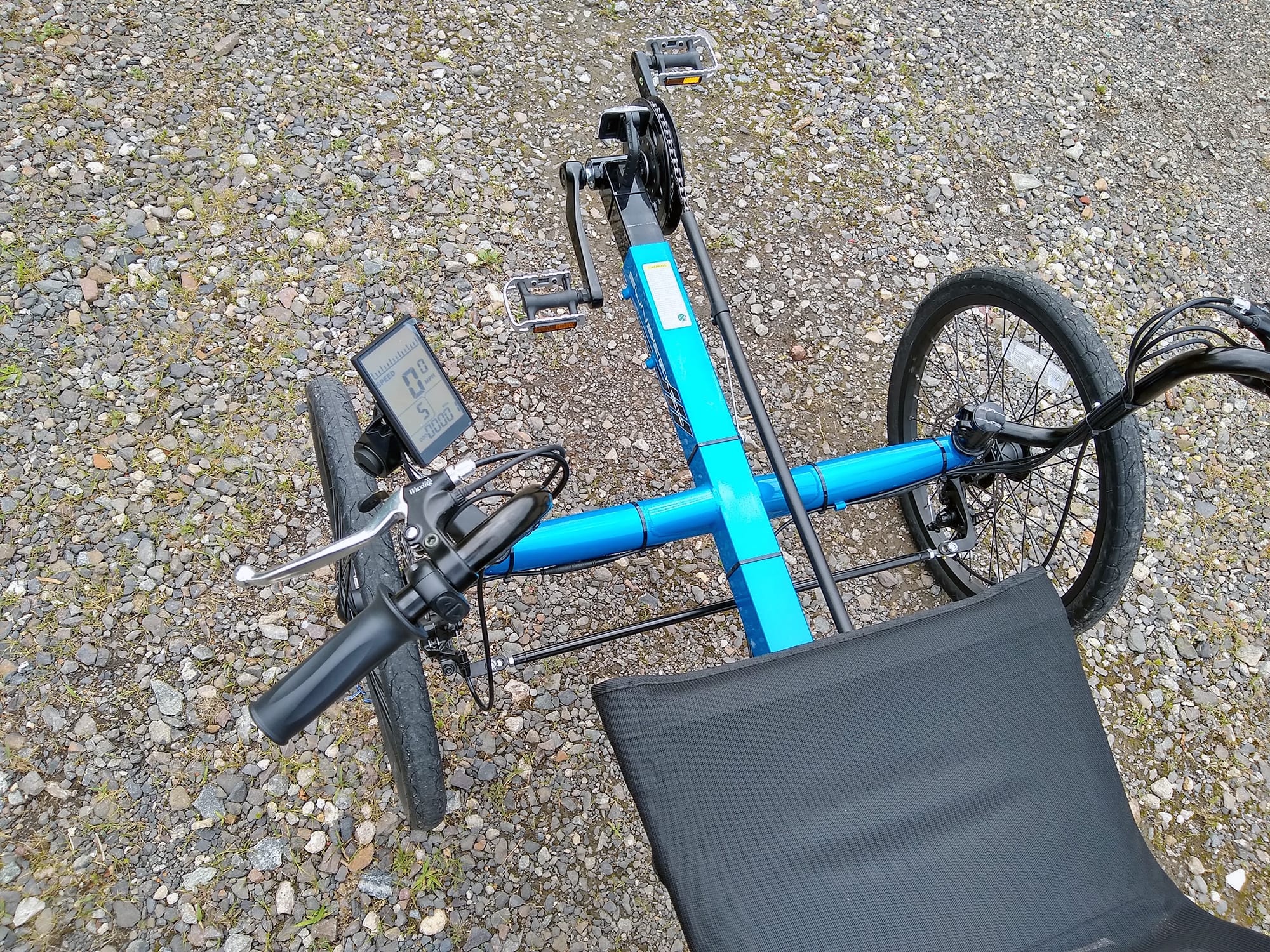

Operating the trike is simple. Once the battery is mounted, start by turning the key in the on position. From there, the display will come to life and give you the read outs. The battery is shown across the top in 16 ticks. These ticks are in an infographic that somewhat resembles a ruler. Shown below that is you speed in MPH and the various levels of pedal assist you might be in, 0-5. To change the pedal assist, simply hit up or down on the arrow controls mounted on the left handle bar. There is an odometer readout below that and pressing the mode button will change that to display max speed, average speed, and trip set. Hold the up and down arrows together for a moment and that will unlock the deep drive menu. Here you can mess with top speed as well as other electrical power configurations to really get the setup how you want it. I think it is cool they used a special mount for the display here. It used to be in the middle and that got in the way of pedaling thighs from time to time so this new position is great. However, my only gripe with the display on this trike is that having it mounted on your left side and a bit further down means you have glance over at it and take your eyes off the road, so do be aware of that.
