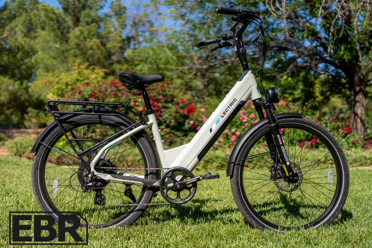

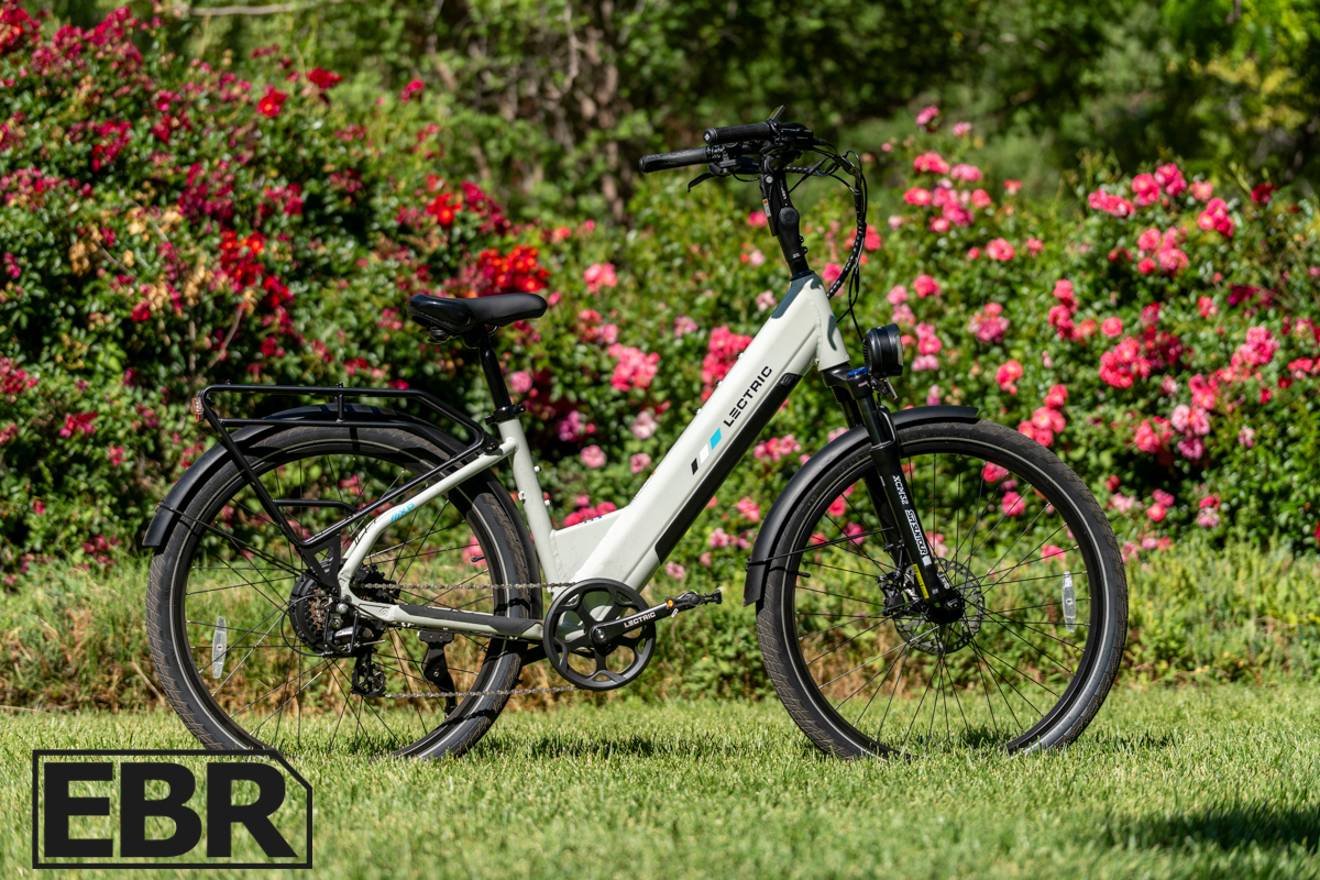

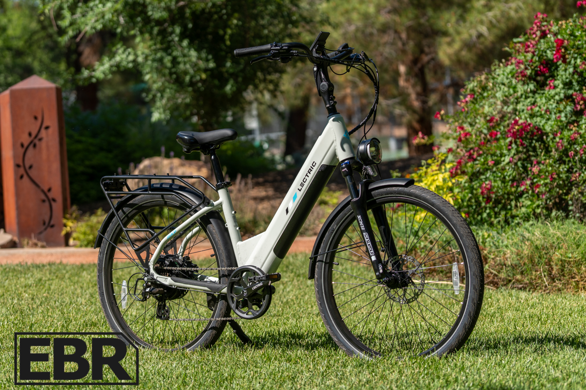

I tested both the high-step commuter and the step-through cruiser, and they’re genuinely different riding experiences — which is exactly the point. Let me walk through both.
The step-through is what Lectric calls a cruiser, and that’s the right word for it. The geometry puts you in a very upright, relaxed Dutch-style stance, and I found myself just… enjoying it. Hands comfortable, weight well distributed between the saddle and the bars, no pressure building up after 30 minutes of riding. I have had wrist issues in the past, and I was pleased with how the adjustable stem let me dial in the angle exactly where I needed it — and that adjustment is essentially toolless, which makes it very easy, even for inexperienced riders who hate turning wrenches.
If you’re someone who prefers a more comfortable, upright riding position but has been reluctant to ride a step-through because you don’t think it looks as cool, I’d encourage you to get that out of your head. The XPress 2 ST has a stiff frame, rides well, and I think a lot of our older readers will appreciate how approachable the low-step frame is — and yes, I’m also talking about myself here.

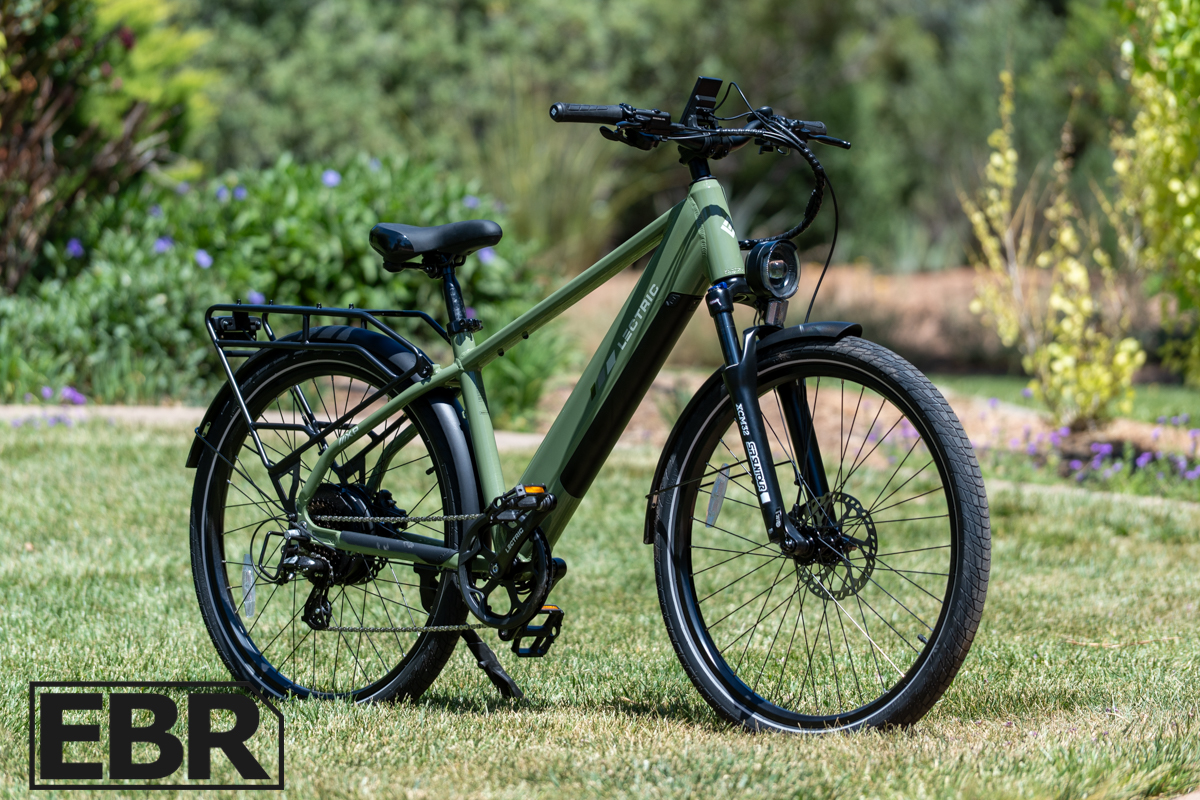

The high-step commuter puts you in a more forward, semi-aggressive position — flat bars with a slight rise, but not going full road-bike aggressive. I rode this one for about 45 minutes and felt great throughout. Weight distribution between the saddle and my hands was solid, and it never got to that point where my hands started going numb, which can happen quickly for me on bikes that aren’t balanced right (thanks to some nagging wrist issues). If you’ve spent time on road bikes or gravel bikes and you want something that still feels like you’re riding rather than sitting, this is your version.
No ghost pedaling at 28 mph in Class 3 mode, which I was happy to see. The 46-tooth chainring and 8-speed 11-32 freewheel keep you in a usable gear through the full speed range. For what it’s worth, I was spending most of my time in fifth, sixth, and seventh gear while riding on flat roads, and didn’t really have to shift down to first or second unless I was climbing a very steep hill.

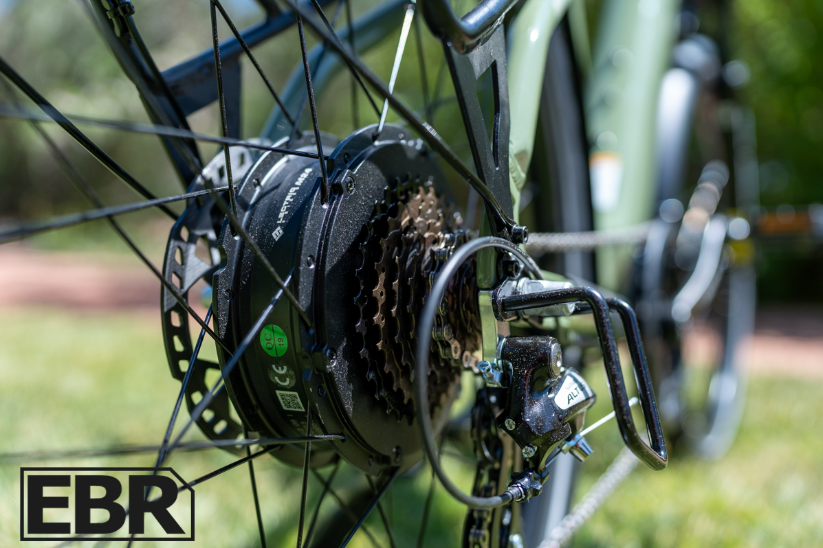

The XPress 2 has a 750W nominal rear hub motor that peaks at 1,310W with 85Nm of torque. Those numbers put the motor right where I think it needs to be for a Class 3 commuter e-bike, as you need a powerful motor when commuting at higher speeds.
On the hill test, this motor felt fantastic – it was powerful but still smooth, and didn’t feel like it was strained. I had the torque multiplier set to the increased setting, which I’d recommend to most riders. The standard setting is fine, but the increased setting just gives the bike a little more pep that I think most people are going to prefer.
What really stood out to me was how much quieter this motor is compared to the original XPress. Lectric has done a lot of work here, and you can feel it. The original was a little loud for my taste – this one is genuinely quiet and smooth, which makes the whole riding experience feel more refined and premium than the price tag would suggest.

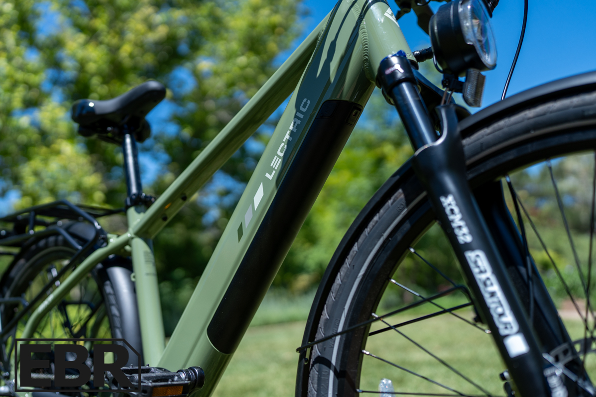

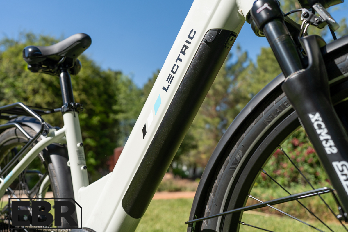

The battery is a 48V, 14Ah pack, which works out to 672Wh. Is it the biggest battery you’ll find on a commuter e-bike? No – bikes like the Aventon Level 4 REC and the Velotric Discover 3 offer more capacity, but those bikes also run $600 more. Given that the battery is one of the most expensive components on any e-bike, Lectric made a smart call here. The 14Ah pack is well-suited to what this bike is designed to do, and most commuters are going to have zero complaints about the range it delivers.
The battery is removable, which matters more than people give it credit for. If you live in an apartment or don’t have easy access to an outdoor outlet, being able to pull the battery and charge it indoors is a genuine quality-of-life feature.

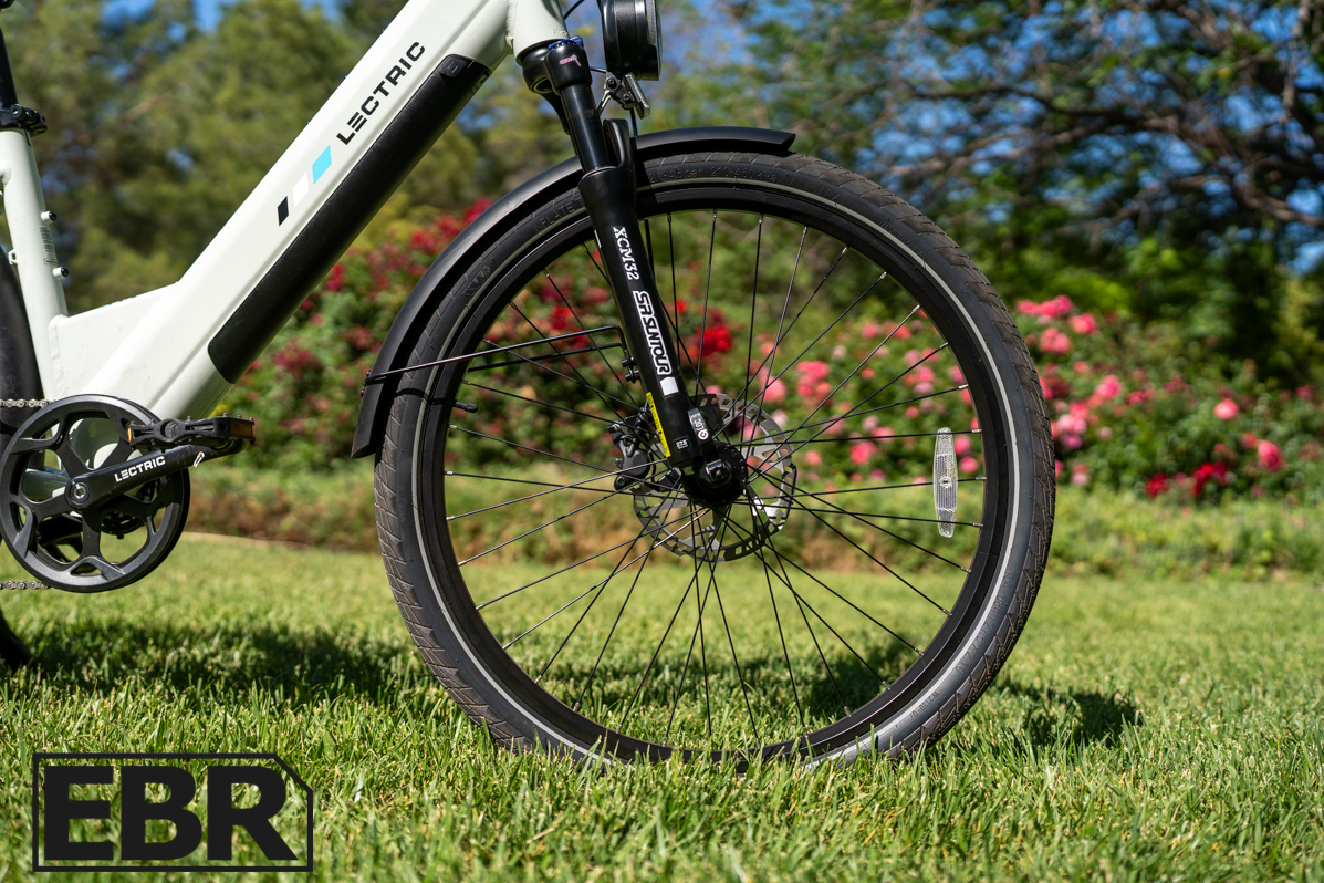

Fork: The SR SunTour XCM 32 fork is one of the more impressive upgrades on the XPress 2. You get 80mm of travel and – here’s the part that really stands out at this price – a 15mm thru-axle instead of a traditional dropout. This makes the front end stiffer and feel more solid overall. The preload adjustment doesn’t do a whole lot, I won’t pretend otherwise, but the travel is there and it takes the edge off on rougher pavement.

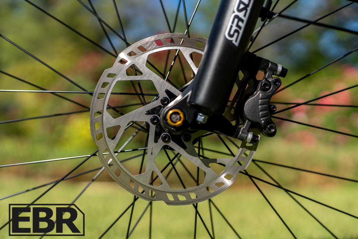

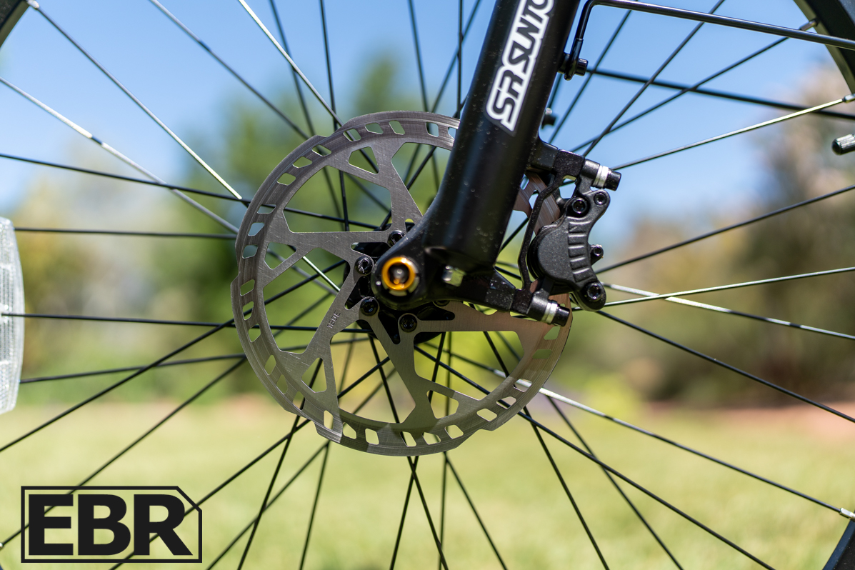

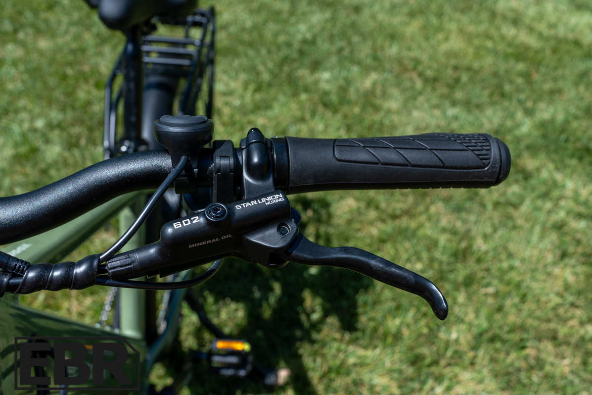

Brakes: Lectric developed the Star Union 602 brakes in partnership with Star Union – the 602 being a nod to the Phoenix area code where Lectric is based. We’ve now seen these on a couple of Lectric bikes, and they continue to impress. These are hydraulic disc brakes with 180mm rotors front and rear, and the rotor thickness is 2.3mm – thicker than the 1.8mm standard you typically see at this price. The lever feel is smooth and consistent, stopping power is strong, and during hill testing I repeatedly rode up to 28 mph and hit the brakes hard without any fade or overheating.

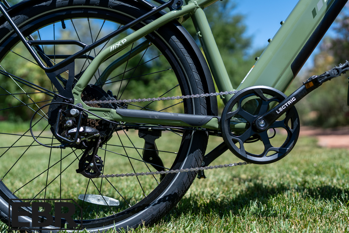

Drivetrain: The XPress 2 comes with a Shimano Altus 8-speed drivetrain with an 11-32 freewheel and a 46-tooth chainring. Shimano Altus is the minimum I want to see on a quality value e-bike, and it’s good to see Lectric step up to it here. Shifting is pretty good, the trigger shifter is easy to operate, and every bike shop in the country can work on it if something goes wrong. Given that the Altus is the entry-level groupset from Shimano, you will likely need to adjust the shifting more frequently than you would on a higher-end counterpart. However, that’s to be expected at this price point.

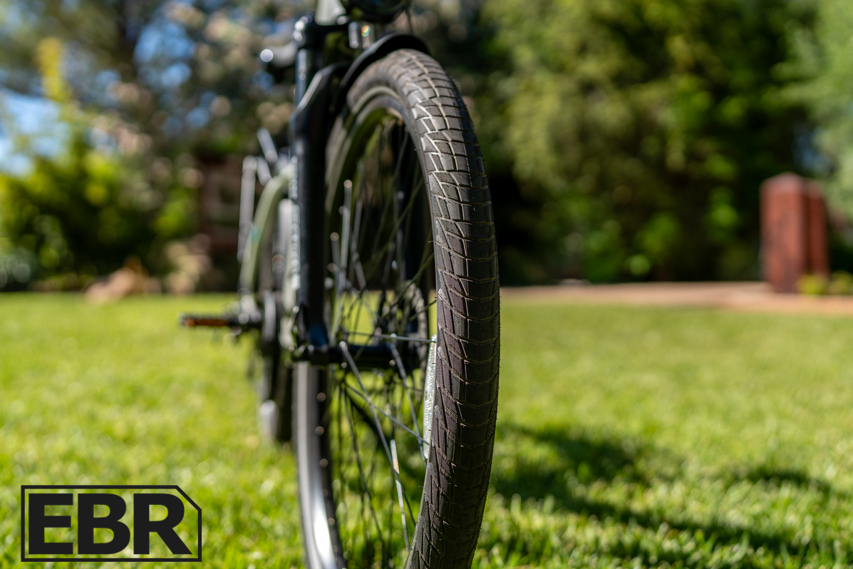

Tires: The XPress 2 is specc’d with 27.5″ x 2.1″ Chaoyang slick tires with Slime pre-installed for puncture protection. I will never understand why other brands don’t ship their bikes with slime in the tires – so kudos to Lectric for doing that, as it will likely save you from having to fix a flat every other month.

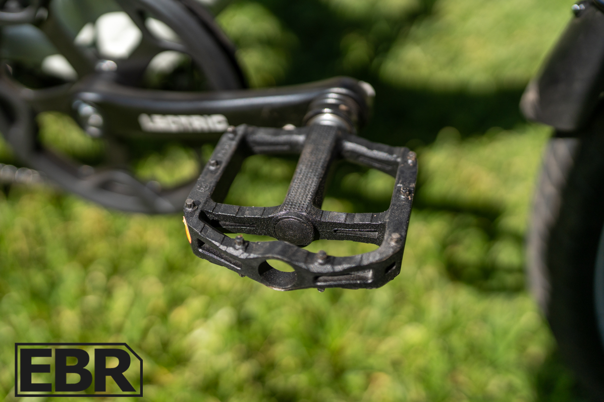

Pedals: Lectric has included their quick-release pedals which are great when you’re regularly loading this bike onto a car rack or storing it in a tight space.

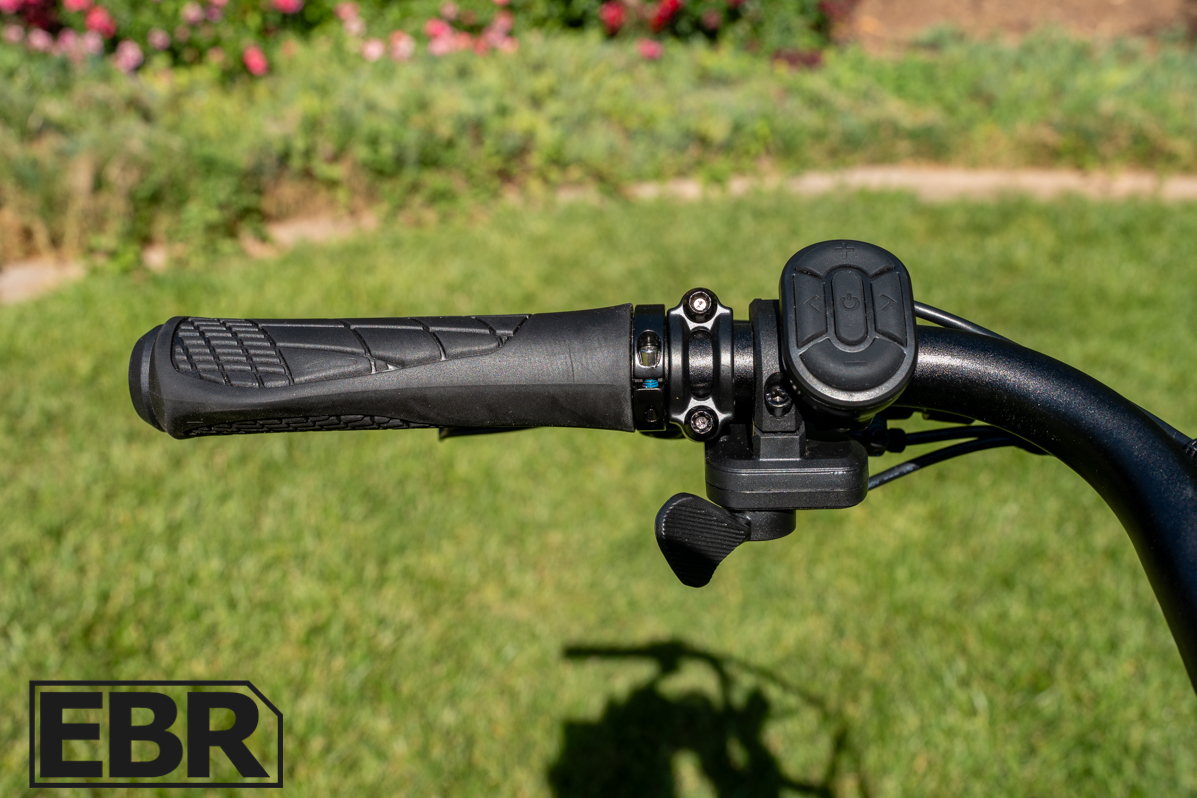

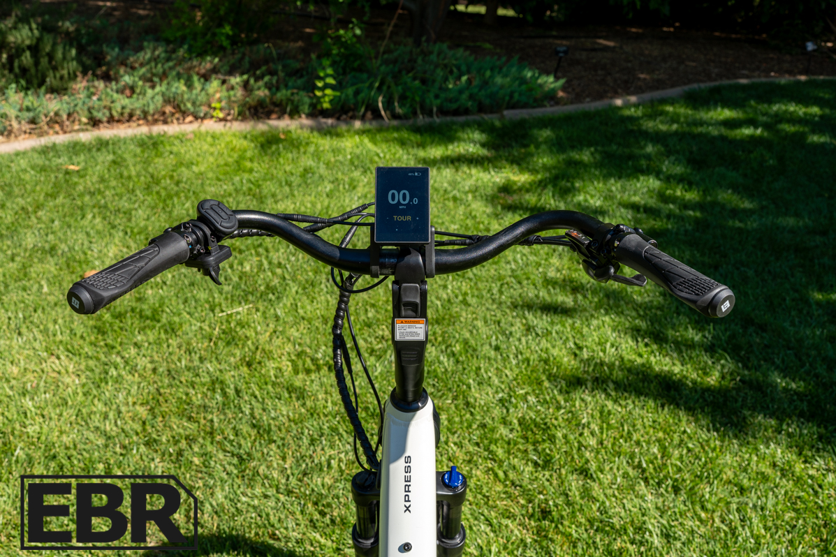

Cockpit: The two versions of the XPress 2 have notably different handlebar setups, and that’s intentional. The high-step commuter comes with a 680mm flat bar that has a 40mm rise and 10° of backsweep. With a shorter reach than some commuters, this gives you a semi-aggressive setup that puts your body in a forward, engaged position.
The step-through cruiser gets a much more swept-back 585mm bar with 50mm of rise and 50° of backsweep, which is what gives it that relaxed, upright Dutch-style feel. The step-through also comes with a fully adjustable stem, which I really liked – easy to set up, essentially toolless, and makes a real difference in making sure the bike rides comfortably.
PLEASE take the time to set up the cockpit how you prefer. It might take 30-45 minutes, but is well worth it.

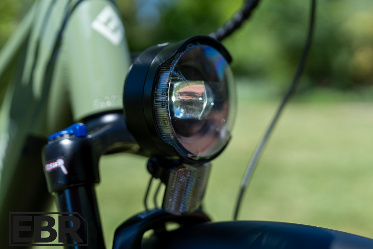

Lights and Accessories: The XPress 2 comes ready to commute right out of the box. You get a 90-lumen front headlight, and a rear light that doubles as a brake light and includes left and right turn signals. I think that is a great feature for anyone riding in traffic.

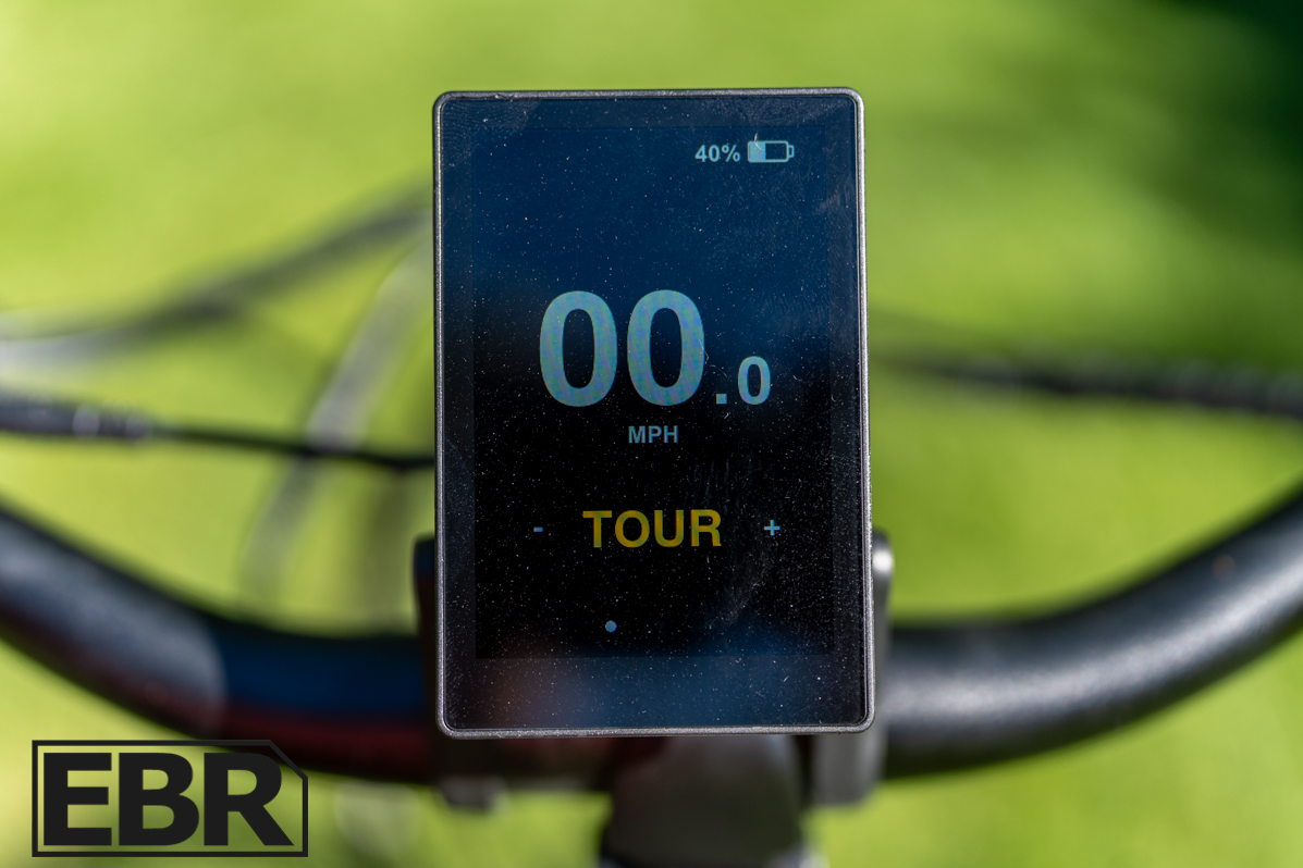

The XPress 2 comes with a backlit LCD display that gives you three screens to toggle through via the power button. The first shows your speed, battery indicator, motor power bar, and assist level. The second adds cadence, trip time, trip distance, and odometer. The third – and my personal favorite – shows input power, motor power output, amps, and voltage. If you like to geek out on what the motor is actually doing while you ride, that third screen is where you’ll spend most of your time.

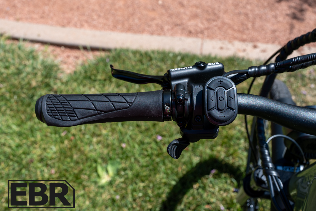

Getting into the advanced settings is pretty easy, just hold the up and down buttons on the control pod at the same time. From there you can adjust screen brightness, set your bike classification (Class 1, 2, 3, or California Class 3), toggle between torque and cadence sensing, customize throttle behavior, set walk mode speed, and adjust light operation.
One critique: the battery readout operates in 10% increments rather than a true percentage readout. As I mentioned in the Range section, that means when it reads 10%, you could actually be at 2%. I’d love to see a more precise readout in a future version.
Lectric does not have a companion app for the XPress 2, which means no over-the-air updates and no phone-based customization. For a bike at this price point that’s understandable, but it is worth noting.

The XPress 2 Commuter is the high-step version, designed for riders who want that forward, more aggressive riding position. It comes in two colors – Tempest Grey and Pine Green – and claims to fit riders from around 5’4″ to 6’4″.
