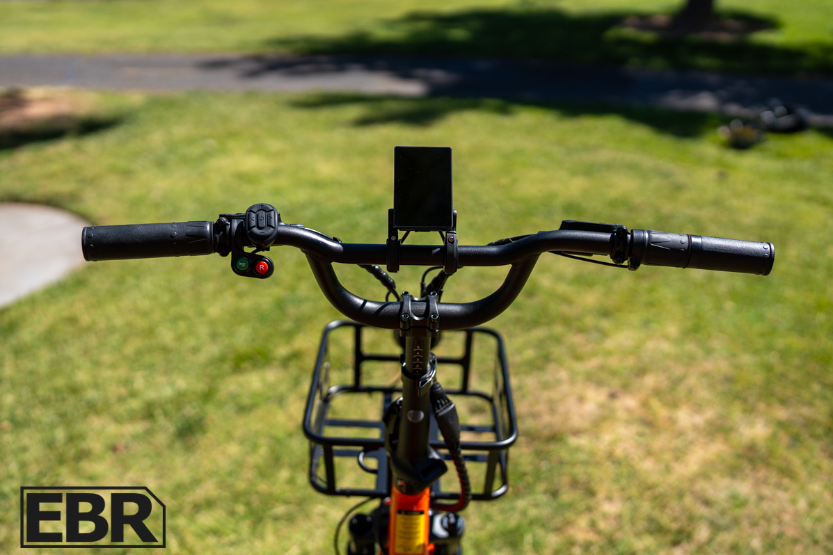

The handlebar is close to flat with a small amount of sweep, which is how I like to ride since my wrists stay straight instead of kinking off to the side. Riders who want a swept-back Dutch-style bar will feel differently about that, so call it a preference.

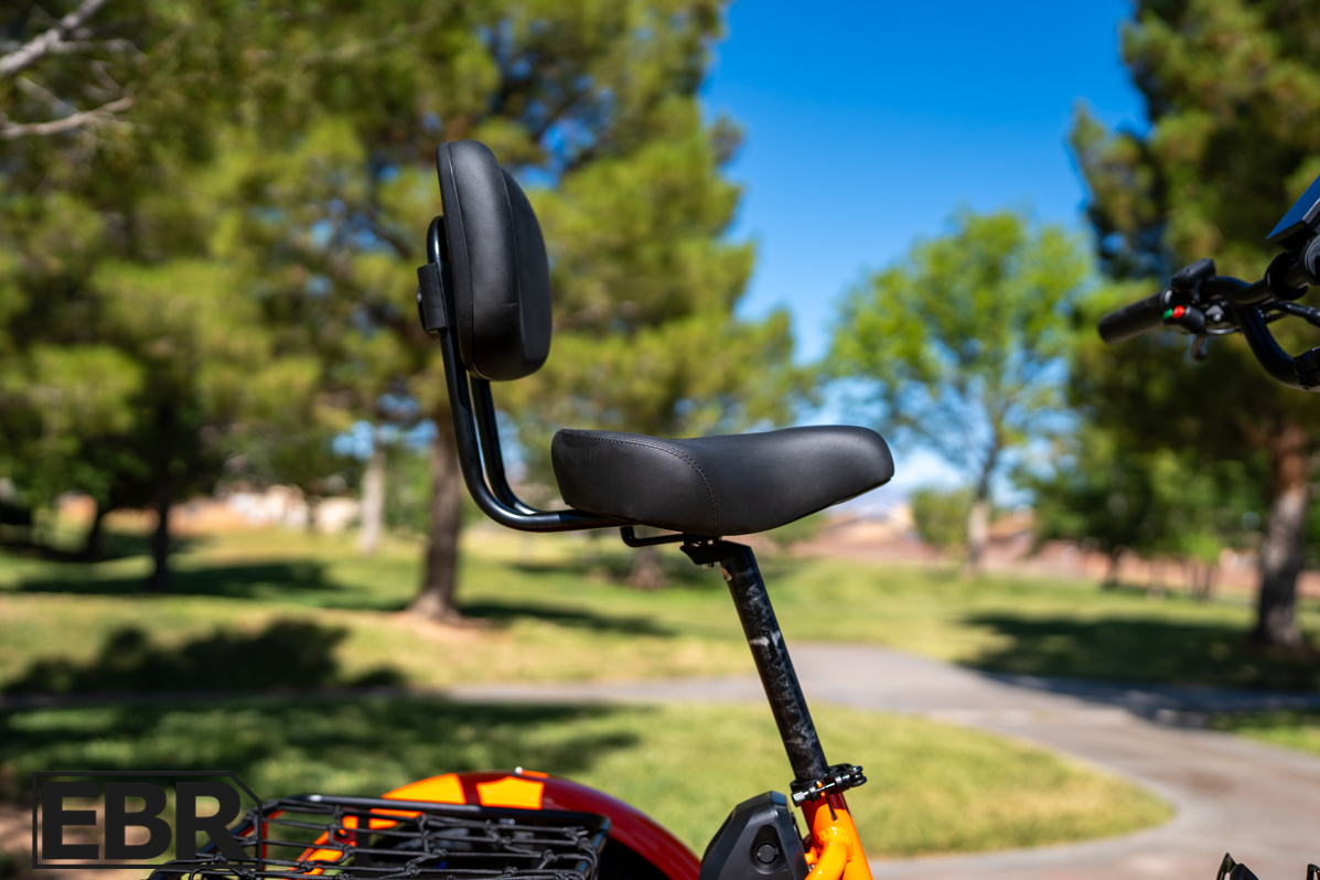

The saddle is a pleasant surprise. I have a hard time with trike saddles, because the wide comfort shape catches the back of my leg at the bottom of the pedal stroke and forces me to run the seat lower than I want. This foam seat does not do that, so I was able to keep my leg extension, and the backrest lets me sit back and relax on longer stretches.

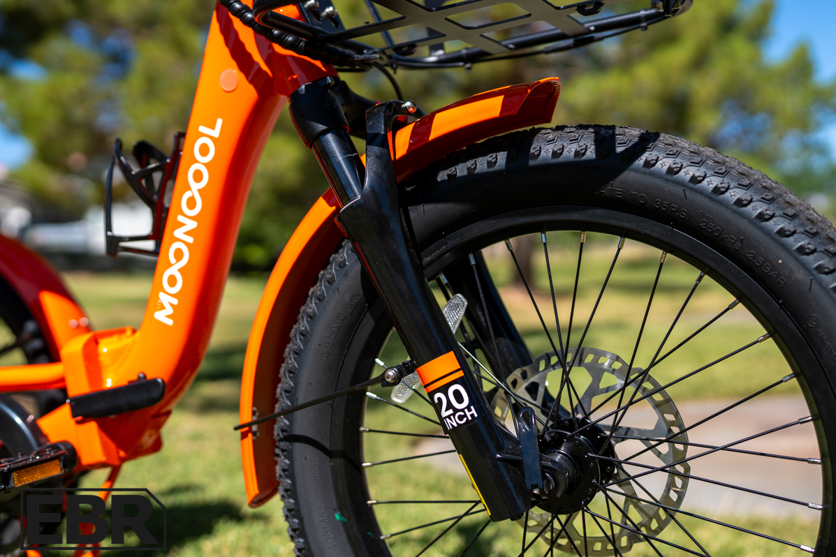

One note on comfort: the front fork (40mm) is more on the firm side. In fact, I have to get out of the saddle and push down on the bar to get it to compress fully, so it does not smooth out road chatter quite the way a softer fork would. However, the fork does a good job of keeping the front wheel on the ground, and still takes off most of the edge from bumps and rocks in the road.

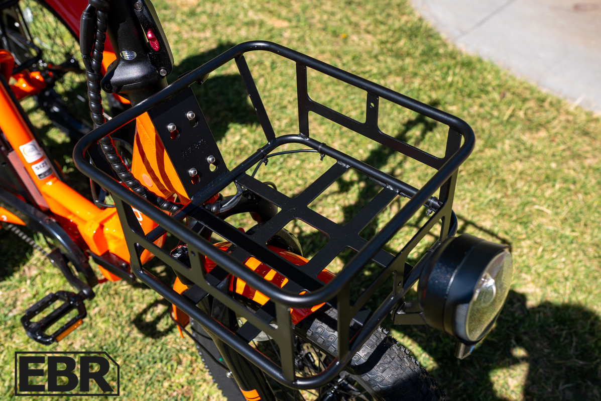

That trade works in Mooncool’s favor once you load the baskets, because the front end stays composed and controllable instead of soft and diving, and the 3-inch tires pick up some of the cushioning slack.

Two things would make it ride and pedal better. I’d like to see an adjustable stem, and I’d love it if the backrest adjusted fore and aft, not just up and down. And know that the single gear spins out around 11 to 13 mph on flats, so most riders will settle in near 10 or 11 mph in Sport or reach for the throttle at those speeds.

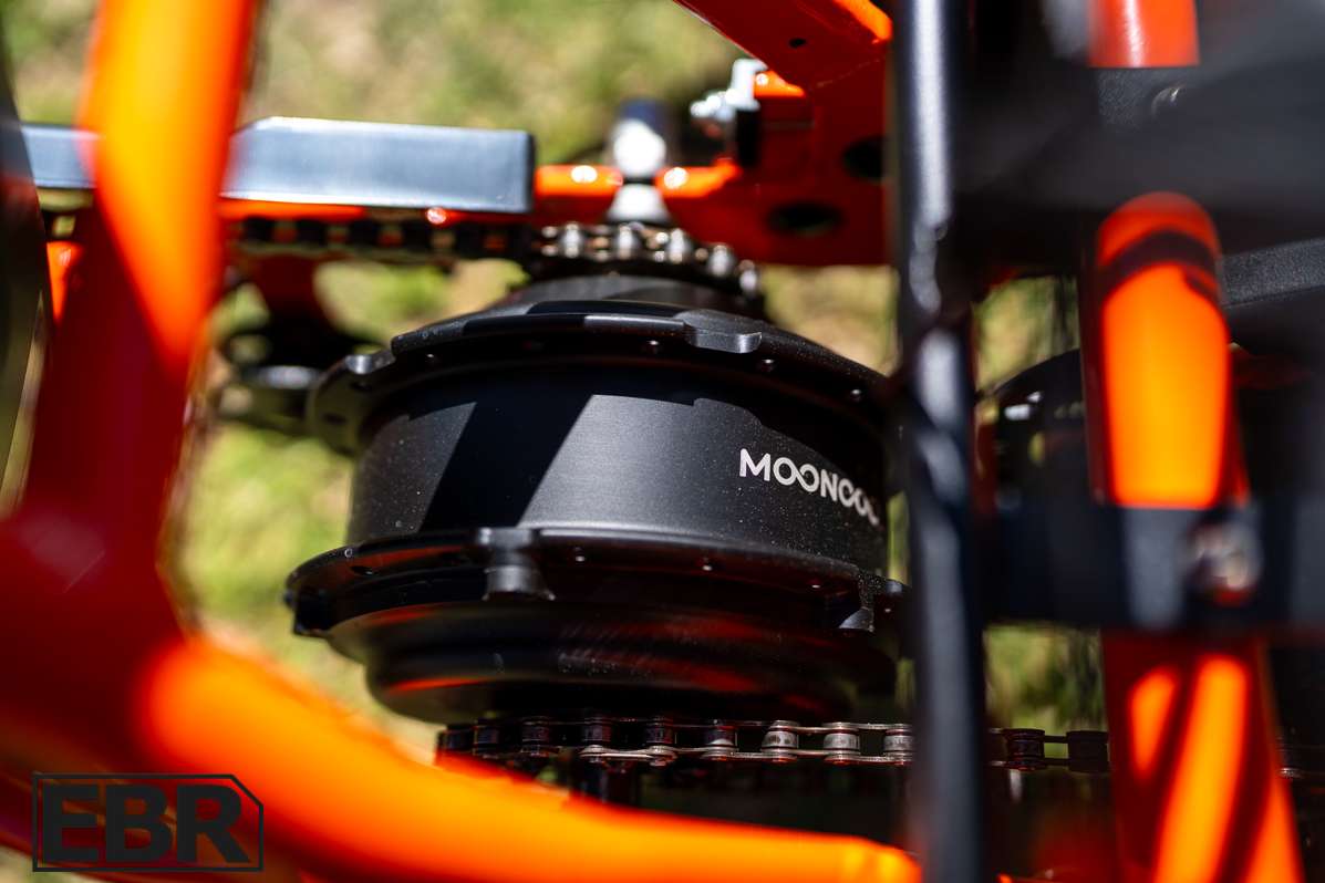

The TK2 runs a 500W nominal rear hub motor that peaks at 1,092W with 65 Nm of torque, and pairs with an FOC 20-amp controller. At 500W, there are a few more powerful trikes on the market (for reference, the Lectric XP Trike is also 500W, the Velotric Triker is 750W). Fortunately, if you want a Mooncool trike AND a 750W motor, then you can get the TK2 Pro.

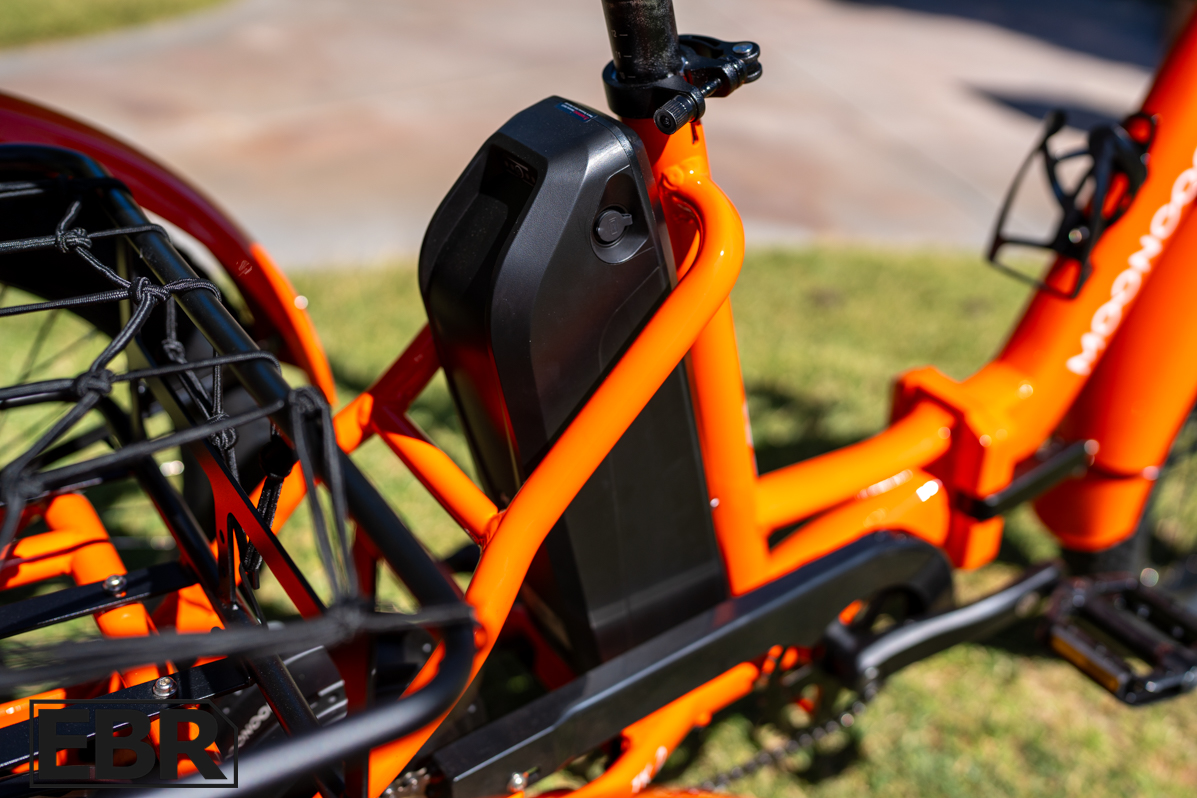

The TK2 carries a 48V 15Ah battery, which works out to 720Wh of capacity, and Mooncool quotes a range of 35 to 75 miles.

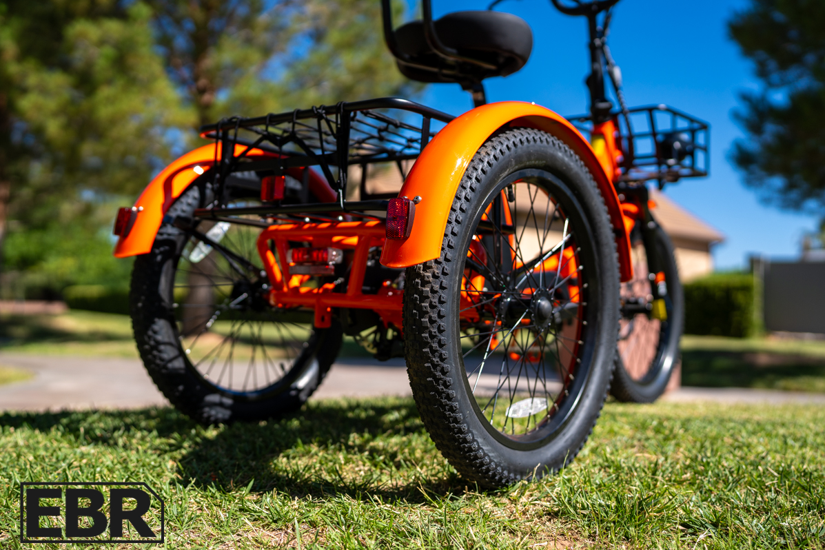

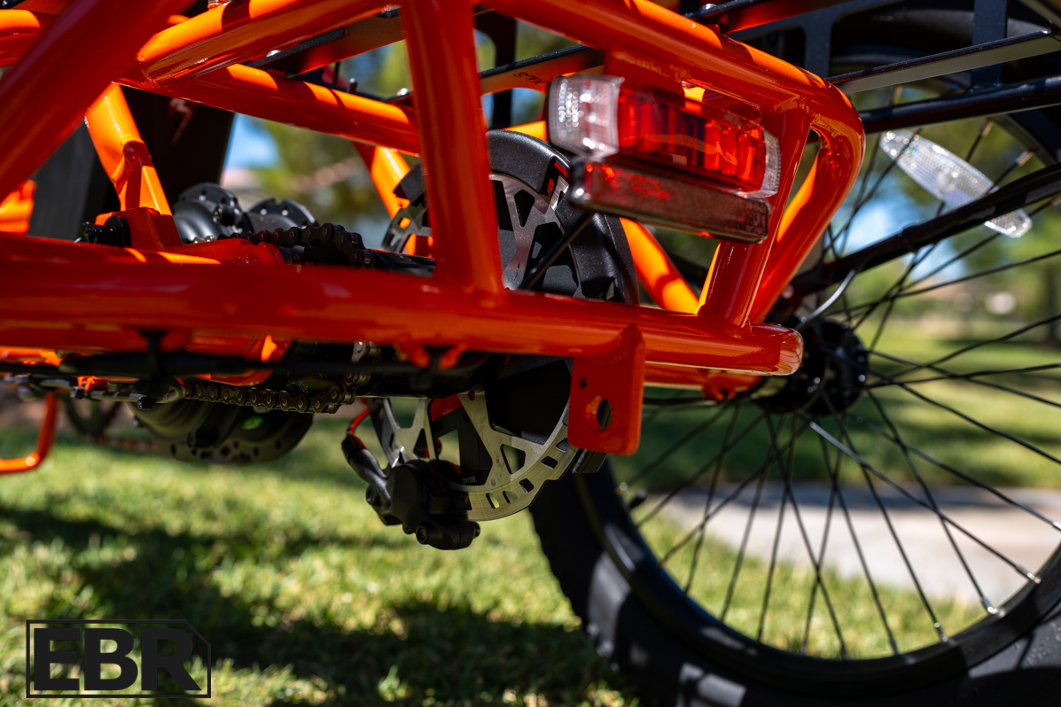

- Rear differential. Check! It does the job I described earlier by letting each rear wheel spin at its own speed through a corner.

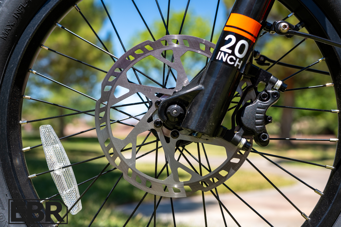

- Star Union hydraulic disc brakes. 180mm rotors front and rear, and Mooncool went with 2.3mm rotor thickness instead of the usual 1.8mm to handle the weight this trike can carry. They are also mineral oil, so any shop can bleed them. Both levers include a parking brake lock, which you will use more than you expect.

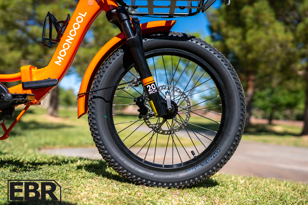

- Chaoyang 20 x 3.0 tires. Light knobs on double-wall alloy rims with stainless spokes. This, combined with the front fork lets you ride grass and dirt roads instead of staying stuck on pavement.

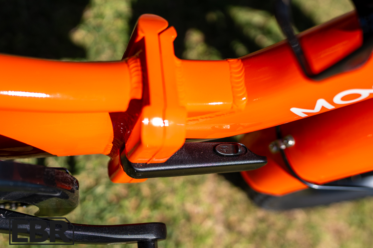

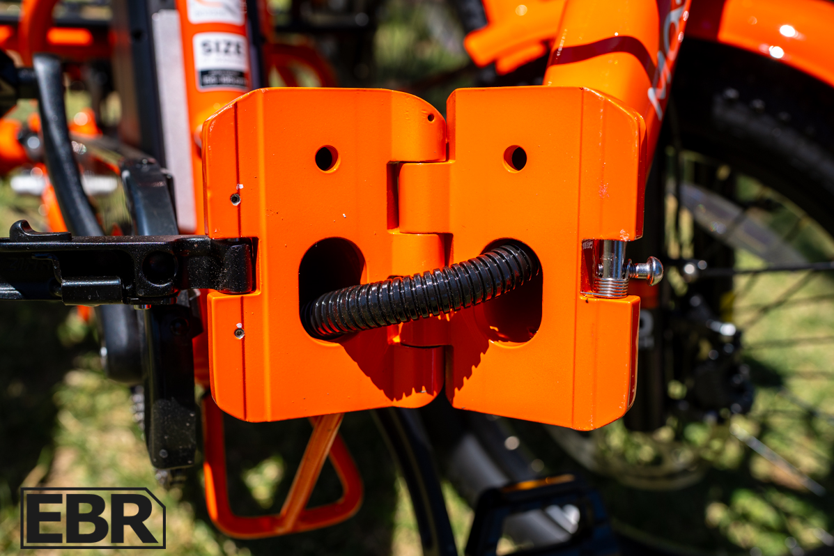

The frame is alloy with a folding hinge in the middle, is rated for 450 lbs, and weighed in at 95.7 lbs on our scale. Folded, it measures 39.4 by 28.7 by 26.8 inches. One thing to know before you buy it as a travel trike: with the front basket installed you can only fold it into a V shape. To get it all the way down you pull the front wheel, which is a quick release, and take the front basket off too.

Up front Mooncool used a half-twist throttle rather than a thumb throttle. I normally argue for a thumb throttle, but on a trike where you cruise at a steady speed with your wrist relaxed, the twist works great.

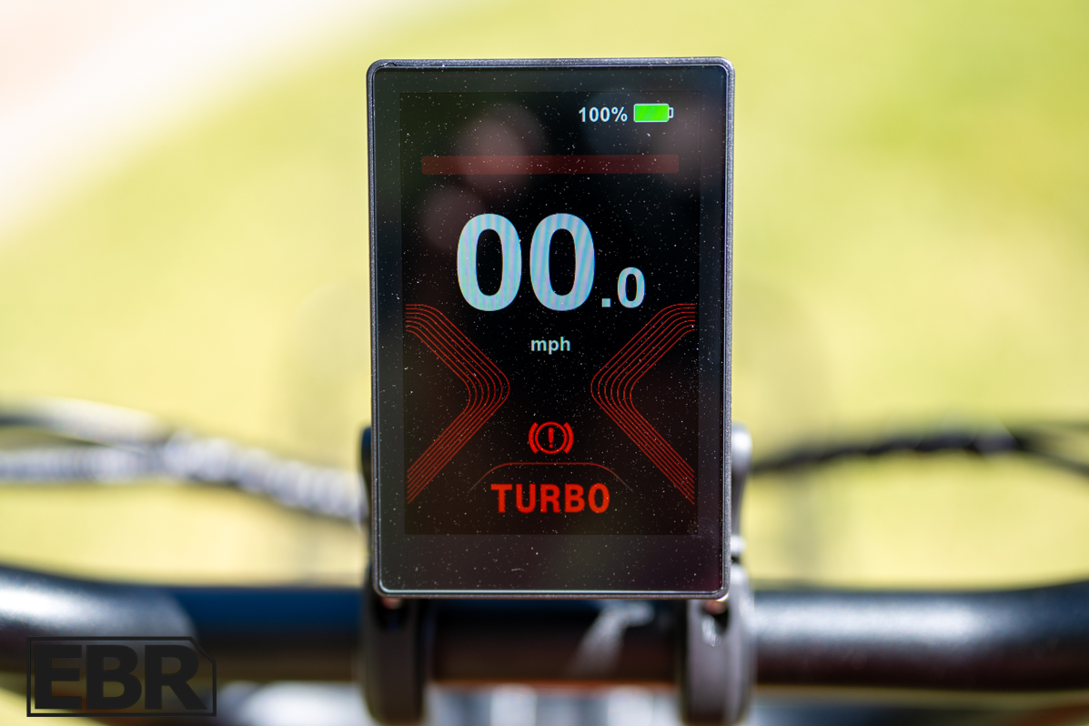

The Mooncool TK2 comes with a 3.5-inch full-color TFT display, mounted in the center of the BMX-style handlebars. It is anti-reflective, rated up to 1,500 nits, sealed to IPX5, and spec’d to work from -4 to 158 degrees Fahrenheit (I kind of found it funny that they talk about such extreme temps, especially since I was already melting riding this around in 105 degree heat).
There is no app for this trike, which means everything gets adjusted from the screen. No pairing ritual, no login, and no scenario where you cannot change a setting because you left your phone at home.
The advanced menu lets you adjust screen brightness, an auto-off timer (I leave mine at five minutes), miles or kilometers, wheel size, the speed limit, and a password lock. There is a battery page with voltage and charge cycles, an HMI page that is there for a shop or tech support, and a trip reset.
You can run the TK2 with three assist levels and a 12 mph cap, or five levels with a 15.5 mph cap. If you are new to a trike, start in the three-level, 12 mph mode. There are things you have to learn about riding one of these, and you can move up once you are comfortable.
One quirk to know: if you are in Turbo and you switch down to the three-level mode, the trike gives you nothing until you click down to Sport, and it will not let you climb back up. It takes about two seconds to sort out, and is a little glitch I’d like to see updated on future models.

- RV and camping folks who need it to fold, with the caveat that a full fold means pulling the front wheel and the front basket, and that 95.7 pounds is not a one-person lift into an SUV.
