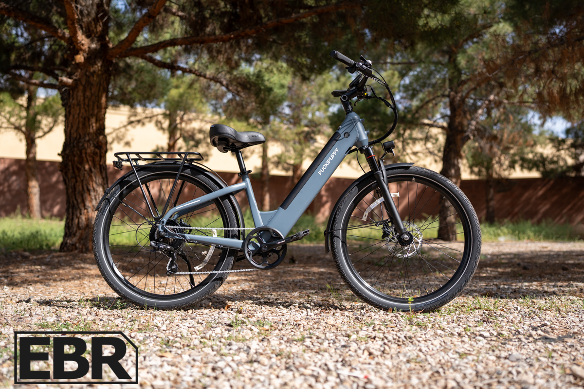

The Poodle is a Dutch-style step-through commuter that Puckipuppy is selling for right around $999, and they’ve loaded it with more features than you’d expect at that price point.
The bike is aimed squarely at casual commuters and cruiser riders who want a Class 3-capable e-bike without spending over a grand. It ships with hydraulic disc brakes, a 750W rear hub motor, a 720Wh battery, and an accessory package that could save you $300–$500 in add-on purchases.
There are trade-offs to hit that price, and we’ll get into all of them, but Puckipuppy has done the research on what this category of rider needs.

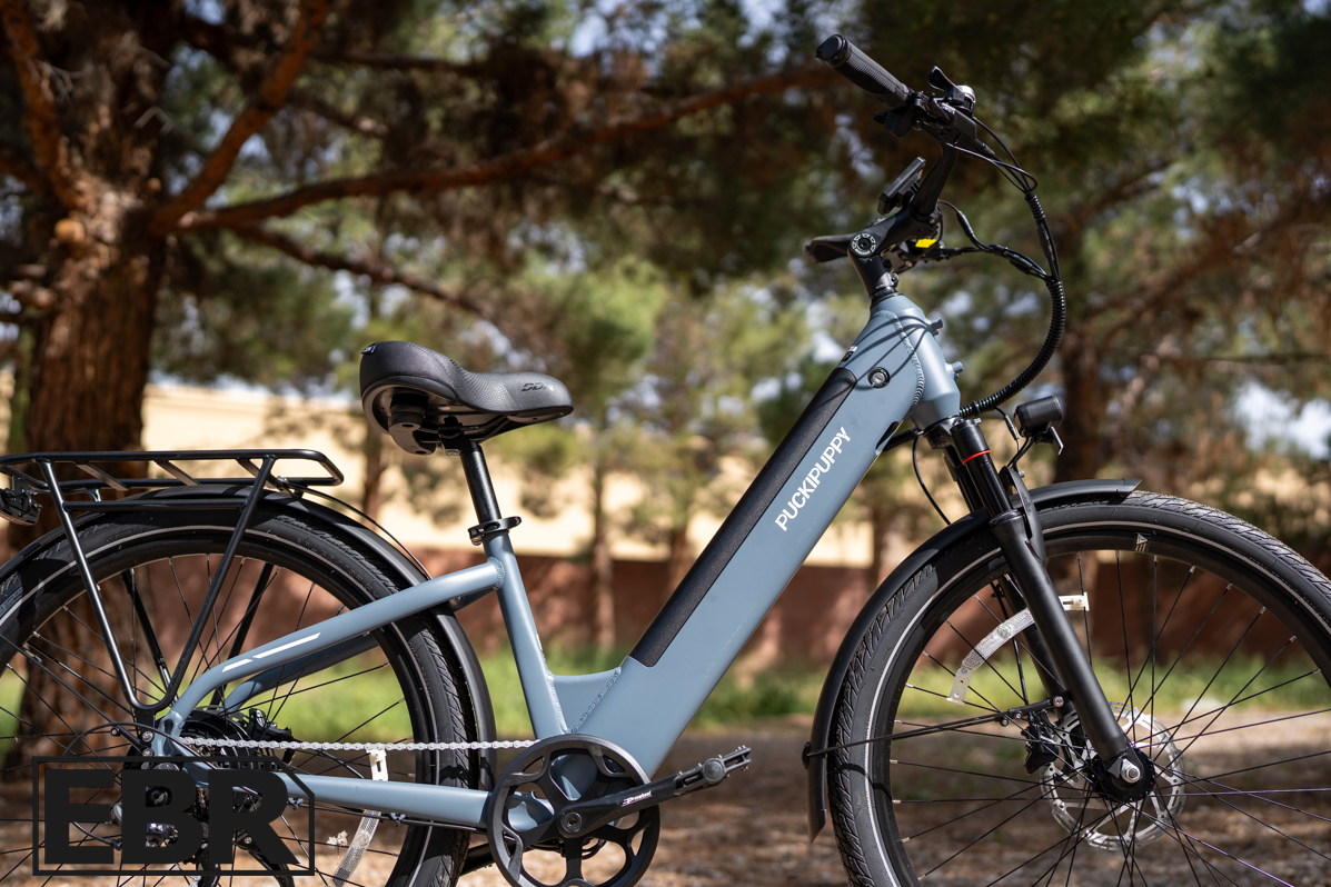

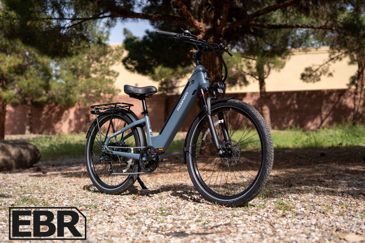

At 5’11” and 185 lbs, the Poodle fit me well, and I think that’s a direct result of Puckipuppy paying attention to what their competitors are doing and borrowing the right lessons. The geometry on this bike is well thought out for what it is. The Dutch-style step-through frame puts you in an upright, comfortable position that falls right in that sweet spot between a traditional laid-back cruiser and a more forward-leaning commuter.
I find a lot of bikes in this style tend to swing too far in one direction: either you’re sitting so upright you feel like you’re on a beach cruiser, or you’re hunched over like you’re on a road bike. The Poodle sits in a middle ground that I think a lot of riders will appreciate.

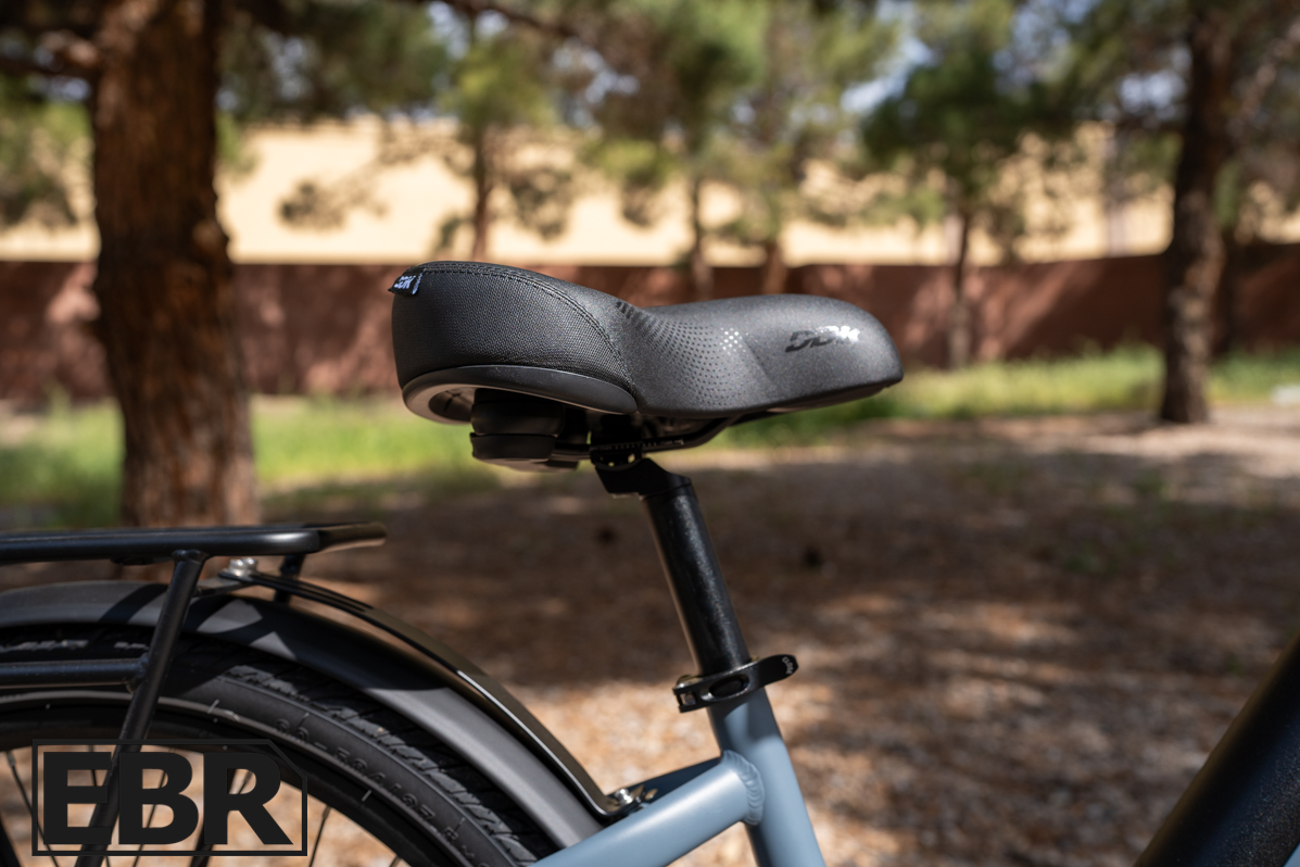

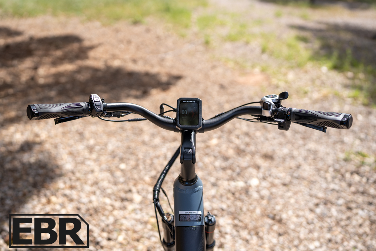

The real standout for me from a geometry and fit perspective is the adjustable stem. It’s a 0–90° adjustable design, which gives you a wide range of positions. When our mechanic Thomas (6’1″ and has a slightly longer reach) was putting the bike together, he had the handlebars pushed forward. I raised it up to shorten the reach a bit for my shorter arms, and it felt great.
For riders at the top of the stated 5’3″–6’4″ range, you may find you can’t get full leg extension even at maximum saddle height. However, I do think the bike would fit a 5’3 rider fairly well.

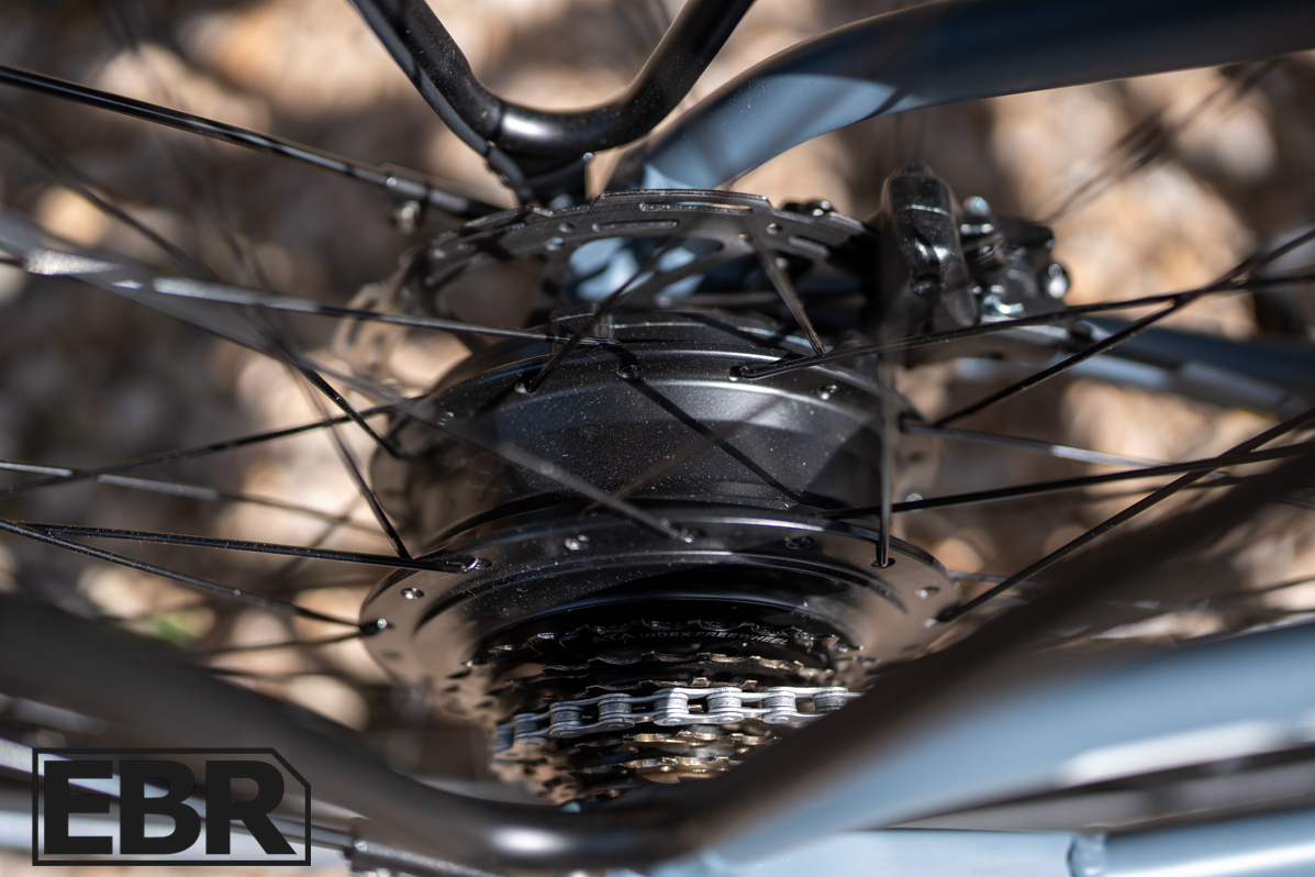

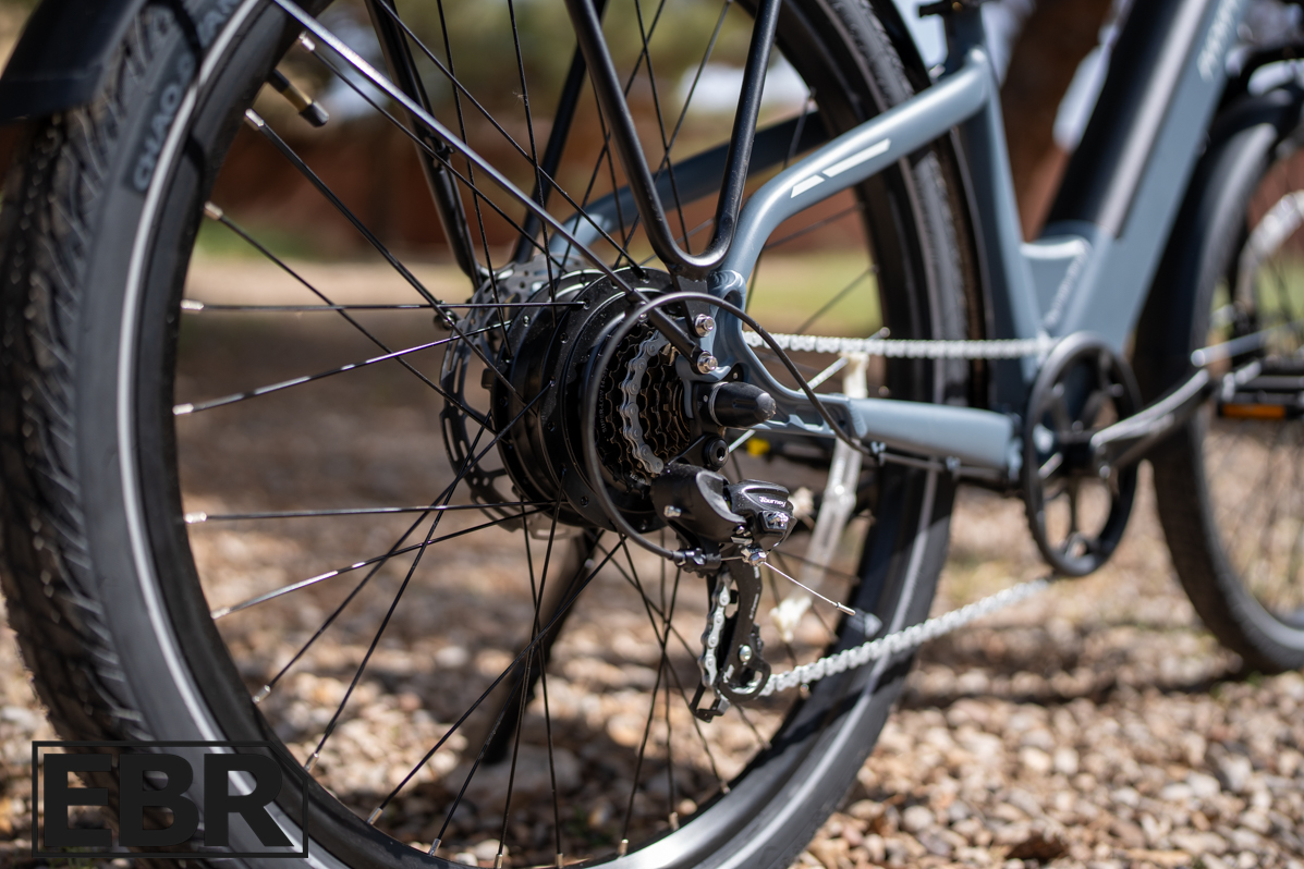

The Poodle has a 750W nominal rear hub motor with a 960W peak output. Puckipuppy doesn’t publish a torque figure, but based on the hill test performance and overall ride feel, my best estimate puts it in the 60Nm range, which would put it at the lighter end of the 750W hub motor segment. That doesn’t mean it’s underpowered for casual commuting; it’s not. But riders expecting the kind of low-end grunt you’d get from a 85Nm hub motor will feel the difference.
On the Black Hill climb, which is .34 miles long, has 185ft of elevation gain, and a 10.1% average grade, I was able to pedal the Poodle up to the top of the hill in 1:57. While we haven’t done a ton of hill tests yet, the bike was a bit slower than the other 2 commuters/cruisers we have tested on the hill so far (Lectric XPress2 and Aventon Pace 5 REC).
The throttle test from 0 to 20 mph took about 10–11 seconds, and there’s a slight startup pause when you hit the throttle from a dead stop. I actually don’t mind a little hesitation there. A throttle that lurches you off the back of the bike on first contact is worse than one that eases in. Under pedal assist, the 0 to 20 mph test took about 9–10 seconds with a slight headwind. Getting to 28 mph in Class 3 required effort from me on the pedals and felt like it was working at its ceiling. The motor ran louder than what I’ve gotten used to hearing on newer-generation motors, but it’s about where the category was 2–3 years ago, so not a dealbreaker, just worth noting.

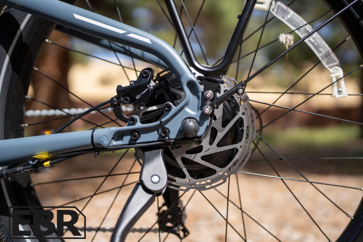

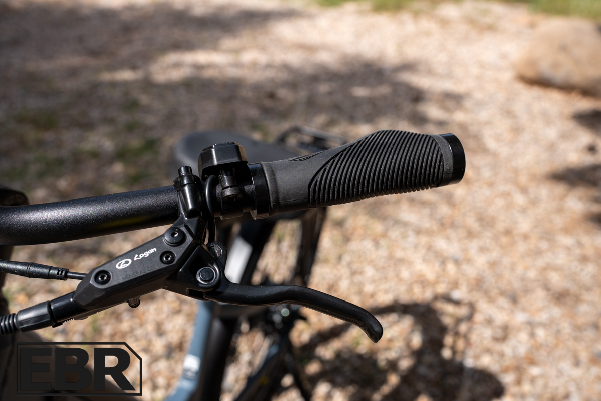

Let’s start with the highlight: the Logan hydraulic disc brakes. These are probably the single best spec on this bike relative to price. 180mm rotors front and rear, 1.85mm rotor thickness, and mineral oil fluid, which make servicing the brakes easy. I ran a sustained brake test going down the Black Hill: six to seven repeated stops from 20–25 mph. These brakes performed better than I honestly expected. Lever feel was consistent from the first stop to the last, with no sponge, no fade, no drama. Great job, Puckipuppy. At this price, cutting corners on the brakes is a common sin, and they didn’t do it.

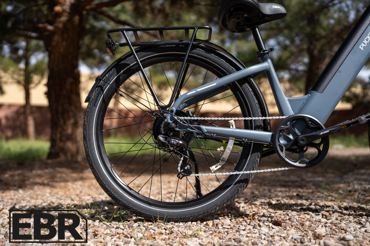

The Shimano 7-speed drivetrain is a more nuanced story. Shimano is obviously a well-known brand, and it’s serviceable at virtually any bike shop in the country. It’s reliable, and it’ll do its job for a casual commuter. The over-handlebar thumb shifter is a personal gripe of mine; I’d rather see under-bar rapid-fire style shifters, but that’s my preference and probably not a dealbreaker at this price.
The bigger mechanical issue is the cassette range. The 14–28T spread is narrow, and I felt it both at the top end (some ghost pedaling in Class 3 territory) and on the hill test, where I was wishing for a lower low gear on the steepest section.

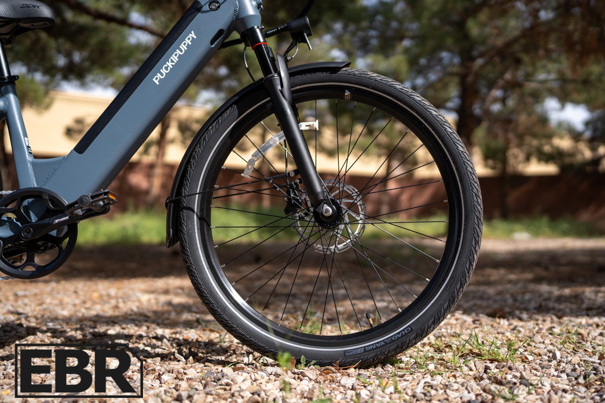

The suspension fork is a basic fork with 80mm travel, a coil spring, basic lockout, no thru-axle. Overall, the fork feels a little soft and not as firm as I’d like. For riders over 220 lbs, I’d expect it to feel noticeably underdamped. But the fact that it has a suspension fork at all on a $999 bike is a nice feature, and for the target use case of smooth urban pavement and paved paths, it does what you need.
The tires are a 27.5″ × 2.4″ fishbone tread pattern. They roll well and the tread design gives ok grip on wet pavement and light dirt without the rolling resistance penalty of a knobby. I liked the choice. The butterfly lock-on grips are a win: nice palm padding, good grip, and they won’t rotate on you. The leather cushion saddle is slightly wider and more padded than average, which I found to be more comfortable than I typically expect at this price point. At 5’11”, I’d drop it an inch or two from maximum height; riders at 6’3″–6’4″ won’t get ideal leg extension and sadly that is something taller people are used to.

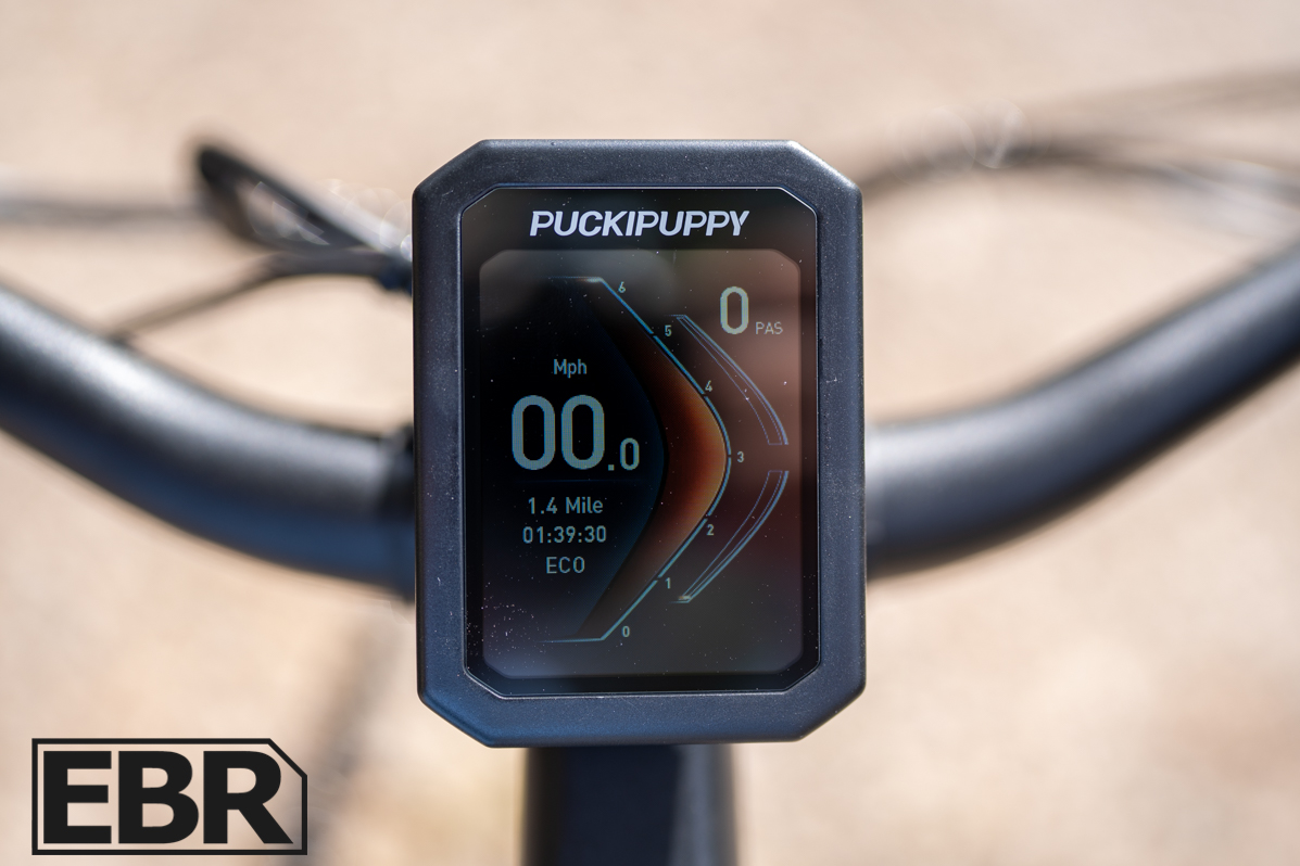

The Poodle comes with a color LCD display mounted at the center of the handlebar, easy to see while riding and well positioned. On a bright day, I’ll be honest, it’s a little dimmer than I’d ideally want. You’ll find yourself tilting it to reduce glare. It’s not a dealbreaker, but a higher-brightness display would be an upgrade I’d welcome.
The standard readout gives you speed, distance, PAS level (1–5), and a battery indicator, which is done via bars instead of a percentage readout. Its bar system shows 0 through 6 segments in a boomerang-style indicator, which I think looks cool but is harder to read than necessary. Below 30% charge, this kind of readout makes range planning harder. For a casual commuter who charges after every ride, it’s manageable. For anyone trying to strategically manage their battery on longer rides, we recommend doing some of your own range tests so you become familiar with the system and know what to expect.
Holding the up and down buttons together gets you into the basic settings: brightness (three levels), units (miles/km), startup mode (free or safe), and trip reset. If you want more customization, hold up, down, and the light button simultaneously. There, you can set your speed limit, choose 5-level or 3-level PAS, adjust voltage setting (36V or 48V), set wheel diameter, and switch between riding modes: motor only (throttle), pedal only (Class 1), and pedal + motor. The intensity setting goes from 1–5 as well.
There is no companion app, which I’ll note as a gap but won’t hold against the bike too harshly at this price. App-based motor tuning and OTA updates are features you won’t get unless you step up in price – at least for now. I think in the future we’ll likely see even budget bikes come with apps that allow for higher levels of customization, but we aren’t there yet.
