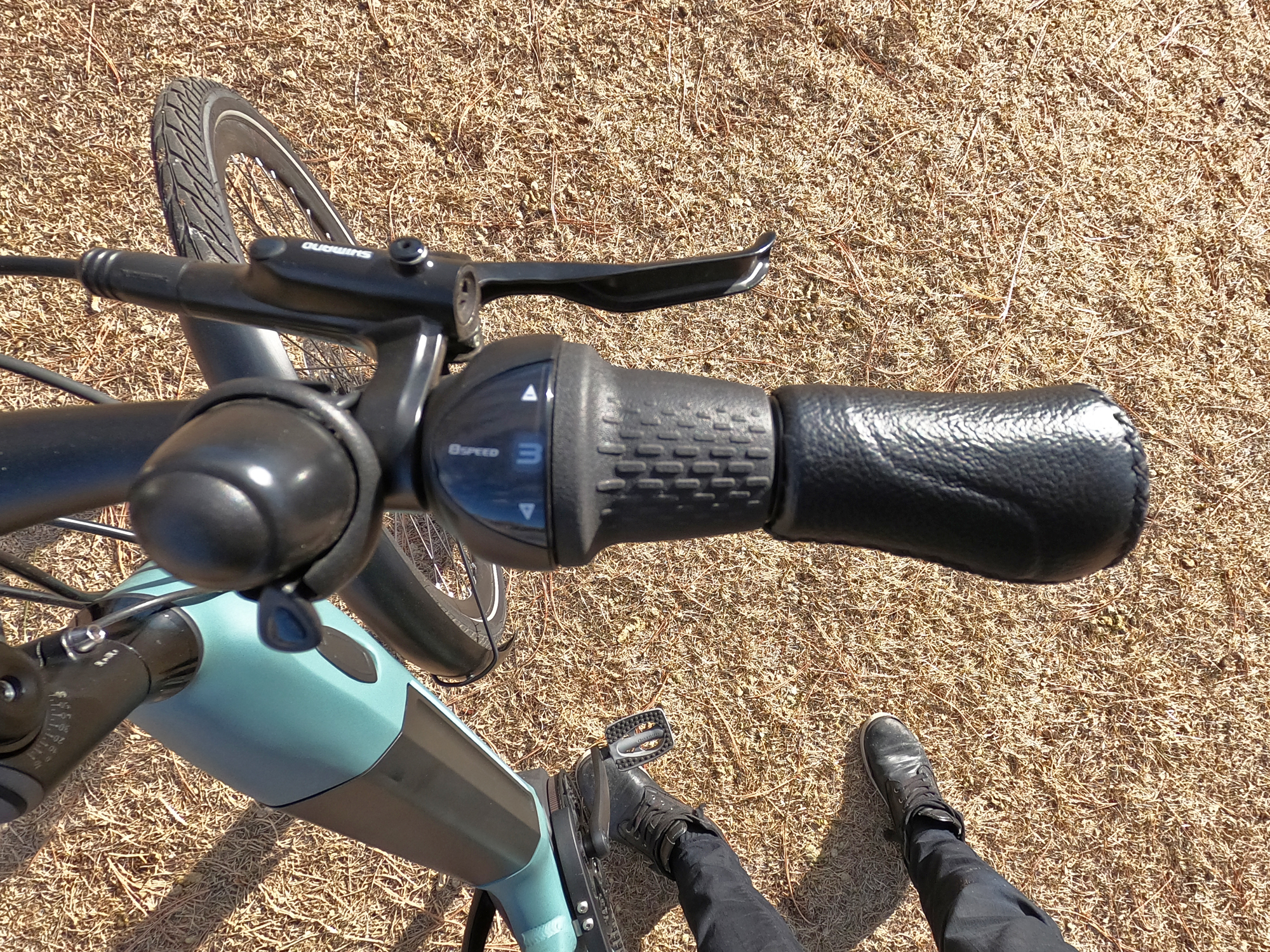

x8 Shimano Nexus SG-C6001-8D Internally Geared Hub, 26 Tooth Rear Cog, 307% Total Gear Ratio, Gear Range Roughly Equivalent to 11-34T CassetteShifter Details:
Shimano Nexus Revoshift SL-C6000-8 on Right Grip, Tactile Rubber with Gearing Window

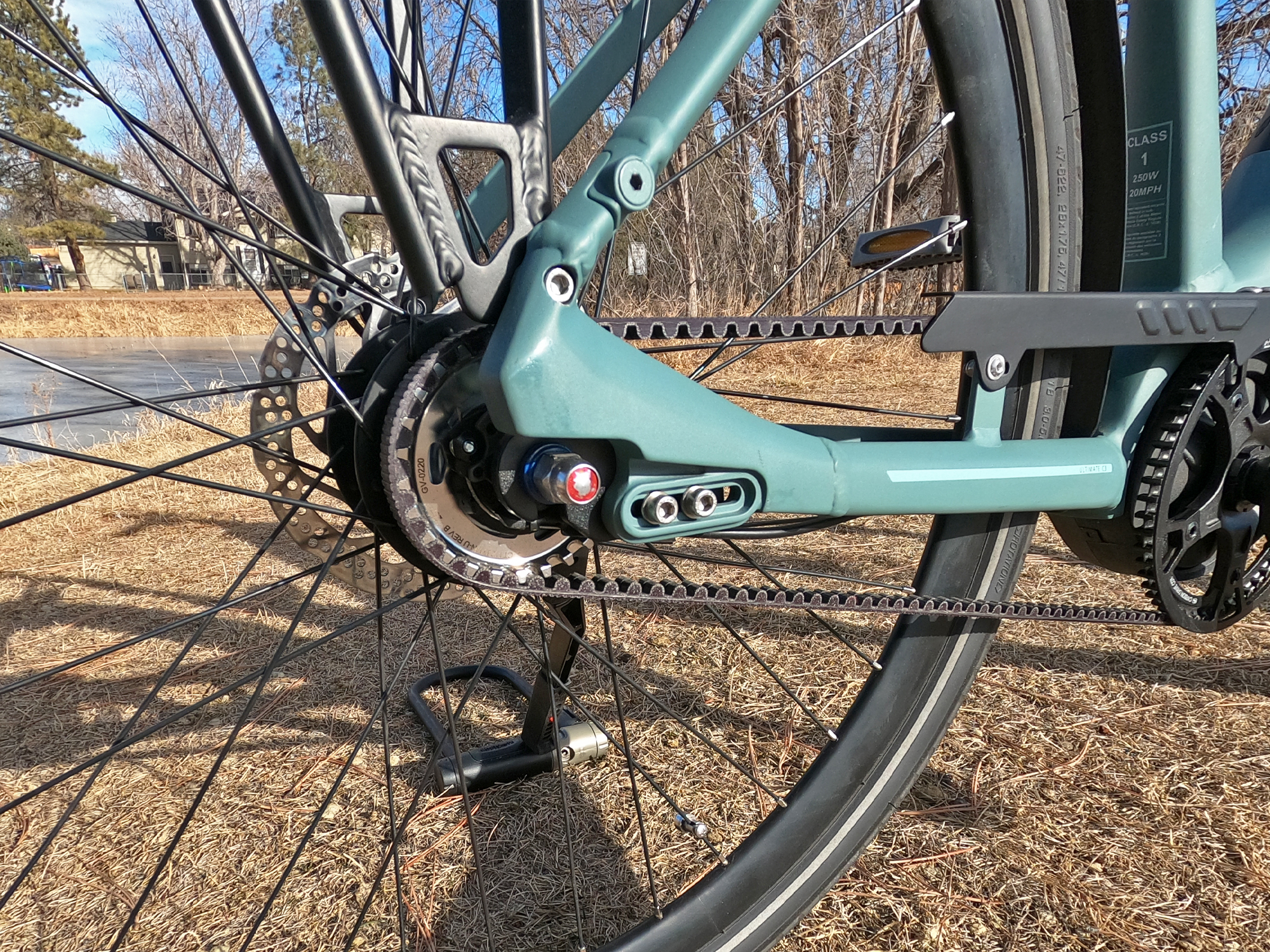

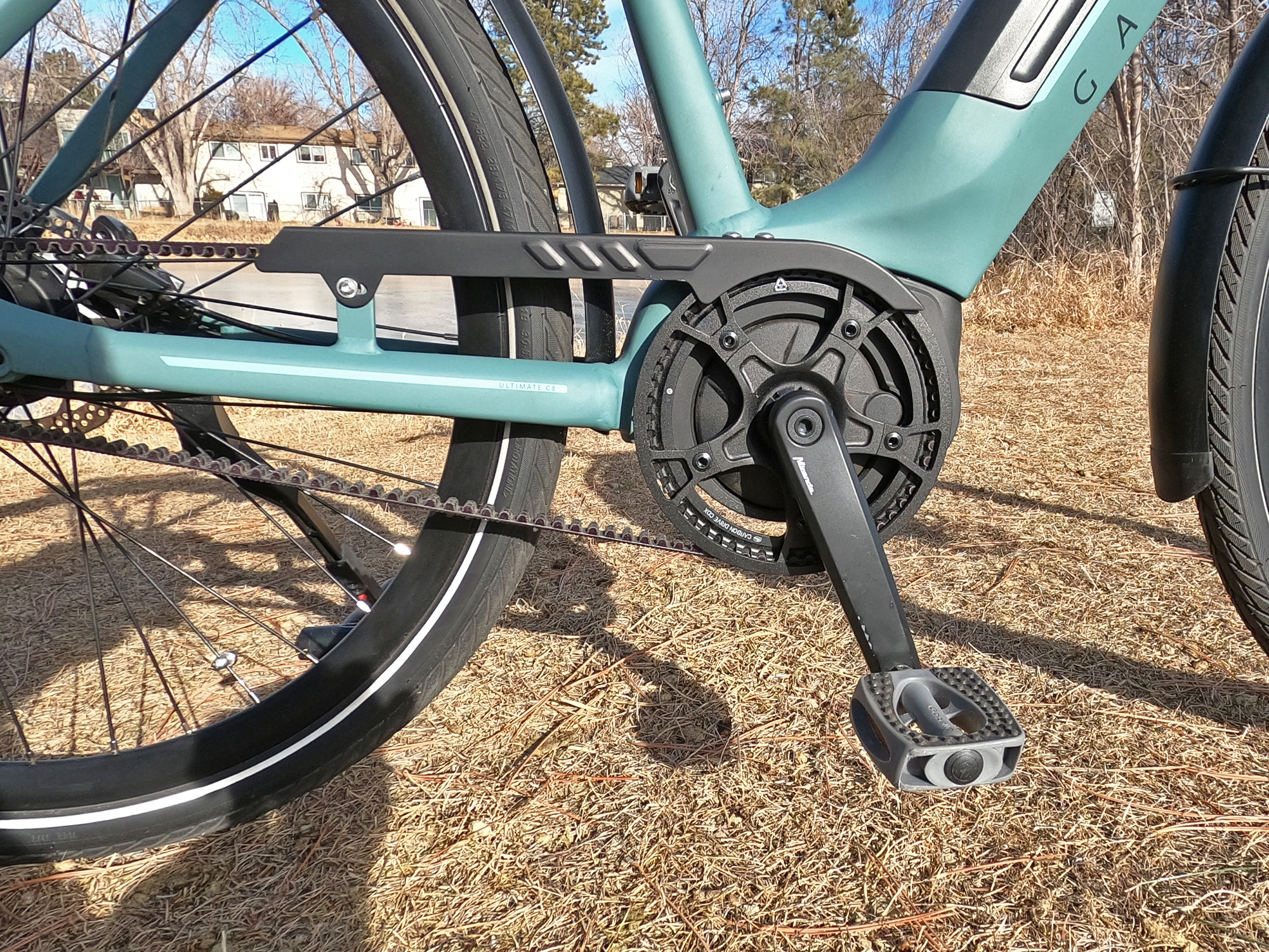

Cranks:
Miranda Forged Aluminum Alloy, 170mm Length Crank Arms, 55 Tooth Gates Carbon Drive CDX Belt Ring Chainring with Alloy Guard, 130mm Bolt Circle Diameter (BCD)

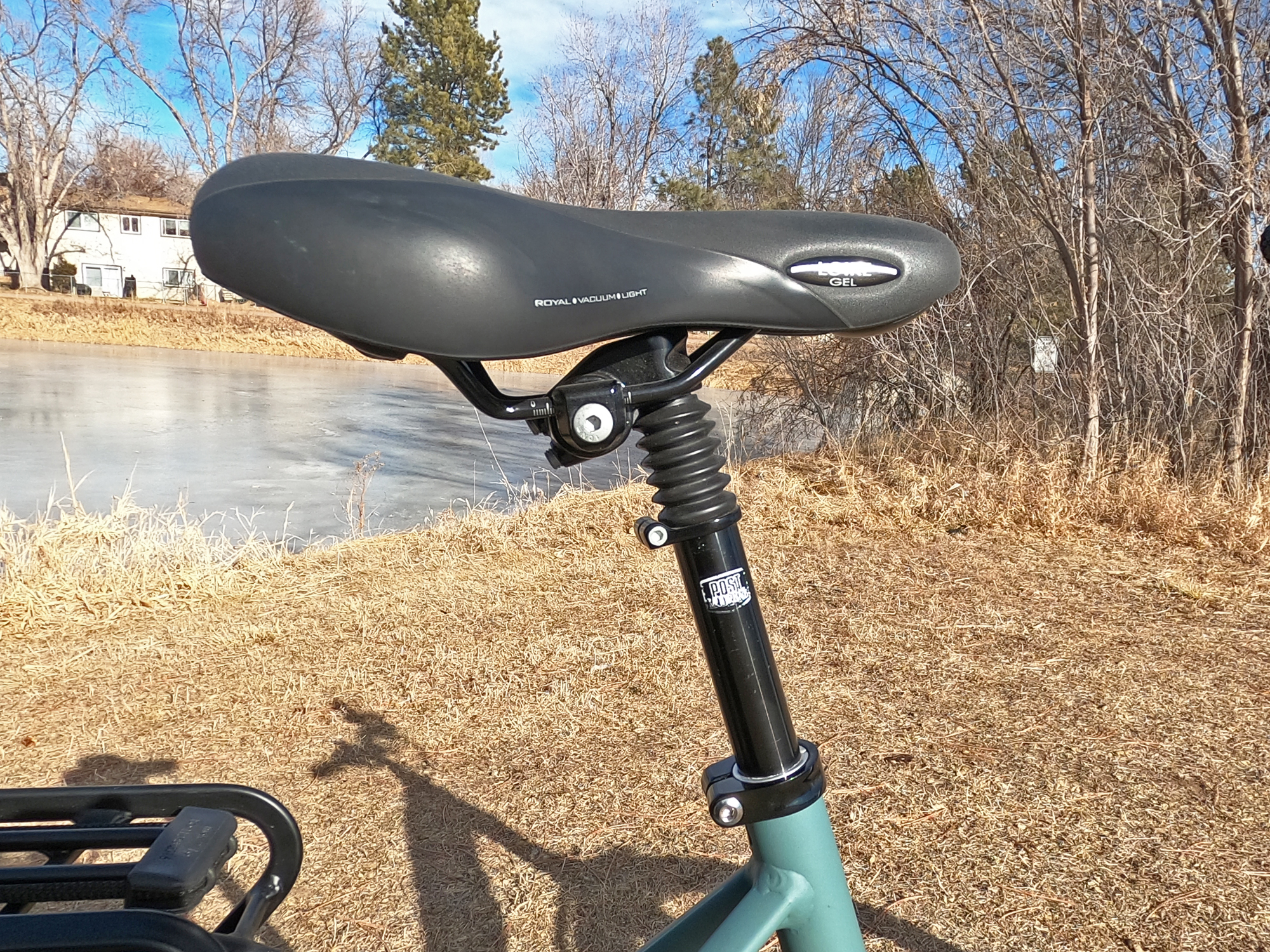

Seat Post:
Post Moderne Suspension Post (40mm Travel, Adjustable Compression with 6mm Hex Wrench at Base), Two Bolt Clamp with two Bolt Rotation (5mm Hex Bolts), 27.2mm to 29.8mm Shim

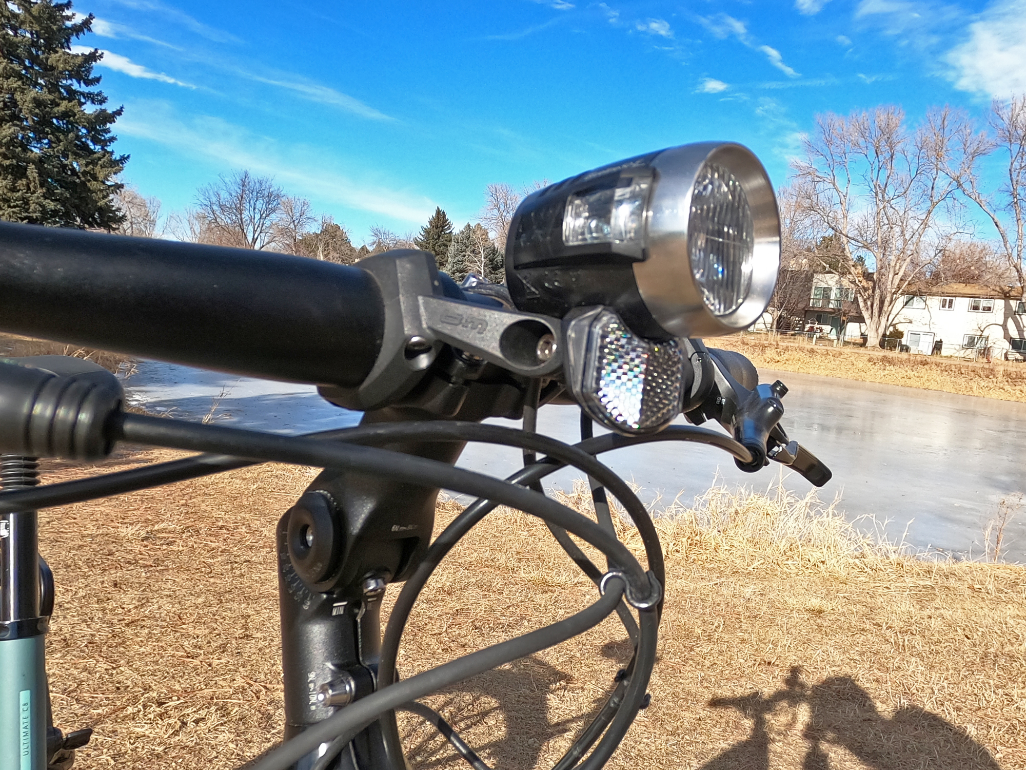

Aluminum Alloy Fenders (60mm Width, Plastic End Caps), Custom Aluminum Alloy Rear Rack (Integrated Double Bungee with Plastic Clip, 27kg 59lb Max Load, Bungee Loops at Base, Fender Support, Pannier Blockers), AXA Defender Frame Lock (Keyed-Alike to Battery Lock), Lightweight Aluminum Alloy Belt and Chainring Cover, Handlebar Mounted Electronically Integrated AXA Blueline 50-E LED Headlight (50 LUX, Side Cutouts, 6 to 12 Volt DC), Rear Rack Mounted Electronically Integrated Herrmans Rear Light (4-LED, Side Cutouts), Ursus Mooi Rear-Mount Tool-Free Adjustable Length Kickstand (20mm Two-Bolt Mounting Standard), Custom Flick Bell on Right

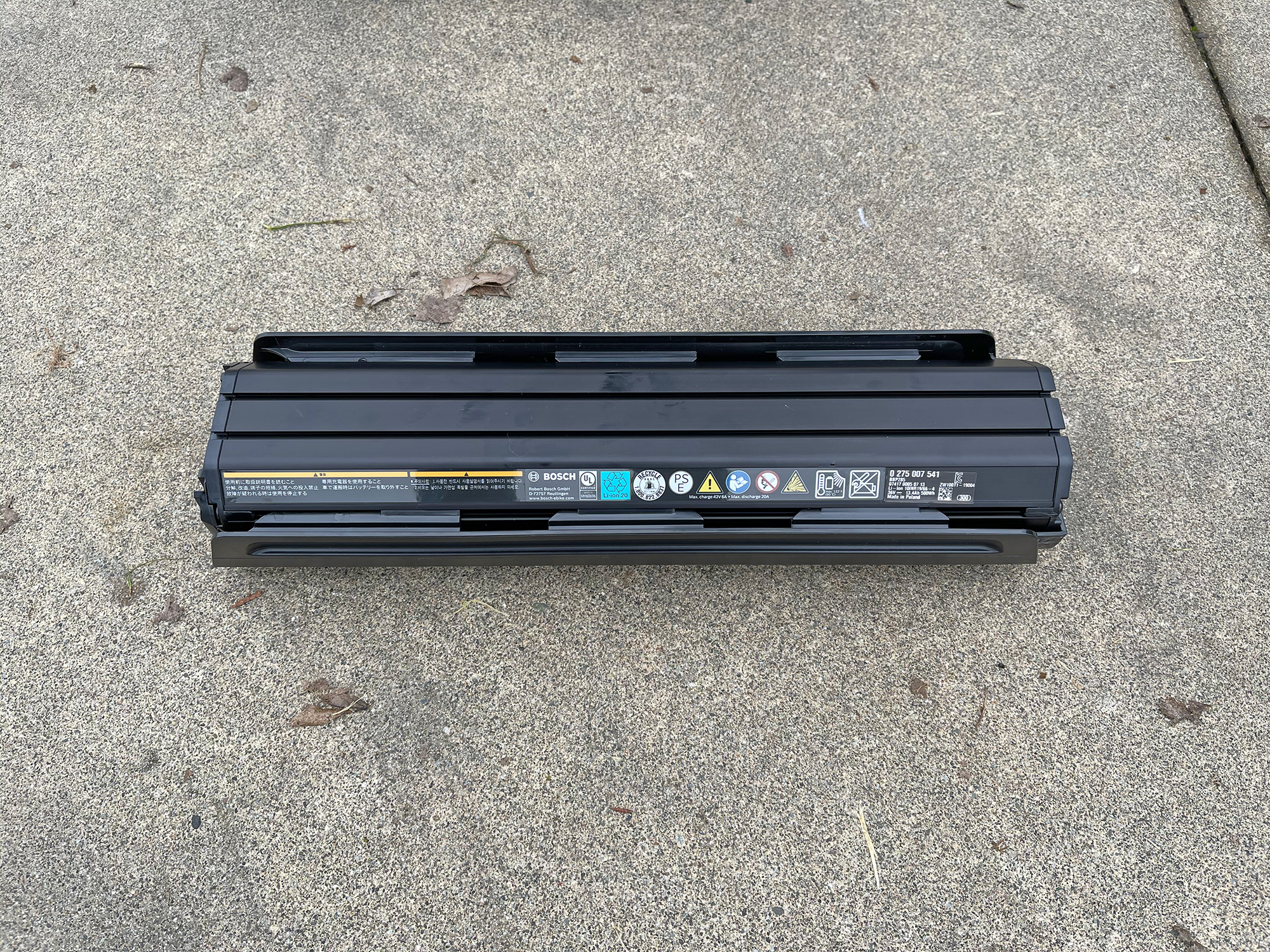

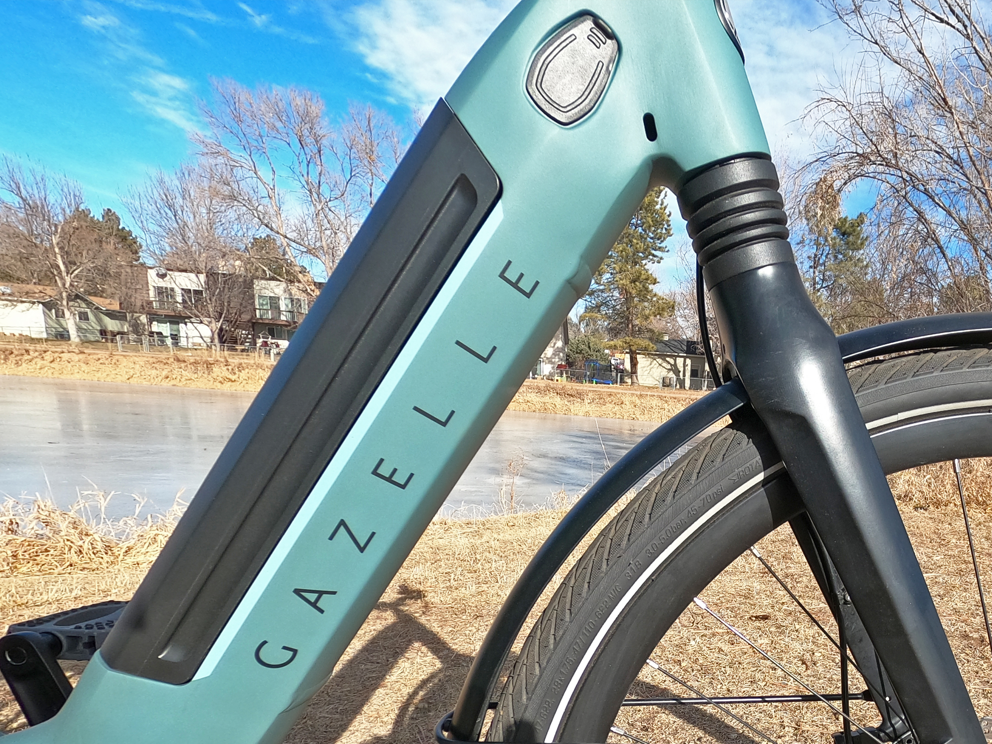

Locking Removable Donwtube-Integrated Bosch PowerTube 500 Battery Pack, 1.6lb 4 Amp Charger, Motor Support Continues Pedaling up to 105 RPM, IP56 Durability Rated (Drive Unit and Display)

7 months agoThe spec summary for the Gazelle C8 alludes to the Nexus gearing as equivalent to 11-42t, whereas the Pros section says 11-36t. Neither is correlated to the front chainring (at 55t, presumably not the same size as the chain version of 55t). I don’t understand the “307% total gear ratio”. The question: what are the specific lowest and highest gear ratios available to the C8 (such that a traditional chain 55/11-36 system would yield 55/36=1.53 minimum and 55/11+5.00 maximum). Thank you.
ReplyCourt
7 months agoHi RDV, thanks for calling out the inconsistency here. I’ve done basic searches on gearing ratio for the Nexus internally geared hub and tried to relate it to a cassette spread. This chart, provided by Shimano, references the 307% ratio that I was trying to reference. When looking at the gear ratio equivalent, I used this source which has an awesome table as you scroll down. It actually looks like the gear ratio equivalent is closer to 11-34 tooth, so I will update the review specs and pros section. Please correct me if you think there’s a mistake with this logic.
ReplyRDV
7 months agoMy own conclusion on the C8 Nexus gear ratios: 1.04 low, 3.19 high. There’s a table at the back of the Gazelle online manual that shows the distance covered by 1 crank revolution for a 28in wheel with an 8 gear hub (as on the C8) to be 2.32m at the lowest gear and 7.11m at the highest. Since 28in = 0.71m, one wheel revolution/circumference covers 0.71×3.14 = 2.23m. Therefore the low gear ratio is 2.32/2.23 = 1.04, comparable to the low gearing in a typical road compact set-up and good for some unassisted climbing in case of power loss/depletion (my main concern).
The high gear ratio is 7.11/2.23 = 3.19, which is a middling ratio for a typical road compact set-up, but seems adequate for this type of bike. This also explains the 307% range, since 3.19/1.04 = 3.07. Clearly the front ring’s 55 tooth spacing for the belt doesn’t correspond to standard chain tooth spacing and shouldn’t be directly compared in approximating a cassette equivalency. A better understanding is gained by matching this gear hub to a typical 50/34 compact set of rings, in which case the equivalent cassette would span from 50/3.19 = ~ 16t to 34/1.04 = ~ 33t. Please do chime in if the above is incorrect.
