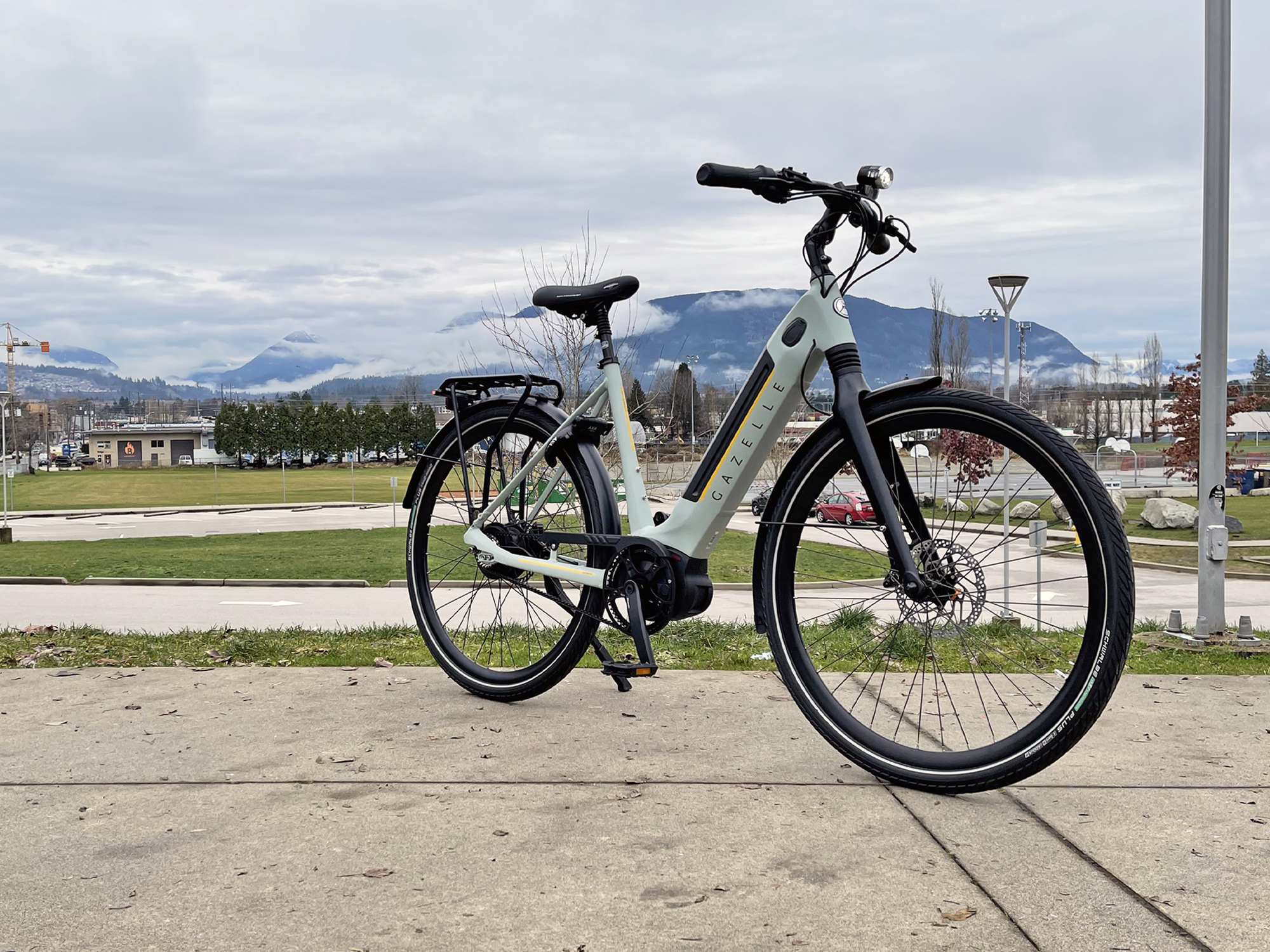

- The Gazelle Ultimate C8 and C380 are two of my favorite electric bikes on the market right now if you’re looking for a city, commuter, or trekking model. This is because they have approachable frames available in three sizes, offer two color choices, feel comfortable, ride extremely quiet, and are sold through shops that provide fitting and post purchase support… Gazelle offers a two year comprehensive warranty (supported by Bosch and enviolo for the C380) and a ten year warranty on the frame! You can just tell that the little details were scrutinized and chosen well when you see the bike, take the battery pack off, see that there’s a memory foam pad at the base to reduce rattling noises, notice the additional supports for the fenders and rack, and ride through choppy terrain to hear how solid and quiet it actually is.

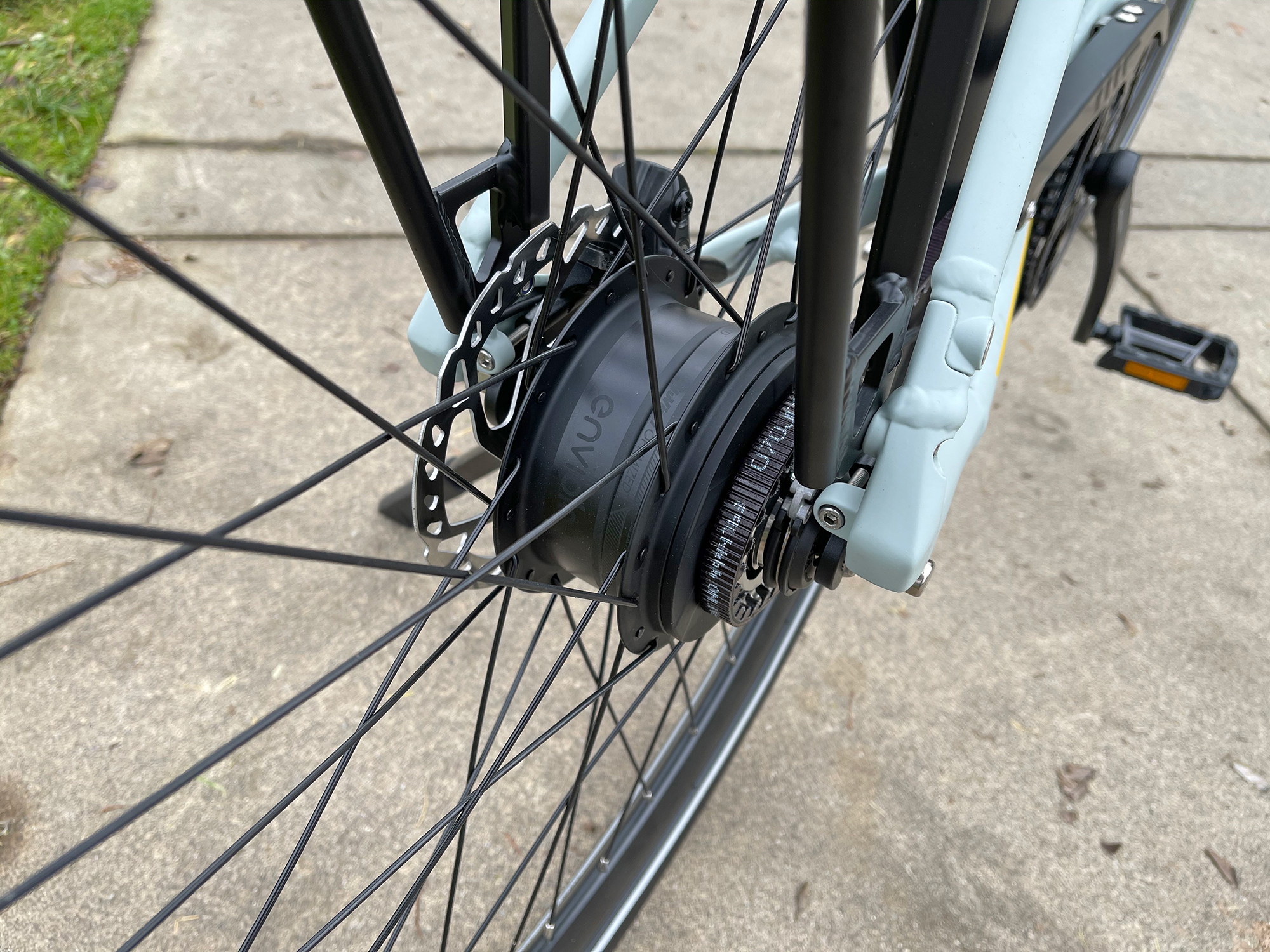

- To make this frame work with the Gates Carbon belt drive system, they had to design a break in the frame (on the right seatstay). This adds a bit to the cost and could compromise load capacity and frame stiffness if done improperly. From what I experienced, it was done well and the result is a super durable, clean, and quiet belt solution vs. a chain.

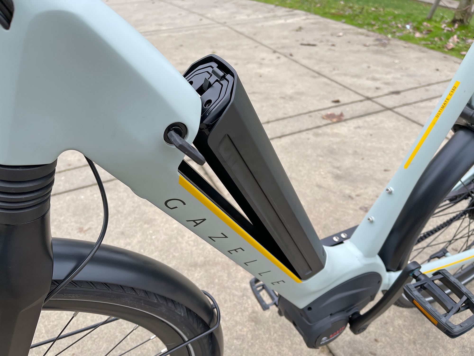

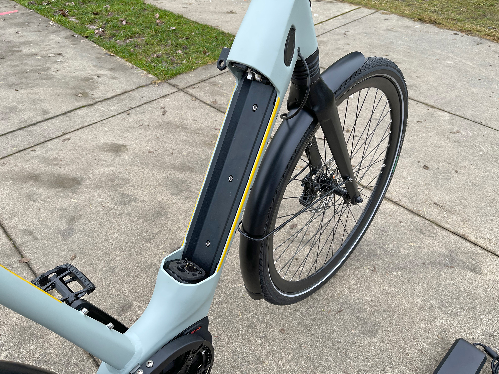

- Along with the beautiful motor integration, the battery pack is also done well. I appreciate that they chose the top mounting pack but still use the security lock so it won’t tumble out. The plastic shield cover is lightweight and blends in pretty well with the dark blue frame. Overall, it isn’t too heavy and the charging port and key ports are both up high so you don’t have to bend over too far to engage with them. Motor and battery weight are both kept low and center for improved stability and handling.

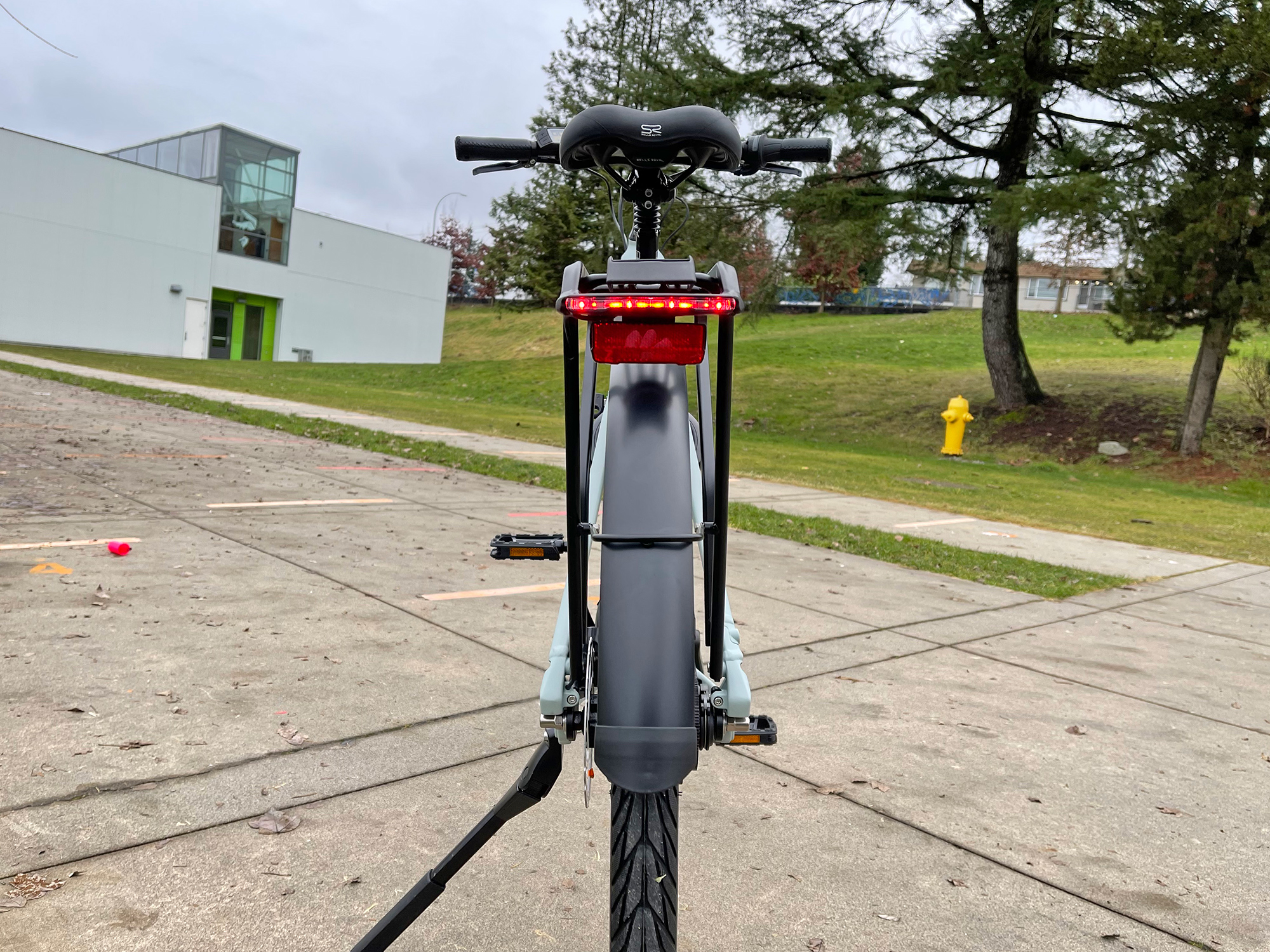

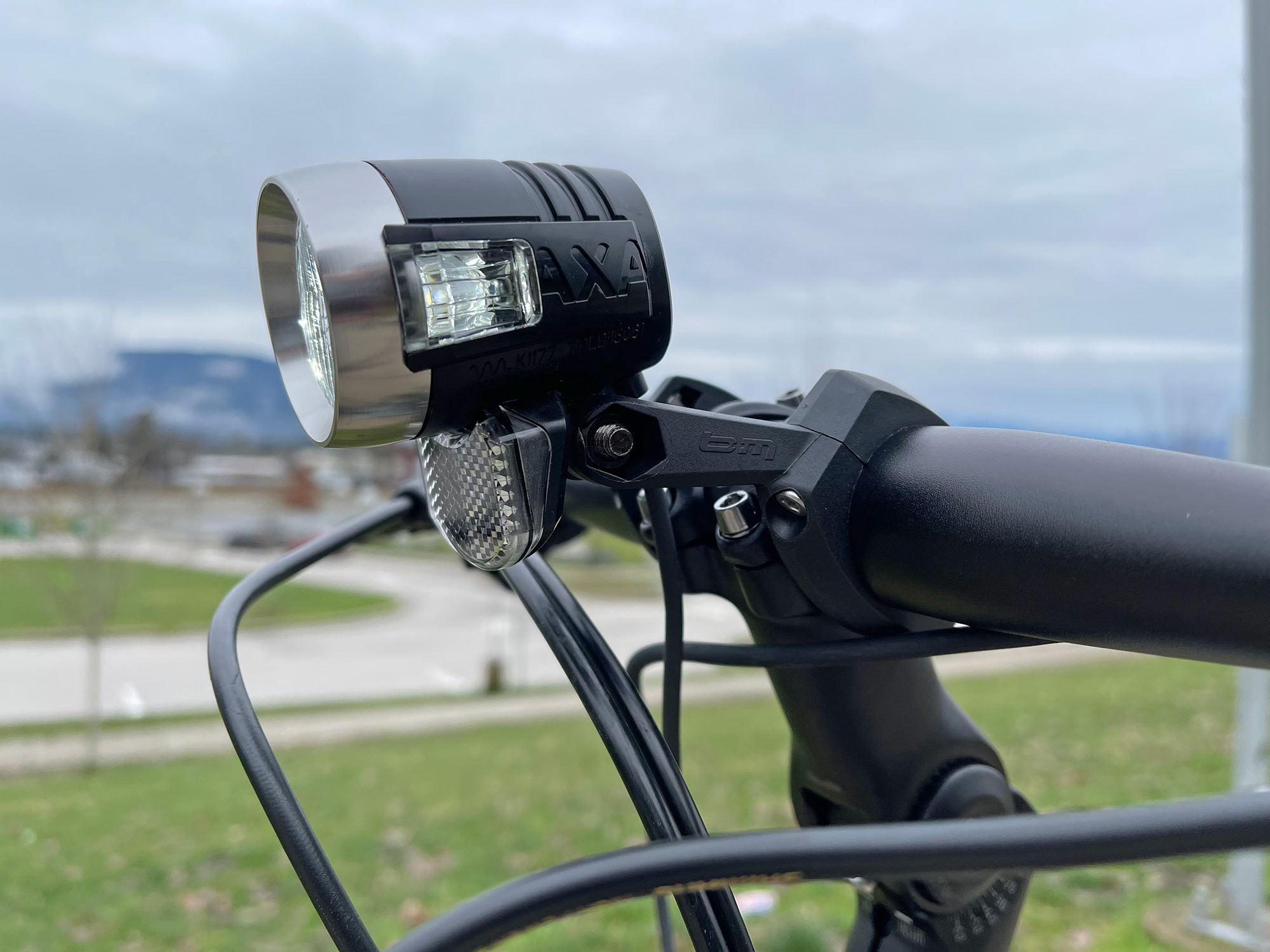

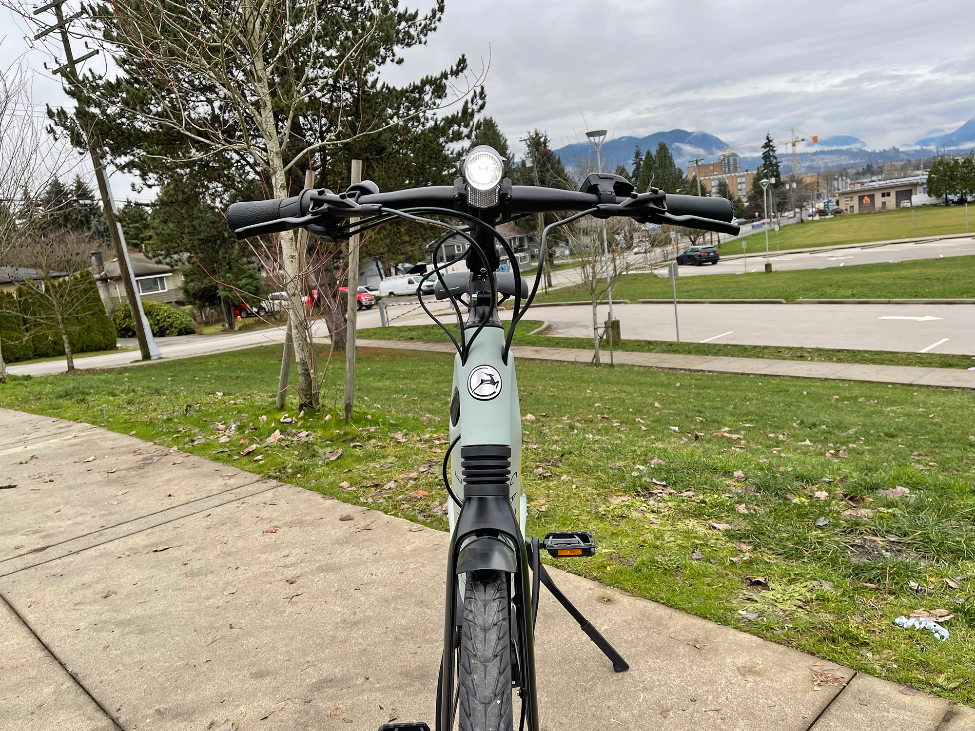

- I love the reflective tires and integrated lights. Gazelle chose a four LED Herrmans rear light that is partially surrounded by metal from the rack itself. This keeps it from breaking if you bump into a wall or take contact at a bike rack. Most rear lights only have one or two LED lights in them. Furthermore, the positioning is high up vs. low and exposed on the fender, and has side cutouts. The headlight is also awesome and mounted perfectly. It puts out 50 LUX and shines forward as well as through windows on both sides. The positioning on the handlebar just above the stem helps you be seen more easily by cars. Again, both of these lights run off of the main rechargeable ebike battery as you’d expect.

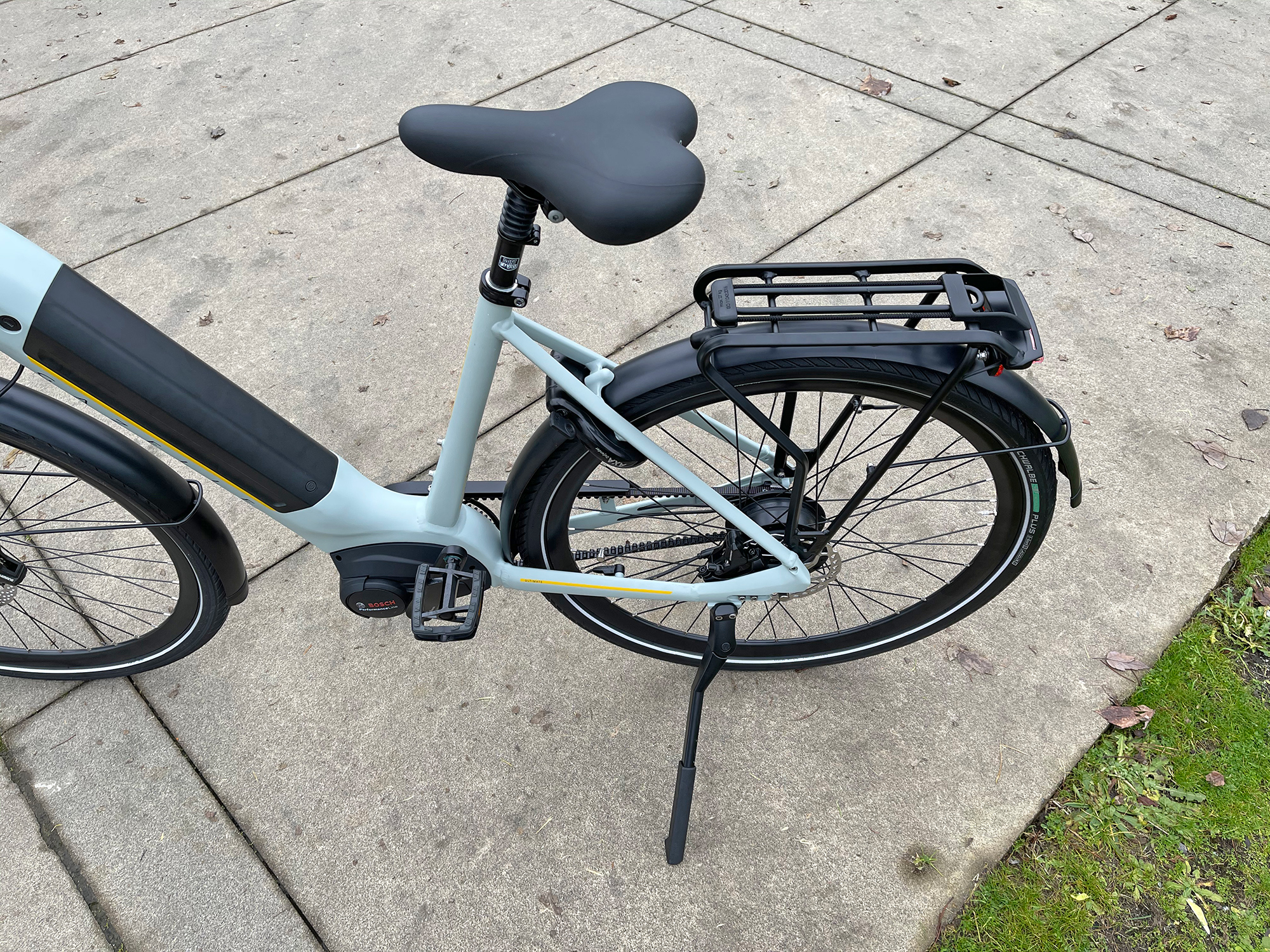

- The rear rack is excellent, and appears to be fairly custom. It offers above average weight capacity at 27kg (59.5lbs), has a flat top for trunk bags or child seat like the Thule Yepp Nexxt Maxi, features a double bungee with plastic handle attachment for quick and easy use, also has bungee loops at the base (which can be used with some side panniers that clip at the bottom to reduce flapping and bouncing), and the tubing design is close enough to standard gauge that I think many clip-on panniers would work. The rack even supports the rear fender in two places to help reduce rattling noise! It’s the best rack I’ve ever seen on an ebike.

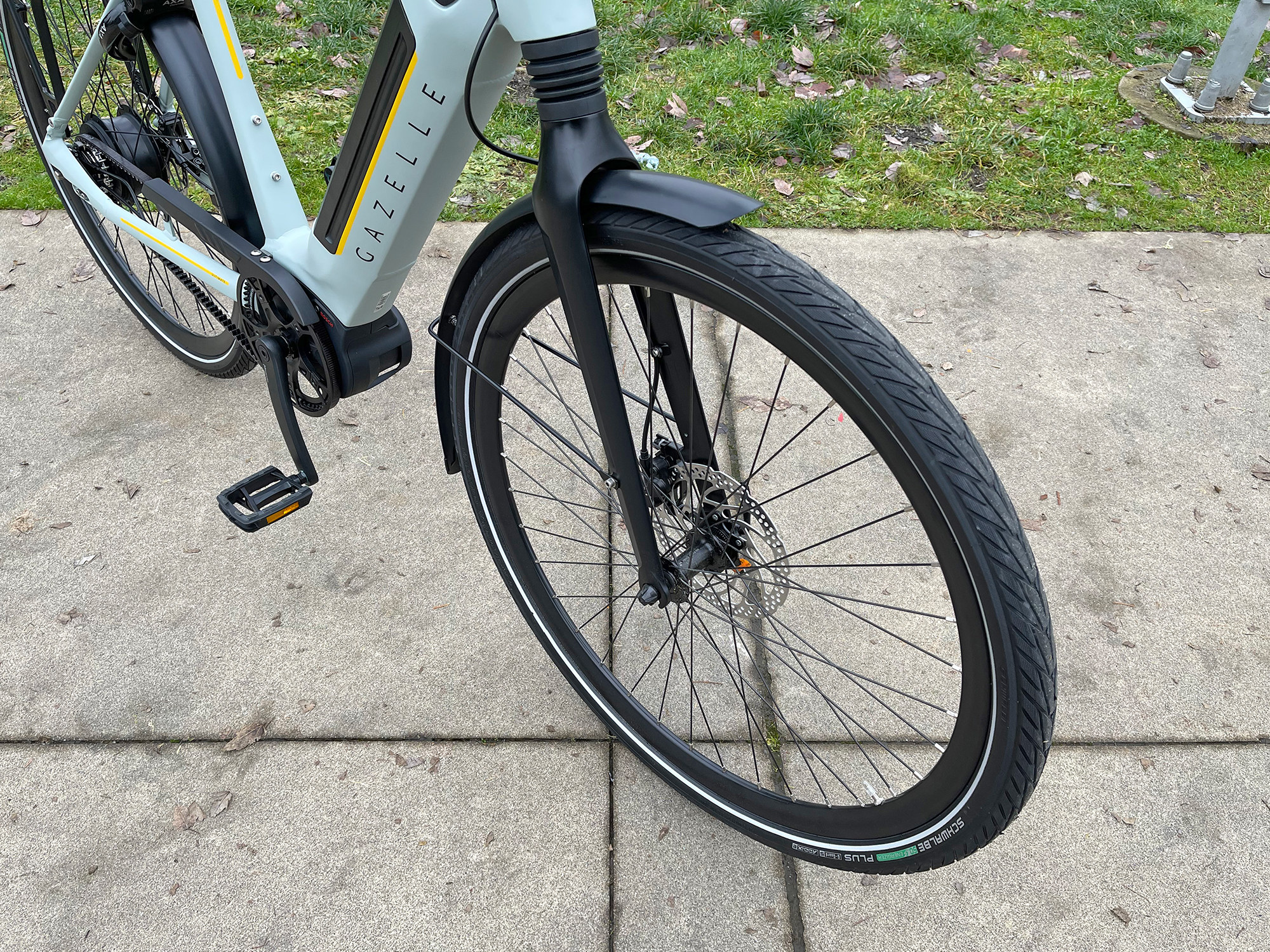

- The fenders on this ebike are also excellent. They’re wide enough and long enough to offer great coverage, they don’t rattle, and they won’t rust because they are aluminum alloy. I also appreciate the minimalist chain cover (belt cover in this case) that matches the look and color of the fenders and other parts of the bike.

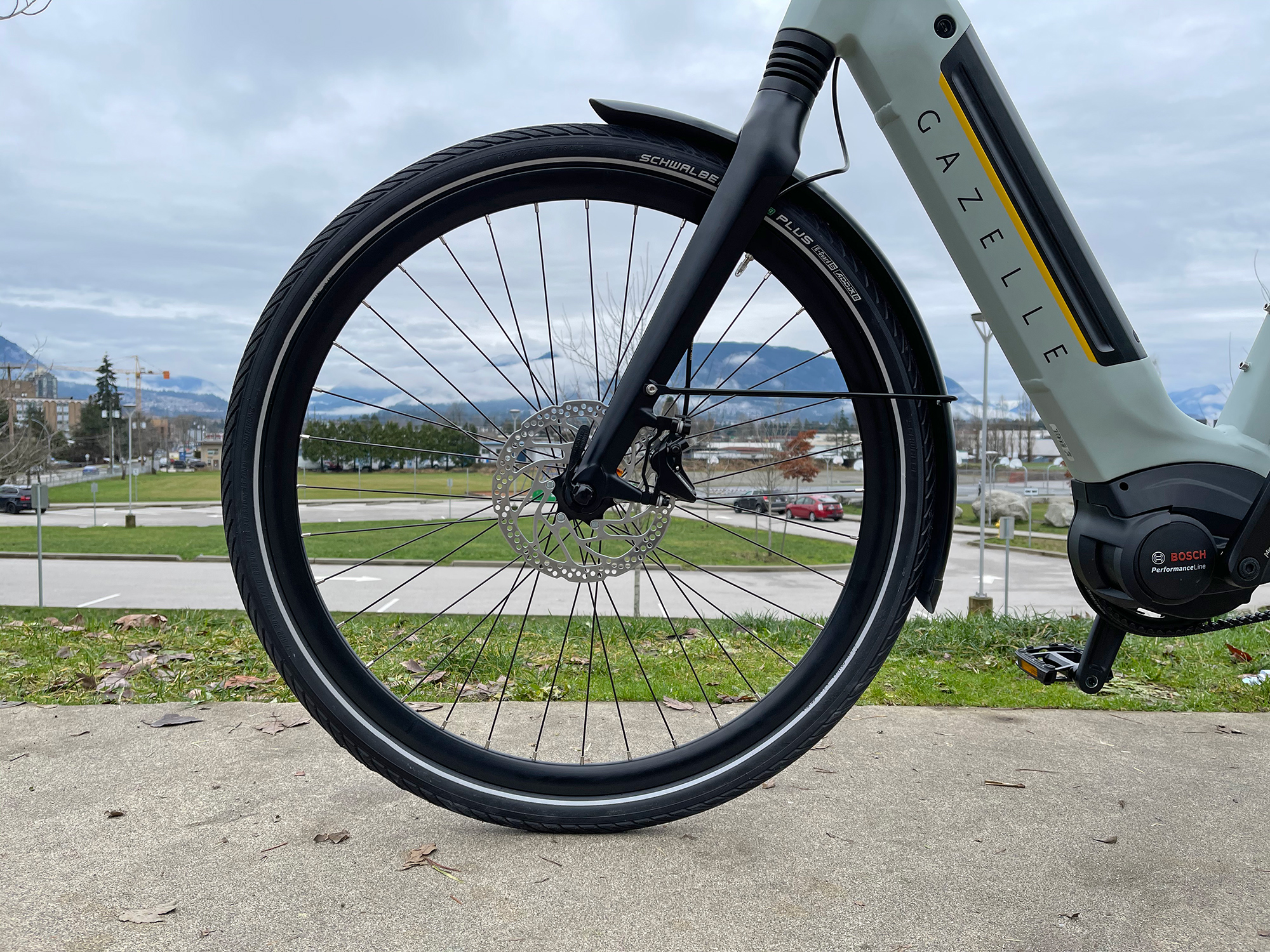

- Great wheel choices. The black spokes and rims match all of the other black hardware ont he bike. The rear spokes are a bit thicker to help support the rack. The rims are mid-dish and aero design for aerodynamics (like the bladed fork). Gazelle spent extra for name brand Schwalbe Energizer ebike tires rated up to 50km per hour (30mph) for stability. They use premium ADDIX rubber, have puncture protection, and are 1.75″ wide for improved stability and comfort with extra air volume. The large 700c (28″) wheel size delivers a lower attack angle that smooths cracks and other bumps in the road.
- Hauling gear, riding for extended periods and at speed, riding in the rain… this calls for nice brakes. The Ultimate C380 comes with upgraded Shimano hydraulic disc brakes with a larger 180mm rotor up front. This improves leverage for stopping (smoothing it out, requiring less hand effort), and also cools faster. The rear 160mm rotors are adequate, but both calipers use four pistons (quad piston) for greater surface area and more even brake feel. They require less hand effort and both brake levers offer adjustable reach. Both levers are two or three finger design which means you can actuate them with just a cuople of fingers and use the others for steering and simply holding on. These are the type of brakes I’d normally see on a mountain bike.

- Sleek and beautiful visual appearance thanks to internally routed cabling, premium satin paint with tasteful minimal accents, and the flawless integration of the PowerTube battery into the downtube. The kickstand choice was superb, as it is positioned clear of the left crank arm (so it won’t cause pedal lock), and offers tool-free adjustable length fo the bike will be stable in many parking situations. I also appreciate the bottle cage bosses on the seat tube here, some ebikes completely skip them, but it’s a nice option to have if you can design around the battery and not compromise frame strength or seat post positioning options.

- The enviolo NuVinci CVT hub system used here is using a more basic twist shifter mechanism that does not include an indicator window or LCD readout system. This means that you won’t know what “gear” the bike is in when you start riding and instead, you have to kind of twist and guess. NuVinci does offer a little infographic readout and electronic display for some of their other models, so I guess this one is designed to be less expensive and maybe more durable or reliable? It’s just more basic and leaves you guessing a bit.

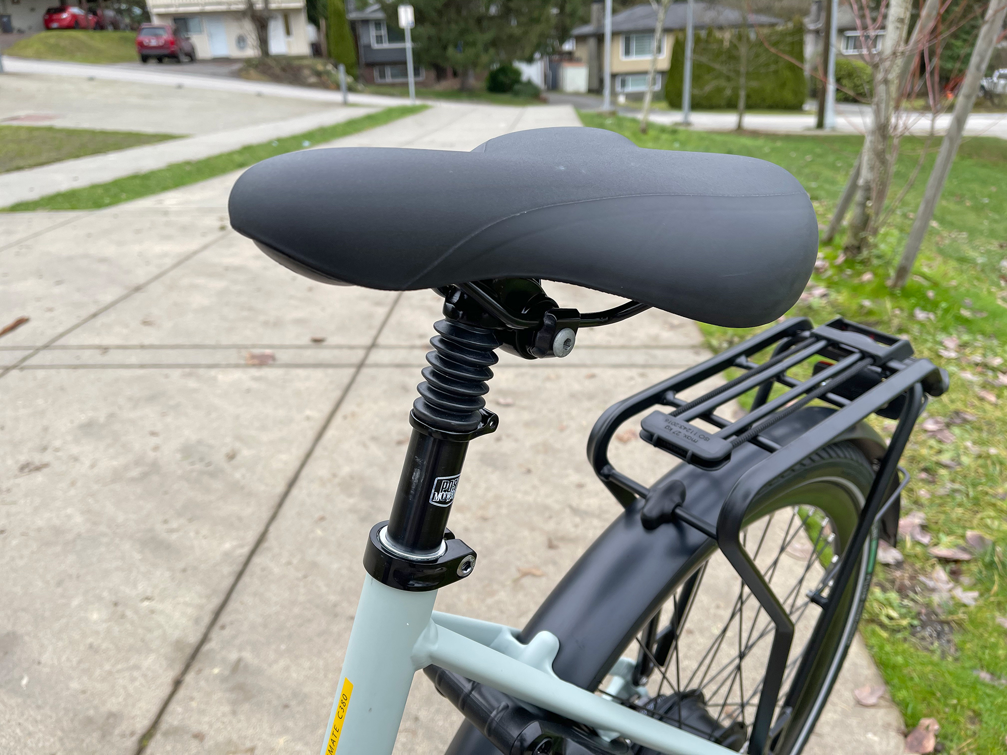

- The suspension seatpost from Post Moderne is pretty basic, even though it’s a brand that I recognize and does have preload adjust in the base. The ride experience for me was more abrupt when the seatpost activated… it wasn’t as buttery and smooth for all of the little bumps, it has more stiction when sliding up and down and sort of locks in the up or down position. Perhaps that would change based on rider weight, age of the post, and temperature outside?

- The lack of a quick-release skewer for the seatpost means that adjustments are more difficult and time-consuming, requiring you to keep some tools handy. This can be especially annoying if you share this bike with a differently-sized family member and need to adjust the seat and stem on a regular basis. Of course, the trade-off here is that the upgraded suspension seat post saddle is less of a theft risk. Interestingly though, the front wheel does use quick release… so that is a theft risk.

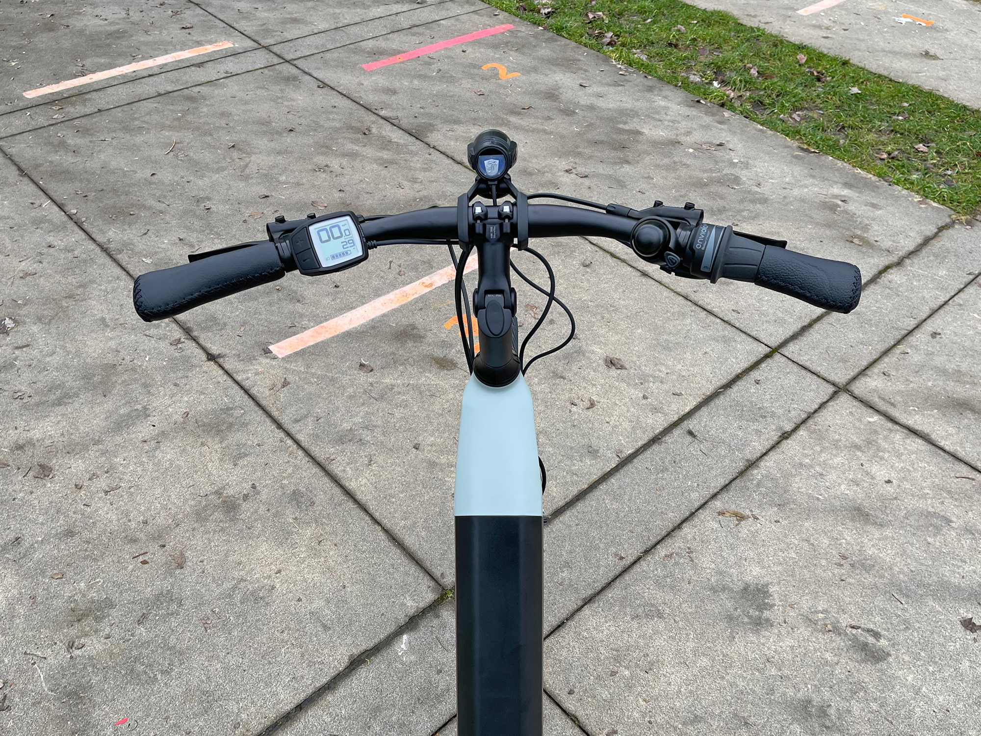

- The Bosch Purion display is not removable, offers limited readouts, lacks a USB port for charging personal electronics, and is not Bluetooth compatible for use with the Bosch smartphone apps. You can find some of these other features on the Intuvia, Kiox, and Nyon models which you can pay a shop to install for you here, since Bosch has an open system. All things considered, the small and basic Purion display is nice on this bike because it leaves the stem area clear for the light to be mounted up high on the handlebar, which maximizes your visibility and safety.
