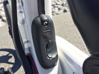

Powering the bike is an upgraded 297 watt hour battery pack consisting of Lithium-ion Panasonic cells. These are best in class batteries that are known for reliability and light weight. The energy density of battery cells has increased over the past several years and it’s cool that Gocycle has taken advantage of this to add range to their bike. The pack is not easily removable but shops can pull it out for service or replacement. This is one area of consideration… many times I’ll store my ebike in one place and bring the battery inside to charge it. Removing the battery would also reduce weight, making it easier to lift and load into a car or other transporter. But that’s the beauty of the Gocycle, at 36 lbs with the battery installed, it’s much lighter than a lot of ebikes are without their batteries. I had no problem lifting it and was impressed with the snap-on wheel design. Each wheel has three quick release levers and there’s a spinning disc that secures the levers. Just behind the seat tube is a little charging plug port with a rubberized on/off button (hold for a couple seconds) and an LED charge level indicator with four dots. These same four dots are replicated on the handlebar dashboard. And this is where we start to see compromises in operation and understanding for simplicity and style. Four dots means 25% increments… which is a lot different than a percentage indicator.

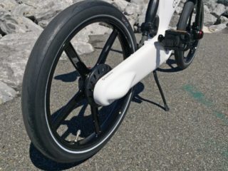

- The chain is completely enclosed in the rear portion of the frame so you won’t get your pants dirty or snagged when pedaling AND you won’t get greasy when folding and lifting the bike

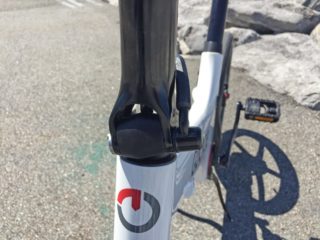

- The stem can be angled forward as well as telescoped upwards… it’s a unique design that can accommodate shorter and taller riders alike and it did not feel loose or wiggly during my test rides

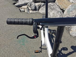

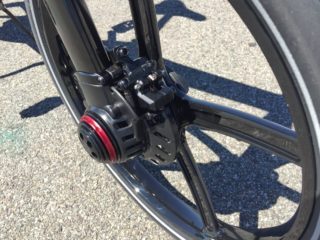

- The hydraulic disc brakes on this bike work as expected, easy to actuate and quite powerful, they have adjustable reach levers to fit large and small hands (or those who ride with gloves)

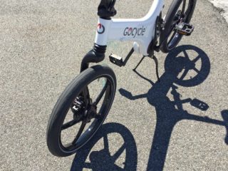

- Mid-suspension design balances weight and simplicity with comfort and foldability, the bike doesn’t feel flexy but you do get a cushioned feel because of the bumper shock and medium-width tires

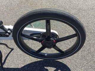

- Clever wheel attachment makes changing flats a breeze and removes the challenge of alignment and over-tightening that standard quick release presents, the Gocycle Pitstop lock system is very cool

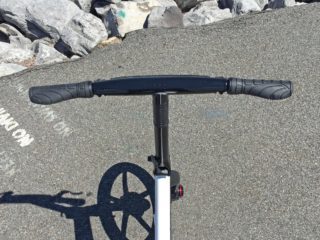

- The G3 has a cleaner cockpit than the G2 with ergonomic grips that blend right into the twist-selectors and LED display section, you have the option of downloading an app for more features but I was just fine without and appreciated that it wasn’t distracting

- The wheels have a sliding ring that shows a lock icon in the locked or unlocked position so you can quickly tell if the bike is ready to ride… and there’s a threaded hole for adding a screw to secure the wheel if you don’t plan on removing them frequently

- The battery is not easily removable, so you pretty much have to bring the bike inside or lean it near a power outlet to charge it… and that’s not terrible given the size and weight of the bike but might be inconvenient if you have to park at a bike rack

- The motor is likely a canister drive and I was told it’s gearless which produces a bit of cogging but apparently they also have a freewheel system in there, the bearings are said to be higher quality with tight rubber seals and can produce some drag when new (as shown in the video review)
- It sounds like some of the first G3 models have a 2 Amp charger while most of the newer ones will have a 4 Amp charger which will fill the bike faster
- You don’t get speed, odometer and other trip stats by default with this e-bike, you need to download the app and use your smartphone but there isn’t a charging port on the bike (and the bike’s battery isn’t especially large at 300 watt hours) so your phone will drain

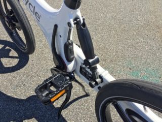

- The front-folding kickstand stays out of the way and holds the bike well but is also a little tricky to get down with your foot… I noticed that one of the plastic caps had come off on our demo bike during the review just from using the kickstand a few times
