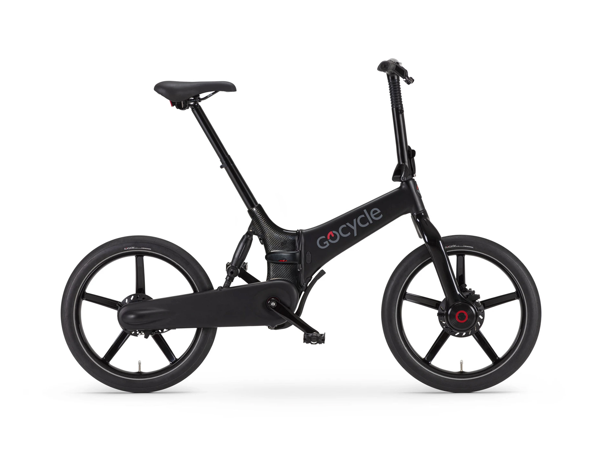

- This is a purpose-built electric bike developed by a former Mclaren Cars Ltd. design engineer named Richard Thorpe with quality, portability, and aesthetics in mind. It definitely stands out from the rest. Gocycles tend to cost more than other folding ebikes, but their frame materials, motor design, battery technology, braking systems, and user interface (with smartphone app) really set them apart. Additionally, Gocycle offers a wide range of custom accessories including racks, bags, and carrying cases that provide maximum utility.
- The G4i is a fourth-generation product with higher capacity battery pack, improved low-end motor torque, redesigned controller, reduced noise, and optimized folding design that is cleaner and faster than before.

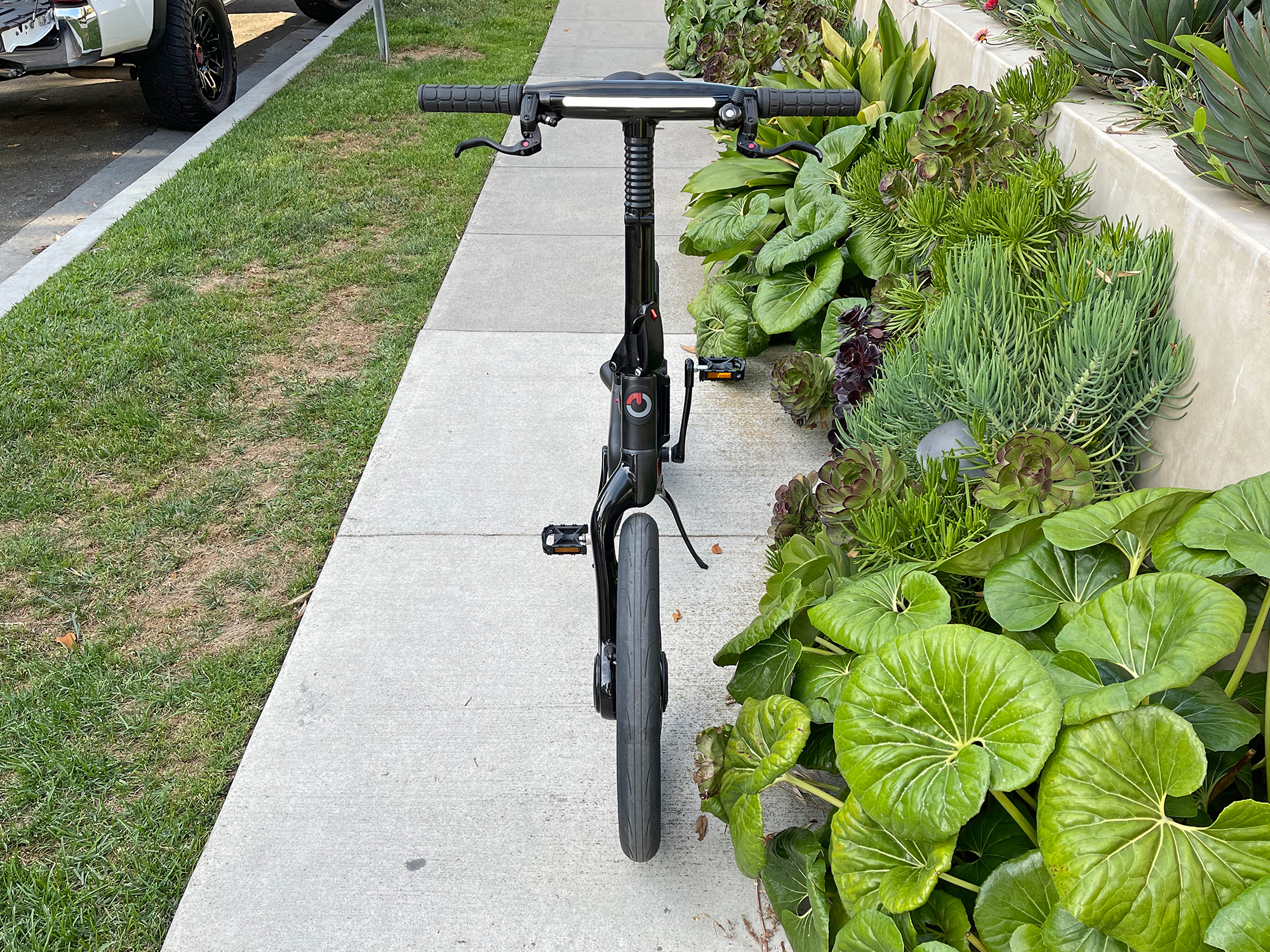

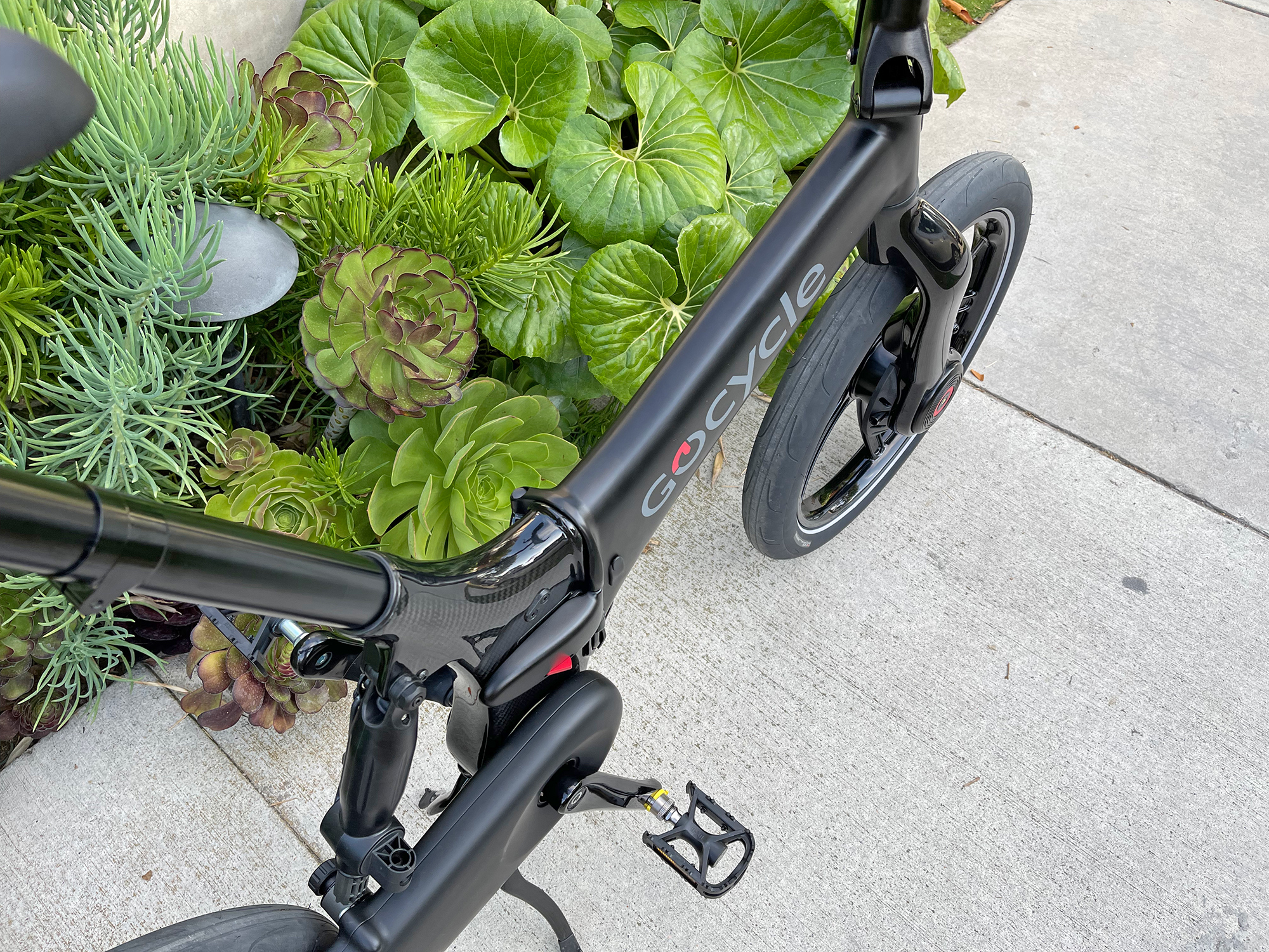

- The bike looks beautiful. All of the electrical wires, shifter cables, and brake lines are internally routed through the custom made frame. There’s no clunky display panel strapped to the handlebar that could get cracked during folding and transport, even the kickstand was custom designed to hug the frame and disappear visually.

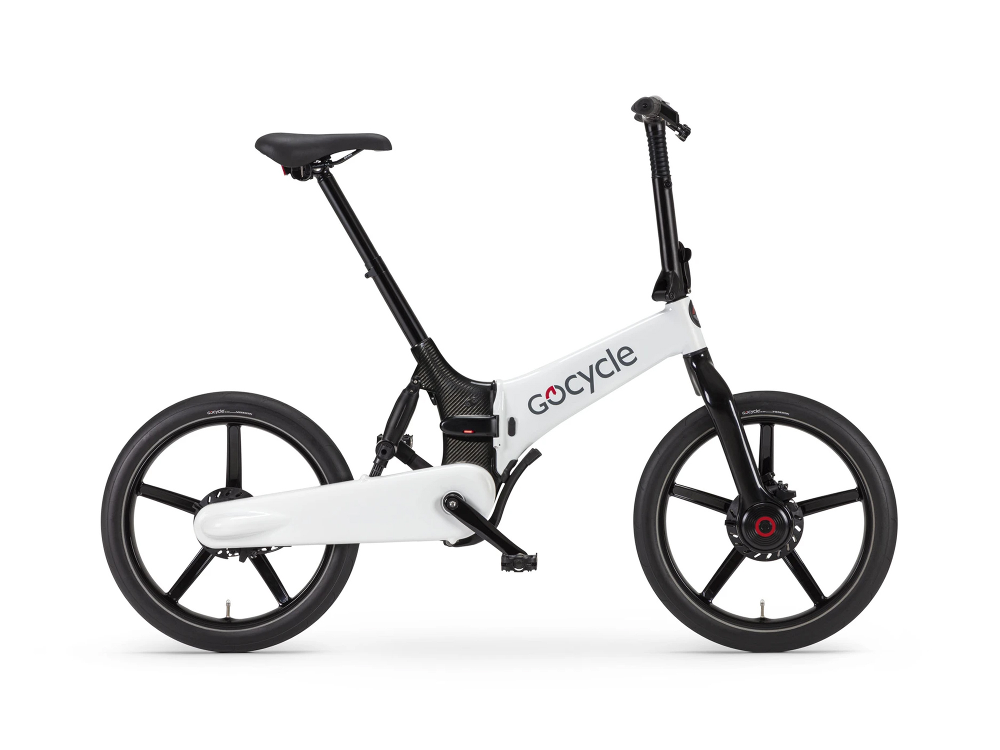

- There are three beautiful colors to choose from, and the white is probably the safest for people who commute at night. I love that the bike has reflective tires and an integrated headlight with four modes (low, low blinking, high, high blinking) that is high up, large, and points where you steer (since it’s basically a part of the handlebar). This integrated light is more about being seen, but Gocycle sells optional Supernova front light that will illuminate the path. There is also a rear light option.

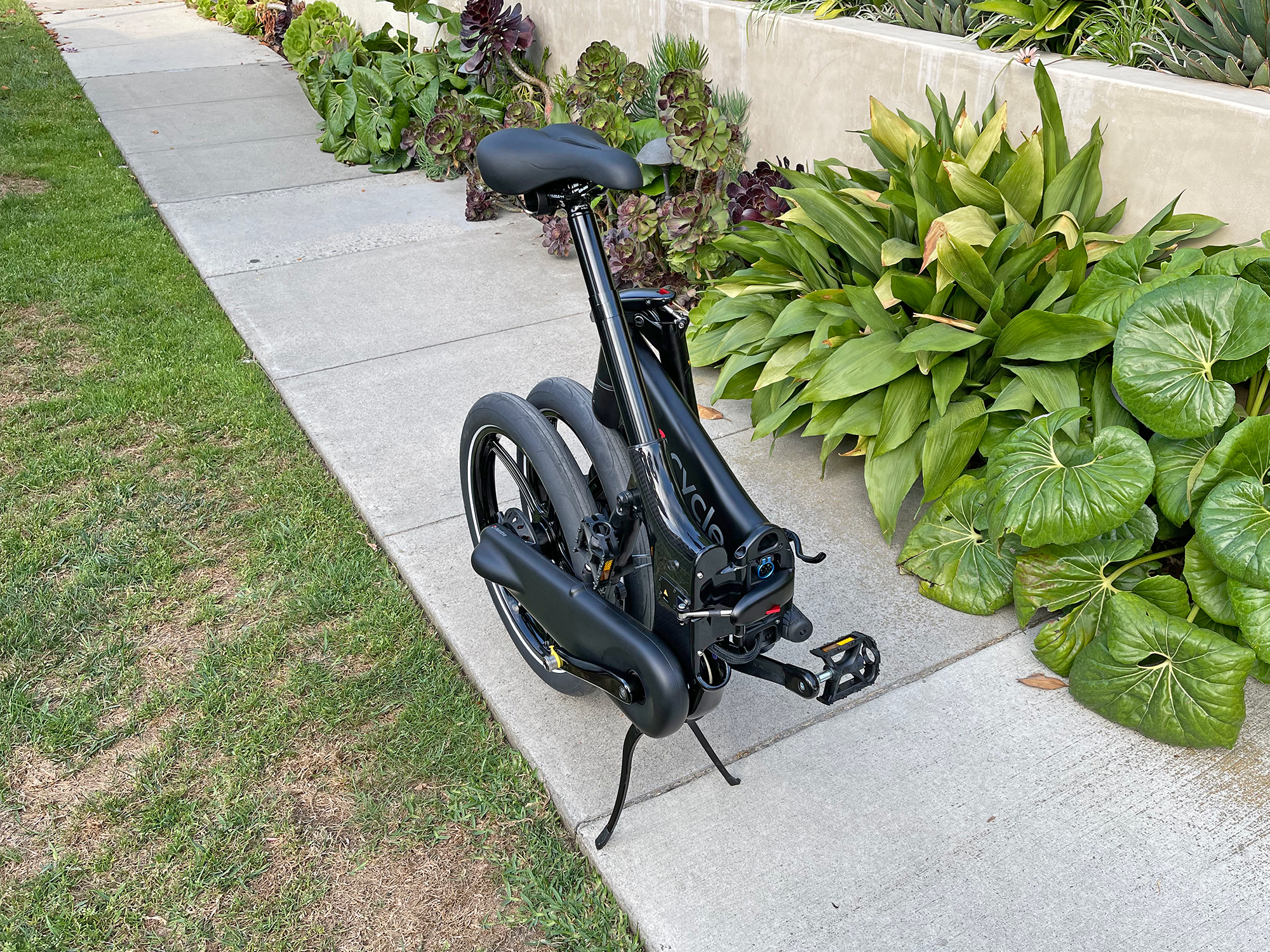

- I weighed the bike at just 38.8lbs, which is extremely light for any electric bike. Some folding models appear small, but still weigh a lot. This one is easier to fold and lift as a result of the low weight. Gocycle uses magnesium, carbon fiber, and high quality plastics to achieve their design and weight goals. I believe that the G4i also utilizes more stainless steel and alloy hardware than competing products, to eliminate corrosion and rust.

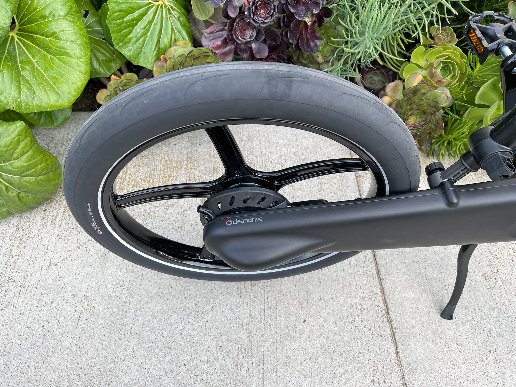

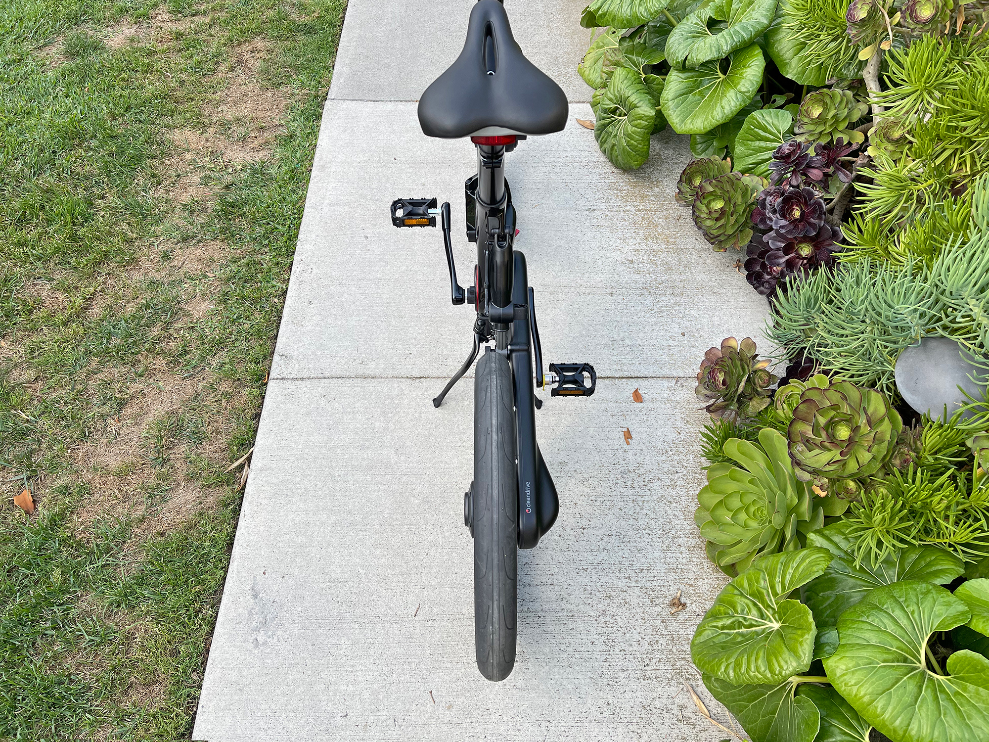

- The chainring, rear sprocket, and chain are all fully contained in the “clean drive” casing that reduces noise, protects the hardware, and ensures that you won’t drop the chain or get your hands greasy when lifting and folding. This concept is also applied to the disc brakes and rotors, which are both located on the drivetrain side of the bike vs. non-drivetrain (as they are on most bicycles). It’s easy to overlook the little changes that were made, but they all add up to a bike that won’t get damaged as easily when folded and stowed. Note the rubber band system that keeps the bike folded, so it won’t rattle around. This rubber band stows nicely when the bike is unfolded.

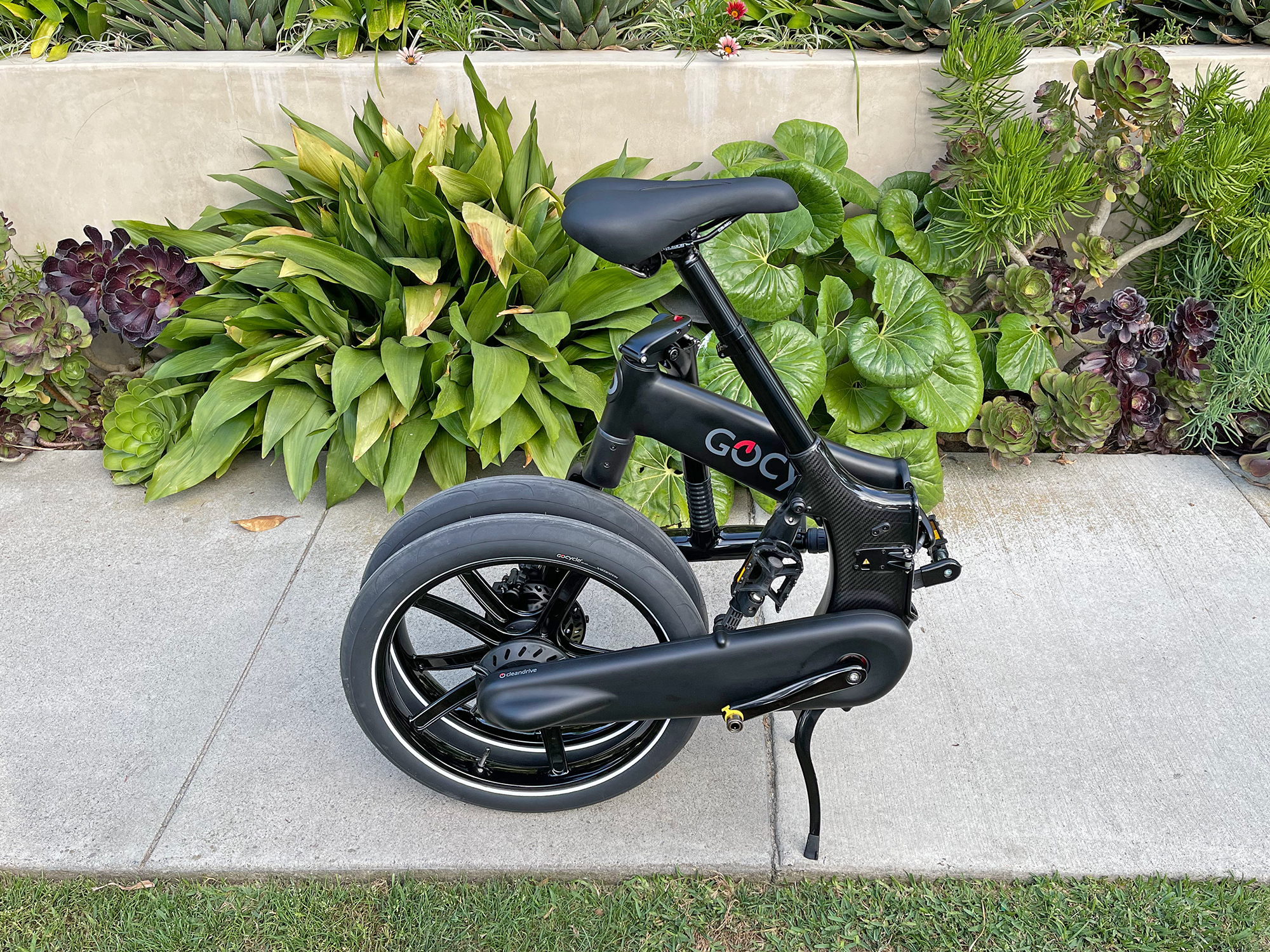

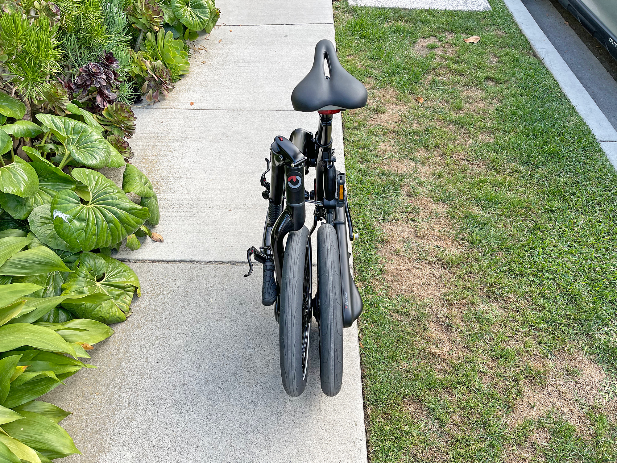

- The half-fold design from Gocycle is an improvement in my mind, though it’s not as fancy or unique as their inward folding concept. With that design, you have to remove the wheels and then fold the frame in on itself. The bike could get more compact by doing this, but your hands would usually get dirtier and it definitely required more time and effort.

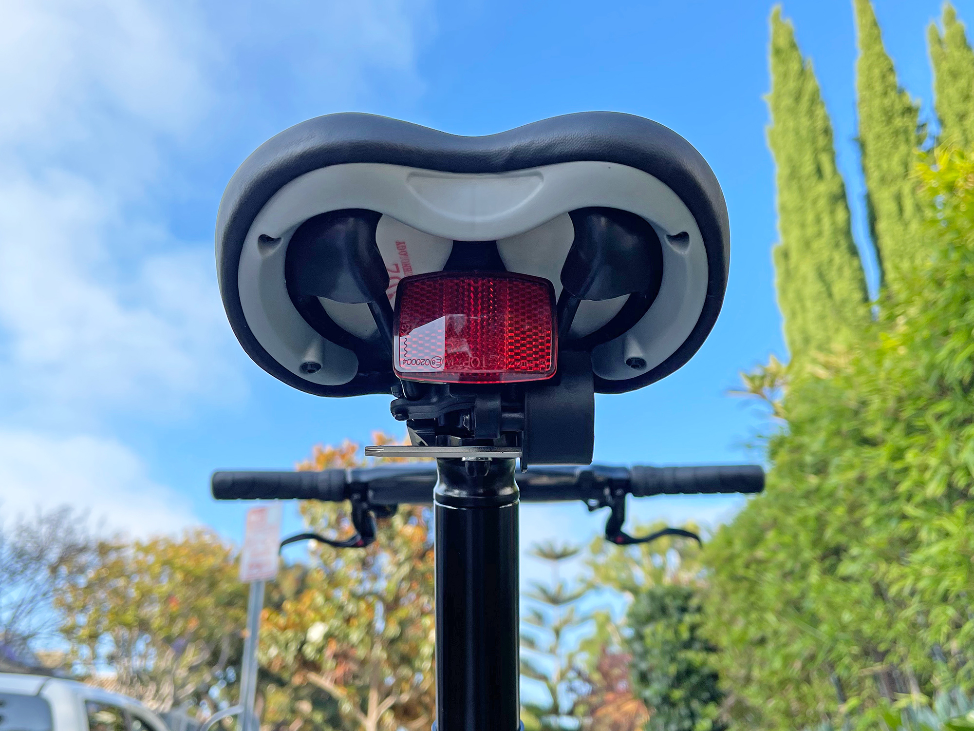

- This is a little detail, but I love that Gocycle includes a hex wrench attached to the saddle mount. It’s fairly hidden, but easy to access and use to adjust the seat and other parts of the bike! Very minimalist and clever.

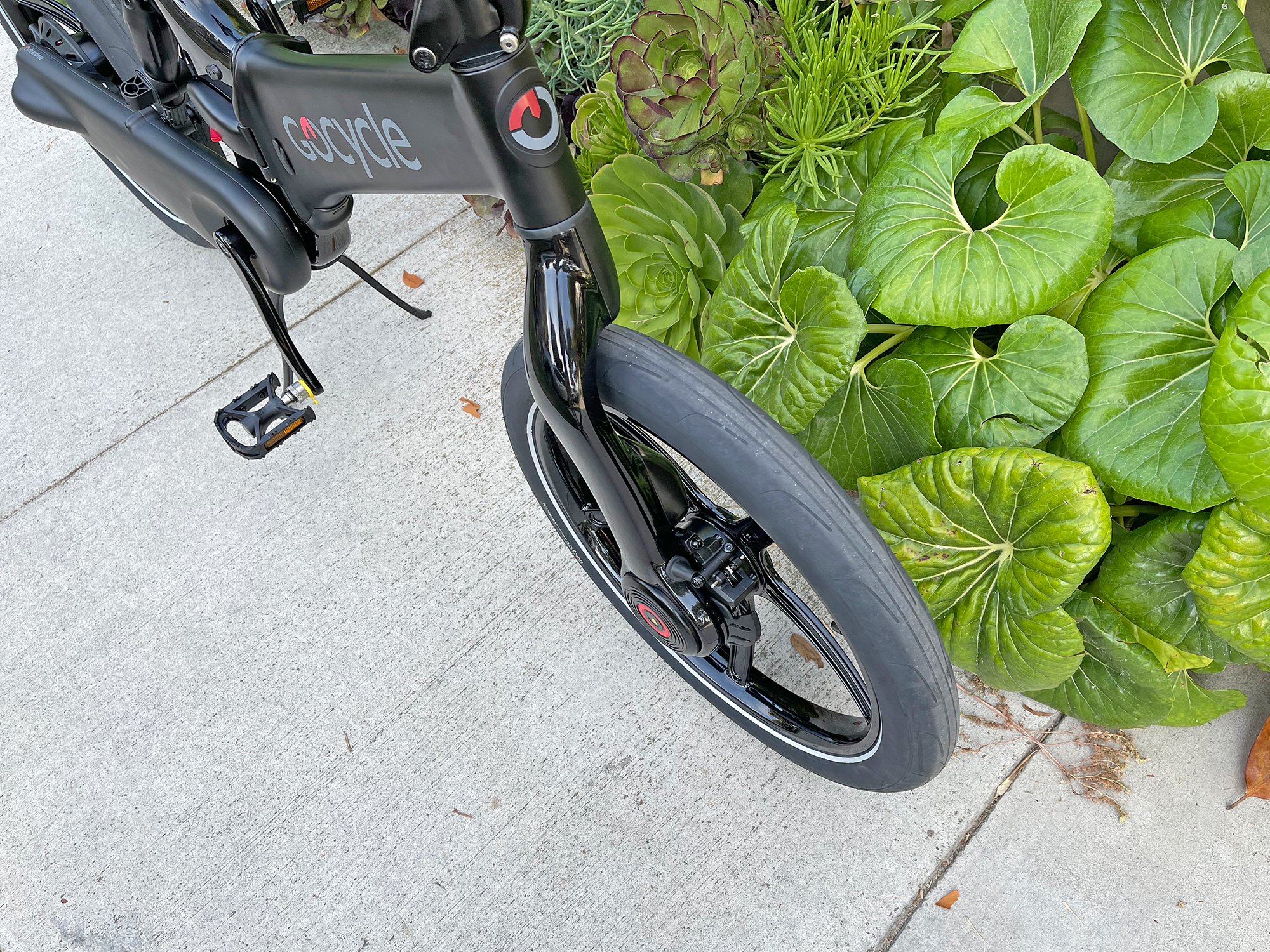

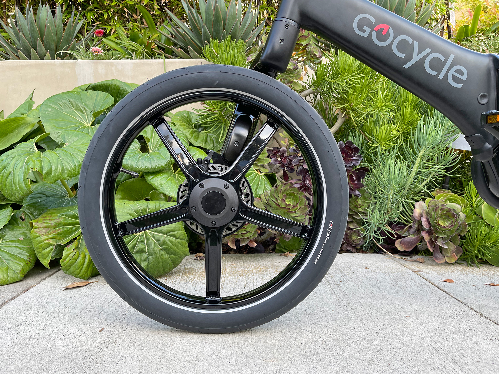

- Notice how the wheels on this electric bike do not use traditional wire spokes? Instead, Gocycle builds rigid wheels using magnesium which look cleaner and don’t require as much truing maintenance.
- Since the wheels attach to the frame on just one side, it’s possible to change a flat tire without actually removing them from the bike! There is no fork arm or seat stay and chain stay to block the tire and tube from being removed.
- Both the stem and center joint have locking mechanisms to keep them secure while riding. It was very quiet during my tests, with limited creaking and no play in the folding joints. I just want to emphasize the attention to detail and refined nature of this bike after four generations.

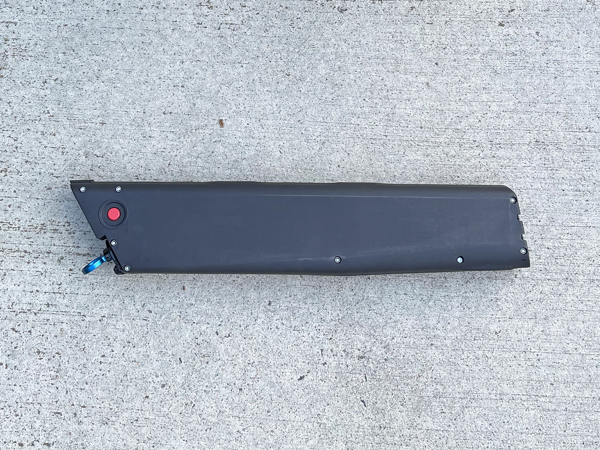

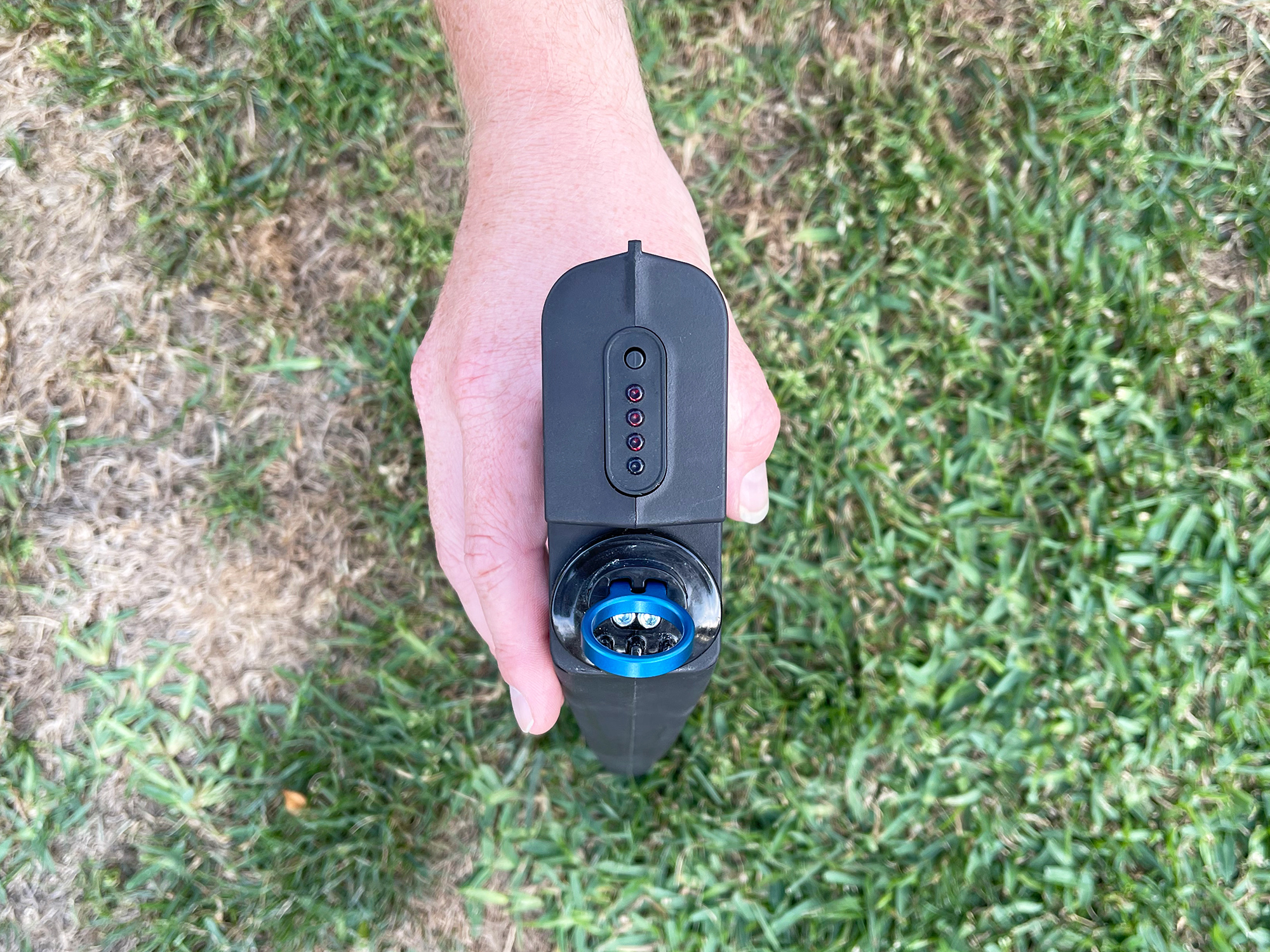

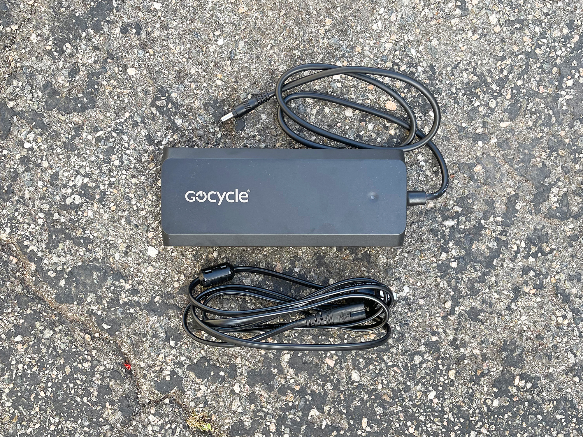

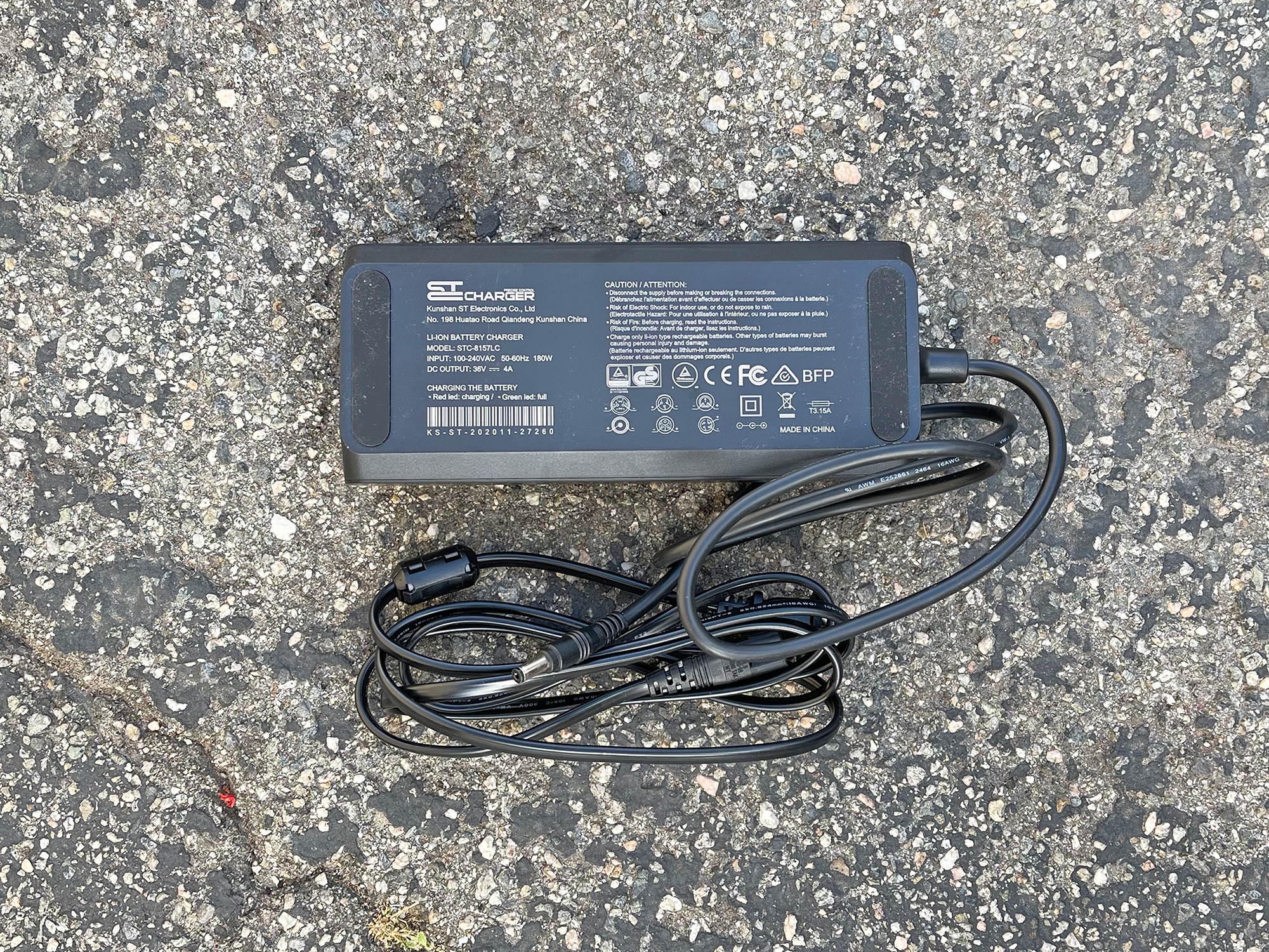

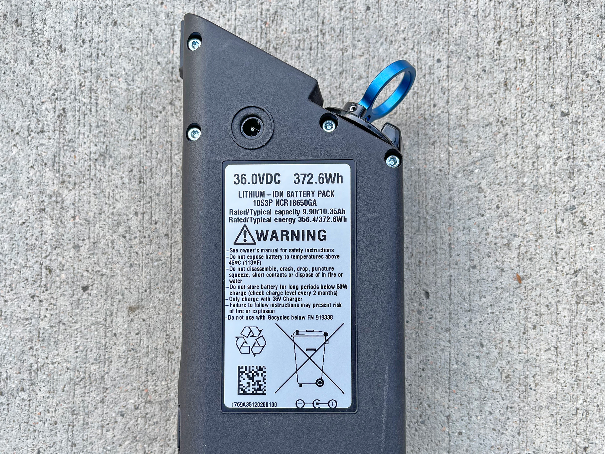

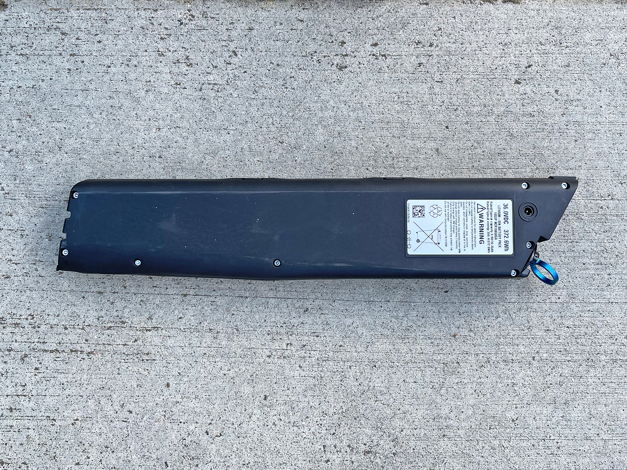

- The battery pack uses premium Panasonic battery cells and offers good capacity for its weight because the cells are higher energy density 3,200 milliamp. The pack can be charged on or off the frame, and now Gocycle includes a four amp charger vs. slower two amp from most competing bikes. You need to fold the bike in order to access the battery in the main frame. It feels well protected there, and situates weight low and center for improved stability and handling. I have been told to store the battery in a cool dry environment, and stay between 20%% and 80% charged when not using, to maximize life. Fully discharging lithium-ion batteries can stress the chemistry and is not recommended.
- Gocycle custom designed the hub motor, mounted in the front wheel hub, and it seemed much quieter to me. They said that they improved low end torque, which I noticed during the climb tests, and it also offers traction control for improved acceleration. Front hub motors can sometimes spin the front wheel since more weight shifts to the rear wheel during acceleration. I’m sure they would have used a rear wheel motor, but that already has the internally geared Shimano Nexus 3-speed hub for pedaling. This is basically an all-wheel-drive ebike.

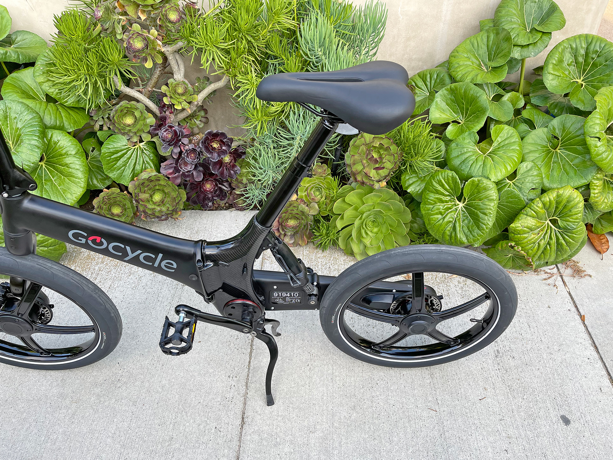

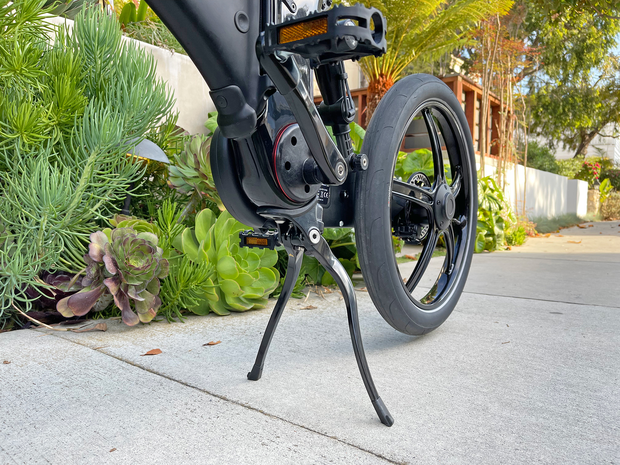

- The center-mount kickstand design is very clean and secure, but it took me a bit more precision to deploy. I found that my foot had to touch the frame and slide down to the nub at the end of the stand in order to deploy, so it could create some smudges or scratches on the frame over time.

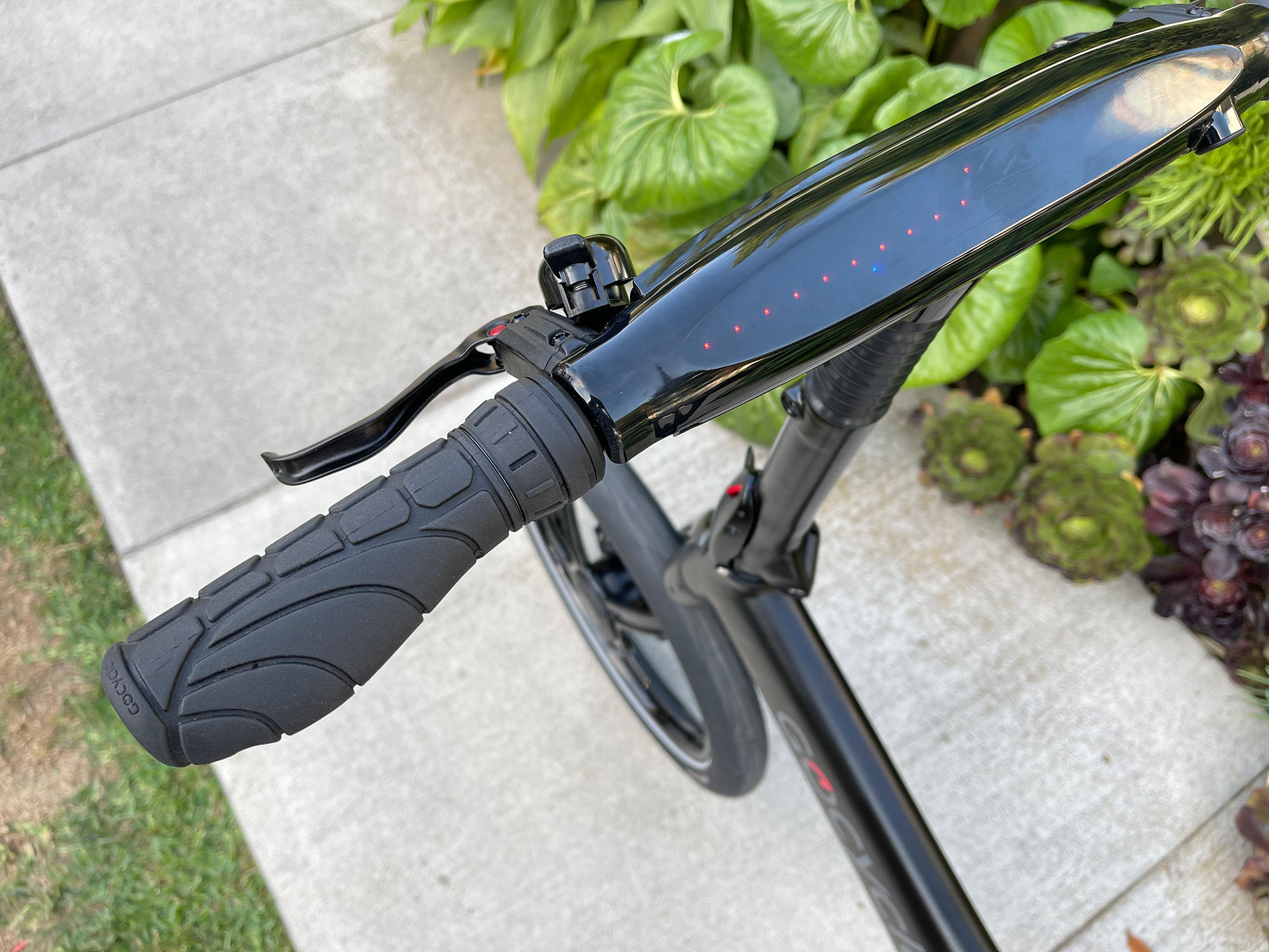

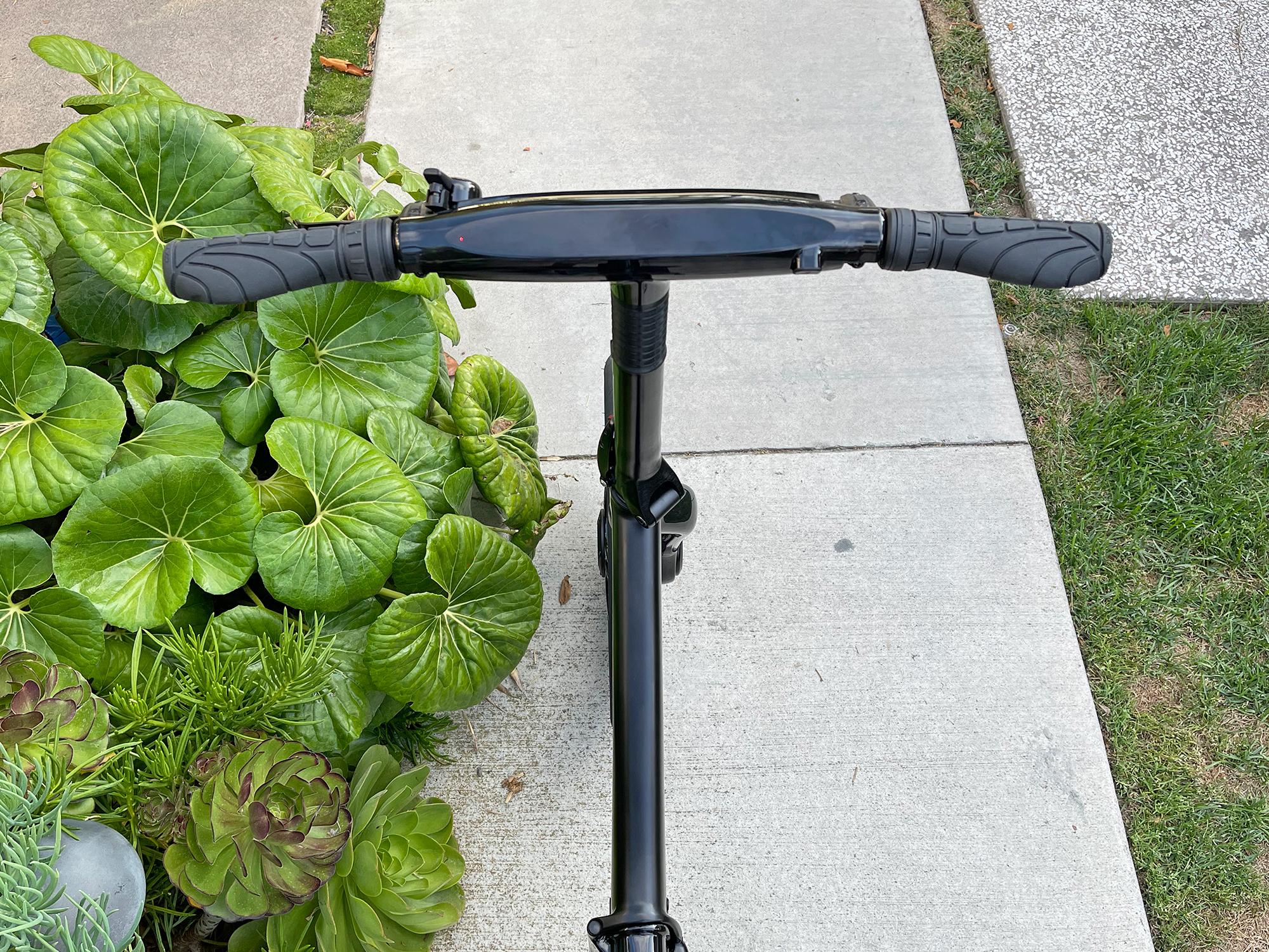

- The handlebar-integrated display panel is very basic, relying on LED lights instead of words and icons as many competing products do. It’s very futuristic and minimalist, but in order to know your current speed, disable automatic shifting, and determine a more precise battery charge level, you will need to download their smartphone app. I love that there’s a USB-C charging port for your phone and that they’ve developed a simple rubber band solution to mount it to the handlebar (which has a flat surface on the front), but it seems that your phone will end up blocking some portion of the main LED display.

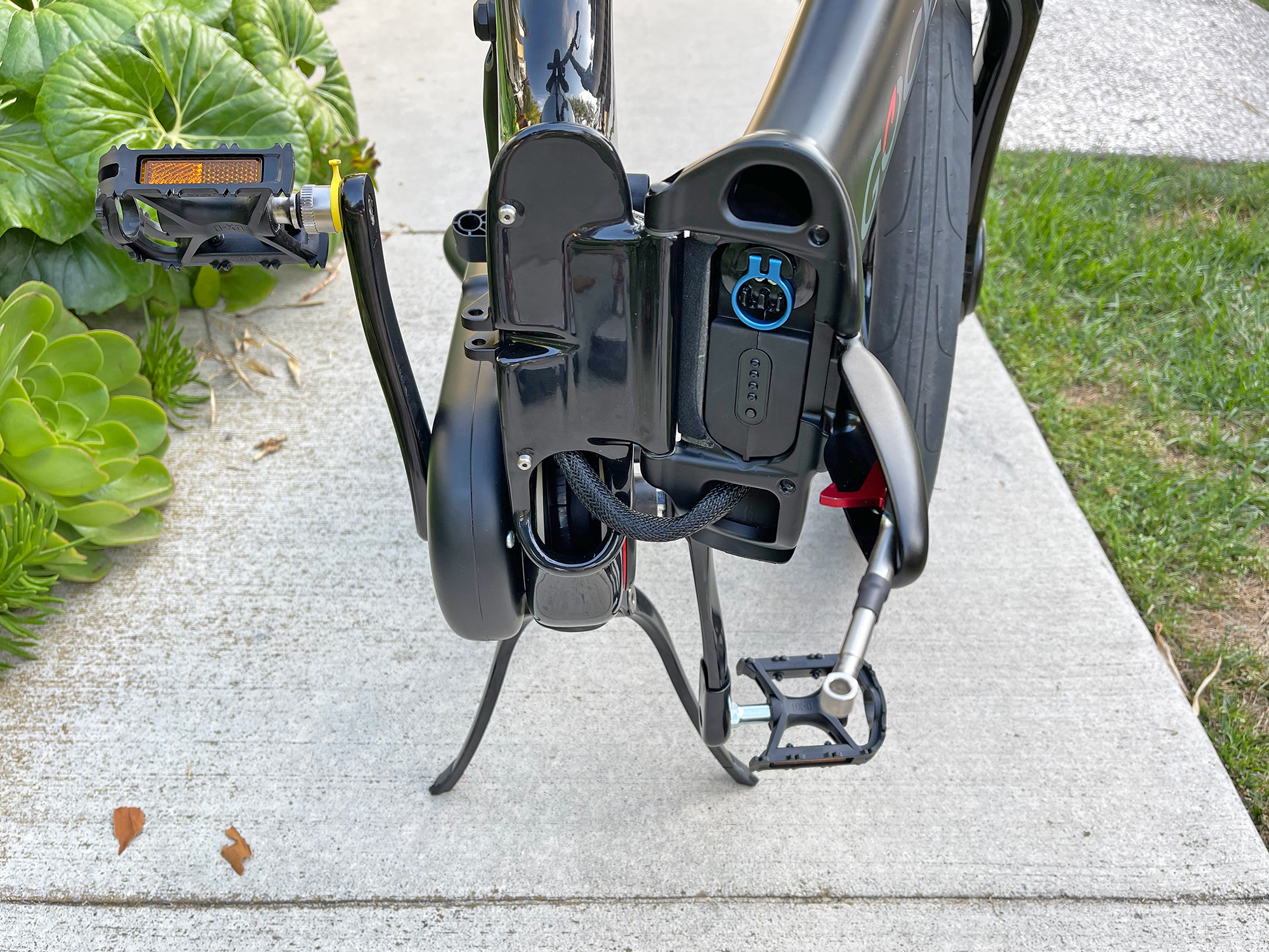

- The battery pack does not lock to the frame with a key like many other ebikes. It appears that someone fold it and remove the battery fairly easily unless it is parked in such a way that the frame cannot be folded.
- The on/off switch for the battery pack and charging port location on the frame are positioned pretty low, and in the path of the crank arms. I mention this because it seems that you have to bend down to engage with the bike for charging and the cranks cold bump the cable or snag it… ideally, they would be positioned higher up for convenience and also protection from cranks, feet, and water or mud that could fly up during rides.
