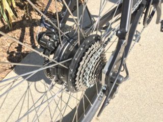

Driving the CrossCurrent Air is the exact same 8Fun internally geared hub motor used on the standard CrossCurrent. It offers 350 to 600+ watts output and is zippier than most motors this size based on a higher 3C rating for battery current output. While the motor does produce a bit of whirring noise, it’s not too bad with the lower levels of assist and it really does get you up to 28 mph. Perhaps my only complaints here are the same complaints that most hub motors get which is the lack of quick release and a wire coming out the right side of the axle where the shifter cables and derailleur are. It’s not as tucked in as the latest fanciest ebikes and could get bent or snagged more easily. Just be careful with that wire and enjoy the fact that this hub motor is compact, built from a mainstream supplier (Bafang/8Fun) and much lighter than a 500 or 750 watt option. Note also that the spokes are slightly thicker and the rims (painted black to match the frame and hub motor) use reinforcement eyelets so they won’t crack as easily under pressure. Sometimes these speed pedelec models can be uncomfortable to pedal at higher speeds if they aren’t geared correctly but those nine options felt good to me and I liked how clean the cockpit was with trigger shifters only on the right. Note that the chainring has a plastic guard to keep your pants or dress from getting dirty or snagged but it’s just plastic and only on the outside so you could still drop the chain towards the inside if the terrain gets really bumpy.

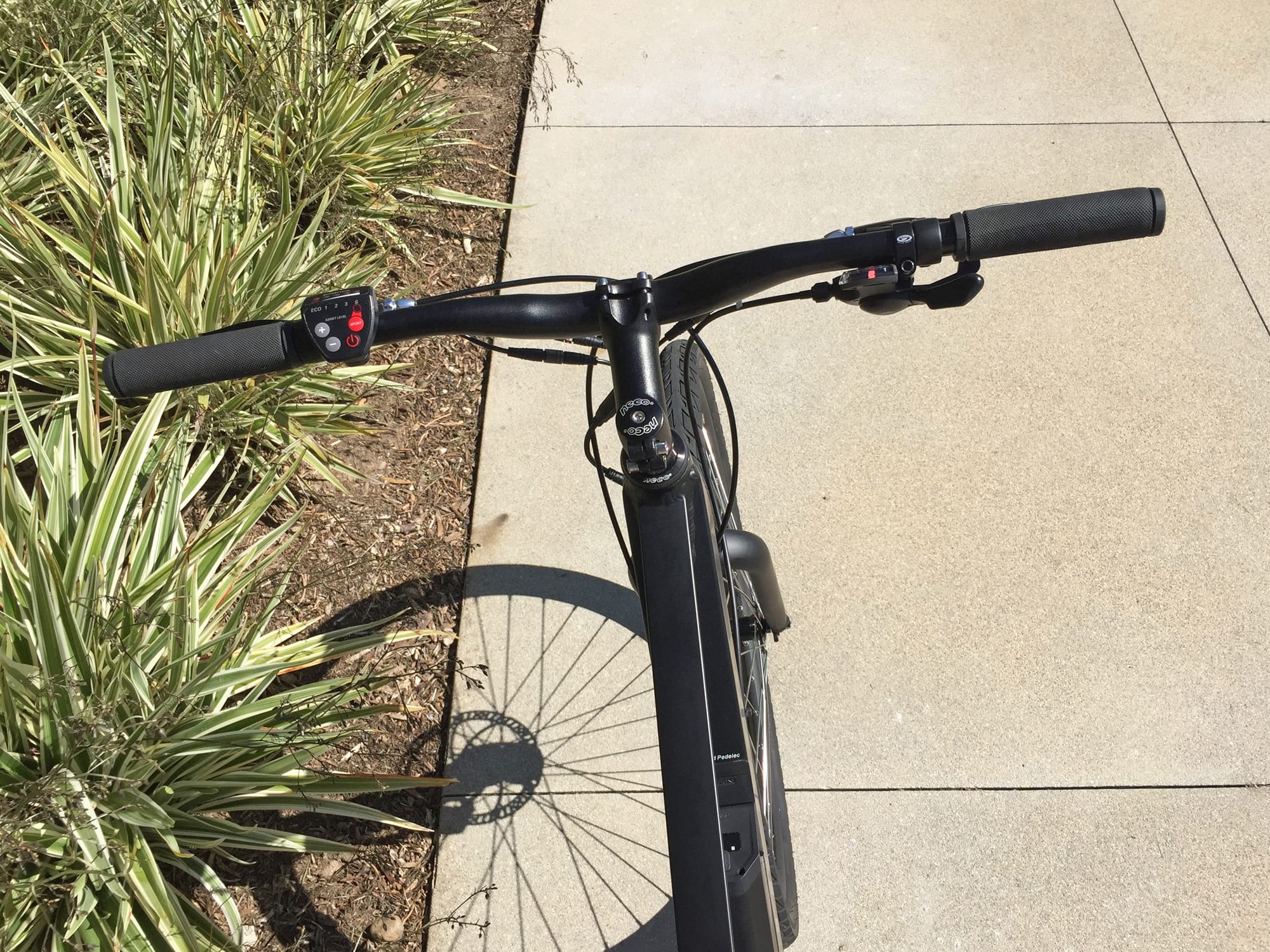

- The display has a cool “sport” feature that lets you jump from any of the three assist levels up to the highest speed and then back down with just one press vs. a bunch of clicks up then back down

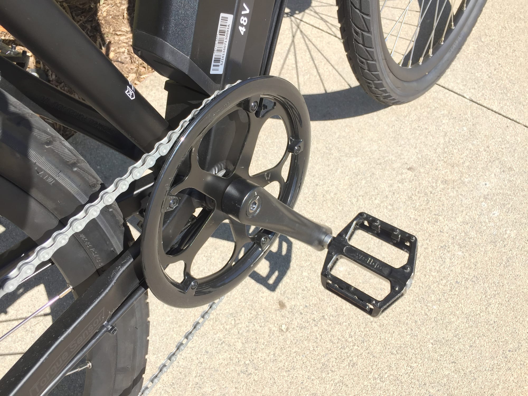

- Great pedals, they match the bike, offer good traction and are large and stiff enough to accommodate taller and heavier riders who might have big feet and need the support
- Even though this electric bike uses a more basic rear-mounted hub motor drive system, they balanced out the weight by bringing the battery forward and keeping it low, impressively, they were able to squeeze in a mounting point for a water bottle cage along the seat tube (at least on the high-step models), so many ebikes don’t include this but it’s very useful even for things like folding locks and mini pumps

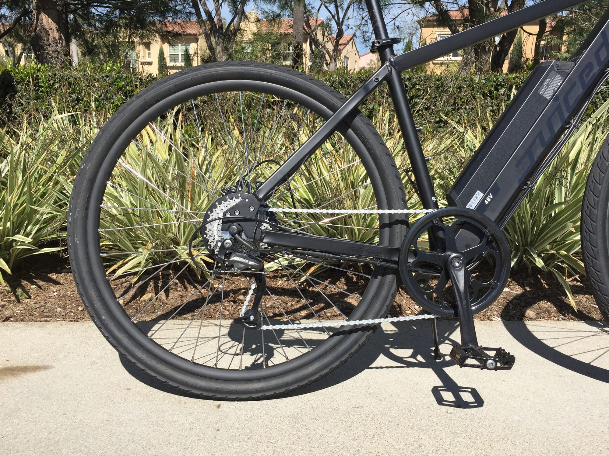

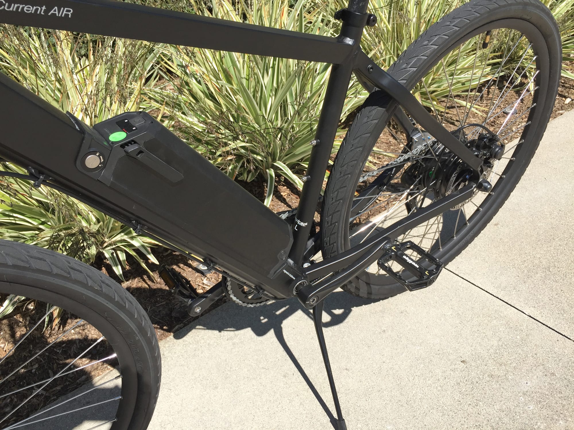

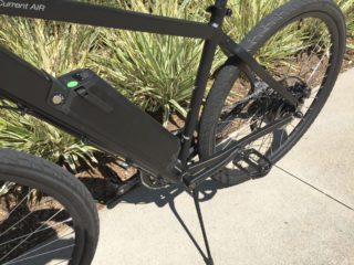

- The kickstand is positioned just under the bottom bracket and if you back the bike up while it’s in the down position the left crank arm will collide with it, would be better if it was mounted slightly towards the rear and out of the way (also so you could pedal the cranks backwards while servicing the drivetrain without need for a full stand)
- The power cable running to the motor protrudes from the end of the right side of the axle where the derailleur and shifter cables are, this is a little crowded and more vulnerable than if it were tucked into the left side as some newer Dapu motors offer, also there’s no quick release on the rear wheel, just the front
- I like that they included a plastic chainring guard but would love a full guide (plastic walls on both sides of the chainring to keep from dropping the chain on bumpy terrain)
- The display panel is not removable so it could take wear from the weather and sunshine a bit more when parked outside (as well as being scratched or banged up) but it’s so small and relatively simple that maybe a few scratches aren’t a big deal compared with a fancy LCD
- The shifter cables and electronic wires aren’t internally routed and hidden the way they are on some more expensive e-bikes but I was told they are more serviceable this way and since they are black, they blend in with the frame pretty well, the top tube is kept bare at least which makes it easier to lift and put on racks without snags

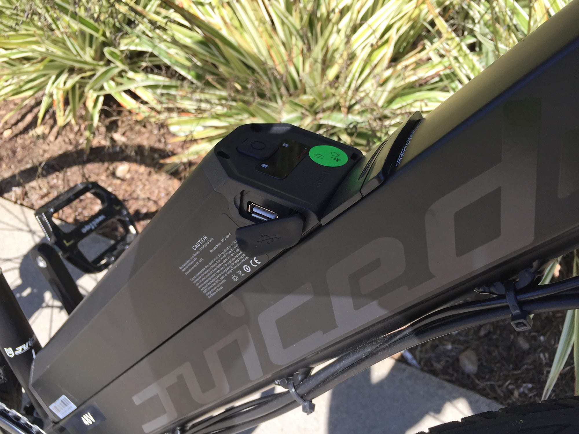

- I’m not a fan of the little rubber nipple that fits into the charging port on the battery, it’s tricky to get in and since it’s low by your left crank arm it could get dust and water inside if you’re not careful… I do like that you can at least take the battery off the bike for charging or cleaning

Hi – does the battery lock into place with a key? How do you keep it from getting stolen when parked?
Court Rye says
Hi Troy! Yes, the battery locks to the frame and I have a picture of it if you scroll through to the third image above. You can see where the battery interfaces in the downtube and the silver circle there near the top (on the left side of the frame) this is what keeps it from getting stolen and keeps it secure in place :)
