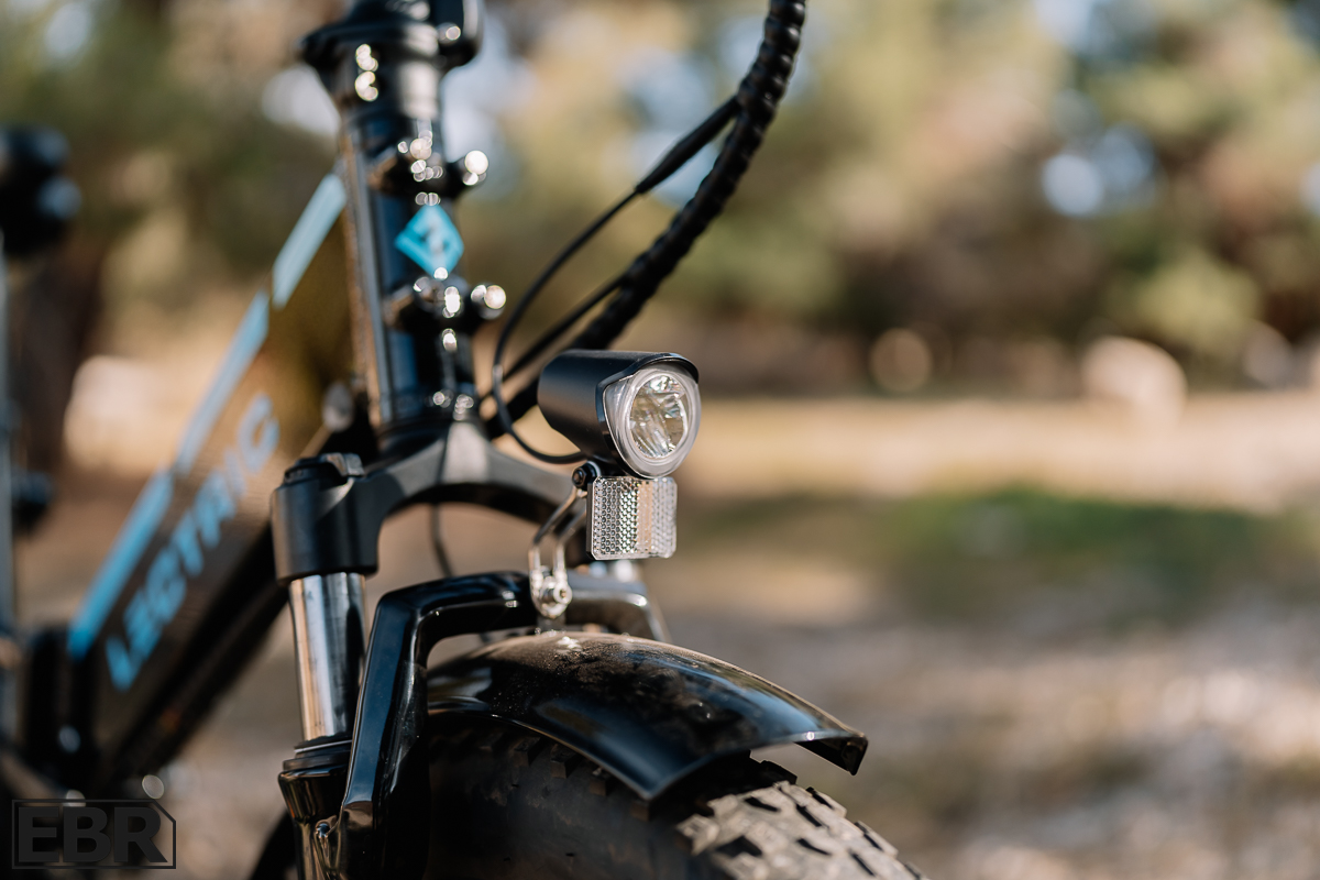

We prize e-bikes that make it easy for someone to incorporate an e-bike into their lifestyle. Practically speaking, what we’re looking for is an e-bike that won’t hold someone back. They need to be able to ride any time of day (lights front and rear), in any conditions (fenders) and will allow them to carry necessities or even another person (rear rack). Oh, and it needs to be easy to store (kickstand and foldable). The XP 3.0 includes all of that, making it all-purpose e-bike.

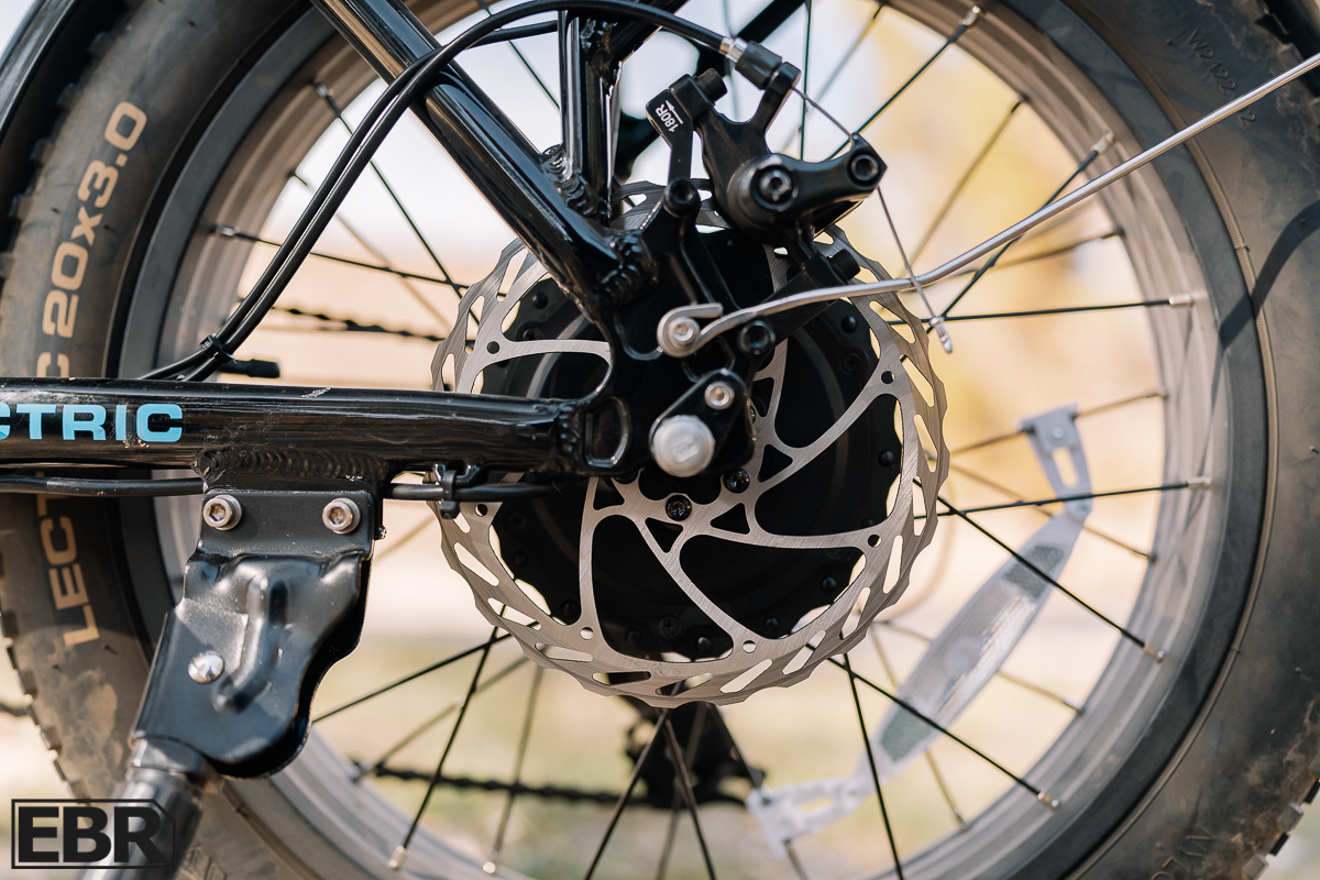

With the Lectric XP 3.0 we have a 500W hub motor, just as we did with the XP 2.0, but this is by no means the same 500W brushless, geared hub motor found on the older version. Peak wattage has climbed from 850 to 1000, an almost 20 percent increase in maximum power. Similarly, the torque the motor produces climbed from 35 to 55Nm, a more than 50 percent increase in the power necessary to accelerate away from a stop or climb a hill.

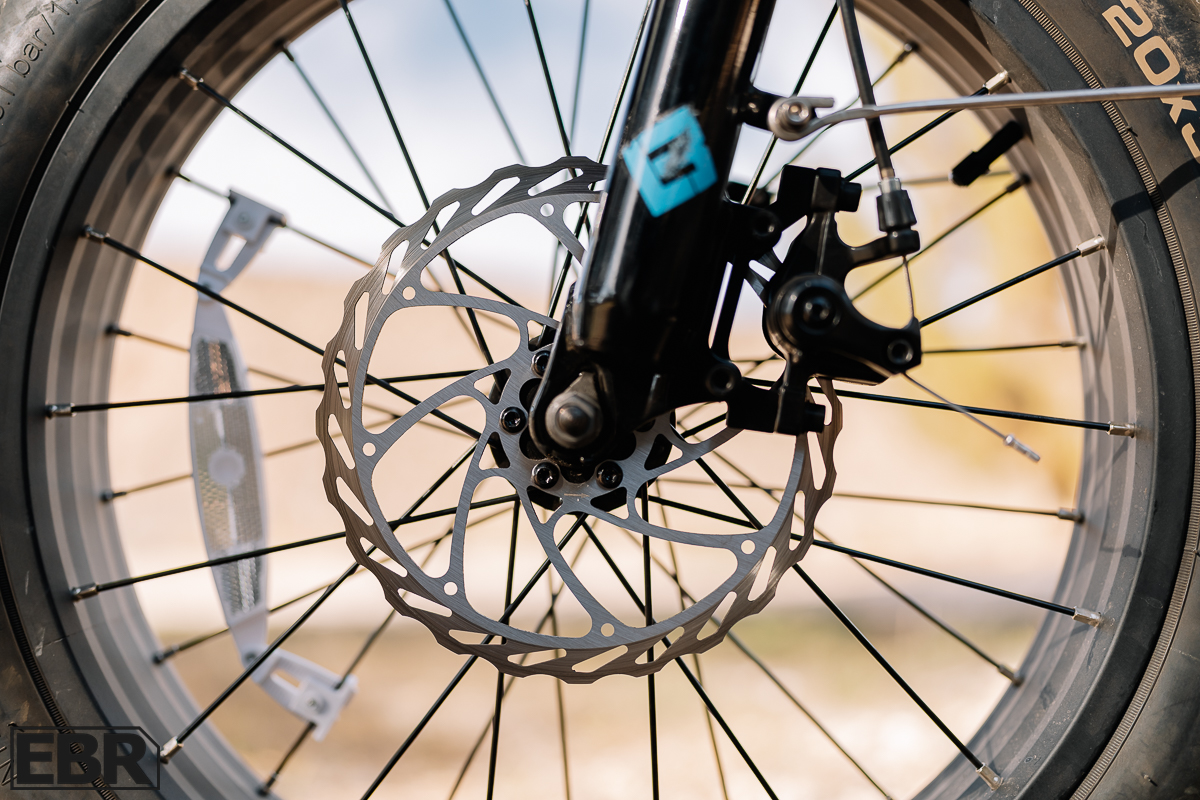

The big change, component-wise, between the XP 3.0 and the XP 2.0, was the switch from mechanical disc brakes to hydraulic disc brakes. Making such a switch not only increased absolute braking power, it also reduced the amount of force necessary at the lever to stop the e-bike. Hydraulic levers also offer a smoother feel in addition to that lighter touch.
Lectric gave buyers a twofer in the brakes by also increasing the rotor size from 160mm to 180mm; the bigger the rotor, the better the stopping power. While light riders might not notice a big difference, bigger riders and anyone toting a child along or lugging some groceries home will welcome the greater braking power.

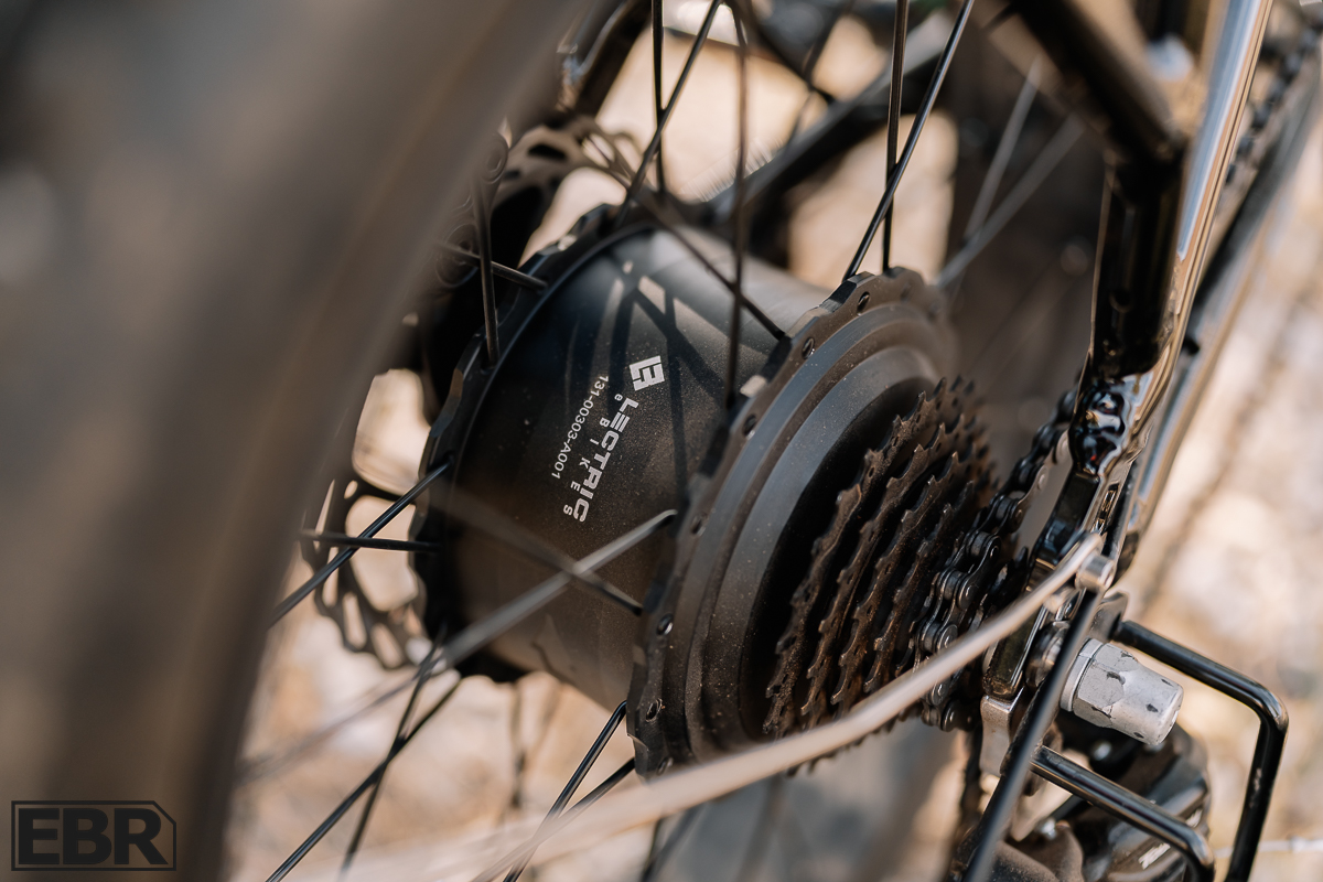

We were critical of the XP 2.0’s ability to reach Class 3 speeds—anything above 20 mph. The largest gear it had, based on its 14-28t freewheel simply wasn’t large enough to do much more than reach 20 mph, unless you could pedal like a windmill in a gale. By replacing the 14-28t freewheel with an 11-28t freewheel, the largest gear will now reliably deliver riders to speeds greater than 20 mph, though reaching 28 mph seems like it will be difficult for most of us.

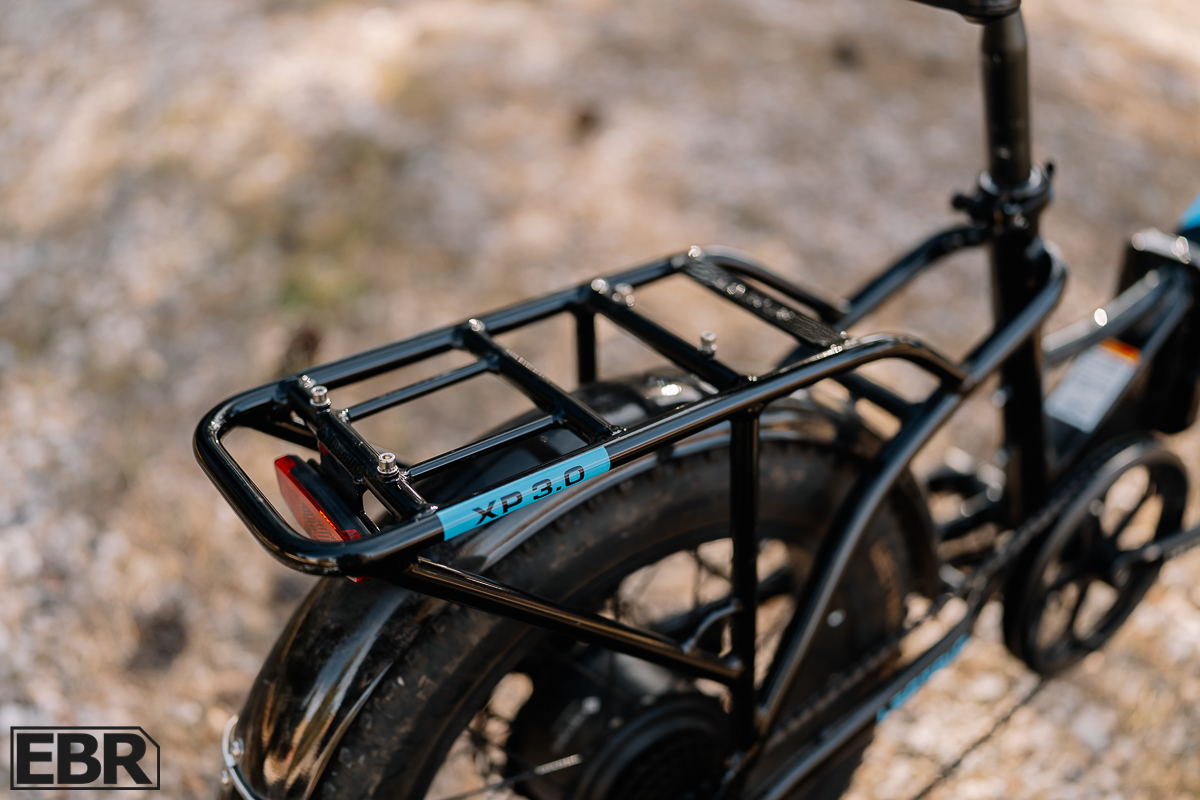

Lectric also changed the frame with the XP 3.0. Previously, the rear rack was bolted onto the frame, but now it is welded to the frame. This is good for the e-bike and the rider in a couple of ways. First, it doubles the rack’s carrying capacity, from 75 lbs. to 150 lbs. The upshot is that the rear rack is now strong enough to be able to accommodate a child seat plus child, fundamentally changing what this e-bike can accomplish.

- By upgrading from mechanical disc brakes to hydraulic disc brakes and from 160mm to 180mm rotors, Lectric gave braking power and rider control a massive boost
- Swapping the 14-28t freewheel for an 11-28t freewheel gave the drivetrain enough muscle to be able to achieve Class 3 speeds north of 20 mph
- With the rear rack now integrated into the frame, its weight capacity has doubled, from 75 lbs. up to 150 lbs., enough to support a child’s seat

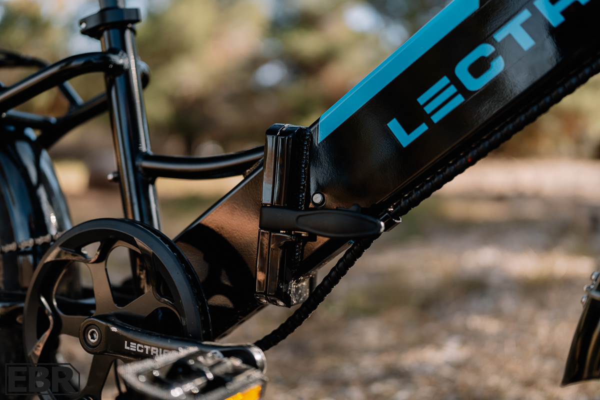

- One of these days they are going to change the battery lock so that the key doesn’t have to be inserted in order to ride the XP 3.0; the jiggling key is annoying
