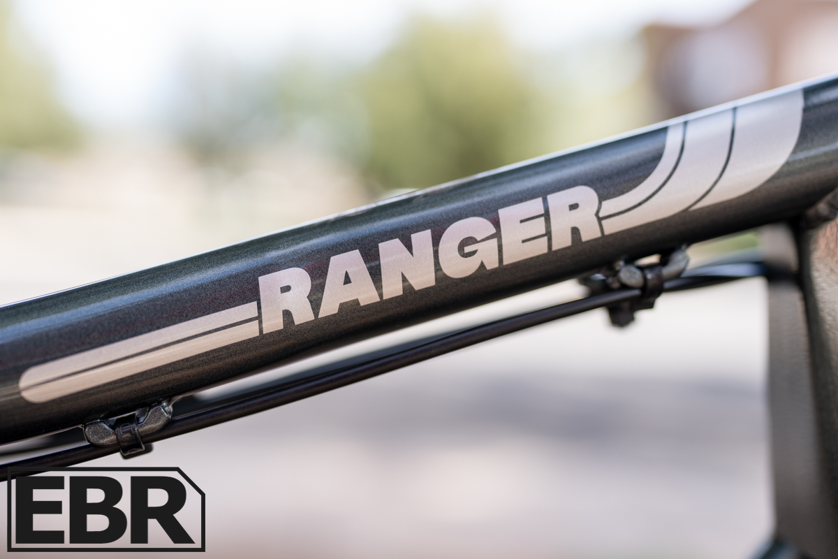

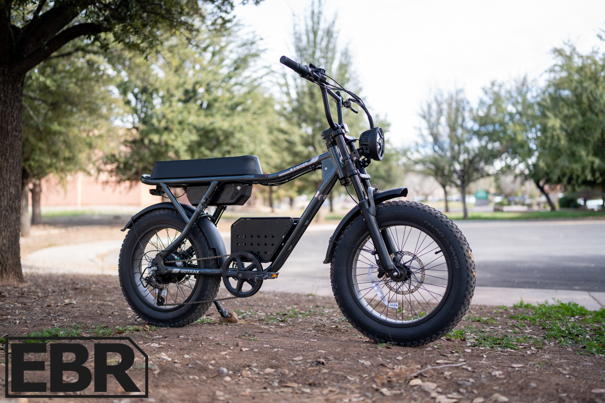

The curb appeal is very cool. Typical of moto style e-bikes, it’s a nod to old school cafe cruisers and they just look good. The only color it comes in is grey and has a nice metallic finish on the frame. Speaking of, the website says the frame is made of ‘iron’ but I’m leaning towards that being a mistake as I believe it’s aluminum, but don’t hold me to it. I reached out for a comment but due to the Chinese New Year, the production facilities are closed for the next couple weeks.
The riding position is upright and relaxed, typical of a moto style ride with the elongated seat and BMX style handlebars. It’s almost a bit ‘chopper’ with your hands straight out in front of your face. Between sliding forward or backward on the saddle and the wide range of reach, you can dial in what works for you.
Comfort is definitely there thanks to that saddle and riding position, but it’s further expressed with the fat 4 inch tires and the dual crown moto fork that soaks up any major impacts like coming off curbs or hitting speed bumps.

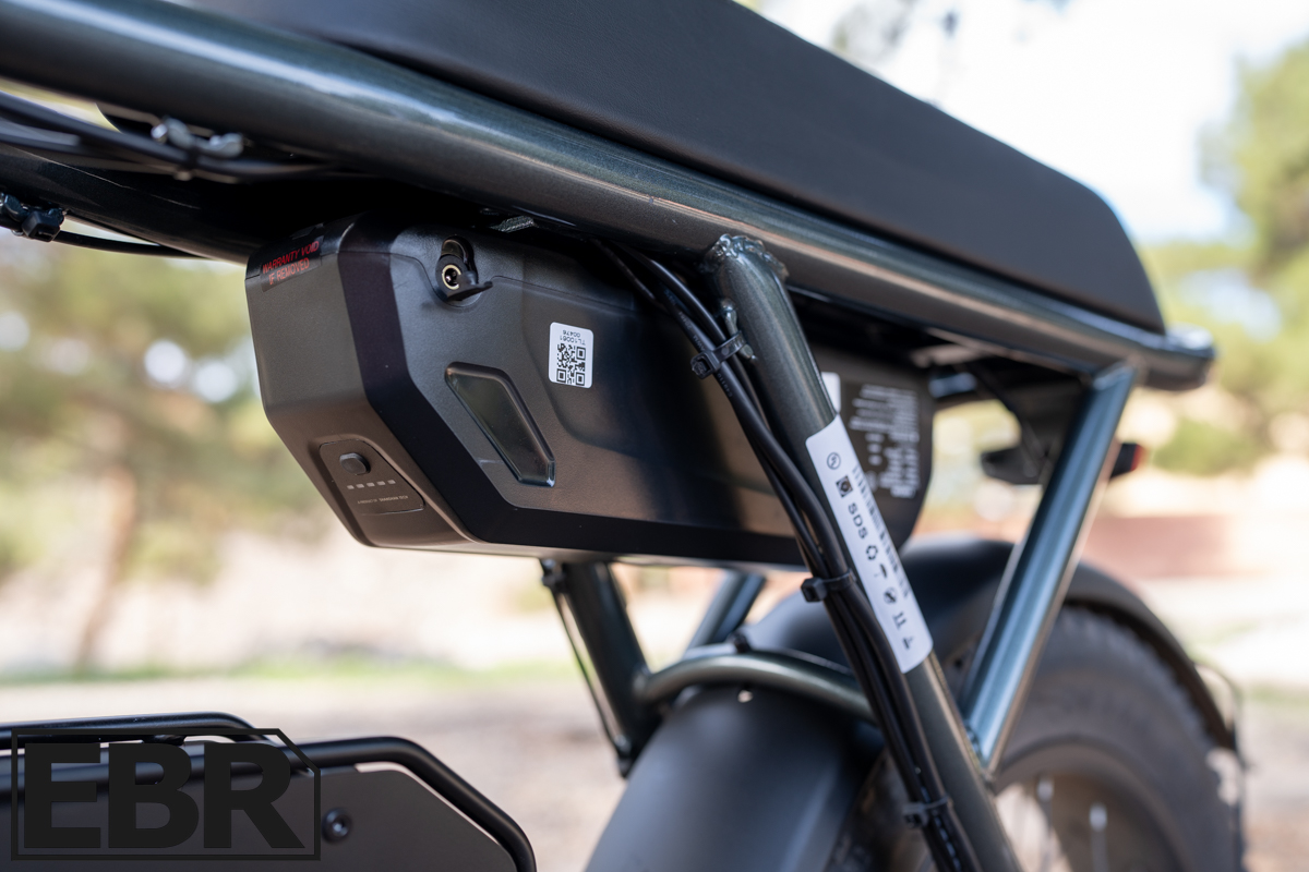

Power (Motor & Battery)
Power on the Ranger is from a 500W rear hub motor. The brand doesn’t list on their site the peaking wattage or the torque rating so I was left to just ride it and try and explain it here. The power is good. Its good enough that I was able to hold the throttle only with no pedaling up a ¼ mile hill at 7-9% with no sustained drop in speed aside from some slight fluctuations from bumps, it helped a solid 20mph the whole hill climb.

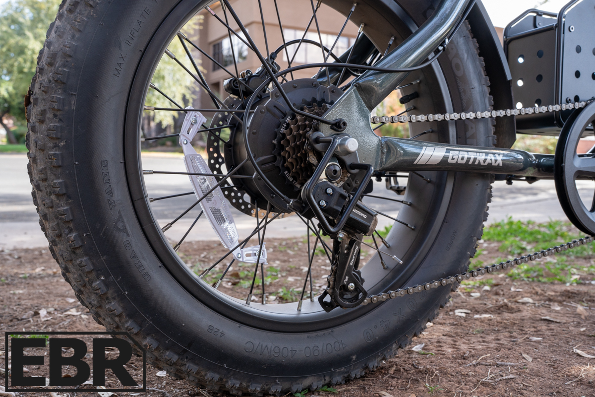

As you would expect, components on the Ranger are straightforward and effective with no extra flair. The drivetrain is a Shimano 7-Speed with a Shimano rear derailleur, one 7-speed over-the-bar thumb shifter, and a window view to see what gear you are in at a glance.
The cassette is a 14-28T with a 48T chainring that gives a nice range of gears to work through for varied terrain. In my opinion, it’s a bit of overkill. A bike like this doesn’t really have long leg extension for proper pedal stroke and for most folks this will be a throttle rig, not something where pedaling is the focus and gear changes help riders get through tougher hills as they ride. The Ranger is meant to be throttled around and a single speed chain drive or a single speed belt drive would likely be the best bet here. But it’s never a bad thing to have more, it’s just not really needed here.

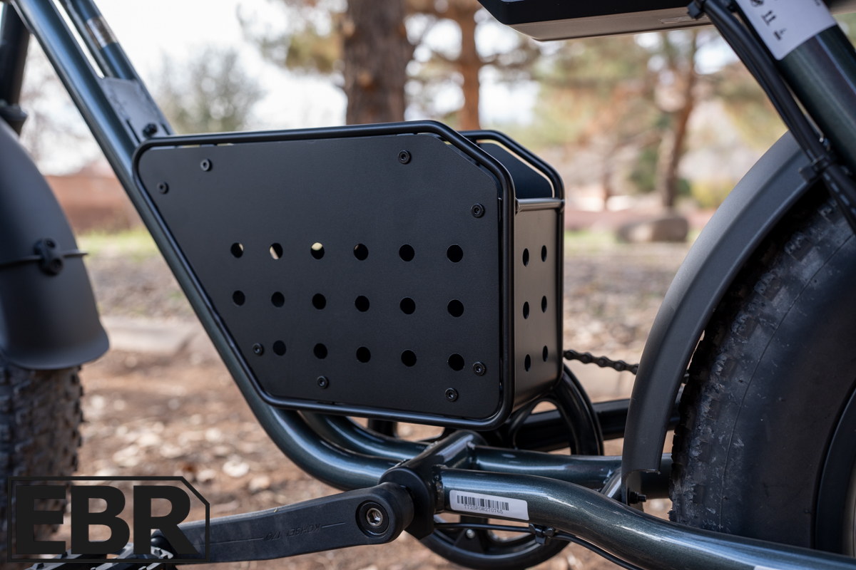

One of the cool components is the storage basket secured in the open space of the frame. The storage cubby makes great use of an empty area on the bike and gives riders more options to put their gear when riding. Plus, because there are no mounting points for water bottles, the cubby becomes the only place to store gear unless you wear some sort of bag while you ride.

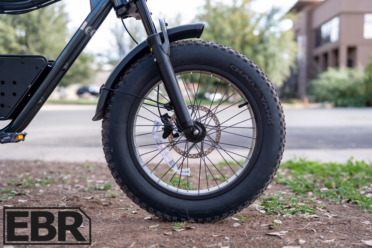

The wheels and tires are an appropriately themed all terrain moto setup with 20×4″ Chaoyang tires that look ready to tackle whatever your plans could be, from downtown commutes to weekend trail rides, even some mud. It’s important to keep in mind the tires are all-terrains so they will have a bit of a big tire ‘hum’ on pavement like bigger trucks do. It’s not a fault of the tires, just a real-world byproduct.
The front suspension fork is a Gotrax branded inverted dual crown moto style fork with a coil spring. The travel of the fork is not listed by Gotrax, but in my shop measurements, it appears to be around 70mm. Don’t quote me, but that’s what I’m sticking with.

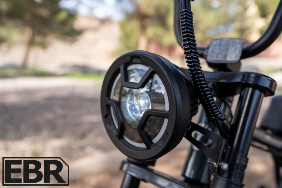

The Ranger also comes equipped with a big front LED headlight that has the same cool moto-style look and it compliments the bike’s overall moto-styling. There is no listed illumination rating by Gotrax, but I’d say it’s bright enough to light your path nicely at night and still be seen for safety reasons as well.

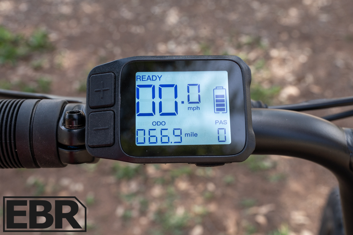

At roughly 2 inches in size, the LCD display is mounted on the left side of the handlebar and has 3 buttons: the ON/OFF and then the Plus and Minus buttons for the pedal assist. The display, along with the rest of the bike, is IPX5 water resistant, meaning rainy day commutes won’t make it quit on you.
All the needed ride metrics are front and center like speed, battery life, odometer, and pedal assist level in use. You can access a couple advanced settings by holding the plus/minus buttons for 2-3 seconds. In the advanced settings you can choose between a top speed limit of 20mph or 25mph, but fair warning, you will want to use the display manual as the codes for each setting cannot be determined as they are coded.
The display on the Gotrax Ranger keeps with the minimalist theme and provides all you need to glance at your ride metrics while on the go without cluttering it with extensive menu options or tech features. There is no app connectivity to mess with, which I can appreciate.
