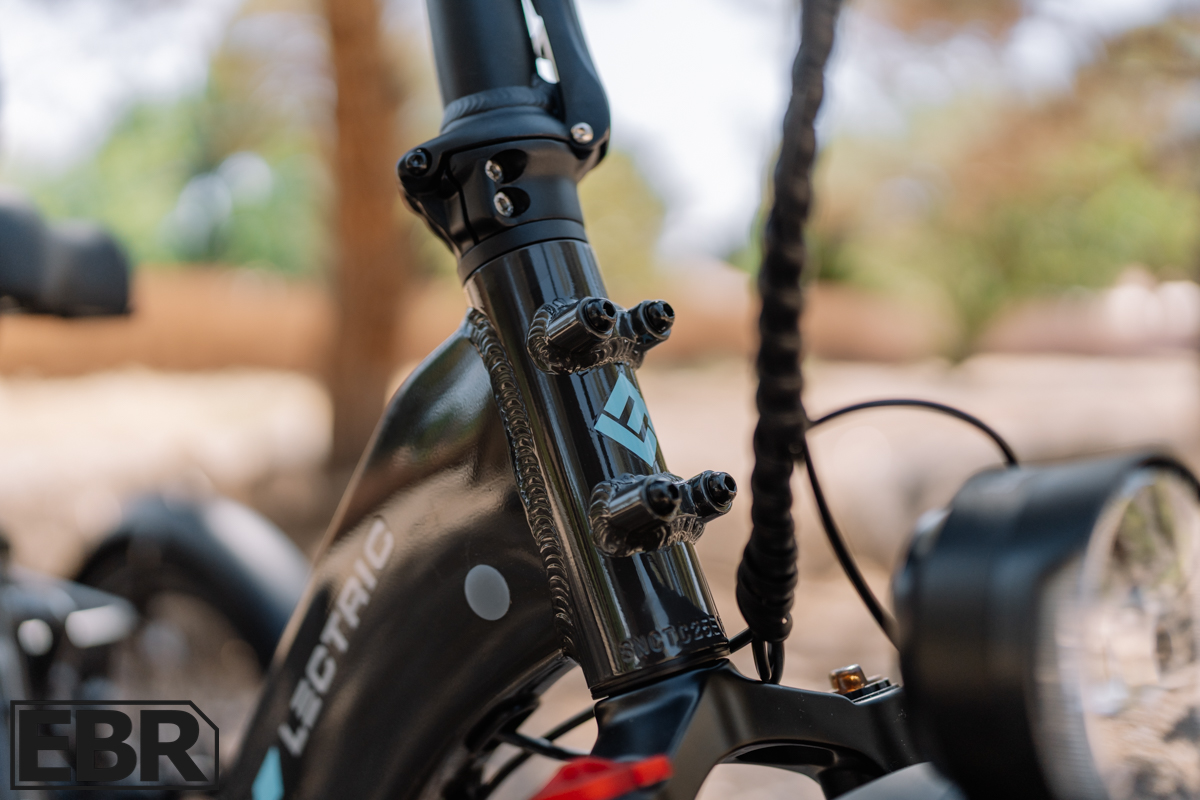

The new frame brings sleeker lines with fewer visible weld marks. My test unit came in Tempest Grey – a very dark grey that’s nearly black with a gloss finish and black accents at the contact points. It’s got a nice modern look that feels a bit more grown-up than the original XP Trike from a couple years back.

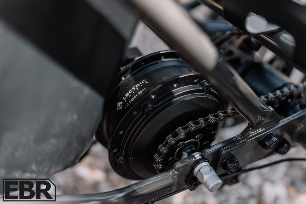

The Trike2’s power comes from the 48V system powering a 500W rear hub motor.
The 500W rear hub motor runs pretty quiet, it’s not silent, but it also won’t wake the neighbors. It can peak at 1,092W and delivers 65Nm of torque, which gives it solid performance across different terrain. On flat ground it performs well, and it has enough power to handle reasonable hills without struggling. I was actually gaining speed on a 7% grade during my test rides. The cadence sensor responds quickly with just about a quarter turn of the pedals before the motor assistance kicks in.

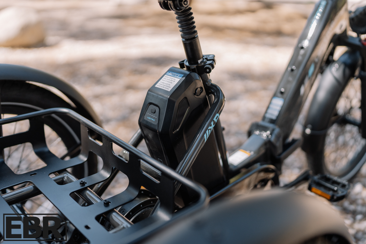

The standard model comes with a 48V, 13Ah battery (624Wh total capacity) providing up to 50 miles of range per charge. The battery is UL 2271 safety certified and weighs around 8.5 pounds, making it nice and manageable for removal when needed. Accessing the battery is straightforward, simply unlock it, and slide it out from the underside of the saddle along the seat tube.

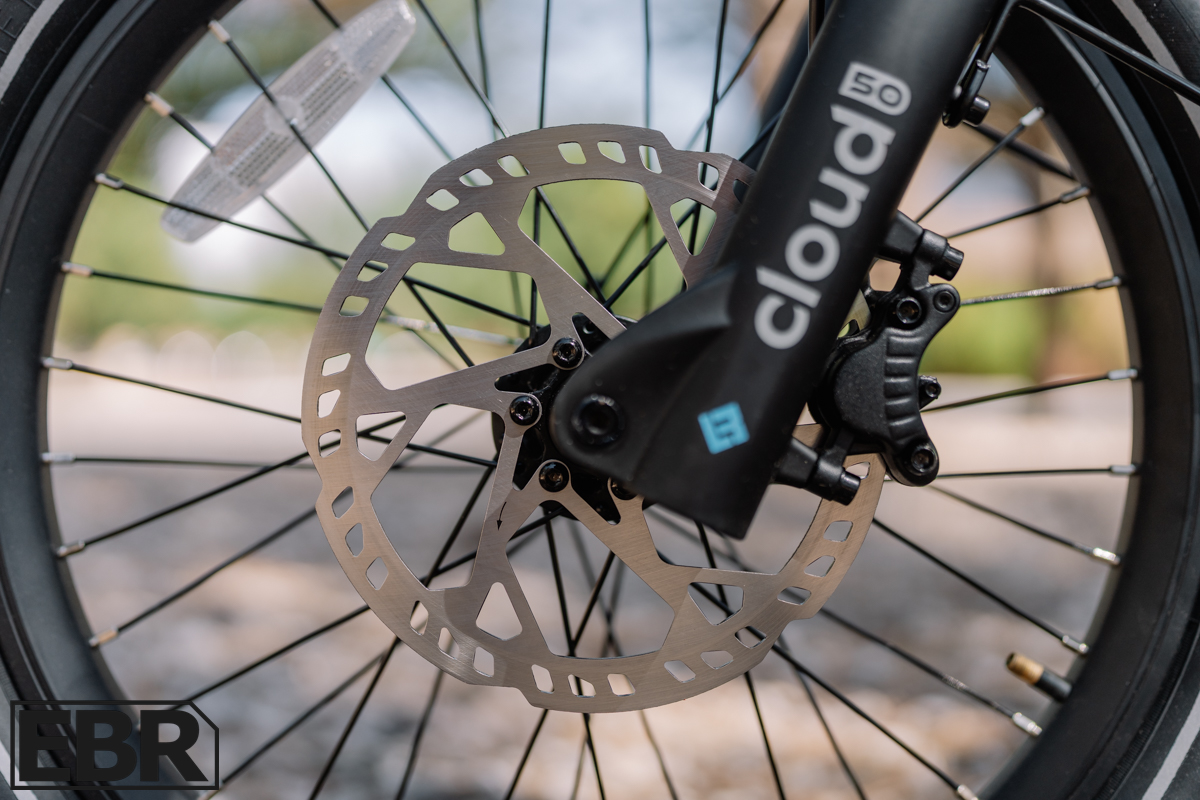

A major upgrade here is the new Cloud 50 suspension fork providing 50mm of travel. This is a big step up from the rigid fork on the original XP Trike. Combined with the 40mm suspension seatpost, you get a much smoother ride that takes the pressure off your joints when hitting bumps and rough pavement.

Star Union hydraulic disc brakes with 180mm rotors handle stopping duties for both the front wheel and rear axle. This hydraulic system provides consistent, reliable stopping power. What’s really handy are the parking brake levers that help keep your trike secure when parked – a thoughtful addition for a three-wheeler.

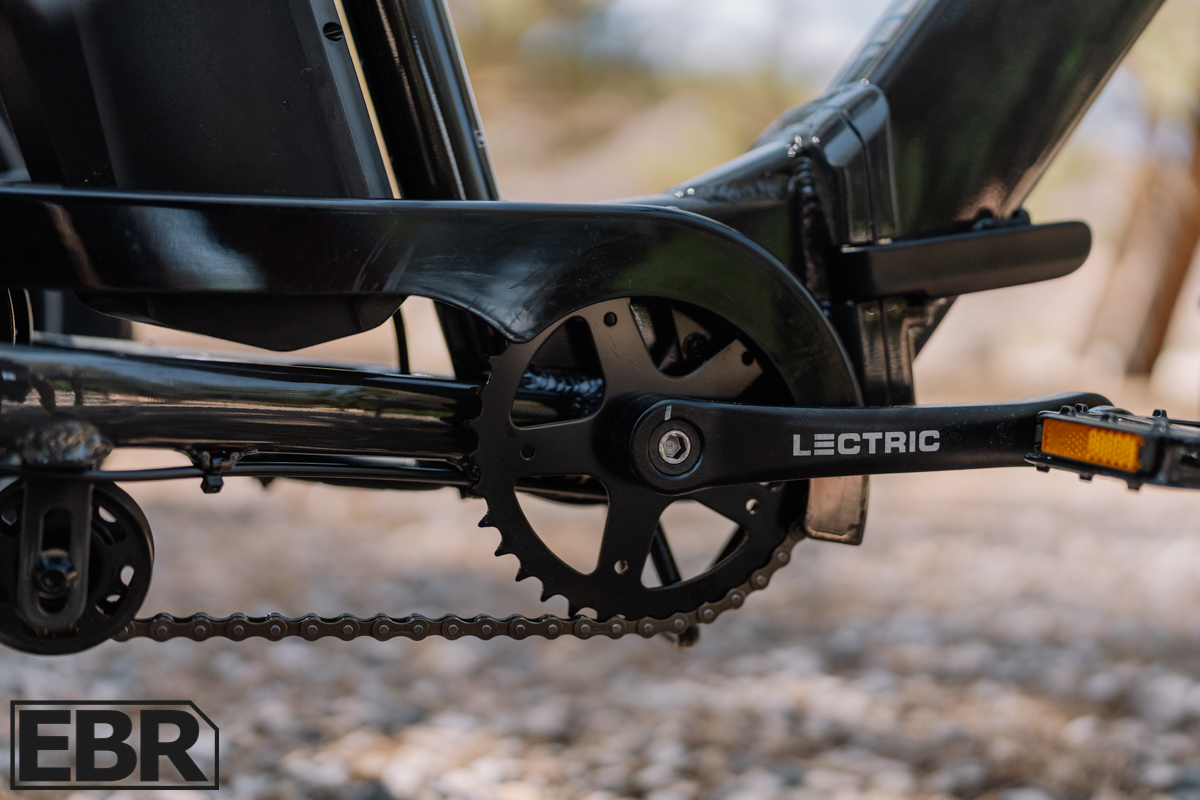

Lectric kept things simple with a single-speed setup using a 36-tooth chainring paired with a 16-tooth cog. This configuration is low-maintenance and works well with the electric assist system. No shifting to worry about – just pedal and let the motor do the heavy lifting when you need it.

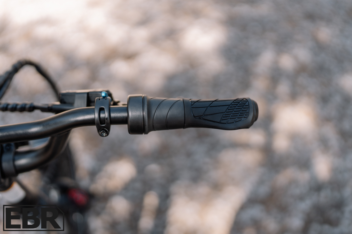

BMX-style handlebars with a 9-degree stem position improve posture compared to the original. Comfortable grips work well for extended rides, and the wide platform pedals provide good foot support. As mentioned earlier, the upgraded backrest-supported saddle takes some dialing in but offers good comfort once properly adjusted for your riding position.

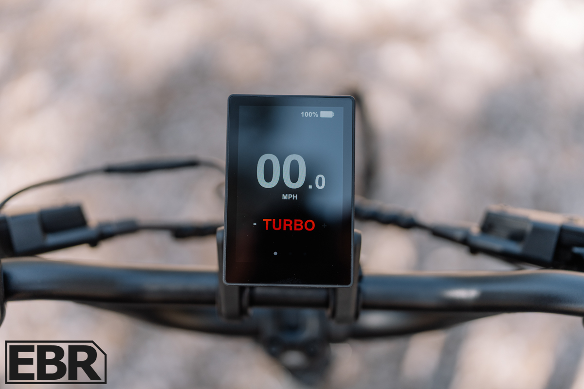

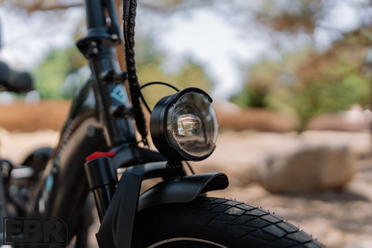

One of the standout upgrades is the new 3.5″ full-color TFT display that replaces the old black and white unit. This thing is bright with high contrast that remains easy to read even in direct sunlight – no more squinting to see your speed or battery level on bright days.
The user interface got a complete overhaul and it shows. You get a clean layout that’s still packed with useful data points, and you can toggle through different screens to see all the information you need. What’s really refreshing is how Lectric ditched the cryptic menu system that required you to decode abbreviated settings that made no sense. Remember having to reference the manual just to change basic settings? Those days are over.
Now both regular and advanced menus use plain language that anyone can understand and navigate. Want to adjust your power settings or change display preferences? It’s all laid out in clear, simple terms that don’t require a decoder ring to figure out.
