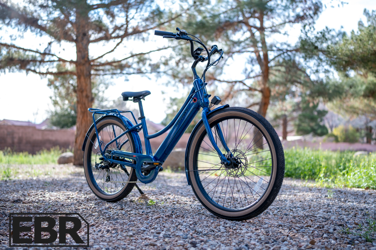

It seems the ‘comfort’ cruiser segment in e-bikes is having a bit of a moment in 2026. We saw just in the last few months, the Velotric Discover 3 2026 update from the Discover 2, and the Tenways Wayfarer as their first entry into this comfort cruiser segment, both of which were well-received.
Now, we have the folks over at Magnum dropping this, the all-new Magnum Melody, a comfy city cruiser that comes well-equipped with suspension, a rear MIK rack, class 2 and 3 speeds and a very sleek display integrated into a 60-degree adjustable stem – which is a first for me.
So, with a few days of clearing cold and wet weather that lingers this time of year, it was a perfect time to get outside and take this rig out for a ride and see how it felt when rubber meets the road in the Magnum Melody review.

Starting off with fit and feel, the Melody has that typical comfort cruiser relaxed geometry that puts you in an upright and relaxed body position with a nice clear view of the path. You’re not leaning forward with any awkward stress on your lower back and your palms rest naturally on the platform ergonomic grips. At 5’11, I found the fit to be very good for me. Fortunately, you have generous room in the seat post and a 60 degrees of adjustability in the stem to help dial in a fit that feels right for you. The leather saddle has a classic, almost vintage vibe and comes with a nice wide area for your sit bones without being so wide that it’s awkward to pedal, it’s a nice compromise. Once you head out on the ride, that’s when I immediately noticed the power on the Melody was punching above its weight class.
The rear hub motor, while nominally rated at 500W’s is seemingly unsuspecting. The Melody has 6 levels of pedal assist, a bold deviation from the more typical 4 or 5 levels commonly seen. From ‘Eco’ on the low end to ‘Hyper’ on the highest level 6 of pedal assistance, each level gets increasingly more powerful as you ascend the levels.
The motor is activated through a torque sensor to edge off the initial power and give a nice fluid and natural pedal assist that also allows for a smooth acceleration. Fortunately, the 6 levels of assistance allow you to just pick how aggressive you want to ride, you can easily relax and cruise around town on ‘Tour’ mode casually cruising at 12-14 mph or you can crank it to level 6 ‘Hyper’ mode and you get some serious power and hitting the class 3 max of 28MPH in a very quick sprint.
Frankly, it’s the best of both worlds, don’t want a ton of power and speed? Dial it back. Want to crank it up and burn through your battery range in an hour? Just flip to ‘Hyper’ mode and have a blast. You’re not stuck with an e-bike profile that’s either too laid back or too powerful, you’re getting a rig that can give both.
Hills are surprisingly easy for the Melody when you bump up the assistance, even steeper hills feel relatively essay making this a good choice for those that live in hillier areas.
The drivetrain and braking are nothing fancy and typical in what we see in these types of ebikes, an 8-speed Microshift Acolyte drivetrain with braking covered by Tektro hydraulic disc brakes with e-cutoff sensors for some extra safety. This included alloy falt pedals were a nice surprise over the more commonly seen plastics, complete with traction studs and reflectors for late night visibility.

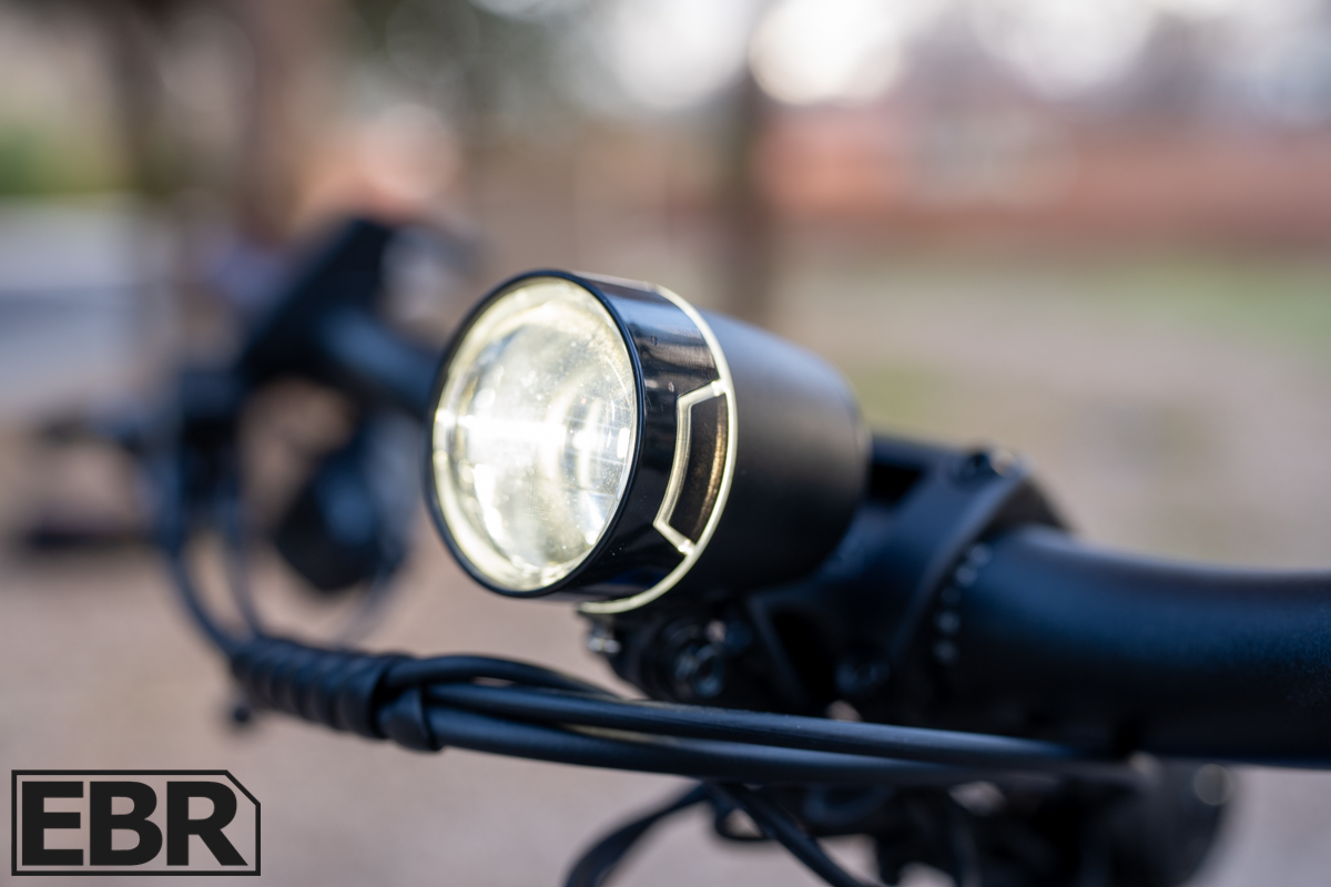

Speaking of visibility, the Melody comes with a a bright front LED headlight that has an adjustable angle and a tail light mounted on the rear MIK rack. The tires also have a reflective stripe that gives a nice dual-wheel profile when lights hit from the side increasing traffic visibility as well in low light rides.
In terms of gear, you have included front to back fenders, a 55lb payload rear rack that’s MIK compatible for all sorts of accessories and there are two mounting bosses on the seat tube for a water bottle cage.
All in all, the Melody delivers what you want in a comfort cruiser, first that’s a comfy ride and nice curb appeal. But, beyond that, the motor and power delivery really does punch above its weight class. It gives a capable, smooth ride that looks good and doesn’t cost an arm and a leg. In 2026, that’s a solid value.

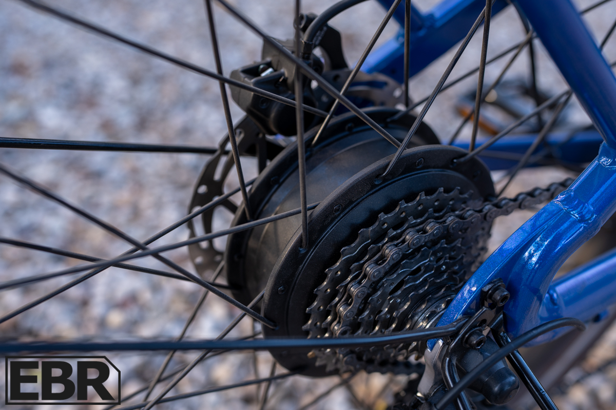

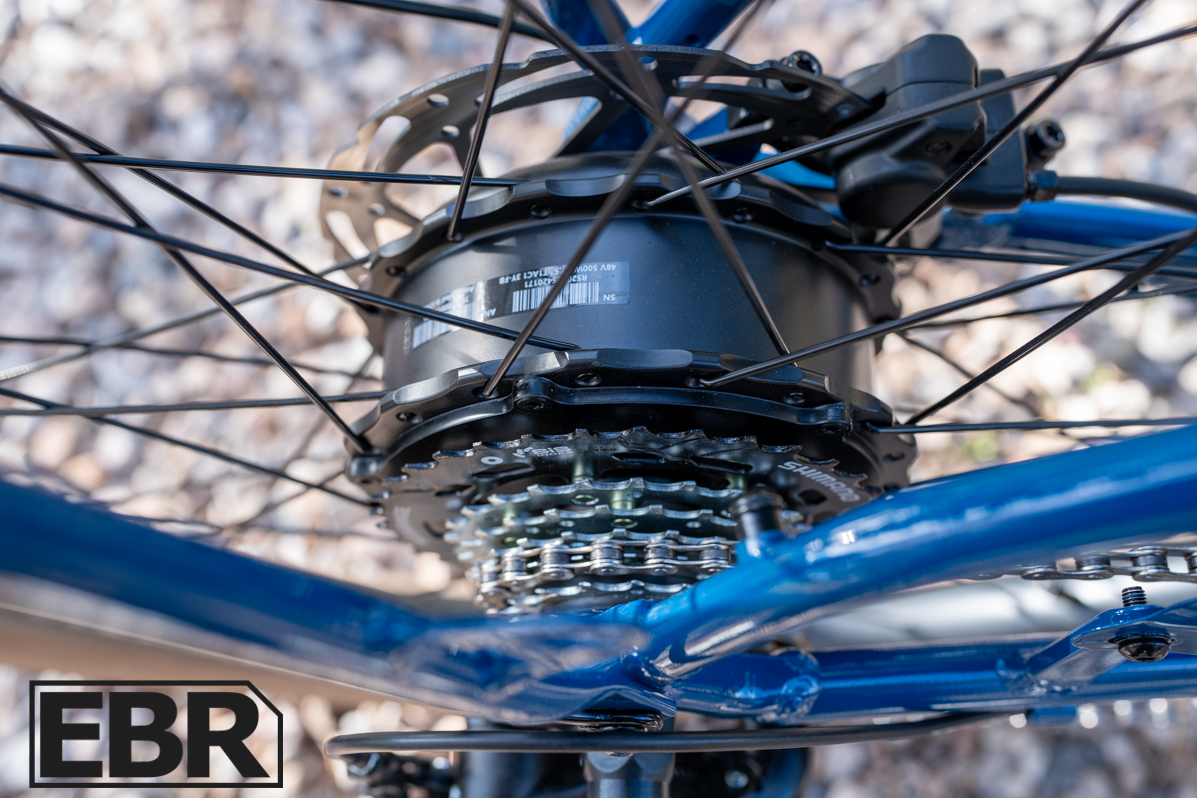

Power delivery on the Magnum Melody is covered by a 48V system and a 500W rear hub motor. On paper that sounds pretty generic, but this setup has a few tricks up its sleeve we should chat about.
First up, the rear hub motor is a 500W motor made by Sutto and pumps up to 750W’s. The motor is activated by either a torque or cadence sensor that is selected by the rider in the display settings.
I’m a big fan of brands giving owners both a torque and cadence sensor, it lets the rider decide what they like while using both, rather than needing to choose a bike with one or the other. Both have good use cases for different scenarios, and now riders have the luxury of using both and seeing what they like more.
Motor assistance comes in 6 levels, Eco on the low end and Hyper on the high end, each offering more power as you go up.
The 48V battery has 15 amp-hours totaling 720 watt-hours, containing Samsung cells and is UL 2271 certified. The Battery weighs about 9 lbs and fits inside the frame where it locks in place for use. The Melody comes with a set of keys so riders can have that security peace of mind in addition to being able to take the battery off the bike for storage or off-the-bike charging.

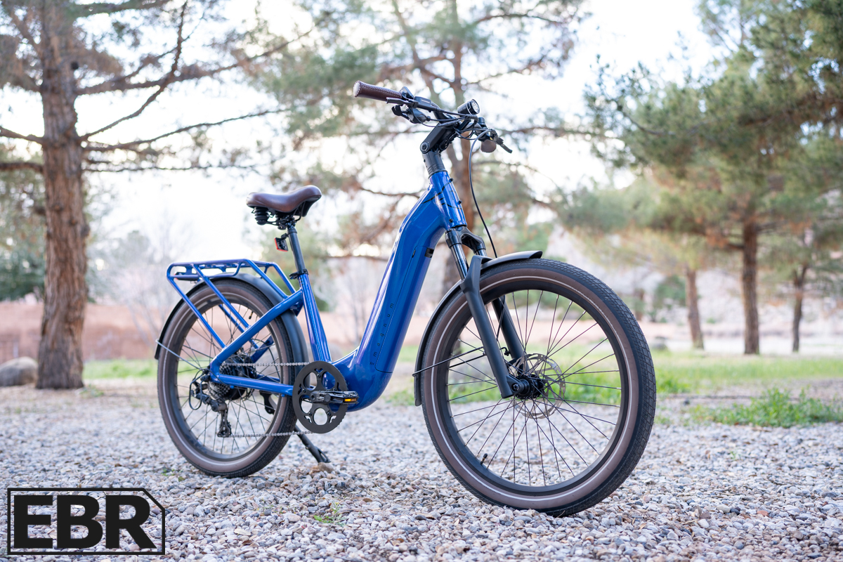

Components
Components on the Magnum Melody are straightforward with name brand parts. The frame is a 6000 series aluminum step through frame rolling on 27.5” wheels. Wrapping those wheels are 27.5×2.4” commuter tires with a nice accented tan color that compliments the other tan components. The tires have a mild commuter tread pattern and sidewall reflective strip for late night ride visibility.

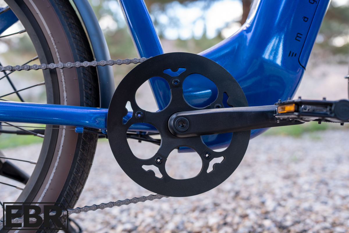

The Melodies drivetrain is made up of a Microshift Acolyte 8-Speed rear derailleur mated to a 11-32T cassette and 52T chain ring. I was pumped to see the Microsoft Acolyte has a clutched derailleur meaning better tension with less dropped chains and less abuse to the chainstay paint on the frame.

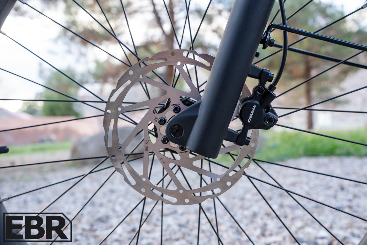

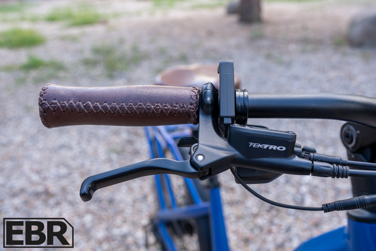

Braking is handled by Tektro HD-3520 hydraulic disc brakes with 2-piston calipers and 180mm rotors front to back. These brakes are widely known for good stopping power and that was the case with the Melody. For a little bump in safety, these brakes have a motor cutoff sensor to kill motor power when you are using it if you hit the brakes. This is a nice way to let you focus on a clean quick stop rather than fighting the motor as you try to slow down in a pinch.
The saddle on the Magnum Melody is a nice looking brown leather(ish) material and spring supports on the bottomside. The saddle is wide and cushy so it is comfortable, but not so wide that it distracts from being able to pedal without rubbing your thighs raw. Matching ergonomic grips in the same brown leather(ish) material and have platforms to rest your palms on longer rides.
The pedals are a flat alloy pedal with a 9/16” spindle and come with reflectors and traction studs for grip on the soles of your shoes. The crank arms are alloy and there is a chainguard to protect your legs from unwanted chain grease stains on your rides.

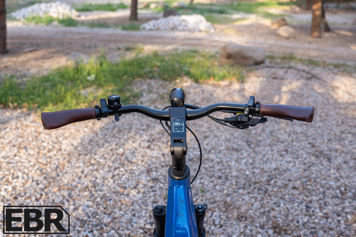

Up in the cockpit, you have a cruiser style, 28” handlebar with a center diameter of 31.8mm that has a rise and sweep back for that comfortable position these cruisers are so well-liked for. On the right side you have the Microshift 8-speed trigger shifters and a push throttle, and on the left you have a bell and your display control pad to manage your assistance and navigate the display settings. Supporting the handlebar is a 60-degree adjustable stem that also houses the display.

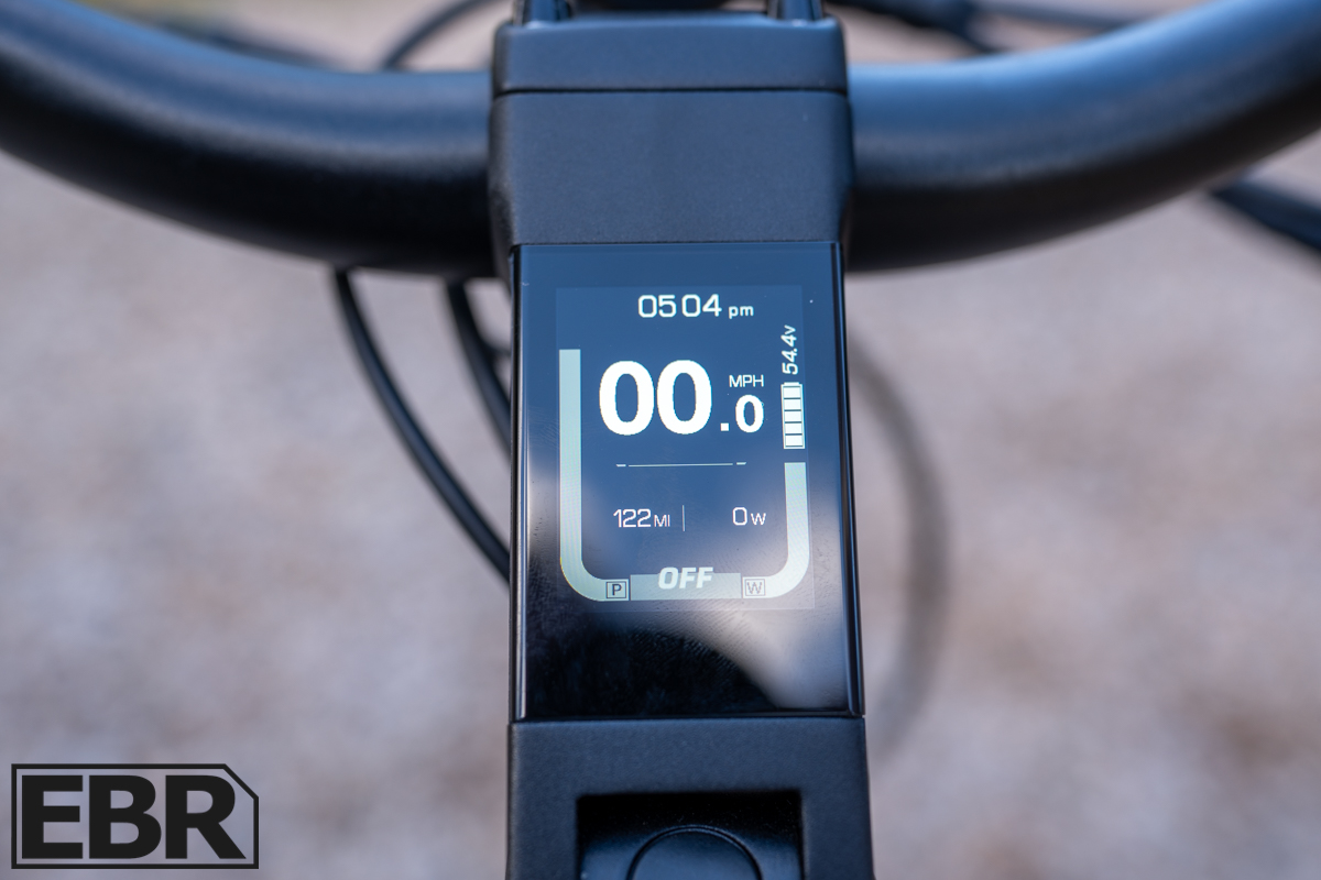

When I first noticed the Velofox display integrated into the stem, I wasn’t sure what I thought about it. On one hand, it looks very sleek and modern, on the other hand, I immediately considered the fact that you might need to buy a whole new stem/display combo if the display fails, or at a minimum, you wouldn’t be able to replace the stem very easily. But, I gotta say, It’s grown on me, it looks great and it has the ability to stay in a good angle relative to your eyes as it moves with the stem which I really did appreciate. It also leaves plenty of room for extra accessories if you like to clamp things on your handlebar, this rig has plenty of room left.
The data on the screen is straight forward, yet plentiful, where you have:
- Time
- Speed
- Voltage
- Battery Indicator
- Wattage in numbers
- Wattage in a Dynamic Bar Graph
- Power in a Dynamic Bar Graph
- Odometer
- Pedal Assist Level in Use
Scrolling to the next data screen by tapping the centered ‘M’ button on the control pad, you can see other useful metrics like:
- Average Speed
- Max Speed
- Total Time on Bike
- Pedal Assist Usage by Level
If you head into the settings menu of the display, you can change the class of the bike from class 2 to class 3. In Class 3, you get the pedal assistance to 28 MPH and the throttle caps at 20 MPH, where in class 2 mode, they both cap at 20 mph.
While there is no app for Magnum e-bikes, I found the Velofox display to be easy to read in all light conditions, neatly integrated into the stem and it offered all the settings and adjustments I would want on any given day of a trip out on the Melody.
