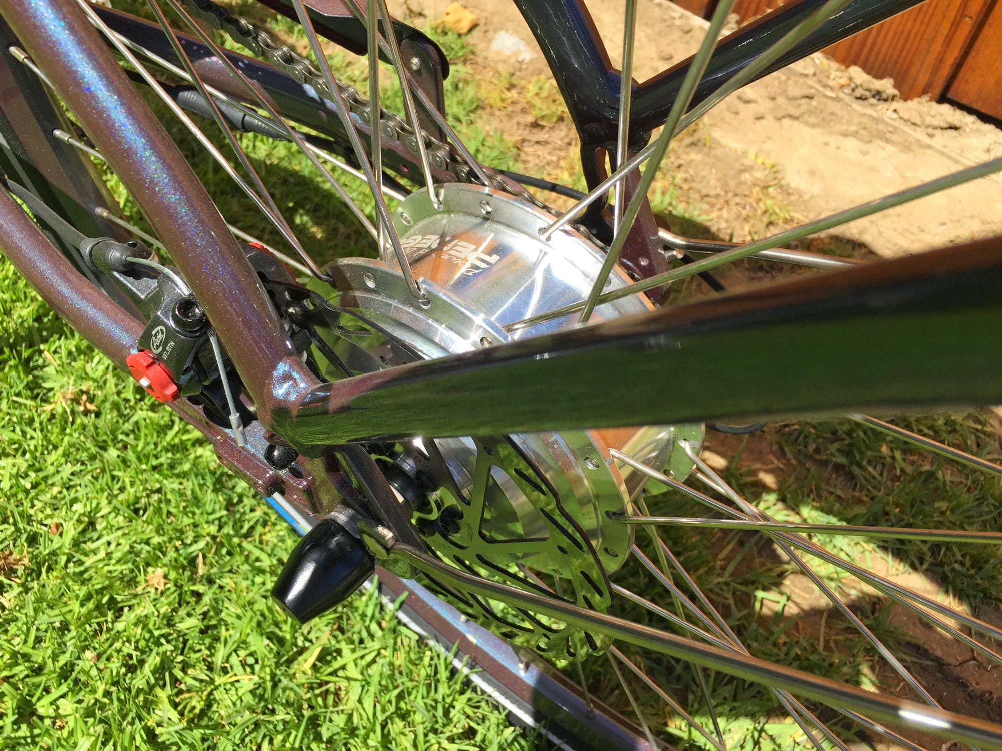

Driving this bike is a 500 watt planetary geared hub motor that’s made by Dapu (the same company that Easy Motion uses for many of their electric bikes). It’s one of the zippier, more powerful geared motors I’ve tested and on the City Commuter it delivers a lot of strength for overcoming wind or climbing moderate hills. It does produce some whirring noise, especially under full power, but that hasn’t bothered me as much as some other models and almost feels satisfying because the bike rides more like a moped. This is an important point… even though the bike offers seven speeds to pedal with and is one of the most active rides (ergonomically speaking) in the Pedego lineup, it is still heavier and less comfortable to pedal with than some other electric bicycles I’ve tested. For this reason, the more powerful motor, cadence sensing pedal assist, twist-type throttle and louder operation feel right. This is a great bike for cruising around the neighborhood or commuting short distances without over exerting yourself. It’s one of the best options for throttle-only operation that I’ve tested.

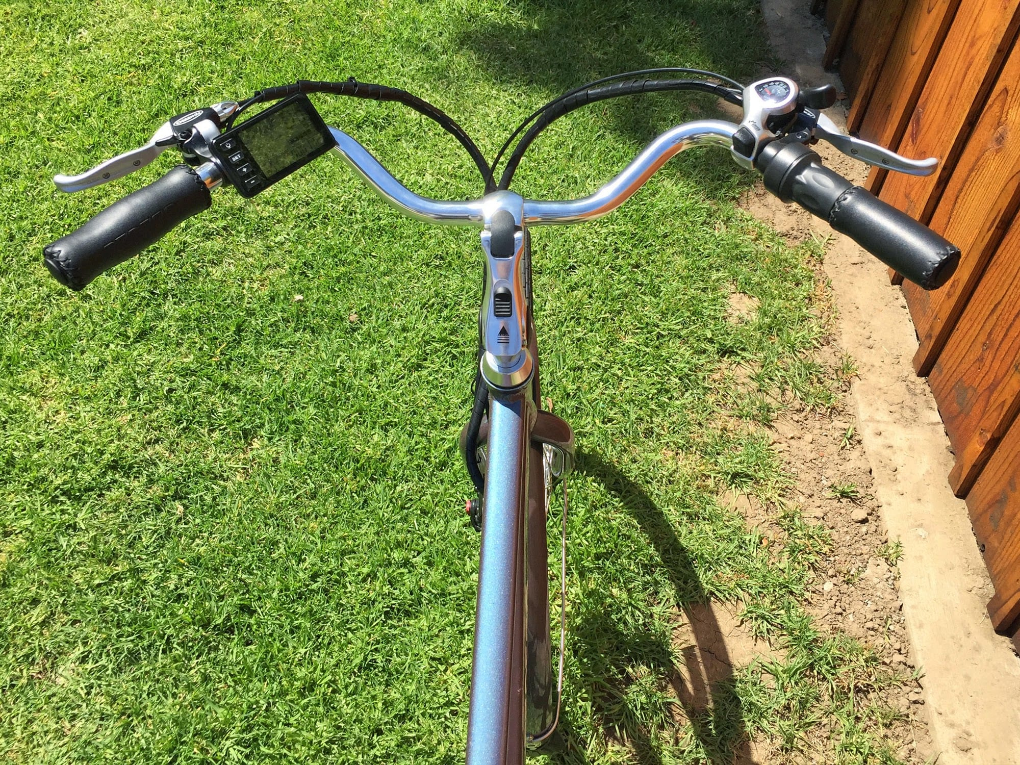

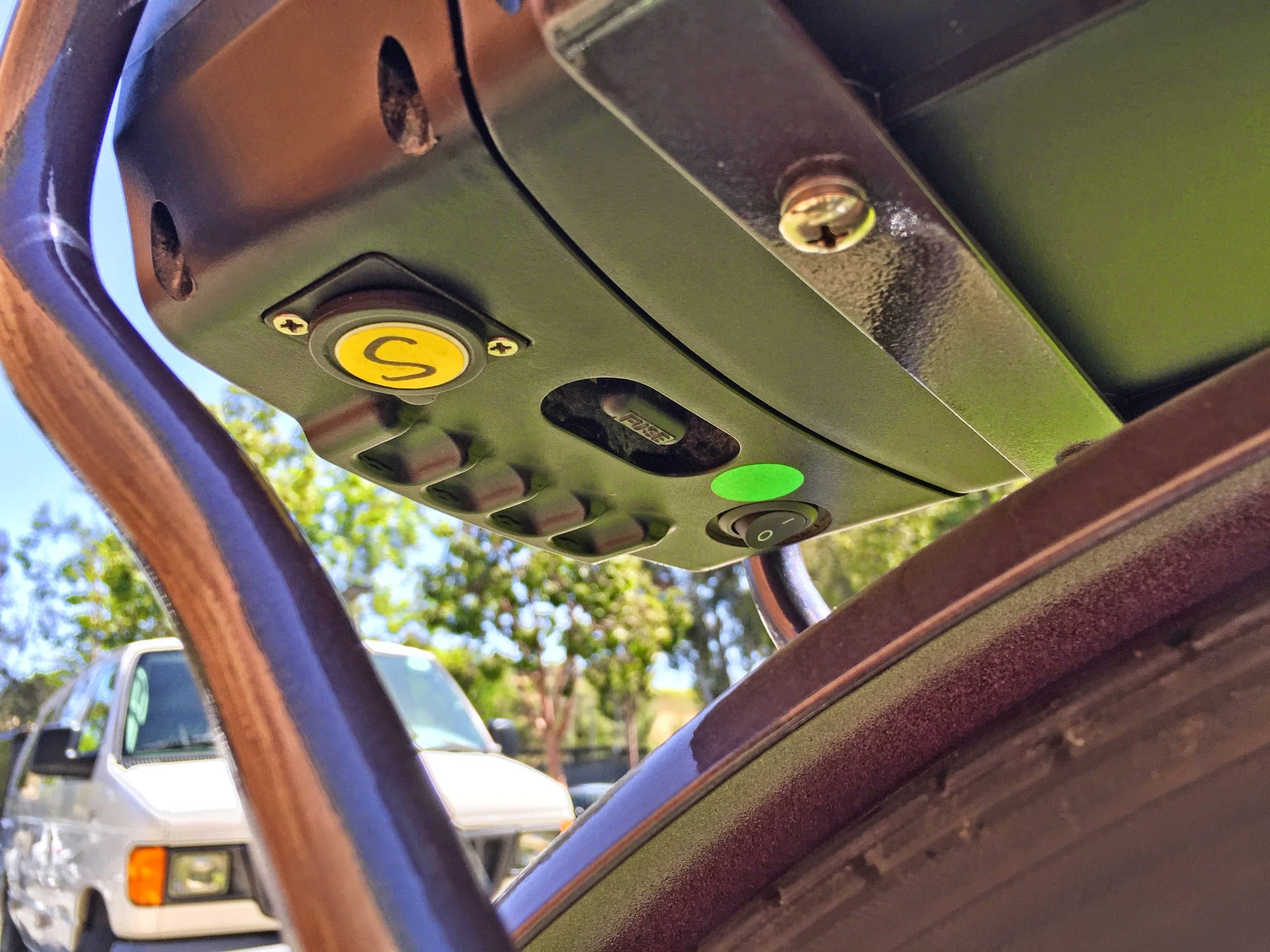

Operating the e-bike systems is pretty easy on the City Commuter. Once the battery is charged, mounted and locked to the rear rack you press the toggle on/off there and then again on the display panel. I like the LCD unit that Pedego is using now because it combines the LCD unit with four interface buttons that are large and reachable while riding. It swivels up and down but is not easily removable which means that it could take more weather wear over time. Using the “Set” button you can see your trip distance, time and odometer and access a bunch of different settings if you hold “Set” for a few seconds. I was able to change from Miles to Kilometers, edit the wheel size and adjust the top speed (which defaults at 20 mph). The other two buttons are “Up” and “Down” which let you navigate through five levels of pedal assist and a zero “throttle mode”. The lowest assist level felt smooth and quite which would be perfect for navigating crowds or conserving battery while the highest felt exciting and powerful. At any time you can twist the throttle and override assist and this is handy for boosting up a hill or getting started from rest. The bike uses a cadence sensor to activate pedal assist which means that once the bike is up to speed you really don’t have to push to get the motor to help out (which is the case with torque sensors). The drawback to cadence sensors is that starting from zero requires all rider power because the motor hasn’t “woken up” yet and this can be a pain if you’re in a higher gear. Again, this is where the twist throttle override comes in super handy. I found myself riding in level two or three assist and gear level six most frequently and I did use the throttle regularly :)

- Neat integrated USB charging port built right into the LCD display panel mounted to the left bar, charge your portable electronics while riding

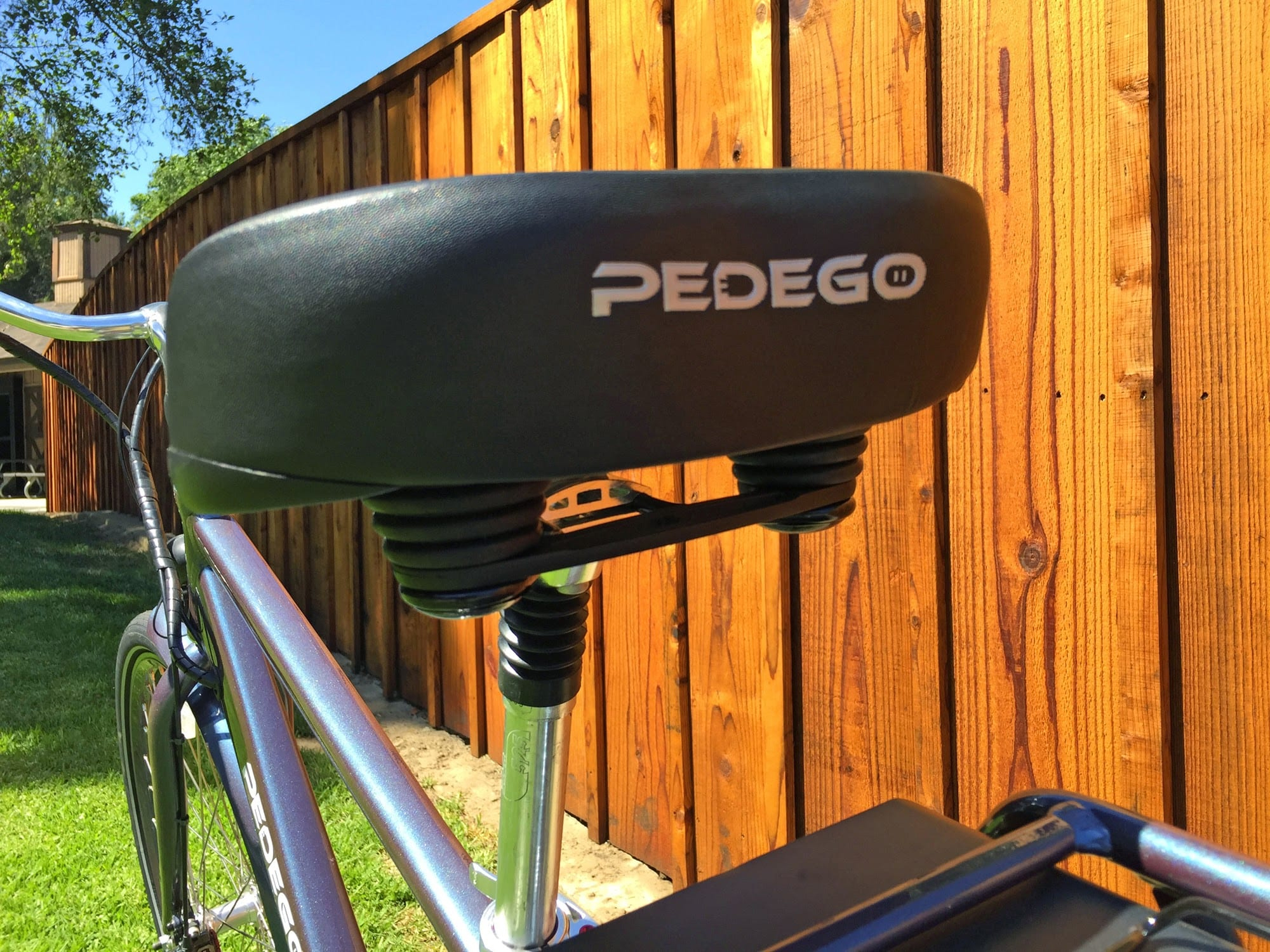

- The swept back handlebars, padded grips, oversized saddle with suspension seat post and large balloon tires help to smooth out bumps for a more comfortable ride

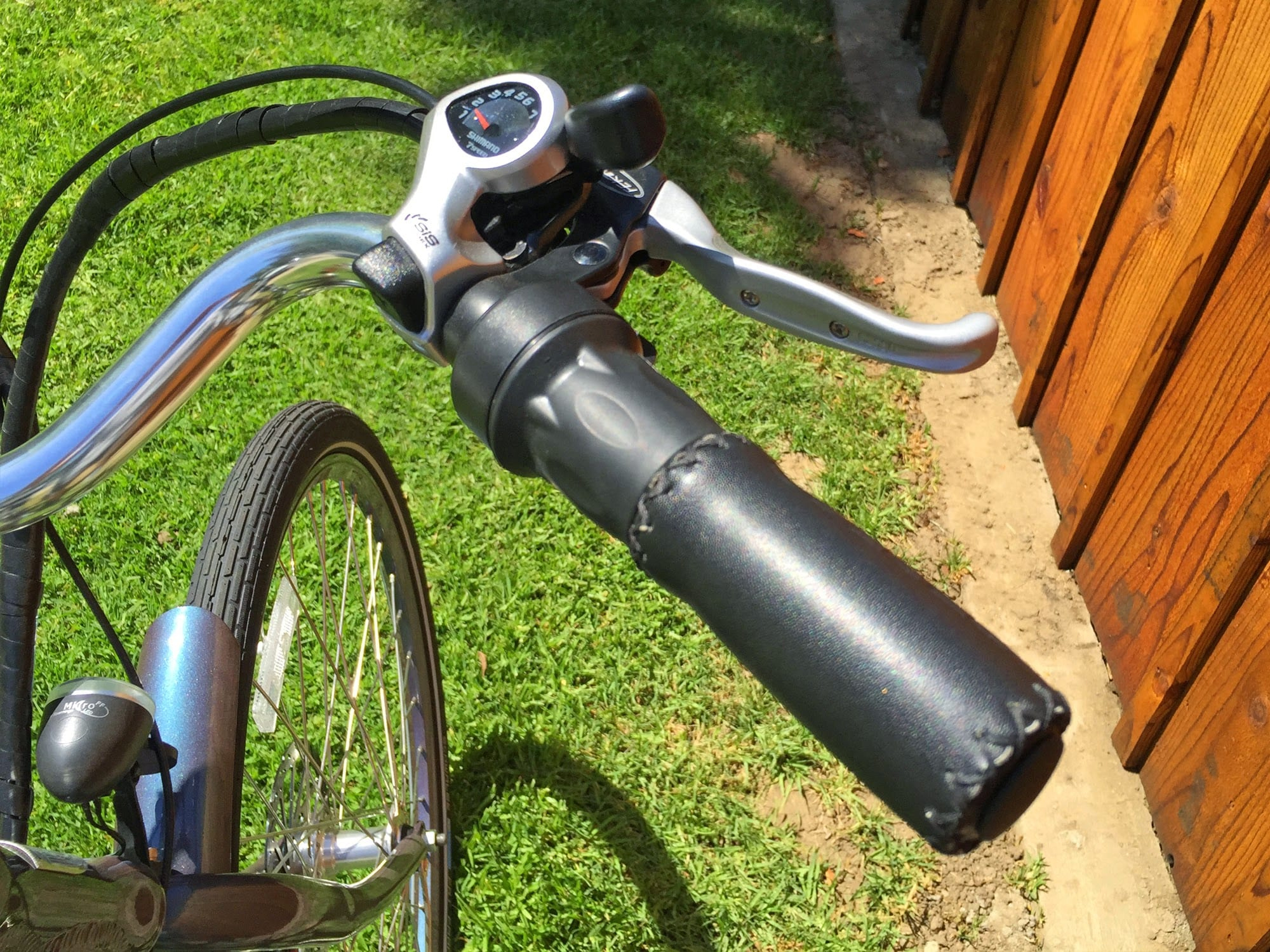

- Variable speed twist throttle can be used in level zero as “throttle only mode” or override one of the five levels of assist offering full power

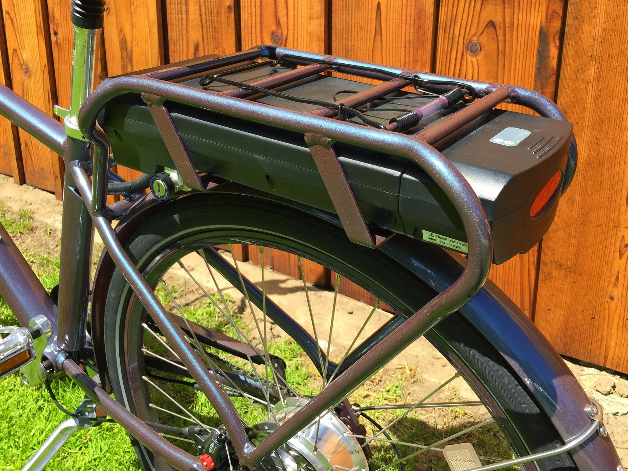

- Rear rack surrounds and protects the battery and is useful for adding a trunk bag or panniers (I like the Elements from Basil)
- The battery locks to the frame for security but is removable for convenient charging and to reduce the overall weight of the bike during transport

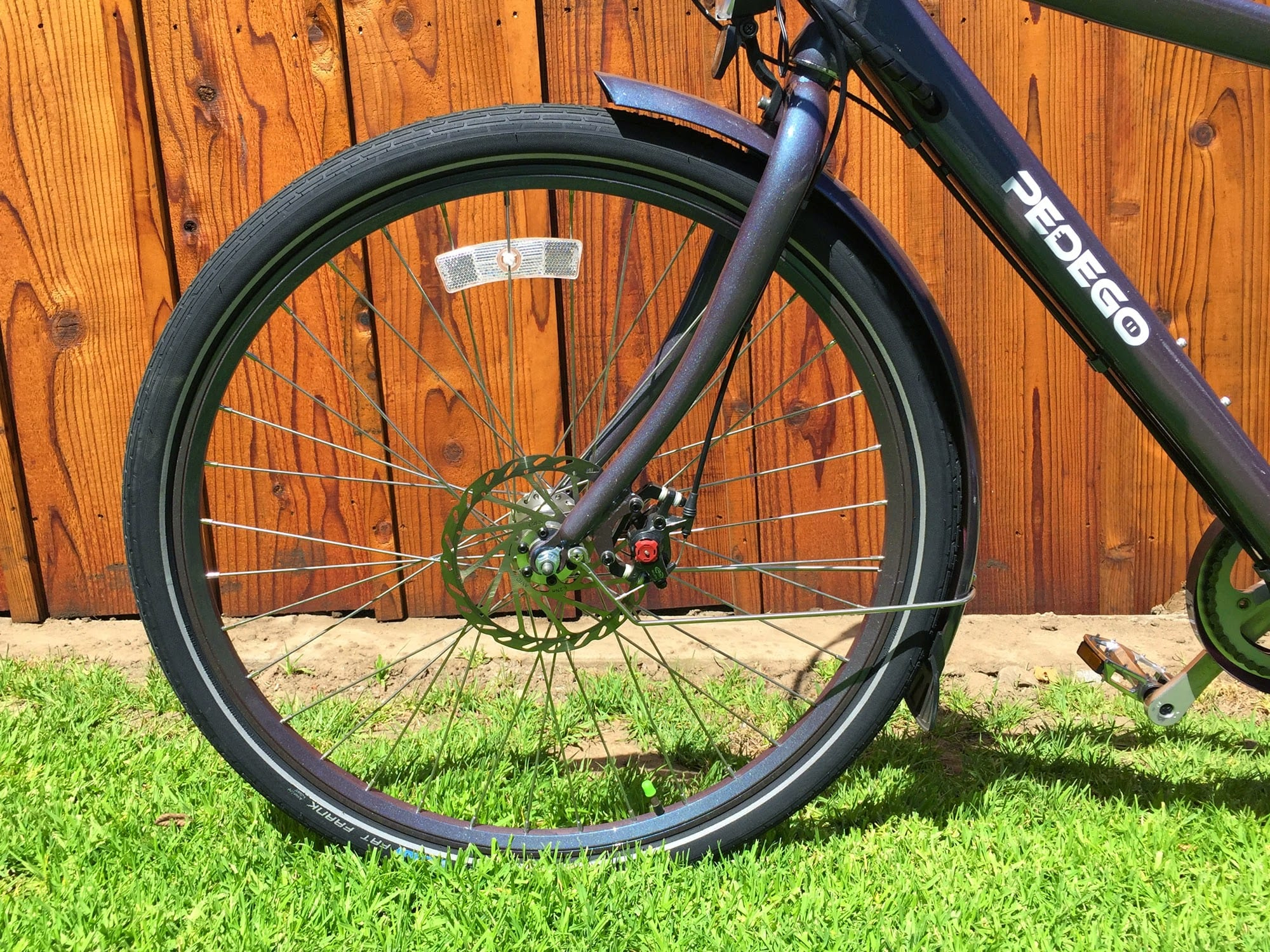

- Integrated motor inhibitors cut power immediately when activated, oversized 180 mm disc brakes are smooth and powerful

- The battery pack must be activated independently from the LCD display, this might deter tampering but requires extra time and may be forgotten (leaving the battery pack on to drain slowly)

- Tubing on the rear rack is wider and thicker than I see on most standardized racks which means it may not work with some clip-on panniers

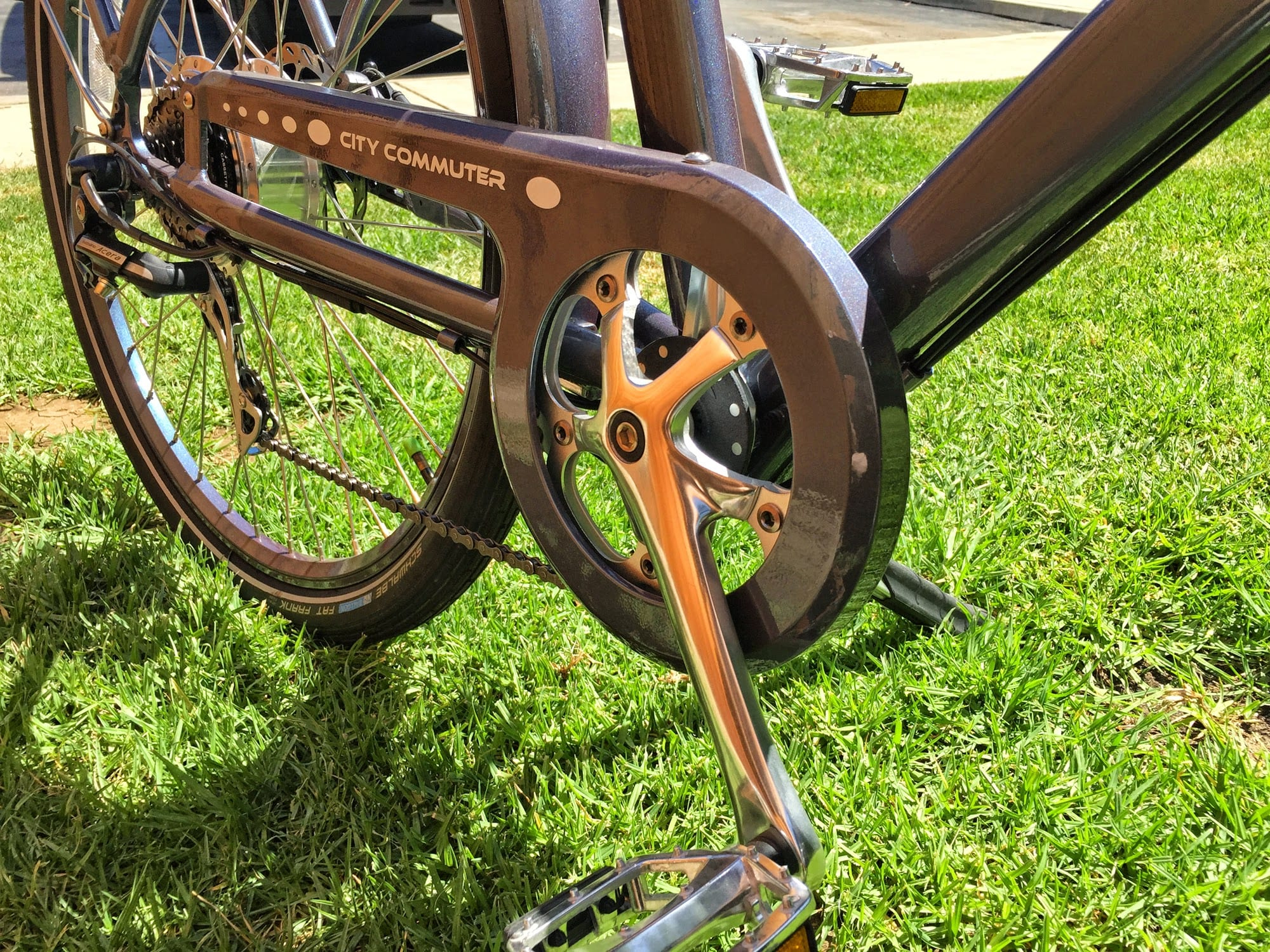

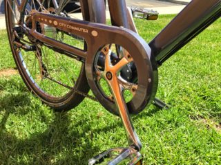

- Chain guard looks nice and is functional but may be bent easily if kicked or stepped on, be extra careful on the step-thru models
