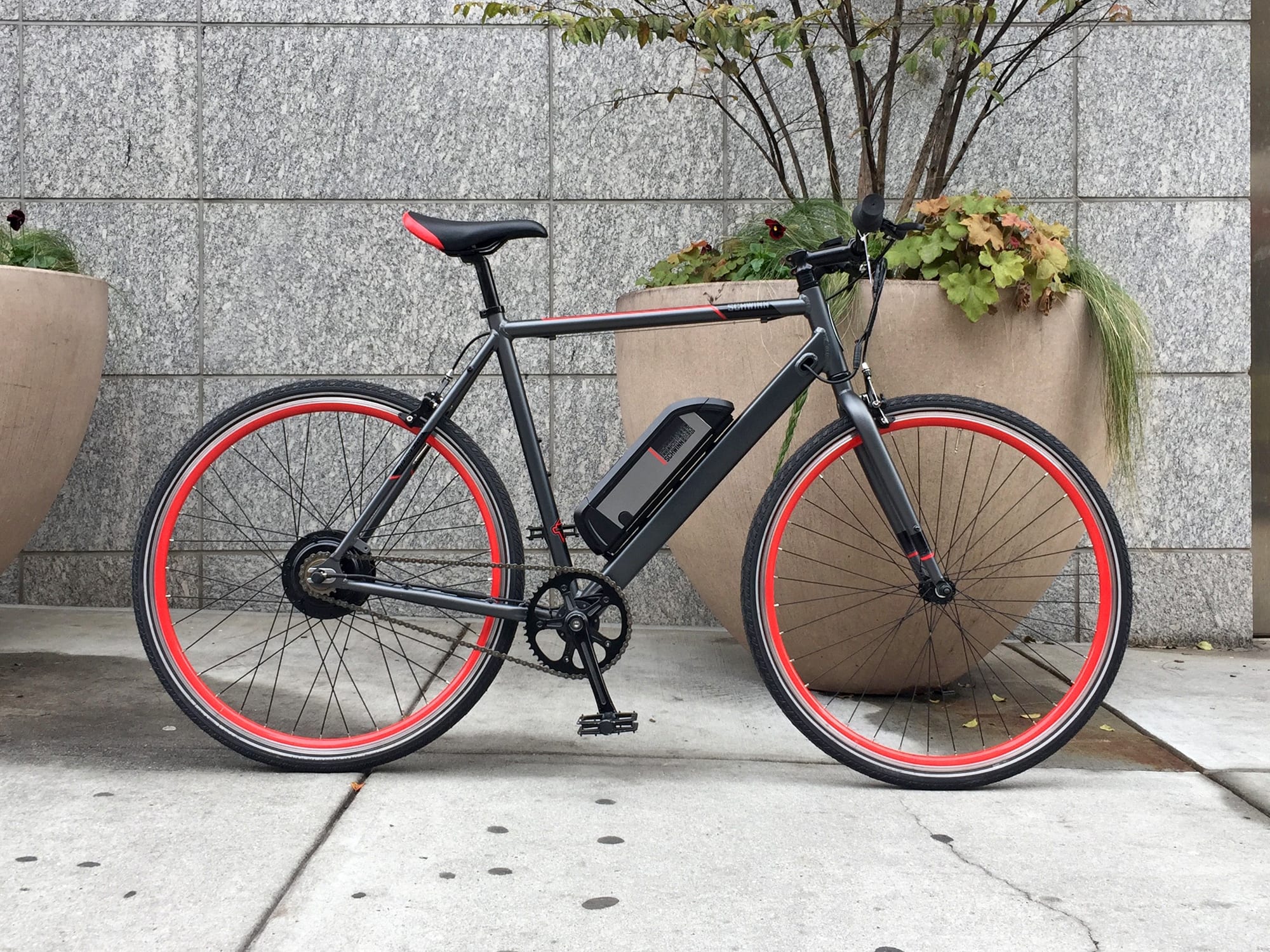

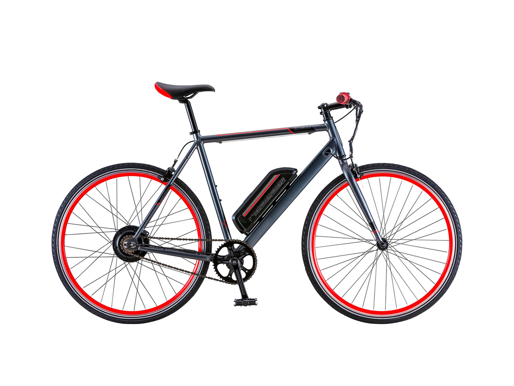

A lightweight, very affordable, name-brand electric bicycle available in three frame sizes for improved fit, purpose-built frame with color matched saddle, grips, and deep dish rims

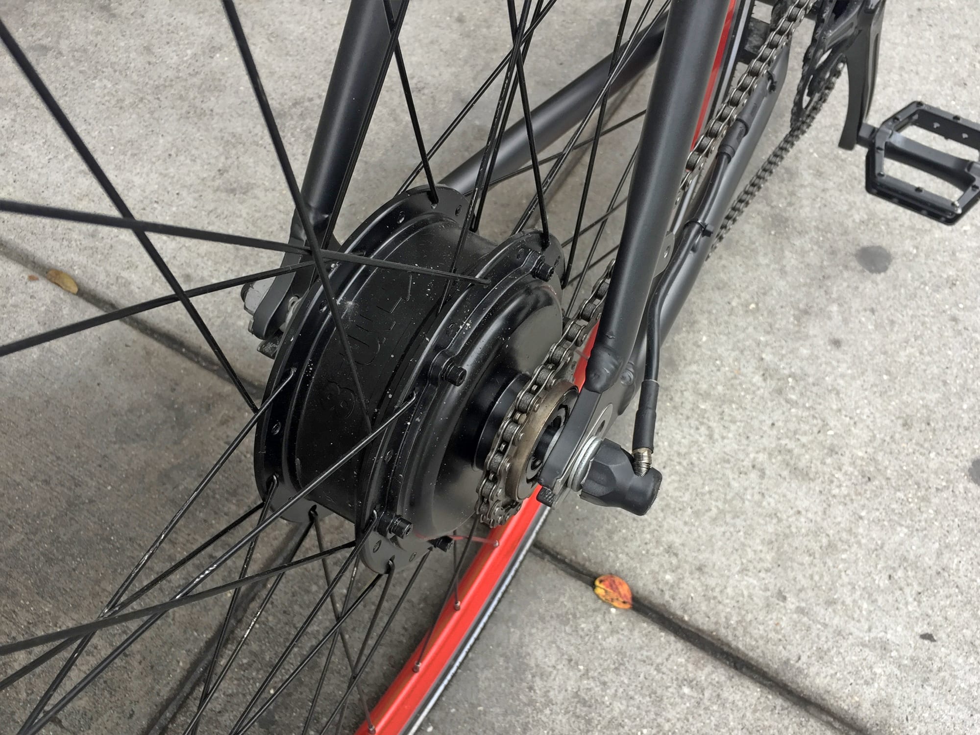

Efficient 250 watt Bafang hub motor feels smooth and responds quickly to a 12-magnet cadence sensor and motor-inhibiting brake levers, top speed 20 mph
Sporty diamond frame and large alloy platform pedals combine for excellent power transfer, longer stem creates a sporty aerodynamic body position, removable battery is easy to charge

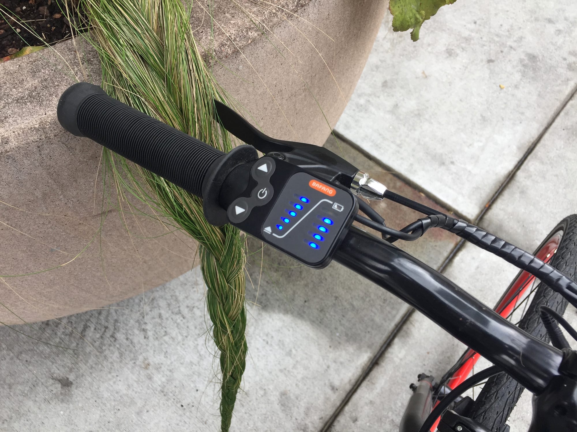

Very basic display only shows your assist level and battery estimate, rigid Aluminum alloy frame and skinny tires are sporty but less comfortable, single-speed drivetrain is durable but limited
Assist Level (5 Blue Dots), Battery Level (5 Blue Dots), Error Code LED

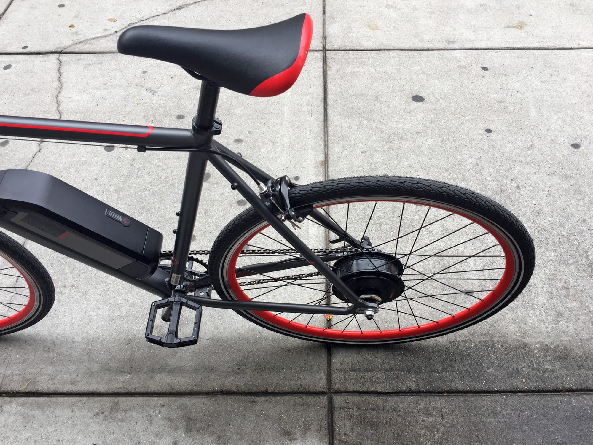

Driving this bike is a very standard, highly recognized, Bafang 250 watt internally geared hub motor. This thing is about as basic and proven as you can get… and it should be reliable. It’s what many European models use (because of their more strict legal framework around pedelec bicycles, and I have also seen it frequently on older US electric bikes to save money and before mid-drives and more fancy systems came about. It is not bad, it’s actually still very relevant because in addition to saving money and being simple, it’s lightweight, relatively quiet, and compact. It blends in with the bike and does not make it so rear-heavy, the way that larger hub motors would. The motor responds quickly to pedal assist once the bike is moving a bit, because there is only one gear and the first pedal strokes can be slow and more difficult to make. Many older electric bikes used five or six magnet sensors but the Monroe 250 and 350 have opted for the high-precision 12 magnet cadence sensor. And furthermore, both brake levers have motor inhibitor switches built-in. So as soon as you activate them, the motor cuts out and you will not be fighting the power of the bike, wasting the battery or overworking your brake pads. This e-bike does not have a throttle, and this allows it to fit into the Class 1 framework of the US, which means you can ride it almost anywhere in most cities. Throttles can be nice, but they add more potential failure points and raise the price. Ultimately, aside from the power cable feeding into the right side of the motor (which is a bit exposed and vulnerable), this thing is well designed and well chosen for this bike.

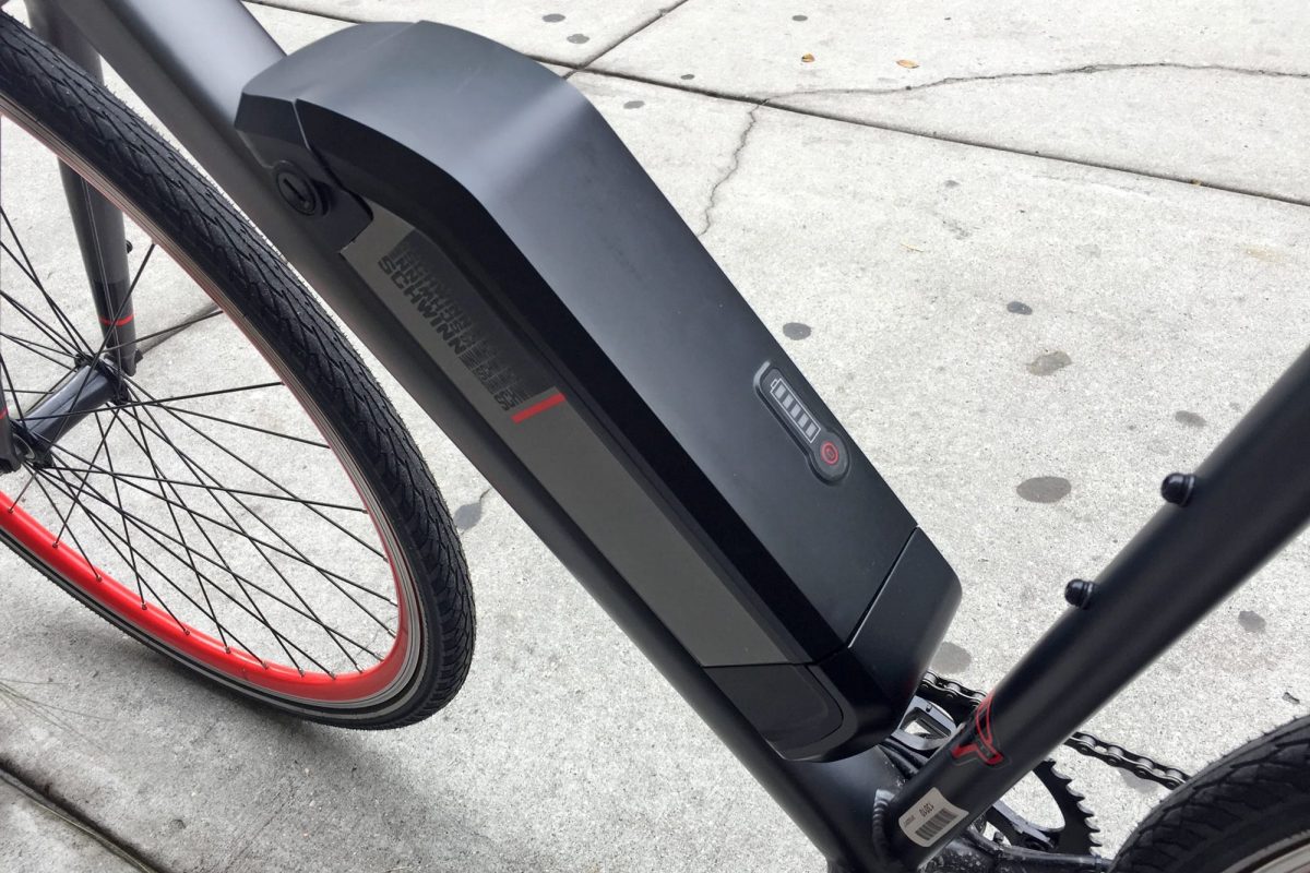

Powering the motor and LED display console is an average sized 36 volt 11.6 amp hour battery pack that is mounted to the downtube. Weighing in at ~5.6 lbs, it is positioned low and center on the frame to improve stability and create room for the bottle cage bosses and provide more space along the top tube for lifting and mounting the bike on hang-style racks. Do be careful of the wire brake line, which is run along the base of the top tube, because it could get snagged or rub into the frame and scratch it over time. Many of the other wires, for the electric assist and control systems, are internally routed through the frame. This design choice makes the bike look nice and provides good protection. I love how the battery pack slides out to the right vs. mounting down from the top and appreciate the three-bolt design of the track, which provides more strength where it attaches to the frame. It’s a nice pack for being on such a cheap bike… and batteries tend to be some of the most expensive parts of electric bicycles. It would be nice if there was a USB charging port somewhere on the bike, to use for your smartphone or lights, but at least the tires have reflective sidewalls and there’s plenty of room on the handlebar for mounting your phone and a rechargeable light separately. The charging port on the battery pack is low on the right side, which puts it near the right crank arm and creates another minor point of vulnerability, just be careful… the charger produces 2 Amps, which is very average and should take 4.5 to 5 hours for a full refill.

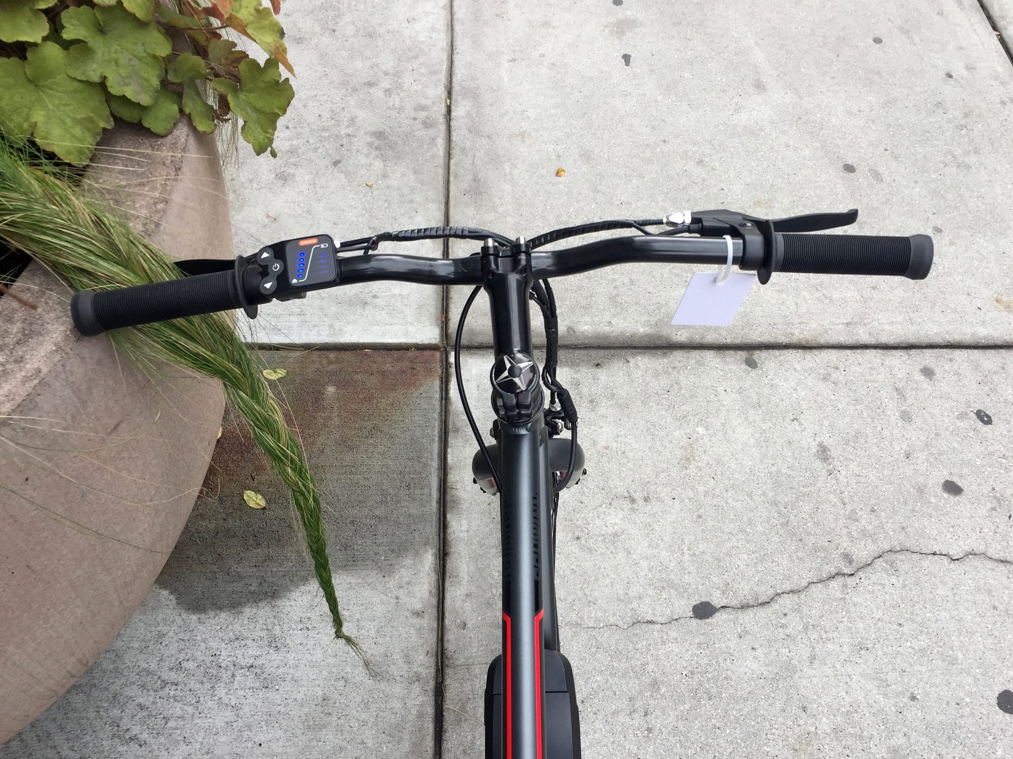

The cockpit and control design of this electric bike are incredibly simple. Once the battery pack has been filled and mounted properly to the frame, it does lock by the way, you just hold the power button on the control pad near the left grip, and it blinks to life. There are two menus here, the left chart shows five dots that indicate 0-5 level of pedal assist. The higher you go, the zippier and faster the motor will spin but it will also draw more power, depleting your battery more quickly. The second chart is a battery level indicator showing five dots, each representing a 20% drop. The display itself is encased in black plastic and has sealed buttons built in that seem well protected from water and dust. It does leave something to be desired when you have experienced fancier ebike products, but it gets the job done. You won’t see your speed, average speed, trip time, odometer, trip meter, range estimate, or any other fancy stats… just your power level and battery level. The buttons were easy enough to reach and press, and I like how the black casing of the display blends in with the black handlebar and matches the black spokes, chainring, pedals, and even the hub motor casing. The one thing I was conflicted about was how bright the blue LED lights were. They worked fine in broad daylight, but at night, it could be distracting or even annoying… so I have used masking tape to dim this sort of light on my own electronic devices before, and I offer that as an inexpensive way to tone down the brightness if you like.

Available in three frame sizes, so even though this is a pretty tall high-step frame, it should be easier to approach and more comfortable to ride for a range of people
I love that even though the bike is minimal and simple in some ways (including price), they managed to squeeze in bottle cage bosses and fender bosses, so it can be used in many different environments… it might even work with a rear rack because of the seat stay bosses, but it didn’t have dropout bosses, just a tab for adding a chain cover (which the Monroe 350 comes with stock and I found out later that the Monroe 250 also has one!)

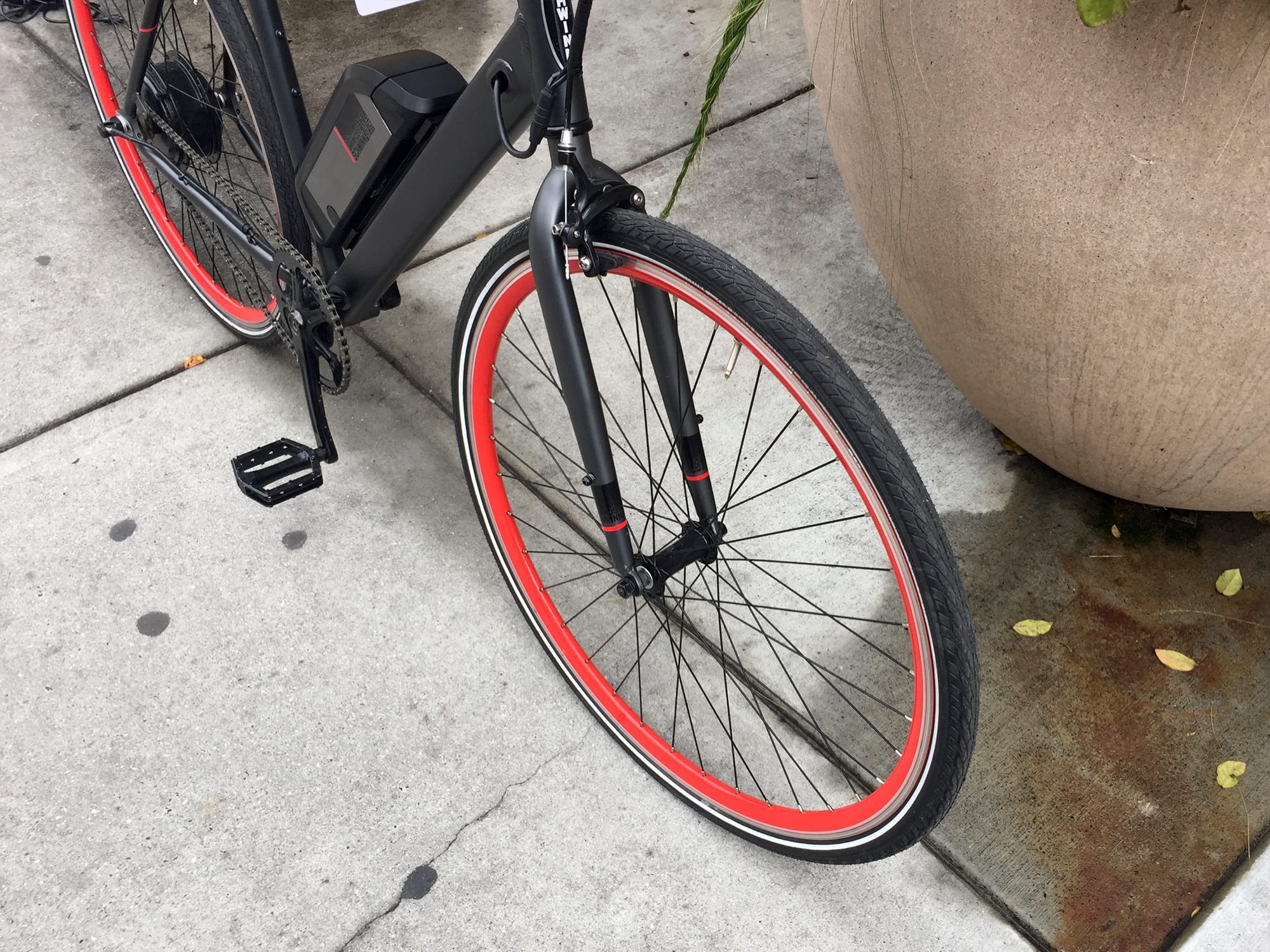

This is a purpose-built electric bike with internally routed cables and a nice paint job, notice how the frame, fork, grips, saddle, and rims all have red accents to tie in and the hub motor, spokes, chainring, cranks, and pedals are all black to match
Single speed bicycles like this tend to require less maintenance, have fewer chain drops, ride quieter, and have a cleaner cockpit which is less prone to damage in a city environment
Weighing in at just over 42 pounds, this is one of the lightest electric bicycles I have reviewed and that makes it easier to lift up stairs if you live in an apartment, it also has a removable battery pack so you can shave 5.6 lbs more just by taking that off and going in two trips
Great pedal choice, they are large, sturdy, and provide excellent traction vs. a cheaper plastic design, Schwinn had to cut costs on some parts to keep the Monroe 250 at that $1,200 price point but I’m glad the pedals were not one of them
I noticed that the battery pack was attached at three points to the frame vs. just two on some conversion designs, this provides more strength and is a good move considering the more sporty rigid design of the bike

Deep-dish rims like the ones used here offer more strength and a slight aerodynamic edge along with some fun styling, but they require more expensive tubes with longer valve stems, it’s a minor gripe but I just wanted to be clear on the trade-offs
The power cable leading into the hub motor is a bit exposed on the right side dropout, be careful not to snag it or allow the bike to tip over onto the right side (lean it towards the left because that side of the bike is less delicate), some ebikes have derailleur guards and I feel that this could protect the wire or that a different motor design with a more tucked-in cable like the Shengyi or Dapu motors could be useful, especially since this e-bike doesn’t have a kickstand
There’s no chain protector or guide to keep pant legs from getting greasy or snagged, it’s a minor complaint here because there’s only one gear and the chain is less likely to fall off, consider a velcro pant retainer like these to stay clean
The compact, efficient 250 watt hub motor isn’t going to be a great climber or feel as zippy as some competing electric bike models, but it is lightweight and fairly efficient
The display is simple, easy to reach, and appears to be durable, but it doesn’t show your speed, how far you’ve gone, or a precise range or battery estimate like some of the fancier ebike products on the market now

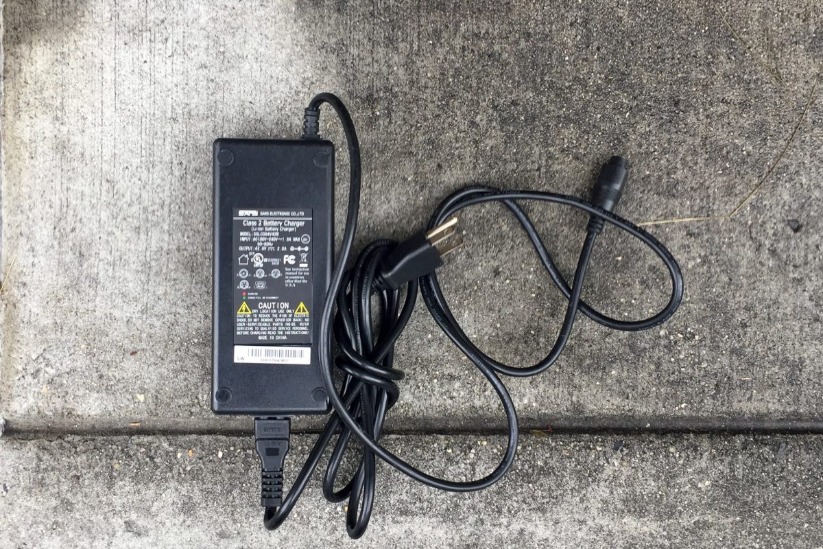

The battery charger is pretty basic, the end plug is plastic vs. metal, and the port where you insert it on the right side of the battery is fairly close to the crank arm and could get snagged or broken more easily there, so be careful

The blue LED’s on the display panel are VERY bright, which is great during the day but could be distracting or even bothersome at night. I might put some masking tape over the display just to dull the brightness for riding in dark conditions

I thought ‘Purpose Built’ meant that the bicycle incorporates the battery into the frame. From the pictures, it seems that the battery is slapped onto an existing frame. From that viewpoint, this bike is not ‘purpose-built.’ What is the feature on this bicycle that indicates that this is purpose-built?
I define purpose-built as a frame that was designed specifically to integrate with an electric drive system. In this case, the battery mounts with a triple bolt pattern vs. just two, the electronic cables are internally routed through the frame, and the rear dropouts have a steel insert to provide greater strength against the motor axle (as it produces more torque and rock when starting and stopping compared to simple pedaling by the rider). The cadence sensor is also tucked inside the chainring on the right side and the cables for it are tucked in very nicely. You are correct that the battery is not fully integrated on this model, but I still think it’s a big step up from an aftermarket kit conversion with lots of wires running across the frame and a less secure or balanced battery design.
