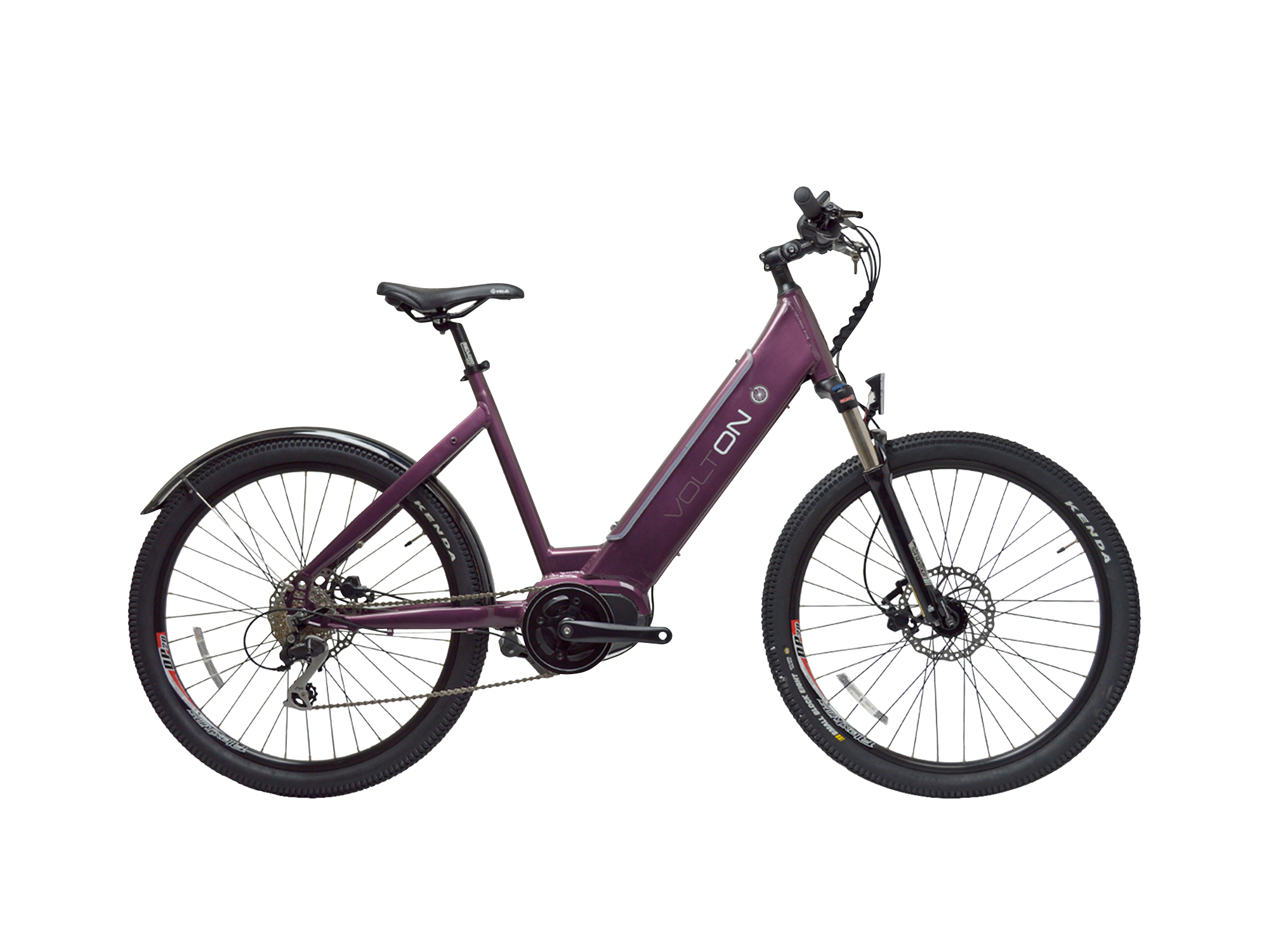

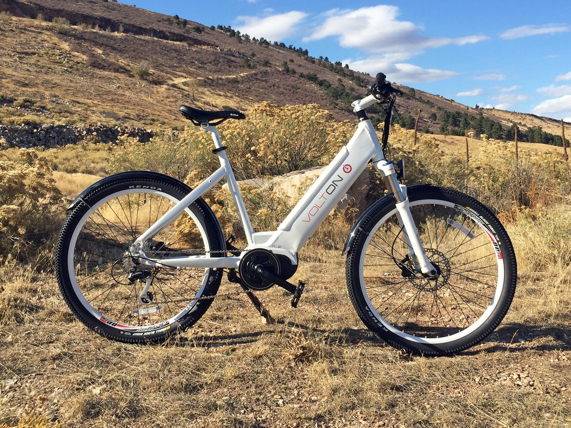

The latest Volton Alation electric bike builds on what has worked for Volton over the past several years (a mid-priced, powerful ebike with clean battery integration) but improves frame balance, efficiency and climbing power with a Bafang Max Drive mid-motor vs. a hub motor or older bolt-on BBS02 motor. The Max Drive looks a lot more polished and in my experience offers excellent power without producing much noise. While the diamond frame version of this bike (which comes with either a 24″ or regular sized 26″ wheel) is on par with many competing bikes I found the step-thru model to be unique and exciting because it opens up trail riding to petite riders in a way that inspires confidence. This model also comes in the 24″ or 26″ wheel size as well as several fun colors but doesn’t skimp on power. The battery is just slightly smaller (in order to fit in the smaller frame) but otherwise it’s basically the same bike. Trade-offs with most step-thru bikes include a flexier feeling frame and often more limited bicycle rack mounting options… thankfully the battery and both wheels are removable.
I tested this e-bike with lots of help from my girlfriend who is ~5’2″ and an avid pedal-power mountain biker. At first the weigh of the bike was a question mark and the lack of bottle cages, clunky kickstand and rattly fenders gave us pause. The first half of the review above was filmed with the fenders still attached but for mountain biking applications you’d be well served to take them off immediately. That’s the thing about this bike, it’s really well rounded and would work for neighborhood riding in the rain, high speed 28 mph commuting in the city if you added a rack or trail and light mountain riding as we did. There just aren’t a lot of bikes out there that let you jump right off onto both feet with no problem. Furthering this sense of control and confidence are the powerful and easy to use 180 mm hydraulic disc brakes. For riders with smaller hands and less muscular forearms and fingers these brakes are a real blessing. Keep in mind… you can pay a lot more for e-mountain bikes with adjustable length levers and lighter weight air forks and shift sensing and 203 mm rotors etc. etc. but most of those aren’t truly step-thru’s like this even if they are marketed to petite riders and they all cost a lot more. Volton is maintaining that balance of value and while I wouldn’t call this bike cheap at $2,649 it is certainly justifying the price with a lot of upgraded components and custom frame.

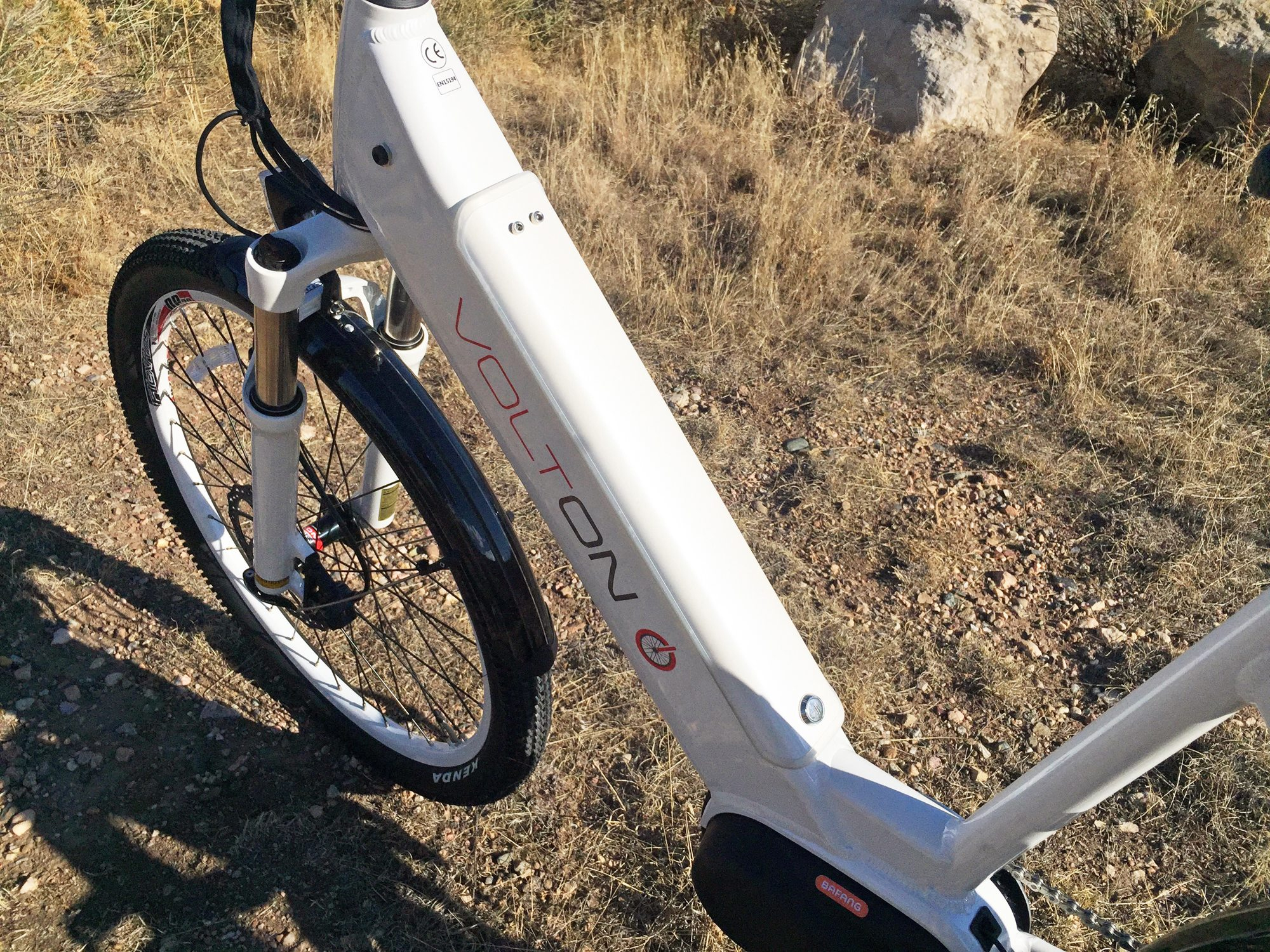

A few gripes I have to mention are how tricky it was to get the battery pack out due to the canvas bag it’s mounted in. This made it tight (reducing rattling) but the handle started to tear after taking it out and putting it back a few times and even with my knowledge of how to do it correctly… it took more time than other e-bikes I’ve tested. The battery is low, centered and completely hidden in the frame. The cover locks for security but is just made of plastic so maybe not as confidence inspiring as some other designs. The cover also didn’t sit perfectly flush and tight with the tubing so I believe that in heavy rain some water would get in. That’s not a huge issue as the pack itself is sealed in a metal box but the bag and wires might get a little wet. At ~7.1 lbs the battery can be charged on or off the bike and is nice to take off if you’re lifting like for a car rack but I think I’d prefer to just leave it in given the hassle.

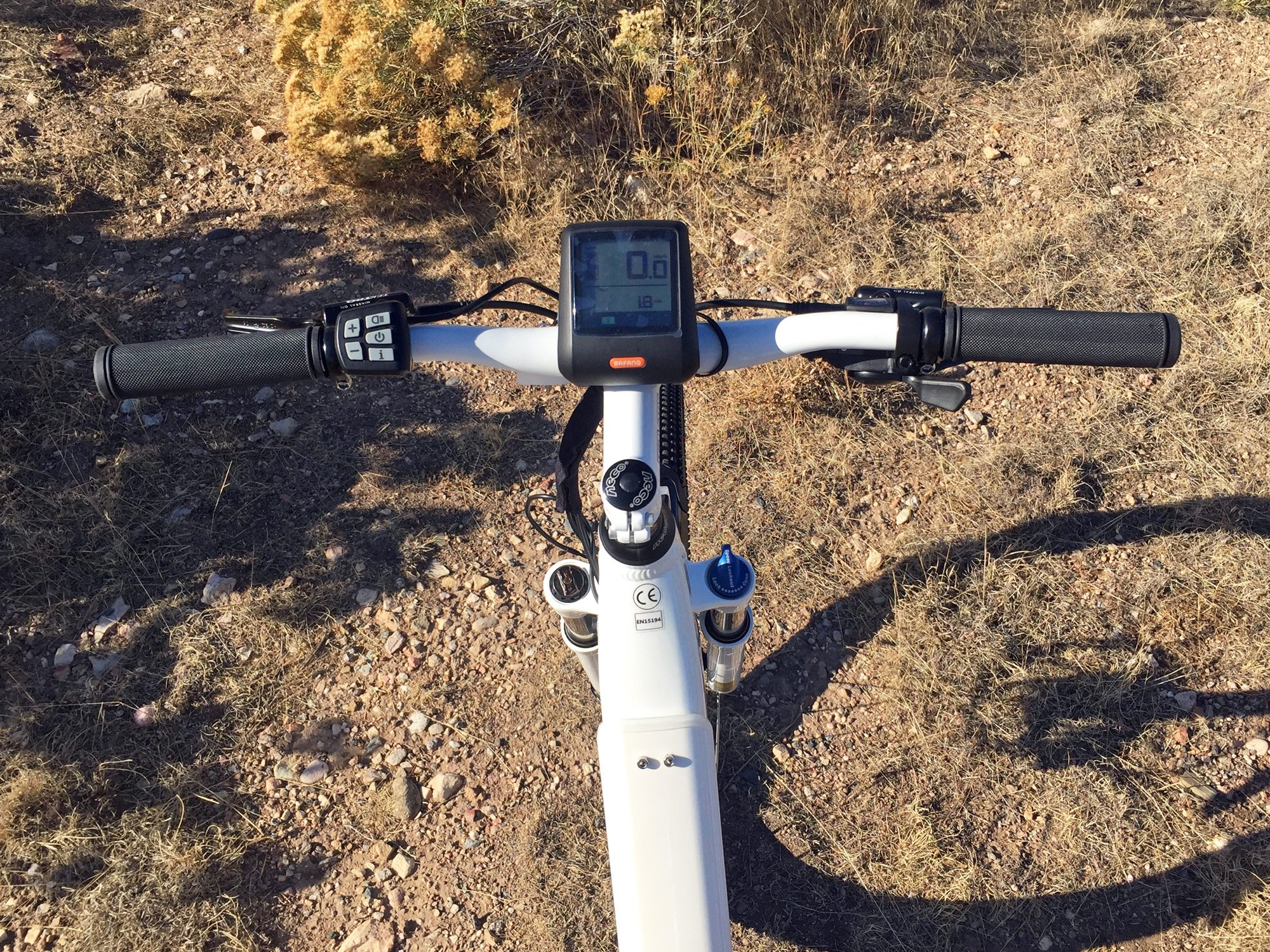

Once charged up, activating the bike is easy and clear thanks to a multi-button control pad positioned near the left grip. Just hold the power button then press + or – to change assist levels. You can go all the way to zero and use the battery just to power the computer display showing speed, range and odometer readouts as well as the headlight or you can arrow up to level 5 for maximum power and speed. Note that by unlocking the display (double tap the “i” button then use +, – and i to navigate) you can change the top speed and adjust other settings. The maximum speed is 28 mph but we tested at 20 while trail riding to perform as a Class 1 ebike for legal reasons. In the parking lot, I was able to hit the top speed by shifting to the highest gear and using level 5 assist and I was really impressed with the power and how quiet, smooth and responsive the motor was.

- By double tapping the “i” button you can enter the display settings and change the top speed (by entering the unlock code that Volton provides) and this lets you hit up to 28 mph top speeds as a Class 3 or dial it down as low as you want, at 20 mph it’s Class 1 and can be used on more mountain bike trails

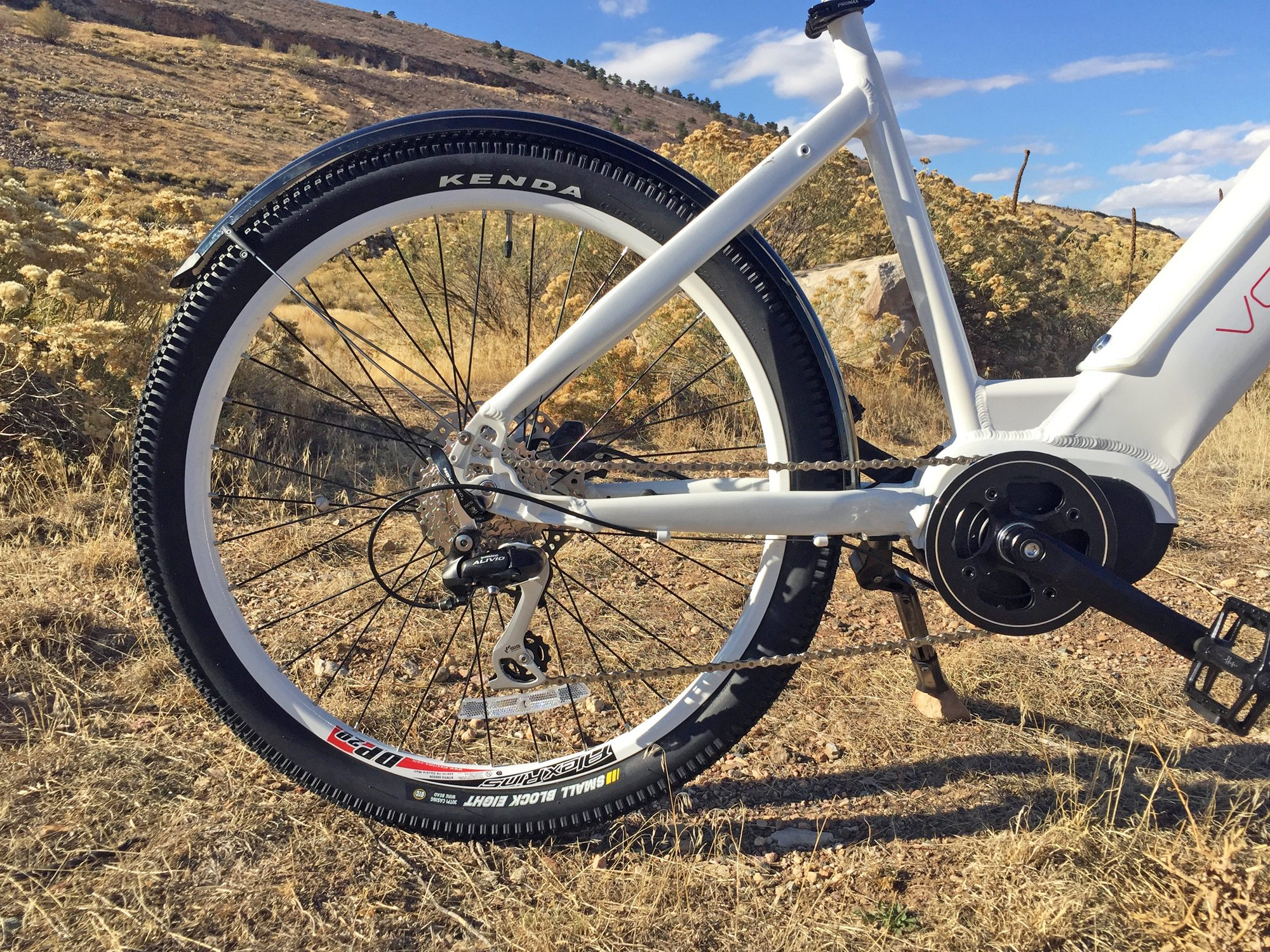

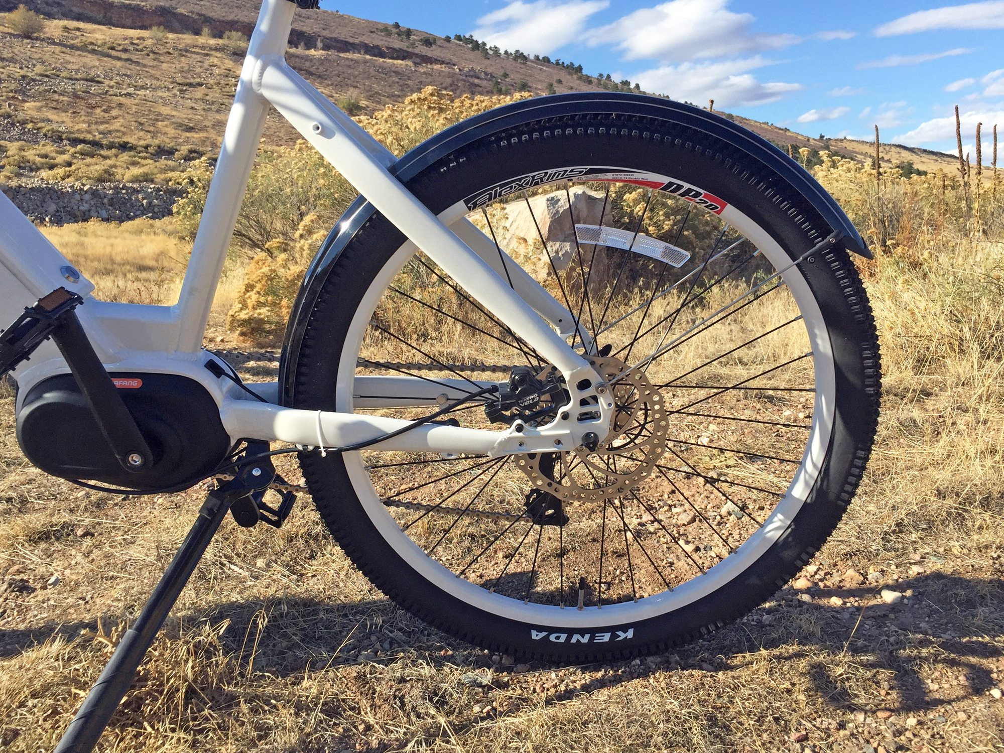

- Good choice on the tires, they were wide and grippy enough to handle the trail but rolled fairly smoothly on pavement, I also appreciated the upgraded thicker 13 gauge spokes for rugged terrain or heavier loads

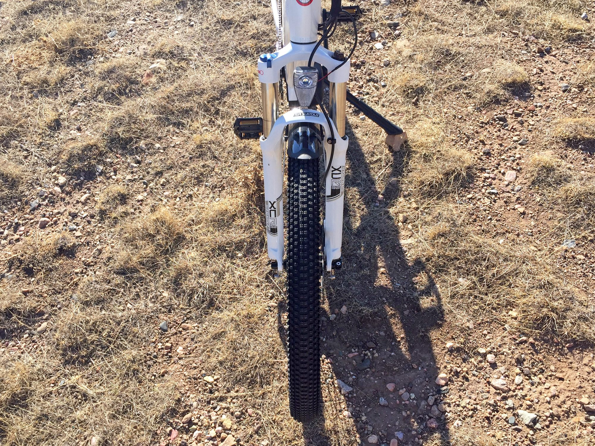

- Decent suspension fork with preload and lockout adjustment, makes it suitable to trails or city riding and I like that they sort of match the frame color depending on which one you get
- Both wheels have quick release skewers making it much easier to change flats or transport the bike if you don’t have a rack (like if you’re carrying it in your car’s trunk) without needing tools, this is one of the potential big benefits of mid-drive ebikes

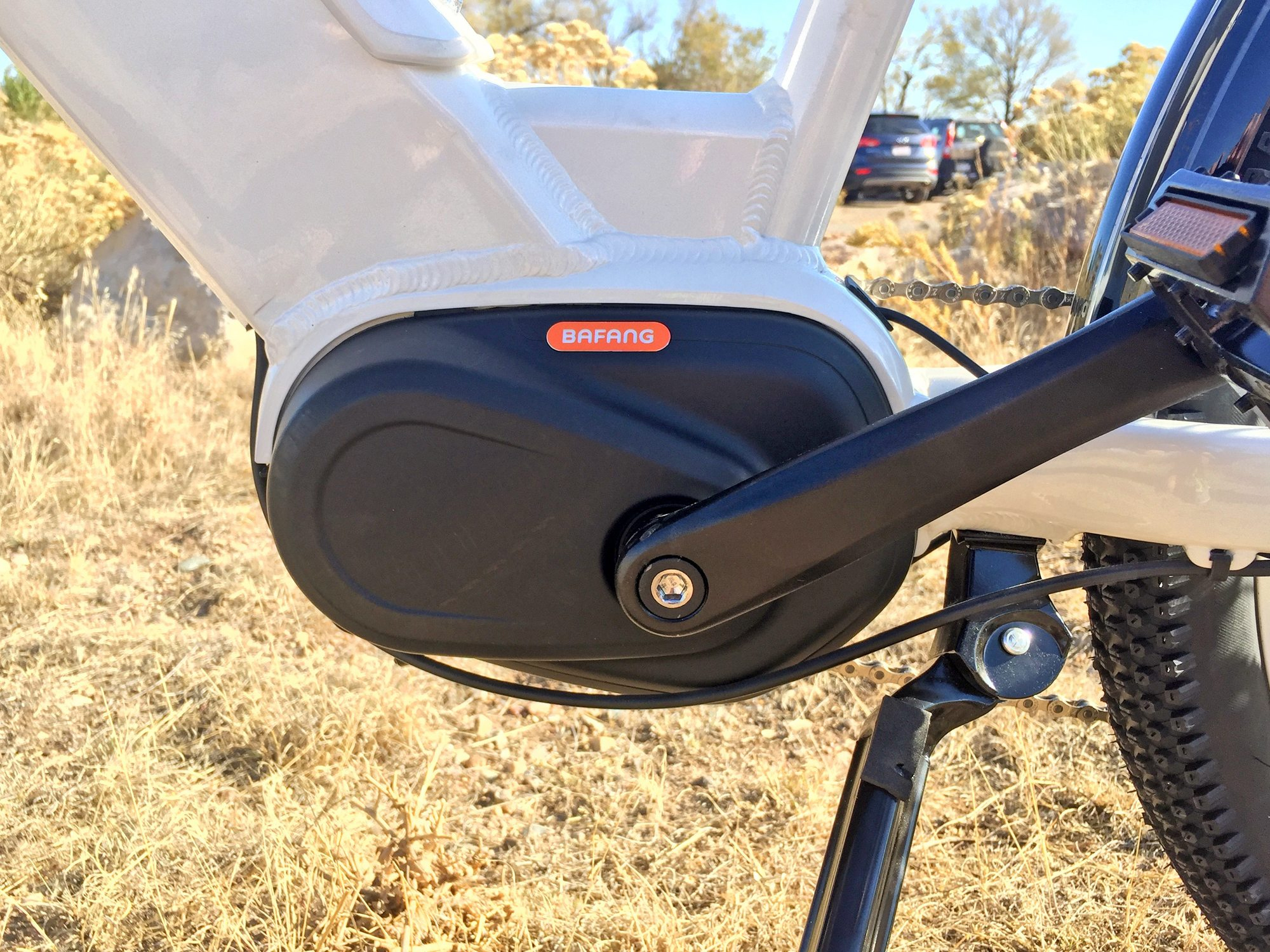

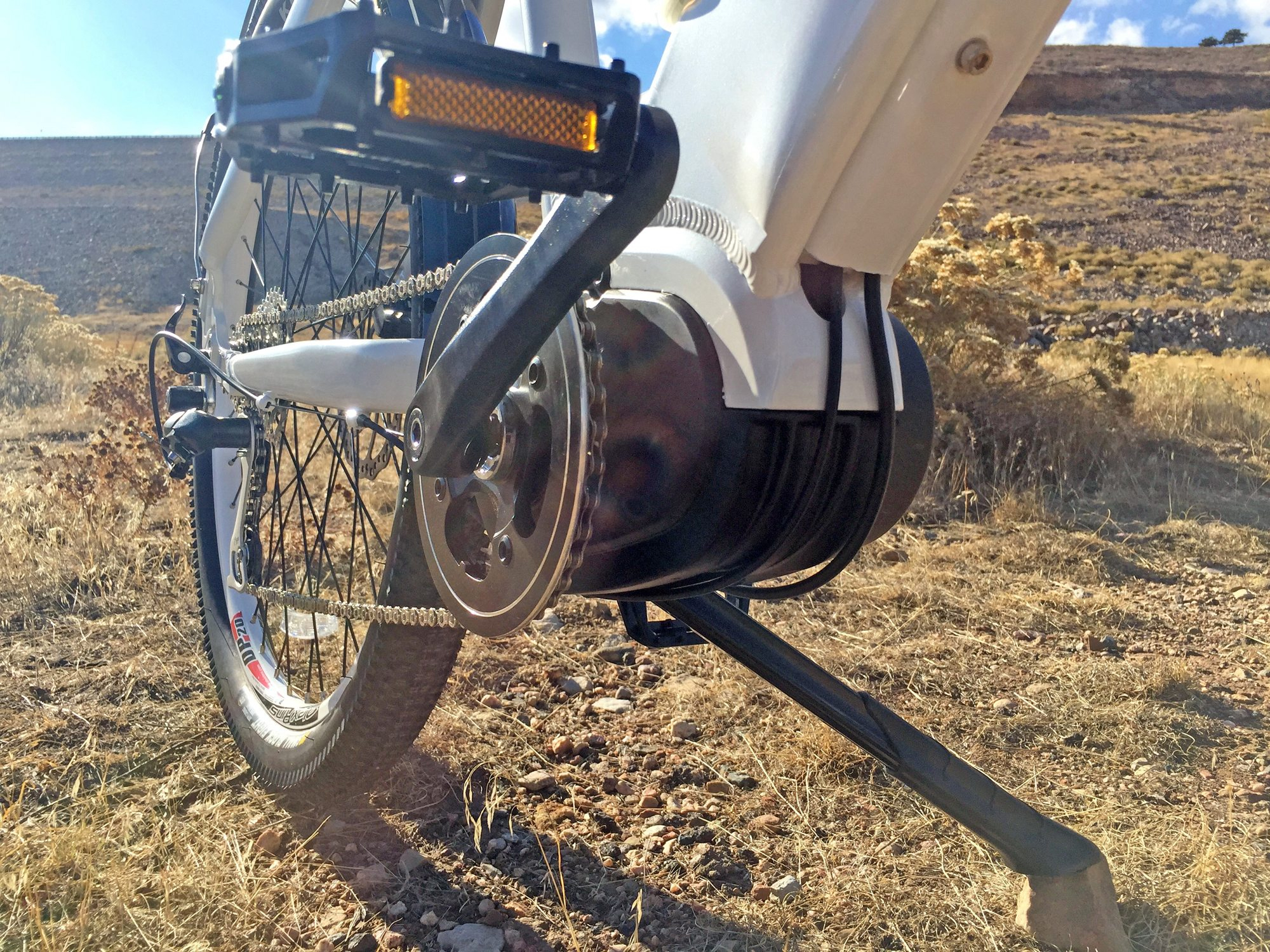

- The motor is compact, good looking and VERY quiet… possibly one of the quietest mid-drive motors I have tested to date, this is great when riding on trails in nature

- Hydraulic disc brakes with full sized 180 mm rotors! This is an important upgrade that helps the make the bike trail worthy, they are easier to use, stronger and smoother than mechanical
- The motor offers 80 Newton meters of torque which had no problem taking me up a steeper section of trail, you have to pedal since there’s no throttle but it worked great and truly impressed me given this was the first Bafang Max Drive electric bicycle I had tried

- I love that the display panel shows 10 ticks on the battery level indicator! that’s much better for communicating than a lot of ebikes which only have 4 or 5 tick

- I wasn’t a huge fan of the kickstand because it mounts at the bottom bracket exposing it to your cranks once parked (like if you back up the cranks will collide with it) and I felt that even in its longest position the bike still tipped too far to the side
- The deep step-thru model we tested felt a little front heavy and flexy which could turn into speed wobble if you ride 20+ mph fast without having a good grip and paying attention, it’s a common design compromise with single-tube step-thru’s
- The cover for the battery pack works well enough but didn’t completely seal at the top which could allow a bit of water in if it’s raining heavily… shouldn’t cause a huge issue as the battery is sealed inside the downtube in its own metal case but the bag it’s in could get wet
- I found the battery with the bag to be a little tricky to remove and put back in, I didn’t realize that you have to un-Velcro the straps first and I started to rip the demo model a bit, I think in practice I’d just leave the battery in most of the time but at ~7.1 lbs it would reduce weight if you took it off for transport and is handy that you can charge separately
- There isn’t a slap guard on the chainstay which means the chain will chip it over time as it bounces if you ride over bumpy terrain… you could get an aftermarket neoprene one like this if you expect to do trail riding

- The shifter cables, brake lines and wires are mostly hidden and protected thanks to a channel and cover along the downtube but they are exposed at and below the motor… thankfully the chainring drops even lower and has a big bash guard that would offer some protection but it’s not as refined as a Bosch, Brose or Yamaha mid-drive
- The display is fairly large and not removable, that means it could be exposed to more damage in the event of a crash and will take more sun and wear when parked outside, also there are no USB charging ports or other little extras

Hi Court, Nice review did you get the serial number under the motor to see if it is a standard 250W Max drive with a 48V battery: MM G330.250 or MM G330.350
Distance remaining: I have the MM G330.250. The battery level shows charge remaining, it shows in real time so you can see how far you can go in each assist level under the style of cycling you are doing. I can get 100km on assist level 1 cycling in the correct gear, so I know each bar represents 10km to me with my 35v,11.6Ah.
I reckon the display may be interchangeable with the bbs02 but have not tested, Volton didn’t mention anything about changing out the display. Court, if you overlook the display experience (usability of the display) and took it out of the equation and focused on ebike riding experience where would it rank against other mid drive motors: Bosch,Brose, yamaha, BBS02? D
Court Rye says
Hi Daniel! I cannot confirm the serial number as the bike has been returned to Volton but perhaps they will chime in? I was so impressed with and excited about the motor that I shot a separate video exploring it more thoroughly here. I thought the display was alright… yeah it’s a little large but it feels solid and has great readouts :)
Joe Marchfield says
Daniel, The motor tag is a 330.350. I’ll have a MM display connected to a BBS setup and update. I have a feeling they may not be compatible. Appreciate you checking the new Alation out. Joe [email protected]
