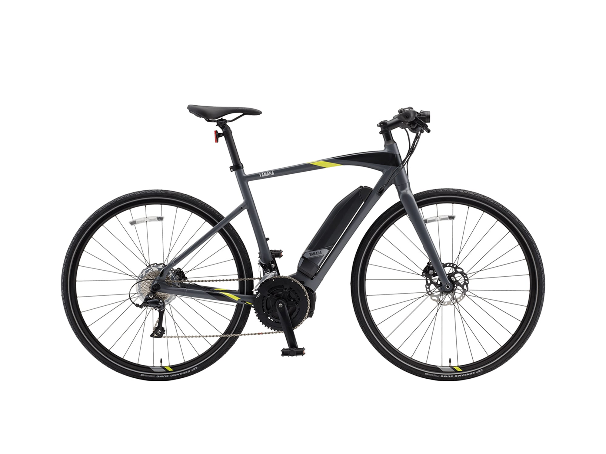

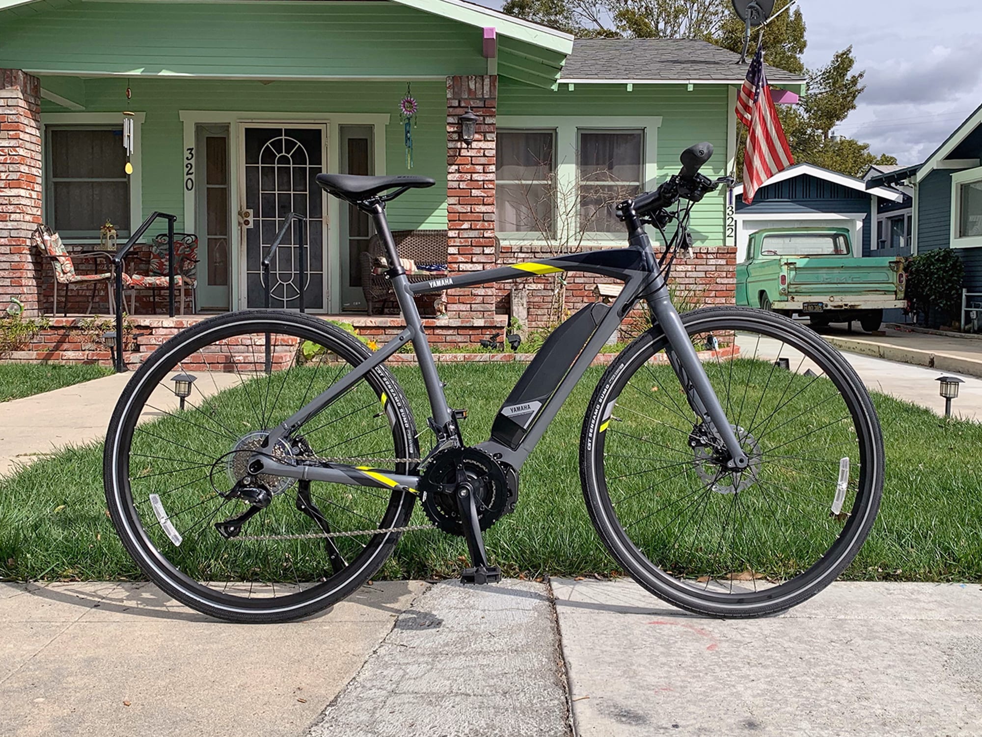

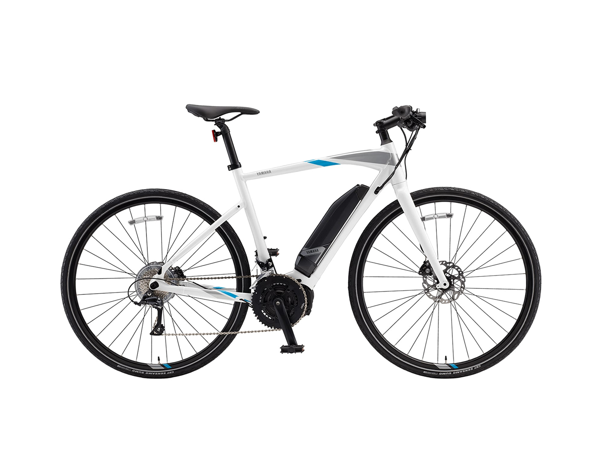

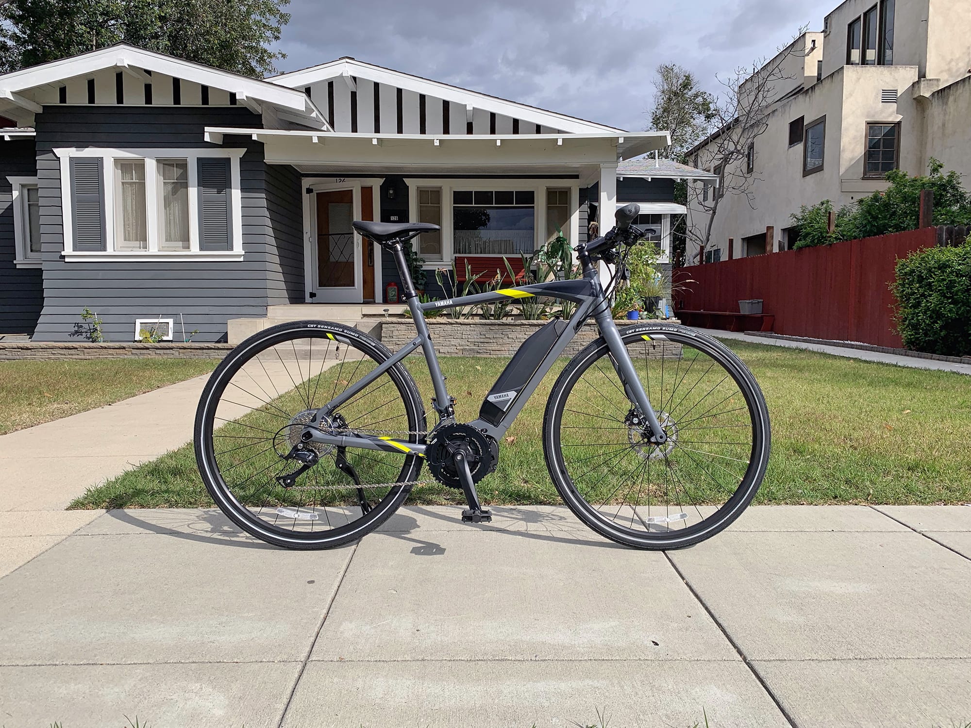

Today I got a chance to review the Yamaha Cross Core and I am super excited to share this information. Currently, Yamaha offers 4 ebikes, the race inspired Urban Rush, the mountain YDX Torc, the affordable Cross Core, and the commuter oriented Cross Connect. The Core and Connect don’t just share the same Cross name, but they are essentially the same bike frame with the Connect having more options attached for commuting uses while the Core maintains a value price while still offering key functions. The two are very similar so if you get a chance to see my review on the Cross Connect, you may see a lot of parallel information. However, there are differences, so I will point those out along the way. Years before entering the scene, Yamaha did focused research on the North American ebike market looking at needs and wants as well as pulling data from their use in brand name bikes like Haibike, Giant, etc. If I could summarize the results, I would say they are going for a balance of price, performance, efficiency, and a purist feel. Other than the Yamaha name, many will also be drawn to this bike for the price. The Cross Core is $600 less than the Cross Connect, coming in at an affordable $2.399. While only having 1 frame style option, the bike comes in 2 colors: Slate Gray or White Opal. It comes in 3 sizes, Small, Medium, and Large. For those looking to really dial in the right fit, I recommend checking out the sizing chart on Yamaha’s website as it really gets into detail on each and every measurement on the bike. The frames are a bit on the smaller size, even more so than the sizes on the Cross Connect, so stem risers are a common aftermarket accessory. It’s a extremely lightweight bike overall, I weighed the bike and came up with 44.5lbs, which is about 5lbs lighter than the Cross Connect, really an unheard of weight in many ebike segments. When comparing to its big brother, the Cross Connect, the first thing you will likely notice is the lack of fenders, rear rack, and suspension fork. This is not exactly bad news however, because not only does this keep the cost down, but Yamaha had the insight to add bosses for fenders, rear rack, and bottle cages… so really you could customize this and add them yourself to get a setup that is perfect for you. On the other hand, the bike does not have a tapered head tube, so you will likely have to get used to the rigid fork. I am happy to report that one of my favorite features made the cut on this bike and that is the battery integrated Yamaha LED headlight. The headlight is a nice aluminum alloy housed unit with internally routed wires, giving it a clean look. For tires, Yamaha equipped these 28” CST E-Series Pro’s, which are ebike specific tires rated for the higher speeds. They have reflective sidewall stripes and protection level 5 puncture protection with decent air volume (although narrower). Being somewhat larger tires, they still provide for a lower attack angle which does well to soak up the area if it gets a little bumpy. Complimenting the tires are these nice lightweight rims made of double walled aluminum alloy. There are 32 14 gauge spoke rims with eyelets which is great because that means less of a possibility that they will crack. A strong 12mm thru-axle is present on both the front and the rear wheel, which makes maintenance a cinch and really helps support the the rims making it more sturdy and capable of handling those higher speeds. Other features include ergonomic locking grips, active saddle, integrated bell, internally routed cables, a kickstand positioned out of the way for reducing pedal lock, and a 30.9mm rigid seat post.

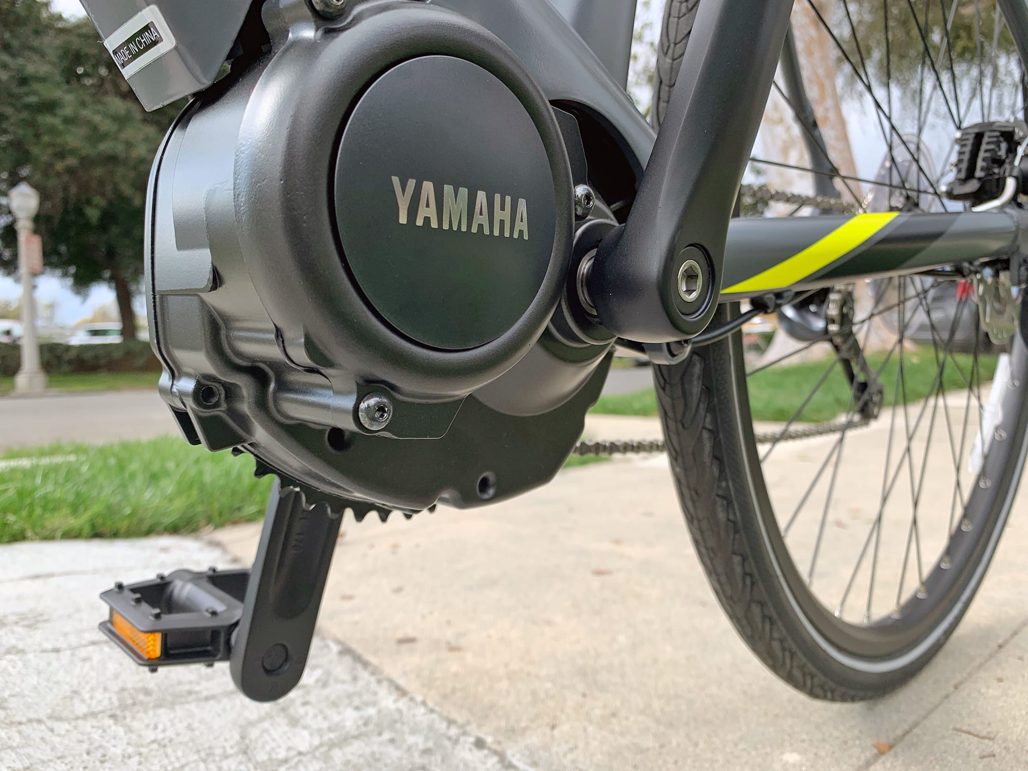

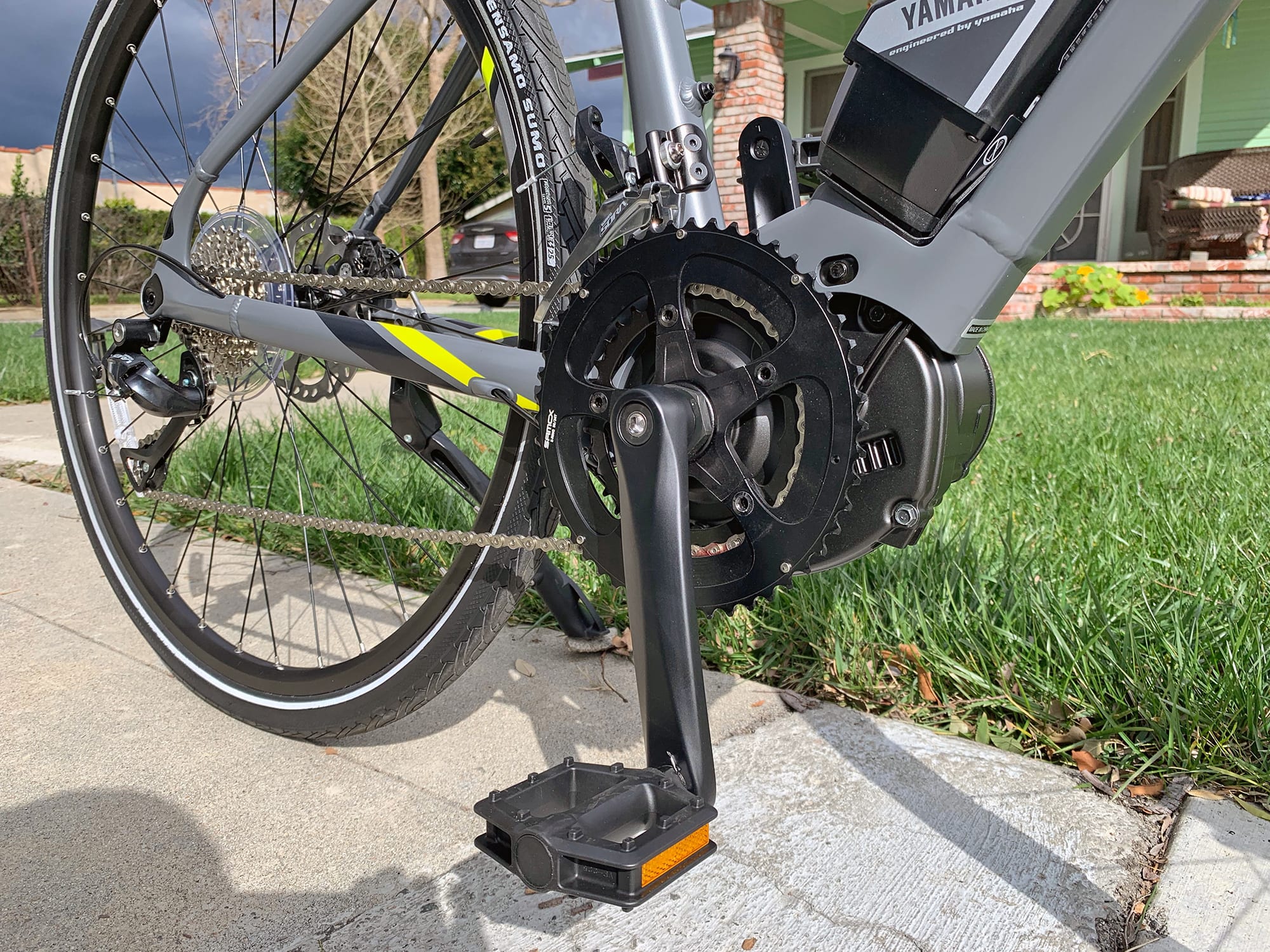

Driving this e-bike is the compact, quiet, and reliable Yamaha PW SE mid-motor. All of the dealers that I’ve asked about this motor have said that it never comes back with warranty issues. And, that’s not surprising considering that Yamaha comes from the power sports industry and has been making internal combustion engines for decades. They make generators, motorcycles, snowmobiles, jet skis, and a whole host of other machines that get exposed to long term use in rigorous environments. The electric bike motors fall right in line with this professionalism and I have been told by many dealers that Yamaha is the most reliable electric motor brand they carry. The PW SE is their mid-level electric bike motor, and offers up to 70 Newton meters of torque. It has sensors to measure rear wheel speed, cadence, and torque. It is quite noticeable, yet very smooth at the same time. Its fluid and quiet at low pedal speeds, unlike other bikes that kind of jerk you along a bit. The power rating is 250 to ~500 watts, and the only drawback compared to higher specced PW-X drive systems is that it offers a more limited 110 RPM cadence support as opposed to 120. In short, you cannot pedal faster than 110 RPM and expect much motor assistance, it just doesn’t spin that quickly. But for a value priced bike like the Cross Core, that’s not much of an issue… Most bikes in this range are not nearly as sophisticated. There’s a plastic shell built along the base of the bottom bracket to protect the motor from rock and log strikes if you do go off road. And, the motor and battery blend into the seat tube and downtube nicely, the ground clearance is pretty good and everything feels solid and secure. I like how most of the shifter, brake, and power cables are internally routed through the frame of this bike. You can pedal with the motor turned off, and it feels very efficient because there’s no drag from reduction gearing or magnets, but there isn’t a shift sensor here. If you don’t ease back a bit before changing gears, the motor could still be active and stress the chain, sprockets, and derailleur. The Yamaha PW SE motor takes a moment to spin down, but is otherwise very fluid and natural. They advertise a ‘zero cadence’ start feature which aims to keep knee and hip pressure down, you don’t have to push very hard or for very long before the motor kicks in. For mechanicals, we have two 9 speed Shimano Sora derailleurs one for each the front and the rear making a total of 18 gearing combinations on top of the motor assists levels. The rear is a 11-30 tooth while the front is a 34-50 tooth chainring. A bit of a curious set up, having two chainrings next to each other means they can kind of act as a guide, but still the absence of a legitimate chain cover means you can still catch your pants when riding, so make sure to use a Velcro strap or something. Additionally, having the two means added weight and you could be looking at more tuneups or maintenance. Other than the chain ring setup, the other big mechanical difference between this and the Connect is that the Core has mechanical disc brakes instead of hydraulic. Mechanical disc brakes keep the cost down and are easier to adjust and maintain, but they do take more actuation and are not as responsive at hydraulic brakes. At first I was a little hesitant to get excited when I saw they are 160mm instead of 180mm, but both my test ride and experience from bike shops owners have told us that 160mm does indeed get the job done. The brakes also have this nice caliper with heat sync to dissipate all that heat coming off the brakes better. Also, having a slightly smaller rotor means it may be easier to park at a crowded bike rack. Overall, this is a Class 1 ebike with a top speed of 20mph, so I think its a really great choice.

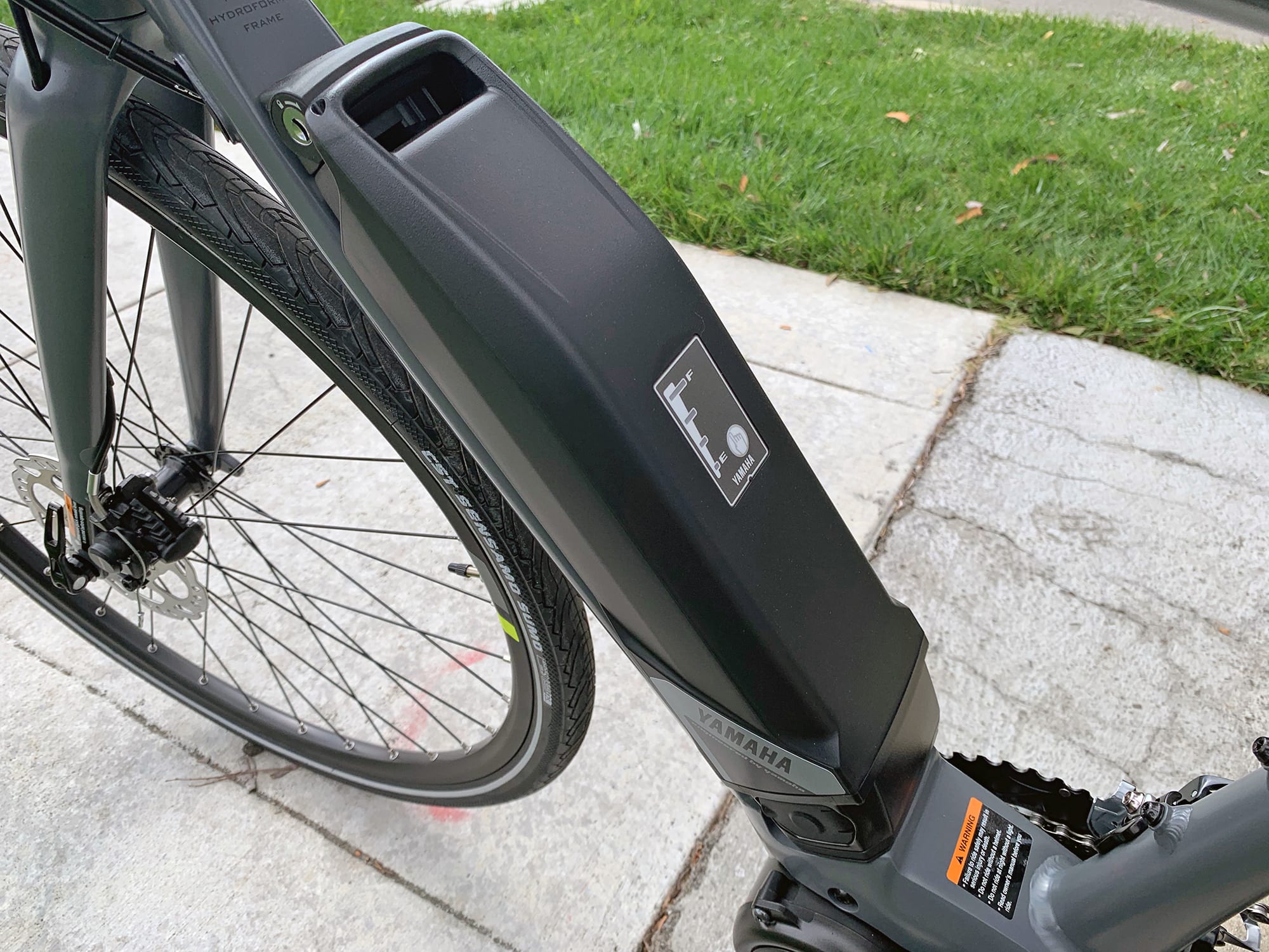

Powering the Cross Core is a 6.6lbs, 36v 13.6ah 489.6 watt hour Lithium-ion battery pack. It’s externally mounted to the downtube, flatter and longer than many competing products, and it tips in from the left side of the frame vs. going in vertically. There’s a lot to like about the Yamaha battery packs, the casing for the 400 and 500 watt hour packs is the same, so it’s backwards compatible if you own a second e-bike with the smaller pack. Maybe you get the Urban Rush model and Cross Core and then share packs between friends or family? While making this interview, I was informed that the Accell Group (owners of Haibike and other brands) have been hired to supply additional battery packs and service for customers in need. The pack is removable with lock and these unique neat looking little keys. There’s a sturdy, and wide, plastic loop at the top of these packs for secure mounting and transport. There’s even a sealed LED battery indicator built into the battery casing, so you can estimate how full it is without mounting to the bike or turning the bike on. And, the locking cylinder design seems sturdy. I like how it’s positioned up high on the mounting interface to reduce debris and dust exposure while riding. As it is currently designed, the charging interface is positioned low on the left, directly in the path of the left crank arm. This creates a point of vulnerability because the charging plug design is relatively thin and seemingly delicate, made of narrow hard plastic. In comparison to Bosch, (which uses a wider rubberized plug) I’m always concerned about stepping on the tip of the Yamaha charger tip and I definitely do not appreciate how long, bulky, and heavy the charger itself is, weighing in at 2.3lbs compared to Bosch at 1.6lbs. The fast 4amp output is much appreciated given the 500 watt hour battery, but this charger is one of the bulkiest on the market at this time and I haven’t seen a portable option from Yamaha yet, as I have from Bosch and Brose with some Haibike and Specialized models. In conclusion, this battery pack is great in many ways but definitely has some room for improvement, mostly with the bulky charger. It’s best to store any Lithium-ion battery in a cool, dry location, and avoid dropping and discharging below 20% to maximize stability and lifespan.

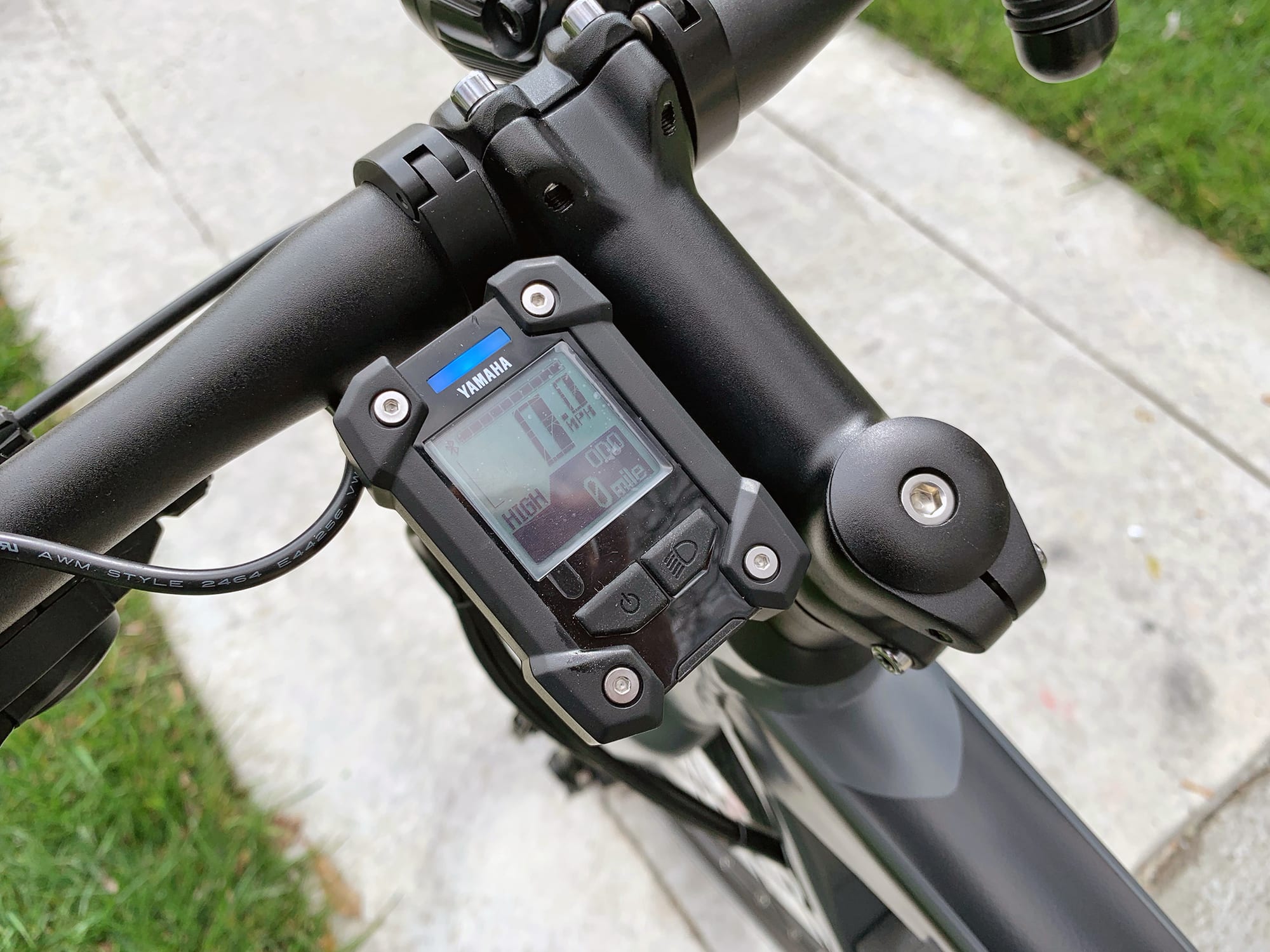

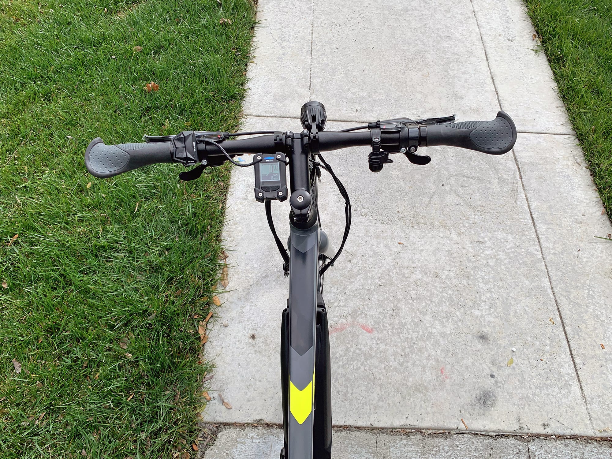

This bike features the excellent PW-X display. Yamaha has drawn earlier early control interface designs to create a durable but feature rich offering that maintains their Micro-USB port. I love that they kept this interface because it can be useful if you use a smartphone for GPS navigation, Strava, or music, as well as diagnostics and software updates. However, the 500ma rating means it may not be enough juice to power a newer iPhone at this time. The PW-X user interface consists of a compact LCD screen, positionable on either side of the stem, and a remote button pad, usually attached near the left grip. This button pad was still very reachable for me during the test rides and remains functional with the second set of triggers to control a front derailleur as is the case with the Cross Core. Buttons include a rubberized power button and light button on the display console along with plastic select, up, down, and walk mode buttons on the control pad. Once the display is turned on, the most basic interactions are to arrow up and down through Off, +ECO, ECO, STD, HIGH, and EXPW. Select allows you to navigate through different sub menus including odometer, trip meter, average speed, maximum speed, distance (range estimator), pedal cadence, time, and battery percentage. It was neat being able to test my pedal cadence on the fly, I really appreciate the range estimate to help gauge when to switch down assist levels in order to make it home without running out of power, and the 10-bar battery infographic and battery percentage drive this point even further. You can enable Bluetooth, disable the USB port, and even remove menus from that long list by holding the select button to get into a settings menu. There are even some deep dive options to tell both you and the service shop about various status updates with the bike and its electrical system too, very nice. And, there’s one final treat with this display. In addition to the blue-backlit LCD screen, there’s a colored light strip that matches up to the different assist levels. I think the idea here is to make it easy to glance down and know what level of assistance is enabled. It’s a great concept because the LCD itself is on the small side, but in practice, I found the LED readout to be difficult to make out in bright daylight. At night and in the woods it probably works best, and might even be distracting. And so, it’s also nice that you can completely disable the LED light strip back in the settings menu. All in all, this display does an excellent job. It mostly stays out of the way and is easy to interact with while pedaling, even without looking down because of the sloped clicky control pad design. It is not removable and cannot be swiveled to reduce glare, but the large plastic bezel looks tough and seems well protected inline with the stem. I love how clean and open the handlebar is, allowing plenty of room to attach a phone or light, the position of the display it self stays pretty protected by the stem and handlebars. Note that there is light button to activate the integrated lights as well. Overall, it is a bit of a busy cockpit with 2 finger brake levers, trigger shifters on the left and right for both derailleurs, and the display and controls.
For an entry level ebike to Yamaha’s lineup, there is surprisingly a lot to talk about with the Cross Core. I almost hesitate to call it value priced because of what it manages to accomplish and the professional manner in which it does so. It has this great minimalist and lightweight feel while giving most people everything they love in a regular bike as well as an ebike. In both the review for the Cross Connect and this Cross Core, I mentioned the redundancy of the two derailleur setup. After riding the Core, It kind of ‘clicked’ with me and I realized that some people may enjoy that shifting feeling. Similar to how shifting in a car can give you an advantage of control and accuracy, I think Yamaha may have been looking to add that to an ebike industry that may have lost that in some ways with big powerful hub motors and throttles that feel more like scooters. I really do think that Yamaha is on track to balance price, performance, efficiency, and that purist feel. Although Yamaha is a big name and really did their homework, there are still a couple of tradeoffs to consider if you want this to be a perfect fit for you. At this point, it may feel like splitting hairs, but some of these concerns may be valid to you, so they are worth mentioning. I love the reflectors on the pedals, but the pedals are a little generic, somewhat narrow, and plastic. A small point to make, but this was likely to keep cost down and pass those savings on to consumers. I do worry about the maintenance that could come up with two derailleurs and I wish we saw some new extras like shift detection or a smaller, more portable charger, but these are all things that probably won’t hinder you enjoyment of the Cross Core itself. As a matter of fact, there is just so much smoothness, efficiency, cleanliness, and overwhelming reliability, that it will likely be a standard bearer for a long time as to how to get everything in harmony. It’s no small wonder as to why they use a tuning fork for their logo, this bike strikes fantastic balance for affordability and performance. It has a considerate 3 year warranty backed by a 65 member and growing dealer network. The dealers get reimbursed for work done too, so any of them should be happy to help you with any needs should they arise. With an MSRP of $2,399, it will impress many looking for a great bike from a company with a great reputation that don’t want to spend upwards of $5,000.

Pros:
- Quiet efficient mid-drive PW-SE motor, proven and reliable tech with a great natural feel and protected display
- Has a minimalist look and feel, keeping mechanical components connects and in harmony while only weighing 44.5lbs
- Comes in 2 colors, Slate Gray or White Opel, also comes in 3 sizes, Small, Medium, and Large
- Has a strong thru-axle for both the front and the rear wheel, 12mm on each, great for maintenance and stability

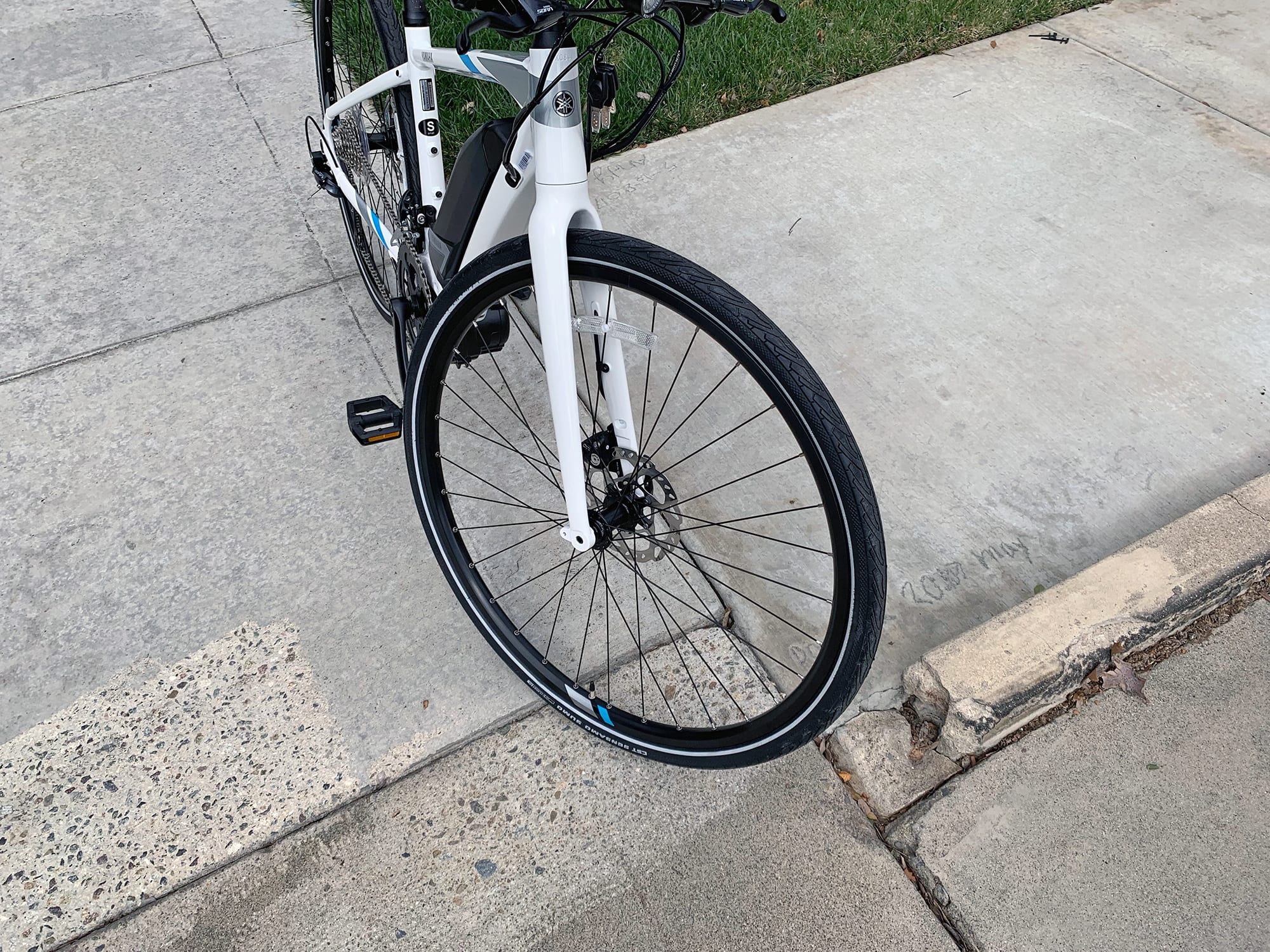

- Has a nice set of 28” CST E-Series Pro’s, which are ebike specific tires rated for the higher speeds, including reflective sidewall stripes, and protection level 5 puncture
- Some nice lightweight rims made of double walled aluminum alloy, 32 14 gauge spoke rims with eyelets which is great because that means less of a possibility that they will crack

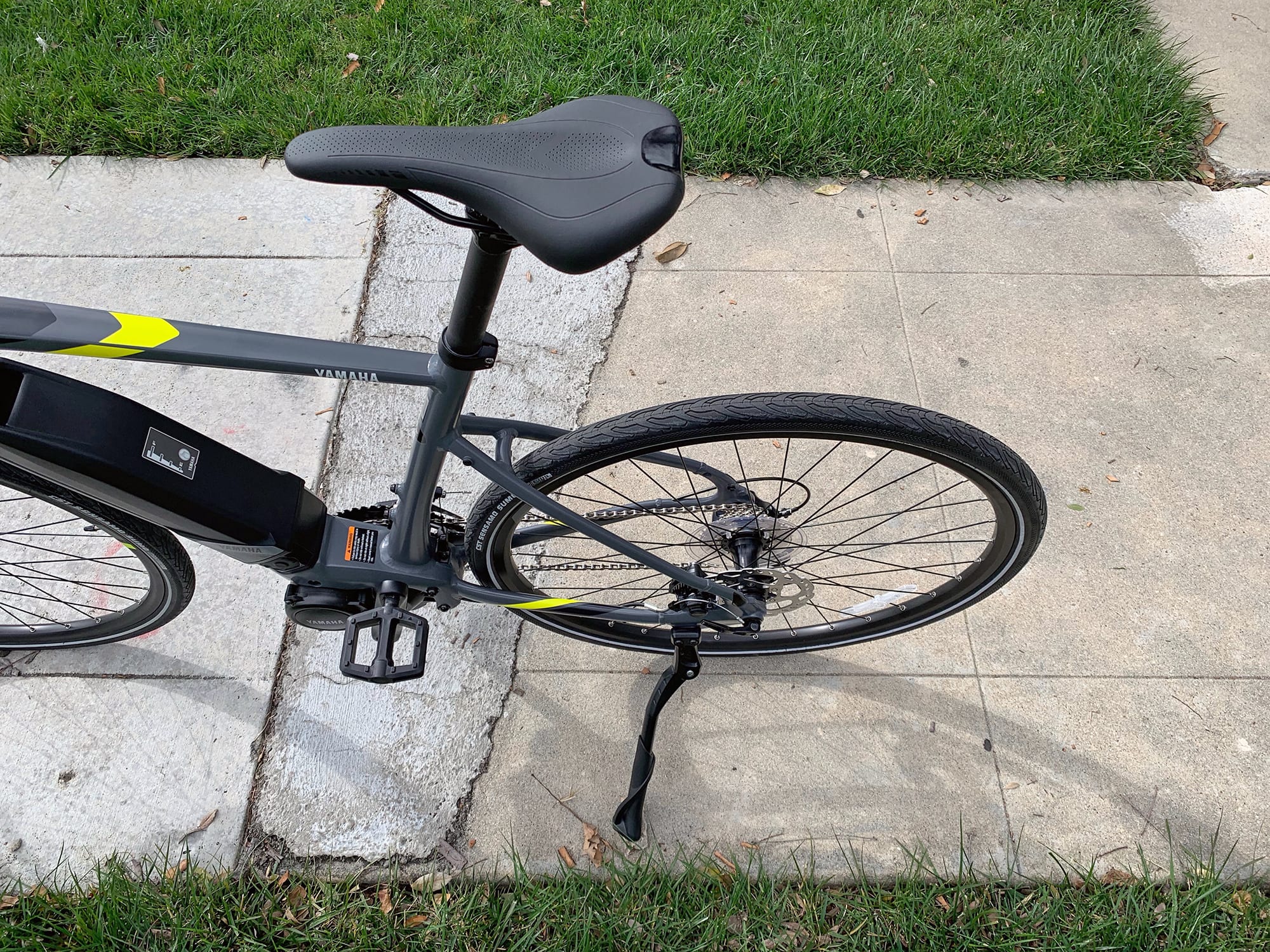

- Integrated bell and kickstand, with the kickstand being positioned out of the way to avoid pedal lock when backing the bike up
- The PW SE is capable of measuring rear wheel speed, cadence, and torque, it is rated at 60nm and 250-500w of power with 110rpm cadence support

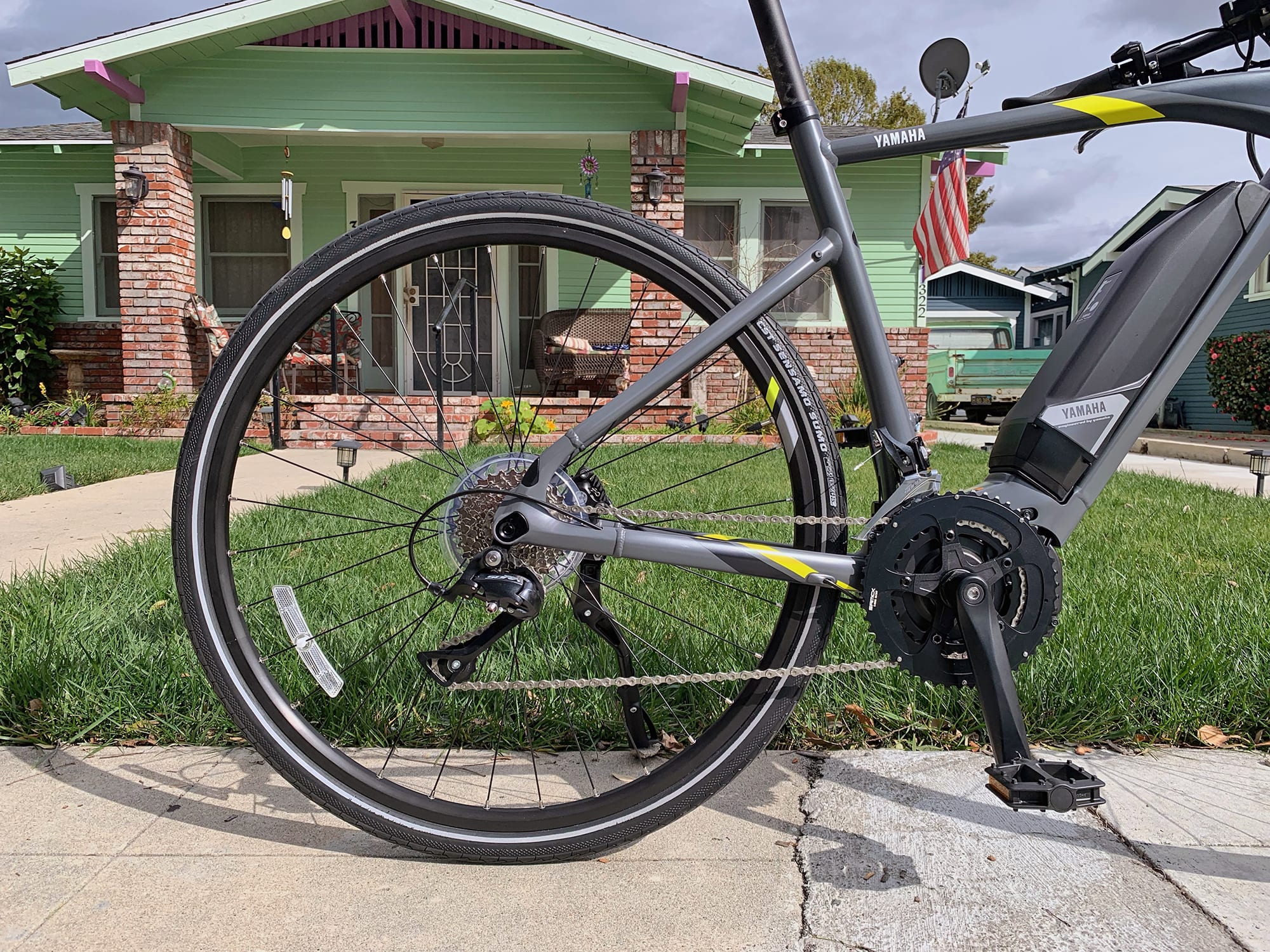

- The drivetrain and powertrain play well together, there are two 9 speed Shimano Sora derailleurs (one for each the front and the rear) making a total of 18 gearing combinations on top of the motor assists levels
- 160mm Shimano mechanical brakes come standard with 2 finger levers, low maintenance, easy to adjust, and adequate stopping power for this lightweight setup
- 36v 13.6ah Yamaha battery with a 4amp charger, a great upgrade charging quicker than the 2amp chargers we sometimes see on value oriented bikes
- The PW-X display is positioned wonderfully by the stem and handlebars, keeping the already rugged aesthetic even more protected in case of a crash or debris
- Most companies do a 1 or 2 year warranty, its nice to see a big name like Yamaha get competitive and offer a 3 year warranty, really standing behind the product
- A great balance of price, performance, efficiency, and a purist feel

- The pedals are a bit narrow, plastic, and somewhat generic, likely chosen to keep costs down

- Like the Cross Connect, the lower part of the battery houses the charging port and when mounted is in the way of the crank arm, so do be mindful when charging on the bike
- Two derailleurs mean added weight and could be more maintenance and tuneups, similarly, there is no chain cover (although the second ring can act as a chain guide), so be careful with pants

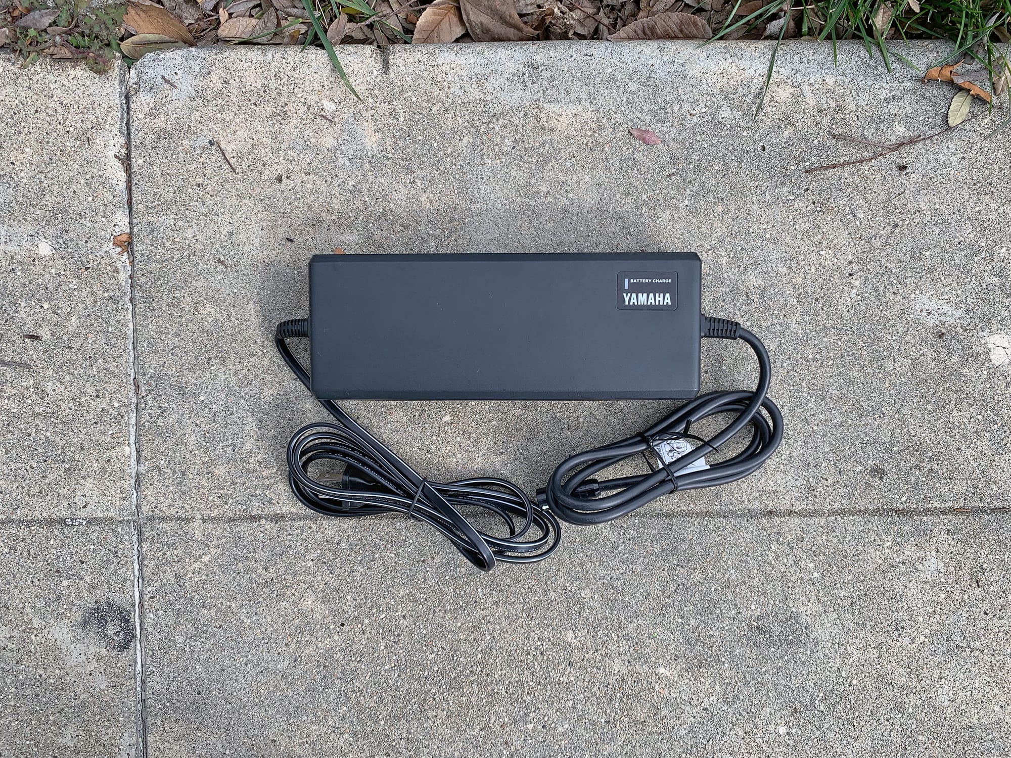

- Yamaha’s standard battery charger is nice and quick because is is 4amps, but it is on the bulky side and has fixed long wires, making portability somewhat of an issue
